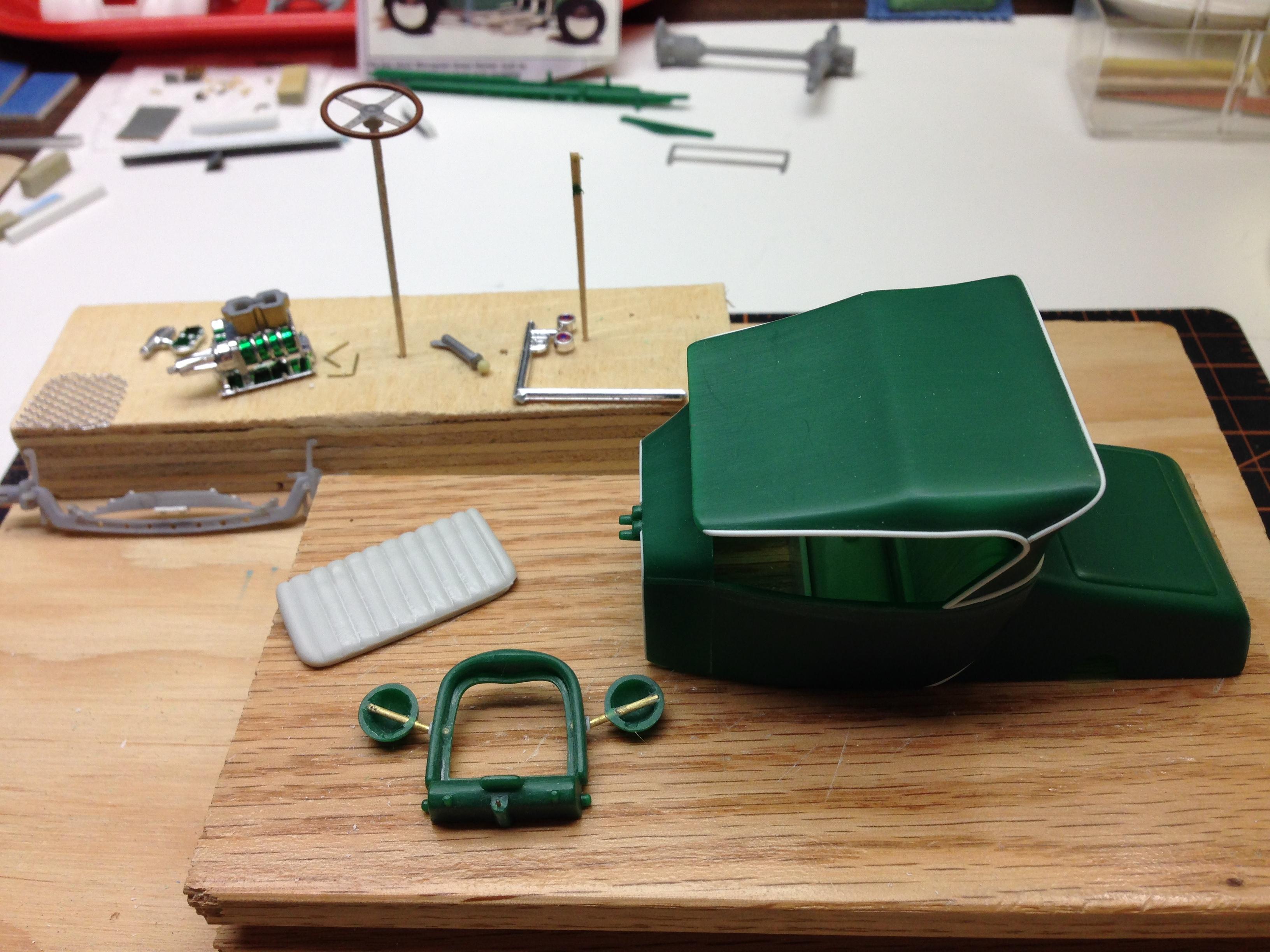

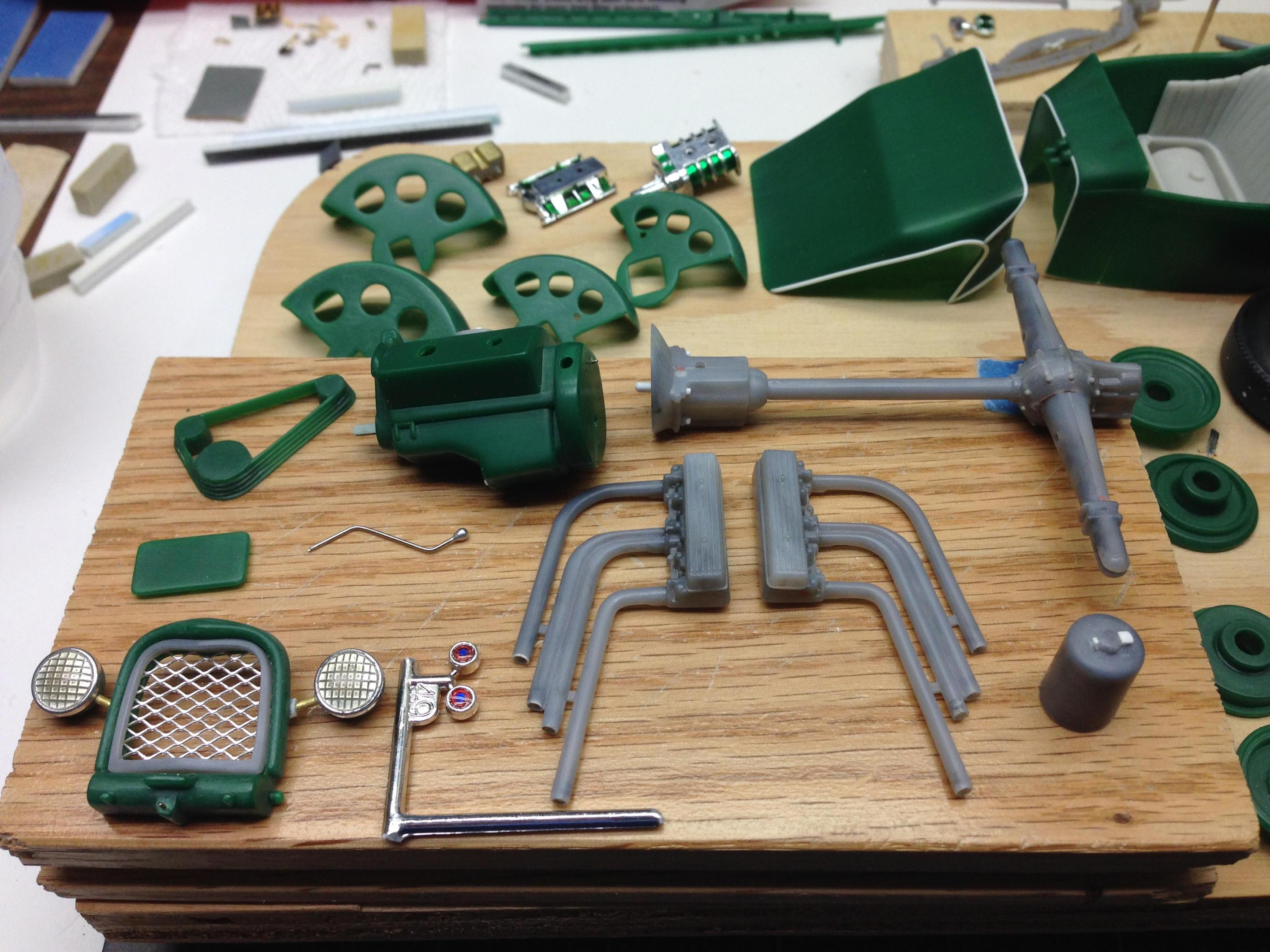

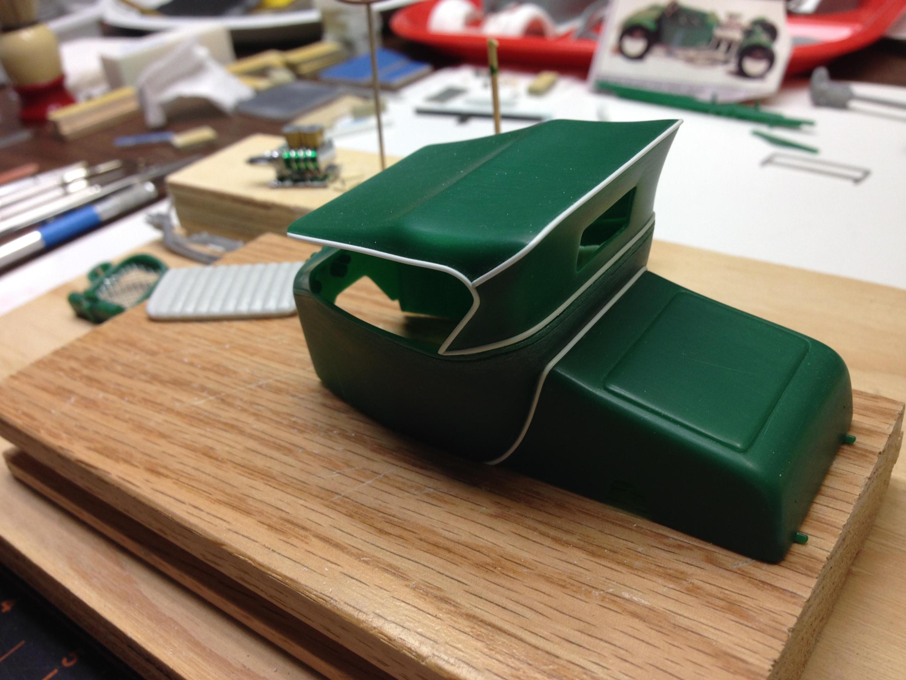

Thought I might as well jump in and post something being worked on in the model room. Chose the Green Hornet because I am having fun with it!  The model build was started awhile back and put away, got it back onto the bench and we will see where this goes. Made some changes because I can never leave well enough alone and am considering a bench seat instead of the kit piece. Don't look for a fast build here, folks, 'cause it ain't going to happen!?  Anyway, here is what I have going on with the build at this point.  Comments and suggestions always welcome.
Joe
  • Like 2

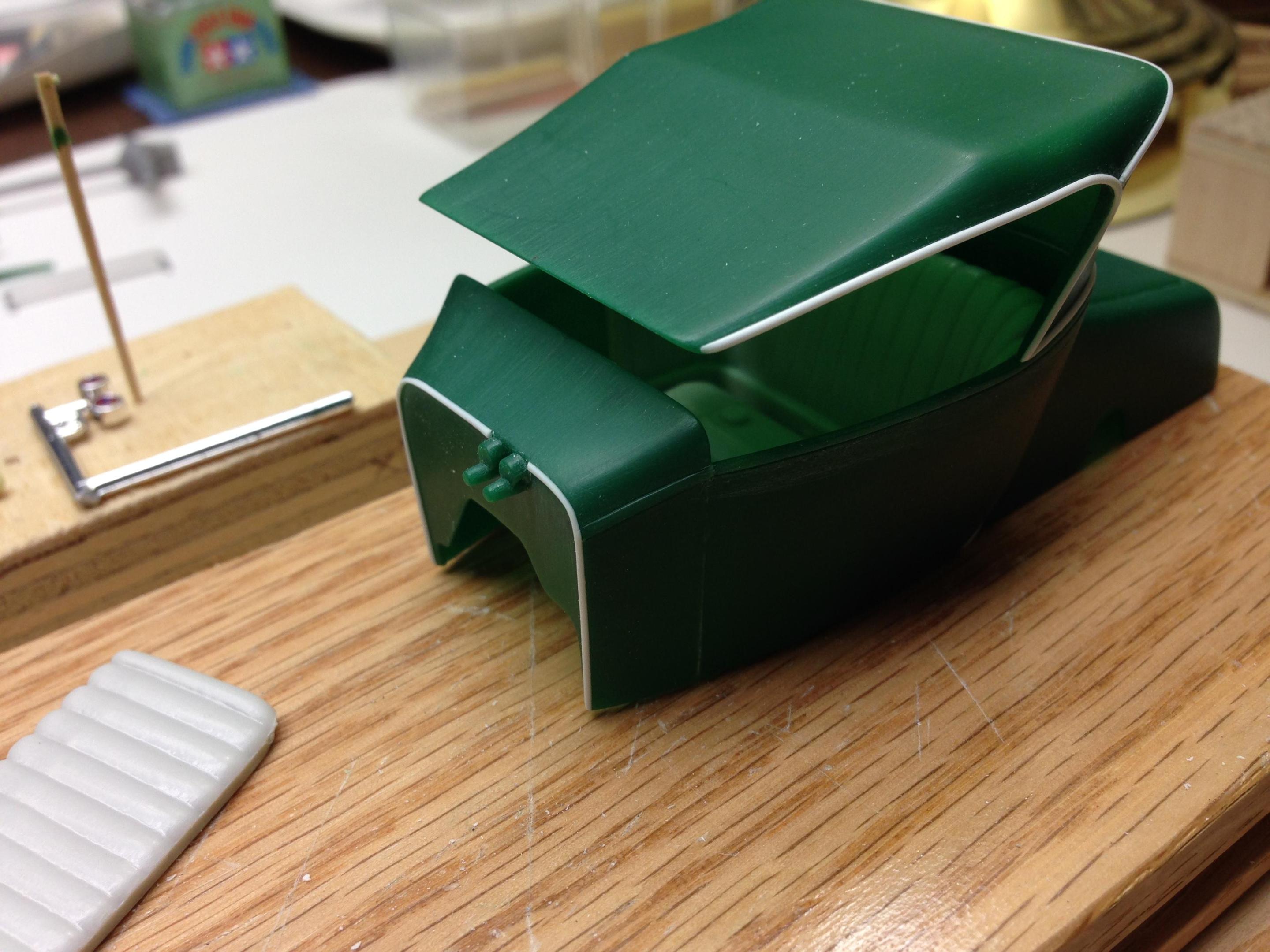

Still working the tops lower edge to fit nicely to the body. Right now the top will sit on the body by itself without support so it’s coming along. Need to make a decision regarding the seat modification though; not much of a frame under the seat area and I would have to put flooring under the body. I like the idea of the bench seat but wondering if it would look hokey with the minimal frame structure.
Joe

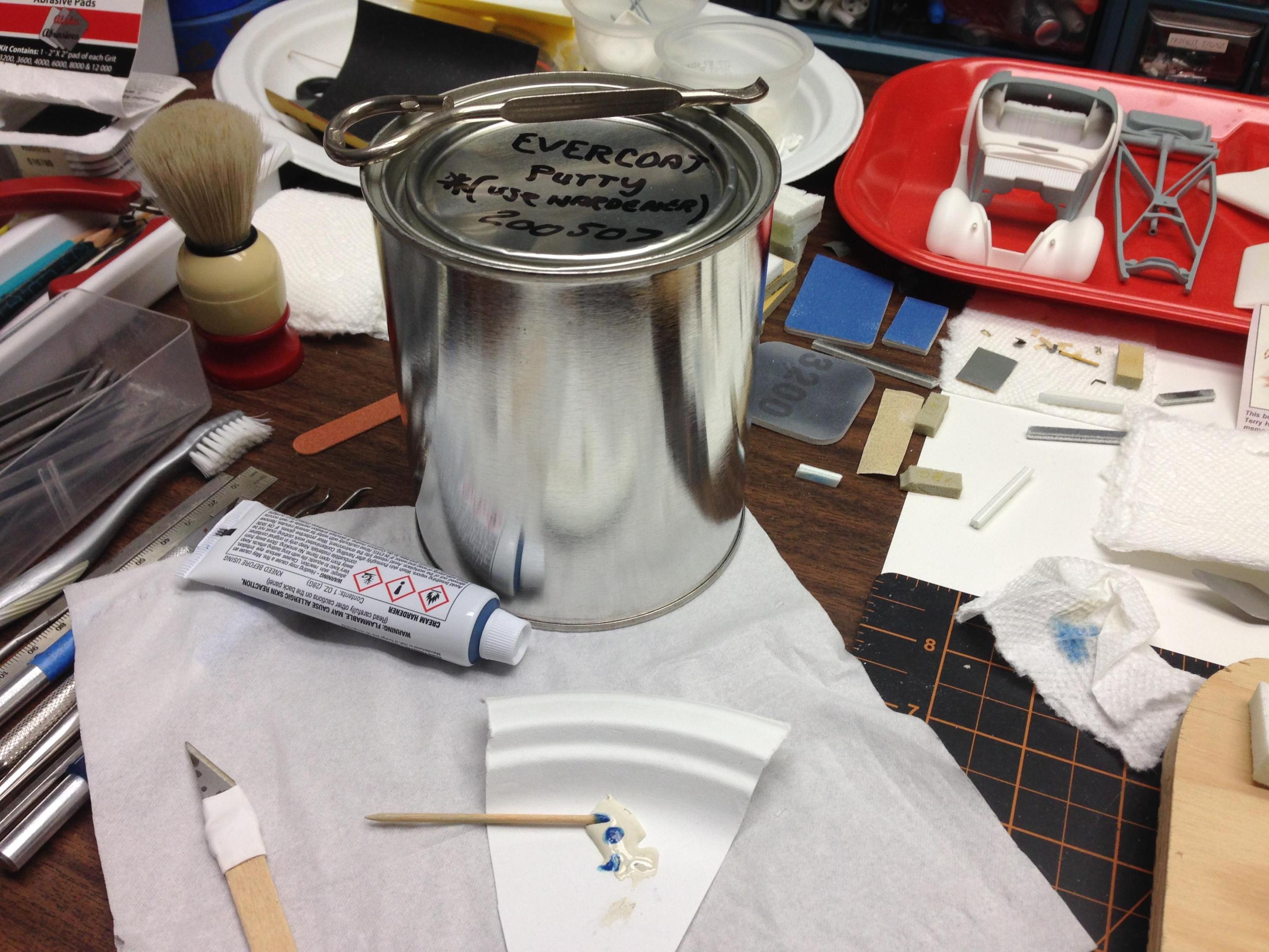

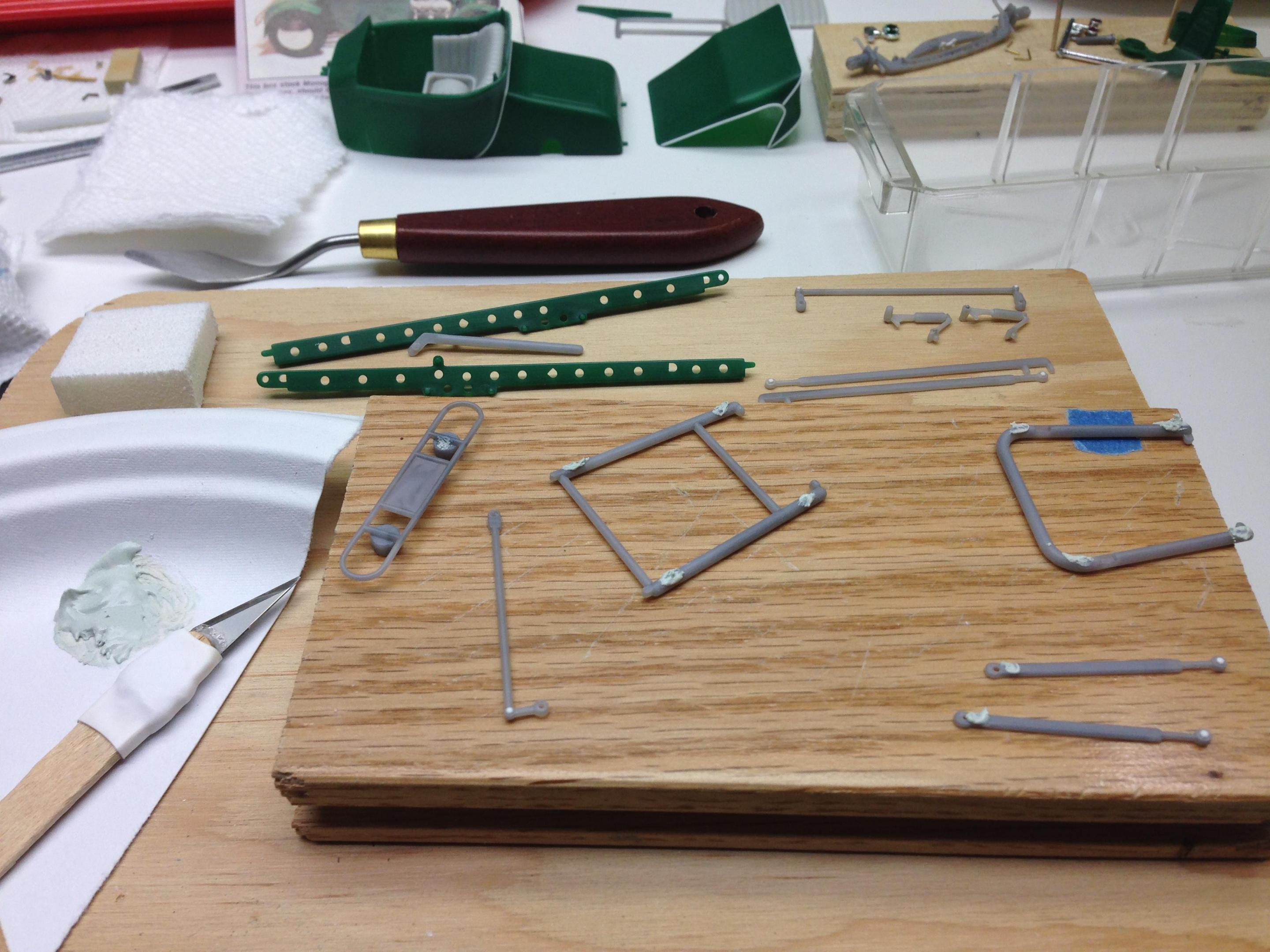

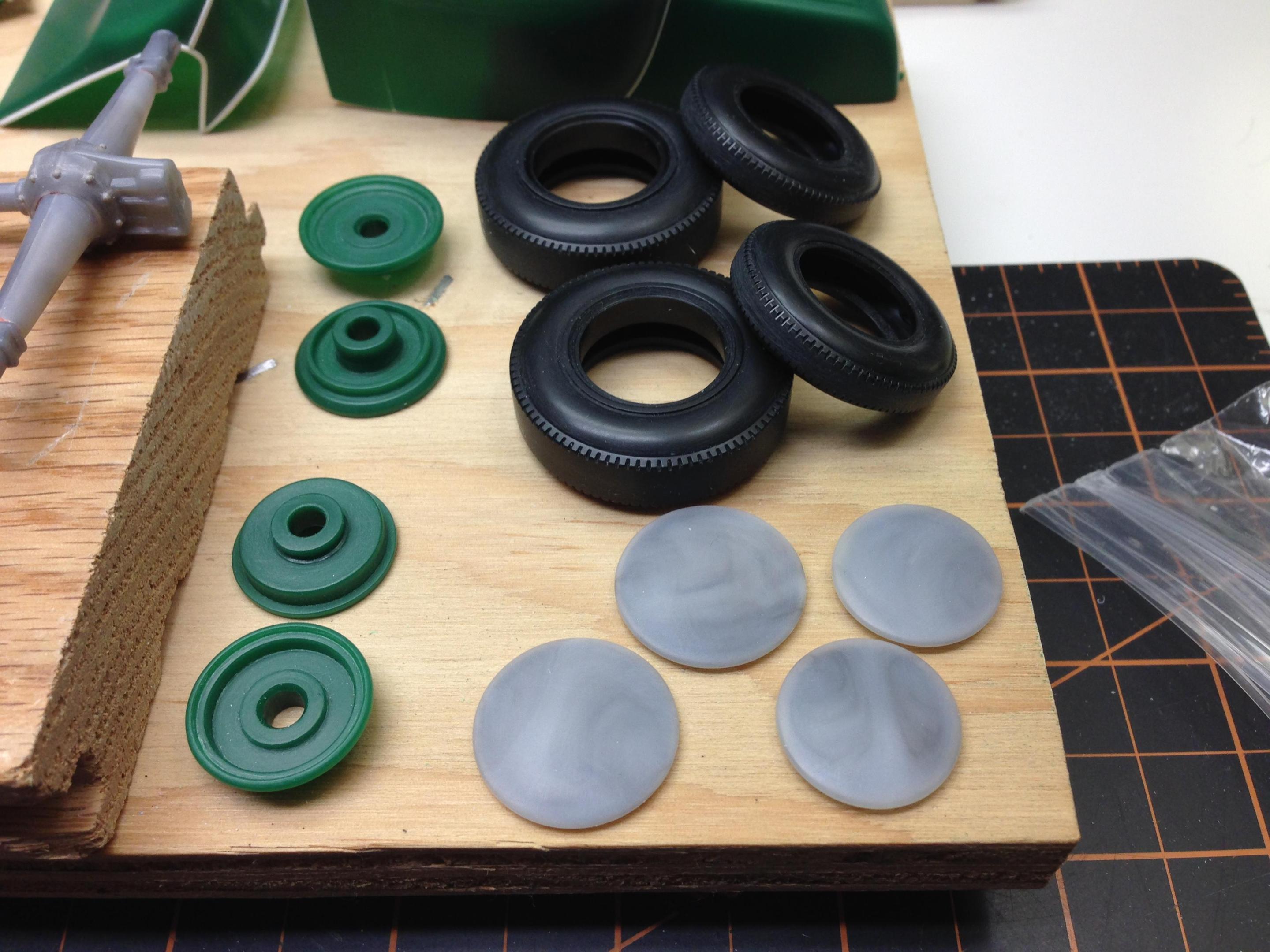

Have removed the chrome from the majority of chromed kit parts to facilitate cleanup. Got the items sanded and have filled the mold dimples on the parts that needed it using Evercoat Putty. Will let the putty dry and then get back to the model parts.
Joe
  • Like 2
Nice work! One of my favorite kits to play with. Beware that there are a ton of sink marks etc.. like the length of the frame rails.
Onto the fun part.. the kit builds with a removable body… and nearly every 20-30s body in 1/24 and 1/25 fits on it!  Maybe build it with two switcher bodies?  ?

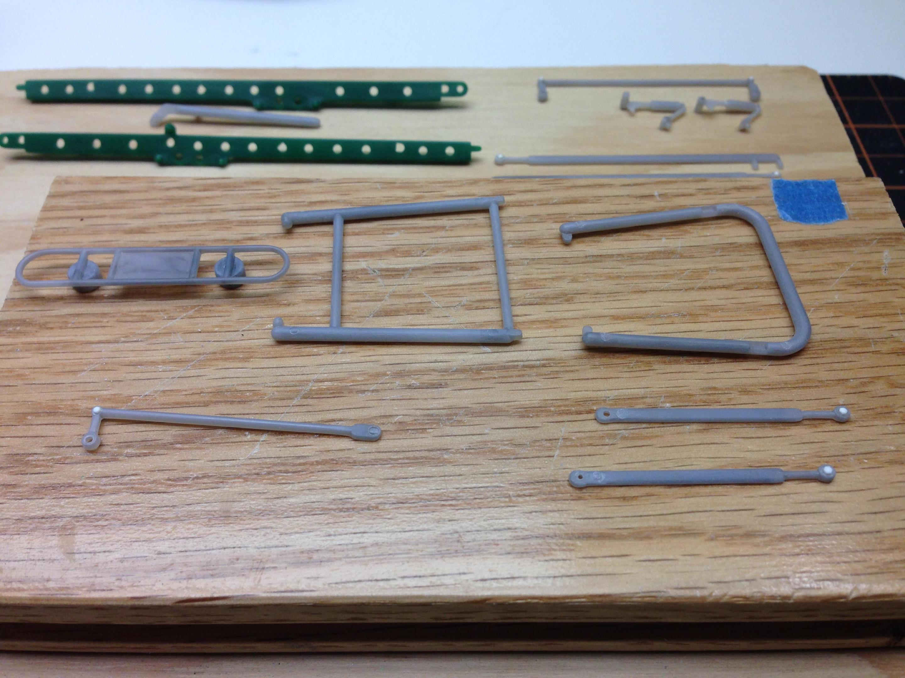

Have done quite a bit of sanding and cleaning up of parts with this release. Opened up the frame holes so they would be similar in size and crisp and I will need to add some putty to the rails before I am satisfied with them, however, it’s all part of the fun.
Joe

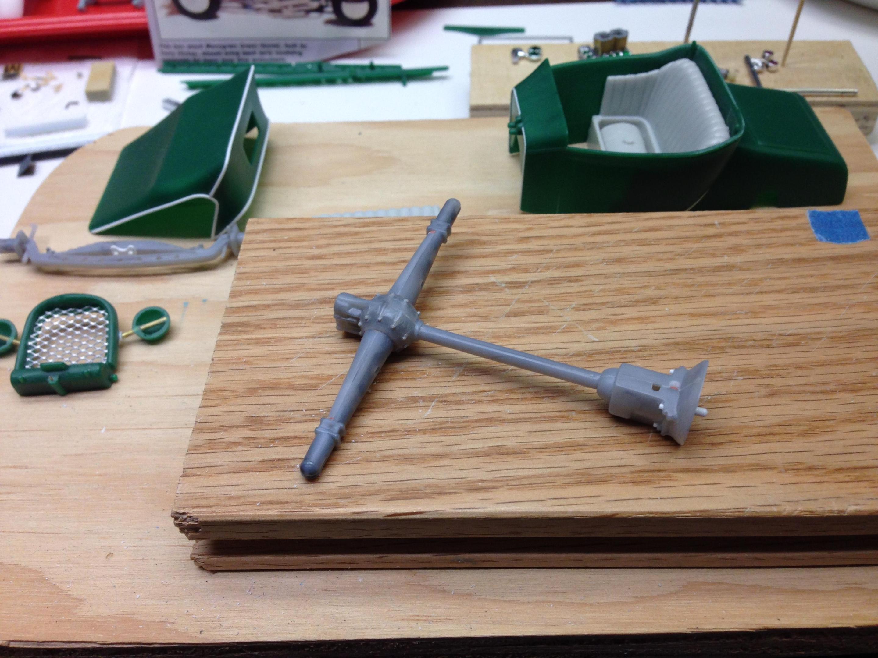

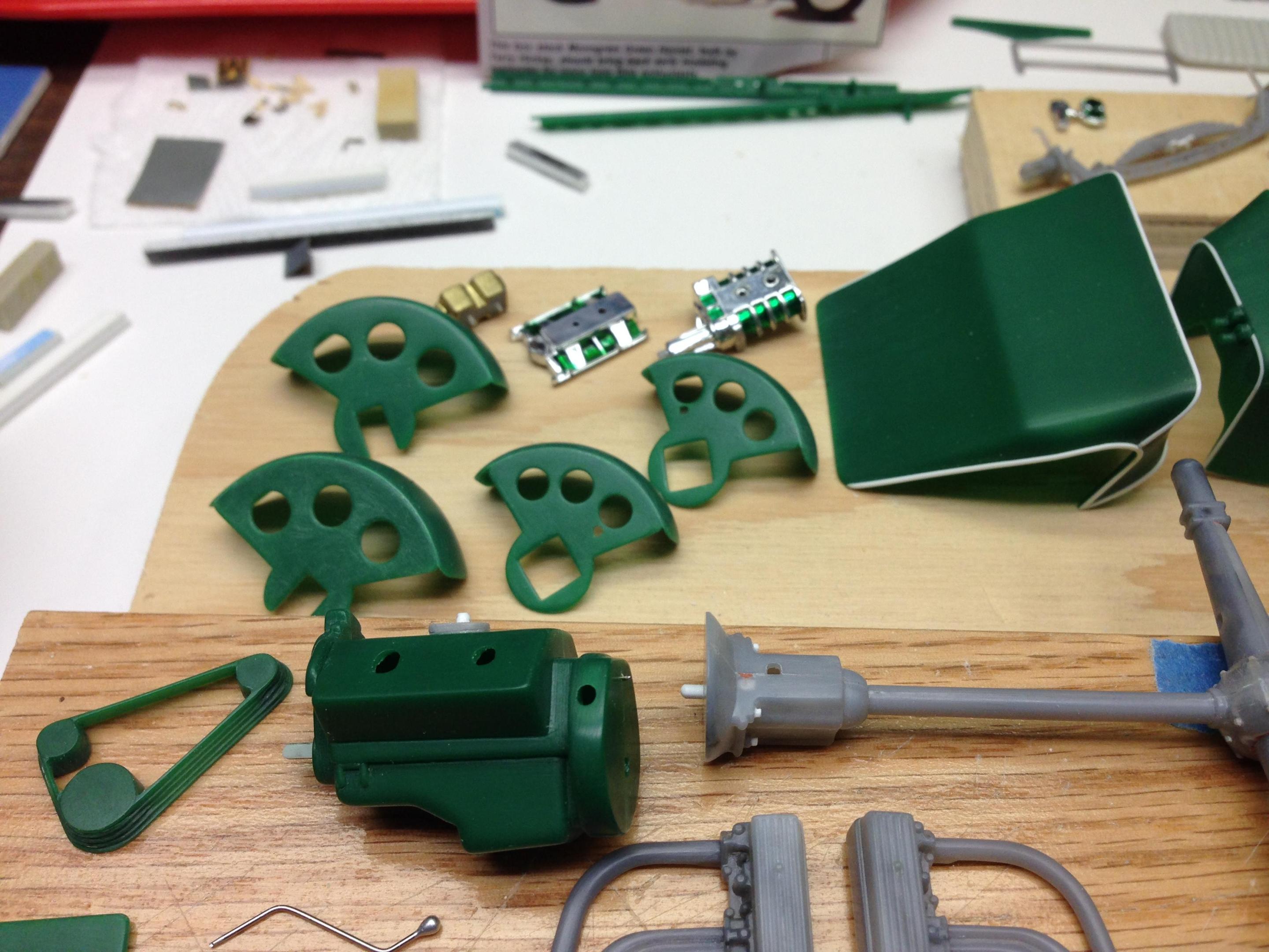

Just having a little fun at the work bench with scraps of hexagon rod and sheet plastic before I go back outside to finish the yard work.
JoeIMG_1466.thumb.JPG.6298a45fd4f1f9446a4968afcf2d7971.JPGIMG_1467.thumb.JPG.66a0de77cec89010f85310b0a72cf132.JPG

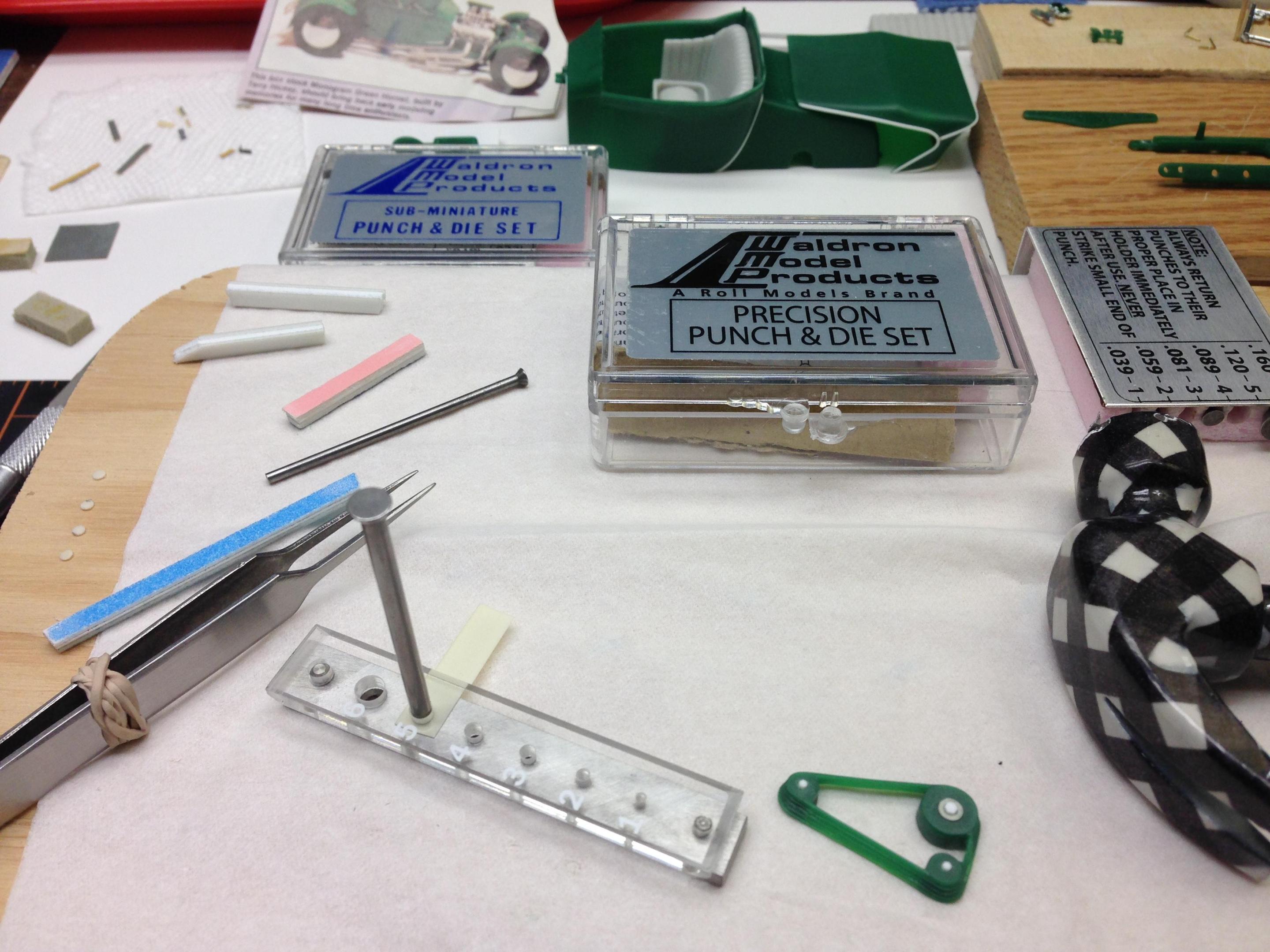

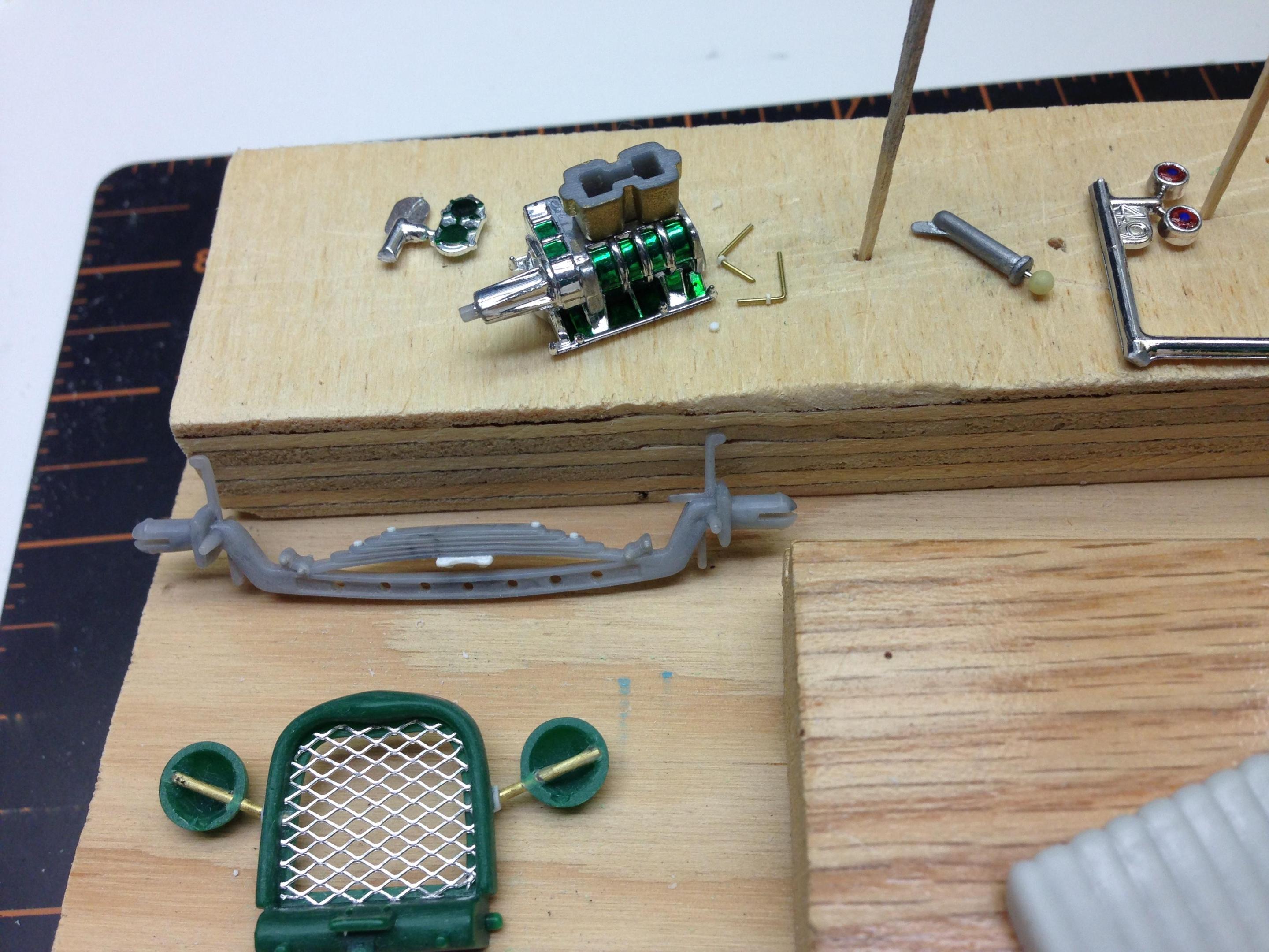

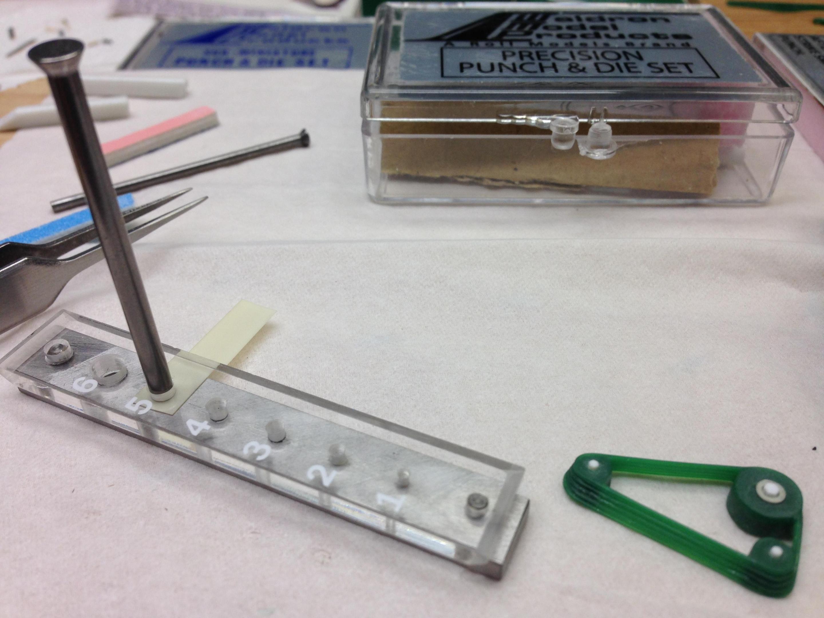

I added a bit of detail to the belt pulleys, and made some pedal covers for the bare kit plastic piece along with some plug wire looms. The pedal cover pieces and wire looms were cut from the plastic that encased Sudafed pills and has an embossed aluminum appearance.
Joe

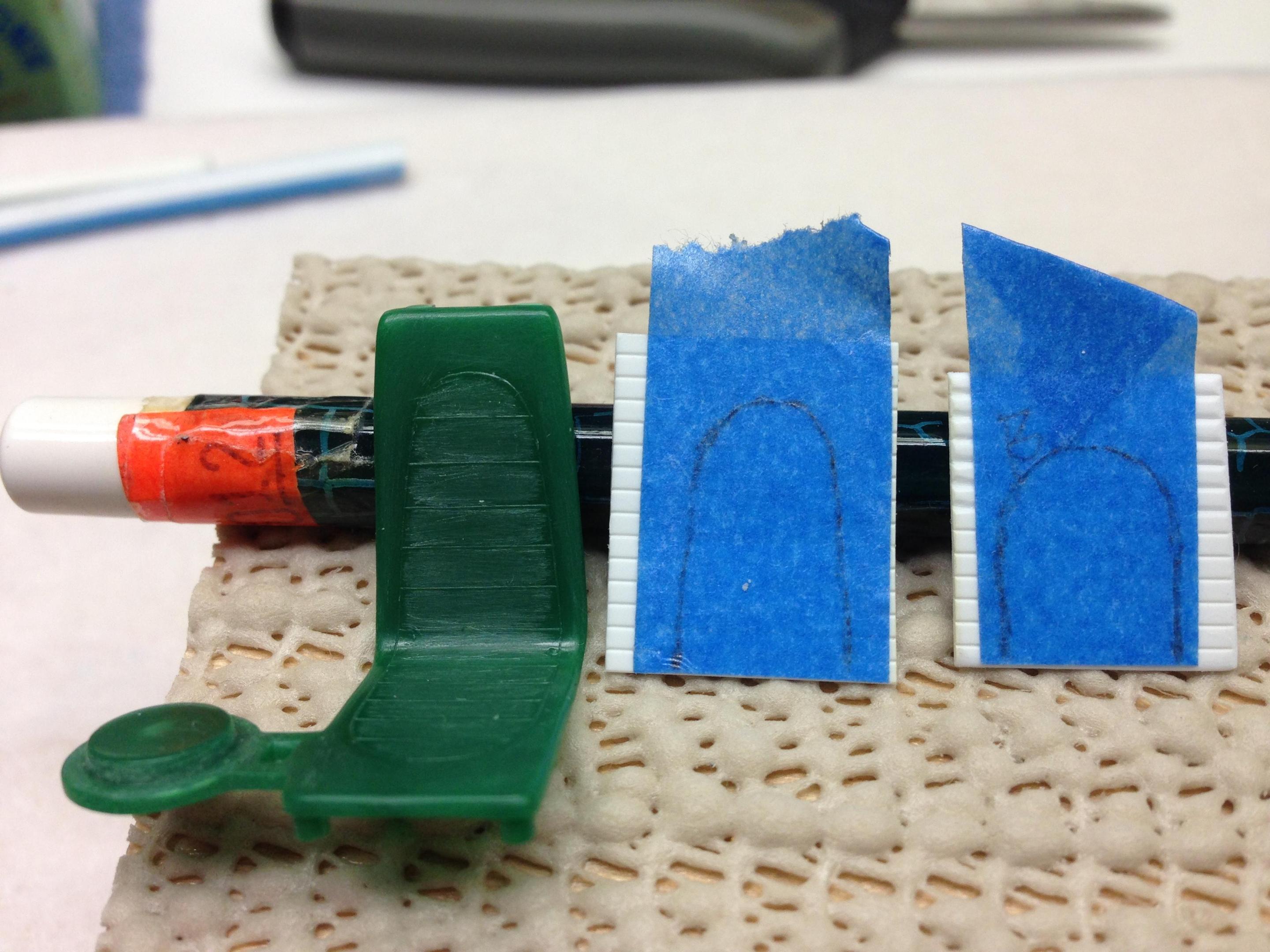

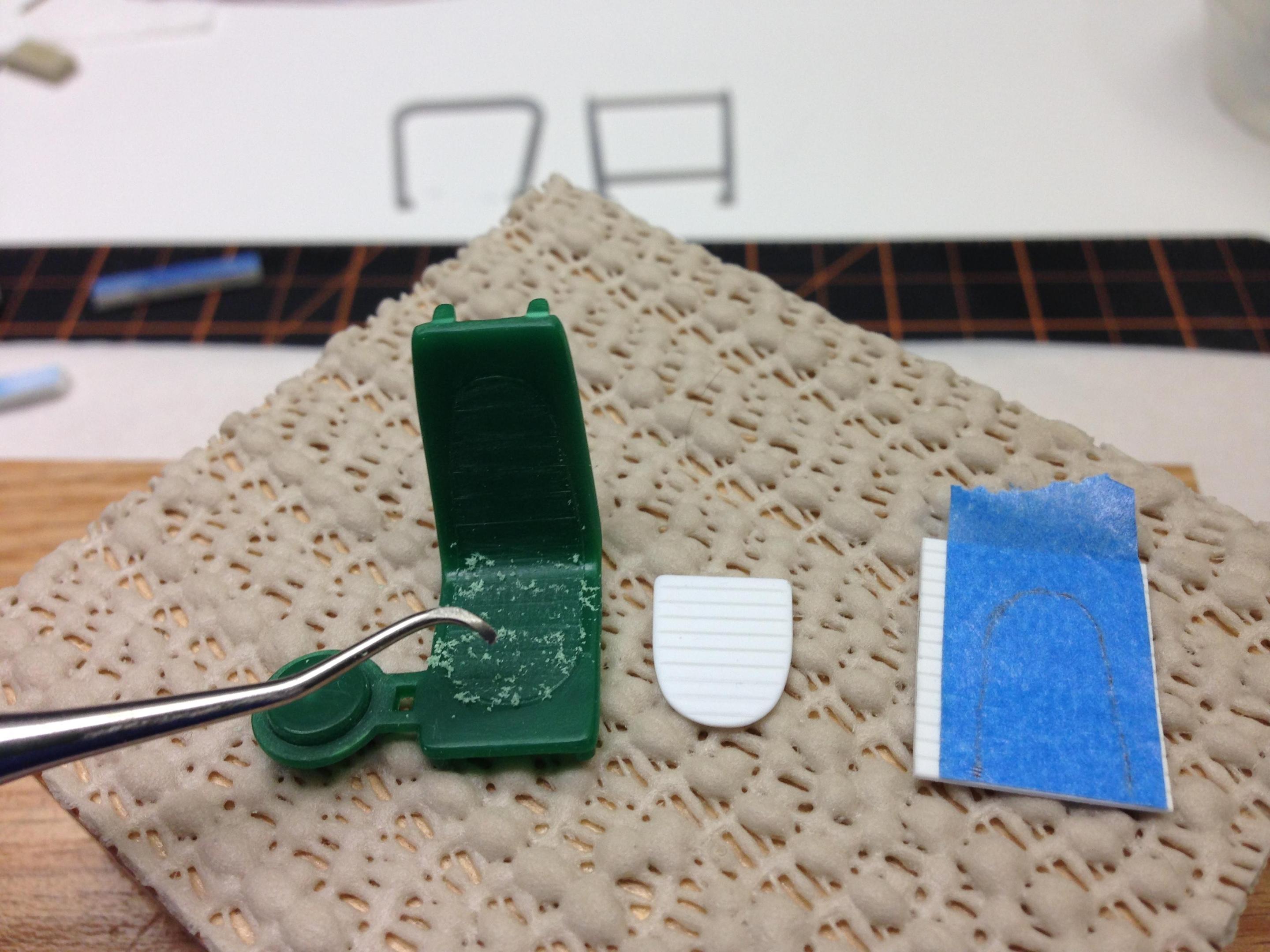

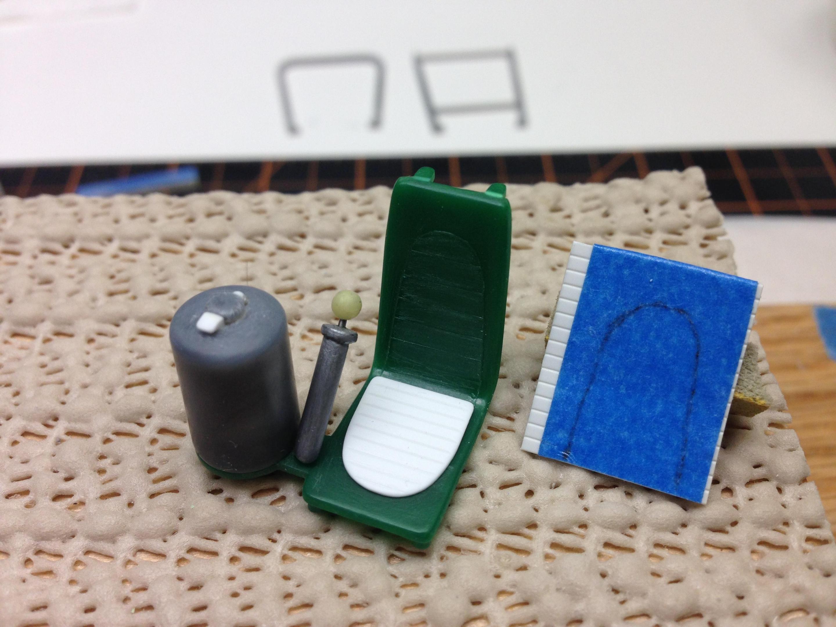

And a couple of photos showing the next little modification of a kit part...I decided to not install the bench seat after all.
Joe

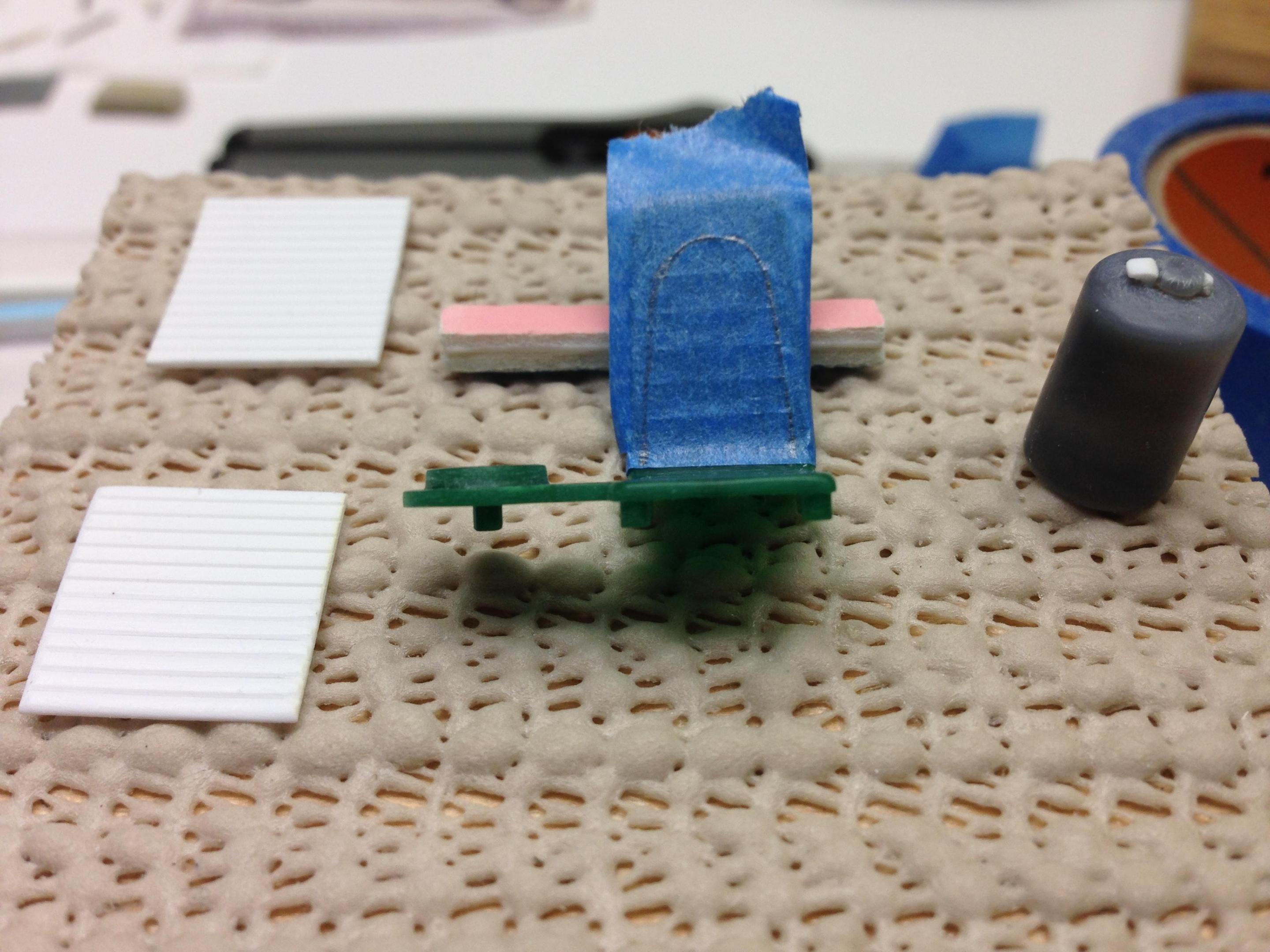

Working on the seat and here's how it's coming along sans paint. I will probably drill small holes around the seat edges, add some small diameter rod around the seat edges and then hang the seat using a heavy thread rather then just gluing the seat to the roll bar and roll bar support. That's the thought for now...
Joe
