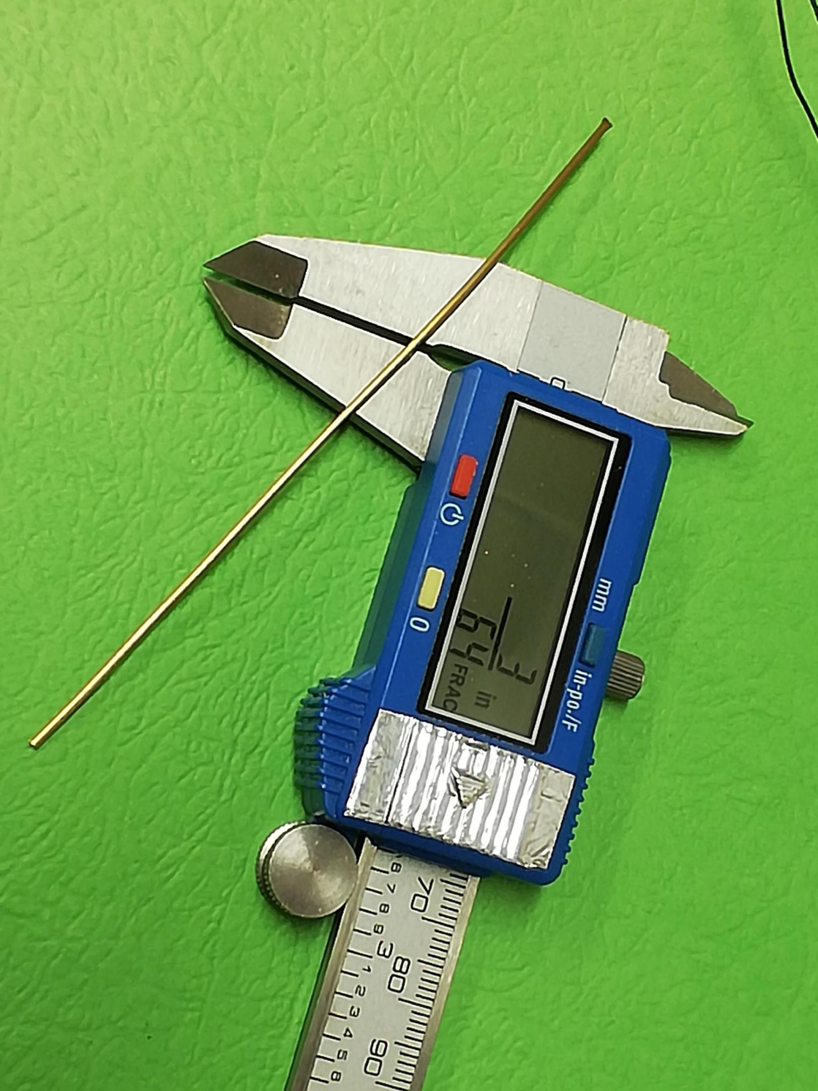

Farmboy Posted April 22, 2023 Author Share Posted April 22, 2023 (edited) I found an excellent on line tutorial making 90 degree plug connectors using solid core plug wire but my plug wire is multi strand. Another approach is needed. Just so happened to have some lengths of close-enough-diameter brass tube. You can see it miked out to 3/64. It has a thin wall that has a nice fit to the wire I'm using. First the opening needs to be round for the wire to be easily installed. I used a sharp pointed tool to first make the inside round and large enough to accept the point of a tapered square file to ream it. Next I eyeballed where to cut a slot half way through the tube. If it's too far from the end a file will dress it to length Then using a corner of the square file I created a notch that went a little deeper to almost the opposite side of the tube When satisfied it was filed enough (be ready to have more than one that doesn't work out). I inserted the pointed tool I used earlier and g e n t l y bent it down 90 degrees. It was then cut to length and the wire test fitted This is the naked result. It has yet to be slightly filed to remove any burrs, primed, and painted (in this case red), but at the end of the day it'll be just what my flathead needs. I may simulate the white insulator before mounting, we'll see. Comments and observations welcome. Edited April 22, 2023 by Farmboy 1 Quote Link to comment Share on other sites More sharing options...

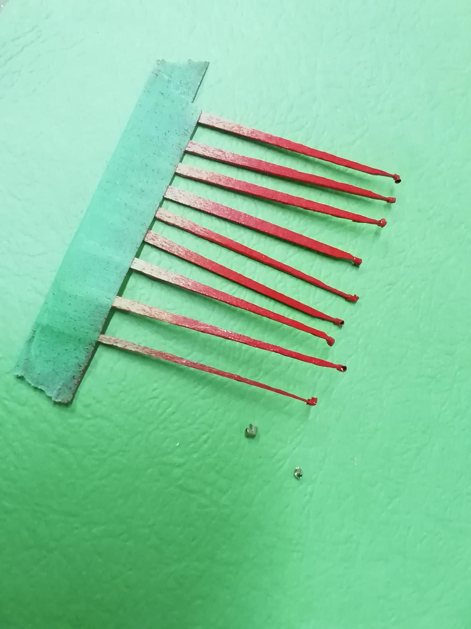

Farmboy Posted June 27, 2023 Author Share Posted June 27, 2023 For fuel works I was planning on a central block with 8 lines total going to the manifold. The plumbing was so small and short I stopped at 4 and did a rethink for fuel delivery. The mockup shot below represents 8 injectors mounted on the manifold. Small styrene rod was sprayed black (hence the licorice alsort appearance). They will be sanded to an even height. Incidentally, the manifold was chrome, I sprayed it with flat clear, I'm ok with the finish. The fuel delivery bars were made from rectangular rod with a piece of half round on one side. These will sit on top of the injectors. I may or may not add simple wiring to simulate injector electrics. The bars will be sprayed chrome. A mockup of how things will sit on the engine, with room to plumb the bars despite the upper rad hose locations. I made those from aluminum tube to keep things a little more compact. To the left are leftover injector cuttings from the couple of dozen I had cut. For size reference Comments and observations welcome. Quote Link to comment Share on other sites More sharing options...
