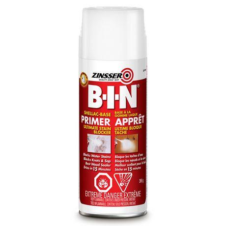

This stuff will definitely create a barrier. It comes in both aerosol and liquid. I have airbrushed the liquid form. Make sure you get the shellac based stuff, as they have other similar products.  It is for sealing knots on wood surfaces. I would put a light coat of Tamiya primer down first then a coat of this.
Edited by NOBLNG
