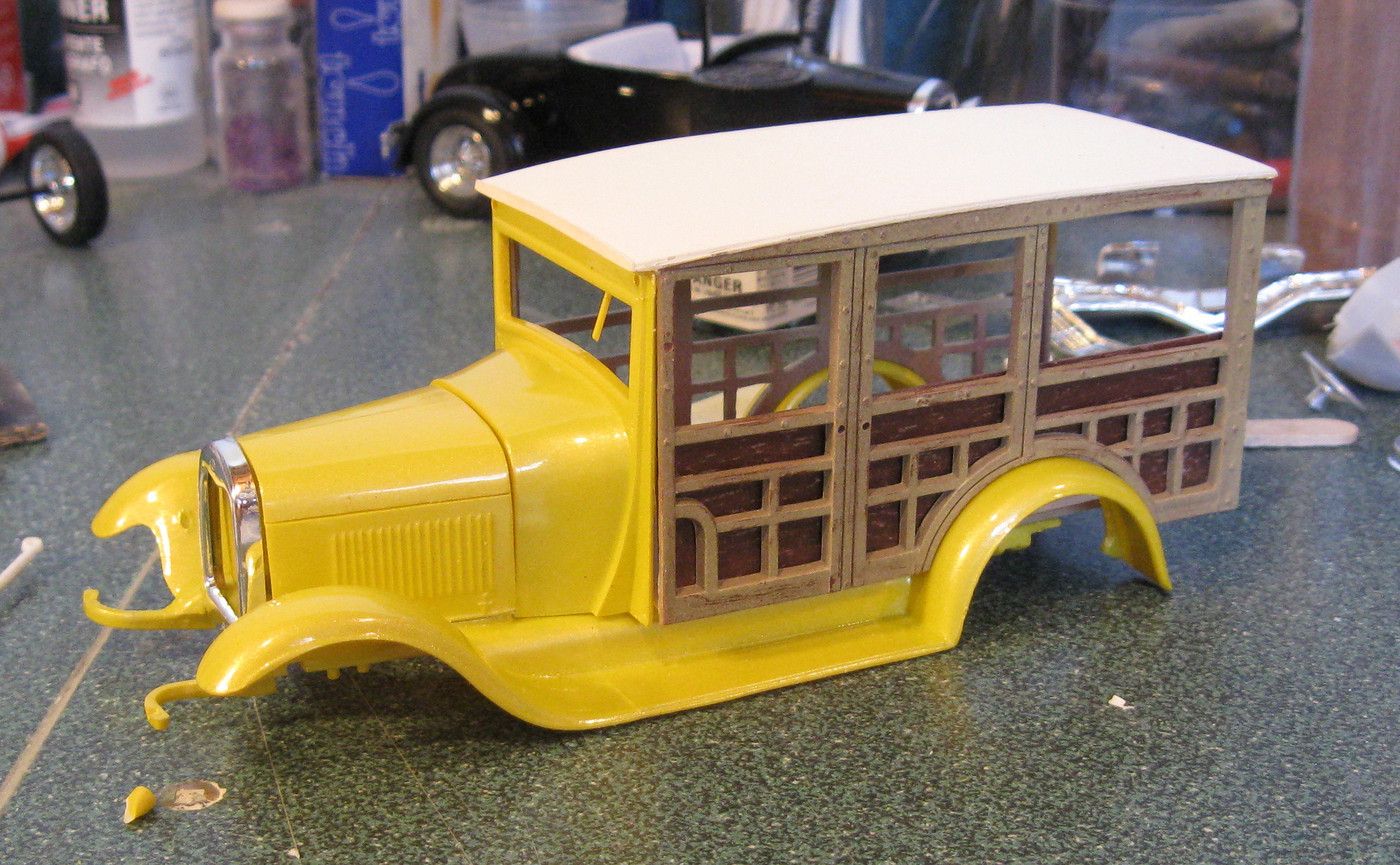

Some pics of the Woodie with the body panels installed.
I sprayed several coats of brown and tan , alternating colors between coats and carefully wet sanded after it was completely dry to reveal the molded in grain detail.
I also assembled the simple flathead engine. It does have a 2-peice distributor but it's not mentioned in the instructions at all. It'll get more detail work and plug wires before installation.

Looking good Steve, that yellow just POPS!
And great idea on severing the cowl from the body. I had that same thought too when I get around to building one of these. Curious what method you used to separate them without losing much material?
  • Like 1
Like the look of the wheels you did. The body color looks as if it may be a Pearl Yellow? The way the "wood" is done on this kit looks like it would be easier to paint and detail.
  • Like 1
Just the good old method of the back of an X-acto blade. Only took a few minutes.
Yup, Tamiya pearl yellow spray decanted and lightened with a little pearl white and some green added for more of a lemon yellow shade then it is in the can.
2 hours ago, Dennis Lacy said:
Looks great in pearl yellow and nice work on the wood grain! The wood is a challenge I’m gonna have to deal with on my own ‘29 Woody.
Thanks Dennis. I can't recommended higher the separation of the cowl from the wood bodywork. Much easier then masking them both off.

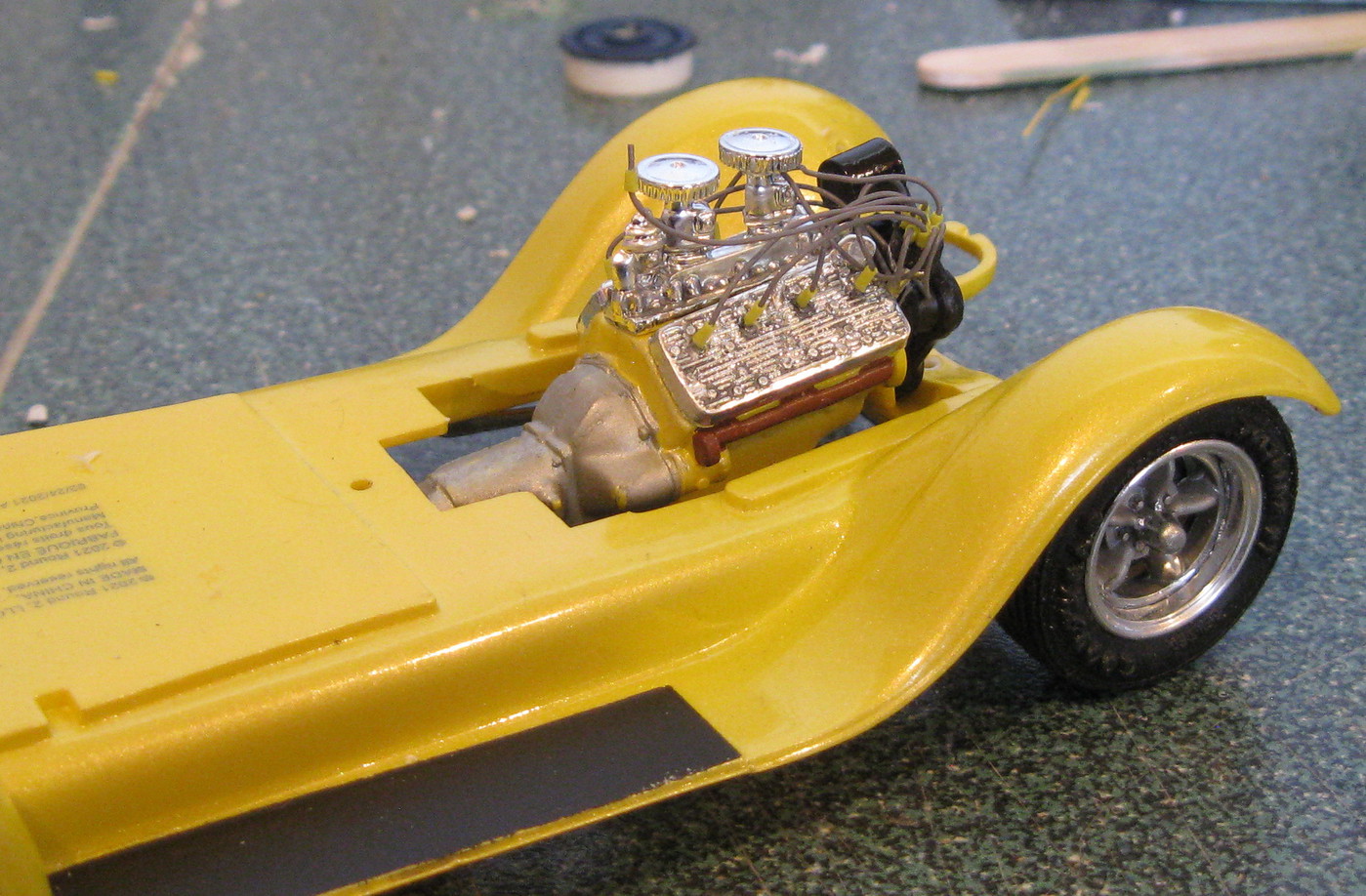

Engine's done and installed. First time I wired a flathead.
In fact, it's almost finished. Just final assembly and some details left to do.
Ait cleaners are from the Revell Motion Performance '67 Camaro and the gauges are from a photoetch set I got years ago.
