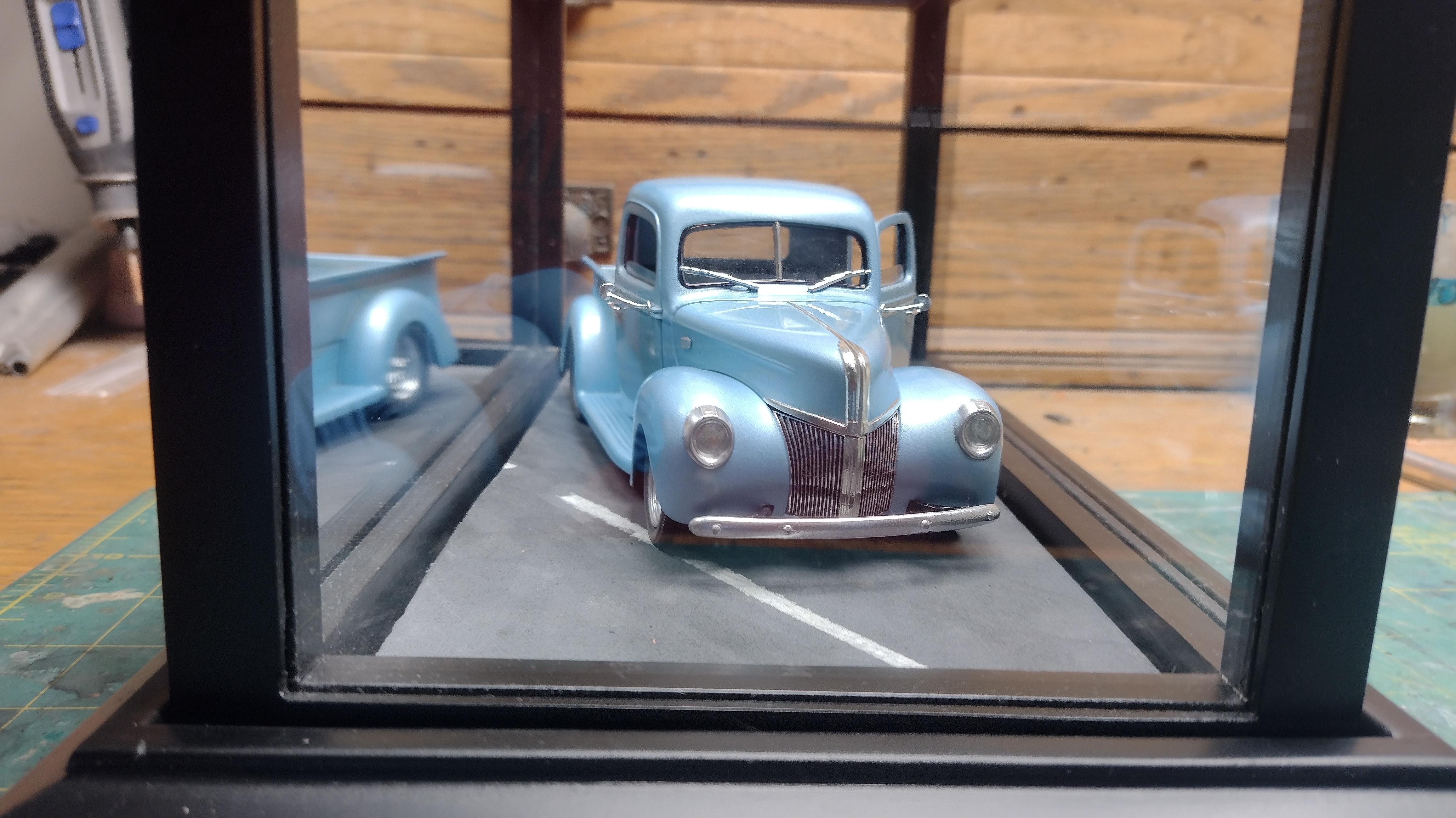

Belugawrx Posted January 11 Author Posted January 11 (edited) On 4/21/2023 at 1:52 PM, espo said: Like the moldings. Thanks 3rd times the charm they say, I tried the JAG paint ...too hot..stripped everything with Dot 3 and started over.. couldn't decide on the proper colour, so ...White Duplicolor primer to start, then after searching Crappy Tire for about 6 Months.. Hyundai frost blue is not available.. I looked in my Craft Smart stash and lo and behold.... Frost blue craftsmart #514144.. Thinned it 1 part paint , 5 parts tap water, 1/8th part Liquitex flow aid and shot it with 18 psi .5 needle ..4 light coats. when it dried it felt like 1000g sandpaper... so I deliberated on Future, or Alclad Aqua gloss clear or just hit it with Duplicolor acrylic enamel or acrylic lacquer.. I think its much closer to Jimmy's truck colour Edited January 11 by Belugawrx 2
Zippi Posted January 11 Posted January 11 Your getting there with this one Bruce. It's looking pretty sharp. 1
Ace-Garageguy Posted January 11 Posted January 11 (edited) Nice work. Love the color, love this kit too. EDIT: And thanks for the paint mix and spraying info too. Details like that are really helpful. Edited January 11 by Ace-Garageguy 1
Belugawrx Posted January 21 Author Posted January 21 After a 2 day thrash at this, I took it out to my bud and he was happy with the colour 👍 More pics and explanation over in Under Glass ...maybe 4
