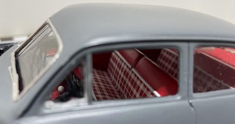

This has been a five or six year, on and off build and even a change in direction. Now this is built to represent a low dollar, home built, semi-custom/hot rod from the early to mid 1950's. The Body: AMT '50 Ford Convertible body with a resin upper body to make a two-door sedan. The body has been channeled slightly over the chassis. The emblems and door handles have been shaved. The headlights have been frenched, and a license plate light and trunk handle created. The rear bumper is made up of parts from the '50 Ford kit and painted using a Gundam Marker for the chrome finish. The front bumper and grill are a plated resin part. The Chassis: Used the frame from the '49 kit with new lower spindles and modified floorboards. The exhaust is a combination of different sized plastic tubing including the glass packs. From the mufflers back I used solder bent to fit and lead to the exhaust out lets in the rear bumper.  Engine: Had two Cadillac engines in the spare parts box and the one with the Hydro trans. wouldn't clear the floor and fire wall so I used the one with a manual trans. and I think it may have come from the '49 kit anyway.  The carbs and air cleaners are from the parts box. Added a prewired distributer and fuel lines as well as radiator hoses.  Paint: Tamiya TS-66 Lin Gray for a primered look with very low gloss.  Interior: Wanted the look of the old "Sears" cheap seat covers. Added fine plastic half rounds to represent the seat and door trim. The seat pattern is scrap book tape cut to fit. Red and White as well as Black Tamiya paint and Red Fuzzy-Fur for the carpet. Scratch built a small shift boot and chrome trim ring for the floor shifter. Wheels & Tires: These are a long-ago swap meet purchase that I knew I would use someday. The Red rims and Wide Whites for the era look. Except for the resin parts everything else was rolling around in the spare parts bin. Fun and challenging at times.

The subtlety of this build is amazing, David.  Not normally a fan of grey paint but it really suits the shoebox. And I love the plaid upholstery!

Alan, I agree about the paint, but I wanted the unfinished premiered look. The upholstery was a first-time experiment based on another builder using the tape. Gave me the look I wanted and better than I could ever do painting alone.

Great build! I'm stealing your awesome scrapbook tape interior trick!
Hi Mark, feel free since I got the idea from another builder here on the Forum.
