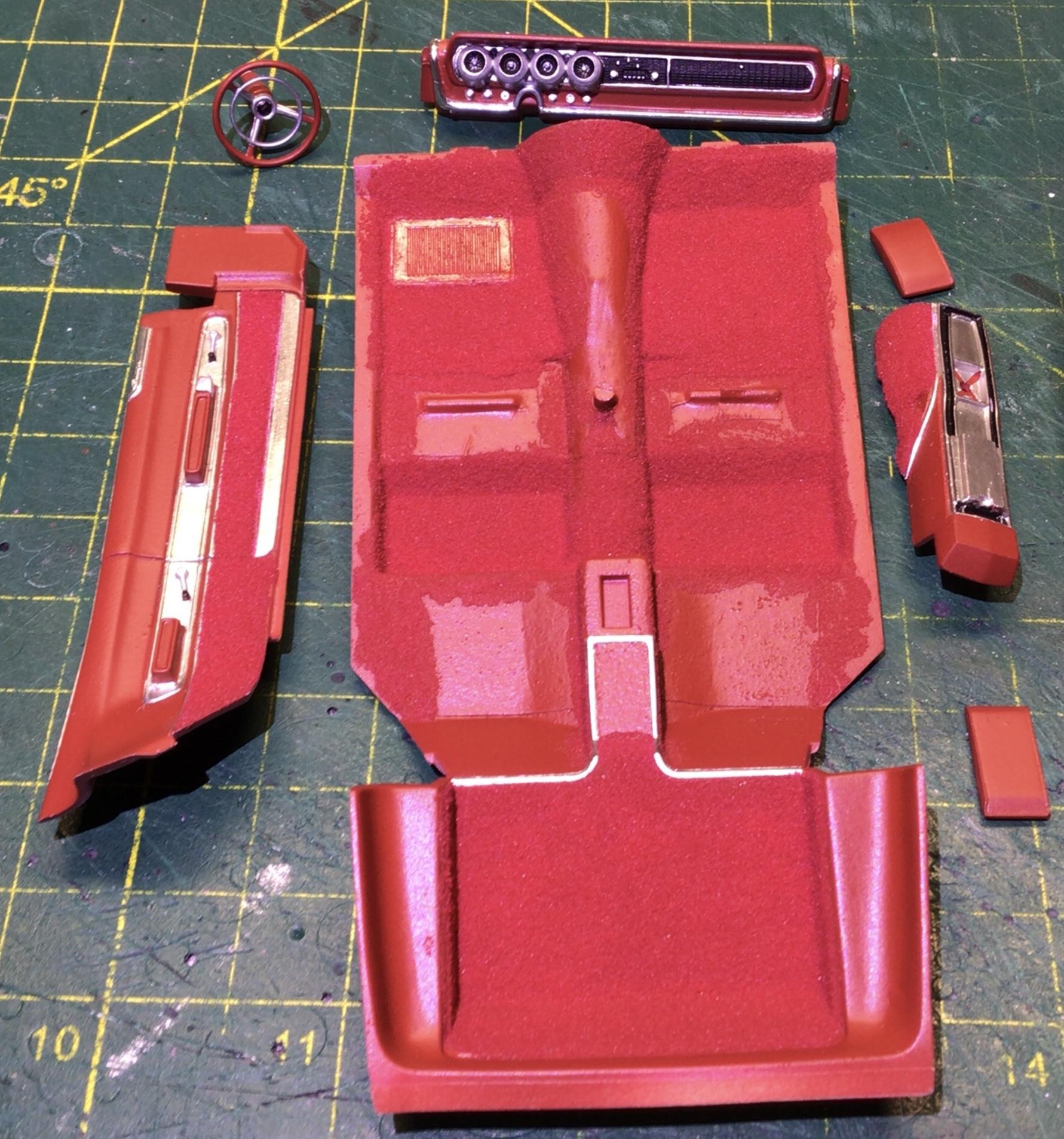

StevenGuthmiller Posted April 6, 2023 Posted April 6, 2023 1 hour ago, Sidney Schwartz said: Good question. What are the differences? Flocking is very fine fibers. I've never had much luck with flocking. It has a tendency to float all over the place, and it's very prone to static electricity, making it want to stick to everything that you don't want it to stick to. It's long fibers make it look more like a shag carpet. Embossing powder is a very fine granular powder. Personally, I find it easier to work with, and it's appearance is more in tune with the cut pile carpet found in most cars. These were done with metallic embossing powder. Steve

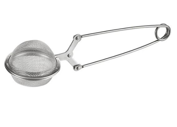

ctruss53 Posted April 6, 2023 Posted April 6, 2023 I buy flocking on Amazon. You can get big bags of it, basically a lifetime supply, for about $15 per color. The flocking available on Amazon is advertised as the stuff used to line drawers on jewelery cabinets. Think, felt lined drawers. Embossing powder looks better. If I had it to do over again I would buy some of that instead. But I got a bunch of flocking powder now. Maybe I'll eventually buy some embossing powder eventually. Something that isn't mentioned in this discussion is application. I use a metal tea strainer. Basically you open the strainer up, dump in some flocking, then let it snap closed. Then when you want to dust your part with the flocking, you shake ot tap on the strainer and the flocking falls out in an even and controlled manner.

NOBLNG Posted April 7, 2023 Posted April 7, 2023 (edited) Yes, it can be painted. I have sprayed it with flat clear also to protect it. Edit: This is actually two coats of embossing powder. The first coat was a bit patchy, so I sprayed it with clear, then more glue and another layer of powder, then more clear. Edited April 7, 2023 by NOBLNG
StevenGuthmiller Posted April 7, 2023 Posted April 7, 2023 2 hours ago, Sidney Schwartz said: Is there a method that will allow me to match the powder color to the interior paint color? Or is it just a matter of being lucky and finding powder and paint that already match? The powders can be mixed fairly convincingly, although don’t expect to mix red and yellow to get orange. It works pretty well to mix similar colors to achieve certain results. In the case of this ‘65 Plymouth, I had no turquoise, so mixing blue and green worked fairly well. Otherwise, the powders come in a wide variety of colors, and if you need a color that you can’t find, the powder is easily painted after application. Steve 1
ctruss53 Posted April 7, 2023 Posted April 7, 2023 3 hours ago, Sidney Schwartz said: Is there a method that will allow me to match the powder color to the interior paint color? Or is it just a matter of being lucky and finding powder and paint that already match? I actually apply paint UNDER the flocking. This way you can slightly change the shade of the flocking without painting it. 1
