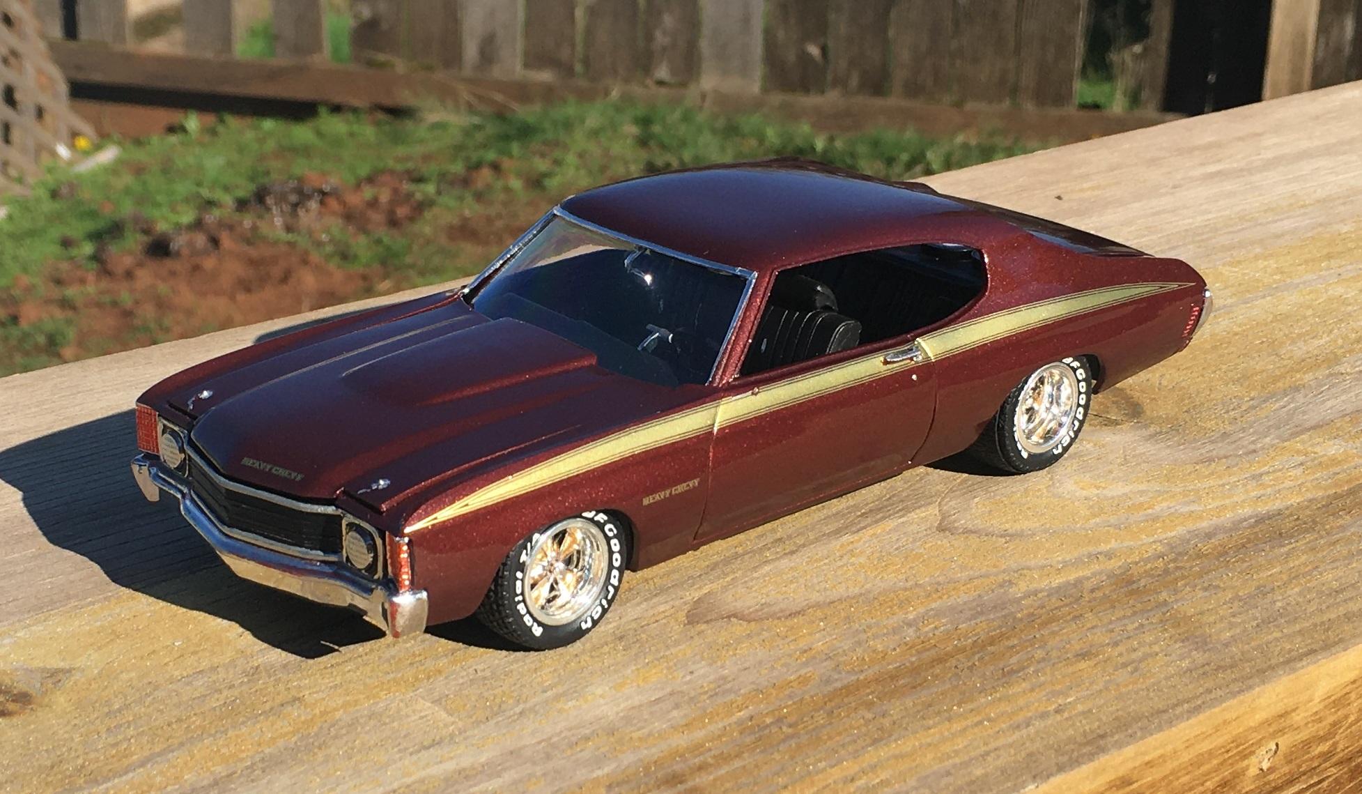

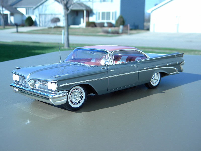

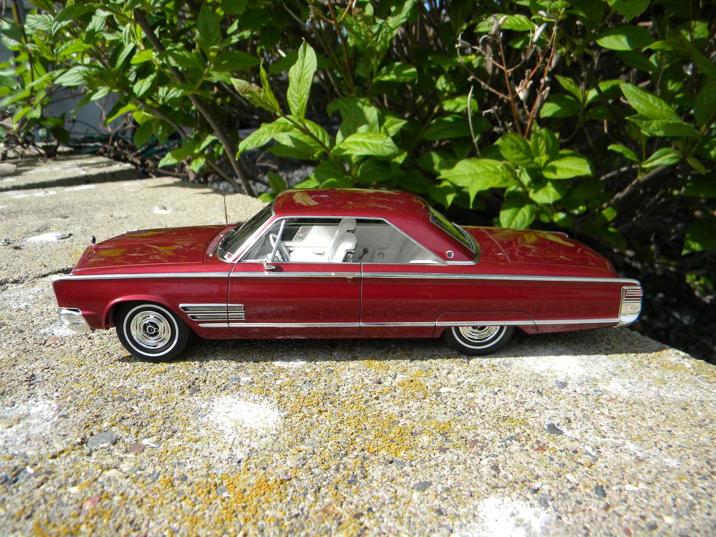

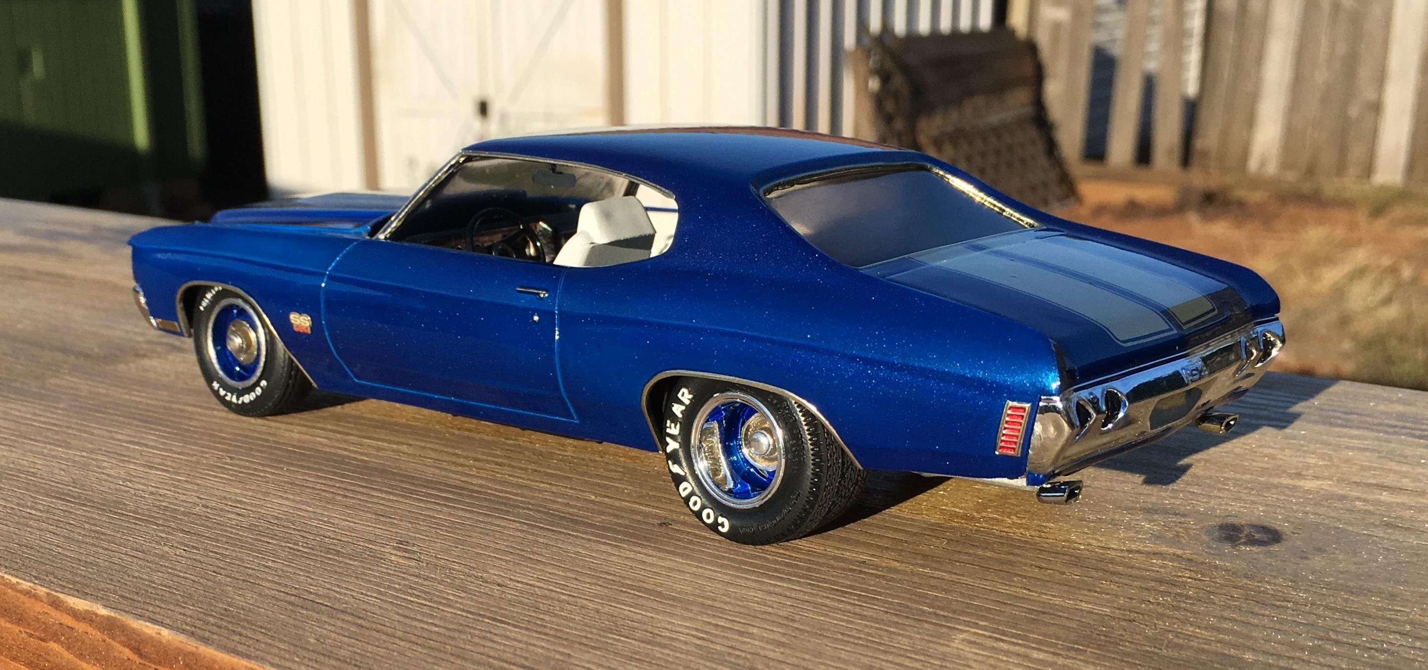

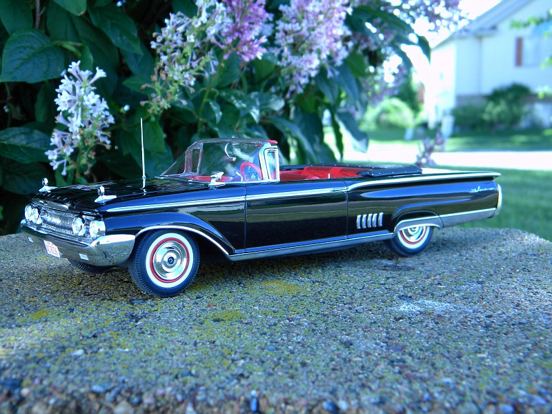

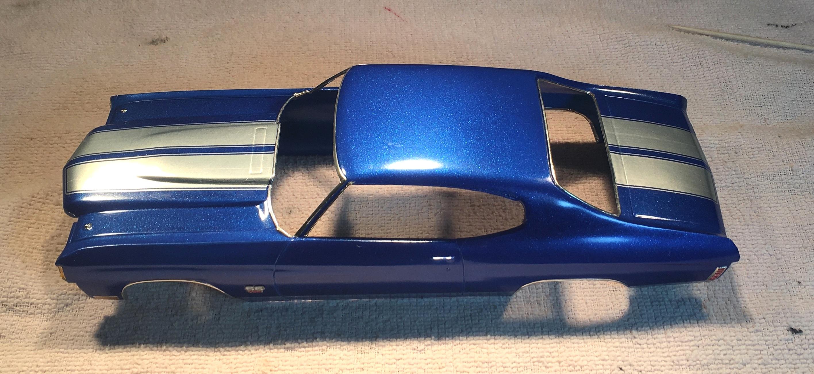

StevenGuthmiller Posted May 31, 2023 Posted May 31, 2023 Maybe at this point some examples of people's work might be helpful to back up their techniques. This is not directed at anyone in particular, but with as much time as I spend on various social media sites, I can attest to how often I see people making statements about how nice their favorite technique works, whether it be paint related, or something else, only to find once photographic proof is provided, that it's not all it's cracked up to be. Very often, we get a lot of lip service on these issues, but not a lot of evidence to back it up. The Molotow chrome issue in particular comes to mind. I can't tell you how often I've heard statements about how Molotow will give you results just as good as foil, but upon inspection you find otherwise the vast majority of the time. I've tried this experiment a few times, and it's usually quite telling. When you ask someone to "show me" how their claimed results are just as good as, or better than another, more often than not, you get nothing but crickets. That's not to say that there are not those out there that can produce an exemplary finished product with whatever their product or technique of choice is, but there are a lot more who's standards are not very high who for some reason or another feel that they should be advising others on their techniques, only to find that it's not always that impressive once you see it. (Mostly I'm thinking of Facebook in this regard) Nobody has everything figured out, (myself included) but I have no compunctions about offering up some evidence to illustrate my successes, (or failures for that matter) That said, I'll throw in a few examples of my work, and they can be taken or left, but they are at least a true picture of what you can expect if you use the techniques and materials that I do. Some of these were painted with and airbrush and aftermarket, hobby related paints, and some with Duplicolor. All polished in the end. Steve 2
atomicholiday Posted May 31, 2023 Author Posted May 31, 2023 Steve, your work never fails to impress. And it's not only your workmanship, but color choices too. Very tasteful.

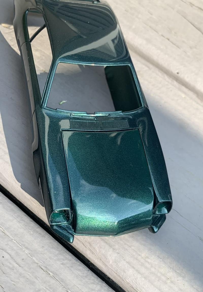

atomicholiday Posted June 8, 2023 Author Posted June 8, 2023 So any who’s been following my plight for the past few months knows I’ve been having a heck of a time getting a decent finish, and when I do, I screw up wet sanding. (See my thread on touching up burn through) At one point I told my wife I was going to burn all my kits and tools. I needed a win. I think I can say I got it finally. Just finished rubbing this one out. It ain’t perfect, but it’s a far cry better than I’ve been putting out lately. The kits are safe for now. Just don’t let me play with matches for a while. Thanks to all for your advice. 2
bobthehobbyguy Posted June 9, 2023 Posted June 9, 2023 One thing that might help would be to put more clear on before you polish .
StevenGuthmiller Posted June 9, 2023 Posted June 9, 2023 On 6/8/2023 at 10:56 PM, atomicholiday said: So any who’s been following my plight for the past few months knows I’ve been having a heck of a time getting a decent finish, and when I do, I screw up wet sanding. (See my thread on touching up burn through) At one point I told my wife I was going to burn all my kits and tools. I needed a win. I think I can say I got it finally. Just finished rubbing this one out. It ain’t perfect, but it’s a far cry better than I’ve been putting out lately. The kits are safe for now. Just don’t let me play with matches for a while. Thanks to all for your advice. Expand Looks fabulous! I think you’re on the right track. You’ll eventually get it down to a science! ? Steve 1
StevenGuthmiller Posted June 9, 2023 Posted June 9, 2023 On 6/9/2023 at 1:00 AM, bobthehobbyguy said: One thing that might help would be to put more clear on before you polish . Expand Agreed. Steve
peteski Posted June 9, 2023 Posted June 9, 2023 On 6/9/2023 at 1:00 AM, bobthehobbyguy said: One thing that might help would be to put more clear on before you polish . Expand But not so many that the model looks like it is dipped in honey. That ruins the realism.
bobthehobbyguy Posted June 9, 2023 Posted June 9, 2023 (edited) True but duplicolor Lacquer coats are thin and if you consistently are burning through to color then one needs a couple more coats. That way if you start seeing color then you know you are through that clear. Edited June 9, 2023 by bobthehobbyguy
