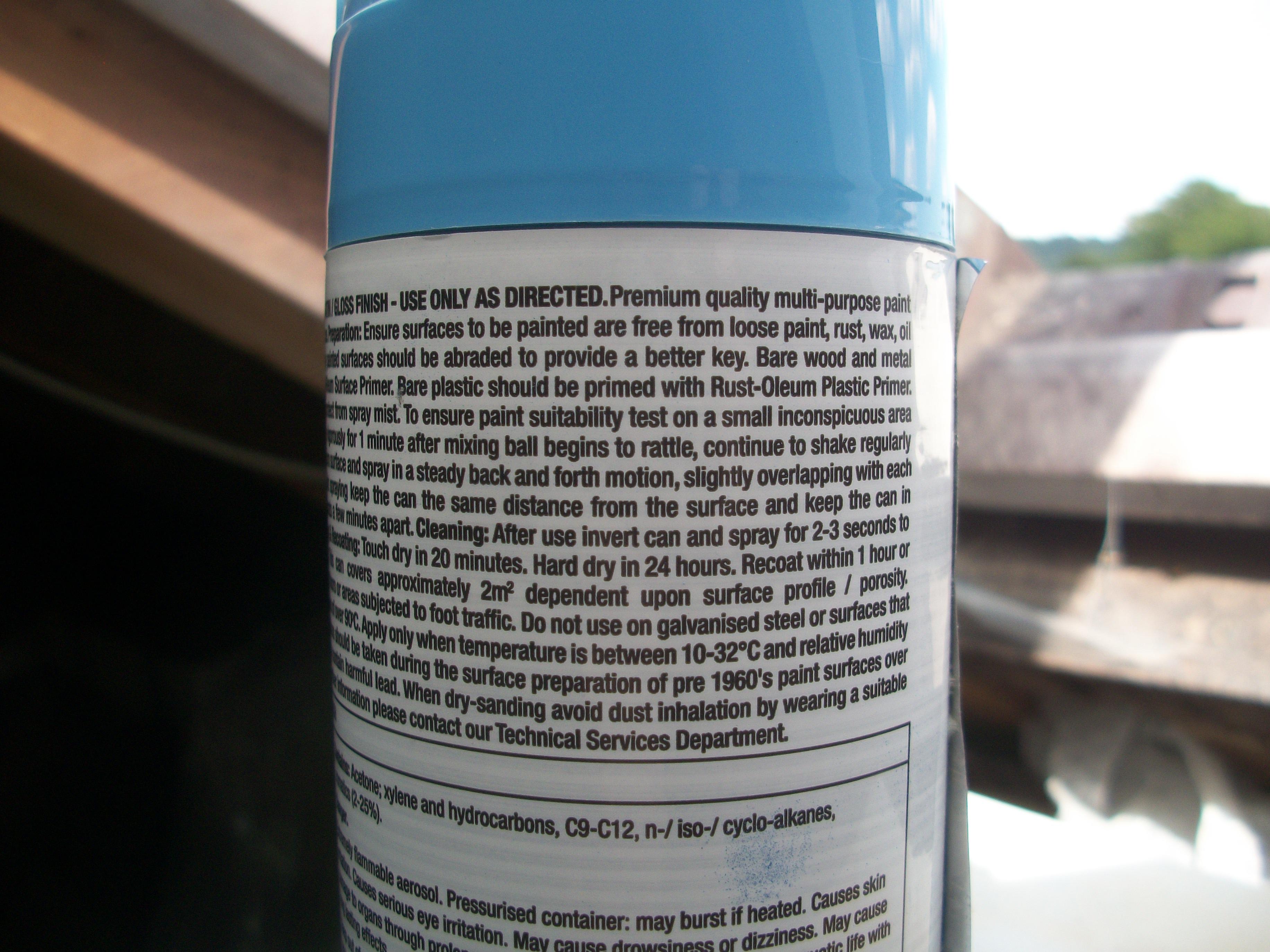

Anglia105E Posted June 16, 2023 Author Posted June 16, 2023 10 hours ago, bobthehobbyguy said: I would hazard a guess that the top paint was drying faster than the primer coat. Another reason not to mix manufactuers I totally agree Bob . . . This is why, despite reading about some disturbing Rust-oleum issues, I have decided to proceed with testing of the Plastic Primer White and the Spa Blue Gloss products, both of which are Rust-oleum branded. David
bobthehobbyguy Posted June 16, 2023 Posted June 16, 2023 True both are Rustleum however you are using two lines of Rustleum paint. The color coat is painters touch but the primer is not. Even though you are testing the still could have issues because these products may never have been designed to work together for all conditions. So slightly different conditions when spraying could cause an immediate paint reaction or one down the road such as the cracking above. Just something to consider.

Anglia105E Posted June 16, 2023 Author Posted June 16, 2023 2 hours ago, bobthehobbyguy said: True both are Rustleum however you are using two lines of Rustleum paint. The color coat is painters touch but the primer is not. Even though you are testing the still could have issues because these products may never have been designed to work together for all conditions. So slightly different conditions when spraying could cause an immediate paint reaction or one down the road such as the cracking above. Just something to consider. I take your point Bob, but can I draw your attention to the wording on the back of the can for the Rust-oleum Spa Blue Gloss . . . See photo. This clearly states ' Bare plastic should be primed with Rust-oleum Plastic Primer ' - ( fourth line down, from the centre to the end of that line '. I am applying these two products to bare plastic (okay this is 60 year old plastic) and my local store 'Boyes' are authorised distributors for Rust-oleum paint products. This means that I am following the manufacturer's instructions to the letter, which clearly states that I must use the Plastic Primer product on the surface of the plastic, before applying the second product which is the gloss enamel. I quite understand that you guys probably have considerably greater knowledge of the Rust-oleum products than I do, because as I said previously, I believe these paint products are more widely used and available in the US than here in UK. . . . Also, I might not be as experienced a scale model painter as you guys, but in this case I am taking extra care to get this right, hence the extensive pre-testing. The Frog Ford Consul Cortina kit is extremely rare, and I have paid a considerable amount of money to get hold of the kit. So far (fingers crossed) there have been no unusual effects appearing on the surface of the plastic, but that does not mean that further down the line there may be something nasty that happens after one week, one month or even one year ! David
Anglia105E Posted June 16, 2023 Author Posted June 16, 2023 2 hours ago, ctruss53 said: I really wish people would stop using Rustoleum priimers and paints on their scale models. Every day I come into this forum and see people having problems with those products on their models. Because they are not designed for scale models. Have any of you noticed how rare it is to see threads about problems with paints designed for scale model use, like Tamiya TS spray paints, Tamiya Primer, and Mr Hobby products. And when you do see threads where people have problems with these products, it is nearly always user error? I just wanted to poiint that out. Thanks Chad, and I take your point . . . Keep in mind please, that where I live in Derbyshire rural UK, we do not have any stores that sell Tamiya aerosol cans, and Mr Hobby products are not available in UK . . . This restricts my scale model building to using paints from the Halfords chain of stores, which sells paint products specifically intended for automotive application ( so not plastic ), then the specialist automotive paint suppliers (also not for plastic models), and finally the Rust-oleum products, which according to US model builders are intended for garden furniture (PVC) and cheap surfaces around the home. Unless I can find a paint product that does not damage my prized Cortina model car, I shall not risk applying any of the above products. At this moment, I have only applied the two Rust-oleum products to parts of the kit that will not be visible when it is completed. David
