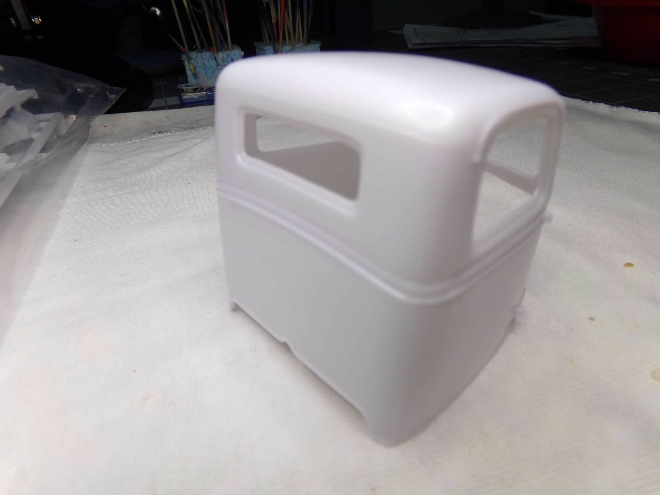

I'm gonna try this Revell kit next.  My Grandsons bought this for me for Father's Day. The first thing I have to do is eliminate the mold lines on the cab. I realize that many of the old cars and trucks had separate body panels that were sealed with lead but after looking at a few photos, I didn't see anything that had lines this prominent. I also found a style that I like and hopefully the photo will copy here. So I'm going to get started! Thanks for looking!

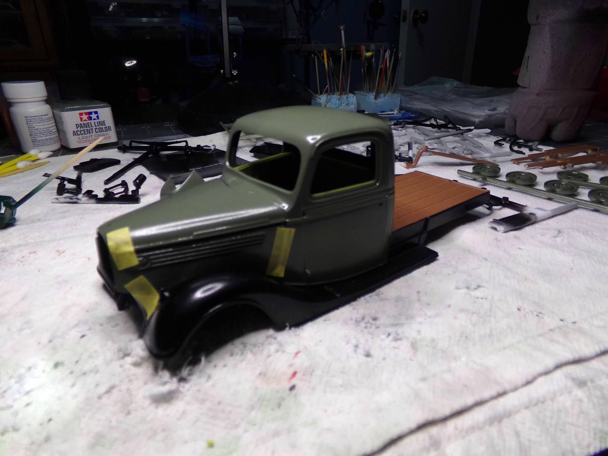

I don't often do this but I wanted to paint this about the colors in the photo above, so I used a can of Krylon Satin Italian Olive that I had on  the shelf for these body parts. The interior doors panels and seat will be Krylon Satin Avocado  that I also had on the shelf (don't ask me why). The brown wood color is Krylon Satin Brown Boots. The fenders will be Dupli-Color Gloss Black. Two coats of paint on each part and two coats of clear. It should polish up fine. Here's a partial mock-up. Thanks for looking! ?

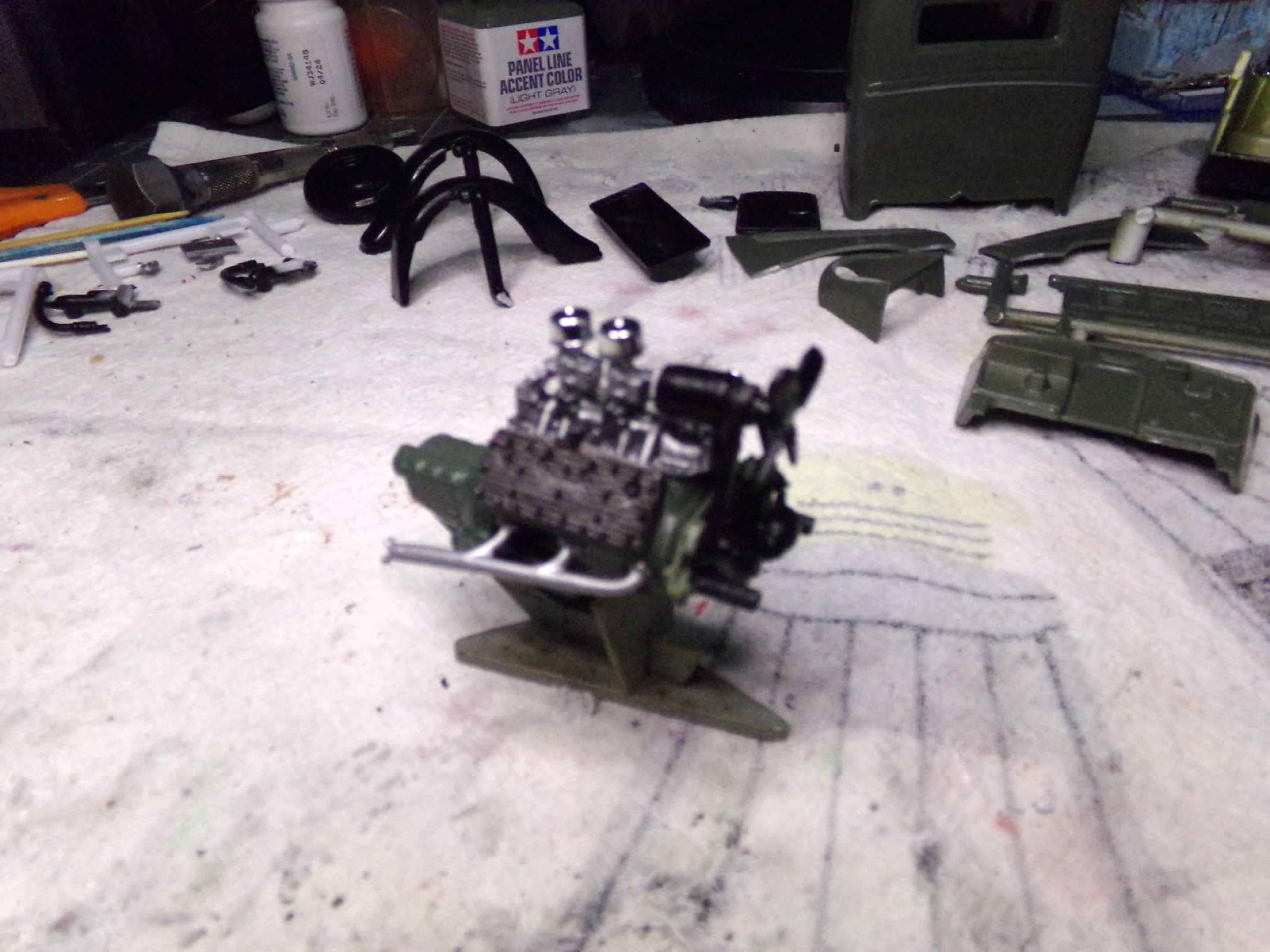

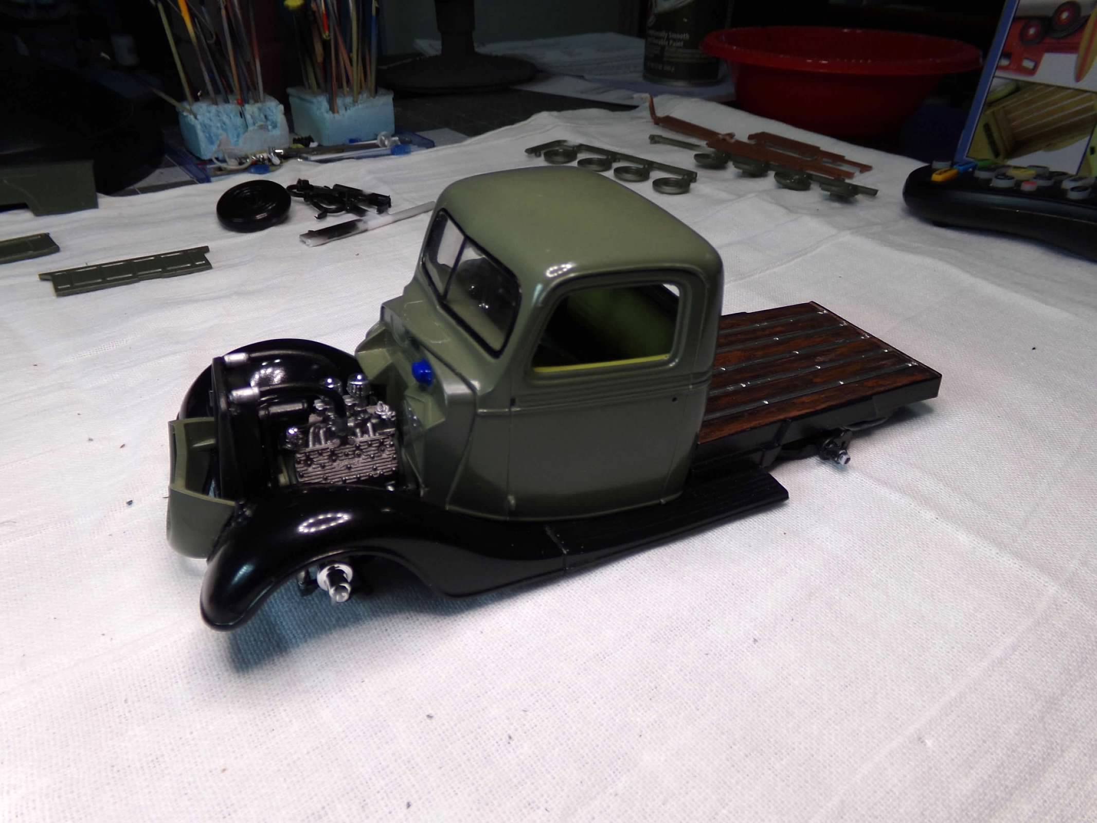

Finished the engine without plug wires because I didn't want to drill out the distributor and thread the wires through the fan and onto the heads. Too fiddly. I removed the chrome plating from the heads, intake manifold, and carbs. I painted them various shades of steel, aluminum and iron. The block is painted the same color as the body, Italian Olive. Building the chassis next.

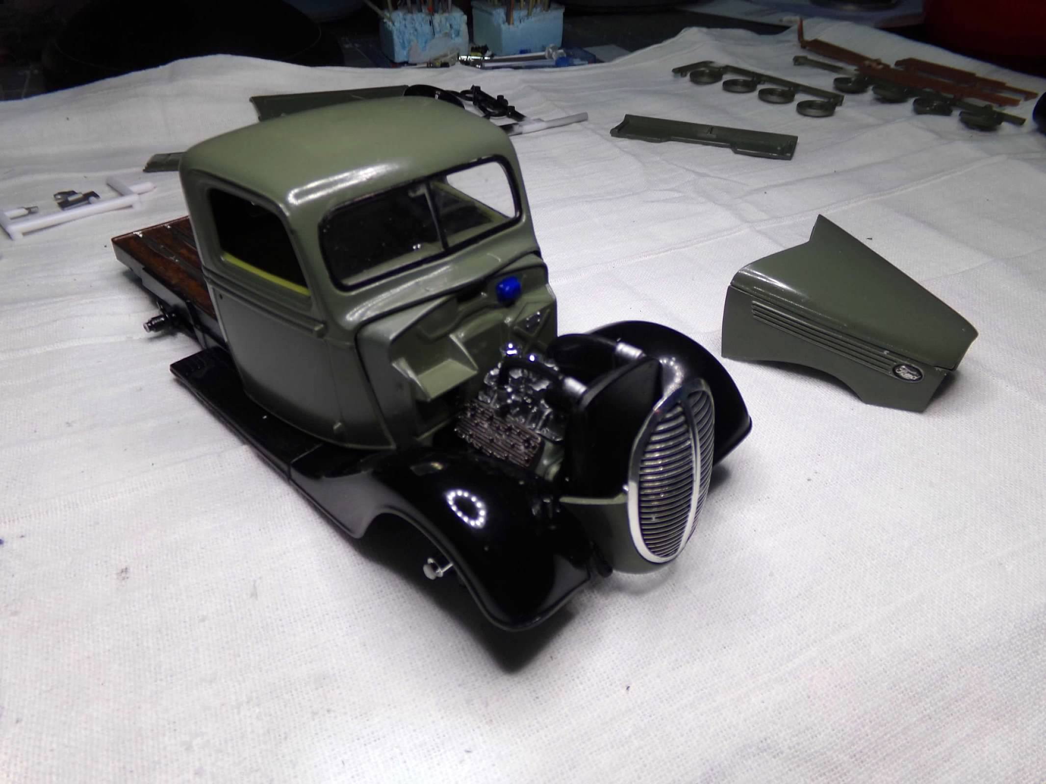

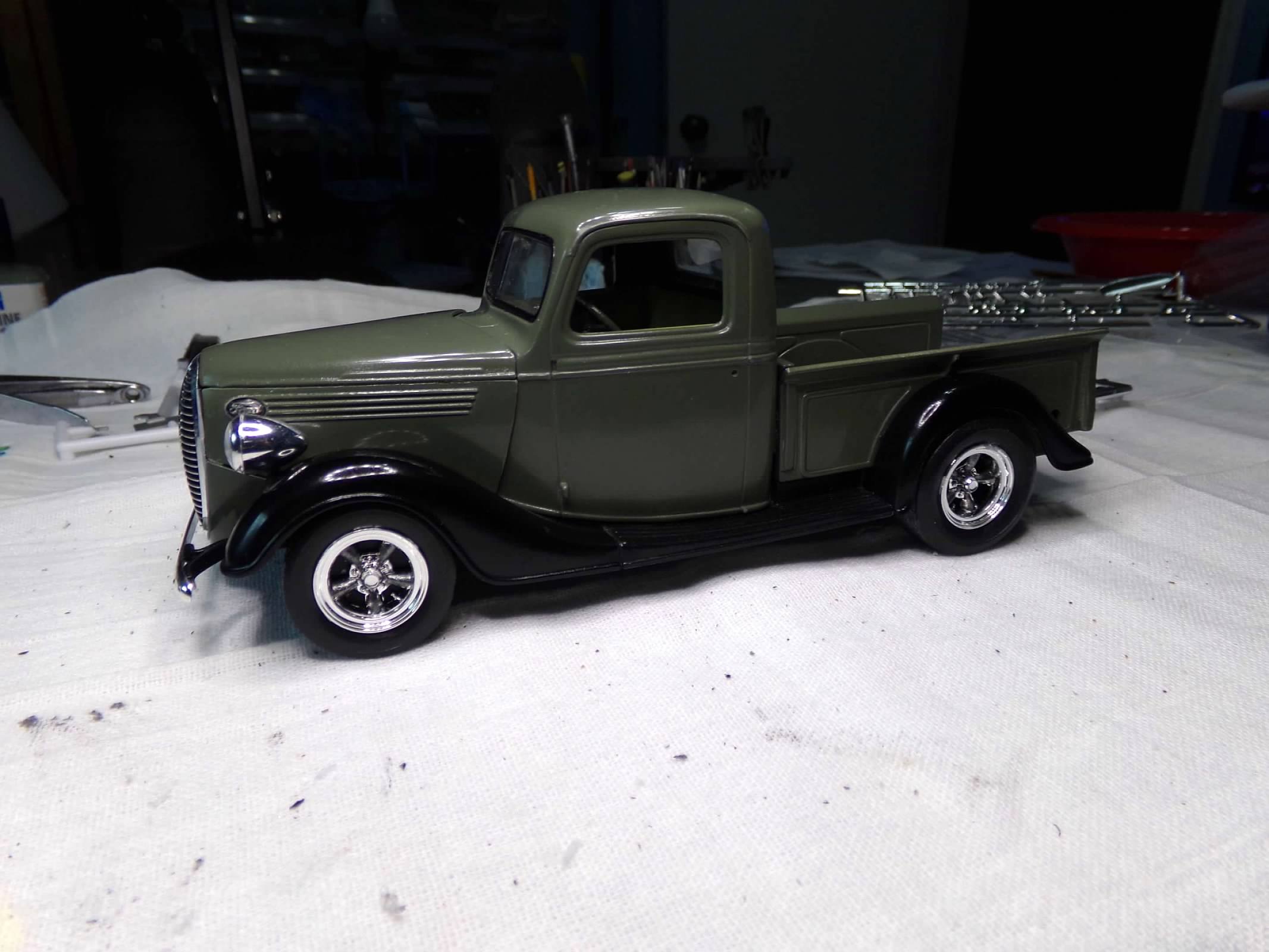

This kit goes together pretty well, so I have been making good progress this afternoon.  The instructions suggest that the side of the hood should be glued on and then the top just sits on top of the sides and is removeable. But I wanted to glue the side to the top of the hood so I mocked it up and glued each side on one at a time. The hood fits better than most one-piece hoods and now the entire hood including the sides can be removed! I also put the bed sides on and now all I have to do is add the rear fenders, glue the cab in place and find some wheels and tires for it if I decide to do something other than box stock. I'll leave that to tomorrow. Thanks for looking! ?

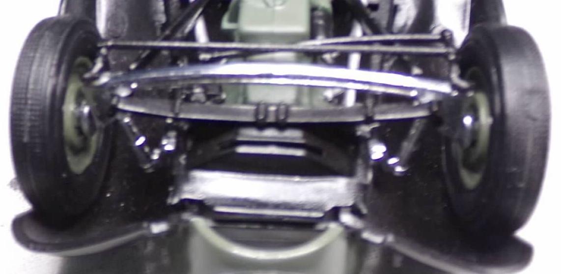

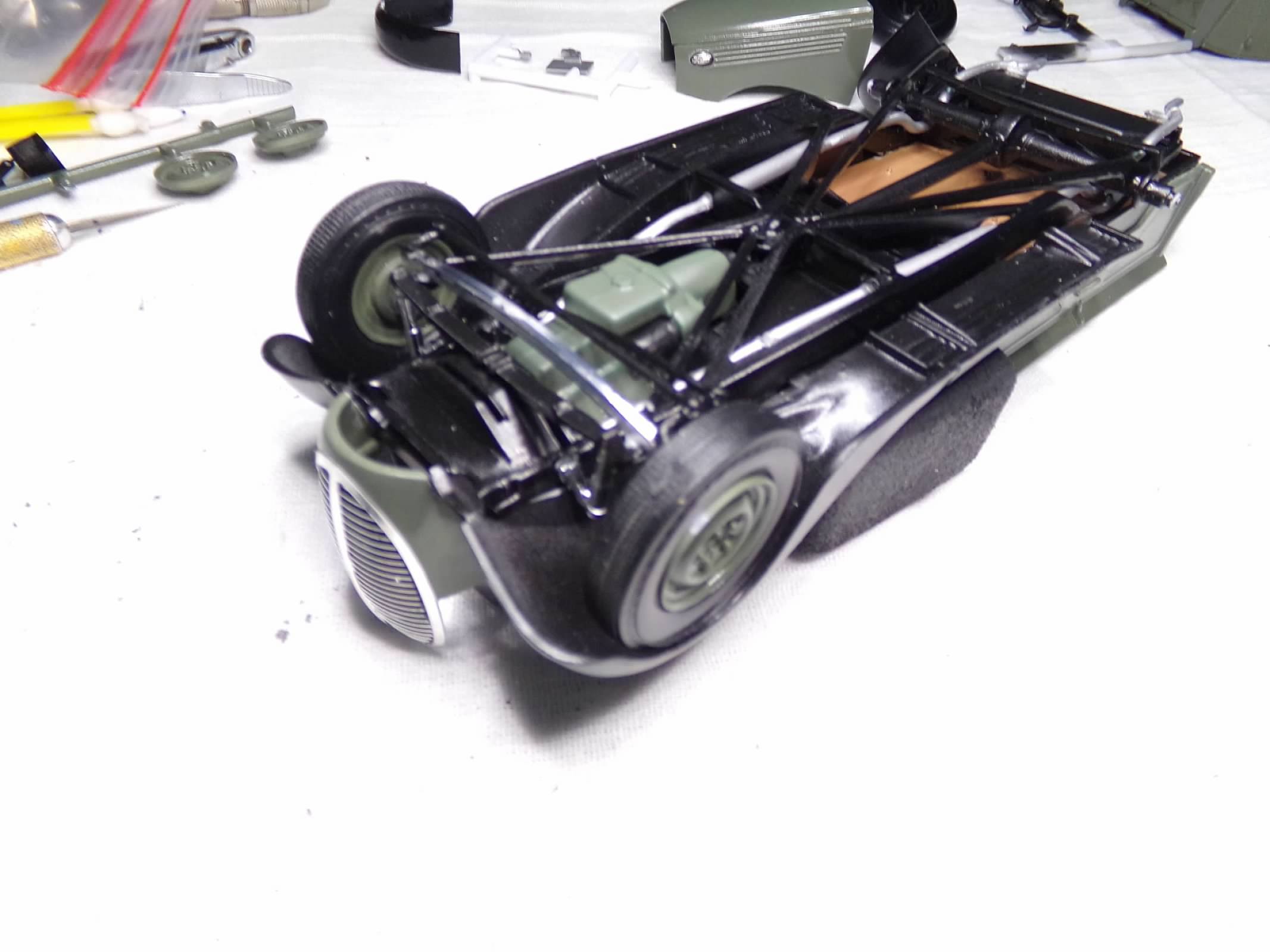

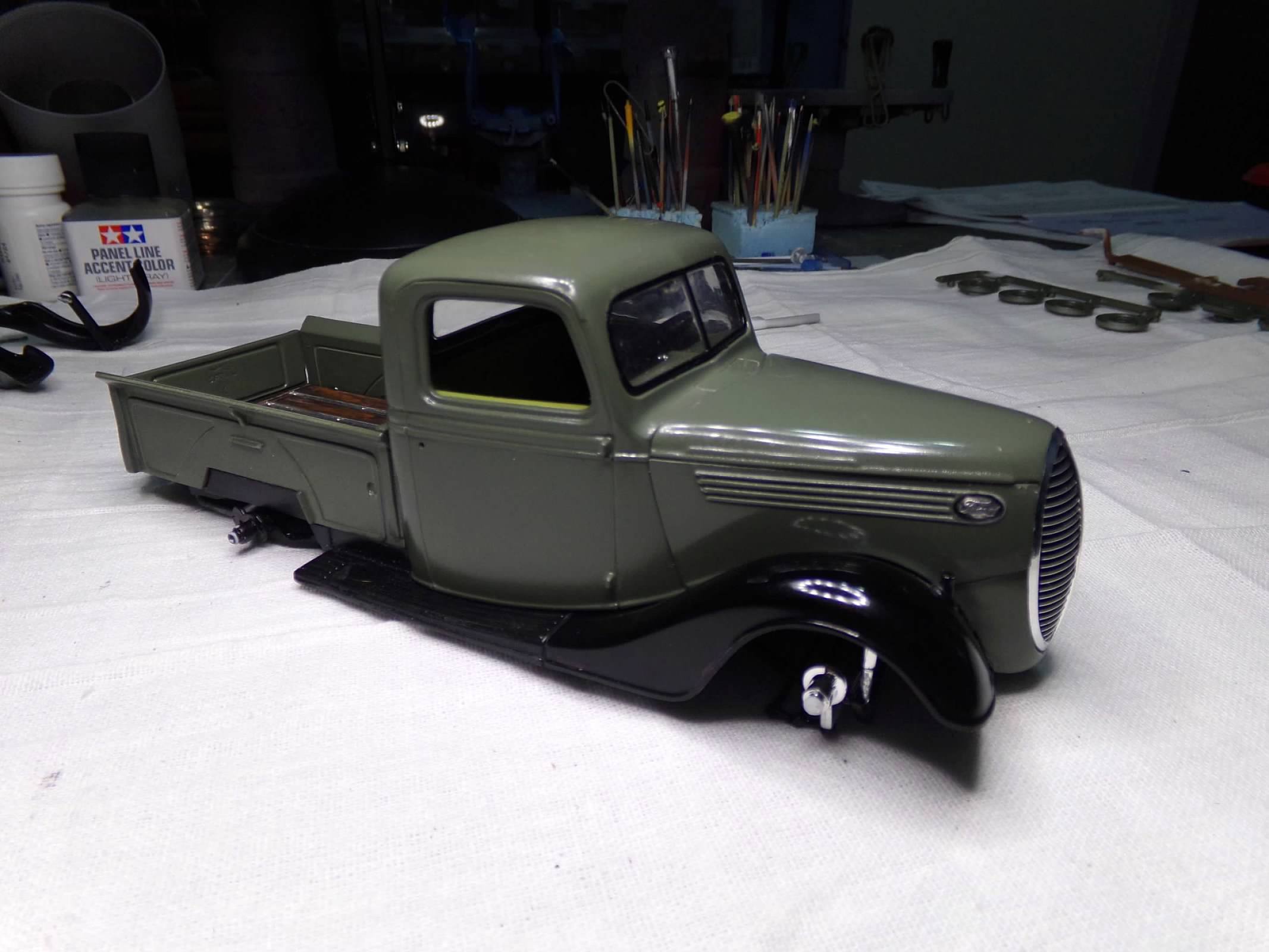

I have a  complication with this build and I need some advice. The front wheels, even with the skinny wheels and tires provided in the kit rub the front fender openings (See photos below). Here are my options in my opinion. Let me know if you have other ideas.
  1. Finish as is and don't worry about the rub or turning radius.
  2. Take out the dropped axle and use the stock axle which should provide more height and space between the wheel and the fender.
  3. Use some square tube to raise the fender unit off the frame and provide more space under the fender unit (front and back). Kind of a gasser look.
  4. Find another fender unit, like from a 32 Ford and do some major surgery.
  5. Use some dragster front wheels and fat tires in the back and use square tube to raise the back (big rake).
Any other ideas?

Looking good John!? My kit only came with the stock axle so no issues. It looks like the inner rim on yours is not quite up against the “backing plate” so it may be possible to trim the mounting pin off a bit to get the wheels to sit further in? You would likely have to glue the wheels on solid, which I always do anyways. I went with green/black also:
http://www.modelcarsmag.com/forums/topic/166562-1937-ford-pickup/
Edited by NOBLNG
  • Like 1
Maybe a smaller diameter tire if you have one that matches the sidewall and tread design.
Greg idea sounds pretty good...
I had a truck that I had dropped a little bit and had the same issue. I took a new sharp blade and ever so slightly trimmed the inner fender til it sit straight...
  • Like 1
Thanks, Greg, David, and Jeremy for your suggestions! I think I figured it out after some work!

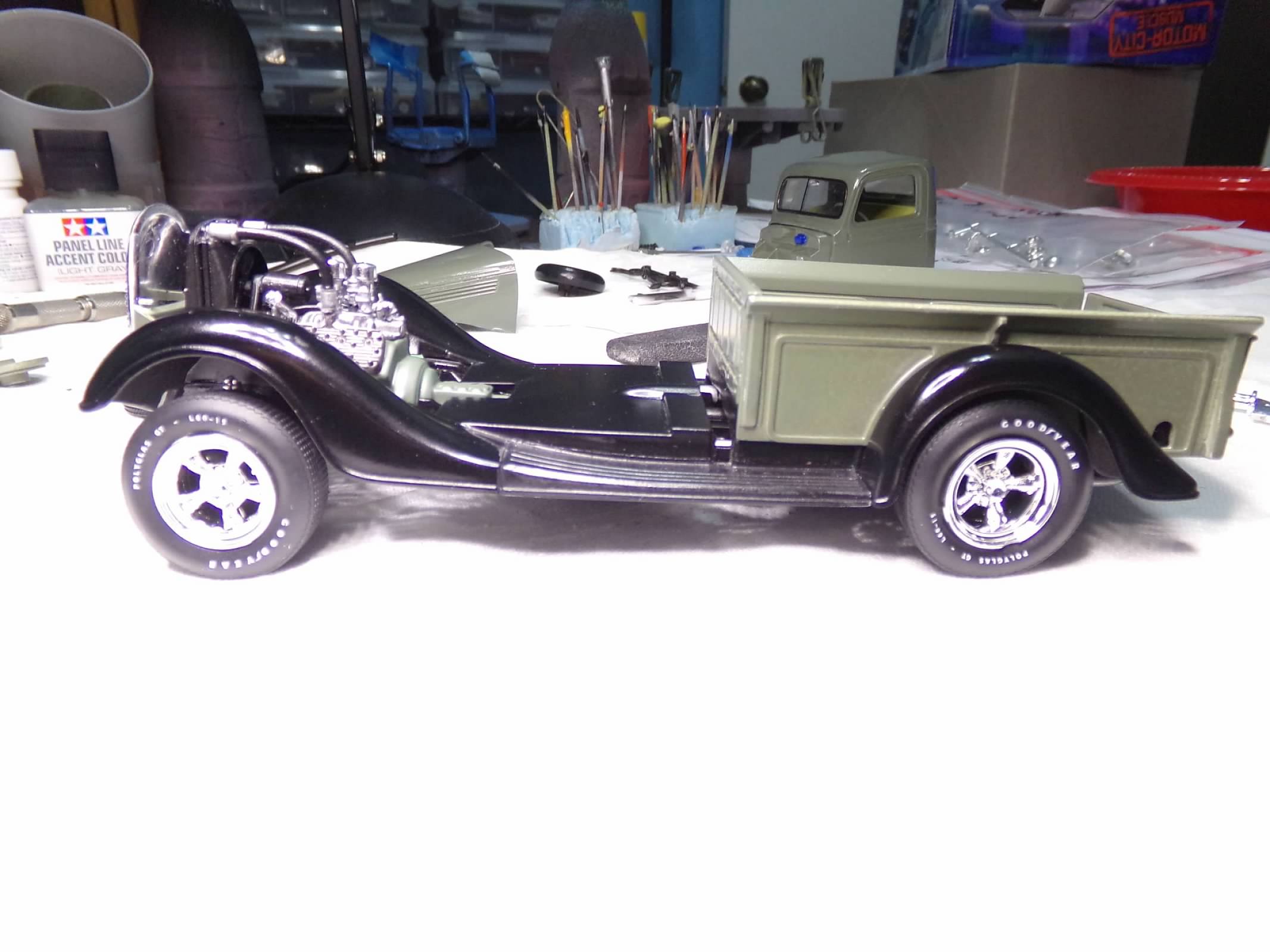

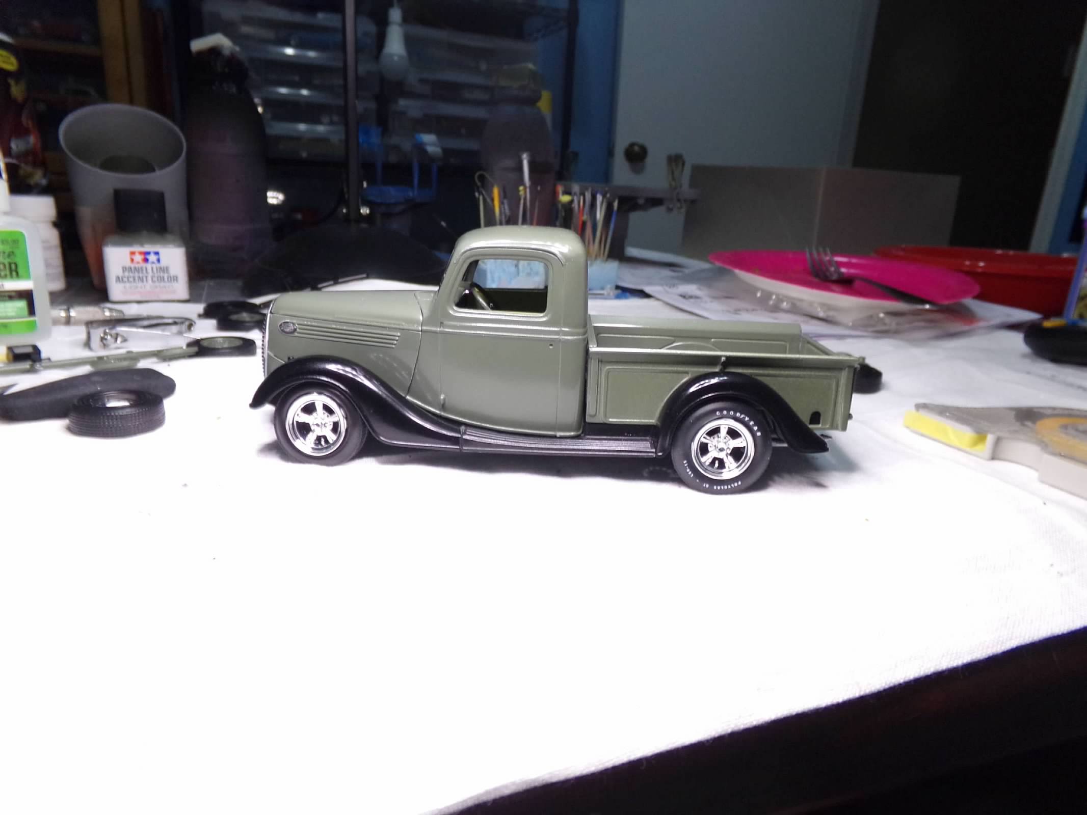

Next I re-installed the dropped axle and went looking for a small tire for the front. The smallest wide tire is probably in the Revell 1969 Camaro RS kit so I have a few of those and took the tires out of one of those for the fronts. They are about F-60 -14s or there abouts. I also used the L60-15s from the last kit I built on the back. So those worked!
00-Y-8Yc6DVh--ZPkGITLwl4ftFjzPT9fAvEBf1aalWdFyxf_AkYEweqhh6fGnBz4J84xJ2Twu75QF_jizMkB1ZdA?cn=THISLIFE&res=large&ts=1688438640
Next, since these wheels are from the Revell 32 5-window Coupe I remembered that I have an extra one of those that I have already used some parts from. I took the tires from this kit and used the wheelbacks that I have already drilled out for these axles. They work great!  It took me all day but I finally have a set of tires and wheels that I am happy with. Tomorrow I clean up the wheels, paint the spokes, and get these wheels and tires put together so that I can complete this build! Thanks for looking!

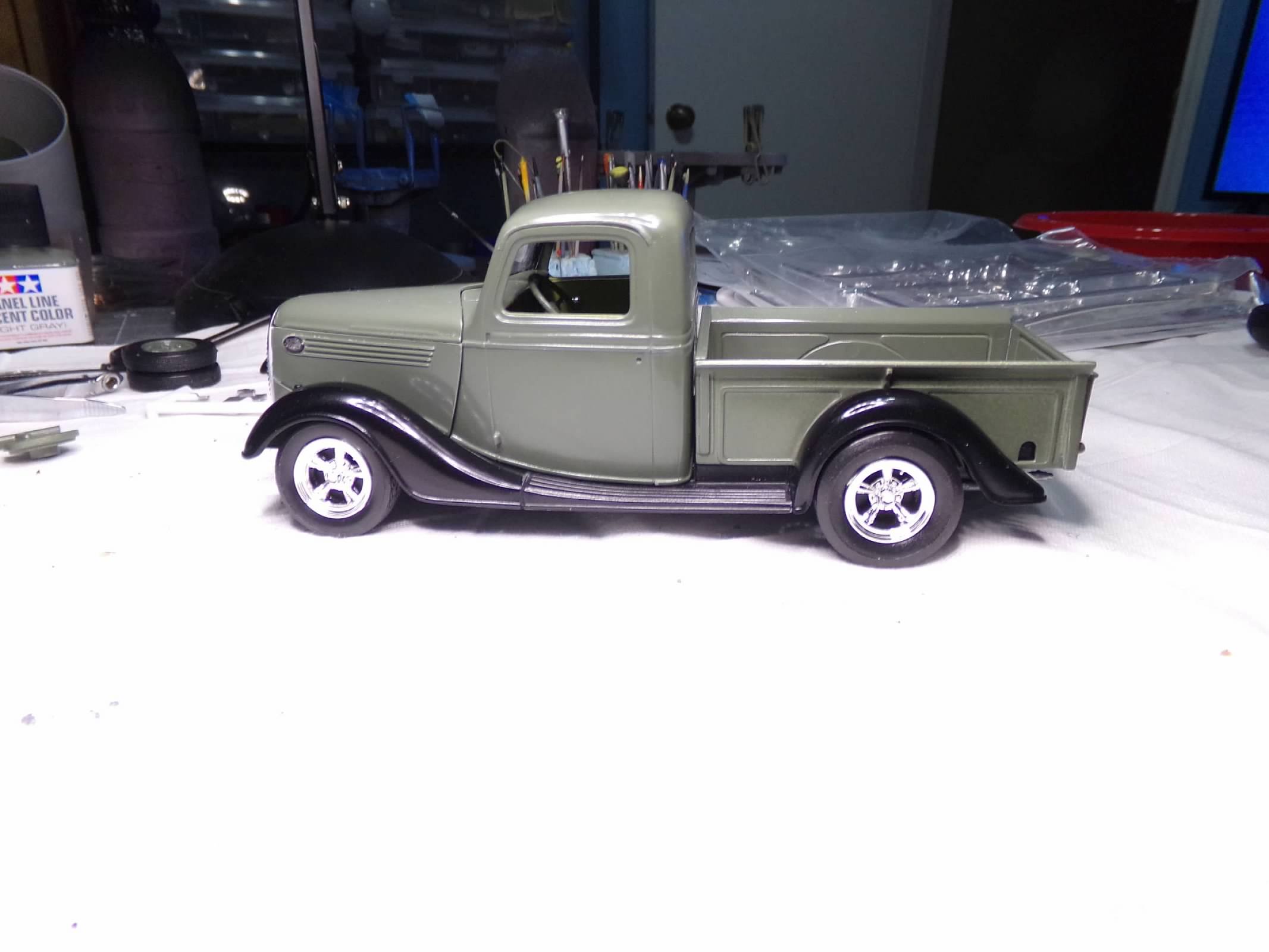

Its so simple but yet so difficult! I now have the wheels and tires glued on. Tires are inside the fenders and not rubbing. Front wheels would turn without rubbing, it seems to me, although it would be tight. These were the wheels I wanted to use all along, I just hadn't made the connection in my head with the extra set of tires I had in the extra kit. But now I'm there - whee! ?
