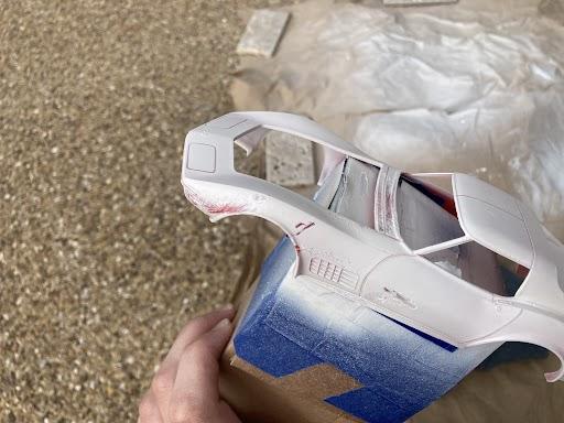

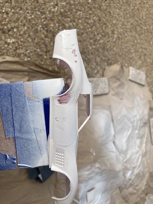

How do I save this, or how do I strip and restart?
For me, I usually strip the paint and start again if I'm not happy with the paint job. As a rule, the prep work is almost more important than the actual paint. I have built several and missed mold lines or scratches and not seen them until after the paint was done. I'd say maybe dunk it in the purple pond and try again if you're not happy with the results. The other option is to try to wet sand or polish the paint.

35 minutes ago, Milo said:
It's just white paint from a spray can
Oh, okay. You'll definitely need to prime that first, especially if you want to paint it white..... There's a bunch of threads in this section of folks trying to cover red plastic.

Milo, the stripping medium heavily depends on the type of paint: enamel (alkyd), acrylic or lacquer. So check that spray can to see what paint you're dealing with.
My best suggestion is to use an ultrasonic cleaner if you have one. I wrote an article about it:
https://robdebie.home.xs4all.nl/models/ultrasonic.htm
Other already mentioned that red plastic can cause problems. The root cause is that the red dye in the plastic is disolved in the solvents of the paint, and will turn your paint color reddish. Judging from your photos, this did not happen with your model, which makes me think the spray can contained water-based acrylic paint.
