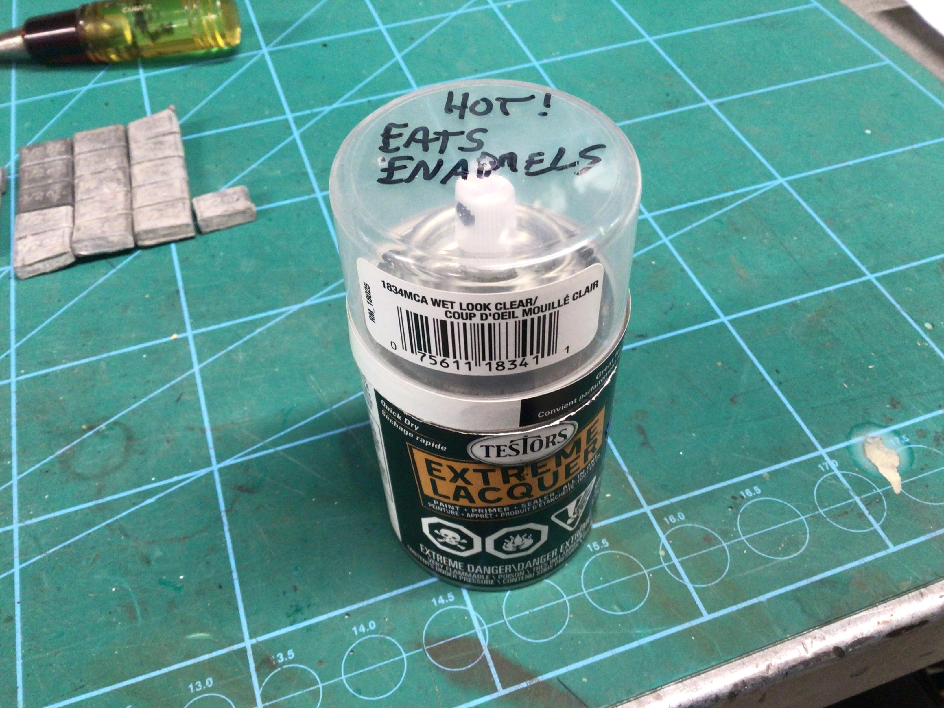

Milo Posted July 17, 2023 Posted July 17, 2023 (edited) I can't recall why I bought this, somehow it came across me as a gloss clear coat. Is this actually that? I used it on an enamel paint job and it came out kind of matte and bumpy. Also what is the best clear gloss coat for an enamel job, if this one isn't good. Edited July 17, 2023 by Milo
NOBLNG Posted July 17, 2023 Posted July 17, 2023 If it’s the 1834 stuff it is gloss. I wrote a note on the lid of my can to remind myself not to use it over enamel. It likely reacted with your enamel and that’s why your finish is matte and bumpy. 1

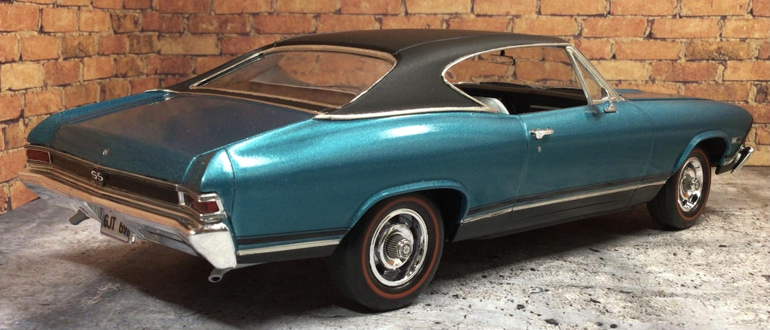

Lunajammer Posted July 17, 2023 Posted July 17, 2023 The conversation has sorta moved past this already, but here's what happened to me when I didn't engage my brain before spraying it over enamel. 1
stitchdup Posted July 17, 2023 Posted July 17, 2023 41 minutes ago, Milo said: Where do I find an acrylic gloss clear tamiya, every time I click a link it then says lacquer even thought it said acrylic just earlier. in some parts of the world lacquer is used to refer to the clear coat. I know when i worked in the body shop lacquer was just clear coat 1
Dave G. Posted July 17, 2023 Posted July 17, 2023 (edited) 16 minutes ago, Lunajammer said: The conversation has sorta moved past this already, but here's what happened to me when I didn't engage my brain before spraying it over enamel. I don't know what "it" was you're referring to but what you're showing is a a good classic and repeatable example of what a reaction of hot lacquer sprayed over fresh enamel often looks like. Edited July 17, 2023 by Dave G.
Lunajammer Posted July 17, 2023 Posted July 17, 2023 8 minutes ago, Dave G. said: I don't know what "it" was you're referring to but but what you're showing is a classic and repeatable reaction of hot lacquer sprayed over fresh enamel. Yeah, the enamel was airbrushed a day or two earlier and I think there was metal flake in it too, which BTW further allows pathways for the lacquer to really get down in there. Happy mistake because the choice of color and paint was all wrong for that project anyway. To clarify, "it" is the product op shows in first post.

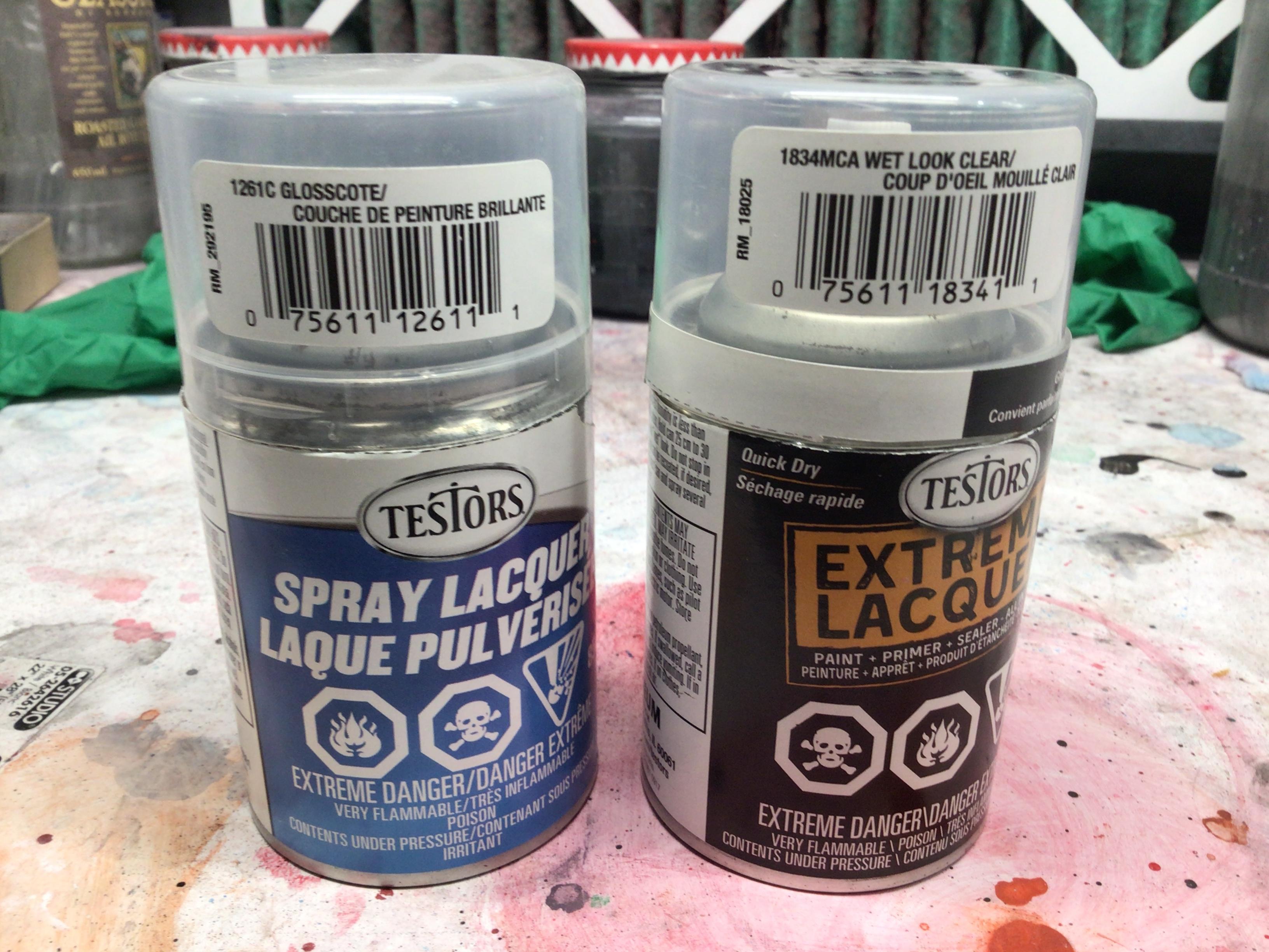

StevenGuthmiller Posted July 17, 2023 Posted July 17, 2023 I don’t understand why everybody has so much trouble using Testors clear lacquer over enamel. I can’t remember the last time that I built a model where half of the parts weren’t first painted with enamel and cleared with Testors lacquer. Testors clear lacquer is in no way, shape or form a hot, automotive type acrylic lacquer. I have no idea what the formulation of the paint is, but I have my doubts that it’s even a lacquer in the normally accepted definition of the word. All that I “can” tell you is that I spray it over enamel all of the time, and by all of the time, I mean very frequently! As a matter of fact, I’ll be doing it tonight over some parts for my current project that were painted last night with flat enamel, and I haven’t even the slightest apprehension about it! Steve
NOBLNG Posted July 17, 2023 Posted July 17, 2023 12 minutes ago, StevenGuthmiller said: I don’t understand why everybody has so much trouble using Testors clear lacquer over enamel. I can’t remember the last time that I built a model where half of the parts weren’t first painted with enamel and cleared with Testors lacquer. Testors clear lacquer is in no way, shape or form a hot, automotive type acrylic lacquer. I have no idea what the formulation of the paint is, but I have my doubts that it’s even a lacquer in the normally accepted definition of the word. All that I “can” tell you is that I spray it over enamel all of the time, and by all of the time, I mean very frequently! As a matter of fact, I’ll be doing it tonight over some parts for my current project that were painted last night with flat enamel, and I haven’t even the slightest apprehension about it! Steve Which one do you use? The #1834 Extreme is hotter than the #1261 I believe.
StevenGuthmiller Posted July 17, 2023 Posted July 17, 2023 1 hour ago, Milo said: What should I thin it with, and what should be the tinner to paint ratio? Do yourself a great big favor and start learning how to work with lacquer paint instead of enamel. It’ll save you from having to jump through all of these hoops. You can basically spray anything over lacquer. Steve 1
StevenGuthmiller Posted July 17, 2023 Posted July 17, 2023 (edited) 8 minutes ago, NOBLNG said: Which one do you use? The #1834 Extreme is hotter than the #1261 I believe. That could be. I wouldn’t know for sure if there’s any difference between the two. I don’t use any of that “extreme”garbage........just my opinion of course.. ? I guess my solution would be that if you want to use clear lacquer over enamel, just shy away from the “fancy label” and get the stuff that does the job. Steve Edited July 17, 2023 by StevenGuthmiller
