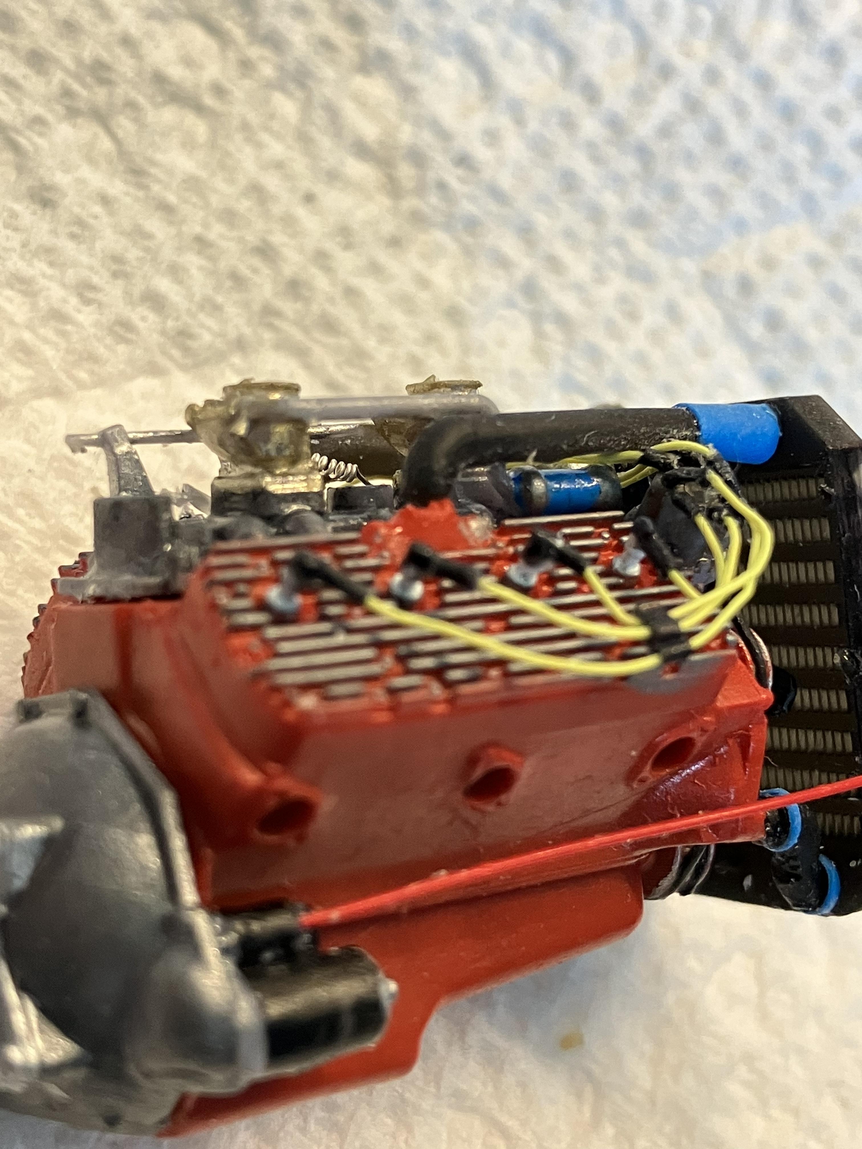

Straightliner59 Posted August 18, 2023 Share Posted August 18, 2023 I used it, for these. The headers are solder and the tailpipe is aluminum tubing. I used my thumbnail to press the still warm tubing around the headers tubes. I'm happy with them! 2 Quote Link to comment Share on other sites More sharing options...
peteski Posted August 18, 2023 Share Posted August 18, 2023 Interesting technique, but I'm worried that heat shrink tubing material is rather flexible and stretchy compared to plastic or metal tubes. If I was using this technique, after shrinking and forming I would wick some thin CA glue where the tubing meets the hard parts. That should make the joint more permanent. Yes, I have been called anal in the past, but I think that trait makes me a better modeler. 1 Quote Link to comment Share on other sites More sharing options...
Straightliner59 Posted August 19, 2023 Share Posted August 19, 2023 12 hours ago, peteski said: Interesting technique, but I'm worried that heat shrink tubing material is rather flexible and stretchy compared to plastic or metal tubes. If I was using this technique, after shrinking and forming I would wick some thin CA glue where the tubing meets the hard parts. That should make the joint more permanent. Yes, I have been called anal in the past, but I think that trait makes me a better modeler. That's exactly what I did. Good call! Quote Link to comment Share on other sites More sharing options...

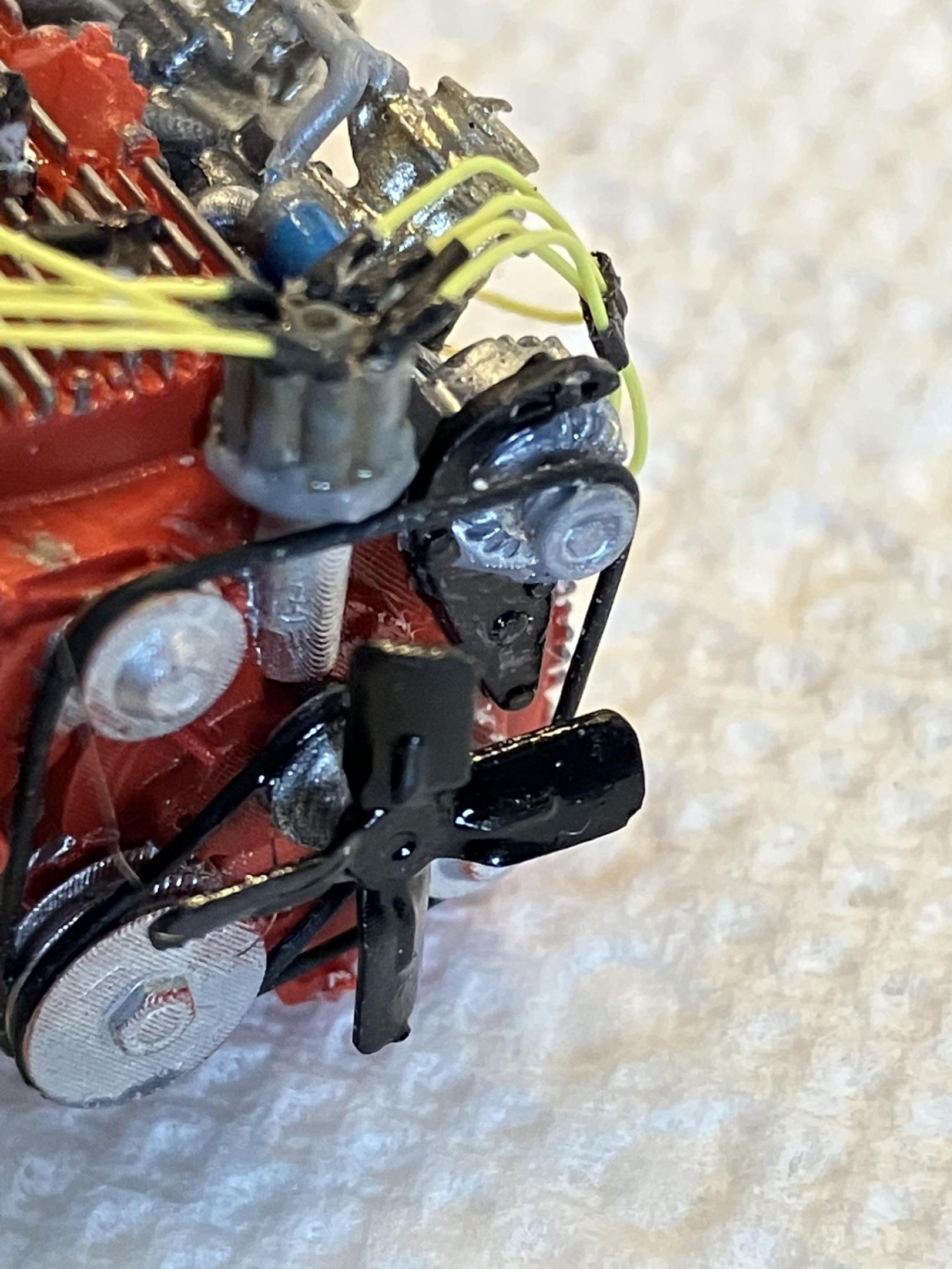

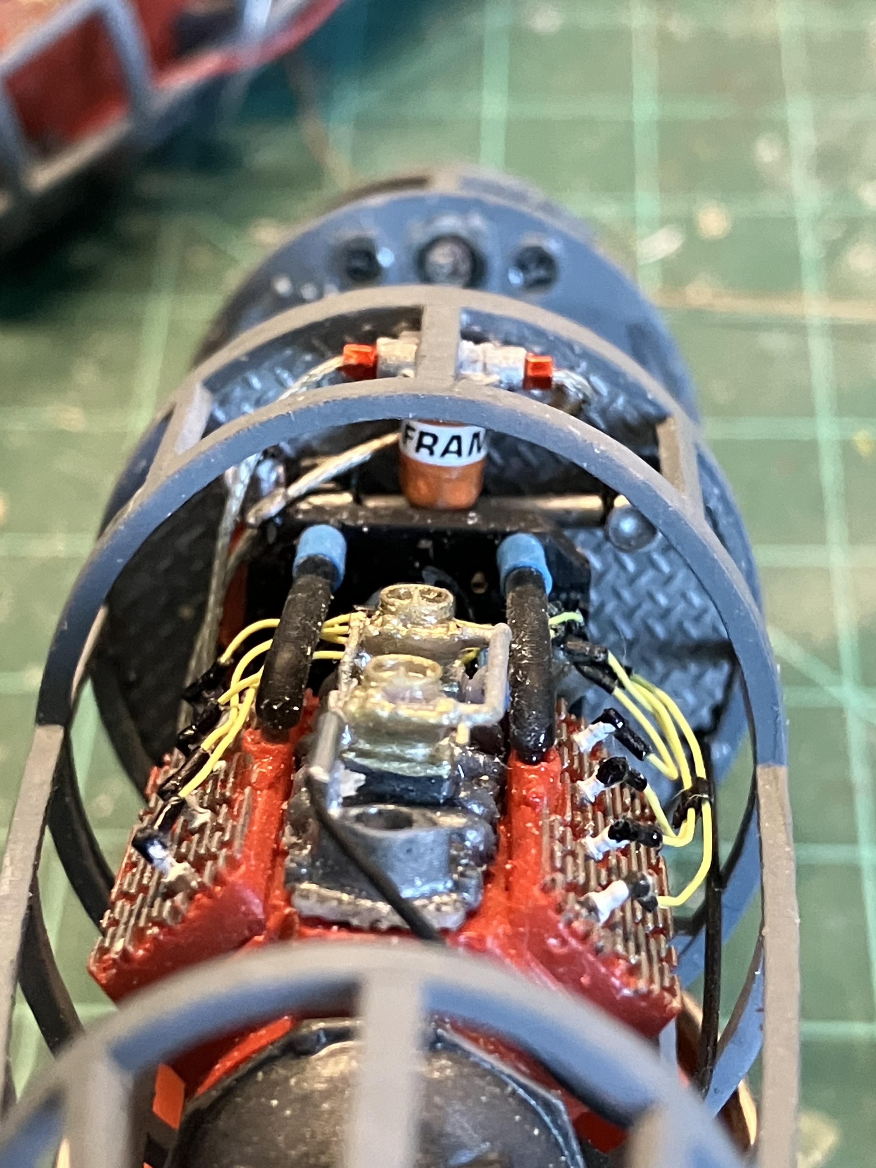

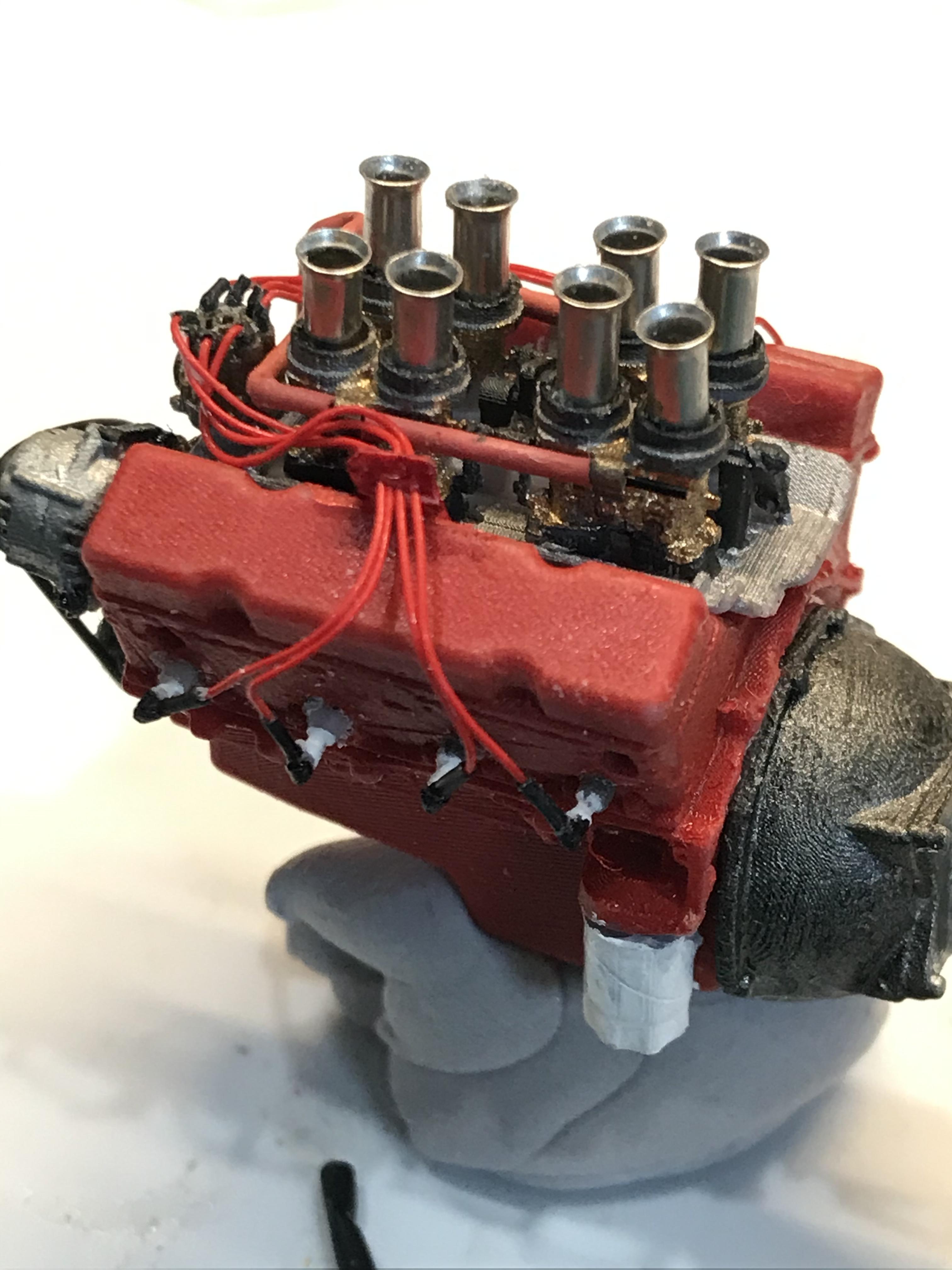

Jiml0001 Posted August 22, 2023 Share Posted August 22, 2023 I use heat shrink a lot. Couple of things. Most heat shrink tubing shrinks at under 200 degrees. Styrene melts at about 350 degrees. I use a heat gun but a good hot hair dryer will work. Open flame tends to melt and deform the tubing and the styrene instead of getting an even shrink. Heat shrink can be stretched when it is warm and you can make tubing as small as you want. I use it for any type of hose and even make plug boots from it On these engines fuel lines, radiator hose coupling, plug boots and even the fan belt are all stretched heat shrink tubing 2 Quote Link to comment Share on other sites More sharing options...
Straightliner59 Posted August 22, 2023 Share Posted August 22, 2023 19 minutes ago, Jiml0001 said: I use heat shrink a lot. Couple of things. Most heat shrink tubing shrinks at under 200 degrees. Styrene melts at about 350 degrees. I use a heat gun but a good hot hair dryer will work. Open flame tends to melt and deform the tubing and the styrene instead of getting an even shrink. Heat shrink can be stretched when it is warm and you can make tubing as small as you want. I use it for any type of hose and even make plug boots from it On these engines fuel lines, radiator hose coupling, plug boots and even the fan belt are all stretched heat shrink tubing Beautiful work! Love the finishes, and the details. Quote Link to comment Share on other sites More sharing options...
