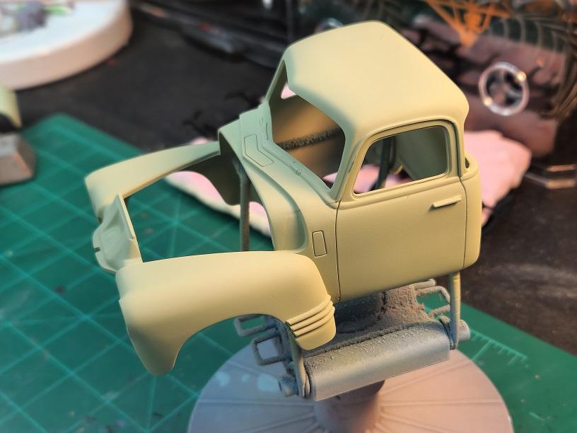

slusher Posted October 25, 2023 Posted October 25, 2023 (edited) Looking good Bob! What size rod did you use on those fenders? My brother gave ne on of these 50 Chevys but I am going box stock .. Edited October 25, 2023 by slusher
Zippi Posted October 25, 2023 Author Posted October 25, 2023 7 hours ago, slusher said: Looking good Bob! What size rod did you use on those fenders? My brother gave ne on of these 50 Chevys but I am going box stock .. Thanks Carl. I used the Half Round .060 (1.5 mm) Item No. 241.

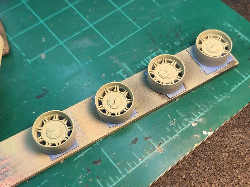

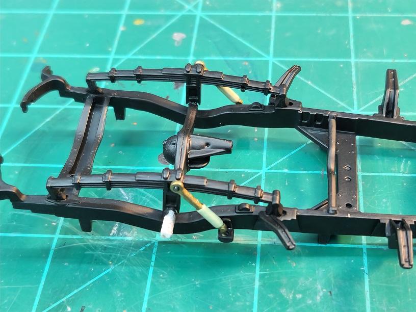

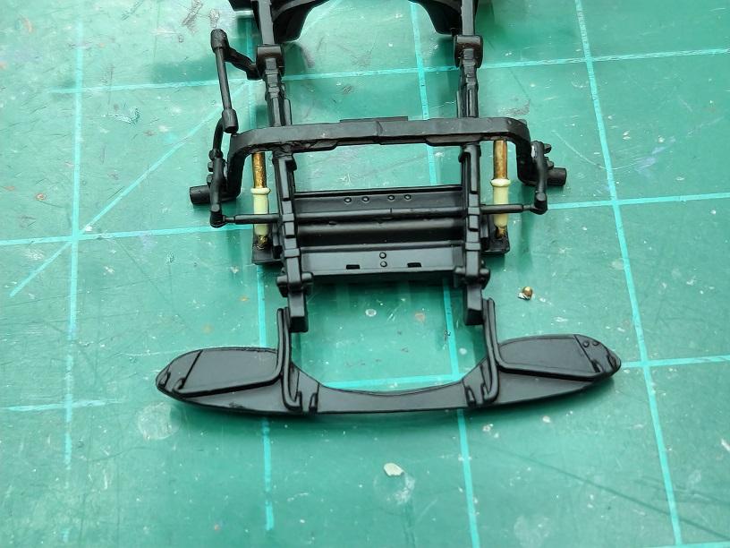

Zippi Posted October 25, 2023 Author Posted October 25, 2023 The weather and humidity was in my favor this morning so I got some paint on the wheels & body. I also got the shocks installed, Tri Power Rochester setup and carbs painted, and the distributor wired. 1

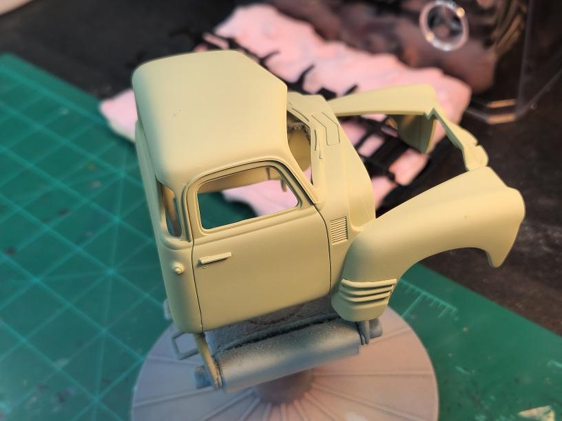

Zippi Posted October 26, 2023 Author Posted October 26, 2023 I got out here today and got the upper half of the cab mask off and painted in Tamiya X-10 Gun Metal. Glad I got it done as it looks like rain for the next 4-5 day. The masking came out better than expected but I'm a happy camper. It's back in the Dehydrator for a while before it gets wet sanded, cleared, wet sanded again, and polished. 3

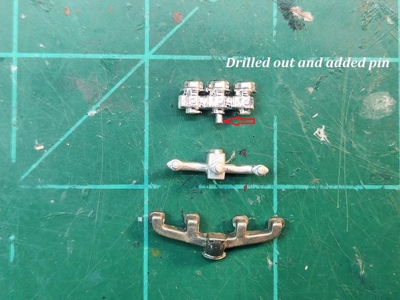

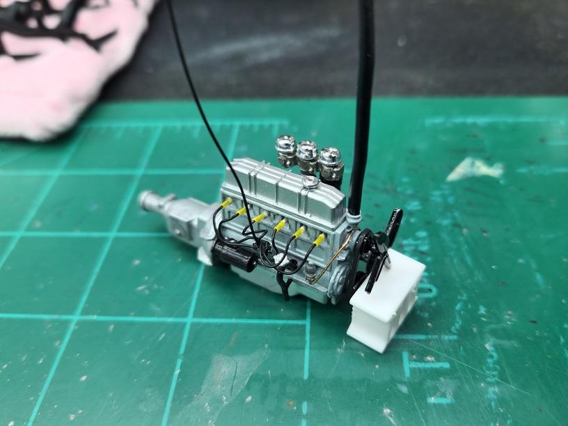

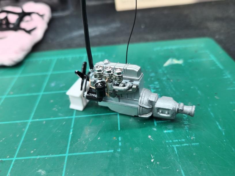

TarheelRick Posted October 27, 2023 Posted October 27, 2023 Really like this build, your color selection works very well with it. I was looking at your tri-power setup and the way you have it only the center carb will be feeding the engine. If you were to cut that square block on top of the manifold so it is flush then all three carbs would be attached to the manifold. Not trying to be judgmental, just thought i might be of some help.

Zippi Posted October 27, 2023 Author Posted October 27, 2023 52 minutes ago, TarheelRick said: Really like this build, your color selection works very well with it. I was looking at your tri-power setup and the way you have it only the center carb will be feeding the engine. If you were to cut that square block on top of the manifold so it is flush then all three carbs would be attached to the manifold. Not trying to be judgmental, just thought i might be of some help. Thanks man and I appreciate your input. I was just going with the one carb so the others are dummy carbs. I may take a look at adding blocks under the other carbs later.

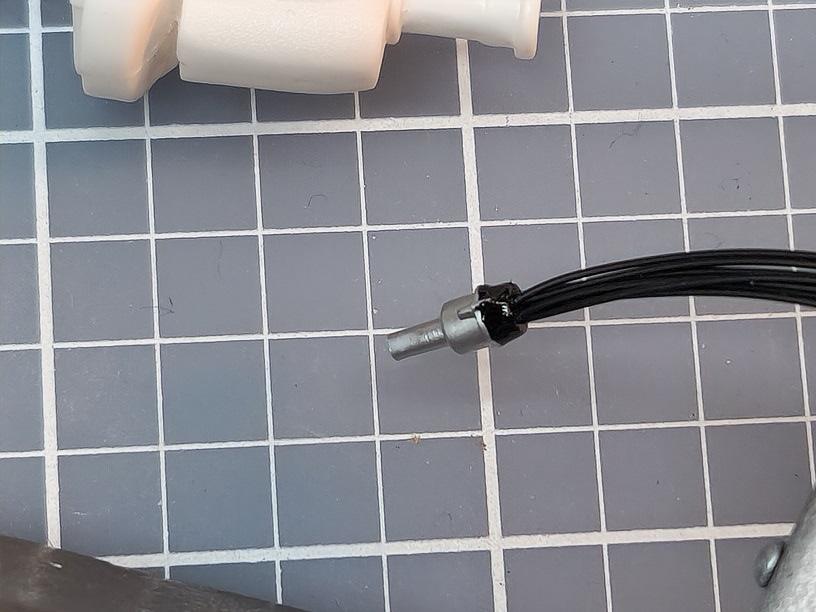

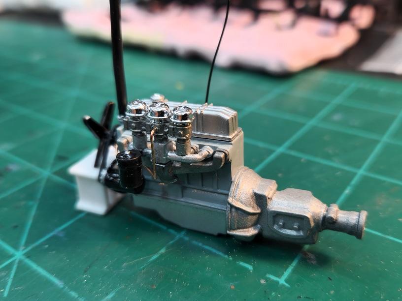

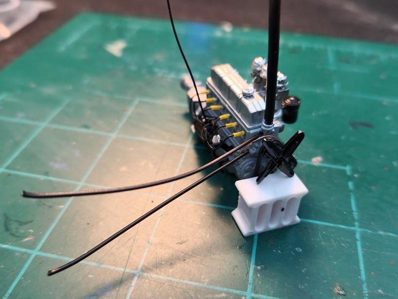

Zippi Posted October 28, 2023 Author Posted October 28, 2023 I got the engine wired and the radiator hose attached but still have to add the clamp. I have the holes in the block and firewall drilled for the heater hoses that I'll add later. Still heeds a little touch up but I'm happy with where I'm at with it.

Zippi Posted October 29, 2023 Author Posted October 29, 2023 I got the heater hoses glued into the engine and I also found some .109 Dia. aluminum tubing from my RC plane days that worked on the two outer cabs. I cut them to size and slipped them between the outer carbs and intake manifold. Didn't even have to paint them as I liked the color.
