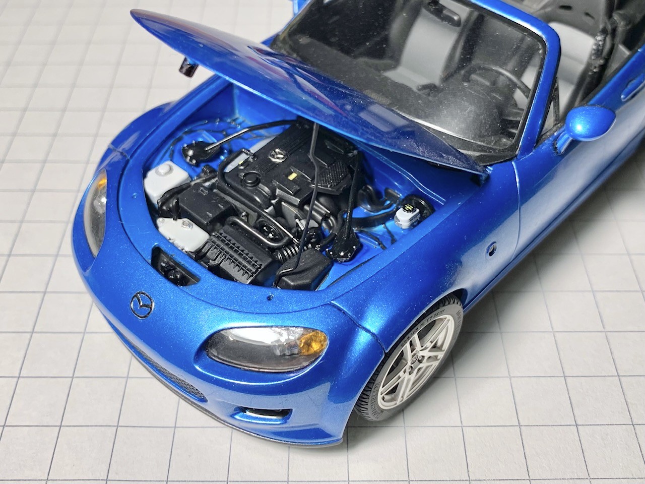

Zoom Zoom Posted October 10, 2023 Posted October 10, 2023 2 hours ago, Monty said: I'm not all that familiar with Tamiya products. Can you elaborate on the difference(s) between this and their Fine Surface Primer? Base white has more pigment than the white fine surface primer for rapid coverage of multiple (any) colors of plastic. It also dries smoother with a bit of gloss. My best example of the base white usage was on this build; the body was molded in white. The separate engine compartment was molded in black. It needed to be body color, and I was painting the body in a metallic blue. I primed the engine compartment in base white and was able to then paint it along with the body panels in blue with no mismatch. Base white was the way to go.
