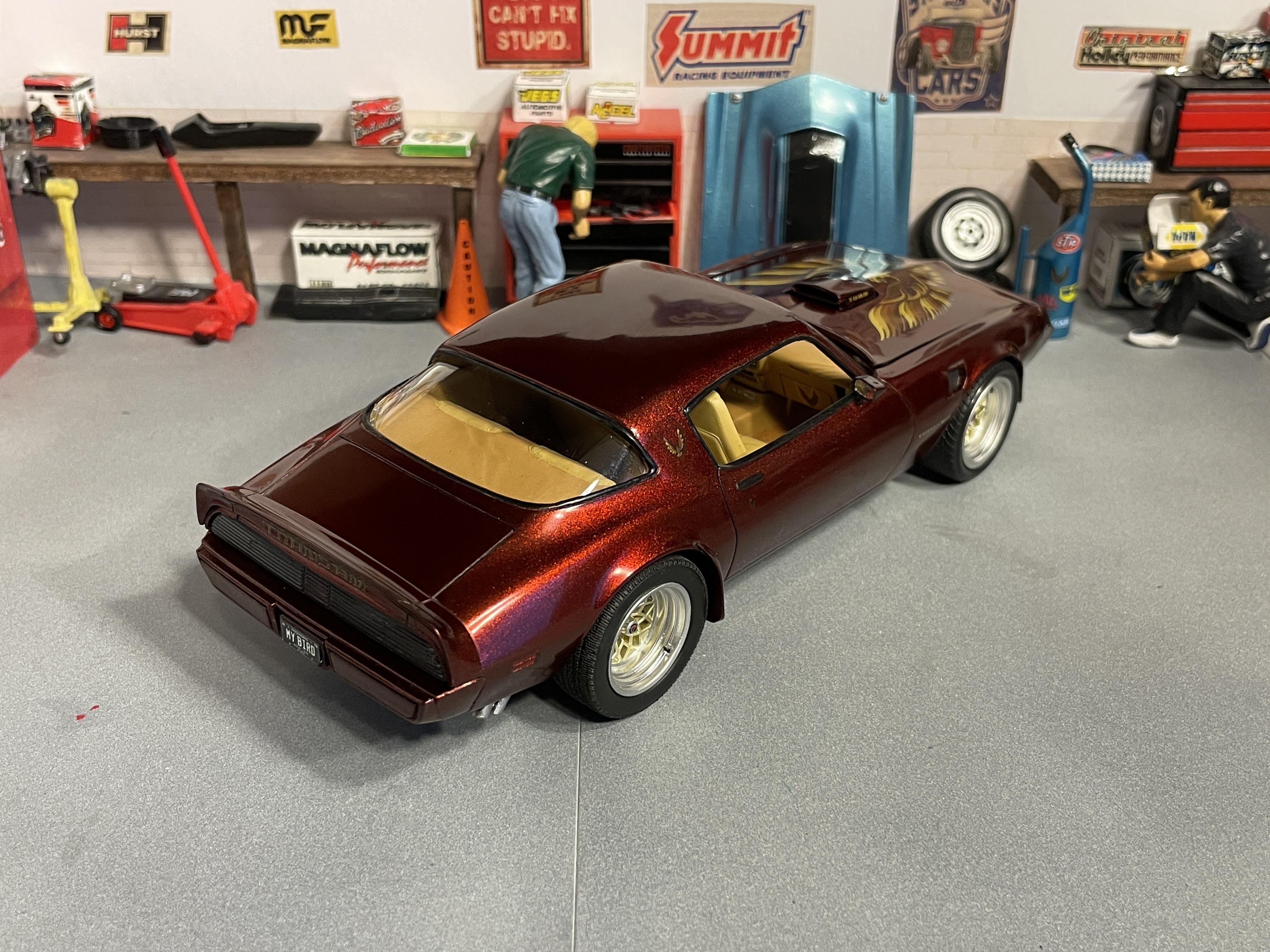

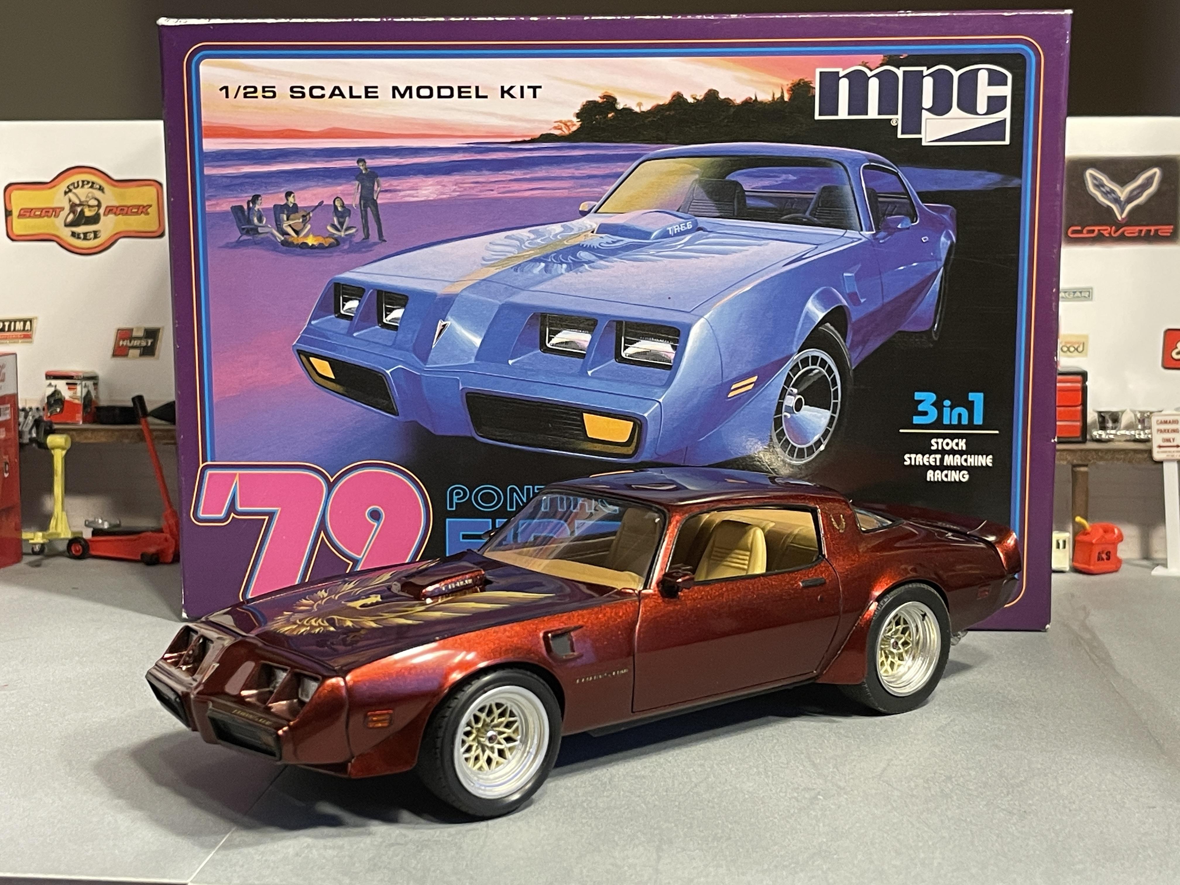

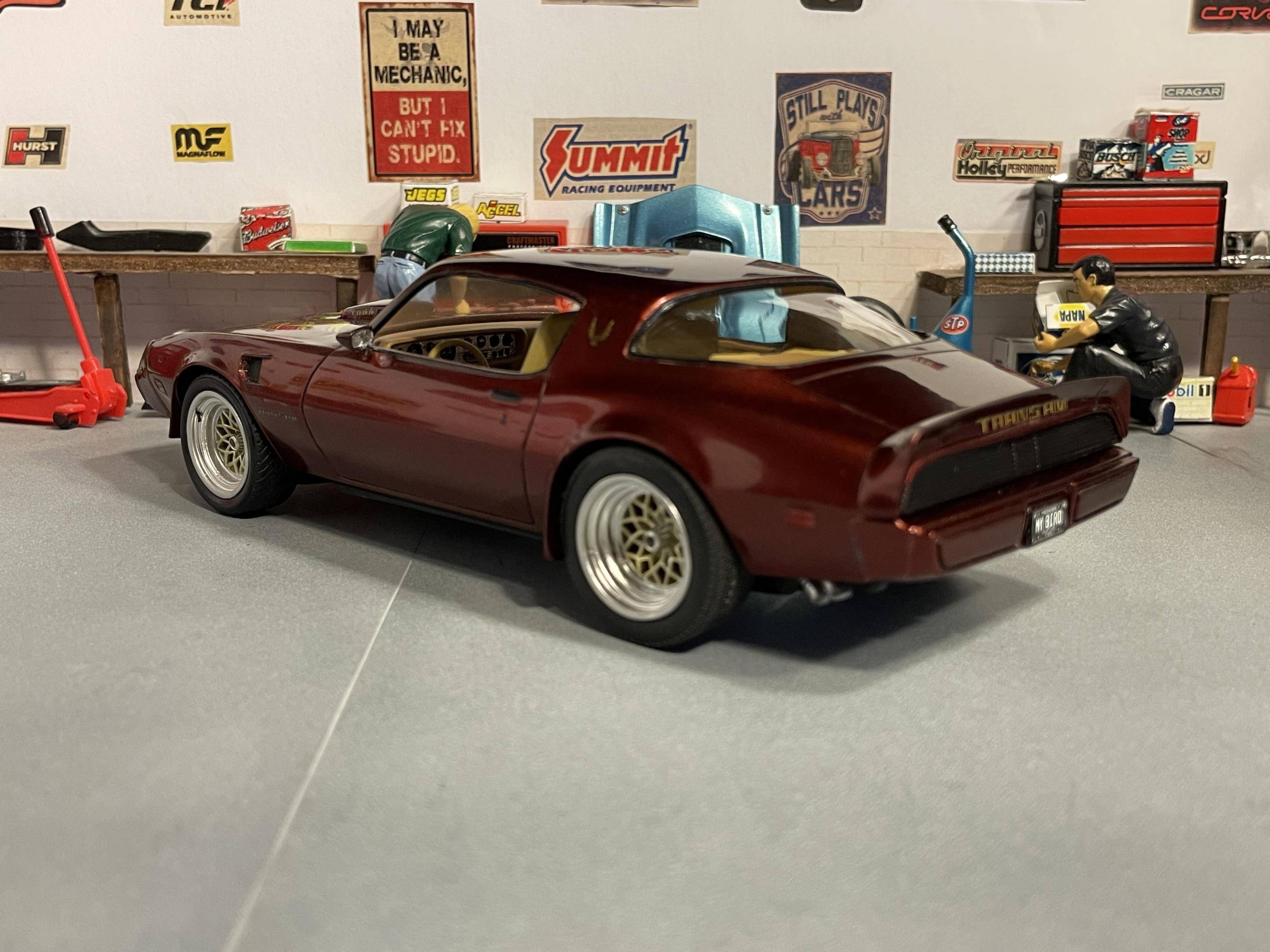

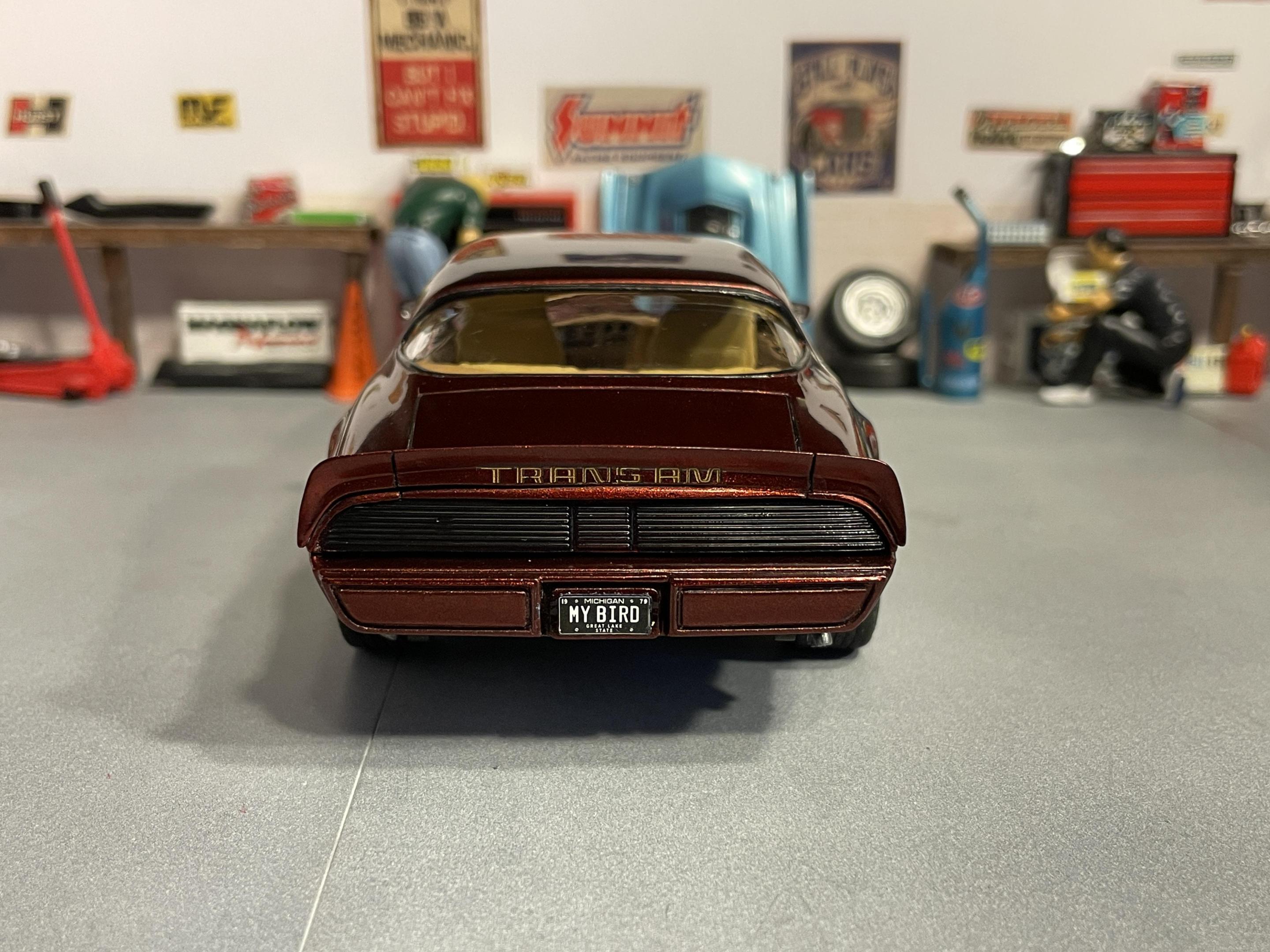

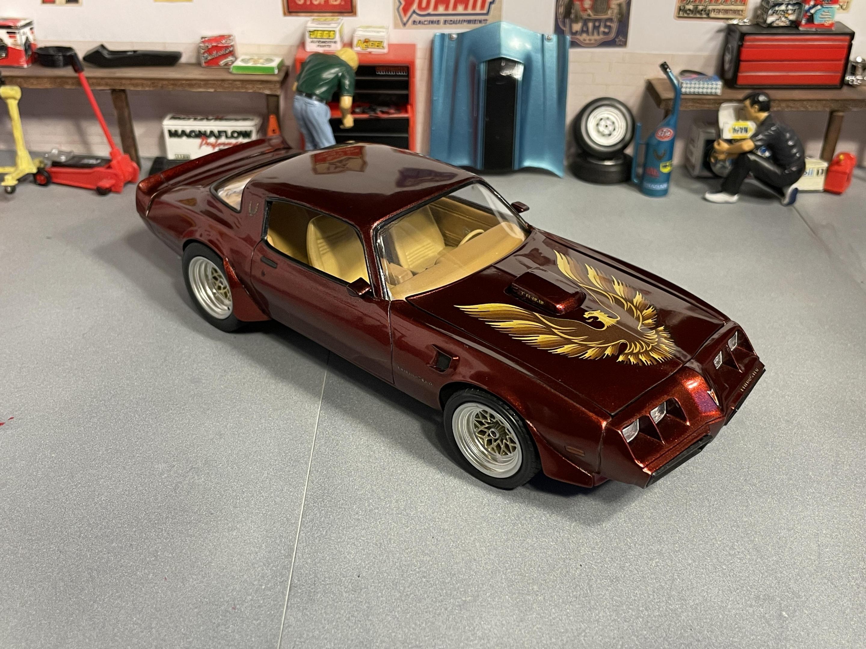

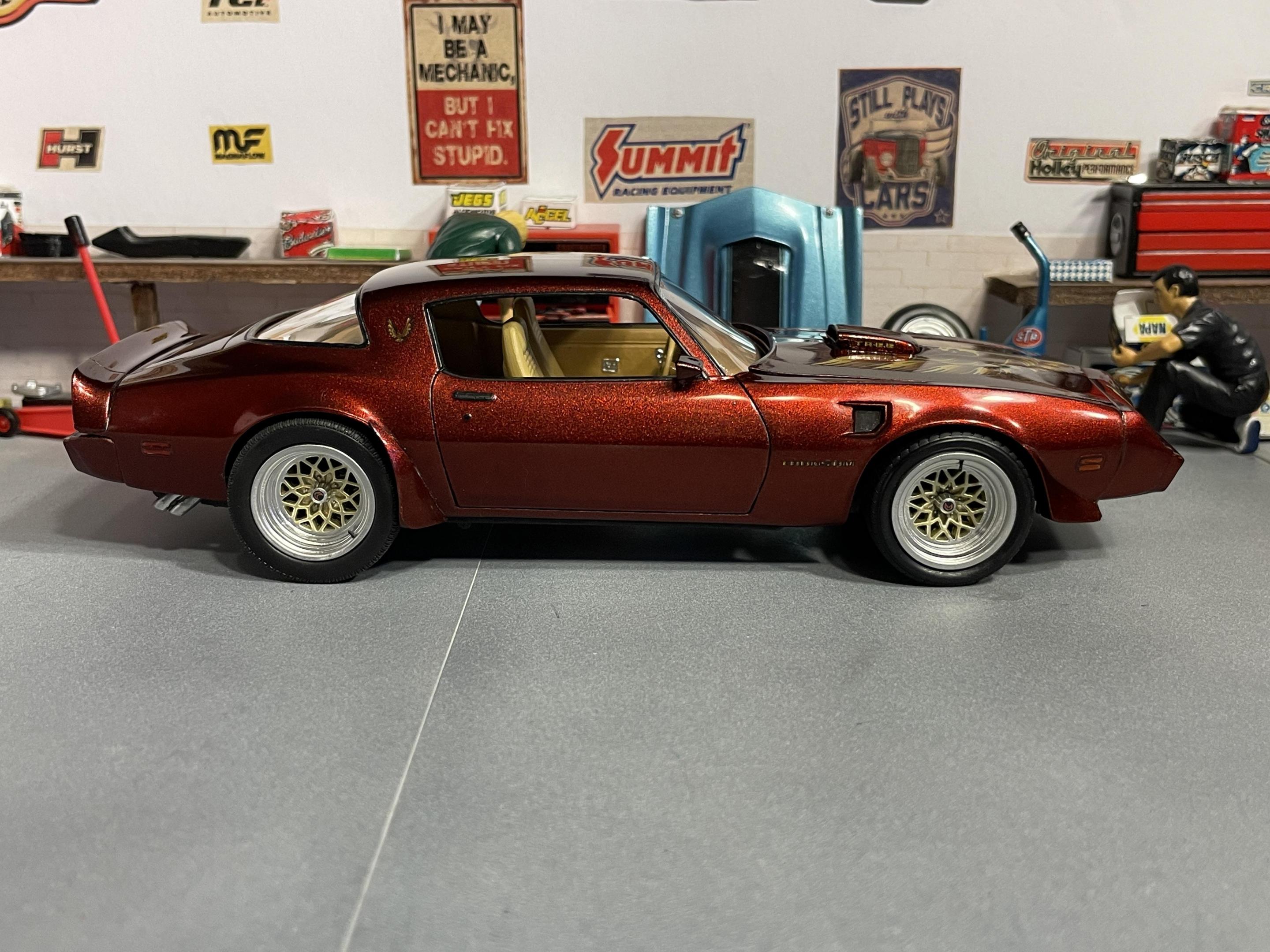

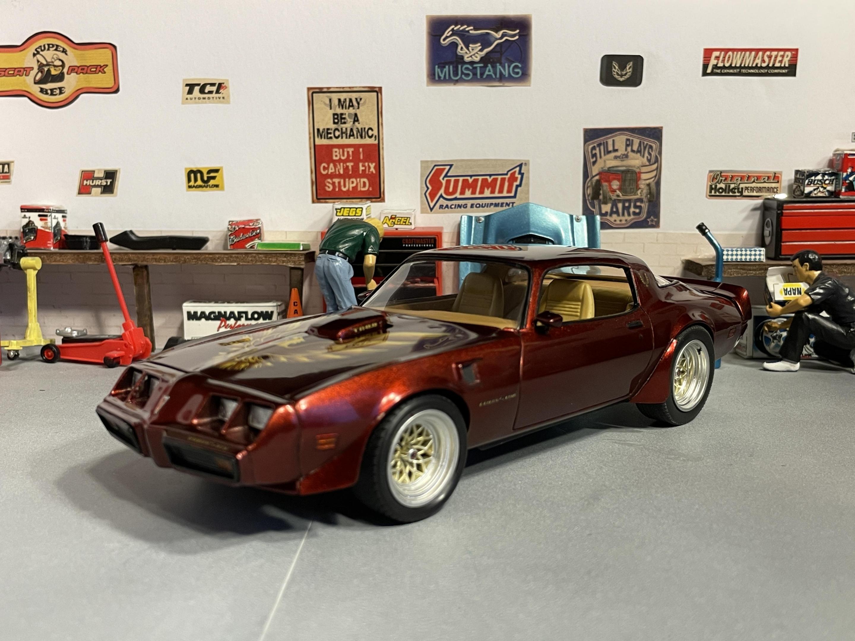

    Here's my version of the MPC 1979 Pontiac Firebird Trans Am. I started with Stynylrez Black Primer, followed by two coats of Shuttle Art Flash Black (Metallic Black), and then three or four coats of Tamiya X-27 Acrylic Clear Red, all through my airbrush. Then I added the decals and sprayed three coats of Createx High Gloss Clear. After that I wet-sanded from 6000-12,000, polished with Novus #2, and finally a coat of Meguiar's Cleaner Wax.

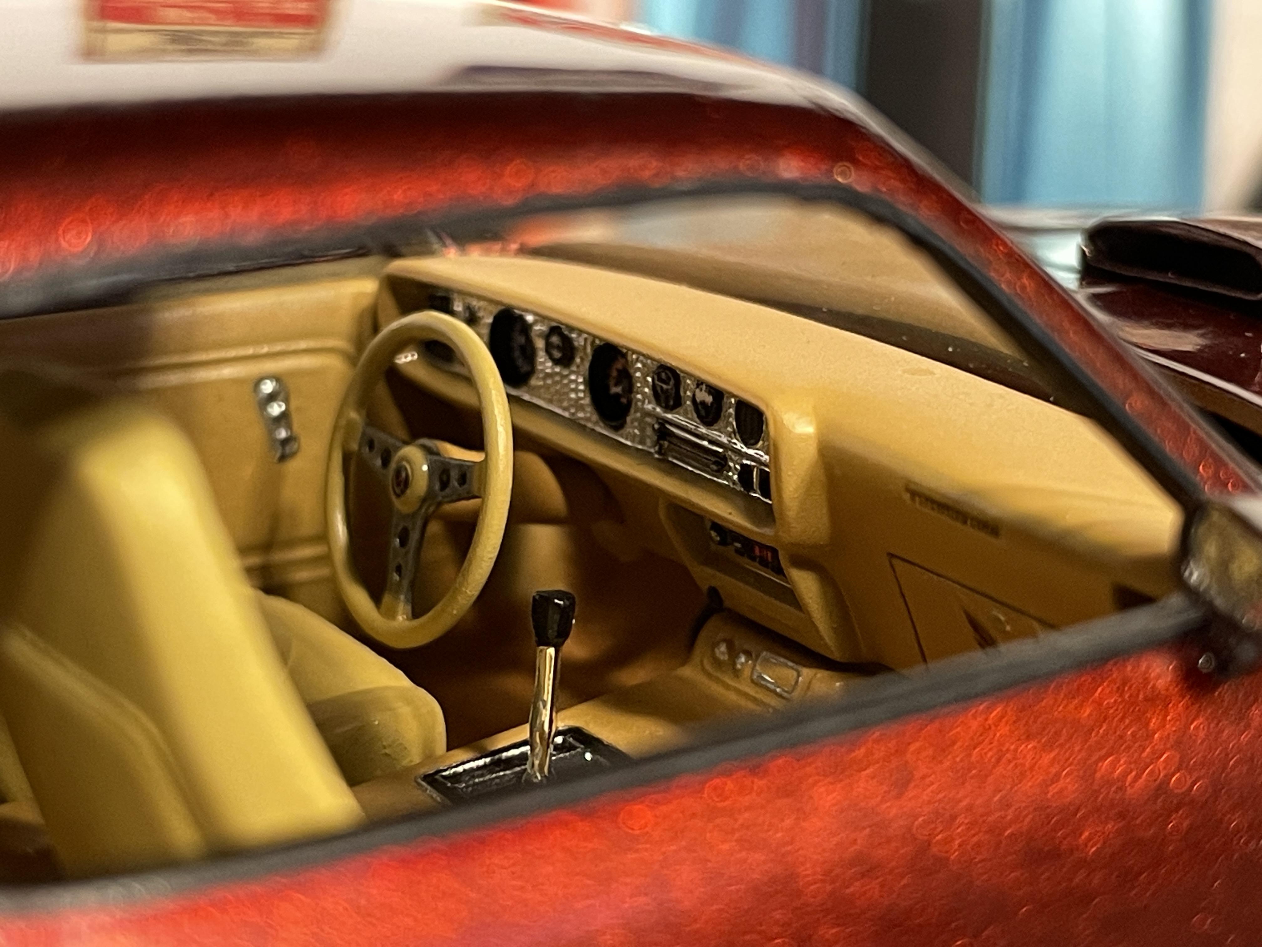

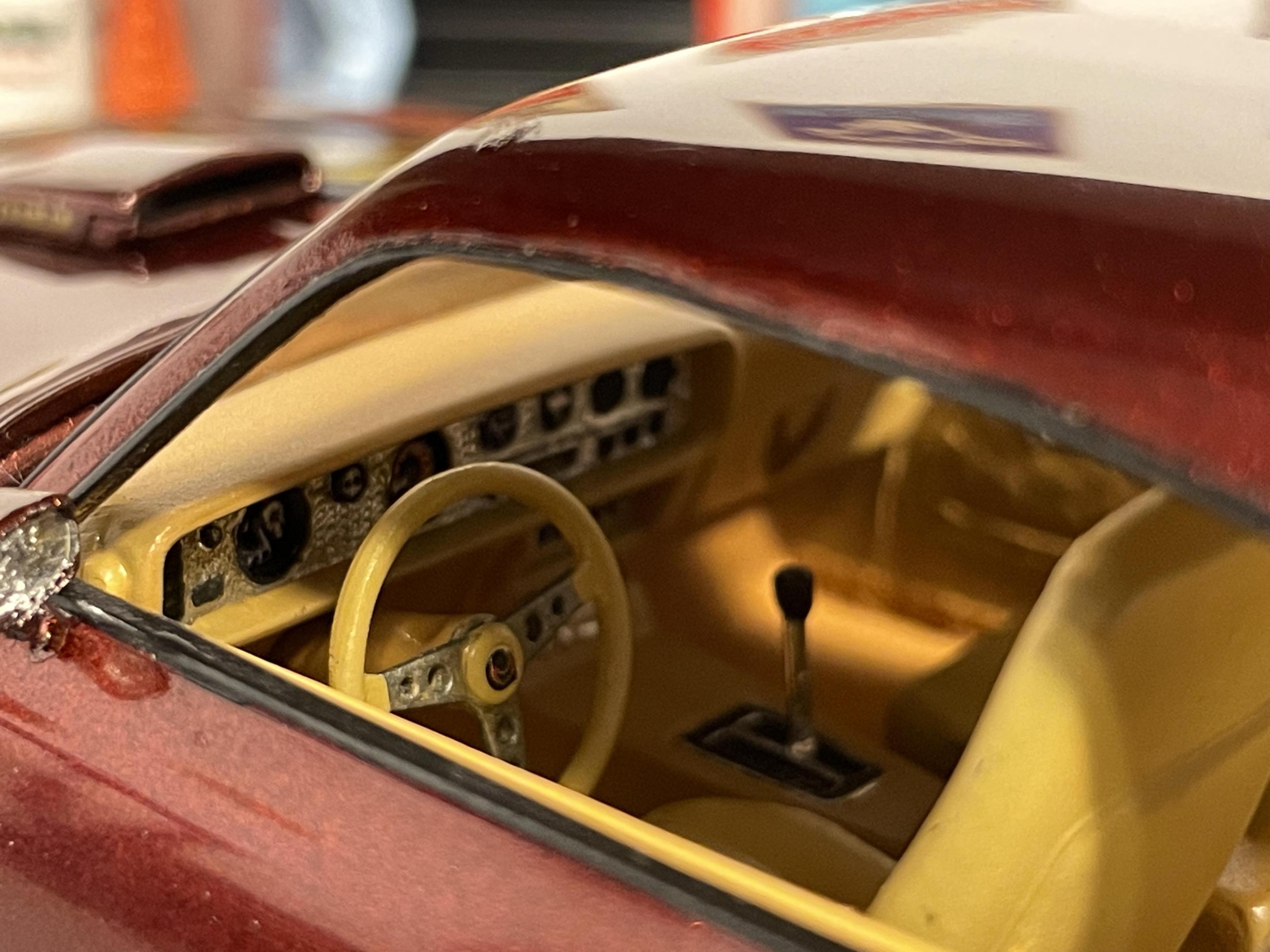

     The interior is all craft paint, using combinations of Apple Barrel Khaki, Apple Barrel Nutmeg Brown, and Decoart Honey Brown. I used Embossing Powder for the carpet area, which was painted over with the Khaki.

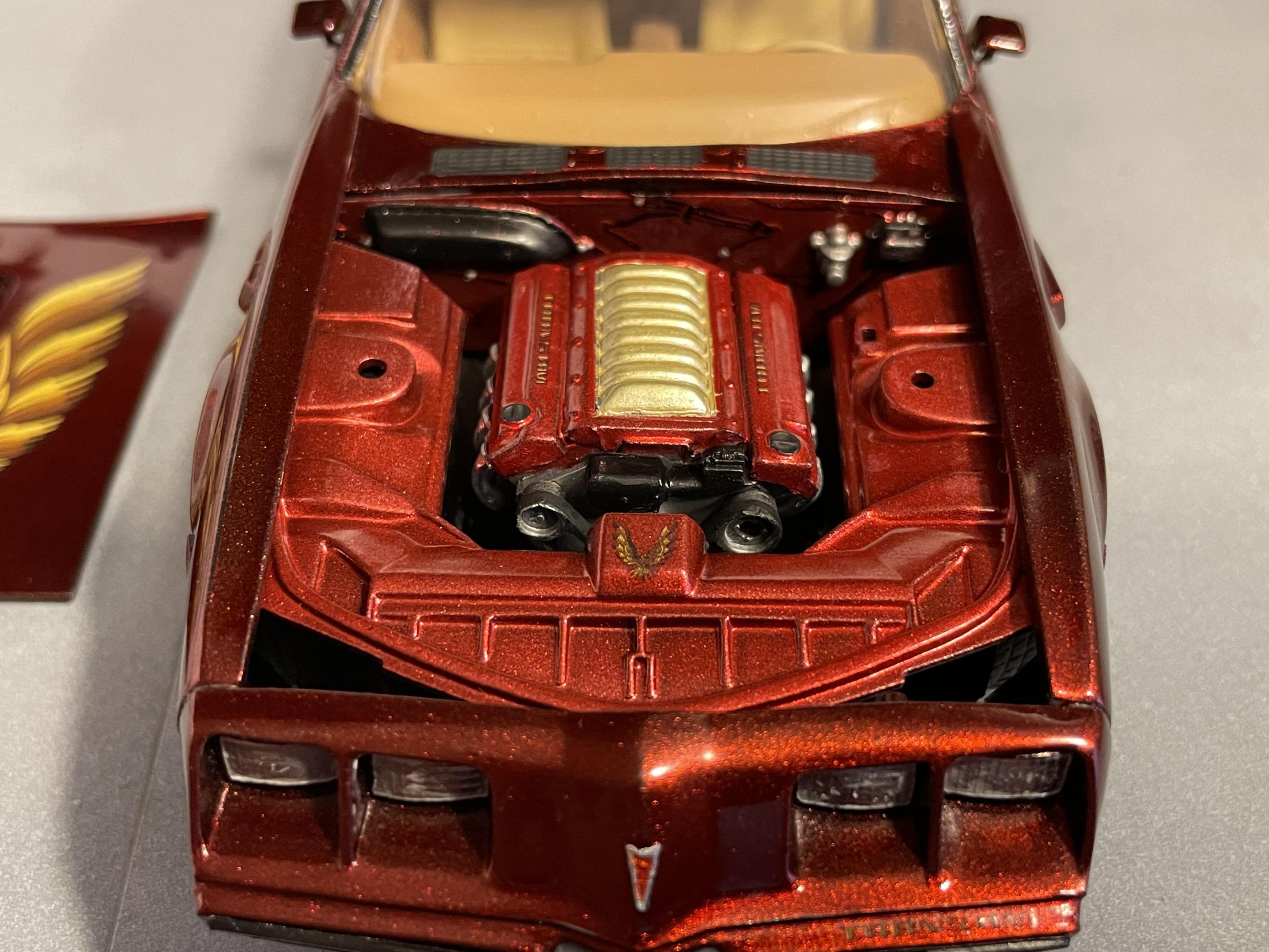

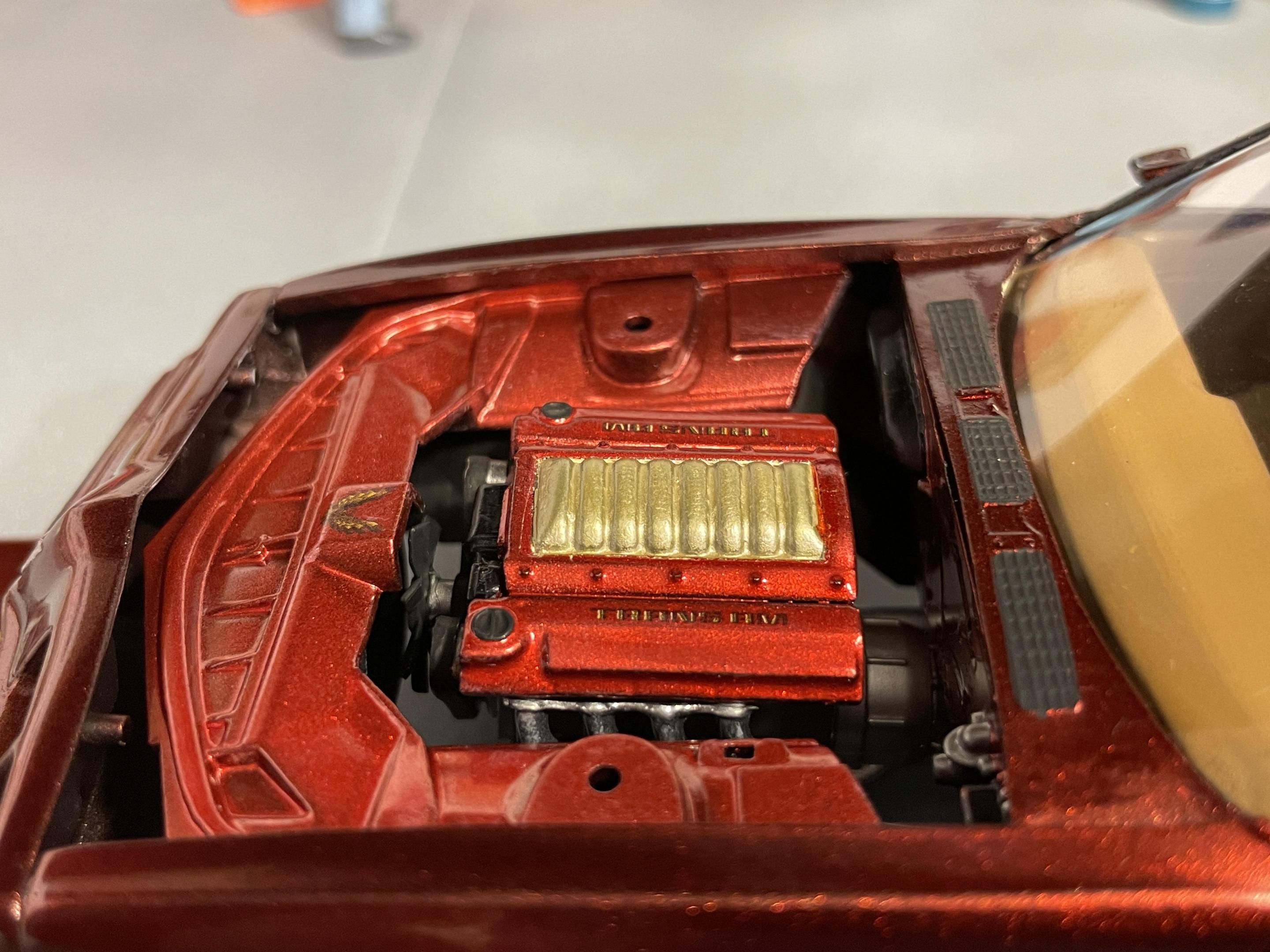

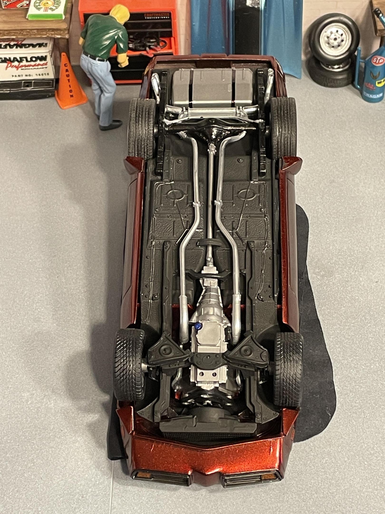

     The engine and transmission is from the AMT 2006 Camaro Concept as is the engine bay surround. The wheels are from Forward Resin on ebay, and the tires are from the parts box. The chassis and suspension are from the kit, with some cutting and trimming done on the front suspension parts to fit the tires. The exhaust is also from the kit, with a bit trimmed off to fit the 1/8 inch styrene tubing carefully bent to reach the LS engine exhaust headers.
     This is a challenging kit in the first place with some excess flash, thick clear glass, sparse details, and an ill fitting body/interior/chassis connection. I don't know if it was easier or trickier with the needed mods made for the non-kit parts, lol. Either way, it was actually a pretty fun build that I am very happy with the results of. I really like these cars, but wish either Round 2 or Revell would re-tool/commit to a new tooling of them as I really think an improved version would do well, but in the end it does look the part which is most important I guess. Anyways, as always thanks for looking!!

Wow, that is beautiful! I love the color combination. It looks like the Model Master "Root Beer" brown, on the exterior. That's something you don't see very often.

Beautiful looking paint color and finish, like the dark deep look. Contrasting interior color goes well and its finish looks great.
Excellent work as always! The exterior color along with the wheels to me give it the restomod look.

Thanks for the compliments guys, much appreciated!
Thanks Jeff! For some reason the lighting gave it more of a red-brown look, but it is a really sharp deep red.
