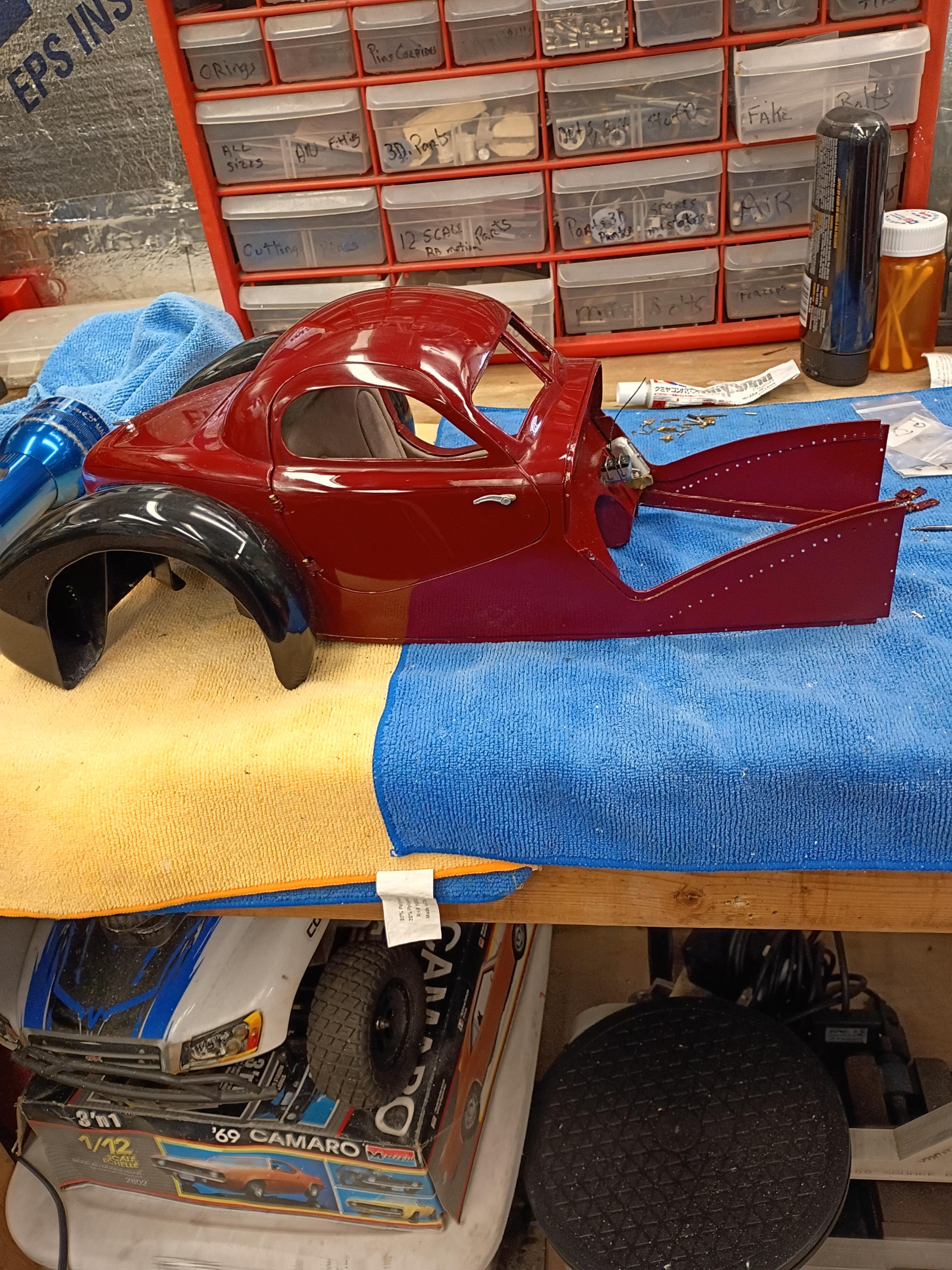

charlie libby Posted June 8 Author Posted June 8 working on finish assembly is slow and kind of scary. i dont want to damage ant thing and its quite difficult. to many parts and to many screws. had to modify the seat bottoms so i had to reupholster them got the doors back on and lined up. door handle and trunk handles are on. realized today i did not make inside window cranks and door handles not a big deal . i am trying to decide how to paint and install the front and rear glass. they are fitted just painting them is up in the air. andrew you don't need brakes in a car like this , who wants to stop or slow down. thanks for your comment mr. gibbs. hi bob come back anytime. francis always good to hear from you,your engine is awesome. going to miss you for the summer.tim i hope your bicep is properly healing. thanks for your comment rattlecan. pierre your nova is the best,i love it, have a great vacation. waiting for rb to catch up to place another order. thanks everbody,charlie
charlie libby Posted June 16 Author Posted June 16 heiio getting closer to putting the body on for good. decided to remove all the carpet . i did not paint it black on the inside so the red showed thru the carpet. soaked it in soapy water and all the elmers glue came off. it looks much better with black under it. made the door handles and window cranks this week and installed them . fitted the doors on . still not sure how to paint these little windows. would like to get the body in place to finish the brake lines and i little more wiring. 1

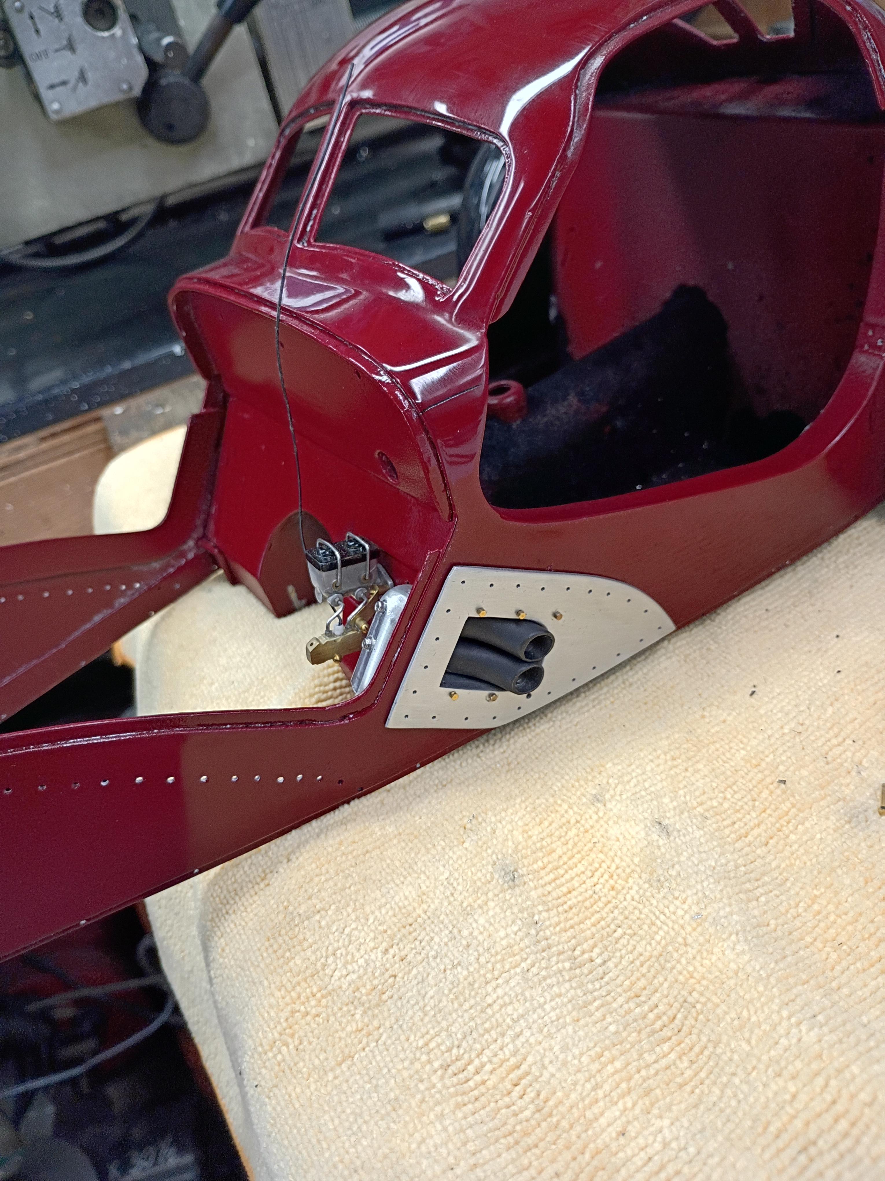

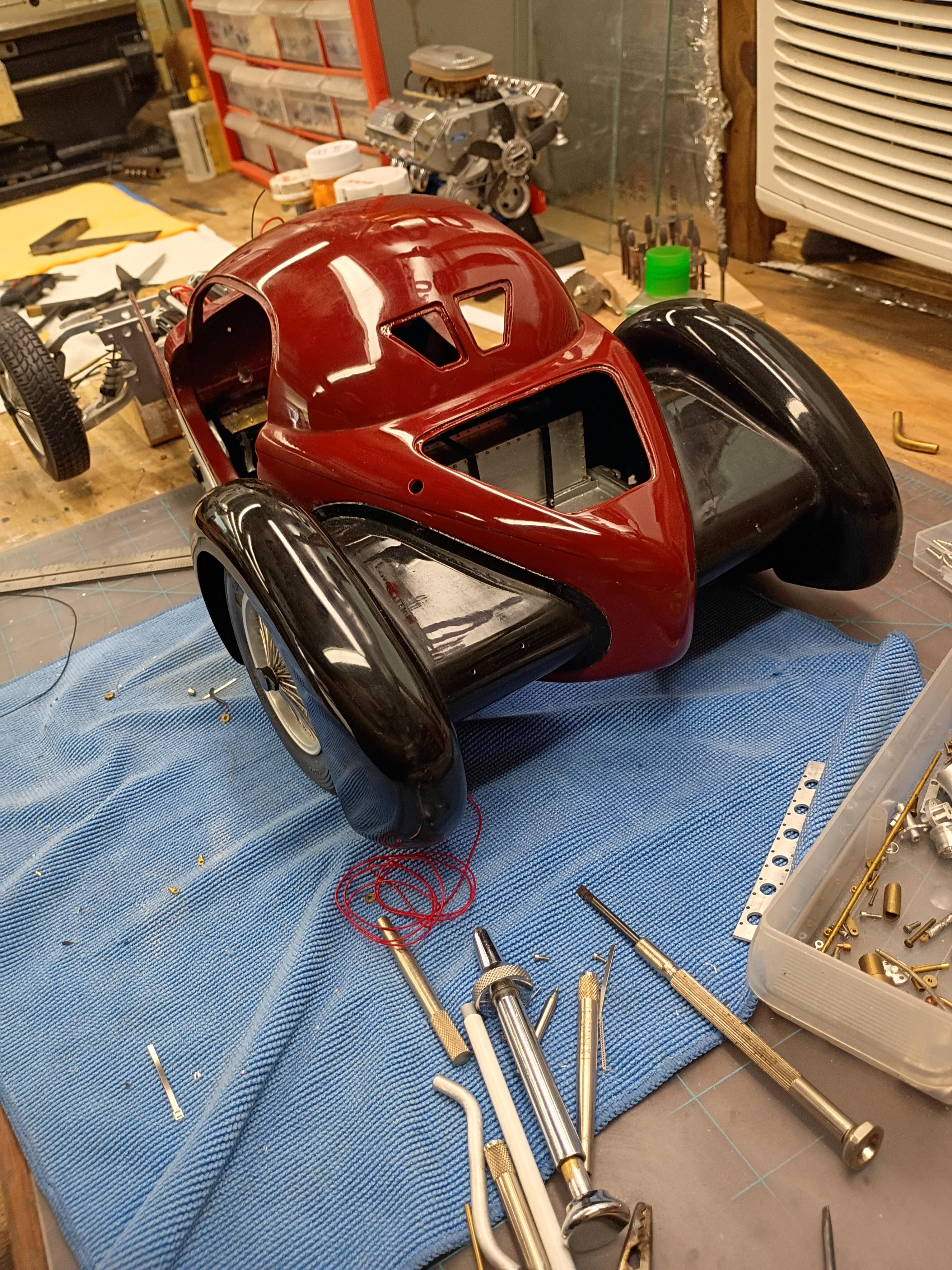

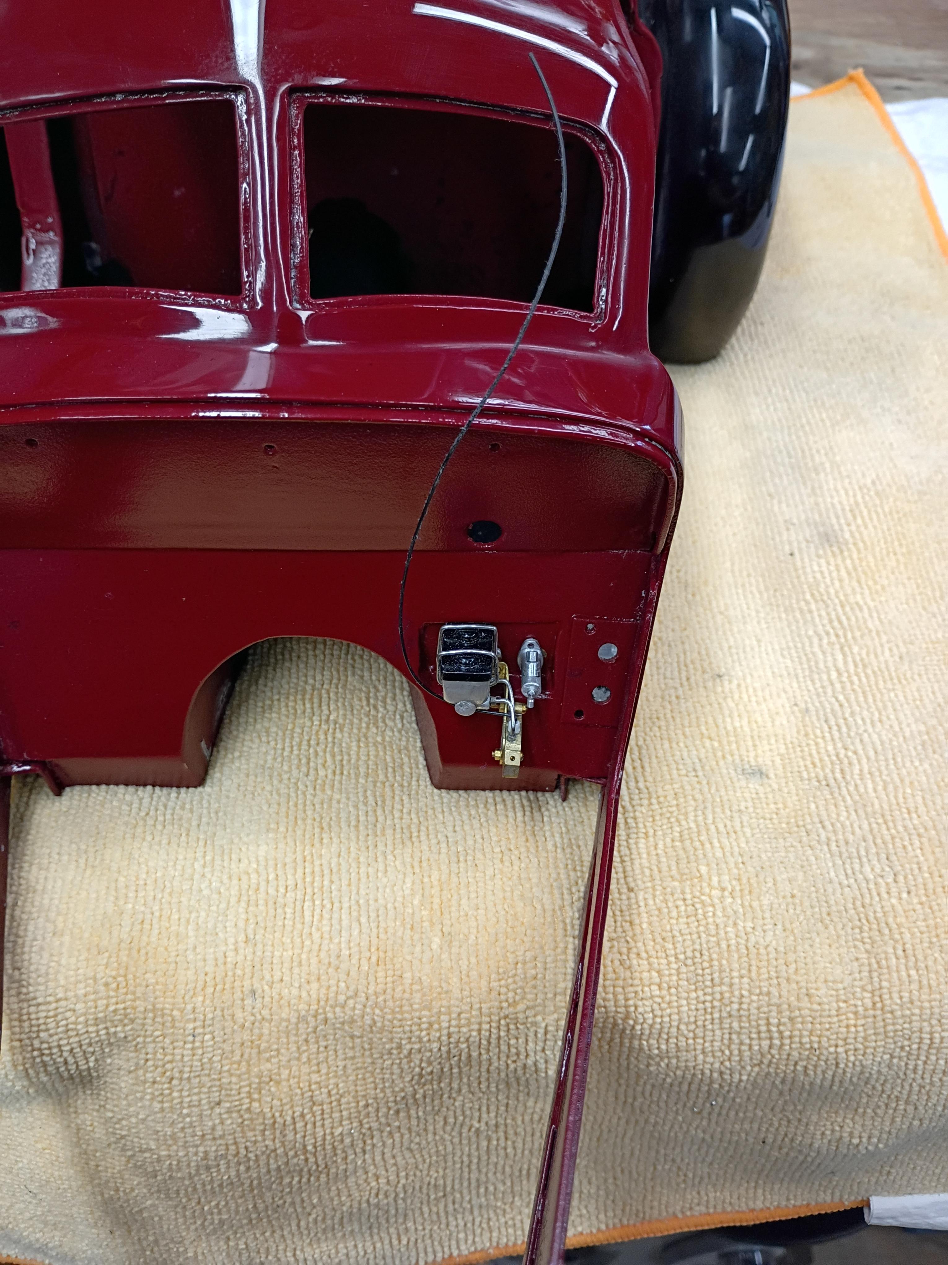

charlie libby Posted Friday at 10:57 PM Author Posted Friday at 10:57 PM assembly is slow.i re did a few parts,that took time. installing the front fenders and nose was frustrating and very time consuming .you cant really get at the screws with a screwdriver very well because of the angle that the fender runs down to the tiny screw head. you cant get the nuts on inside . it took 4 days and alot of swearing. but i got it.some details left,tail lights and fog lamps ,they are all made ,just need to install. front and rear glass as well. it is looking pretty good . a few places need more polishing. happy with it so far. hope to get it to a show somewhere this year. the drill is a collet and it is very well centered . i have used it many times and works well. i like roll up widows. all the wood is oak. 1
