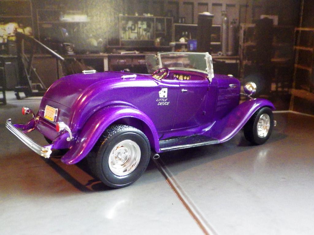

Dan Hay Posted November 23, 2023 Posted November 23, 2023 (edited) Funny, I’ve been thinking about this kit for a while now, and recently did some comparison with it and a Revell 32. I really like the old monogram grille and shell better, among a few other details. Also, the hoods are noticeably longer on the monogram vs Revell. I know the monogram is 1/24 but even with the scale difference it looks better on the monogram. Because of my love of deuces I probably built this kit more than any other, I even remember sawing off the fenders out in the garage on dads bandsaw to make a highboy. So now you got my brain going and will probably build one myself in the near future! The only problem when starting a deuce build is deciding how to build it. Can’t wait to see this one finished with your usual quality and attention to detail. Edited November 23, 2023 by Dan Hay 1
Dennis Lacy Posted November 23, 2023 Author Posted November 23, 2023 4 hours ago, Dan Hay said: Funny, I’ve been thinking about this kit for a while now, and recently did some comparison with it and a Revell 32. I really like the old monogram grille and shell better, among a few other details. Also, the hoods are noticeably longer on the monogram vs Revell. I know the monogram is 1/24 but even with the scale difference it looks better on the monogram. Because of my love of deuces I probably built this kit more than any other, I even remember sawing off the fenders out in the garage on dads bandsaw to make a highboy. So now you got my brain going and will probably build one myself in the near future! The only problem when starting a deuce build is deciding how to build it. Can’t wait to see this one finished with your usual quality and attention to detail. Like @Ace-Garageguy said, the proportions of the body in this kit look really right. I’ve always dug it. I did the same thing with one of mine back in the day, cutting all of the fenders off to make a hiboy. That model only survived a couple years but I can still picture it. I sprayed the body Testors Yellow with Light Green (like Apple Green) frame, suspension and engine, which was the Flathead from the ‘40 Pickup. Wheels were the chrome steelies from The Beach Boys 3-Window. I also remember it had a Full House cards decals on the cowl. That would have been around 1993 and I would have been 13. I’m actually tempted to do another but probably in a more tasteful color combo! ? 2
Dan Hay Posted November 23, 2023 Posted November 23, 2023 (edited) 55 minutes ago, Dennis Lacy said: Like @Ace-Garageguy said, the proportions of the body in this kit look really right. I’ve always dug it. I did the same thing with one of mine back in the day, cutting all of the fenders off to make a hiboy. That model only survived a couple years but I can still picture it. I sprayed the body Testors Yellow with Light Green (like Apple Green) frame, suspension and engine, which was the Flathead from the ‘40 Pickup. Wheels were the chrome steelies from The Beach Boys 3-Window. I also remember it had a Full House cards decals on the cowl. That would have been around 1993 and I would have been 13. I’m actually tempted to do another but probably in a more tasteful color combo! ? I built my hiboy blue and white to clone a real 32 roadster my dad had at the time. The two tone was weird, it was blue above the belt line and wrapped around the body behind the top. It was kinda ugly car in my mind today but back then I loved that thing and couldn’t wait to ride in it every chance I got. Funny I think he had that around 93 as well! Edited November 23, 2023 by Dan Hay 1

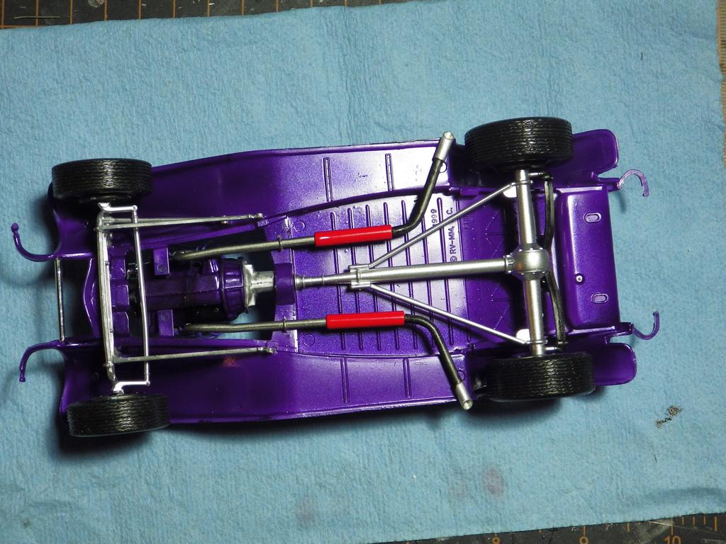

bluestringer Posted November 24, 2023 Posted November 24, 2023 That is looking great. I built this kit a few months ago, but didn't go into many mods like you are. I do wish I had lowered it. I did notice the small tail pipes and fabricated some pipes running out in front of the rear wheels that look a little better. My grandson was here today and saw the built model and wanted it, so it's sitting on his shelf now. I plan to pick up another one, and for next time you have gave me some good tips on lowering it and installing a different engine. Looking forward to seeing your finished work. 4
Dennis Lacy Posted November 24, 2023 Author Posted November 24, 2023 16 hours ago, bluestringer said: That is looking great. I built this kit a few months ago, but didn't go into many mods like you are. I do wish I had lowered it. I did notice the small tail pipes and fabricated some pipes running out in front of the rear wheels that look a little better. My grandson was here today and saw the built model and wanted it, so it's sitting on his shelf now. I plan to pick up another one, and for next time you have gave me some good tips on lowering it and installing a different engine. Looking forward to seeing your finished work. That’s a nice solution you came up with. The consistent “pipe” size and fully enclosed mufflers look so much better. The thing about lowering this kit is that it also requires modifying (or changing) the wheels to tuck them in because the way the kit builds it puts the tires poked and under the fender edges. The front axle I changed to is a good bit narrower. 1

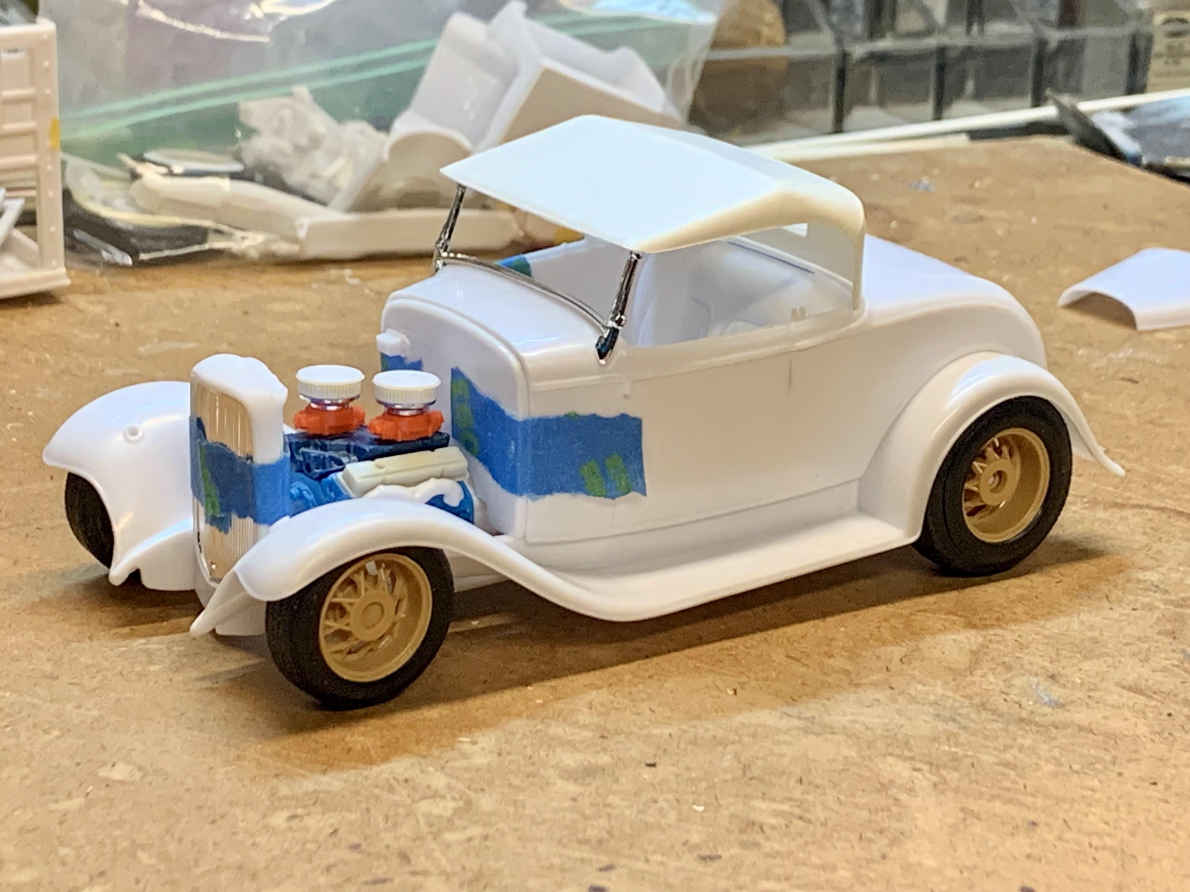

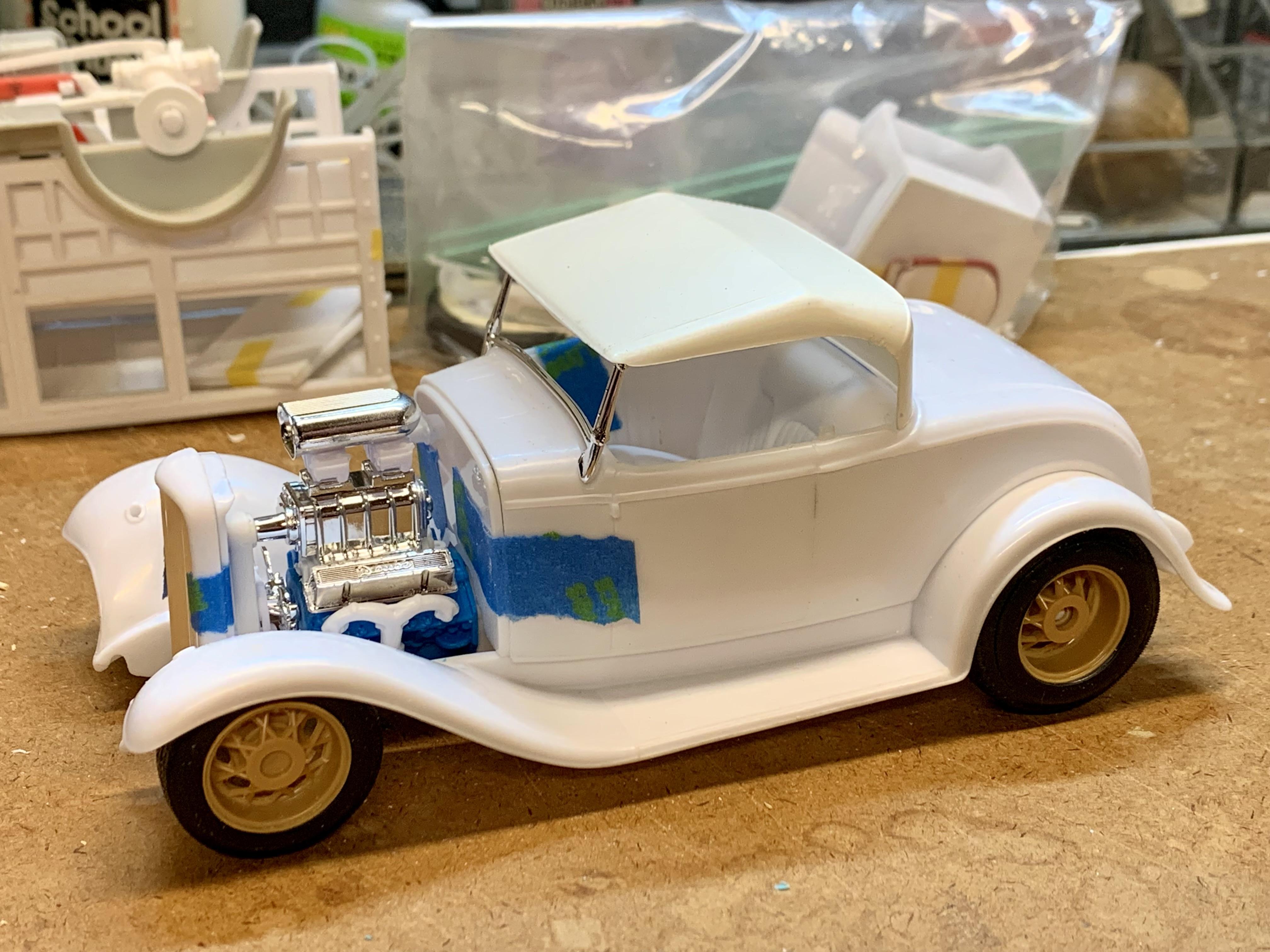

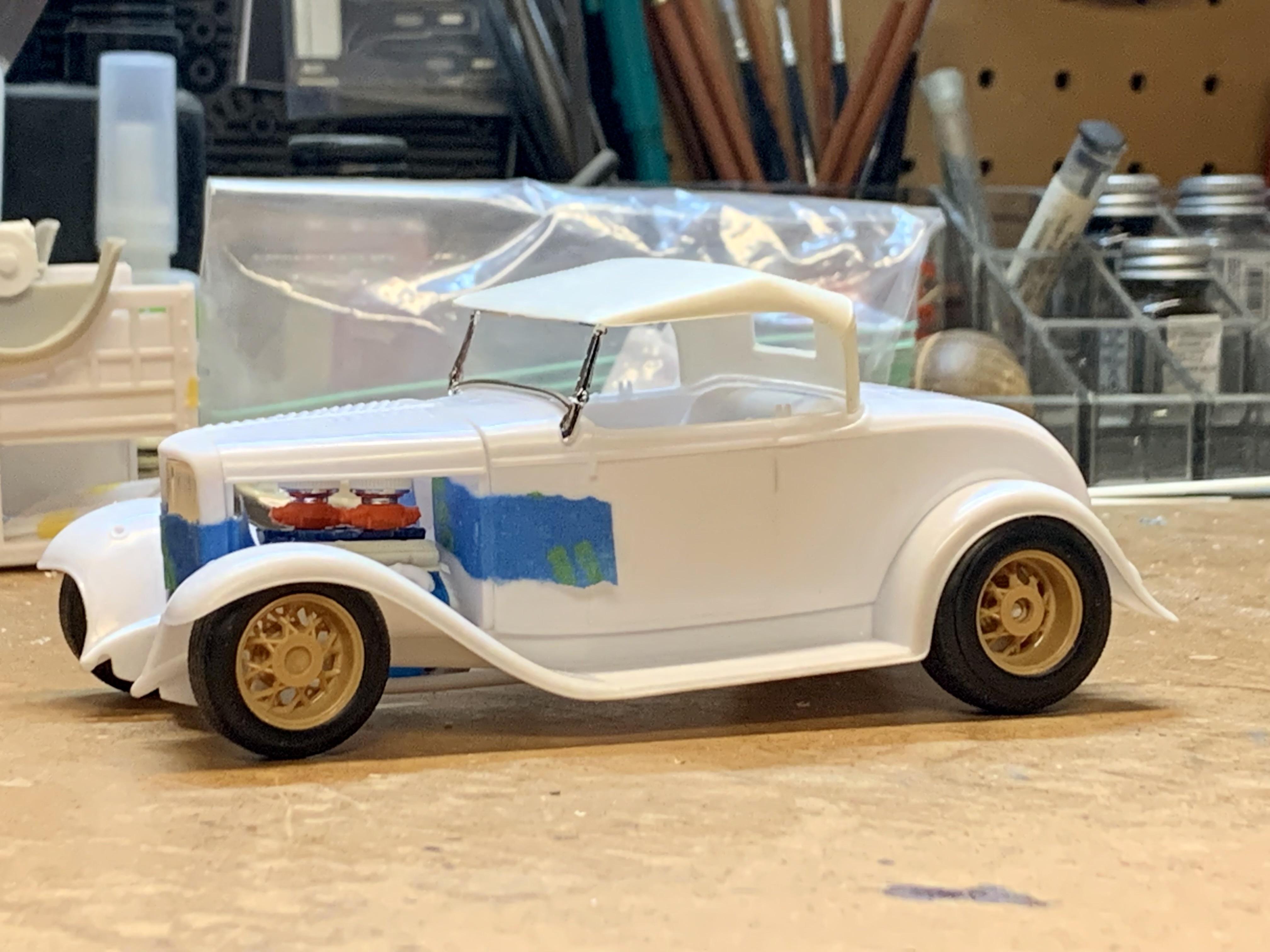

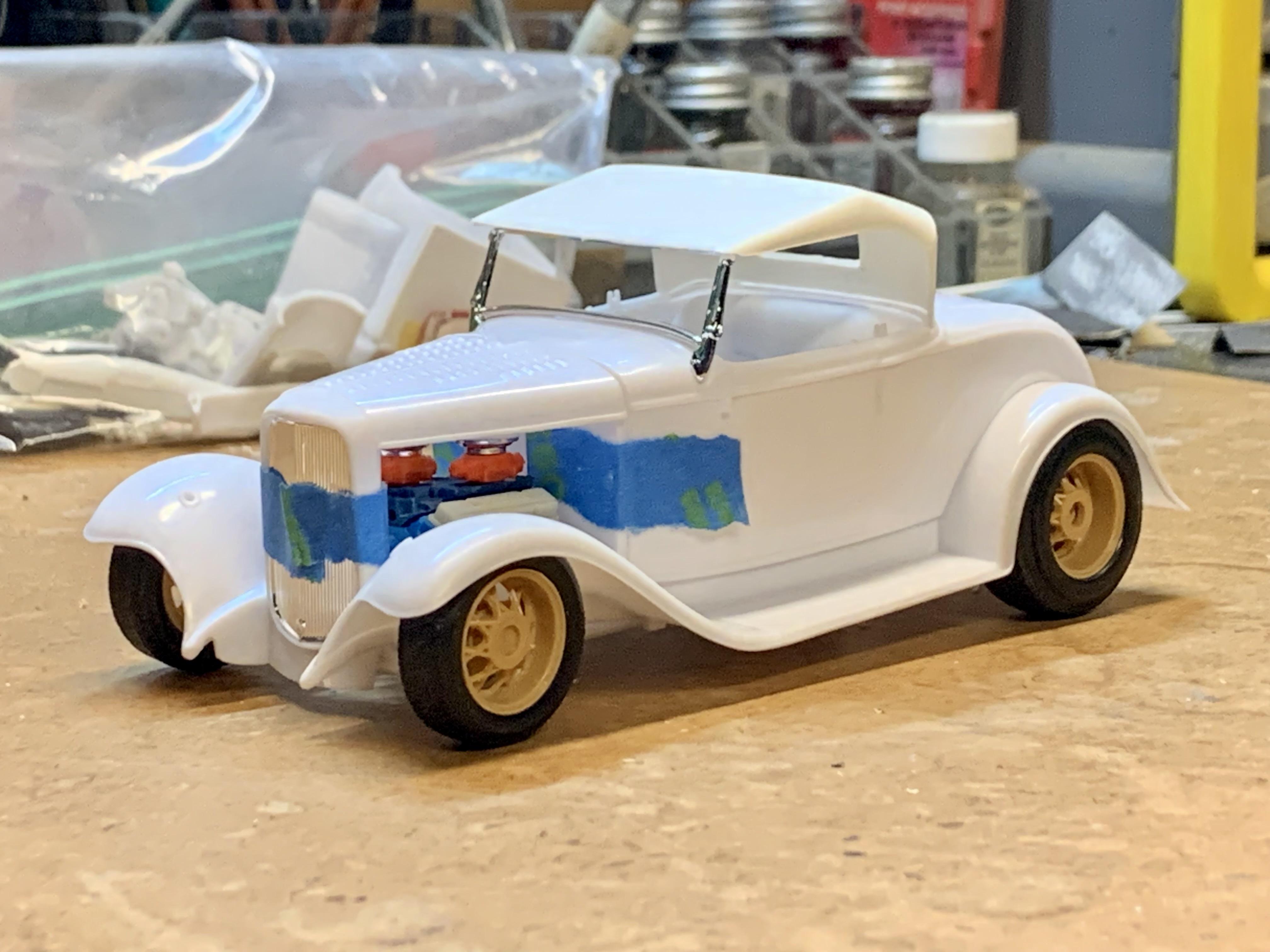

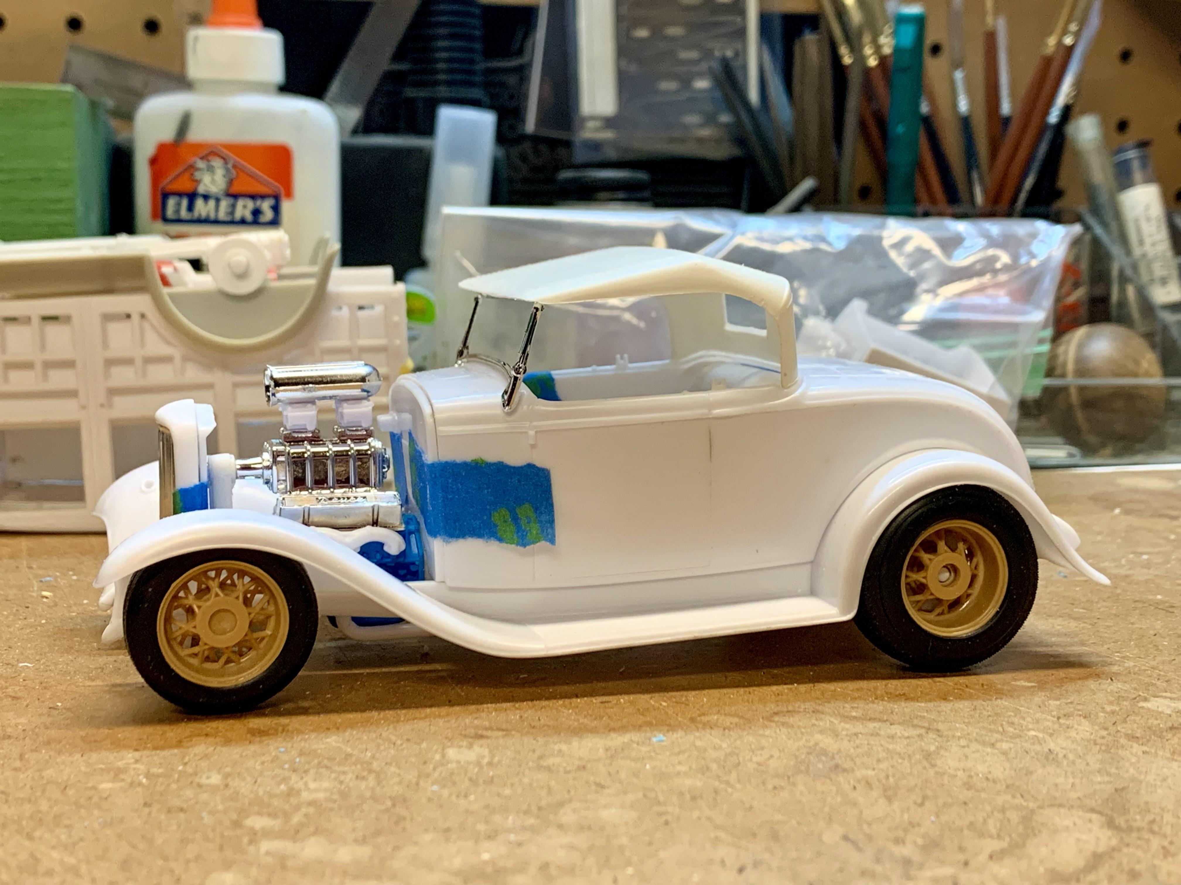

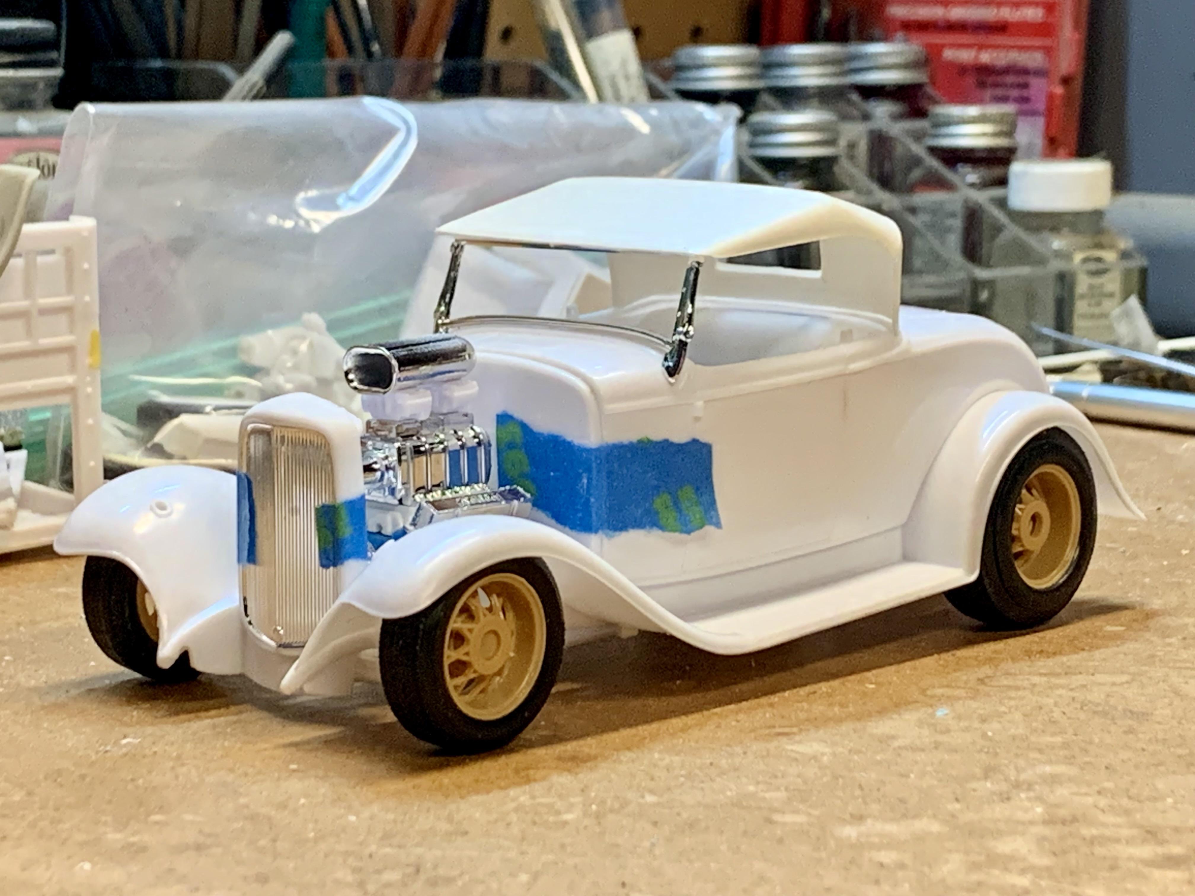

Dennis Lacy Posted November 25, 2023 Author Posted November 25, 2023 Last night I did a mock up with a different set of wheels, the Kelsey Hayes style wires from the Monogram ‘30 Woody. When I was first starting this project they were the first wheels I tried but I was not going to be able to modify them enough to tuck the under the front fenders using the kit dropped axle. Last night it occurred to me that I should try again since I changed the front axle and it’s quite a bit narrower. I haven’t started adapting the wheels yet so now I have to decide which way to go. I definitely like the wires and they will look much better with the chrome hubcaps. Thoughts? 4
Bullybeef Posted November 26, 2023 Posted November 26, 2023 The slots give it a 70’s vibe whereas the Kelsey Hayes are ageless and fit in any era. Both suit the car it will depend on where it sits in your build era. 2

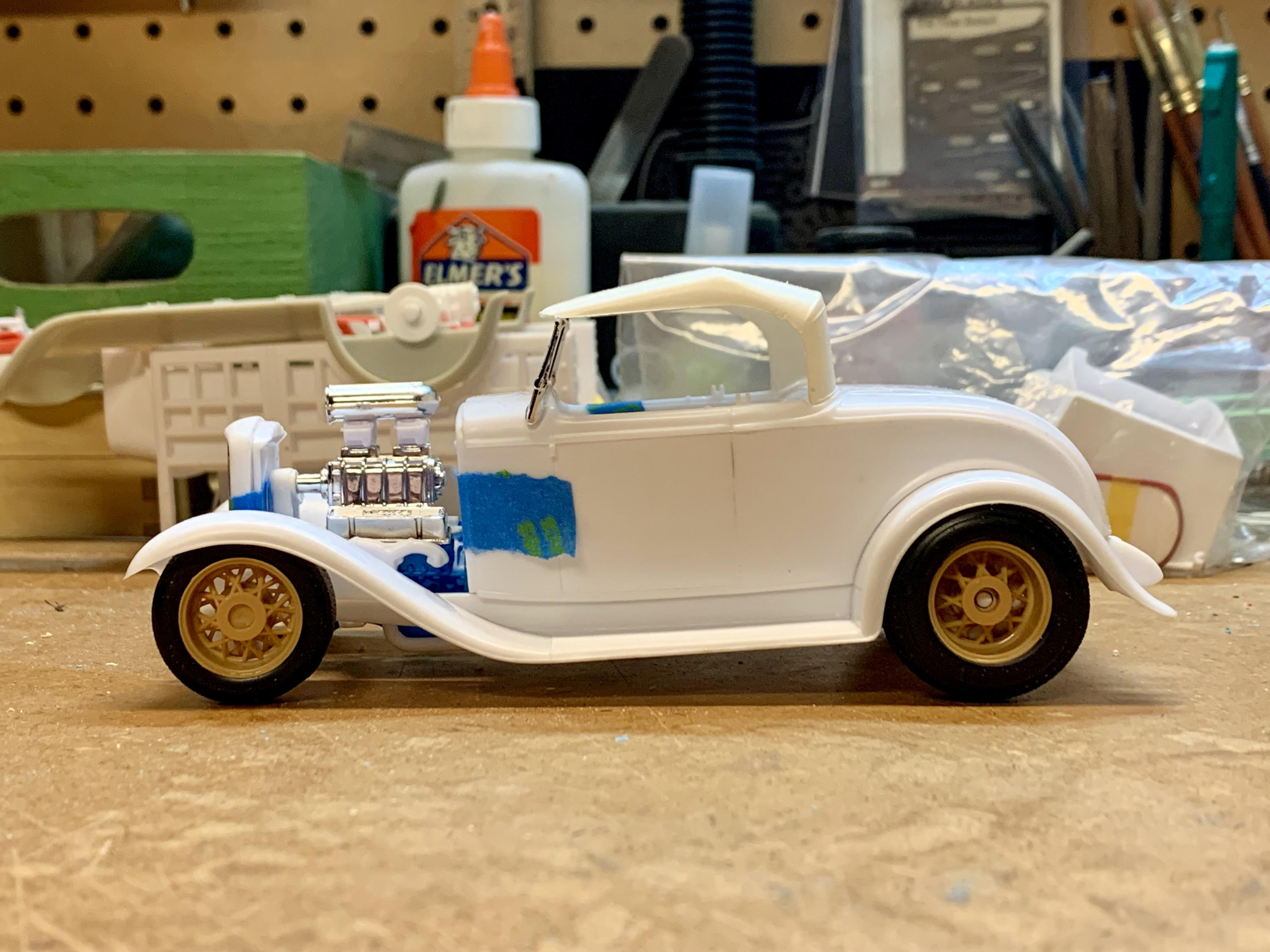

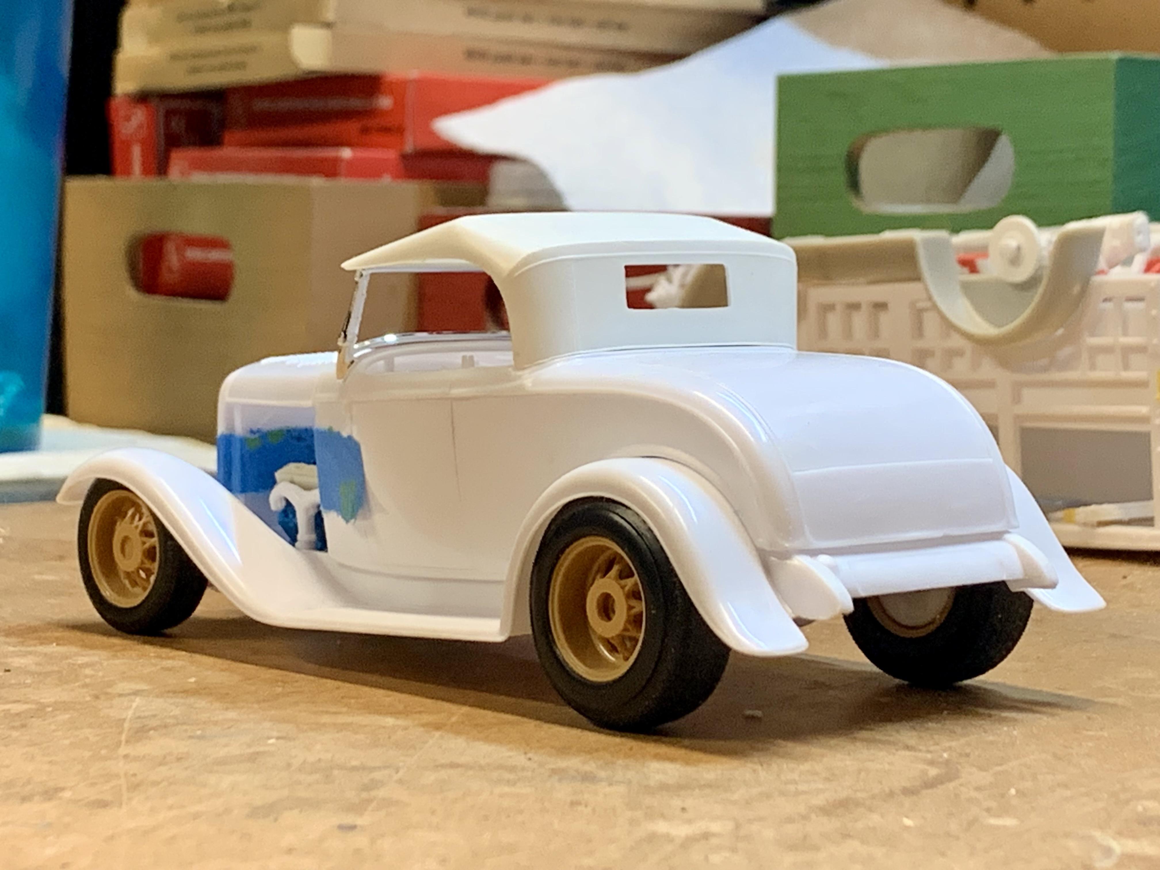

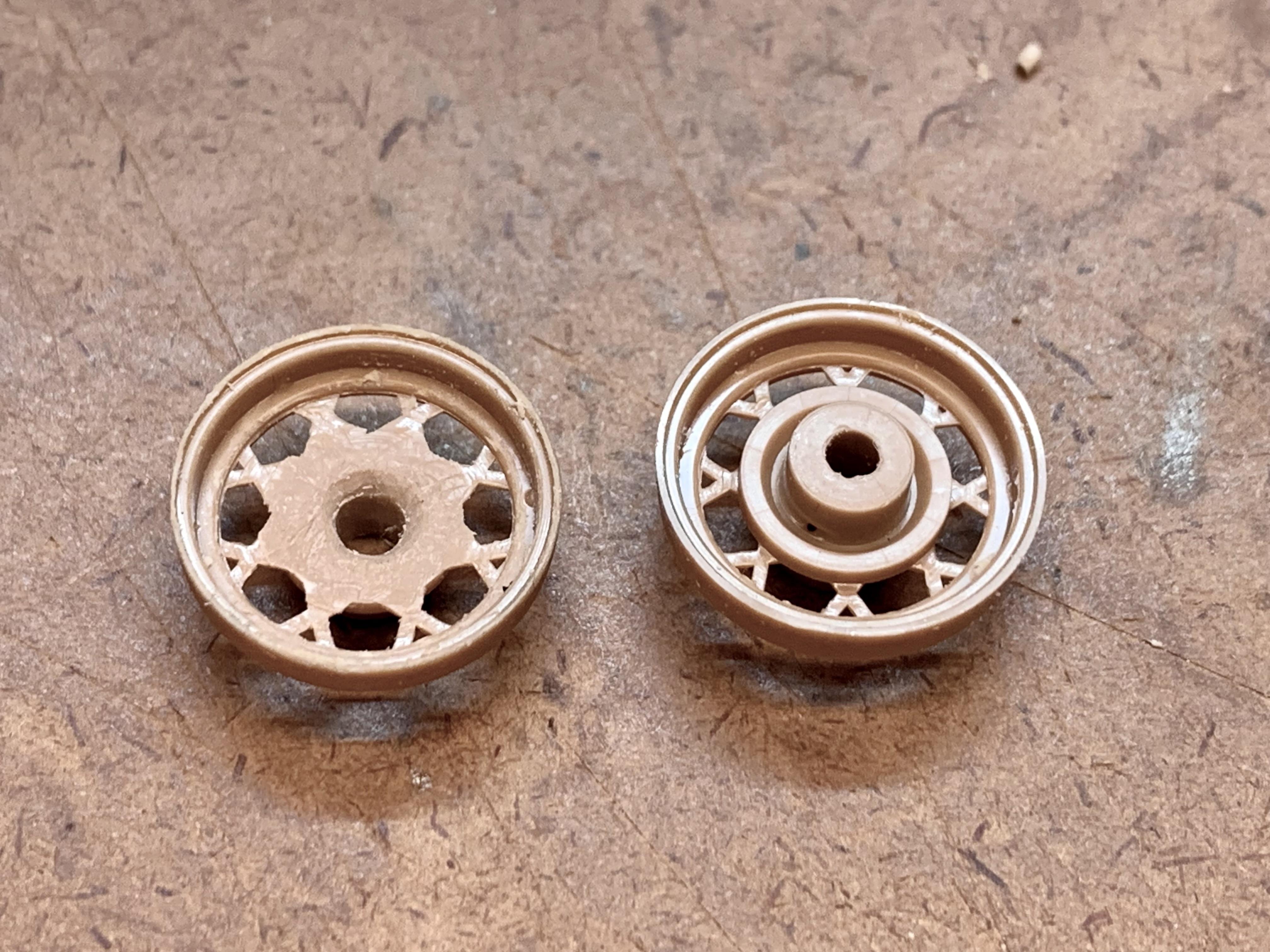

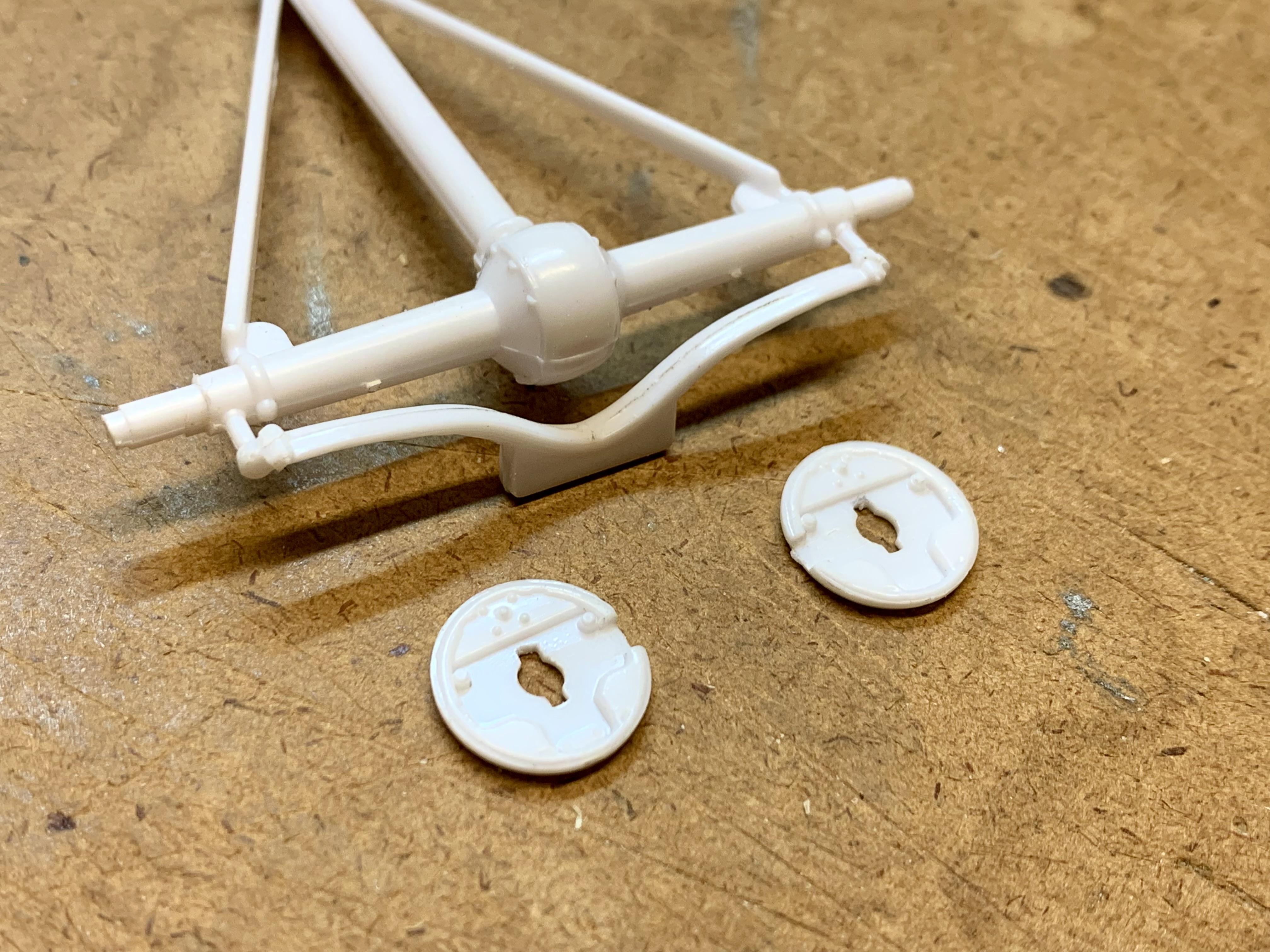

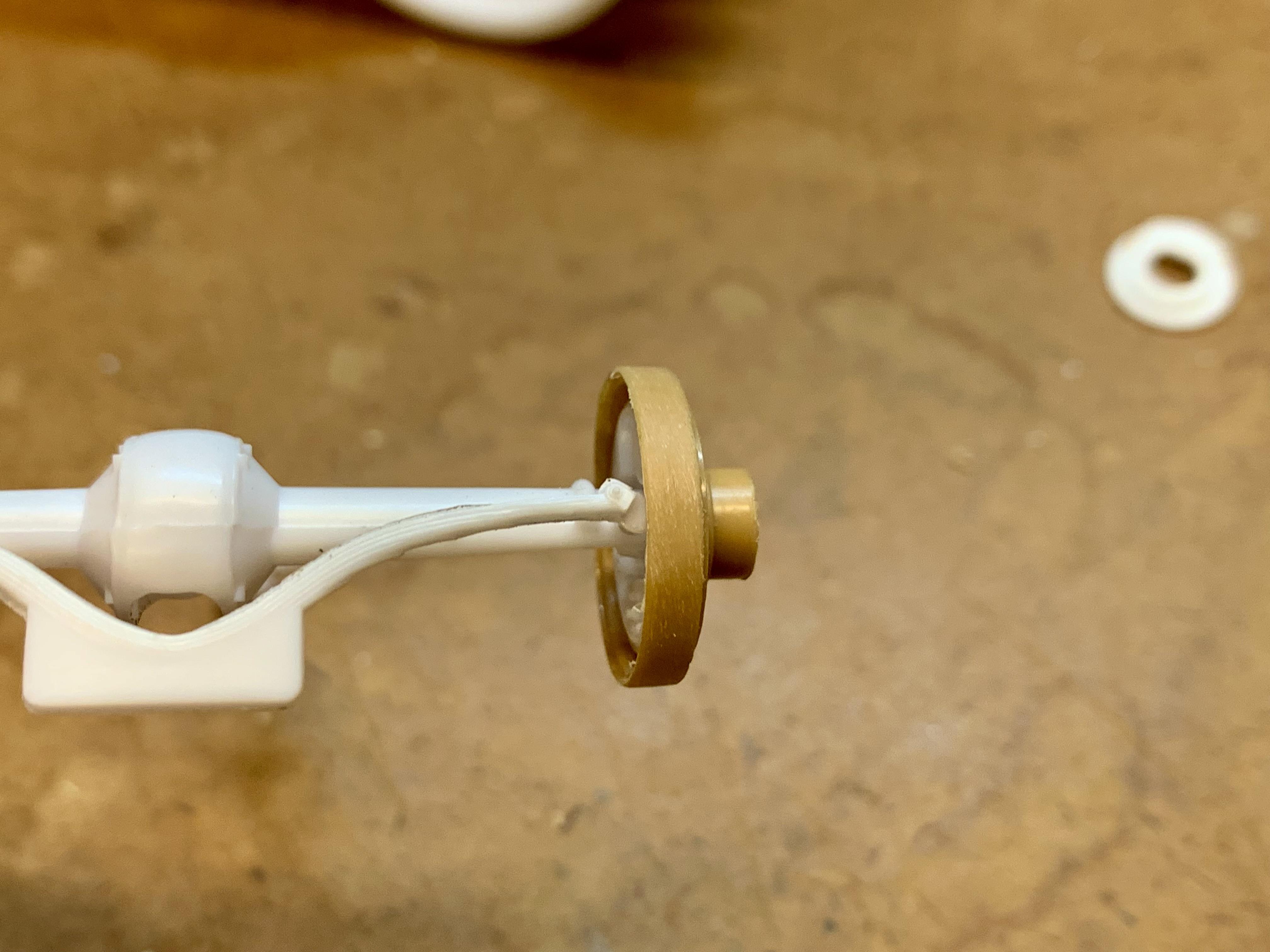

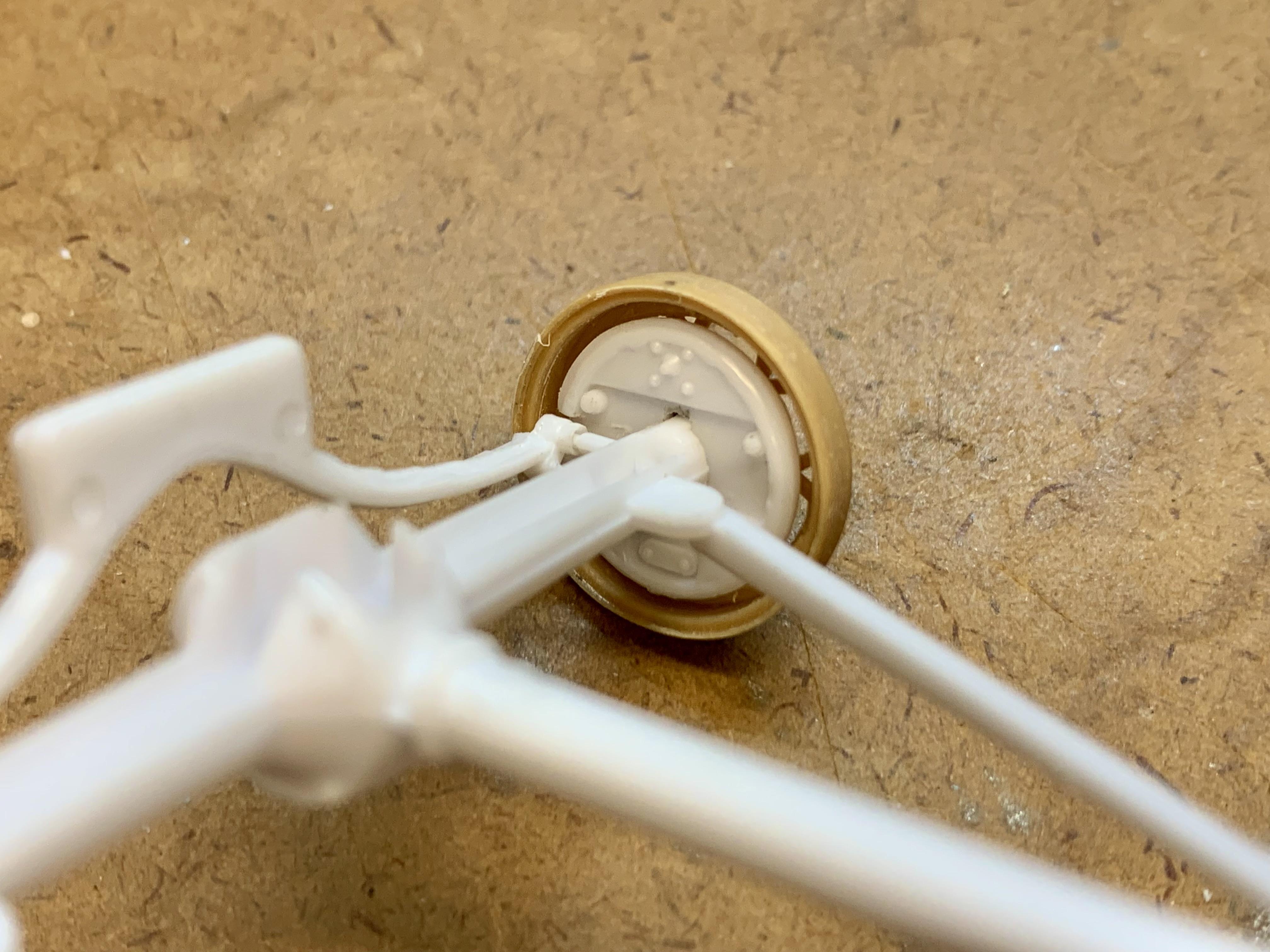

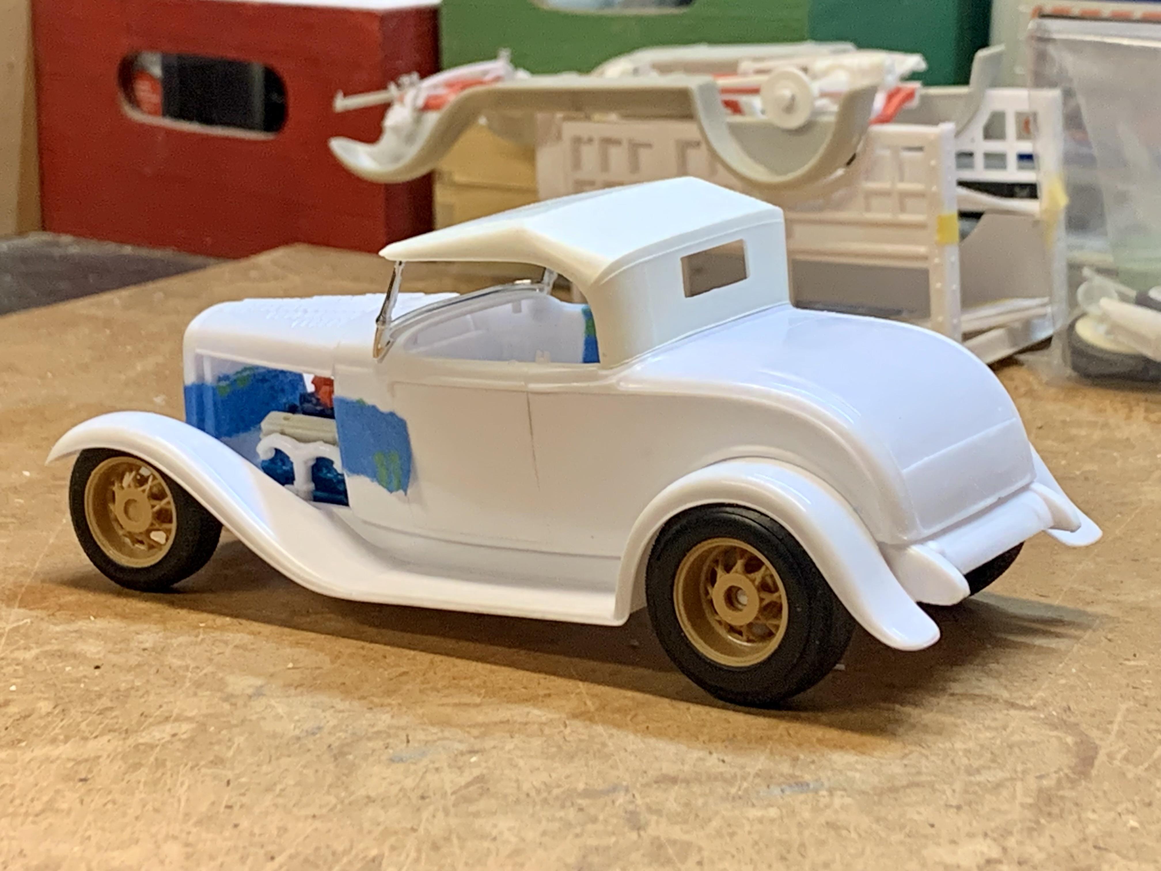

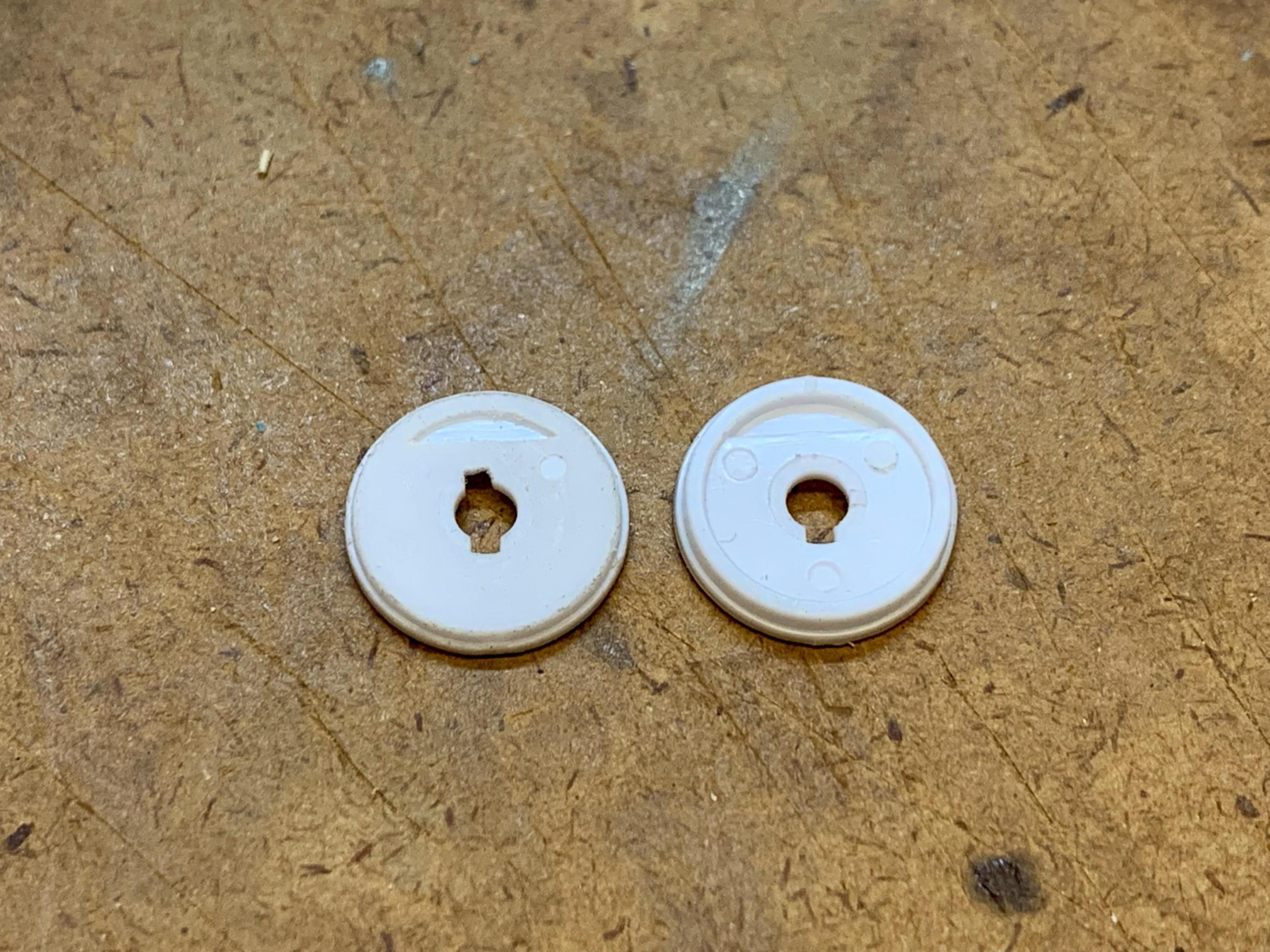

Dennis Lacy Posted November 26, 2023 Author Posted November 26, 2023 And, the winner is… The Kelsey Hayes wires! I was able to spend some time at the workbench this afternoon and decided to get the wheels adapted to the axles. The fronts were very easy only needing to slightly enlarge the holes in the wheels to fit over the axle stubs and sand the center area down, even with the edge of the rim. The rears, on the other hand, took a fair bit of work mixed with trial and error. The inner wheel halves ended requiring the whole raised center area be removed. The rear brake plates were replaced with front plates from the same kit because they are roughly half the thickness and don’t have a raised center area on the front which allowed them to suck in closer to the axle. Even then I needed all of the room I could get so I sanded the slight ridge down on the back sides of the plates. Because the plates are thinner it was necessary to notch them to clear the end of the spring. All of this to allow the rear wheels to suck in as much as possible to get the tires under the fenders. I mocked the Roadster back together and upon looking at it I just wasn’t feeling the engine dress. While a single 4-barrel is perfect for drive ability it’s kind of boring on a scale street rod. Digging through my small block Chevy parts I came across the dual 4-barrel cross-ram intake from Revell’s 1969 Camaro Z28, the only remaining piece I have since having the original issue back in the early 90’s. The carbs come from a couple of Monogram 1937 Ford Sedan original issues with air filters from a Revell ‘32 Roadster (Rat Roaster.) The Edelbrock valve covers come from AMT’s ‘34 Ford 5-Window Coupe. I’m liking this a lot better and it’s much more interesting to look at. And here’s the Roadster sitting properly on its axles with the updated engine dress. Very happy with the stance and wheel fit. 8

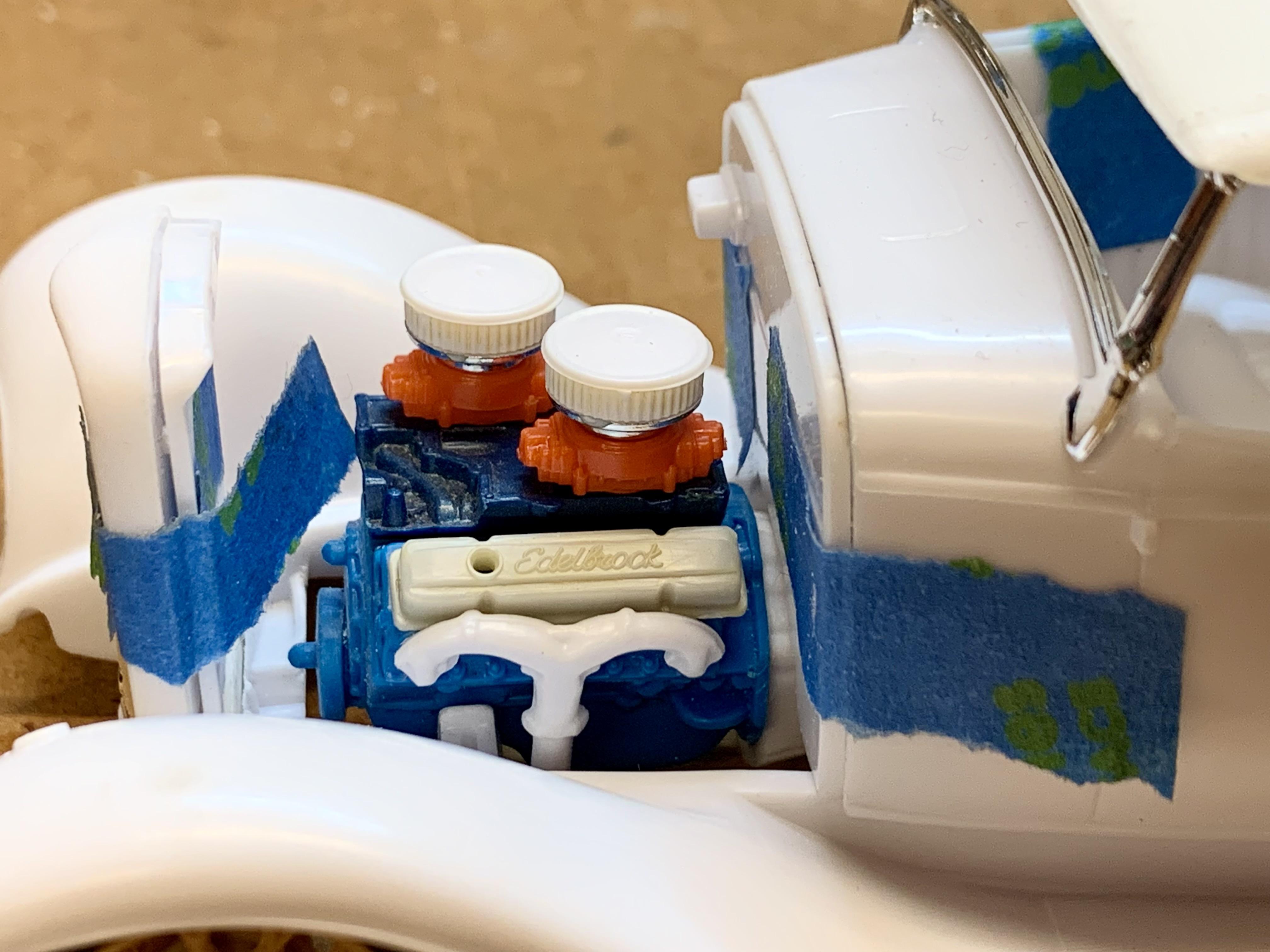

Bullybeef Posted November 26, 2023 Posted November 26, 2023 Engine arrangement looks mucho bueno now! I think a smoothie hood would suit the look a little better than the louvered. My .02 Canadian 2

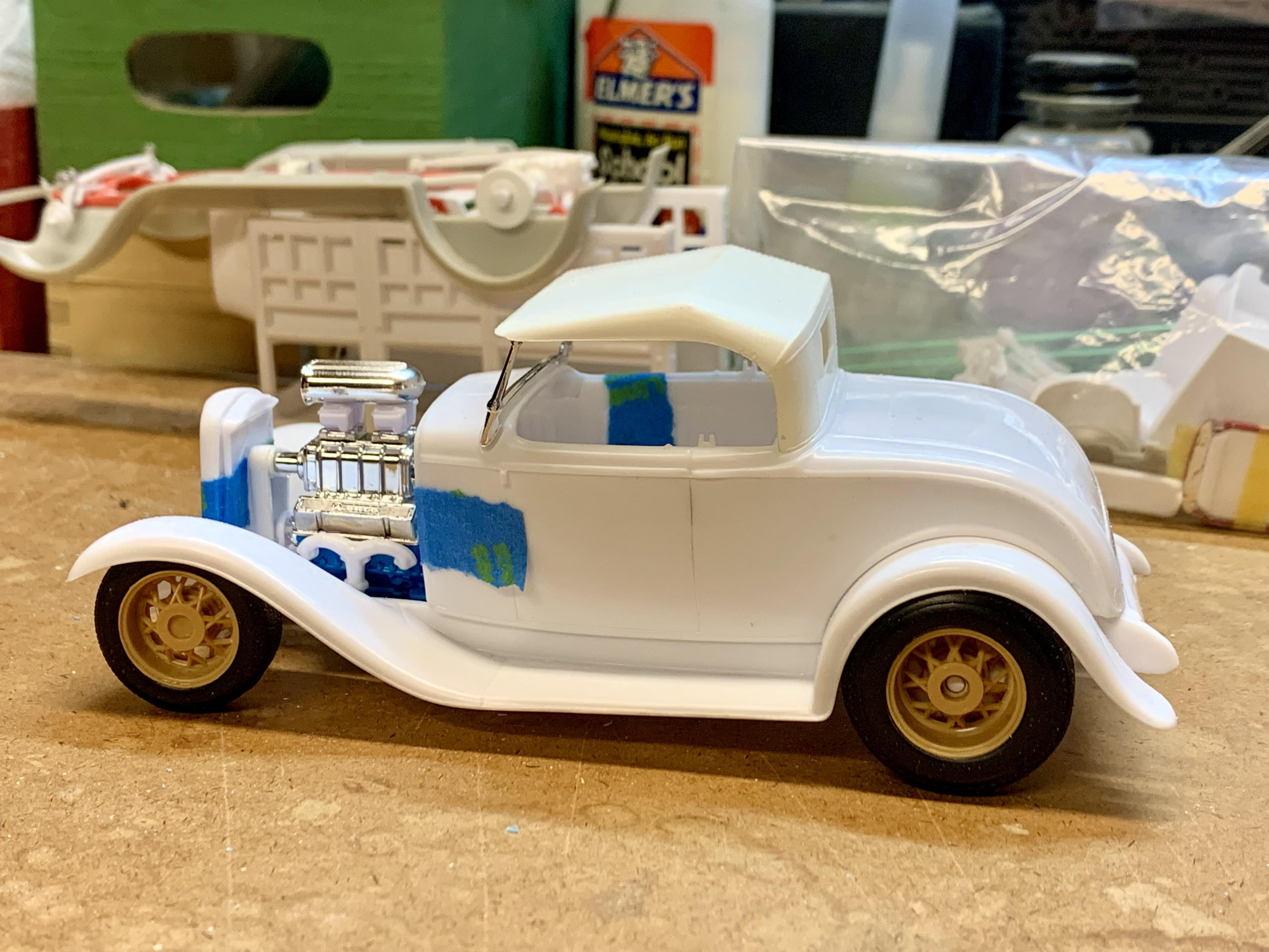

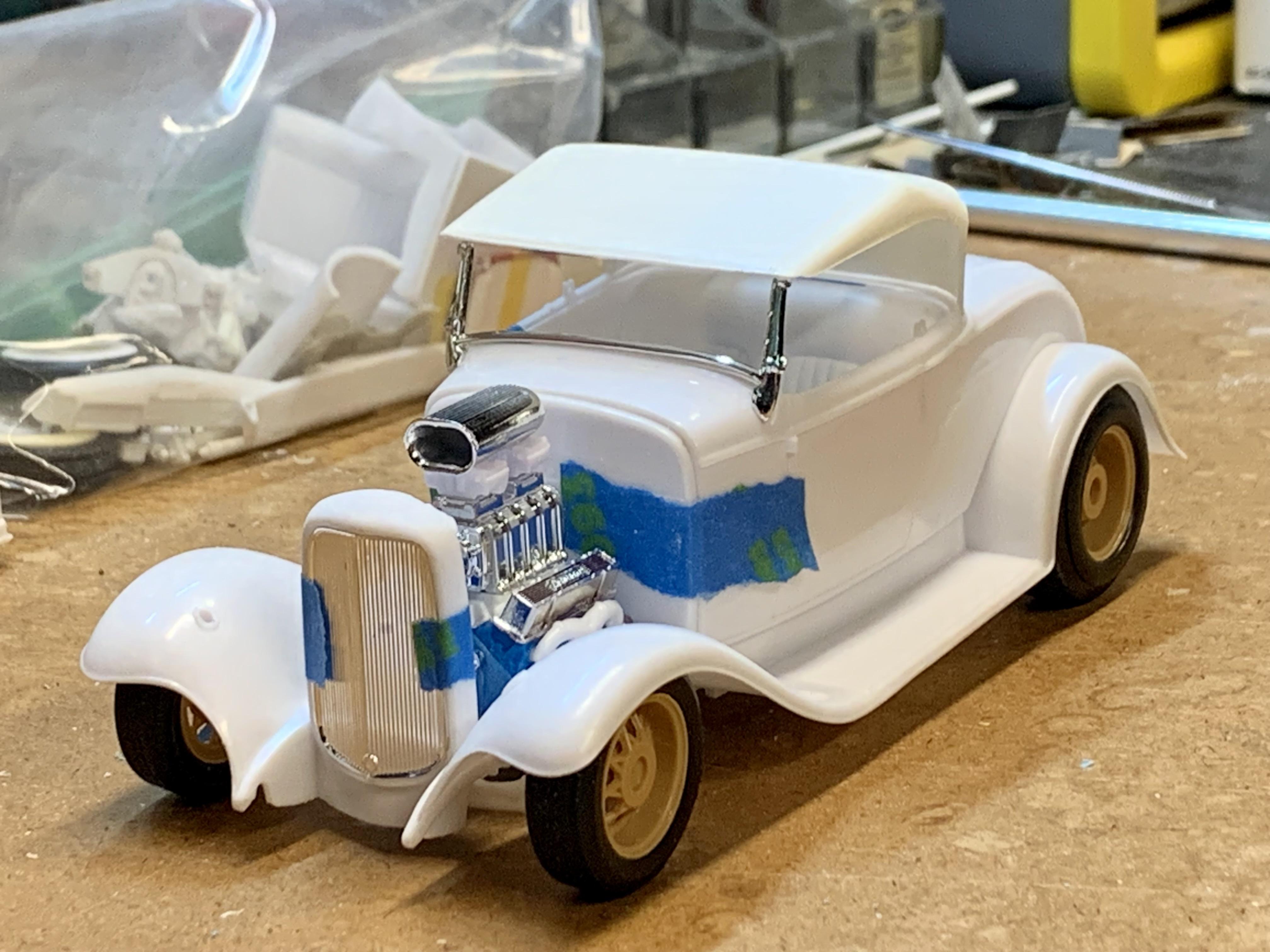

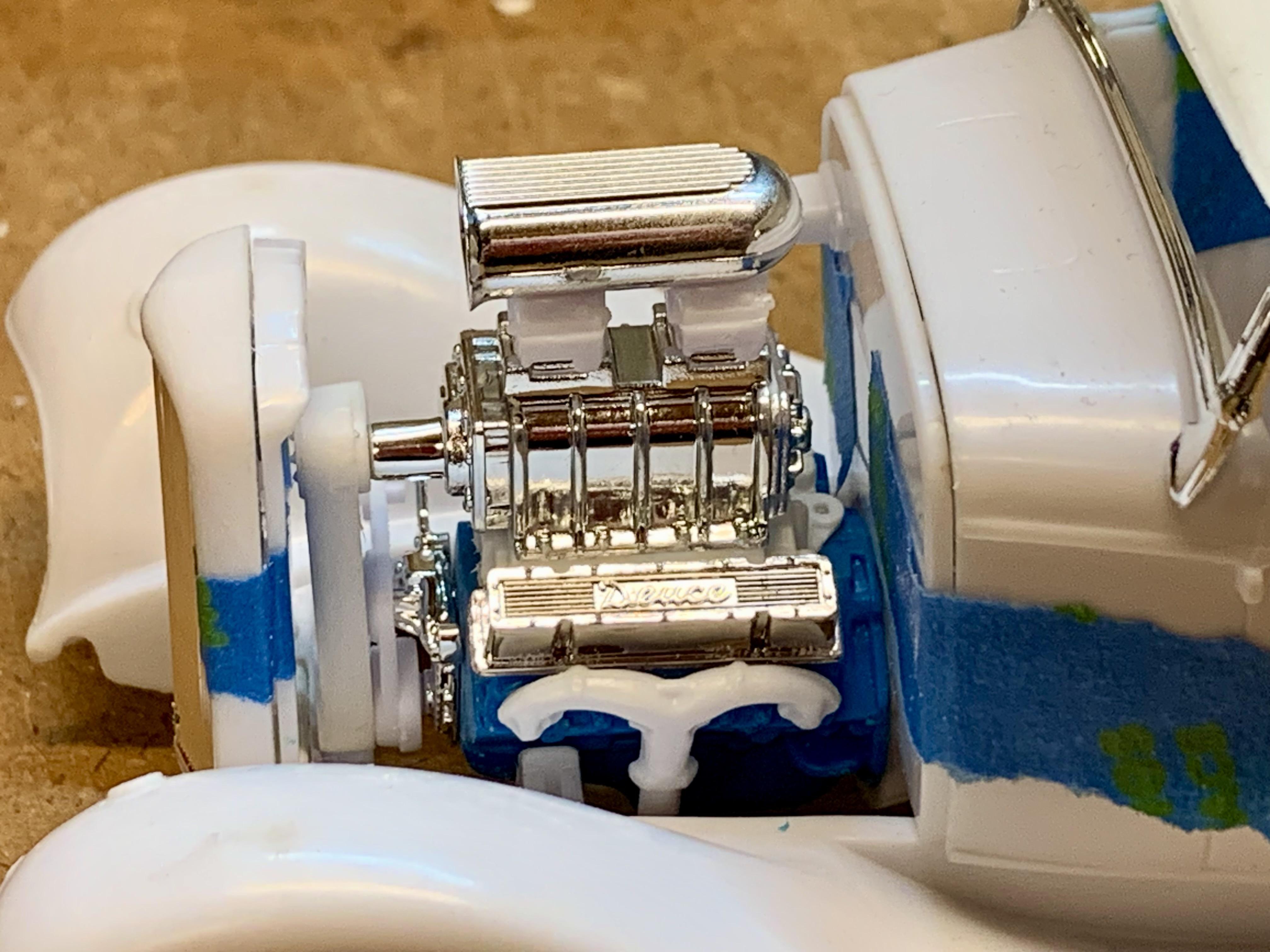

Dennis Lacy Posted November 27, 2023 Author Posted November 27, 2023 Found a little more bench time yesterday afternoon. I had left the Roadster mocked up and after sitting down I got to looking at it. I realized I wasn't totally feeling the engine setup. Part of it was that the 1:24 engine bay still looked a bit empty and after some trial and error I found a way to fill it up! I carved 1/16” off the back of the trans to move the engine back the same amount. I also carved the molded in timing cover / crank balancer off. To the engine I added the complete supercharger assembly, timing cover and belt drives from Revell’s ‘29 Roadster. I’m also back to the “Deuce” valve covers. Totally ridiculous with the fragile early driveline but it looks cool. So that’s it, final answer! 5
Bullybeef Posted November 27, 2023 Posted November 27, 2023 Guess that solves the Hood dilemma haha 1 2
Dennis Lacy Posted November 27, 2023 Author Posted November 27, 2023 11 minutes ago, Bullybeef said: Guess that solves the Hood dilemma haha It sure does! I’m going to run the top but it will be getting smoothed out with a hole in the middle.
