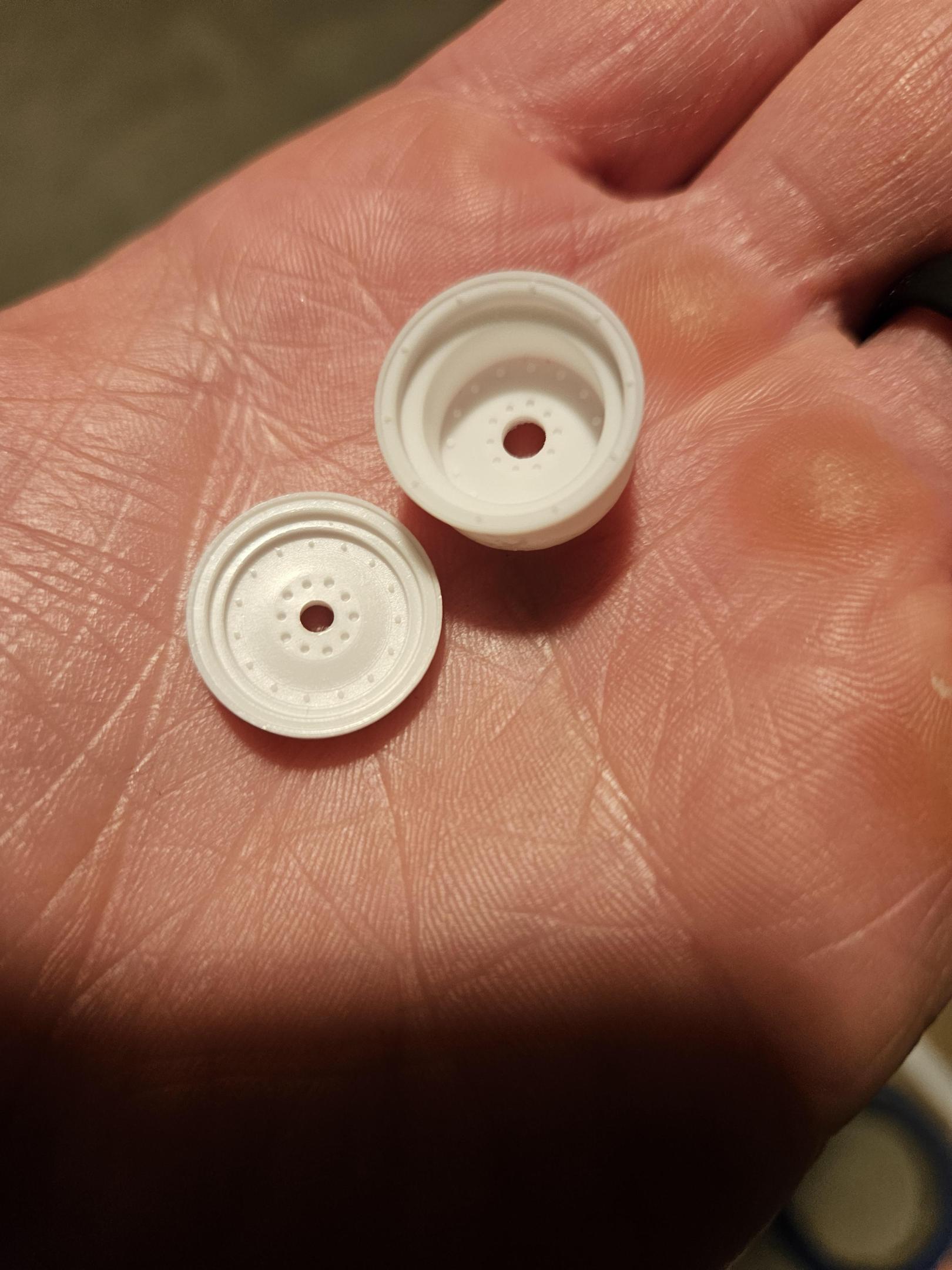

keviiin86 Posted February 26, 2024 Posted February 26, 2024 (edited) Very cool, love these era drag cars, everything so far looks awesome. Maybe I missed it but where did those decals come from? Some day I'd like to do a few lesser known drag cars from some local guys but I have no idea who would make decals for it since it would most likely have to be a one off decal sheet. Only thing I've noticed that could make it more realistic is those front wheels which I assume are from one of the old MPC super stock vega race cars just don't resemble the real deal cragar super tricks or centerline auto drags, they're just too wide for front runners. I've come across a couple aftermarket resin companies that make a great super trick and centerline skinny front runner. I bought a set from futur attraction but competition resin also makes some that look the same, maybe the same tooling? not sure. Edited February 26, 2024 by keviiin86 1
Nitro330 Posted February 26, 2024 Author Posted February 26, 2024 20 hours ago, keviiin86 said: Very cool, love these era drag cars, everything so far looks awesome. Maybe I missed it but where did those decals come from? Some day I'd like to do a few lesser known drag cars from some local guys but I have no idea who would make decals for it since it would most likely have to be a one off decal sheet. Only thing I've noticed that could make it more realistic is those front wheels which I assume are from one of the old MPC super stock vega race cars just don't resemble the real deal cragar super tricks or centerline auto drags, they're just too wide for front runners. I've come across a couple aftermarket resin companies that make a great super trick and centerline skinny front runner. I bought a set from futur attraction but competition resin also makes some that look the same, maybe the same tooling? not sure. Hey, thanks Kevin. The decals came from The Glory Years Decals and Graphics (eBay). Yeah, those aftermarket super tricks are much nicer. I'll have to get some of those for future projects. I just pulled some out of the parts box. 1
