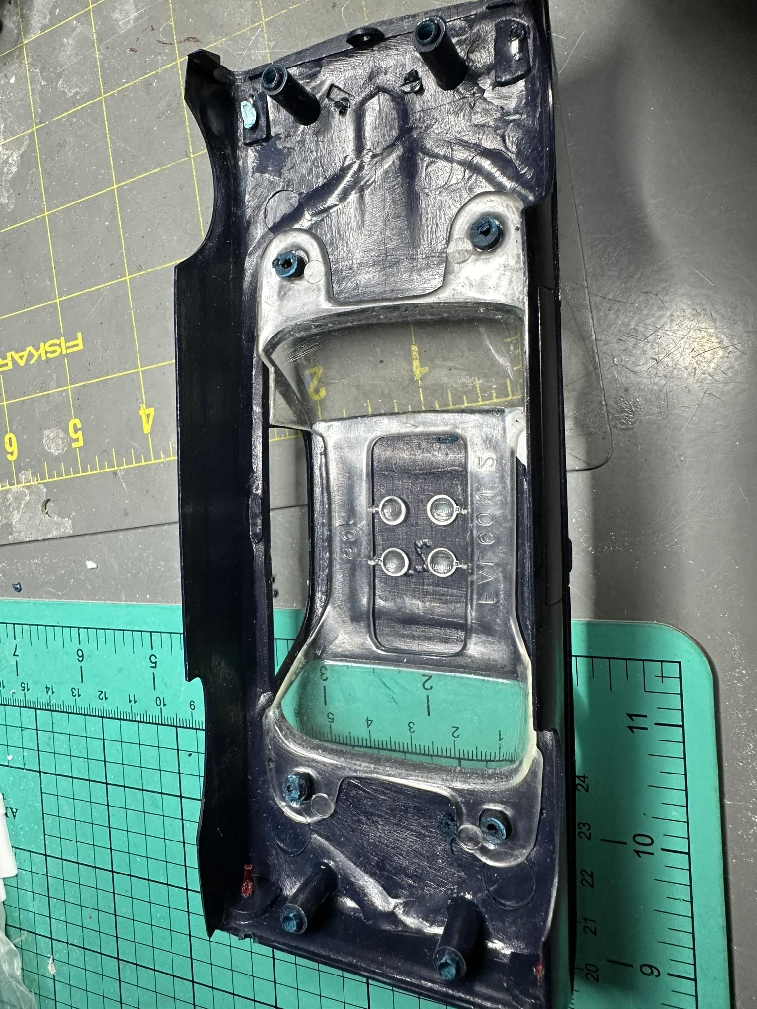

Here's an interesting aside - at least to me. I began disassembly of this car for repair. After removing the interior I was greeted by this. There are unused headlights still attached to the window frame. Score! :)
The headlamps were put there for the kits, which used clear lenses for the custom grille.  In the case of the Falcon, I'm not sure the '62 kit used them.  But the '60 and '61 did.
