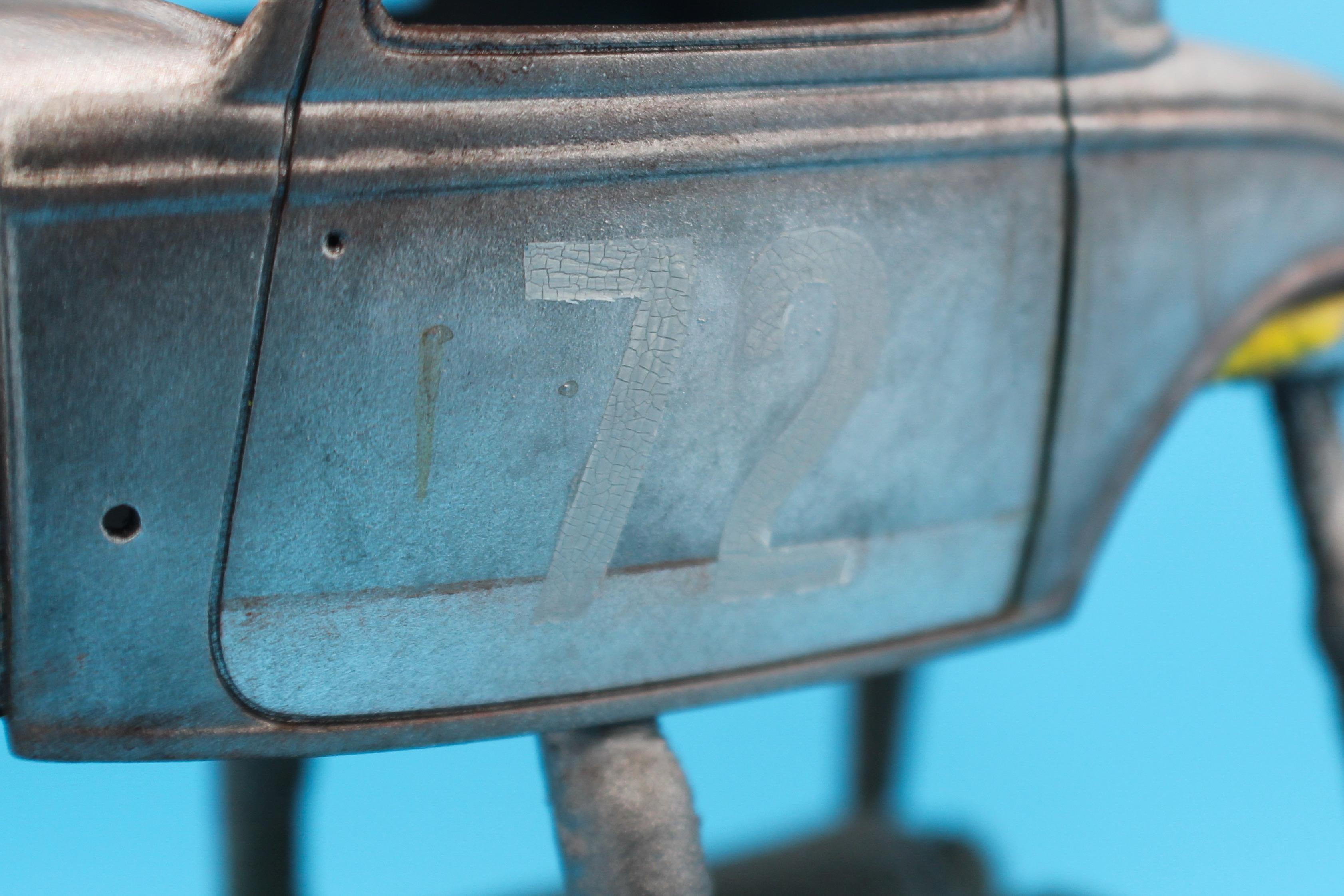

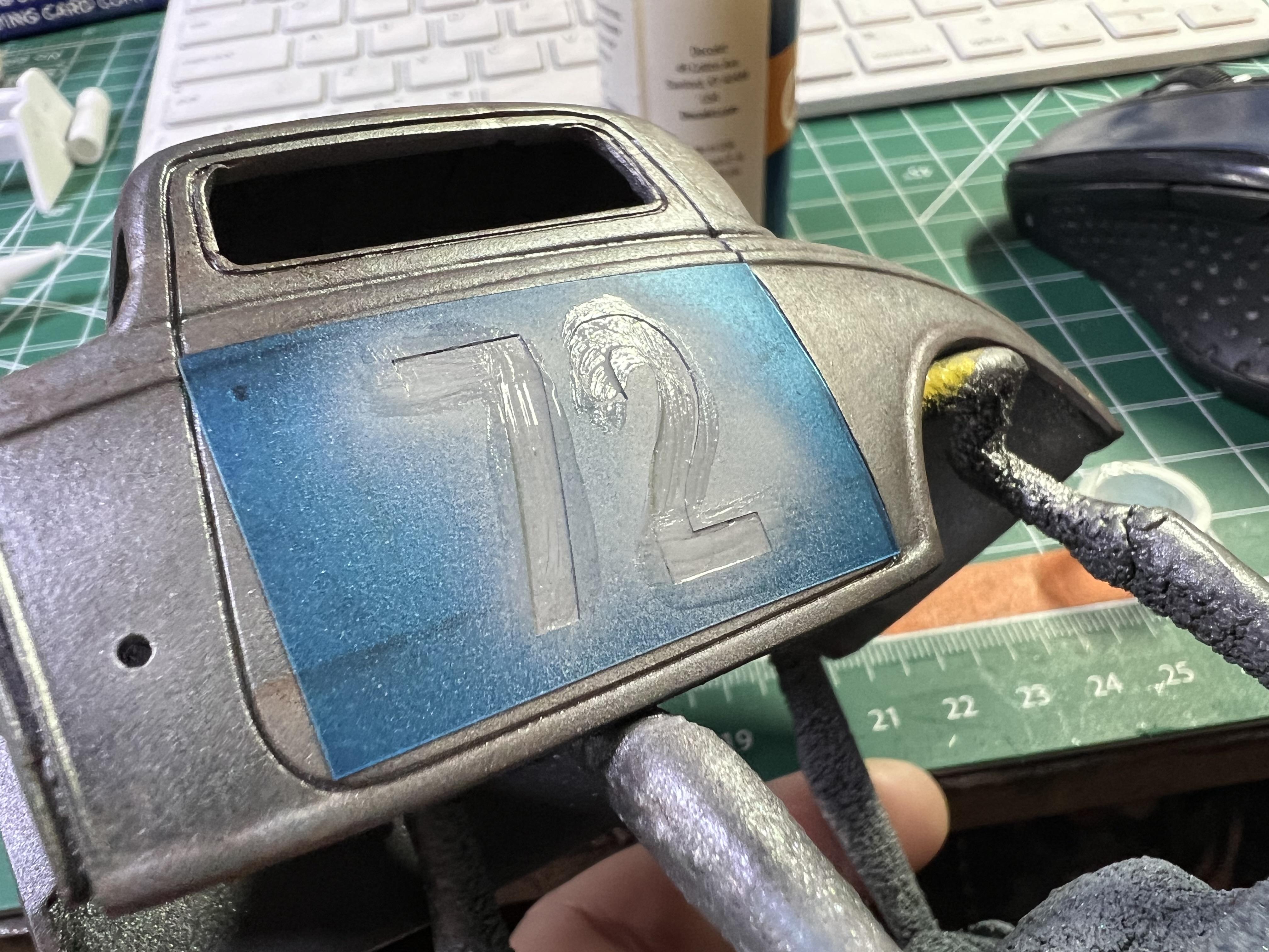

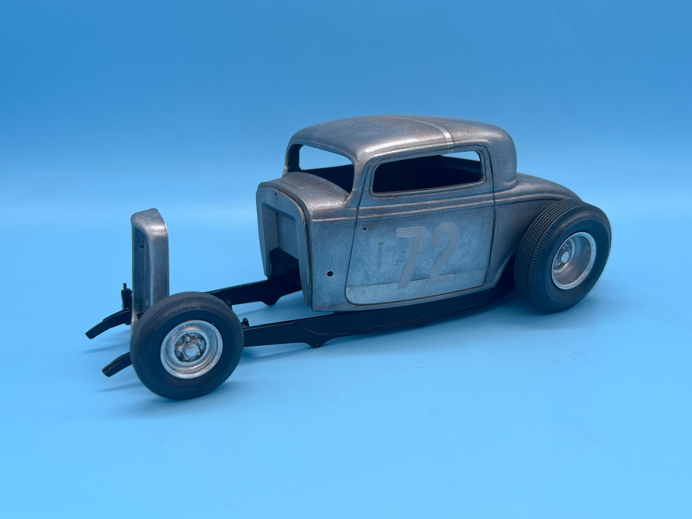

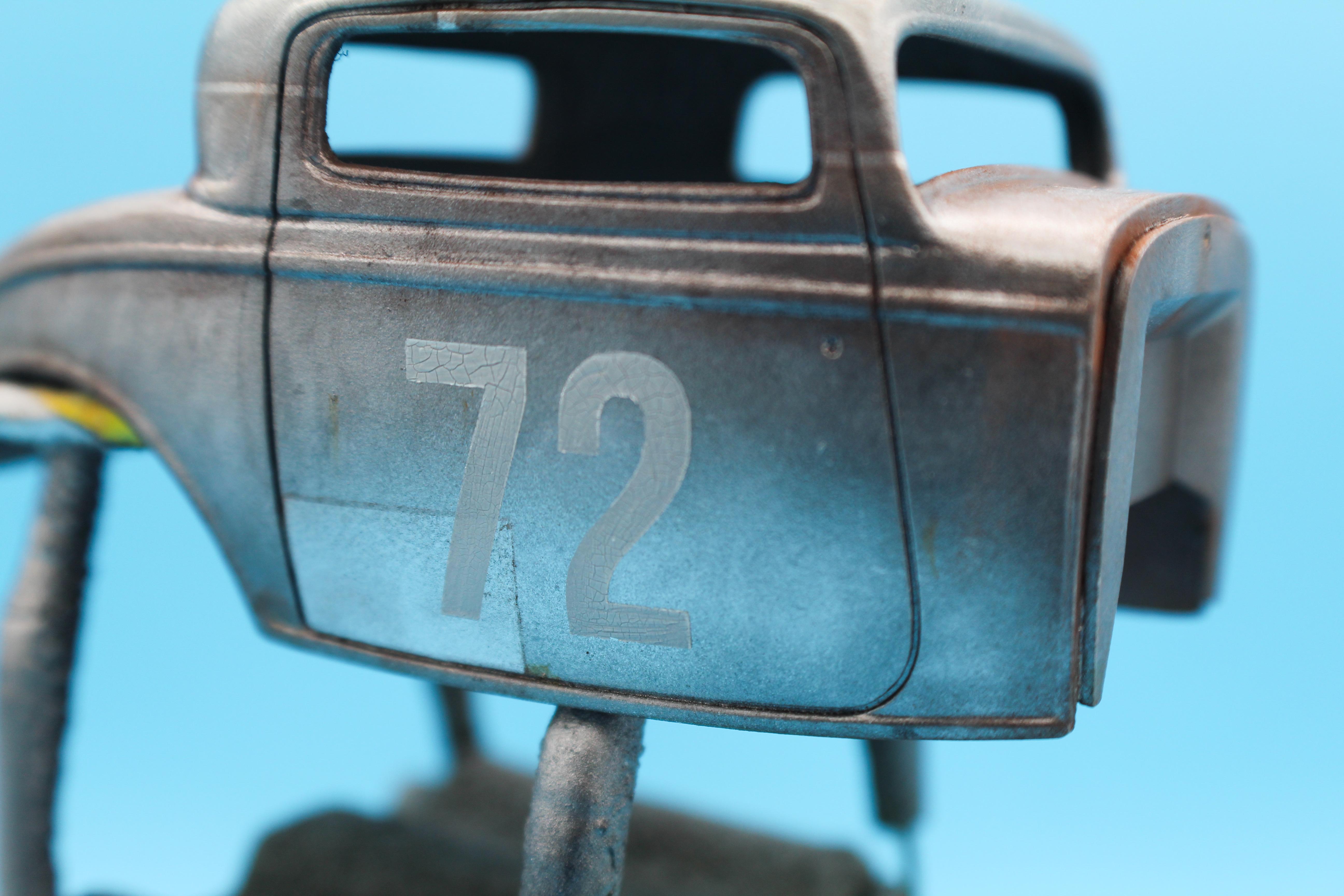

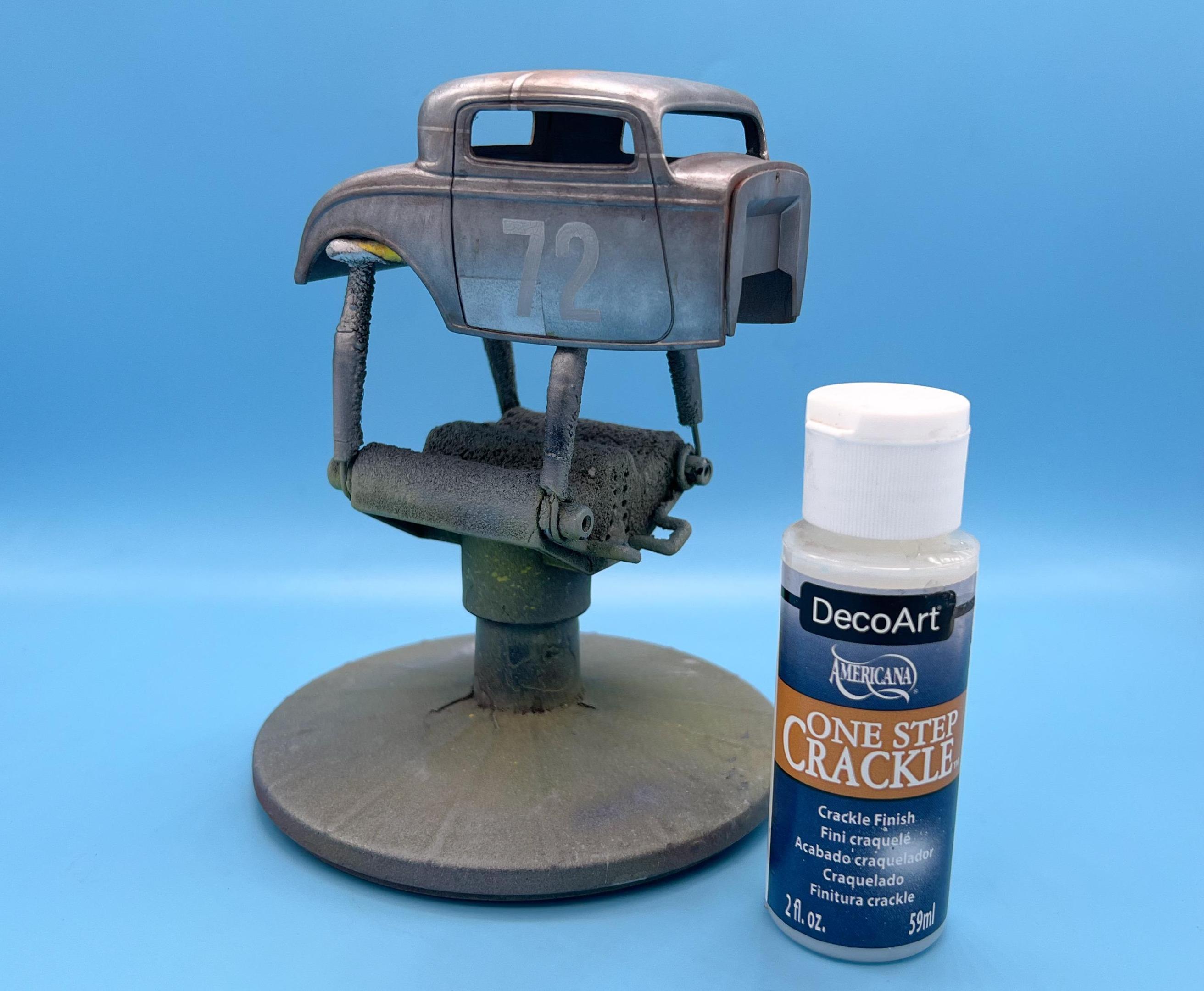

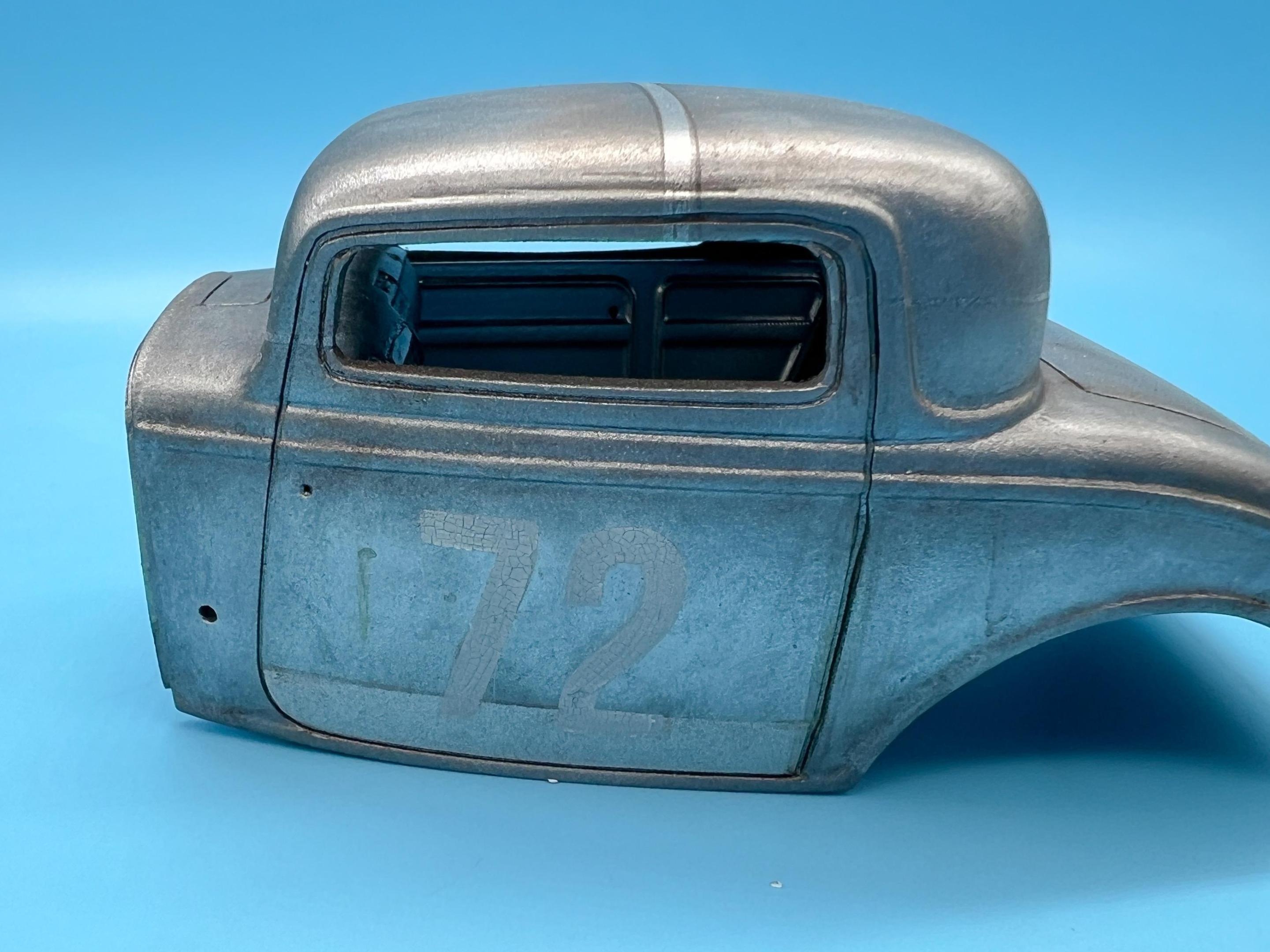

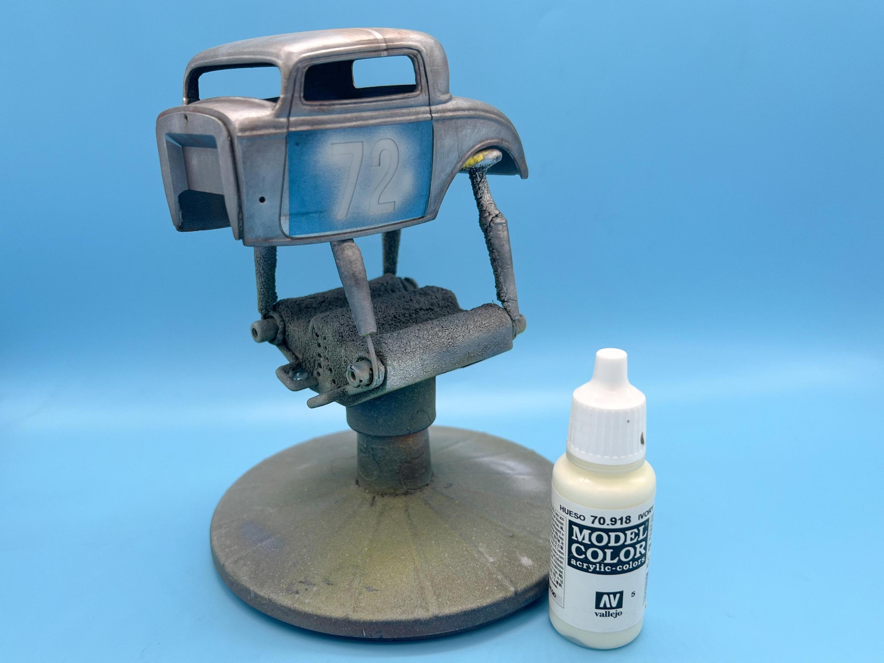

Just a little progress today…some old-school-looking hand-painted door numbers!
Spent some time looking at fonts until I found what I had in my head, then cut some masks:
I went with Vallejo Ivory for the color…I figured they might have been white One Shot at some point, and like all enamels they’ve faded and yellowed somewhat:
I wanted some visible brush-marks and then some cracking and aging so I brushed a little Decoart Crackle medium over top…this stuff is a thick gloopy clear that splits apart as it dries to create faux-aging to whatever you apply it to.  The thicker you apply it, the bigger the cracks, so I had to make sure it wasn’t too thick to get the effect I wanted:
Then, all you do is wait!  It dries over 24 hours, but within 30 minutes you can see it start to break apart and ruin itself - it’s a cool effect, especially when done sparingly:
Just a small update - everything else I achieved today was prepping a whole yard-sale of parts for paint, and no one cares to see me sanding and priming I’m sure…more soon tho, soon as I’ve done more!

Great work Jim, it looks like bare metal to me…and nice tip on the crackle medium.?

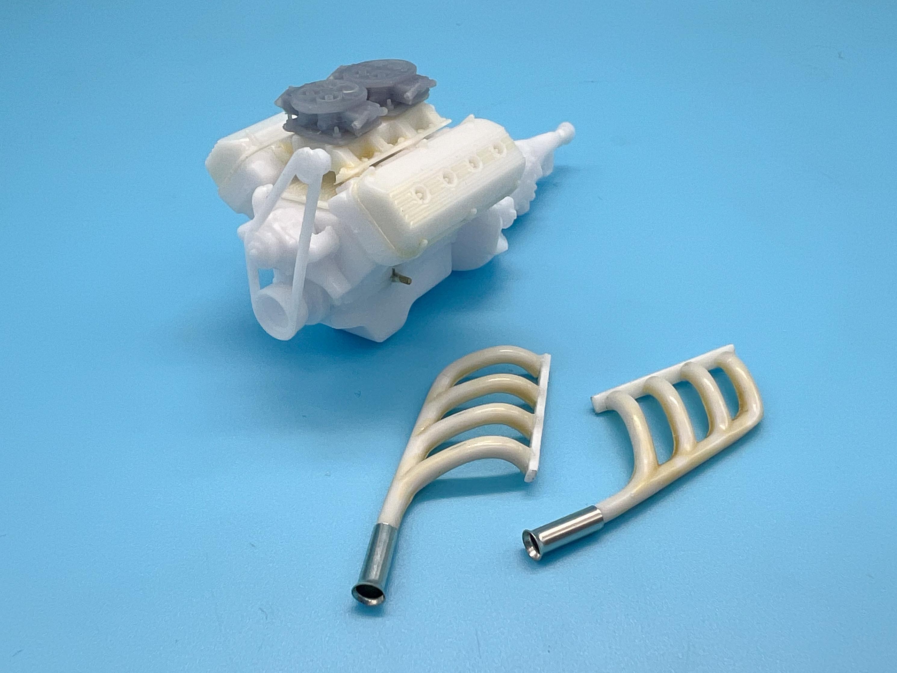

A little more progress today…I spent a couple of hours scratchbuilding some headers, and then didn’t like them as much as the parts-box (AMT?) ones I found originally.  I liked the sweeping arc on these, although they sat a little too low so I sliced them up and removed a few scale inches to get the look I wanted:

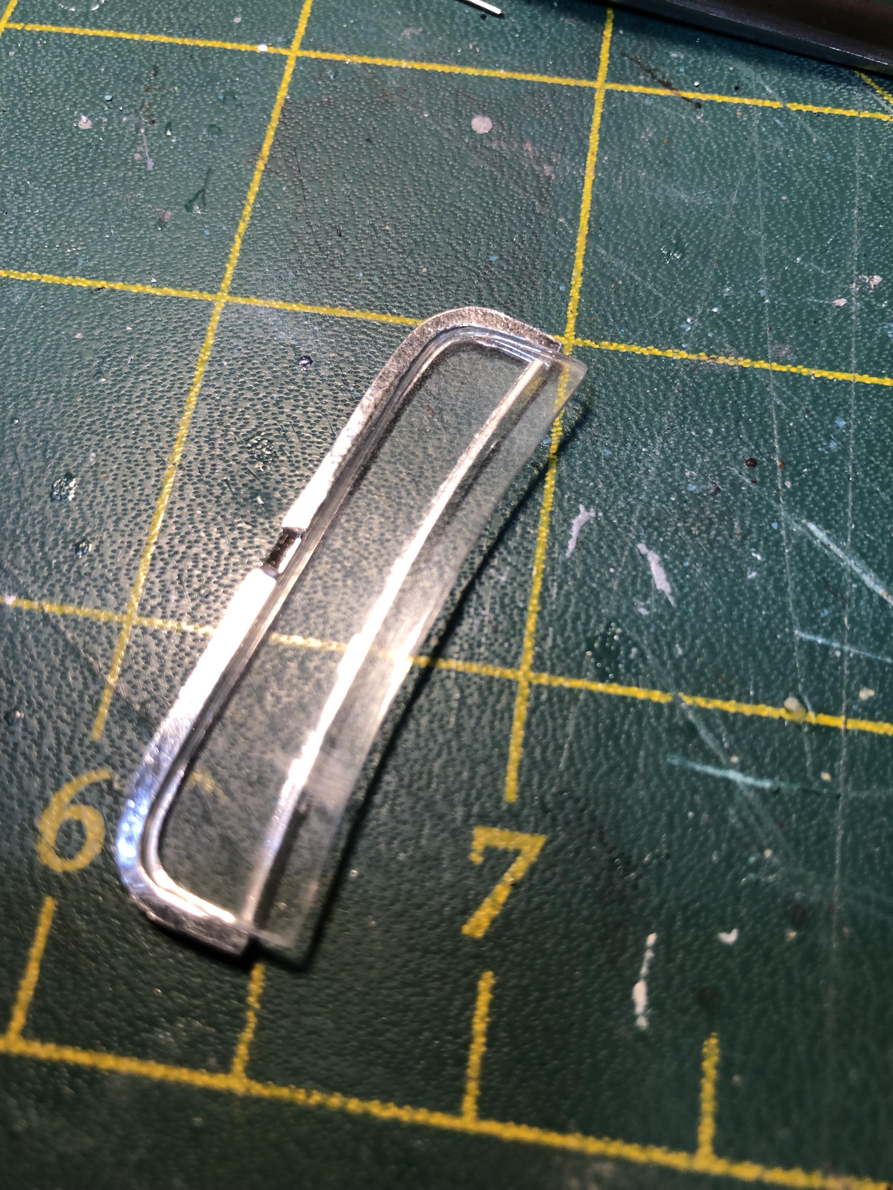

Next thing that I wasn’t super looking forward to was chopping the windshield frame - I should’ve done it before I painted the body, but I really wanted to get the body painted ?. Got it snuggled in there nice, just a little loose with no paint so it should snap right in after some primer and color:
Just need to clean up the edges once the glue has set overnight and I can paint and chrome it.  Reshaped the kit glass to fit, so that’s a chore I wasn’t looking forward to handled…

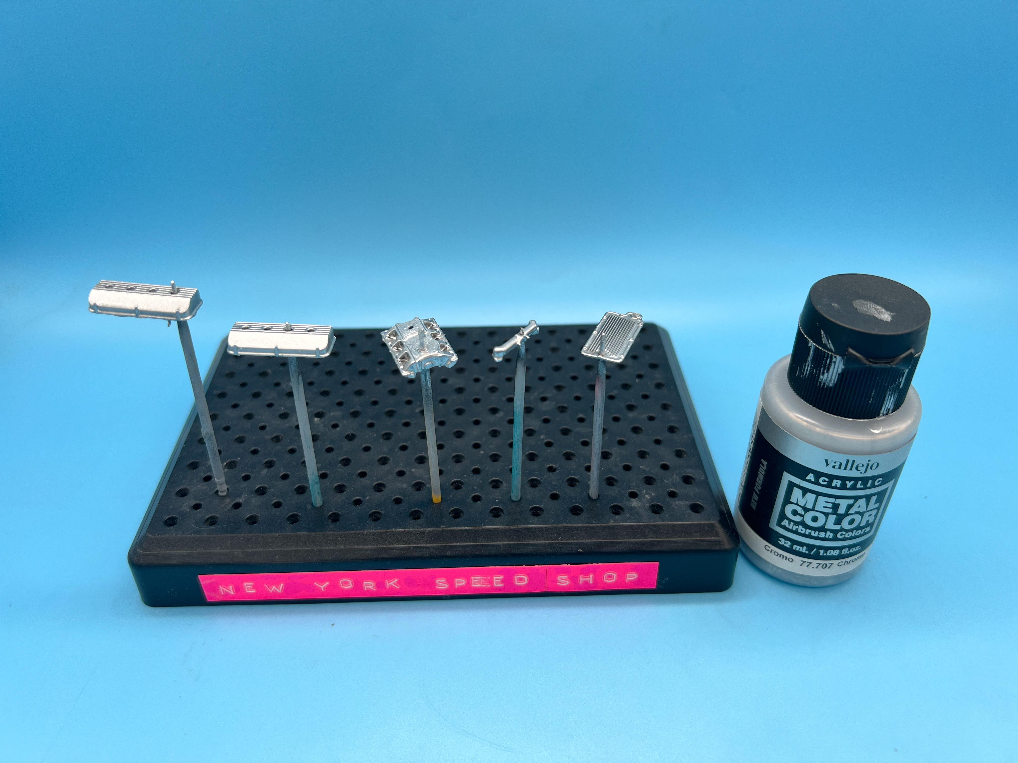

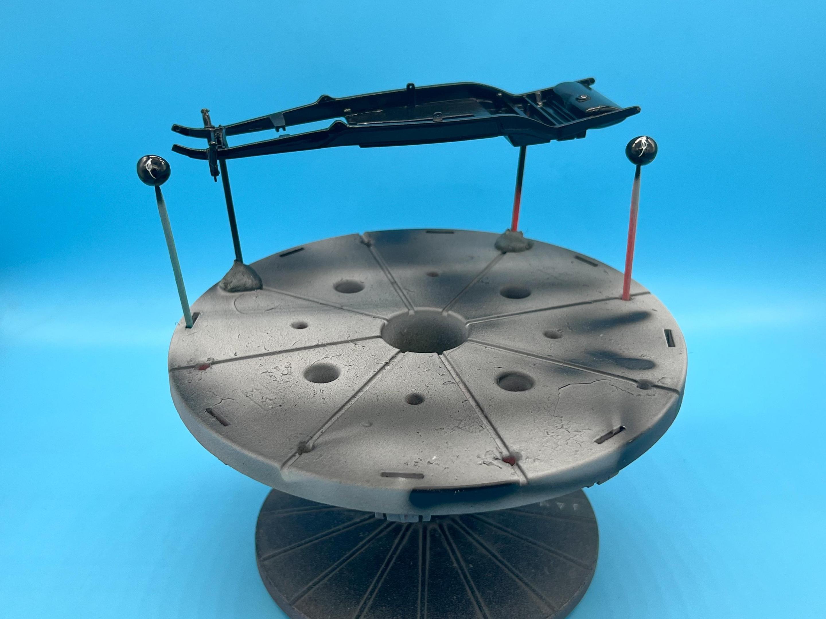

Also shot a BUNCH of parts today - basically everything but the interior tub and the engine.  The frame will be black and everything attaching to it will be either black or some kind of metal tone - the Createx black base is a really good undercoat for Vallejo metal colors in particular so it made sense to just shoot everything with that now.
Here’s a couple of pieces shot with Vallejo aluminum - the black undercoat gives a nice reflectivity:
And that’s about it for this weekend - ran out of time, but I’m really excited to shoot a bunch of metal-looking stuff this coming week and then start figuring out the engine.

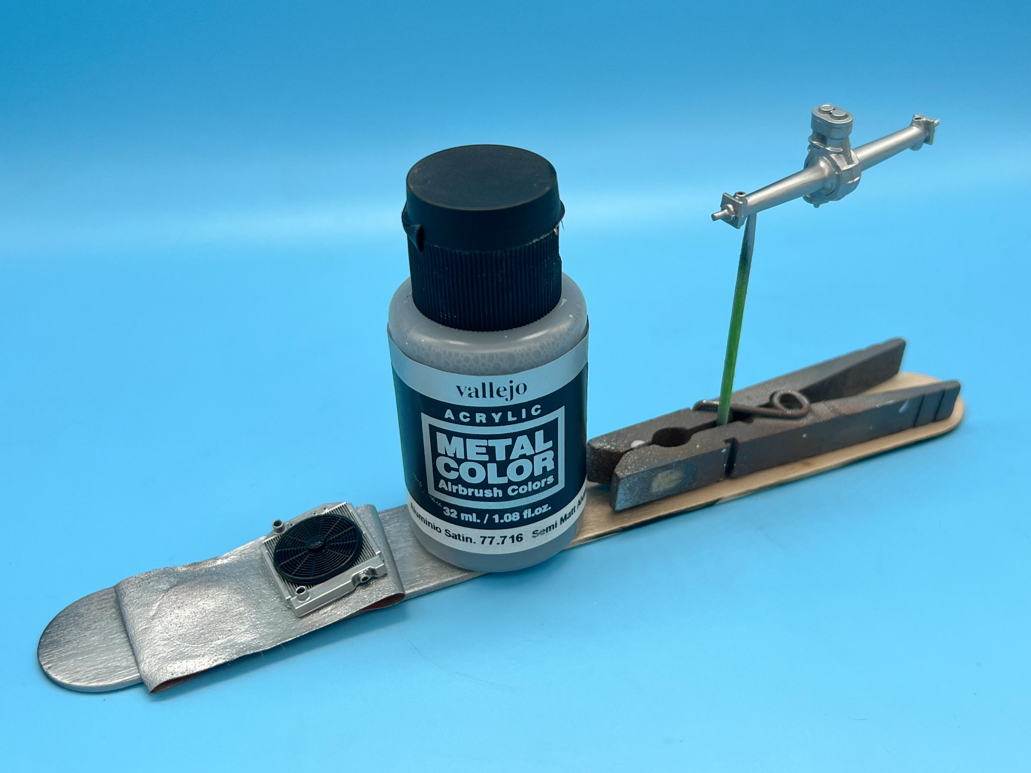

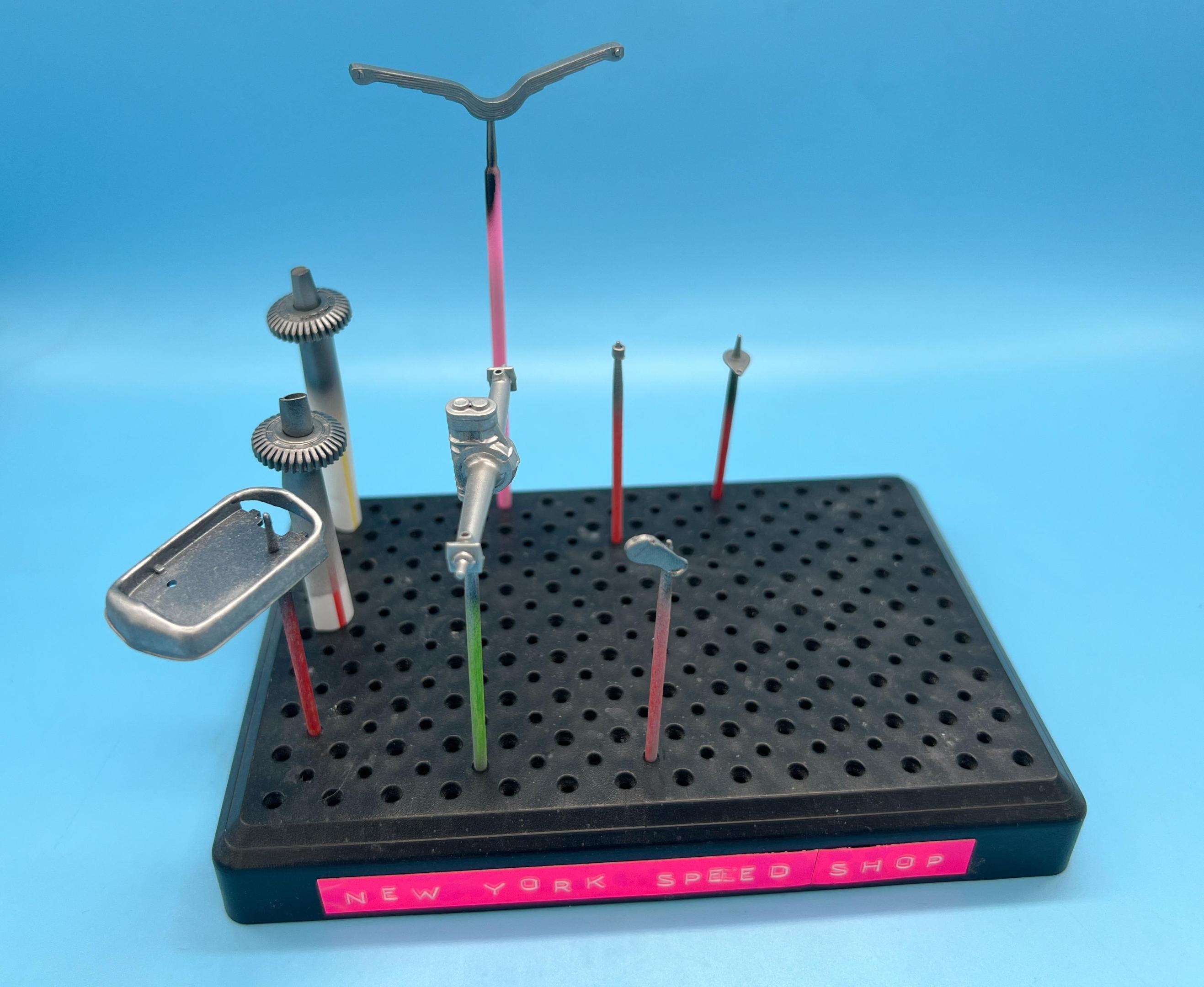

First up, started working thru painting some metal parts.  As I sorted through the parts I realized I wanted more of them to be chrome than I’d originally realized…gotta lay some clear on a load of little bits and get them smooth for some nice shine…
Rear axle is aluminum tho, and will be masked and painted with some different shades this week to add to the realism, the old T leaf spring will be steel, as will the rear brake drums, another aluminum shade for the Moon gas pedal and some other colors for a couple of other pieces…it’s fun mixing and matching different metalizer products for different looks:
Something I heard from an artist whose work I follow recently was “you’re probably not using reference material as much as you should be”.  He was speaking to ‘regular’ artists, people who draw and paint, but I’ve been thinking on that a lot recently and making sure to collect a lot of reference pics even when I think I know how a part should look…here’s some I gathered as reference for future detailing on that quick change, for example:

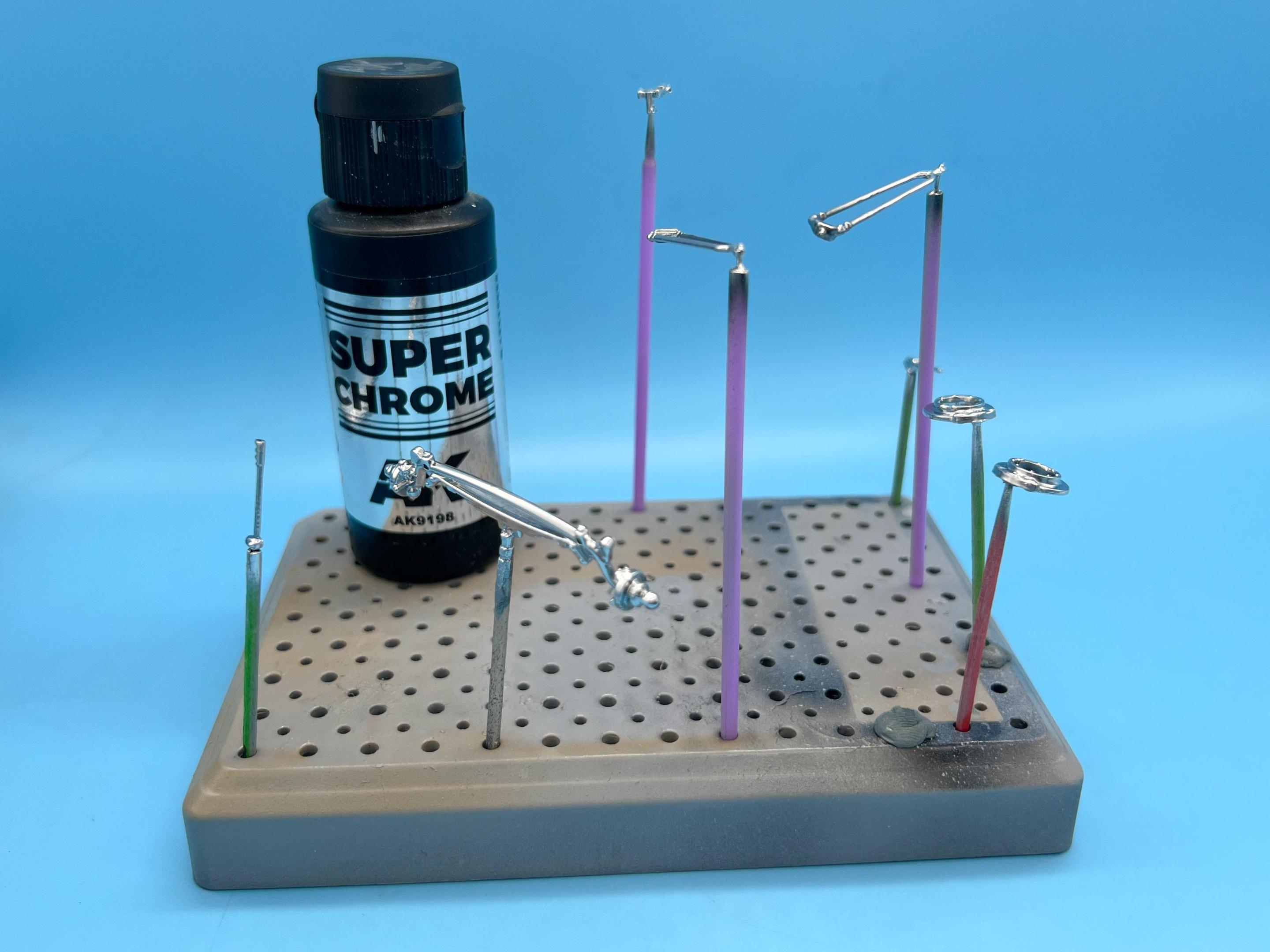

Next up, I had in my head that those headlamps would have pinstriping and be painted, even if nothing much else above the frame is, so I went through my stash of decals just for a change of pace this evening.  I was trying to find a couple of small decals with an arc to them to somewhat mirror the curve of those headers I was messing with yesterday, for some visual symmetry when the car’s viewed from above.
Went through a bunch before finding a couple on the Revell kit decal sheet that did exactly that - doh!  Should’ve started there ?
Theyre still wet and snuggling down with the decal solution right now, but they laid down ok…

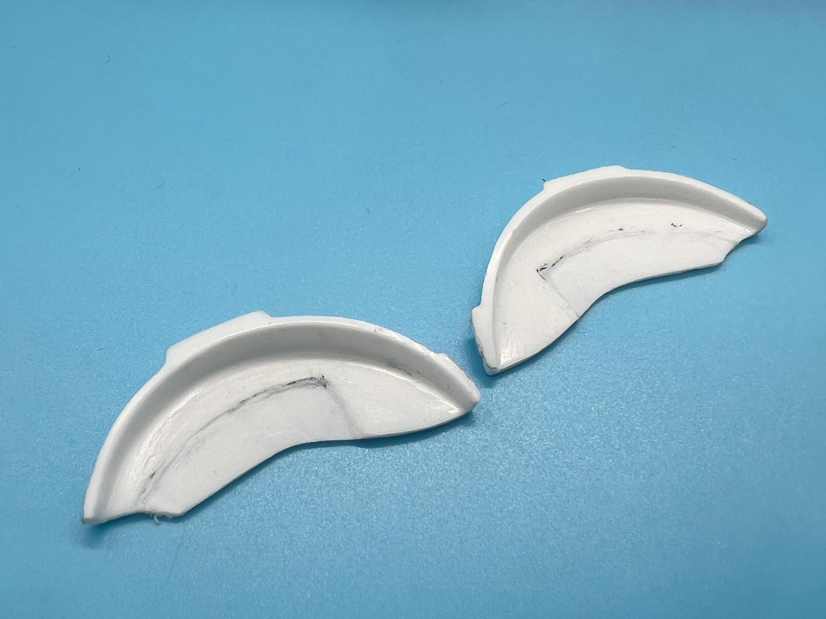

And finally, I made a start on the inner rear fenders tonight.  I’m sure you all know what the flat Revell kit pieces look like, but I wanted to add some detail to make them look more like a real set:
Nothing for it but to get the files out and start carving away material…
Excuse the roughness, they’re not finished yet, but I didn’t achieve much this evening and they were an extra thing to show for my time at the bench ?

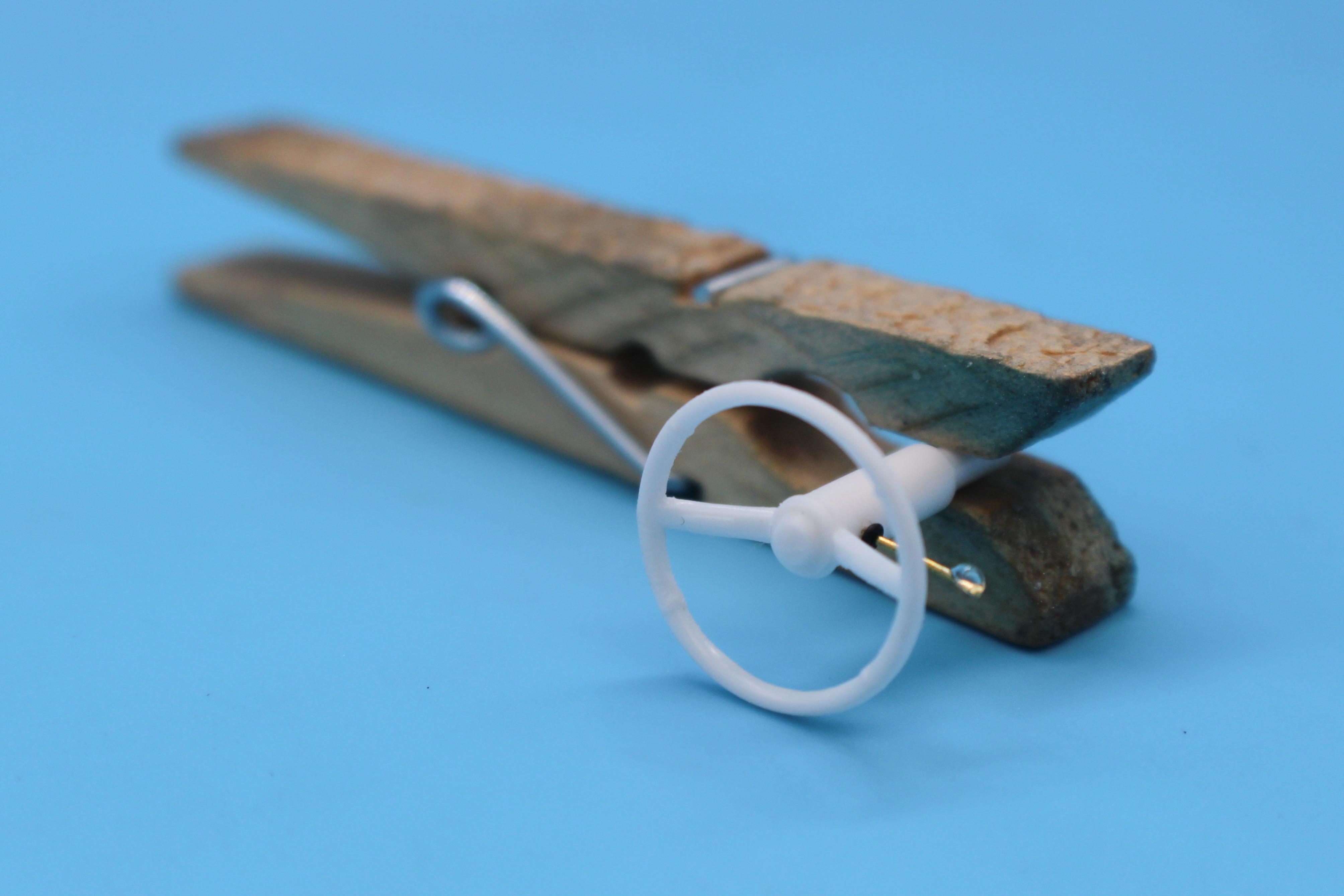

Found a parts-box steering wheel that seems like it might be pretending to be a 40 Ford wheel, which matches the dash nicely, so started cleaning that up and added a turn signal stalk roughly where the column shift would’ve been on an ACTUAL 40:

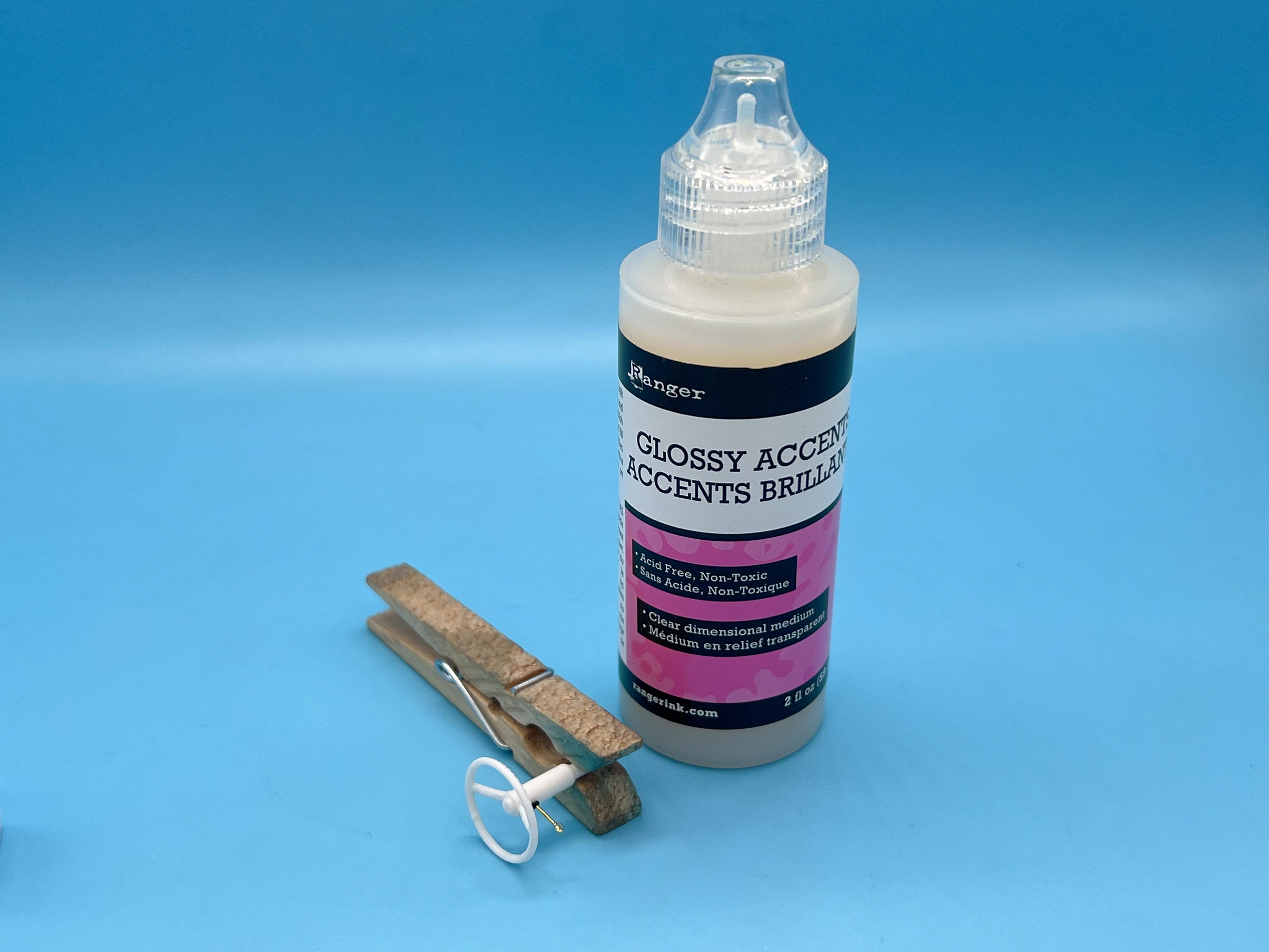

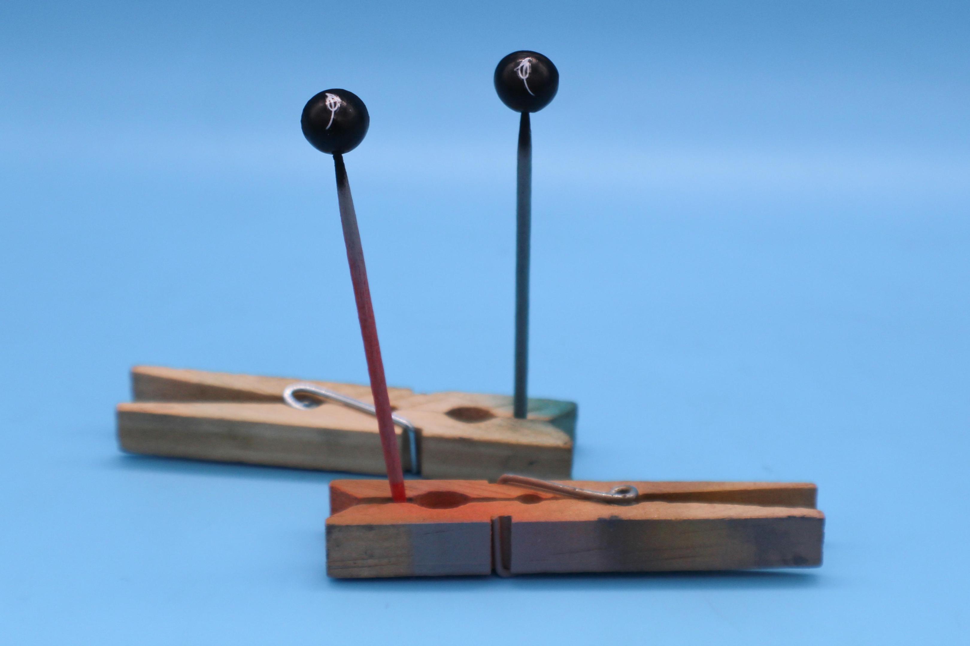

A product I like for making little clear parts as seen at the end of that turn signal lever is this product from Michael’s - it dries crystal clear and is also great for gauge faces, small lenses for lights, and probably a hundred other things too:
Just a small update tonight because it’s cold here and my brain works slow when I’m cold - more soon, thanks for looking!

Love the clear for the signal stalk, yet another little bit I’ve to add to the bench!
Thanks Bil!  I tweaked it a little this evening - not quite done with that particular project yet…

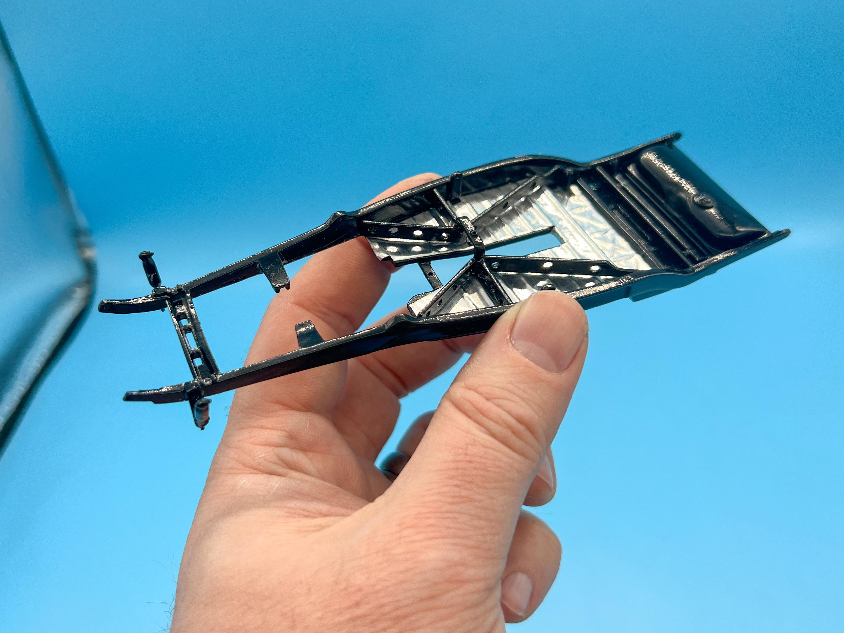

A little more work tonight - I’m in that annoying prime/paint/clear cycle that means you’re doing a lot, but nothing finished…started laying some clear on the frame though…
A frame is about a minus ten out of ten on my scale of fun things to polish, but I want a shiny frame so I’m giving it some careful attention…

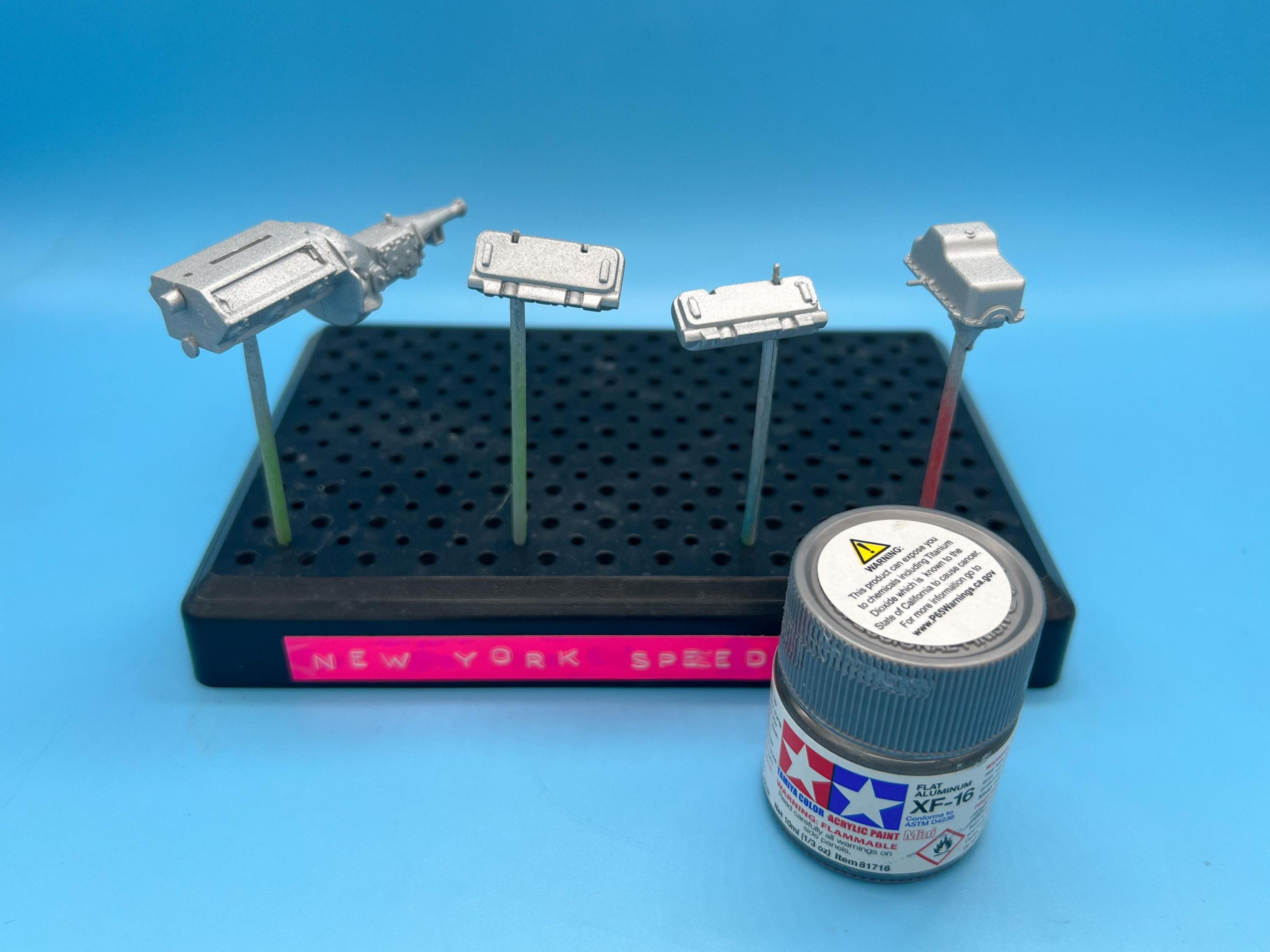

Tonight’s project was shooting some color on the engine - spent some time looking at reference pics today and decided that if I was doing this for real I’d want to use this cherry block that I found online, for sale:
Nice clear original motor, ready to drop in!  They painted these early blocks silver from the factory, and so I’m pretending I picked this thing up, added some minor upgrades (really side-grades, the valve covers, the magneto) and dropped it in that frame that I’m still clearcoating.
Challenge on this part is making sure the silver block looks like it’s silver PAINT, as opposed to metal-looking paint that isn’t the right shade for the metal that the block is made of.
Went for a Tamiya shade that looked about correct to me:
And I’ll gloss coat it lightly to give it more of a ‘paint’ look than a bare metal look.
The (aftermarket? covers should look like this, roughly:
So they got shot, along with the valley cover and some other little bits, Tamiya flat black and then Vallejo chrome (a bad chrome, good aluminum):

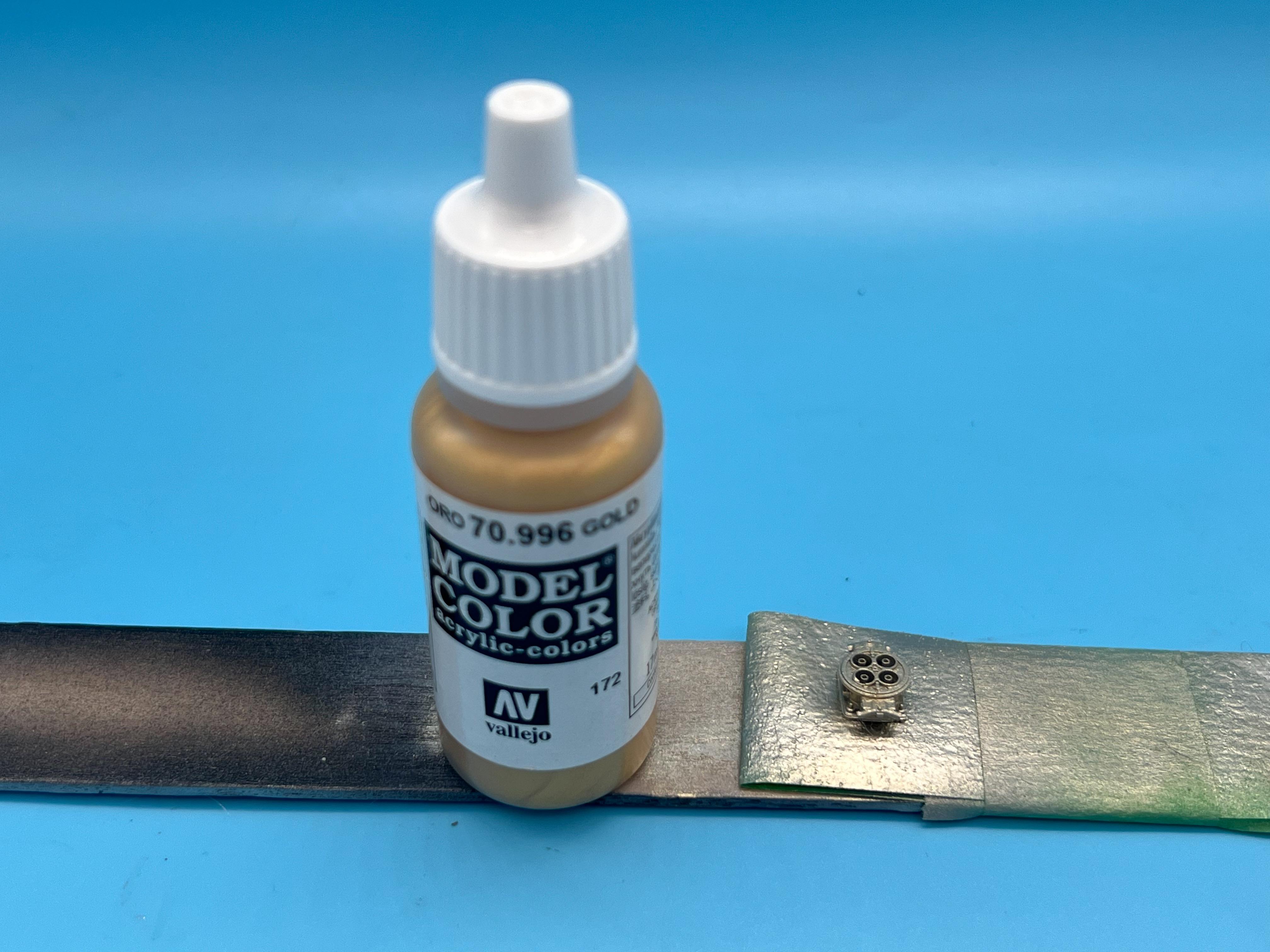

And I like the Holley carbs that have this silvery-gold tone to them, whatever the alloy is that they’re made of:
So I started the painting work on those with a mix of Vallejo Chrome and Vallejo gold:
Didnt quite nail that yet, and they’ll need some detail painting, but plenty of time until I need to glue them on…

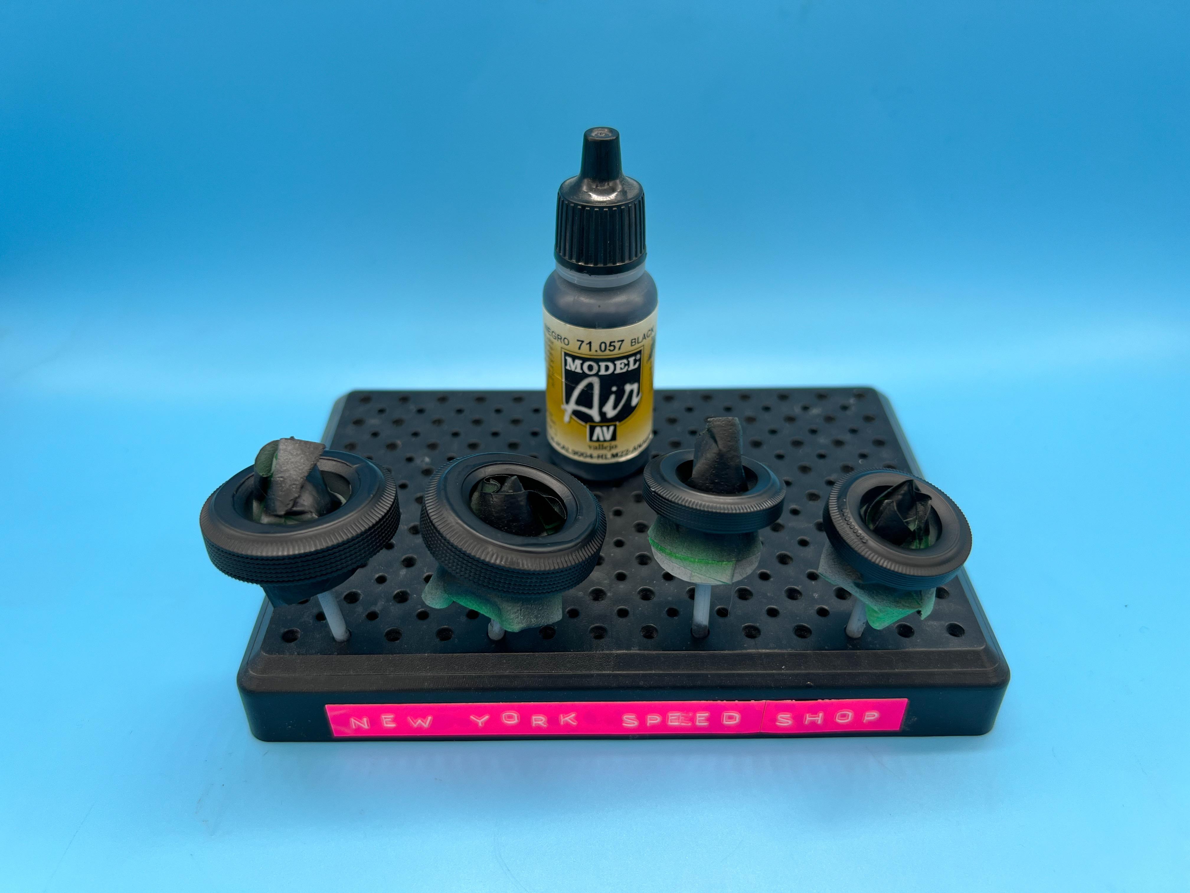

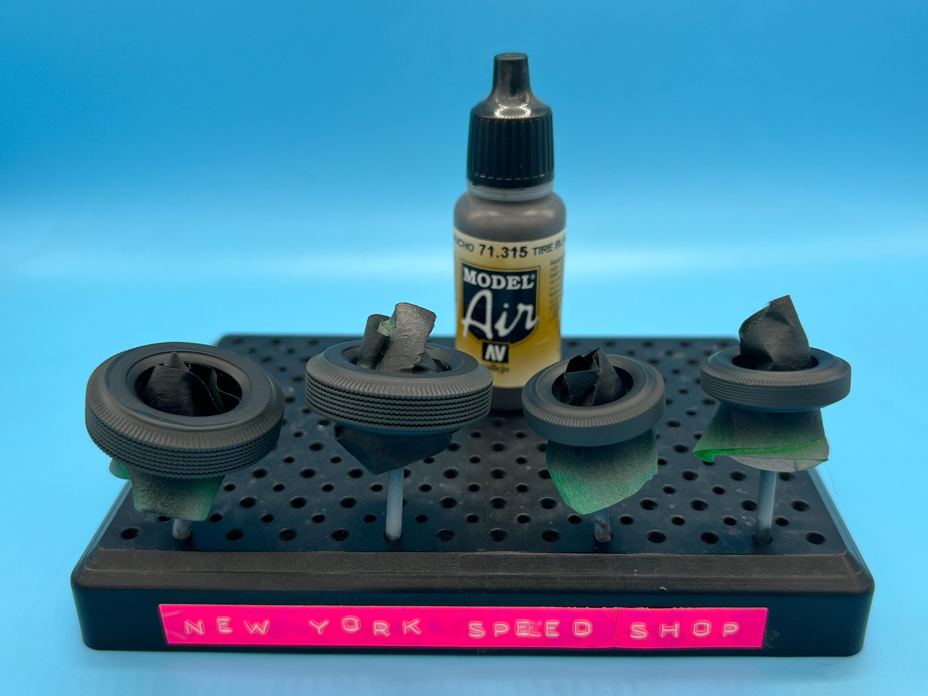

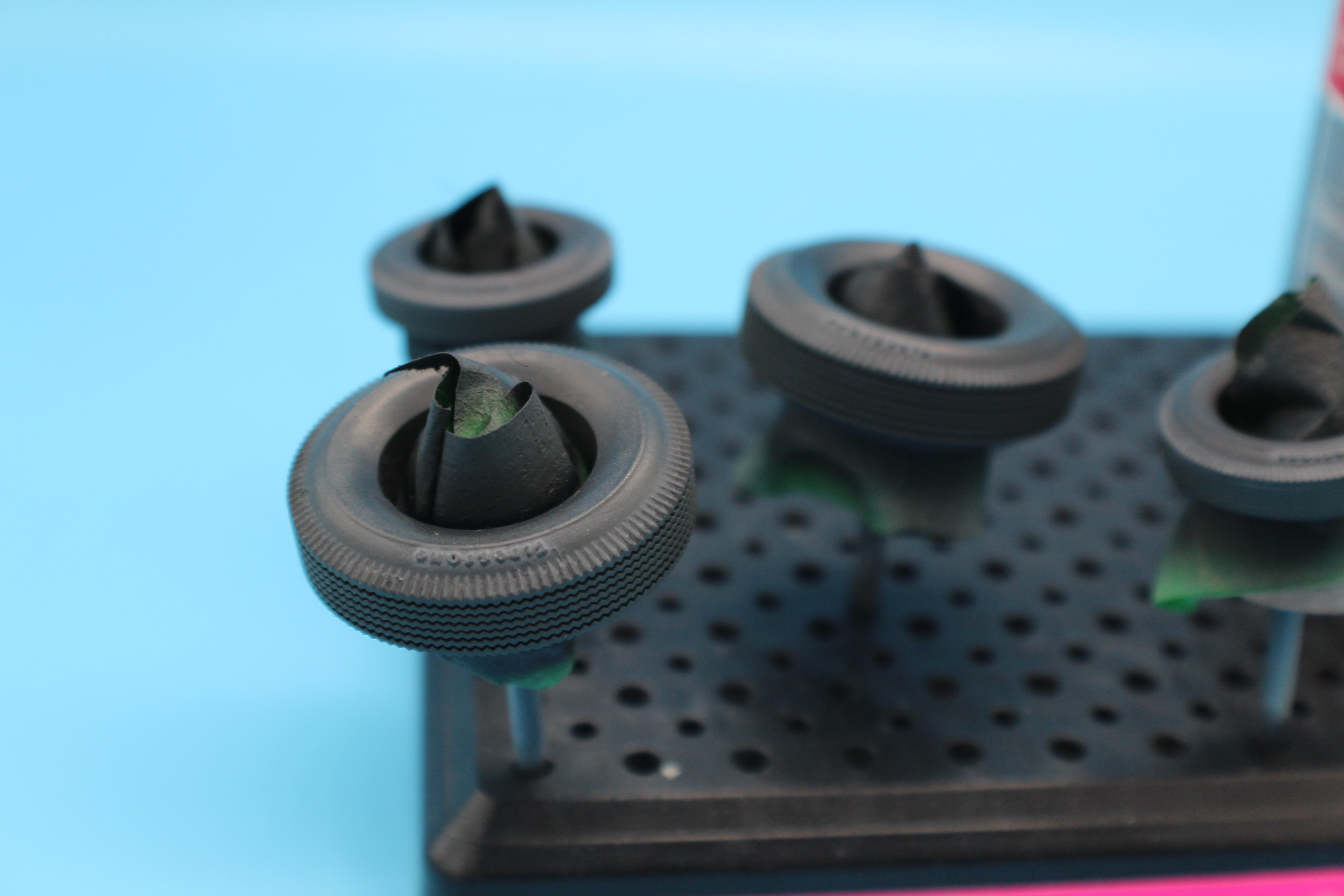

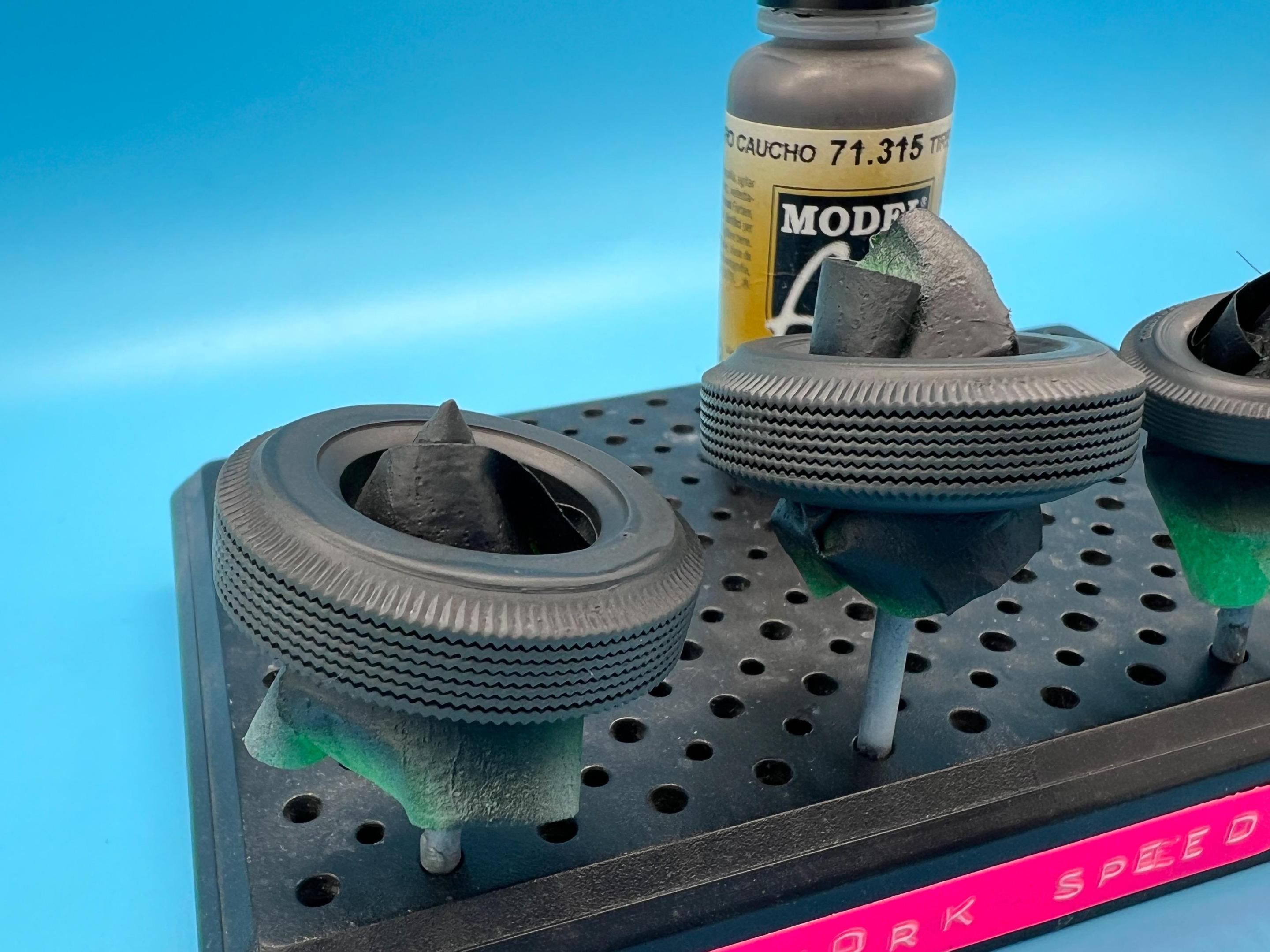

A little more progress this evening…started out with painting the tires, or making a start anyway.  First step is Vallejo black, over-reduced slightly so it flows out and has a little satin sheen to it:
Followed by Vallejo Tire Black (actually a dark gray) misted around the edges and mostly on the treads:
I have a couple more steps to complete on these tomorrow, but I like this two-step Vallejo system (which actually has a third step if you want to dirty them up some) for easy realistic rubber parts:
More on those tomorrow…

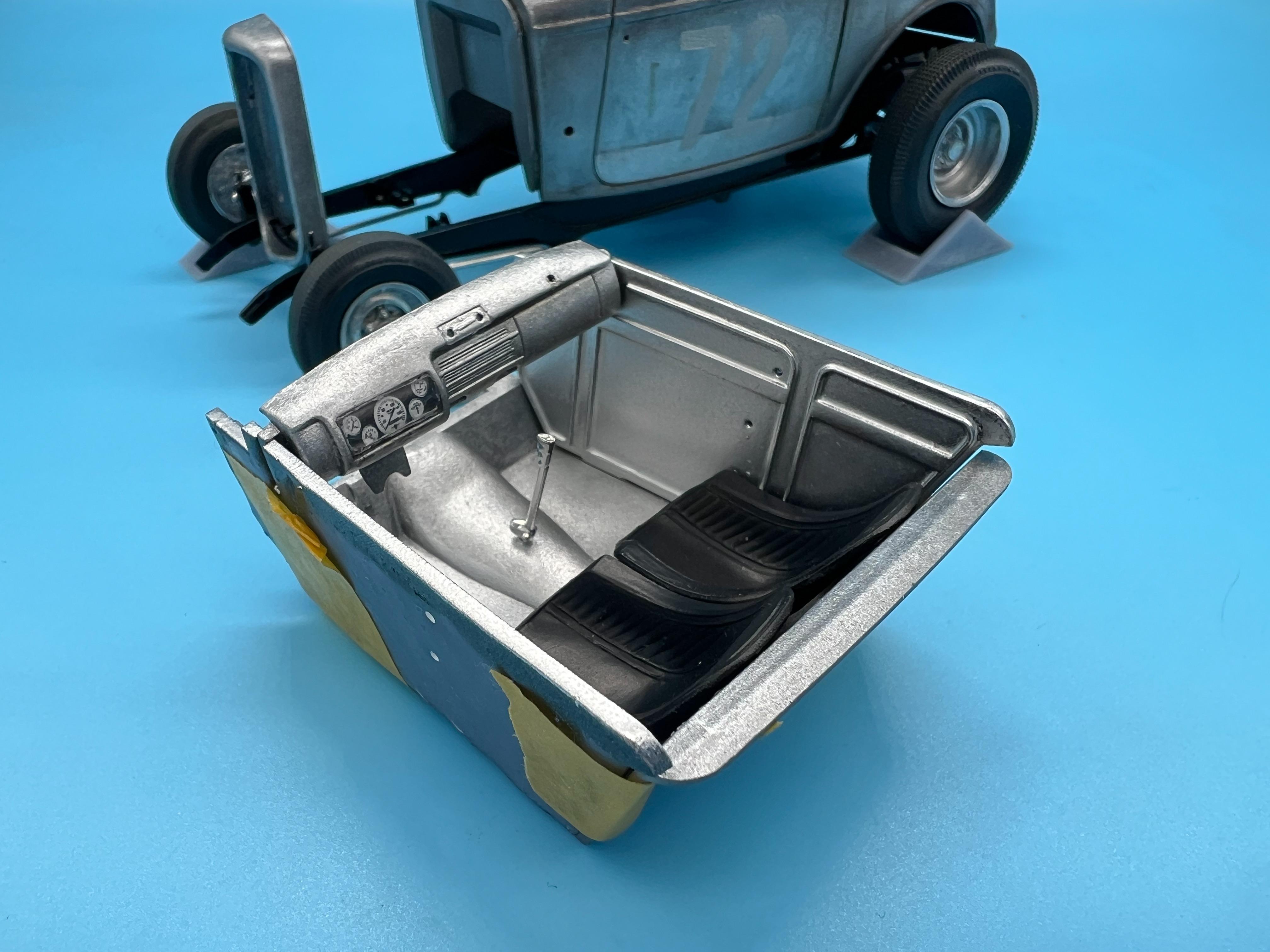

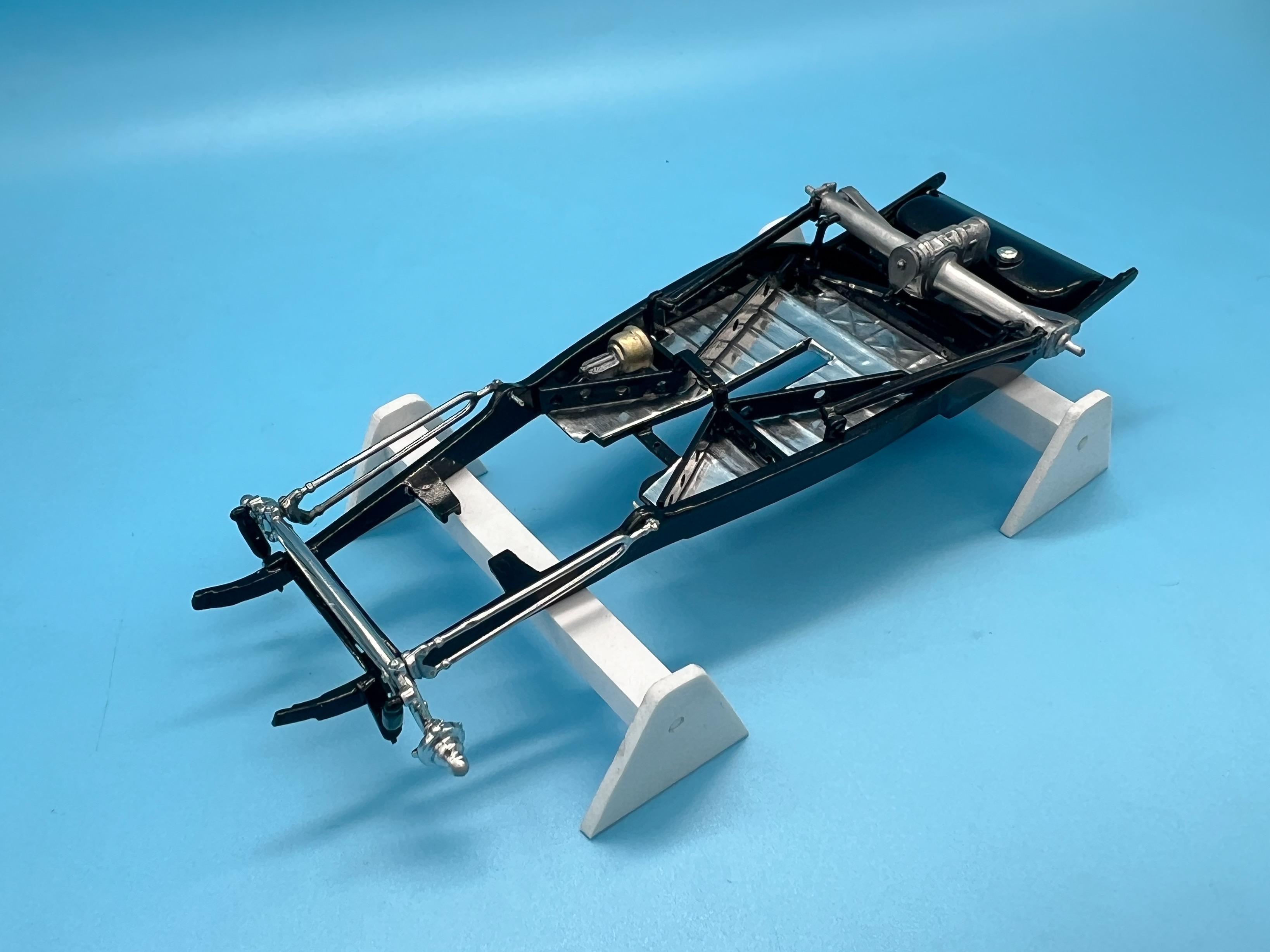

Polished out the frame, as much as I dare anyway (hate burning through those corners, but I got it close as I could without mishap…) and got the aluminum floor that I made previously in place.
The crossmember is just dropped in there right now, just so I could see how it looked…
Still working through the suspension and everything that bolts to the chassis, but I’m nearly done with painting - today’s project was shooting some chrome…
 Revell gives you three decals for the ‘40 Ford dash in their 5 window kit, and my preference was the standard gauges on the left, number 17:
Eighteen was my backup, but both of them fractured into nothingness once they released from the sheet as I tried applying them, so I had to go with the white gauges:
They’re still snuggling down with some decal set in this pic - we’ll see if I wake up to a disaster tomorrow or not…. Nice thing with this particular kit part - there’s a ‘glass’ for them on the clear parts tree - looking forward to installing that…

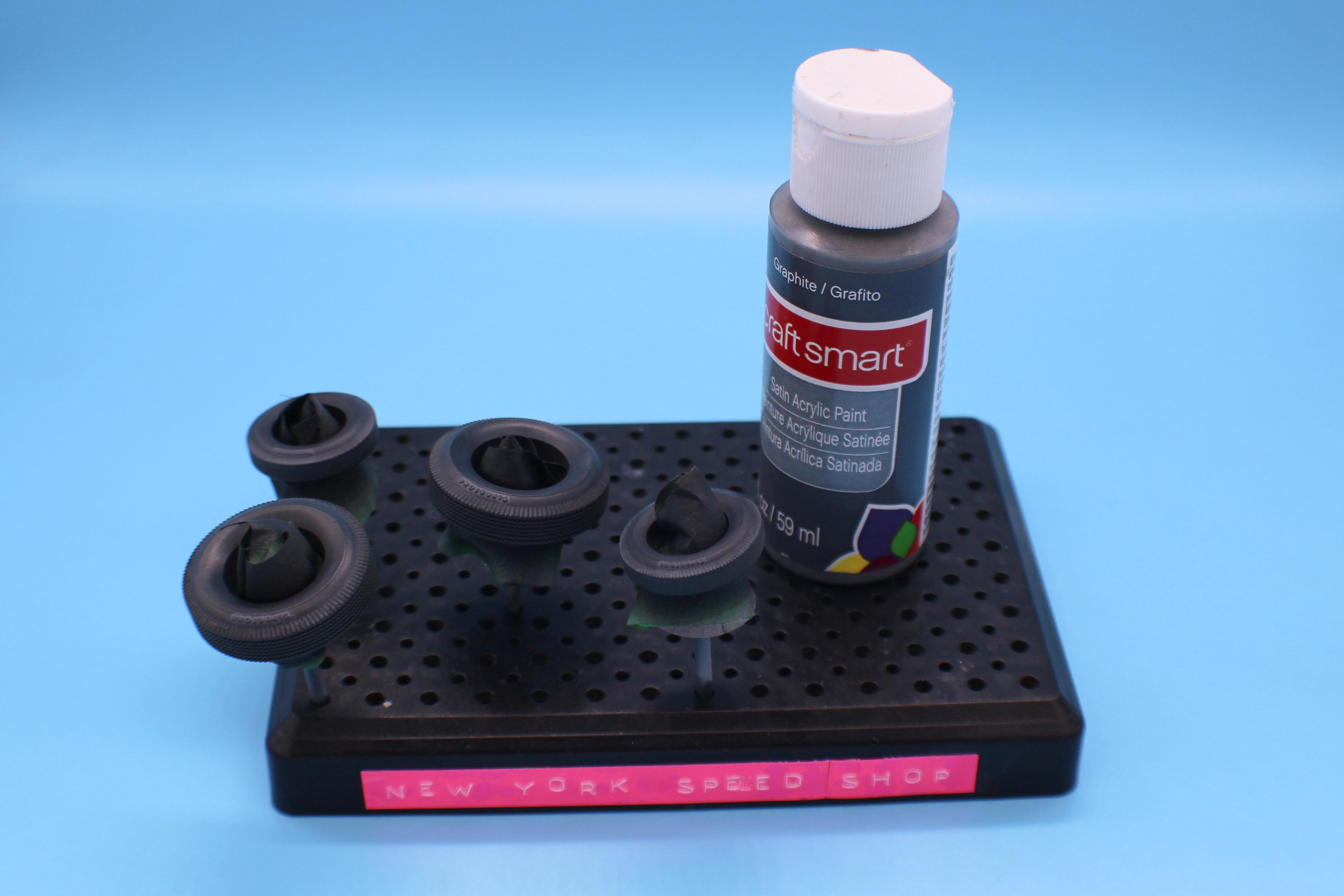

Next up, finishing up the tires with a gray wash of cheap acrylic…just wanted the Firestone lettering to stand out a little and make them look a LITTLE used:
Worked ok I think:

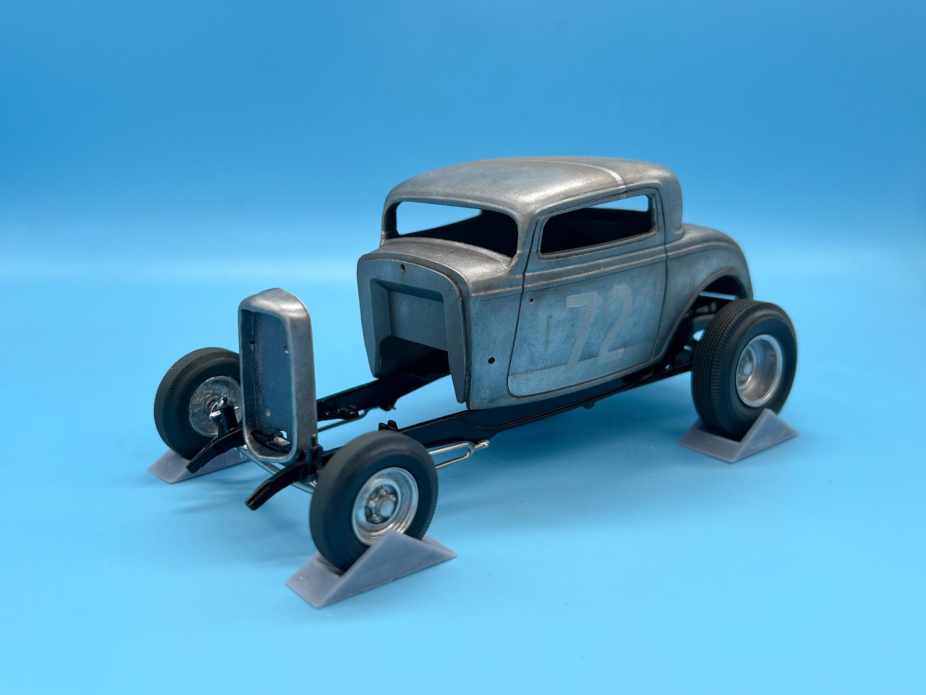

And I couldn’t resist a mockup of the frame, body and wheels & tires just to get a sneak peek at how some of these parts look, all together:

Had a busy Sunday today, but got a coupla three of hours in at the bench…
Started fitting the axles and underneath-stuff to the frame:
The rear end too some finessing to get everything aligned perfectly - lots of little pieces that have to coexist and align right, but got there in the end.  By contrast, the front end practically fell in…still needs the steering linkages and brakes but it’s close…
Painted the interior tub and sides and did a quick mock-up:
Not that you’ll be able to see too much in there when it’s done anyway…
And finally, a quick motivational mock-up or two…
Still plenty to do, but it’s starting to look like a thing!
