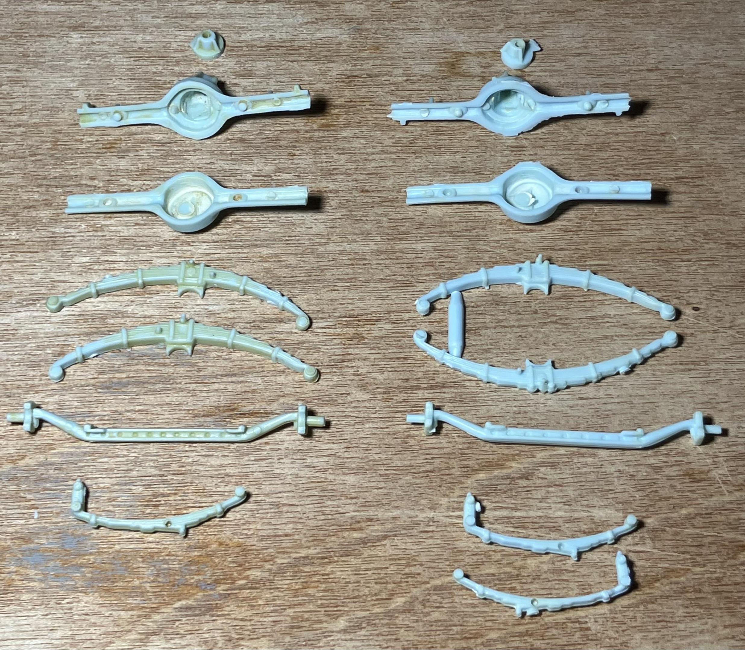

dusty_shelf Posted January 11, 2024 Posted January 11, 2024 While working on my AMT ‘33 Willys build, I became very frustrated with the parts I de-chromed. Despite all my best efforts, I could not remove most of the lacquer/varnish applied to the sprue before plating. The leaf springs in particular are unusable. This undercoating obscures the details. I would question of the adhesion of the paint to it. Fortunately, I have a second parts kit and had complete success removing the chrome. Took it right down to the original plastic color. No cleanup necessary. Upon seeing the results, I compared the racks of chromed parts from the two kits. What is evident is there was too much undercoating applied for one batch. It is particularly noticeable on the intake manifold, blower pulley assembly, and the engine block front. Fine detail is lost and some shapes indistinct. Also, when handling the bad chrome, little flakes come off like glitter. I sure wish the manufacturers wouldn’t plate parts never meant to be plated. 1

dusty_shelf Posted January 11, 2024 Author Posted January 11, 2024 My go-to for chrome removal is LA's Totally Awesome Cleaner. In some instances you can see the chrome come off in real time. Otherwise, a soak for a couple of hours is usually sufficient. I had the bad parts submersed for the better part of two days with no noticeable difference. I did see some removal of the lacquer using non-acetate nail polish remover. However, because of the potential to soften the plastic, I didn’t want to expose it too long. 1

dusty_shelf Posted January 12, 2024 Author Posted January 12, 2024 I think I have found the right combination. I will continue to strip using the LA’s Awesome. It works super fast and removes paint as well. At the suggestion of Bainford, I immersed the bad parts in 91% alcohol for 24 hours. All of the lacquer flaked off using a fine wire brush. No damage to detail. Thanks to all who commented. 4
