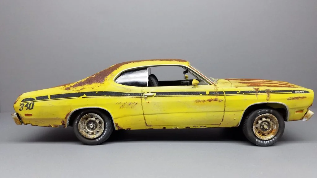

Smitty Posted February 4, 2024 Posted February 4, 2024 (edited) I took a stab at changing the AMT Duster ‘quarter’ windows a while ago. I sanded off the roof drip mouldings and filed and sanded the rear windows into a shape that I was happy with. Then I replaced the mouldings with styrene strip. This car is important enough to me to go to the trouble. I'm sure it's not perfect to everyone's eyes but I'm happy with it. I'll be building more of these kits in the future, and having seen the very helpful comparison photos posted by Bainford (thanks Trevor), I'll try to make the shape even more angular. Edited February 4, 2024 by Smitty 3 Quote

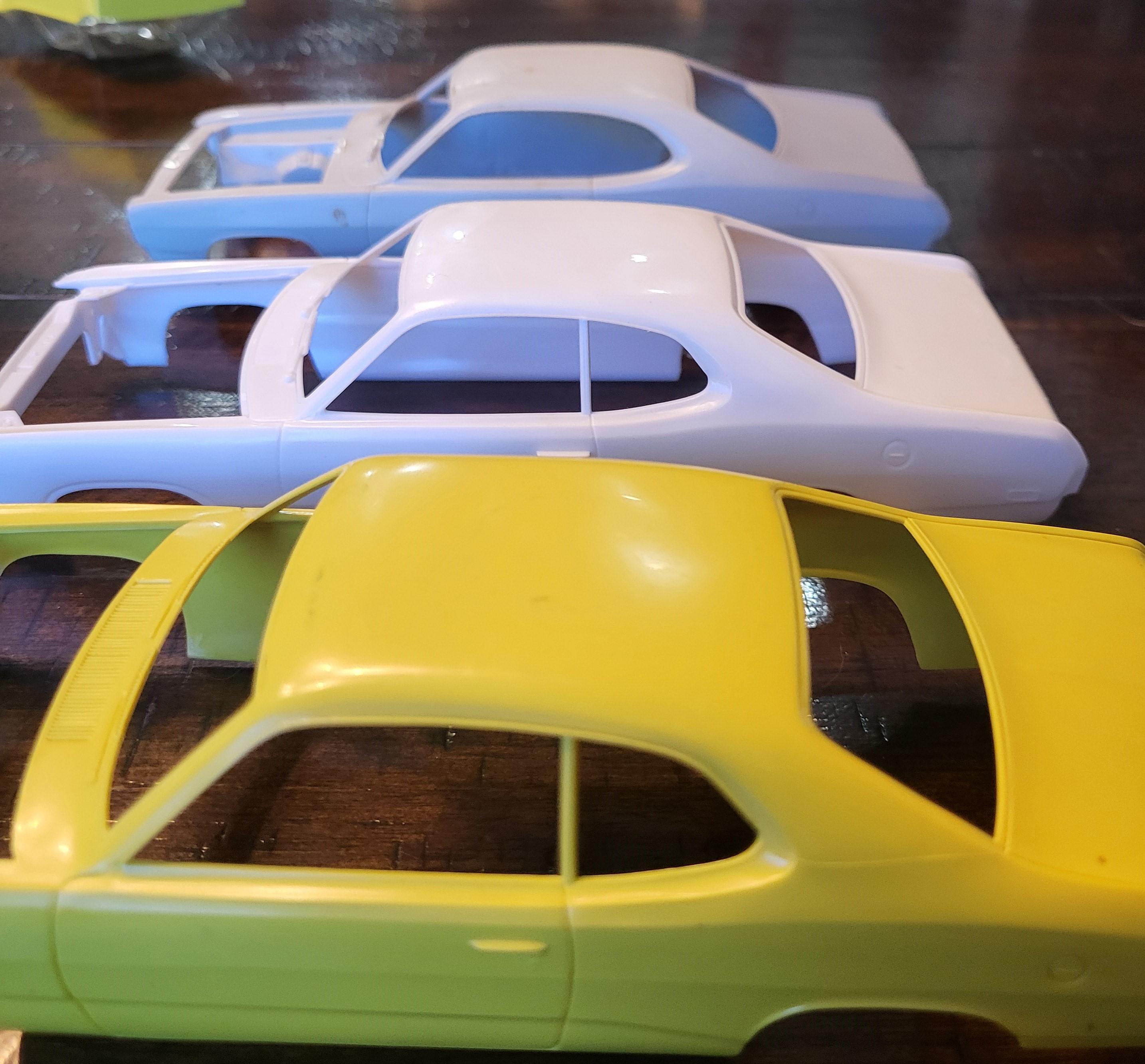

gtx6970 Posted February 5, 2024 Posted February 5, 2024 Ive seen the issue before and its been hashed here before. Myself, I have a built original issue 71 Duster in the case. and an unbuilt 72 Duster to build. So all the current 71 Dusters I have will be old prostock replicas. Will I change the / alter the C pillar? Not likely Pictures are . Lime green MPC 1972 Duster in the fore ground All white the Current 71 Demon in the center White / primer is the current 71 Duster in the rear Quote

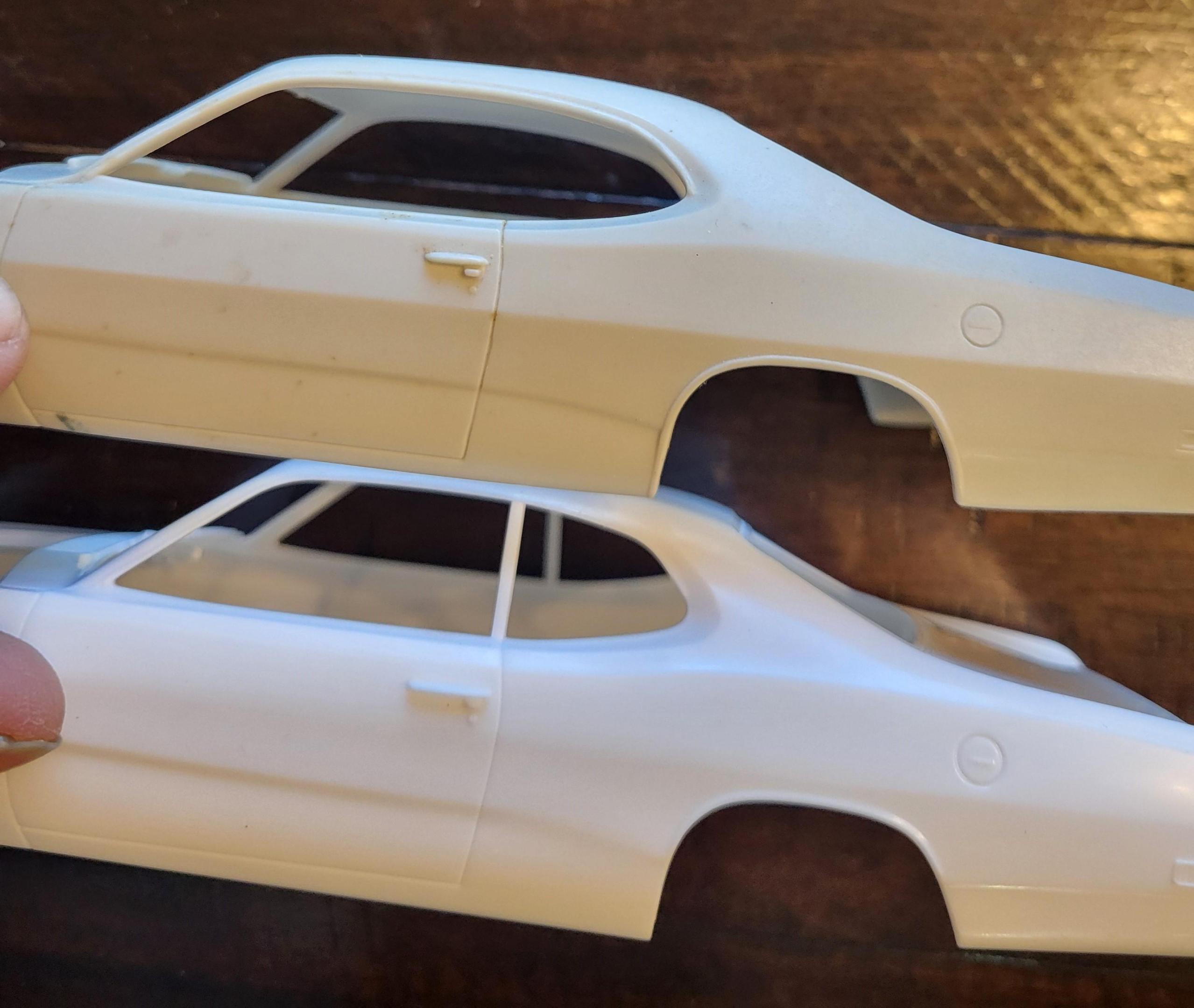

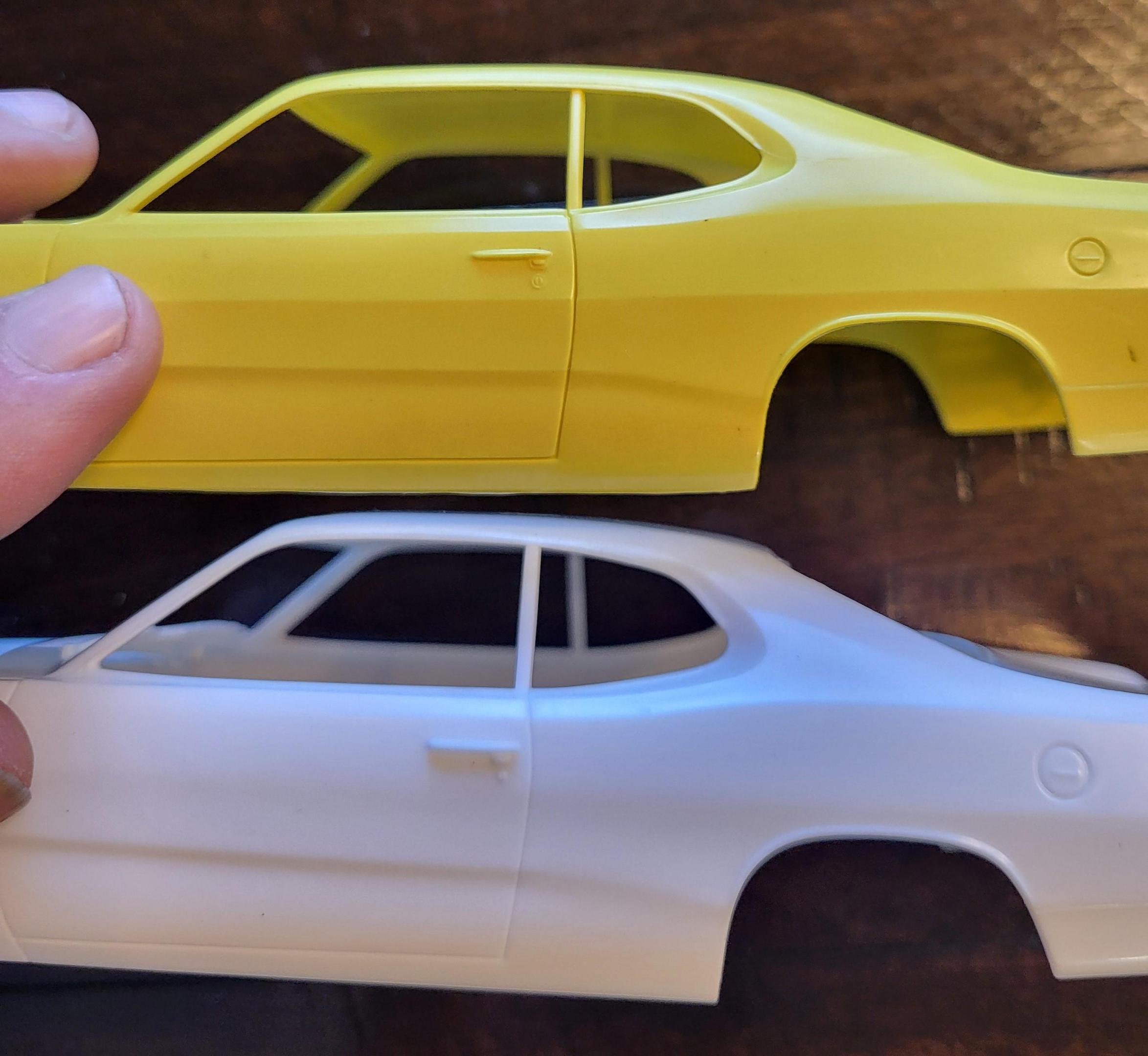

gtx6970 Posted February 5, 2024 Posted February 5, 2024 Closeups. Original MPC 72 versus current 71 Demon Quote
gtx6970 Posted February 5, 2024 Posted February 5, 2024 Current 71 Demon versus current 71 Duster Quote
gtx6970 Posted February 5, 2024 Posted February 5, 2024 Original 72 Duster compared to current 71 Duster Quote
