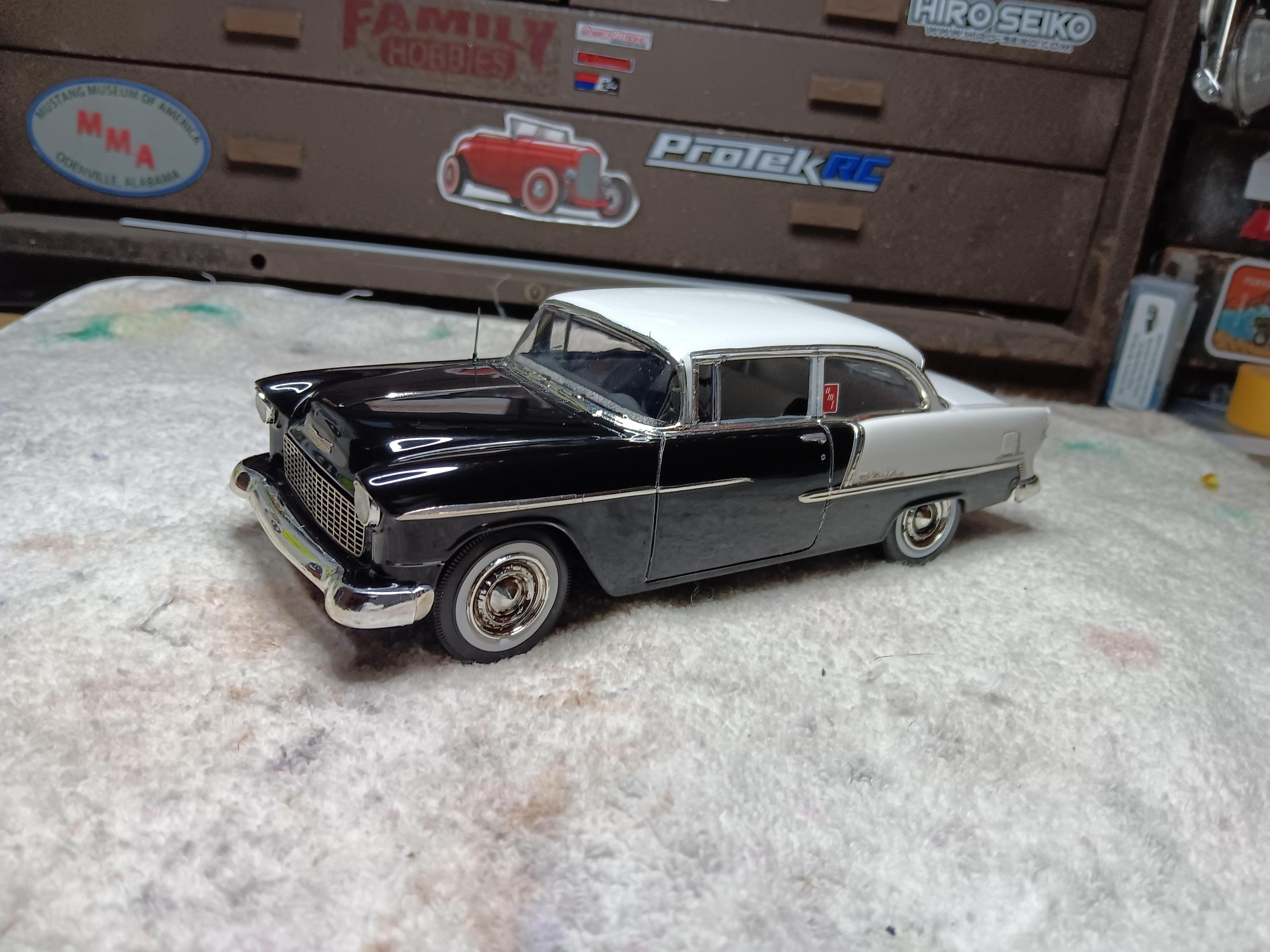

Musclecarbuilder Posted February 16, 2024 Posted February 16, 2024 (edited) I built a '55 bel air from AMT for a friend that was black. I wet sanded it with 4000-12000 grit polishing cloth than I hit it with the Tamiya polishes. After using the Tamiya polish I rubbed the car with Meguiar's cleaner wax that took out 95% of the micro scratches. Hope this helps! Edited February 16, 2024 by Musclecarbuilder 1
