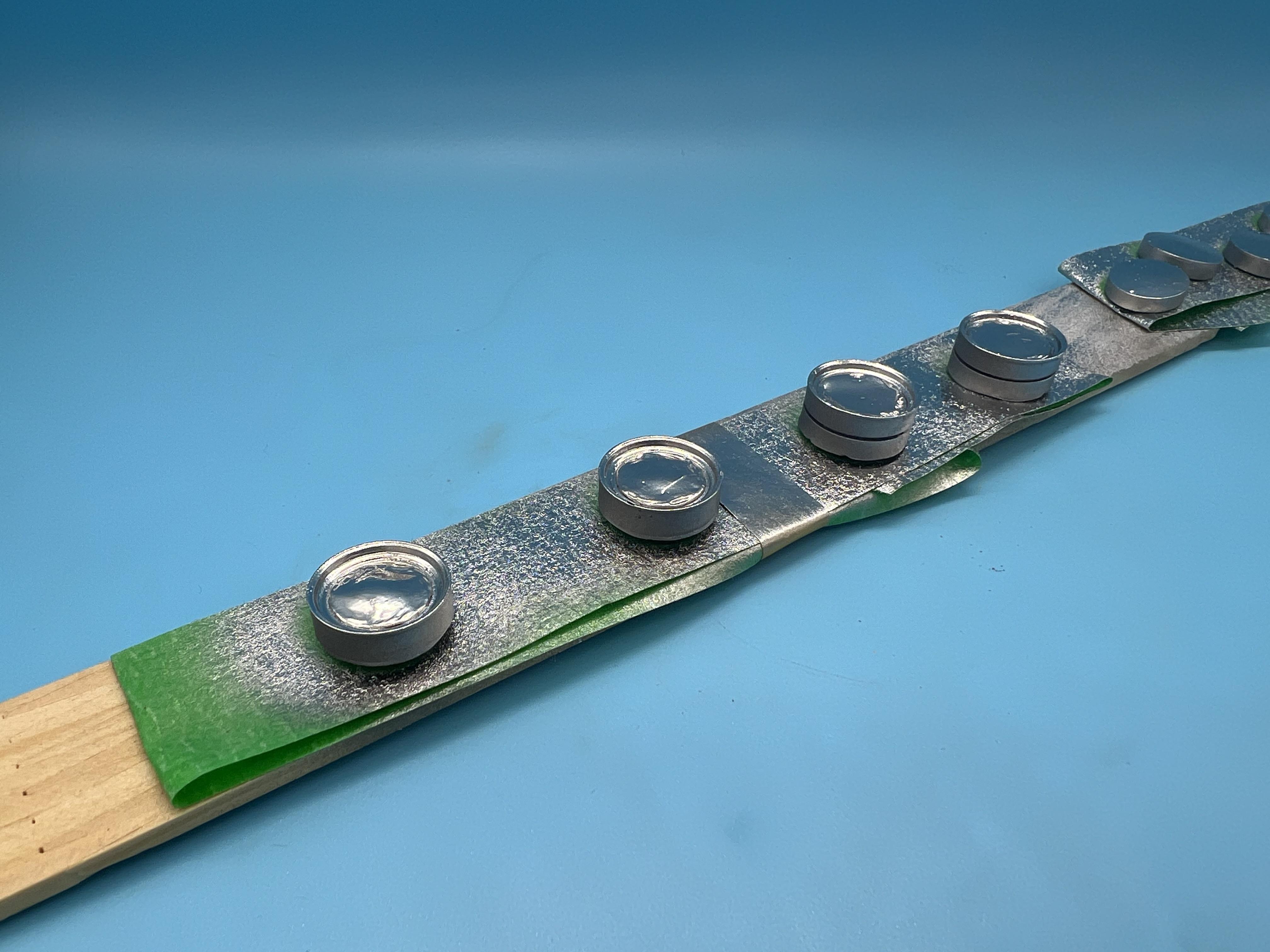

Shot a bunch of pieces in a flake silver…
And then shot the same Tamiya clear orange over top:

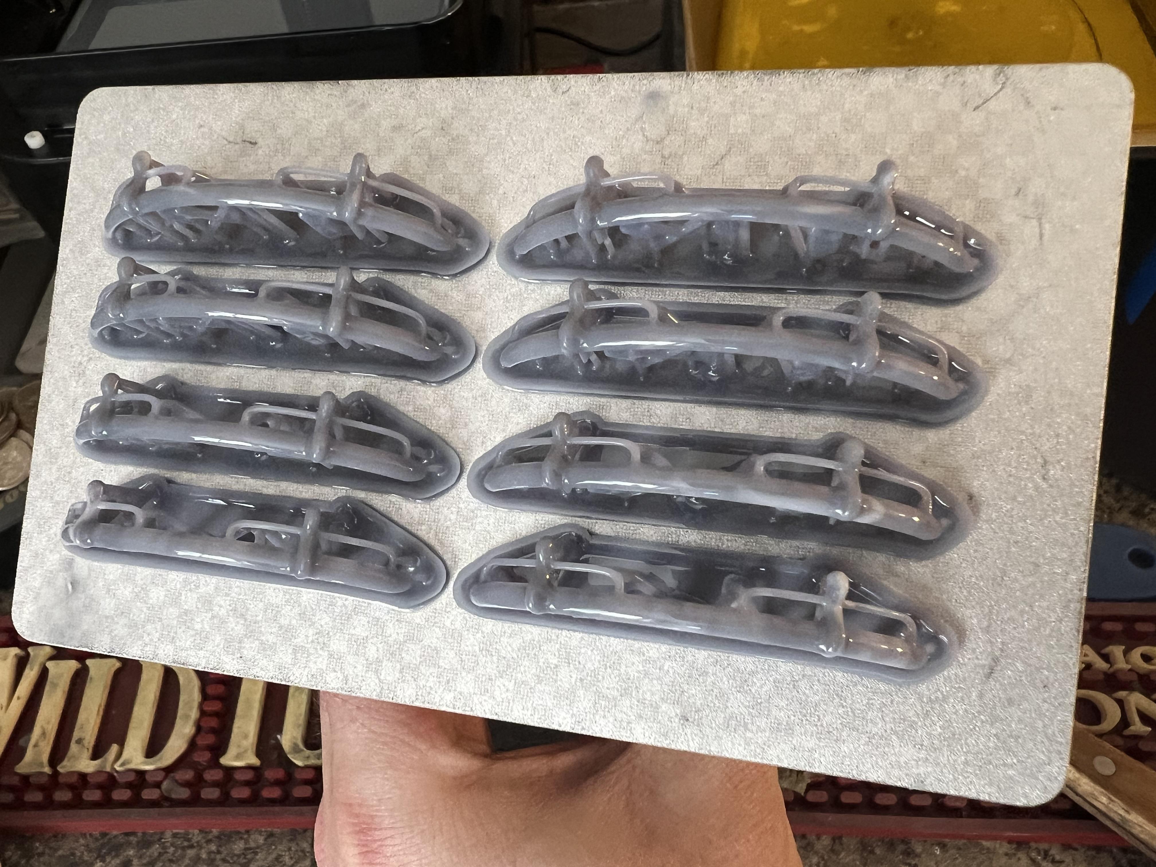

Reprinted one of the bumpers, because the first one I printed had a super-thin wall thickness and it got broken…thickened them up and made a new batch:

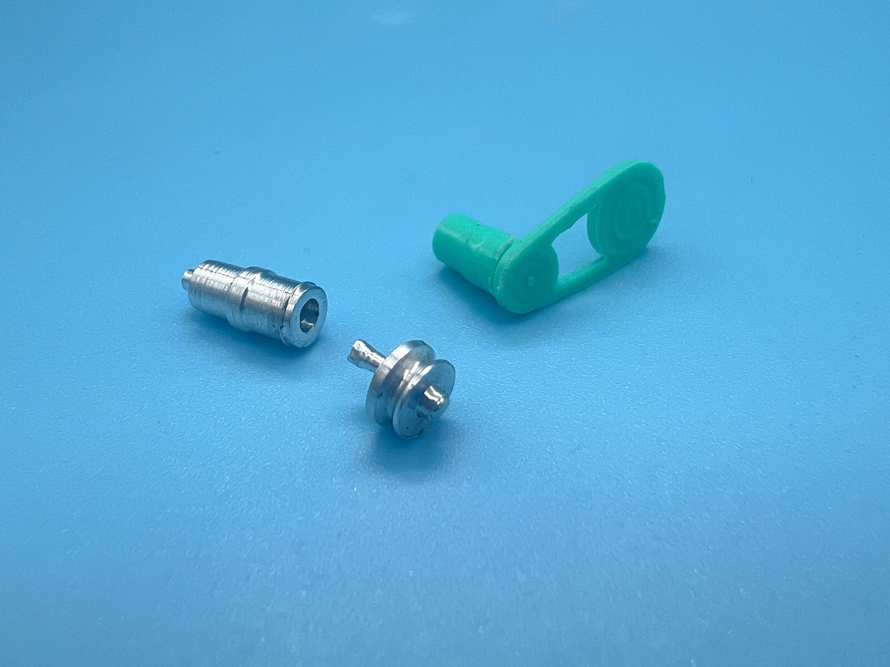

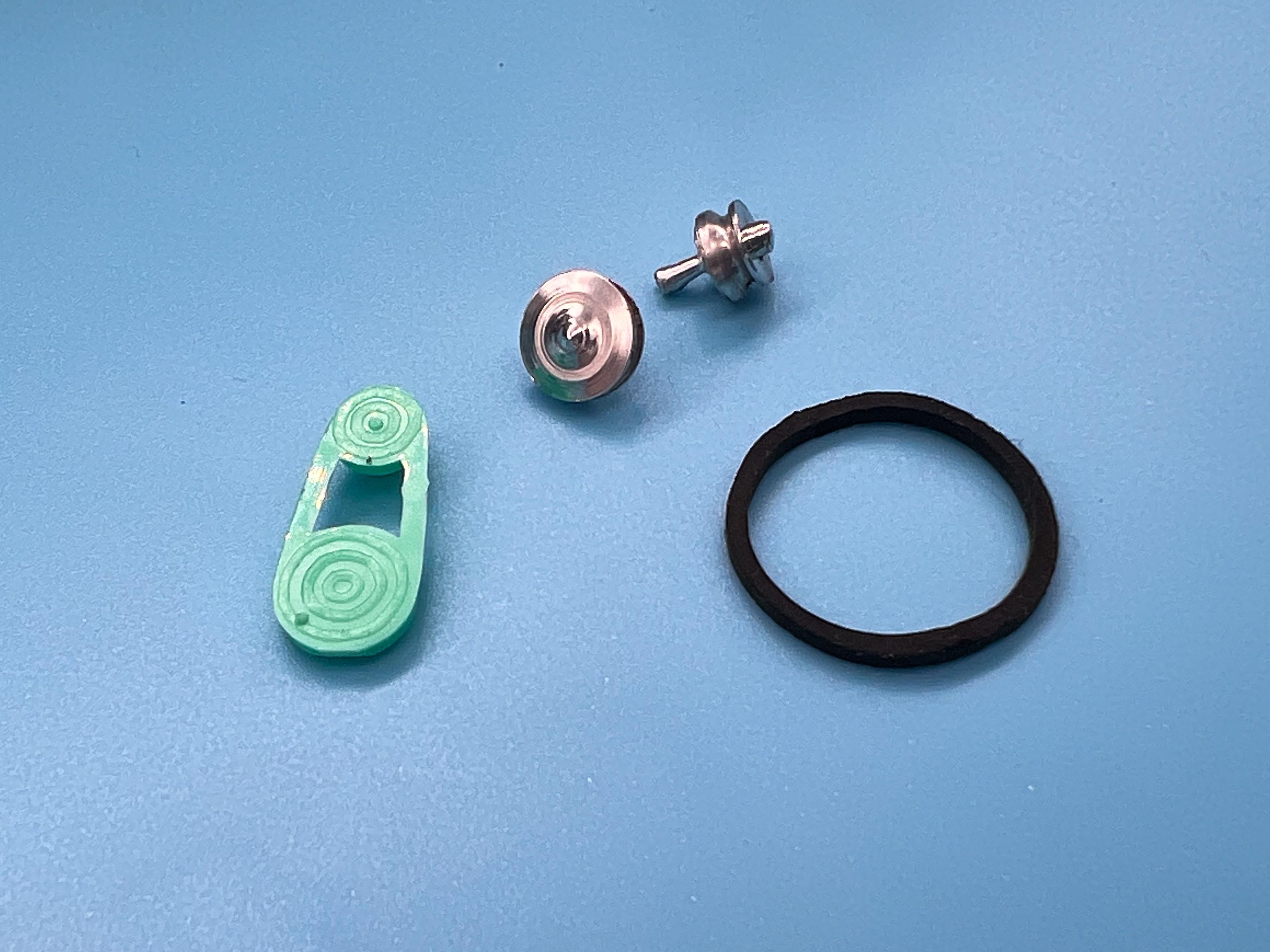

And whilst the paint is drying on the engine block I started looking through the rest of the kit pieces and identified some areas for improvement…spun some pulleys on the lathe:
Then those pulleys made the alternator (generator?) look bad, so I made one of those too:
And then the air filter looked out of place so I made one of those:

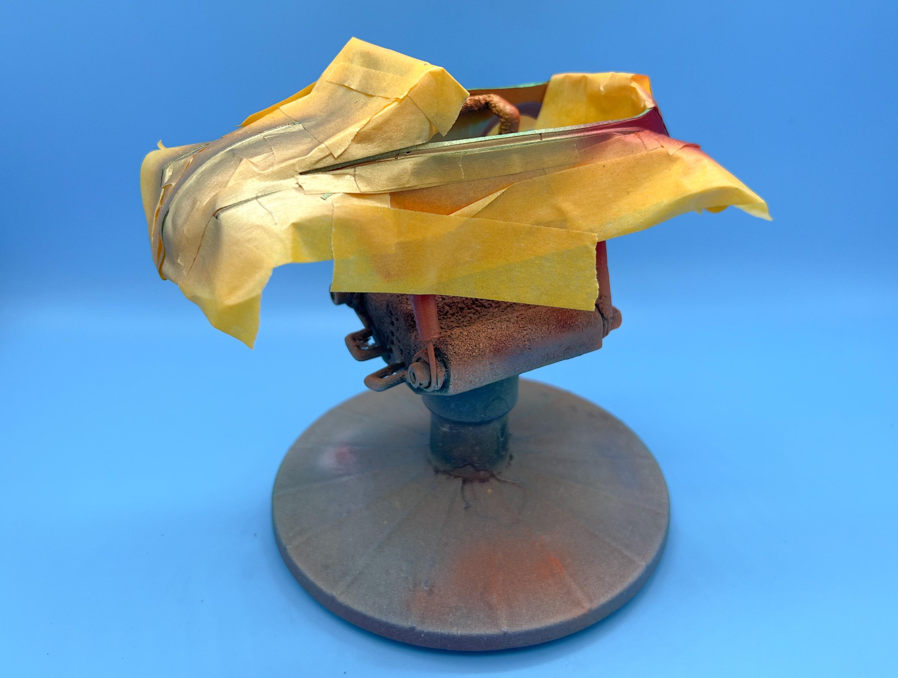

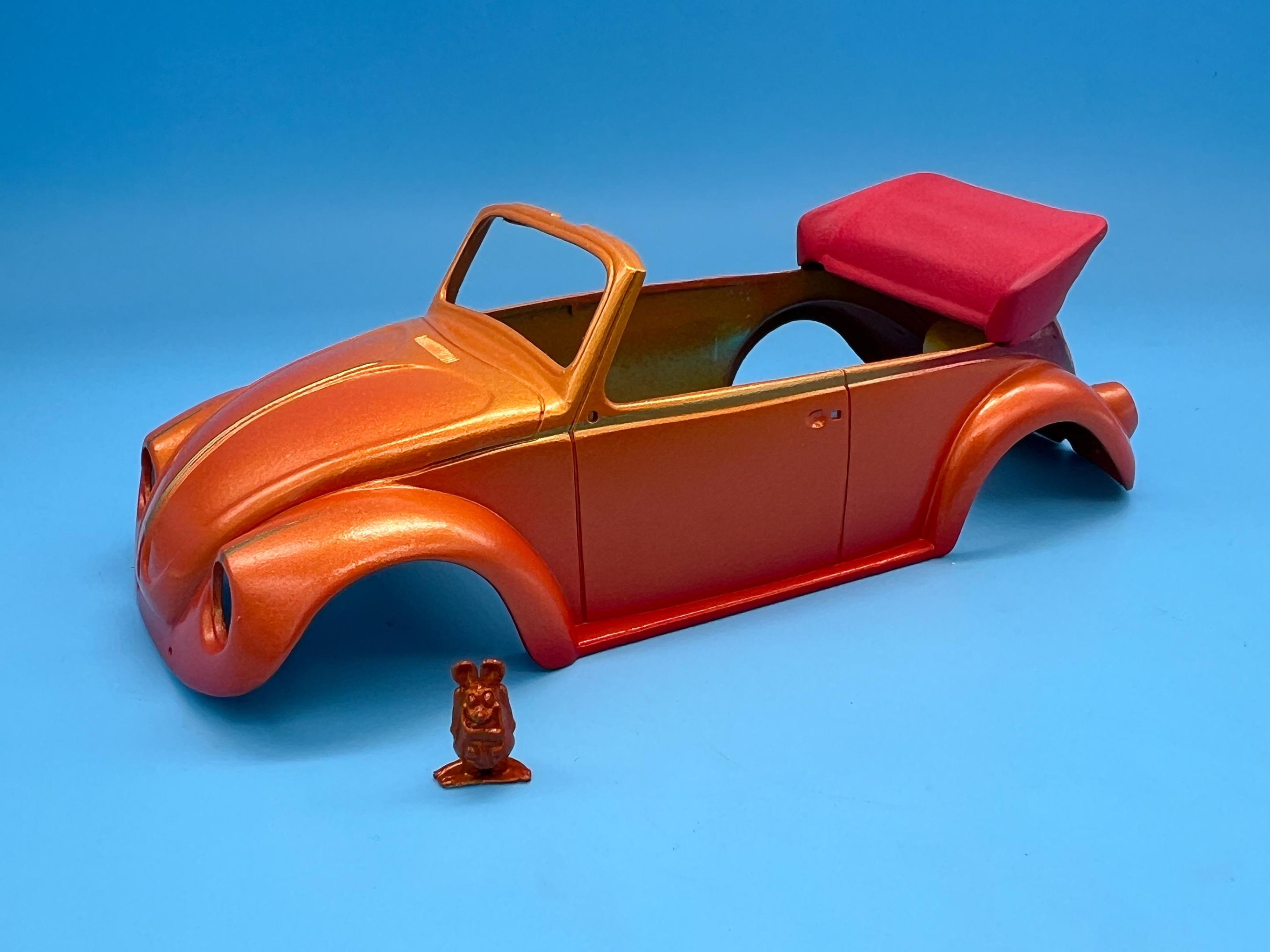

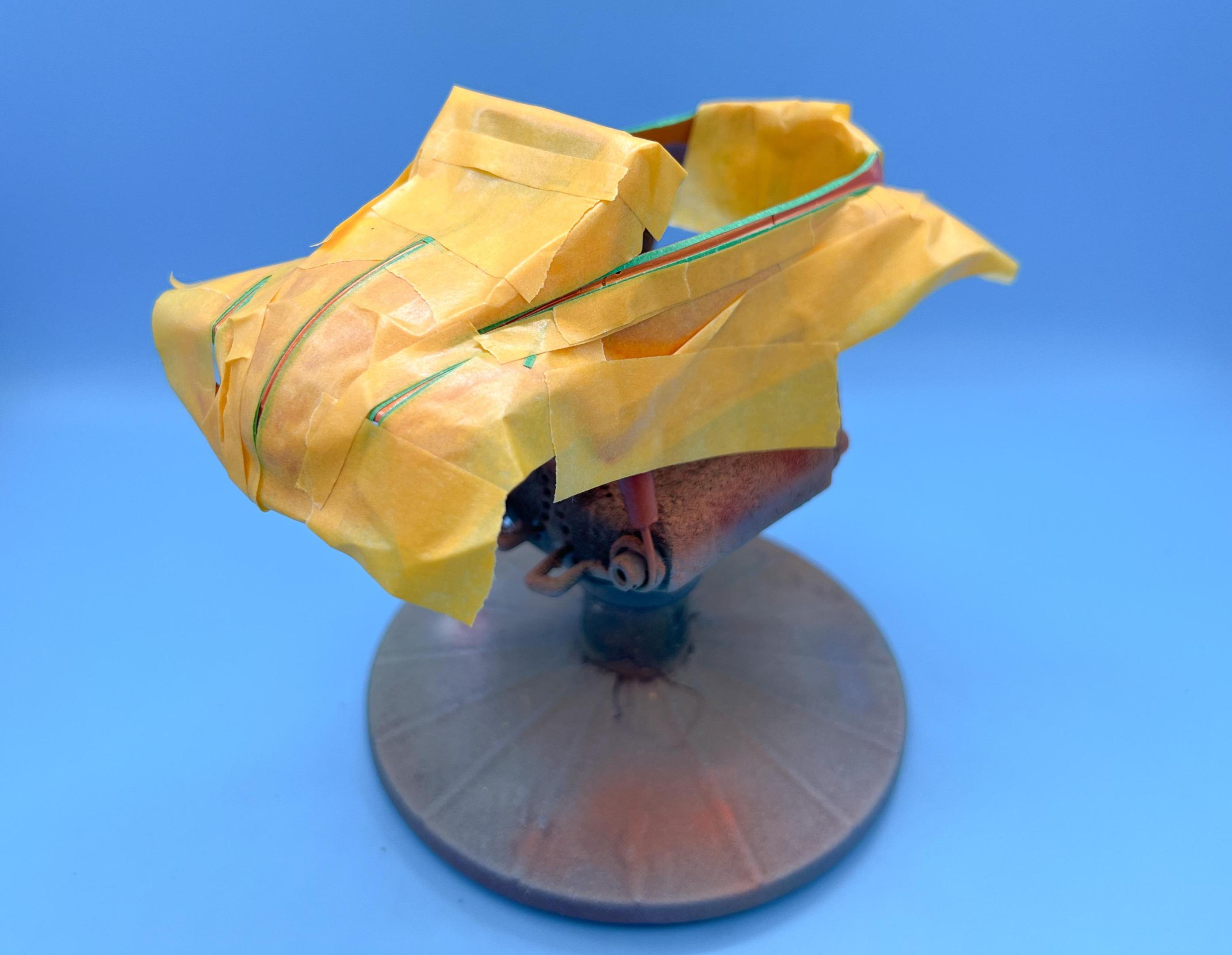

A little more today…felt brave enough to mask on the body so I laid down the next few little bits of detail painting…I’m not going WILD on this one, but had a couple of little touches I wanted to add…
All masked and ready:
All I’m doing here is adding a couple of little highlights…a couple of small scallops coming off the top of the headlamps, painting a stripe on the hood and adding a little strip of gradient along the sides…
Paint shot!
And some careful de-masking later…
Nothing too crazy, just a couple of little touches…
Whilst I was painting, I 3D printed a tiny Ratfink and shot him in Wicked Color silver then candy orange, and whilst that was drying shot the fabric roof cover with some craft acrylic that matched the color I wanted:

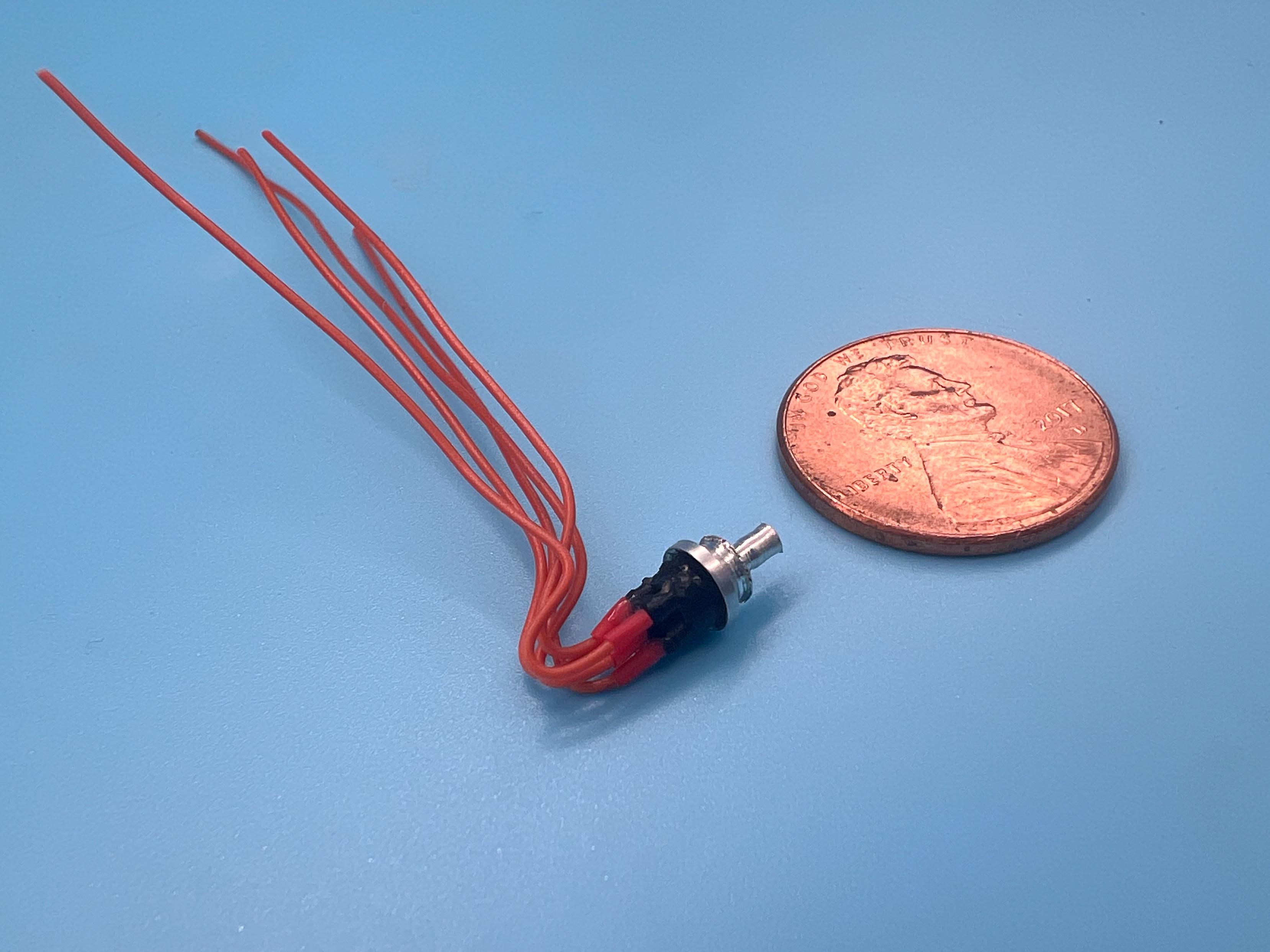

And after I didn’t feel like painting any more today, I did some more work on engine parts…the kit distributor looks undersized to me (and was going to be about impossible to wire) so I printed one and spun up a mount for it:
Even the larger one I printed is still TINY, so excuse the poor photo…
Got it painted, made some plug boots and got it wired ready for installation:

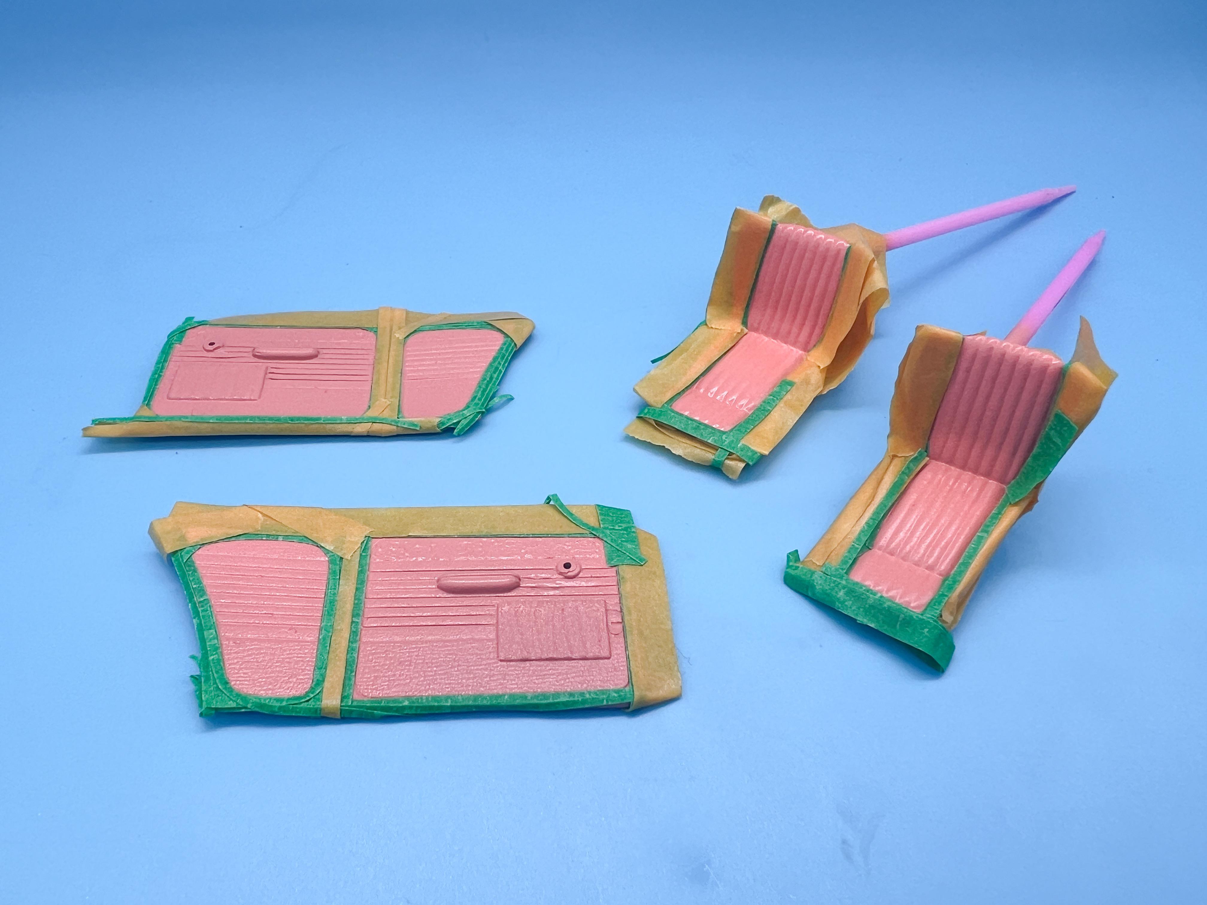

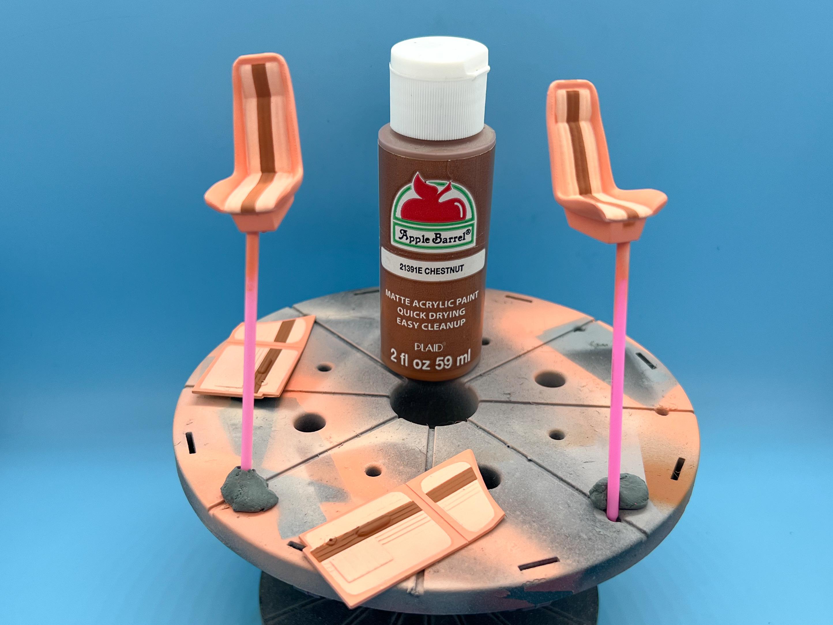

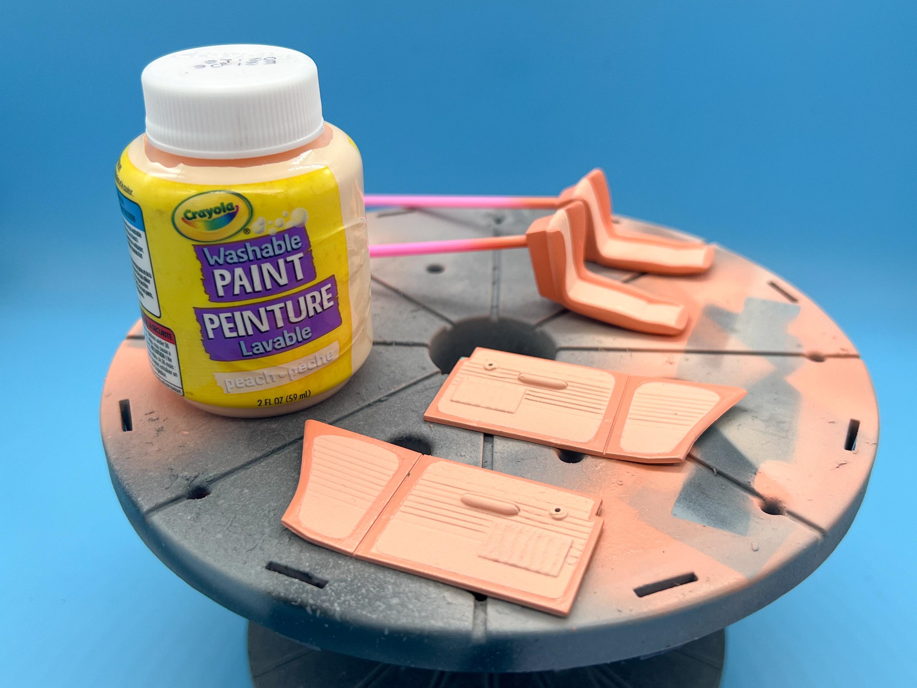

Painted the interior panels…they started off peach:
Masked them for the second color of the three I had in mind…couldn’t find the exact color I wanted in ‘regular’ paints, but this Crayola paint worked well ?
Then, shot a coat of intercoat and then remasked for the third color:
Then de-masked:

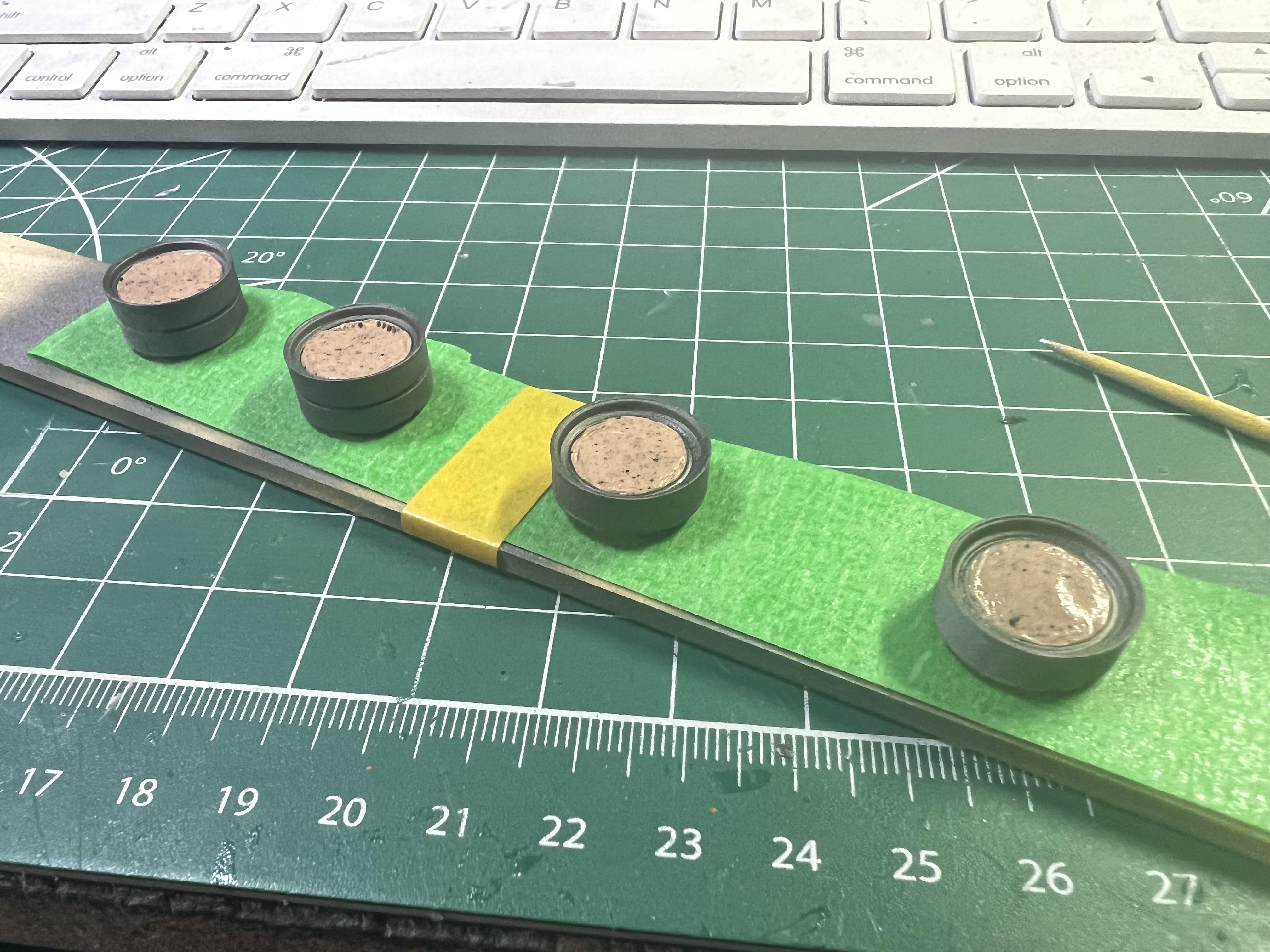

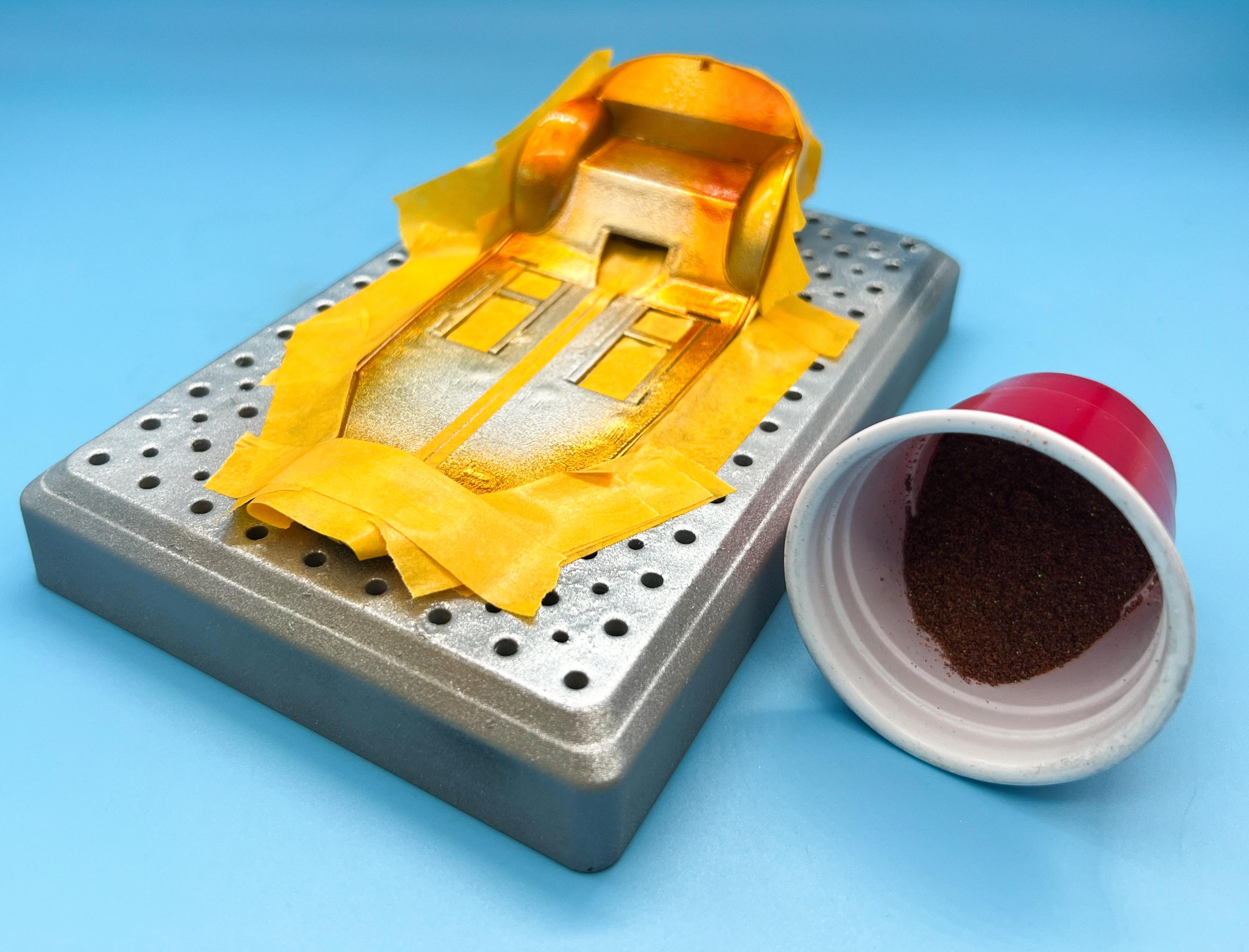

Carpet color will be brown, so that’ll tie together the orange tones and the brown on the interior (hopefully)…masked the chassis for embossing powder:
Applied some custom mixed powder over Testors brown enamel:

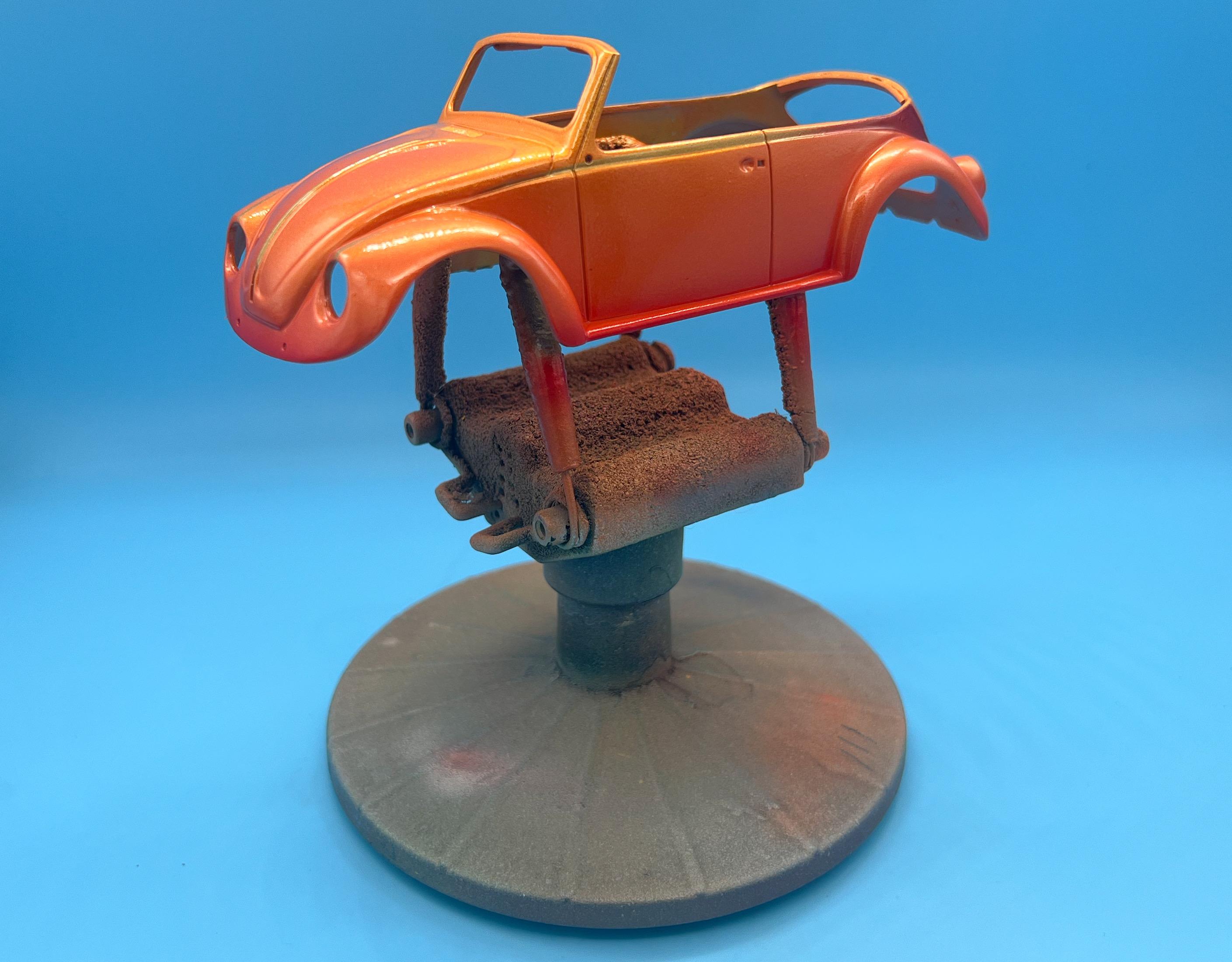

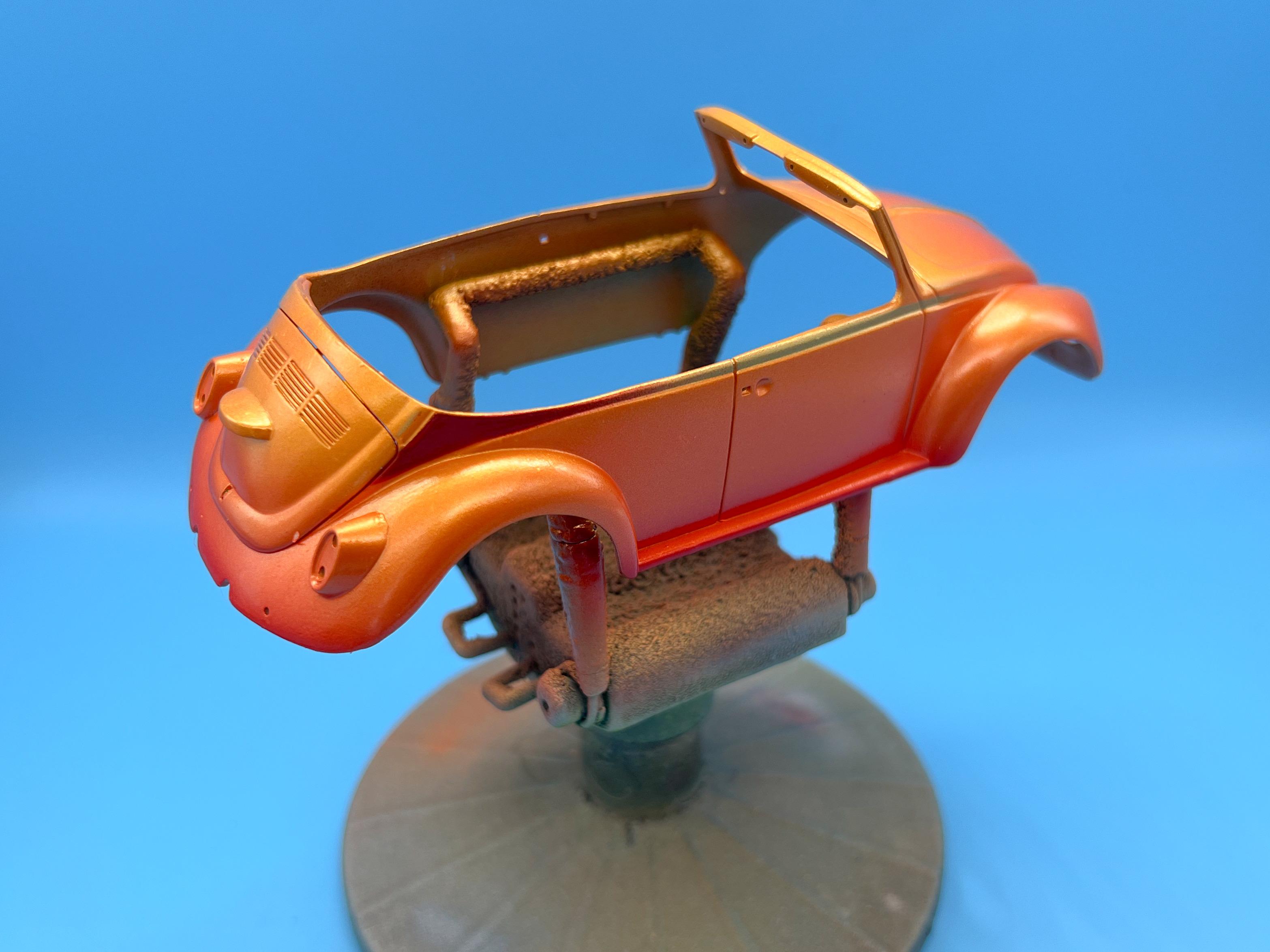

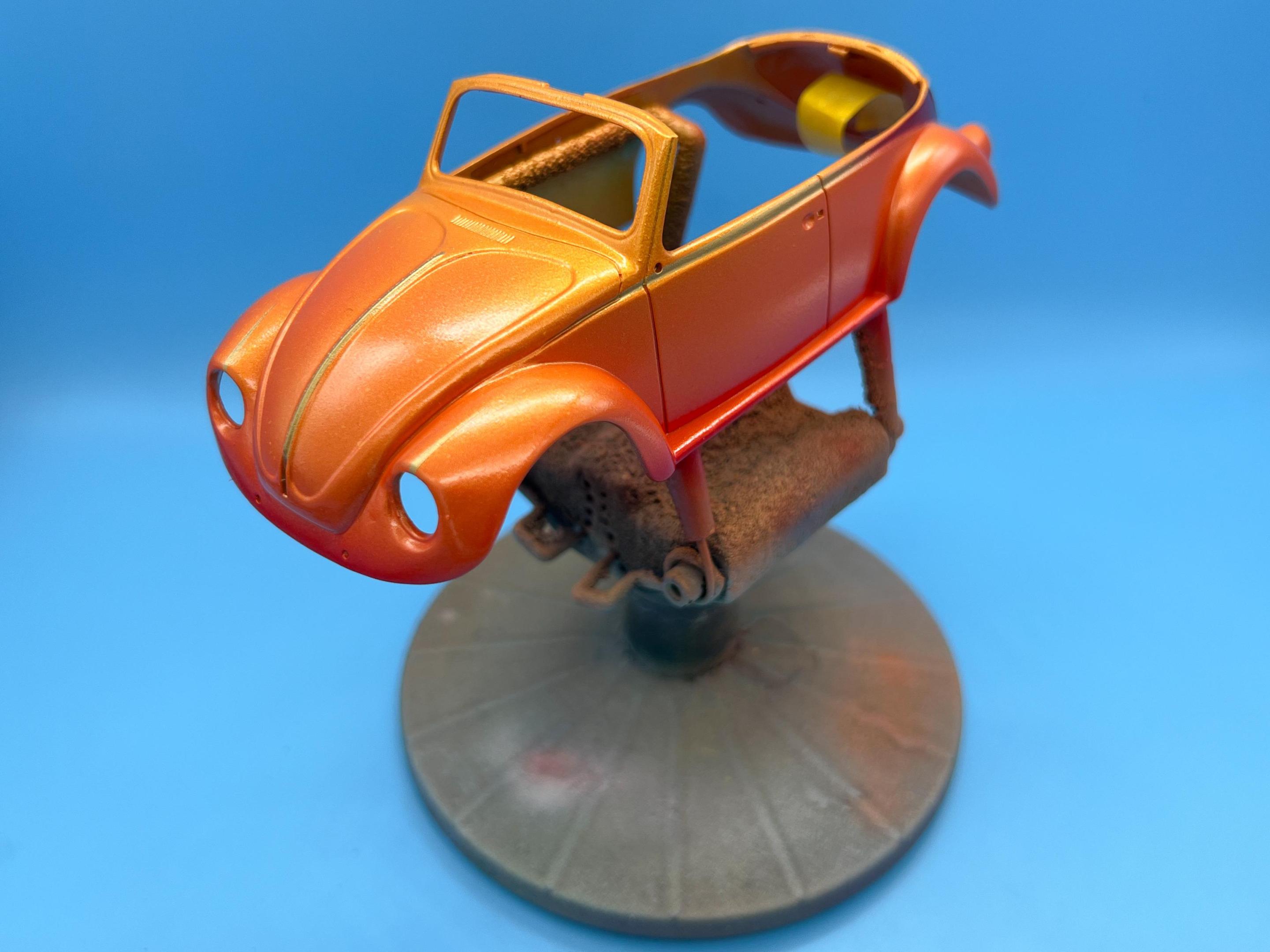

Meanwhile, have been clearcoating the body - this is coat five of seven:

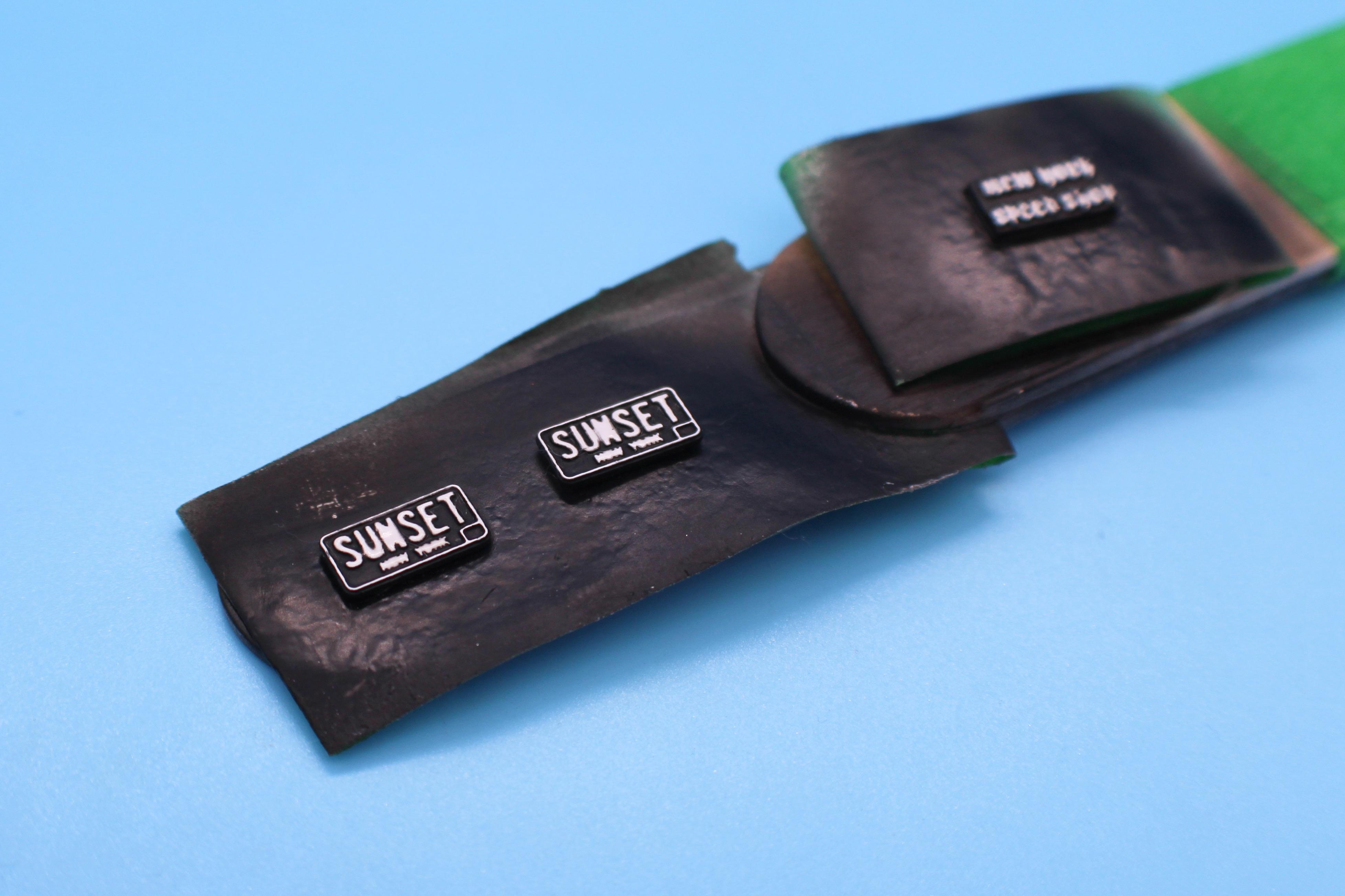

Painted the license plates, first with white, then clear lacquer, then Createx black - you can remove the Createx with an alcohol wipe, leaving the white copy and border visible:

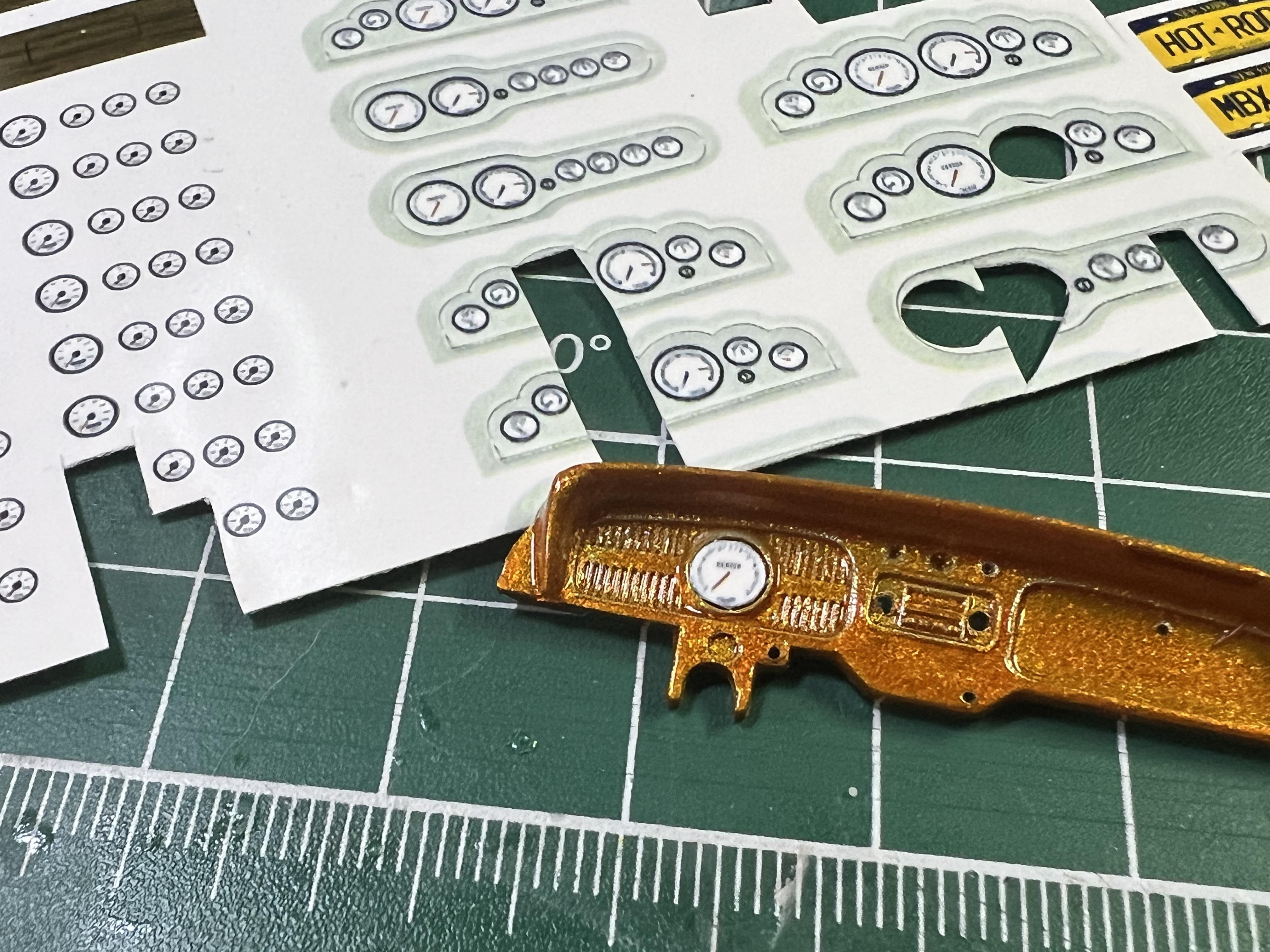

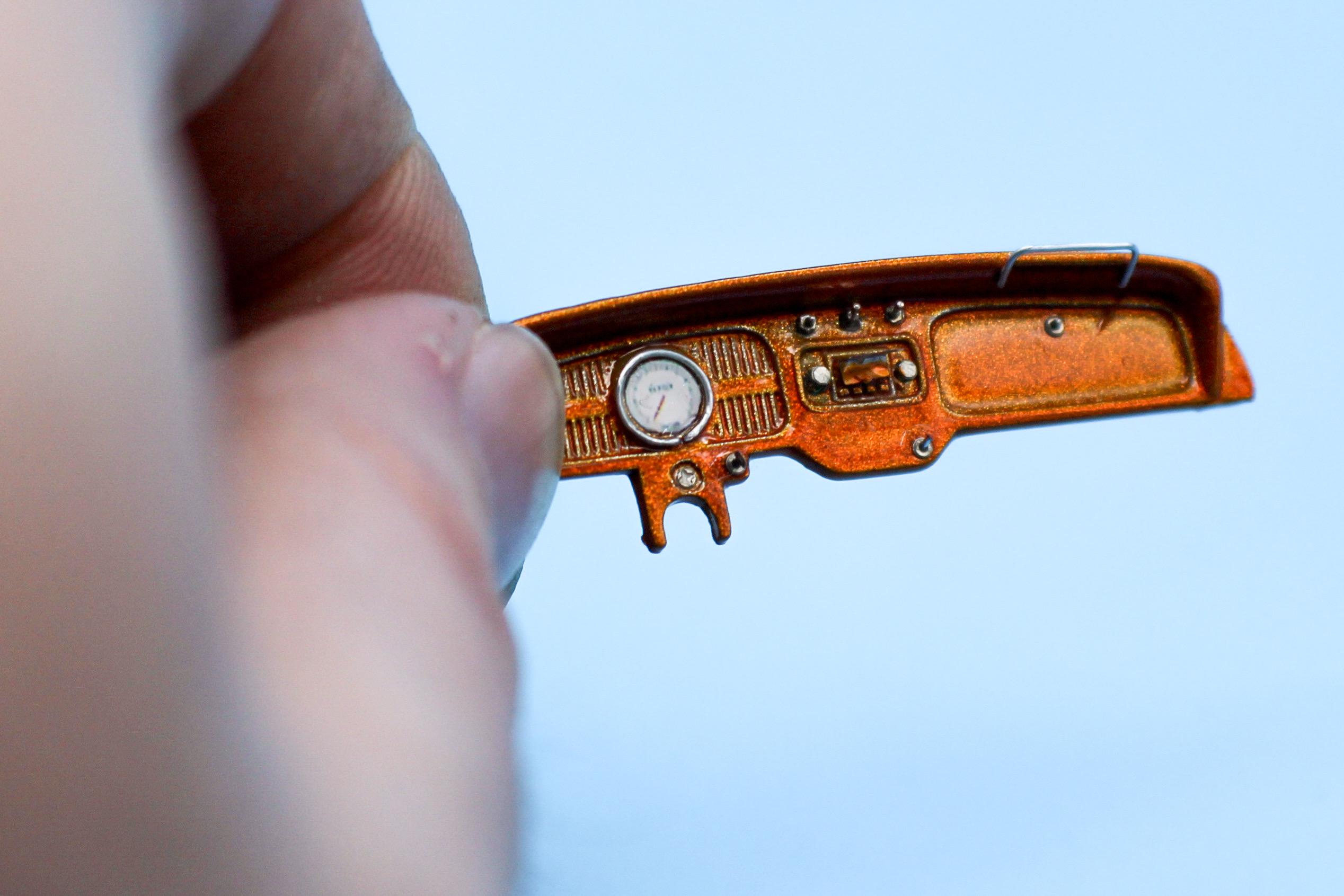

Found a gauge face that would work for the dash - it’s not super high resolution, but it’s better than the ‘no gauge face’ the kit comes with…
Then went thru the dash and started adding switches, a ring for the speedo and some photoetch…not quite done with this yet, but the little metal switches really catch the eye and add some nice detail when you see it in real life:

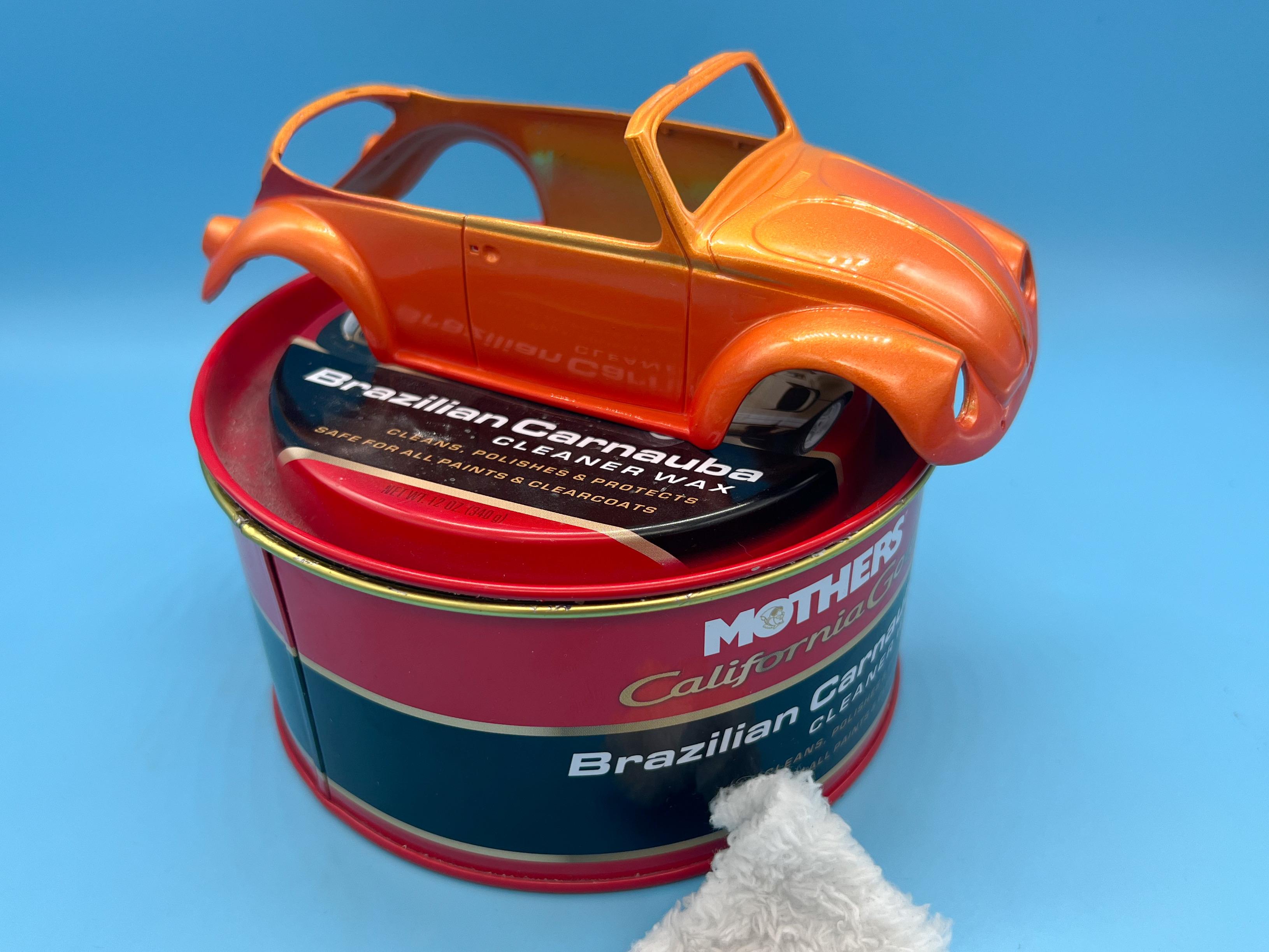

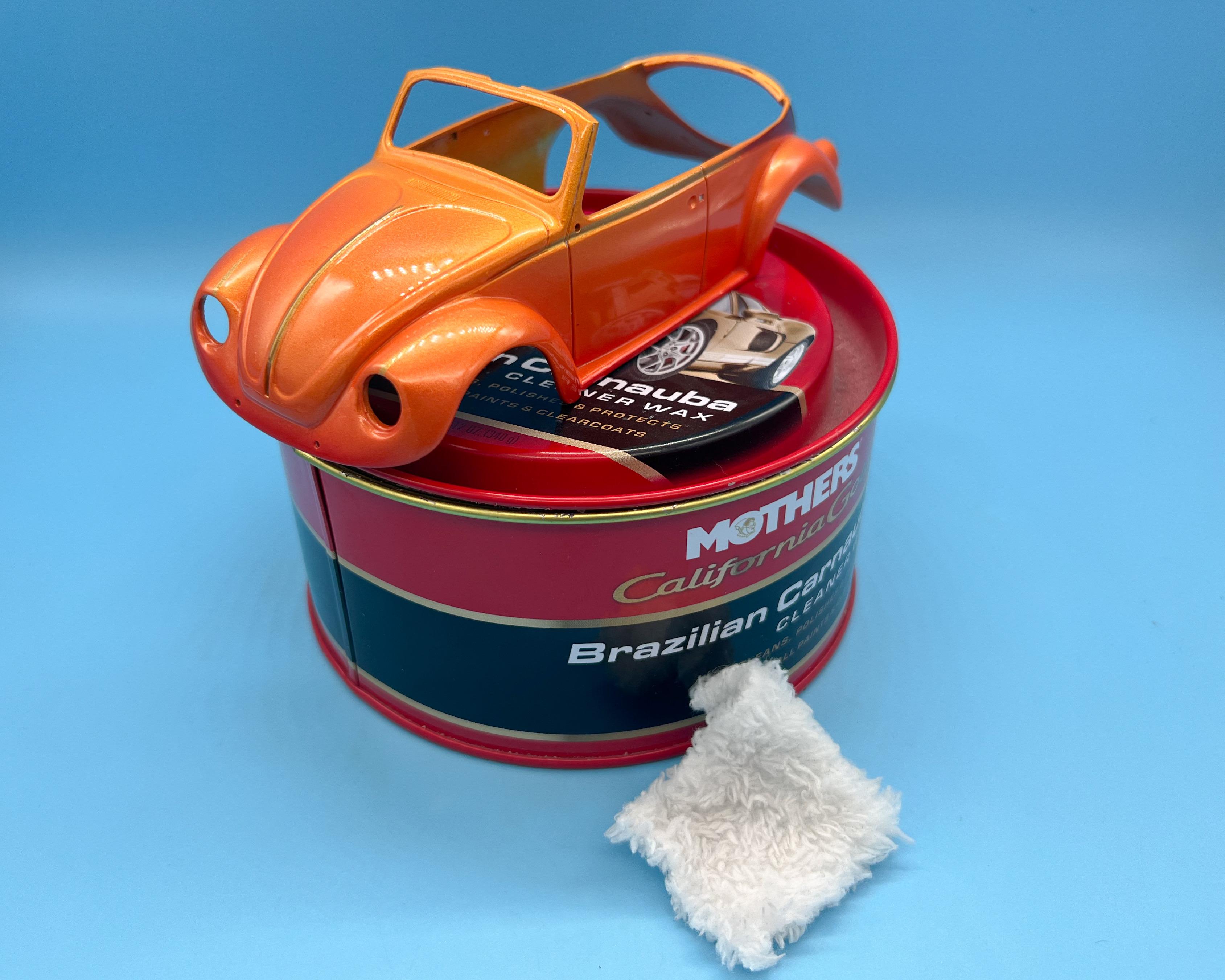

Got the body mostly polished out and waxed:

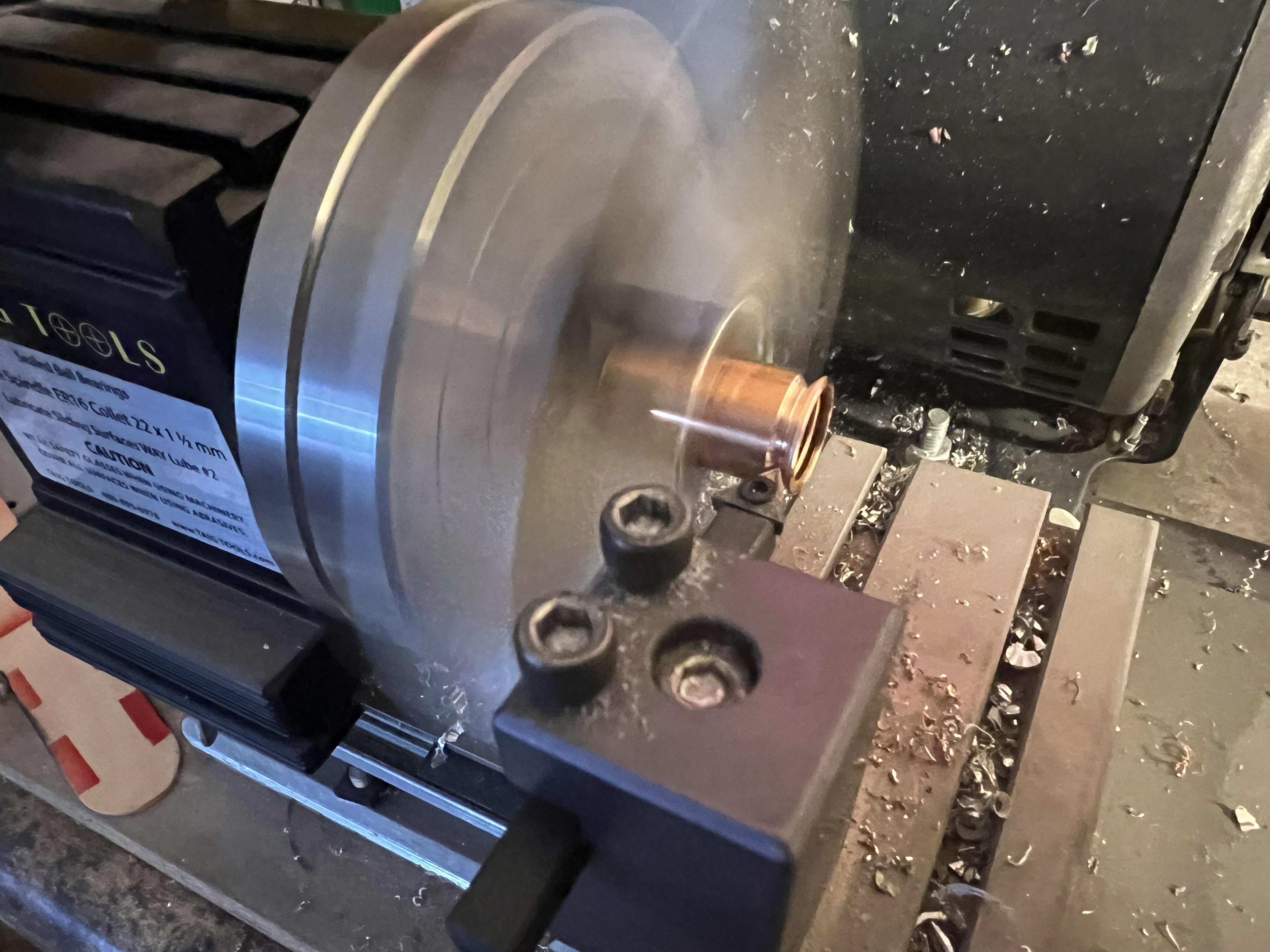

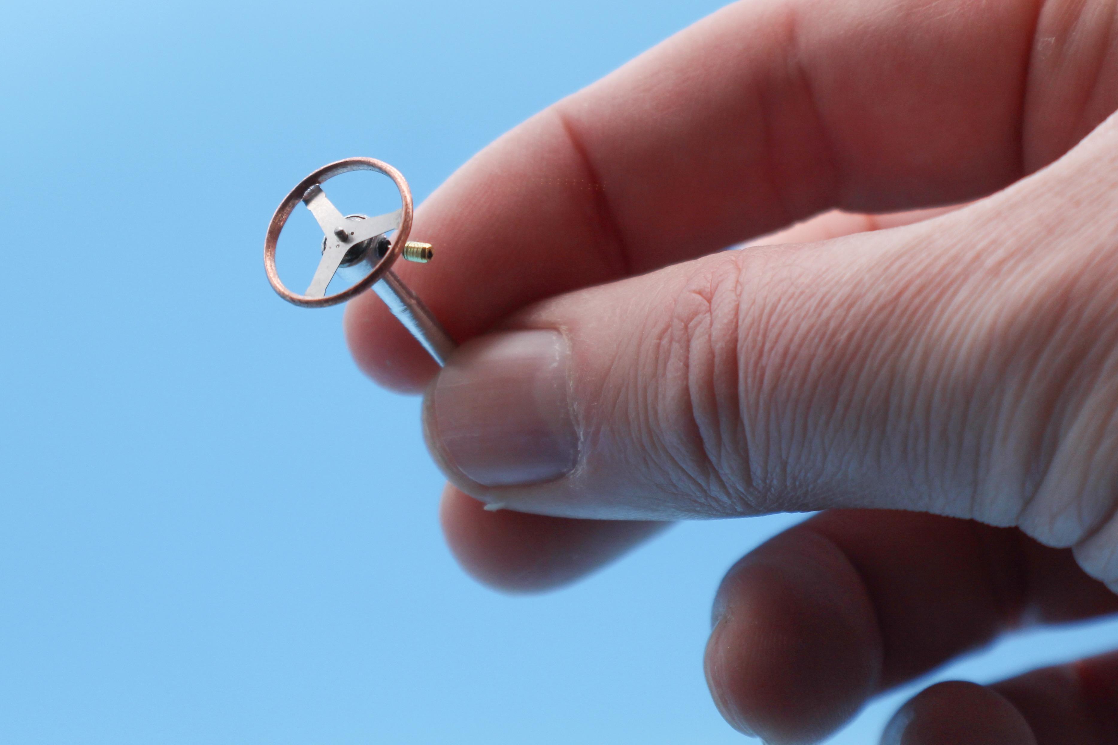

I was determined to use a photoetch center section for the steering wheel, but couldn’t find a spare hoop that would work…decided to fire up the lathe:
And just made one…
I was planning on painting it, but the color of the copper DOES kinda work well with the theme…need to decide on what to do with the center cap too…right now it’s just a little threaded bar that the wheel spins onto…

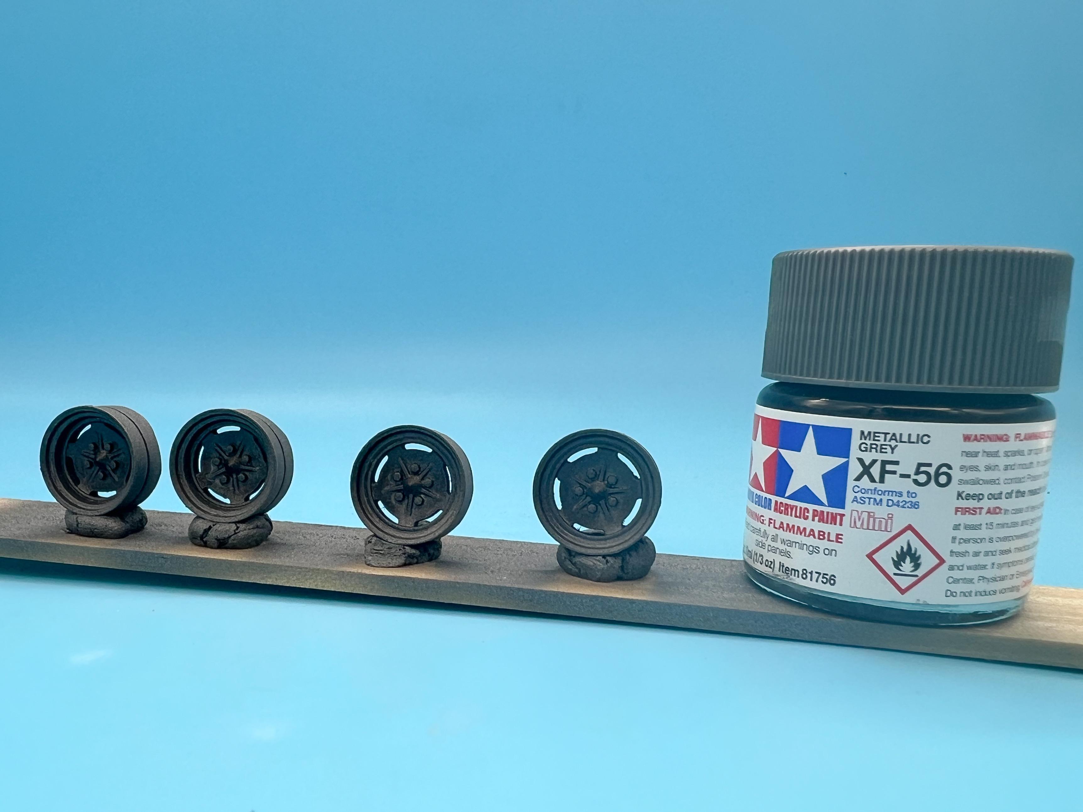

Speaking of wheels, I wanted a gunmetal center for the wheels with a billet-looking outer, so I shot some Tamiya acrylic…
…then a coat of intercoat, then masked with some Silly Putty:
Note: if you leave Silly Putty for a few minutes it’ll start to flatten itself out and seals the edges really nicely…
Next some Hyperchrome over the satin silver:
And some careful de-masking…(and a silver pen for the lugs…)
