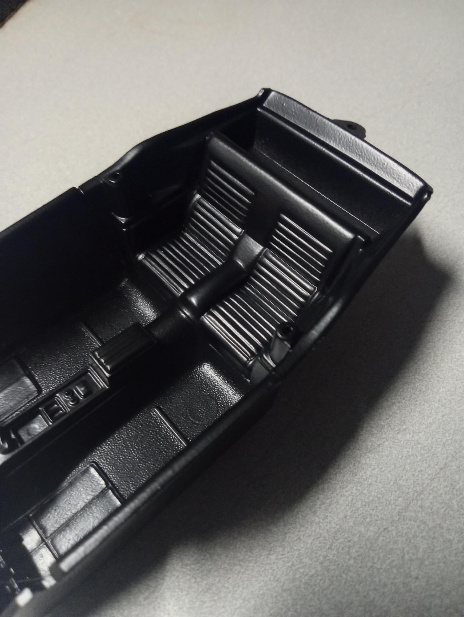

Sledsel Posted February 16, 2024 Posted February 16, 2024 (edited) I did an experiment today on an interior I wanted black, but in my experiences flat black and satin black never had the right sheen. I took this Mustang interior tub and primed it with black primer and then coated it with vinyl dye/paint. I think it came out great, I have some red and some gray vinyl dye I'm going to try on some junk interiors. I will post results. Edited February 18, 2024 by Sledsel 5
JollySipper Posted February 16, 2024 Posted February 16, 2024 I like using vinyl dye for interiors! I've used it on a few now...... It does have just the right shine to it! It looks and works better if you prime first..... 4

peteski Posted February 16, 2024 Posted February 16, 2024 (edited) It is actually a type of paint, not a dye. Dye basically gets absorbed into the material being dyed. Thinks of tie-dyed t-shirts. This stuff (like paint) remains on the surface. But it adheres to the painted surface really well, and it is flexible. I used the white color spray to paint whitewalls on vinyl tires of a Pocher 1:8 scale car. I use the SEM brand (bought at a body shop supplies store) Edited February 16, 2024 by peteski 5

peteski Posted February 17, 2024 Posted February 17, 2024 Just a warning: These paints are fairly "hot". If sprayed on heavily they might slightly craze some kit's plastics. 2
