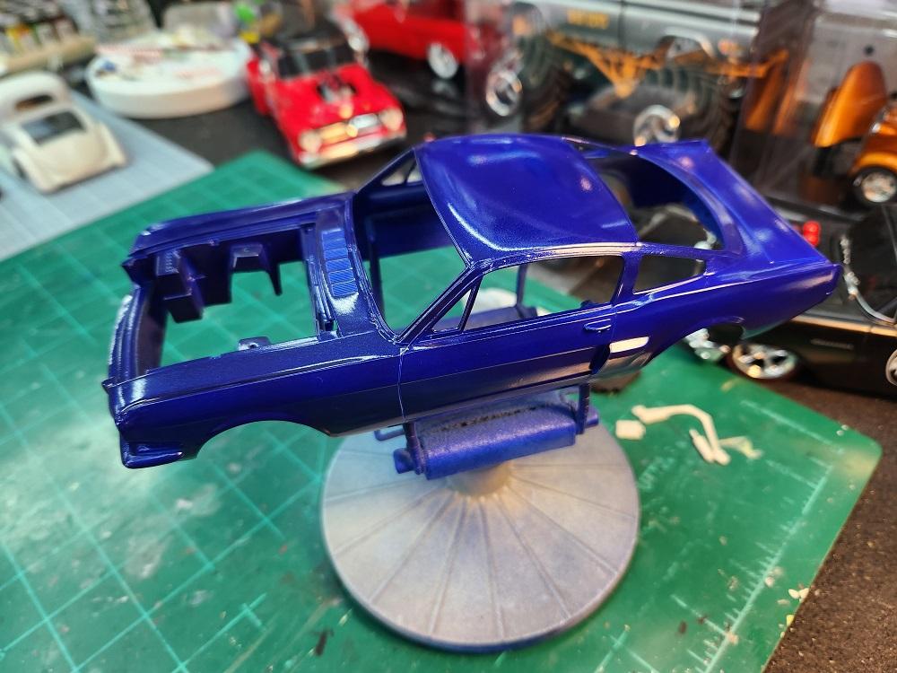

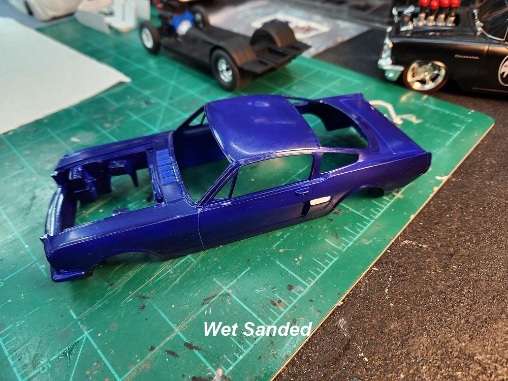

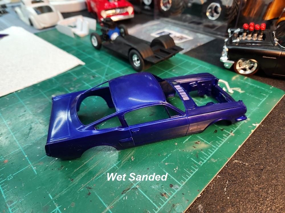

I got some paint on the body yesterday.  The results were not what I expected so this morning I started wet sanding.  I don't use rattle cans when I paint the bodies as it's normally hit and miss for me.  I normally don't wet sand the paint but this time it needed it.  I'm going to go ahead and shoot the clear on it when the weather it right.  If it doesn't look right it will be stripped.

Looks great my friend, really is a nice blue!!
Thanks man.  We'll see how it looks when I hit it with some clear.

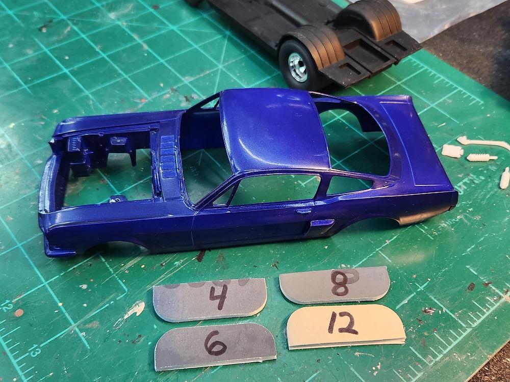

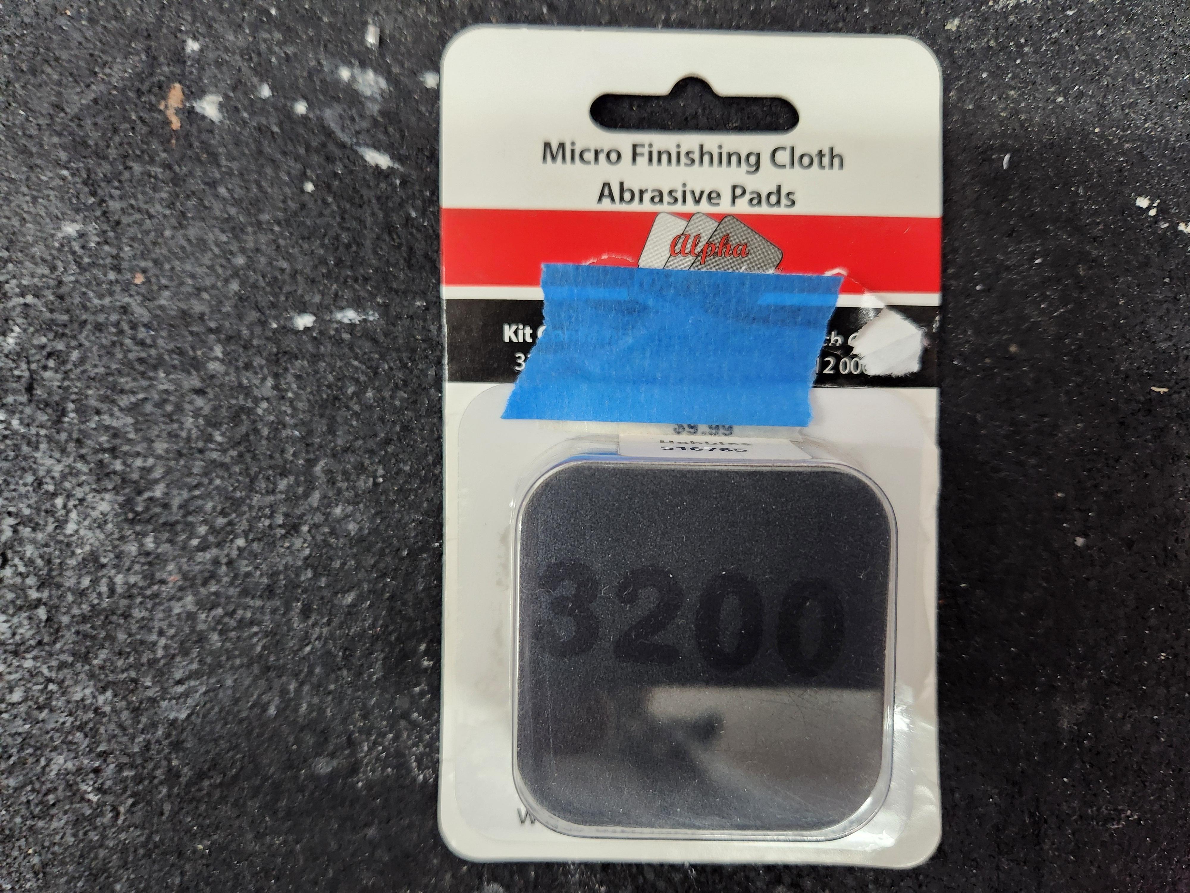

This morning I decided to go over the body one more time with the 4,000, 6,000, 8,000, and 12,000 grit in an attempt to get the paint as flat as possible without burning through.  The jury is still out on this one fellows.  Hoping to shoot some clear on this tomorrow and that will show if I did a good enough job of wet sanding.

What are those sanding pads and where can I find them. Any way love the kolor.
Thanks.  I bought them at Hobby Lobby and cut them into smaller pieces.

Fingers crossed. Love the color, hope you can save it.

I hear ya dude.  Like my granddaddy used to say, hope for the best and expect the worst.

Looking good Bob. I like that blue.
Thanks James.  It's a good looking blue if I can get it flattened out enough to look good.

Looking good Bob. You always seem to hit the rough road when your painting the body. Try shooting your paint alittle closer so as not to get that orange peel. Distance and speed is the key to getting a flat paint job. You know how to paint, Just make some small adjustments and you will have those results you are expecting.
Thanks.  Well, I'm about 4" to 6" away so can't get any closer.  Only time will tell.

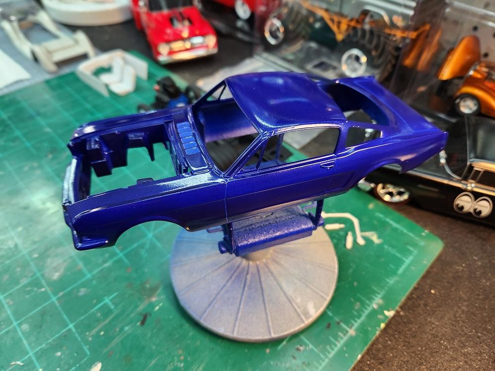

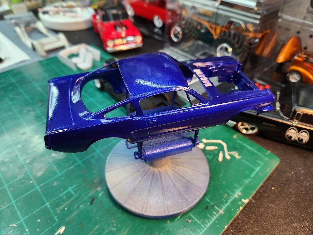

I got the clear on the Mustang.  Not to sure.  It's in the Dehydrator for about 10 hrs then wet sand and polish.  Well see.  At this point I'm not a big fan of what I see.

I am sorry, but I think your gut may be right. I hope I am wrong and you can smooth it out without burn through. Fingers crossed.
