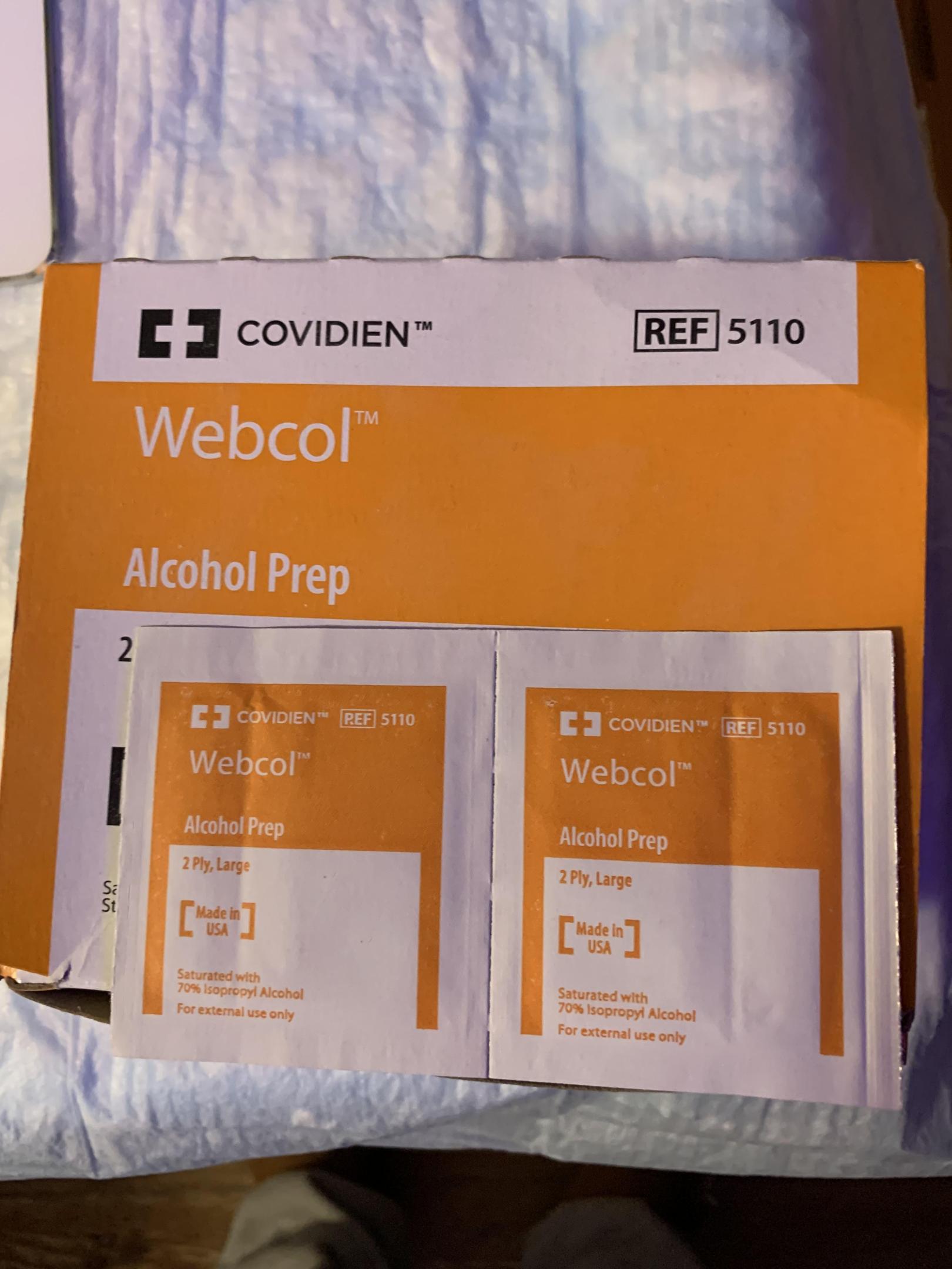

Those alcohol wipes look like a neat idea.
I have recently picked up a microfibre cloth, the type used for cleaning eye glasses, but haven't tried it yet. After giving it a good cleaning I'm going to try it as a lint-free wipe with alcohol.

Really appreciate all these suggestions, everyone. Model has been stripped, but before I get try again, I think I'll try wiping with the alcohol on a test piece and see how that goes. I've got some of those little alcohol wipes as well. Great idea. A new tack rag is definitely in order as well.
