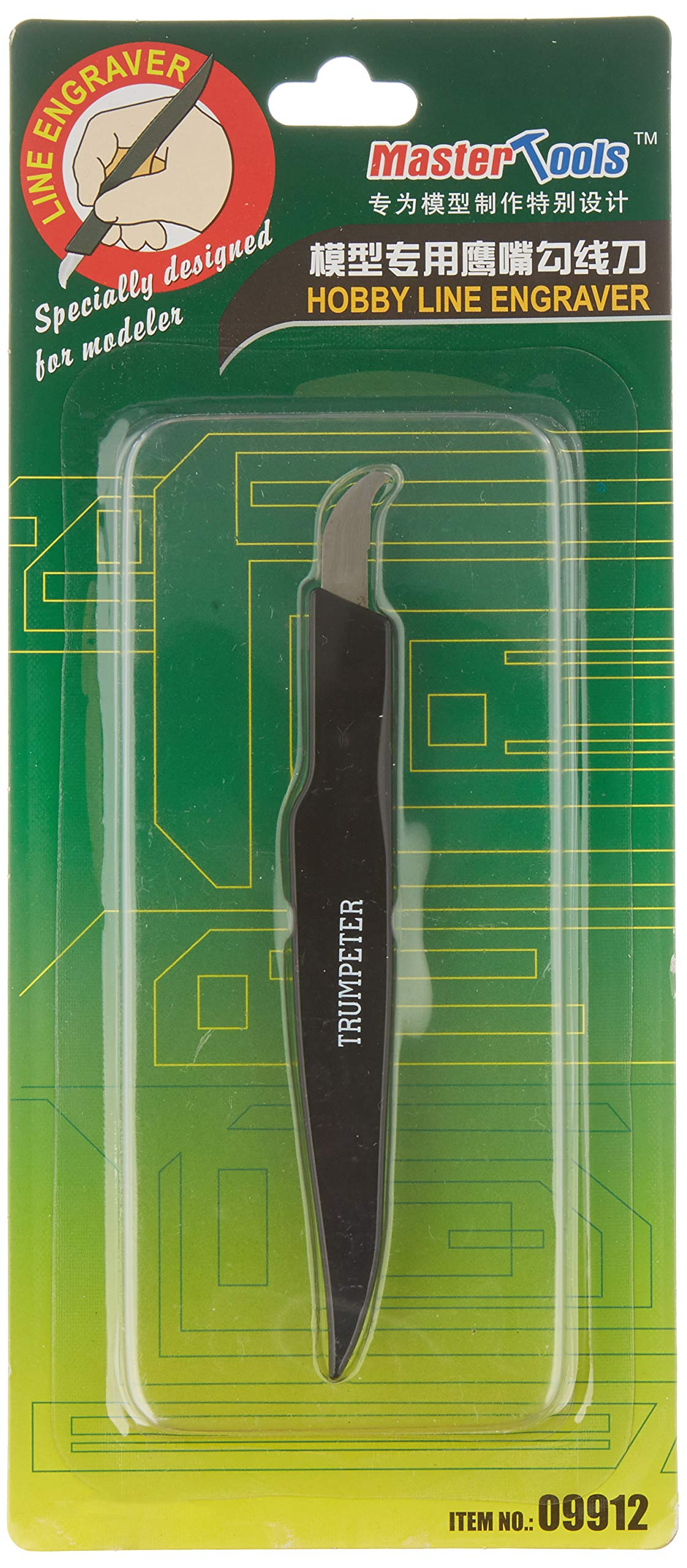

Ace-Garageguy Posted March 18, 2024 Posted March 18, 2024 You might try the Tamiya engraver tools, as they "scribe" by taking a very fine curl of material out of the cut, rather than brutally scratching like the "backside of a #11 blade" does. Used very gently, they MIGHT work for deepening panel lines post-paint, but they're not cheap. They are, however, worth every penny to me for the beautiful pre-paint scribing they're capable of delivering once you learn to use 'em.

Ace-Garageguy Posted March 18, 2024 Posted March 18, 2024 4 minutes ago, gman said: The majority of the time I scribe panel lines to deepen them, it raises the surrounding areas a bit... ...which is the reason for using a tool with a ground, hooked tip that cuts like the Tamiya engravers (which you can make yourself with a grinder) by removing a "curl" of material on the backstroke, deepening the groove without displacing material to either side.

Ace-Garageguy Posted March 20, 2024 Posted March 20, 2024 On 3/19/2024 at 2:55 AM, gman said: I haven't tried the Tamiya scriber, but will give it a shot if I can locate one locally. The Tamiya engravers are pretty spendy for a tool you might not like. This Trumpeter tool cuts a curl on the backstroke like the Tamiya tool, but is a lot cheaper, if you just want to get a feel for how they work. I bought mine at HobbyTown.
