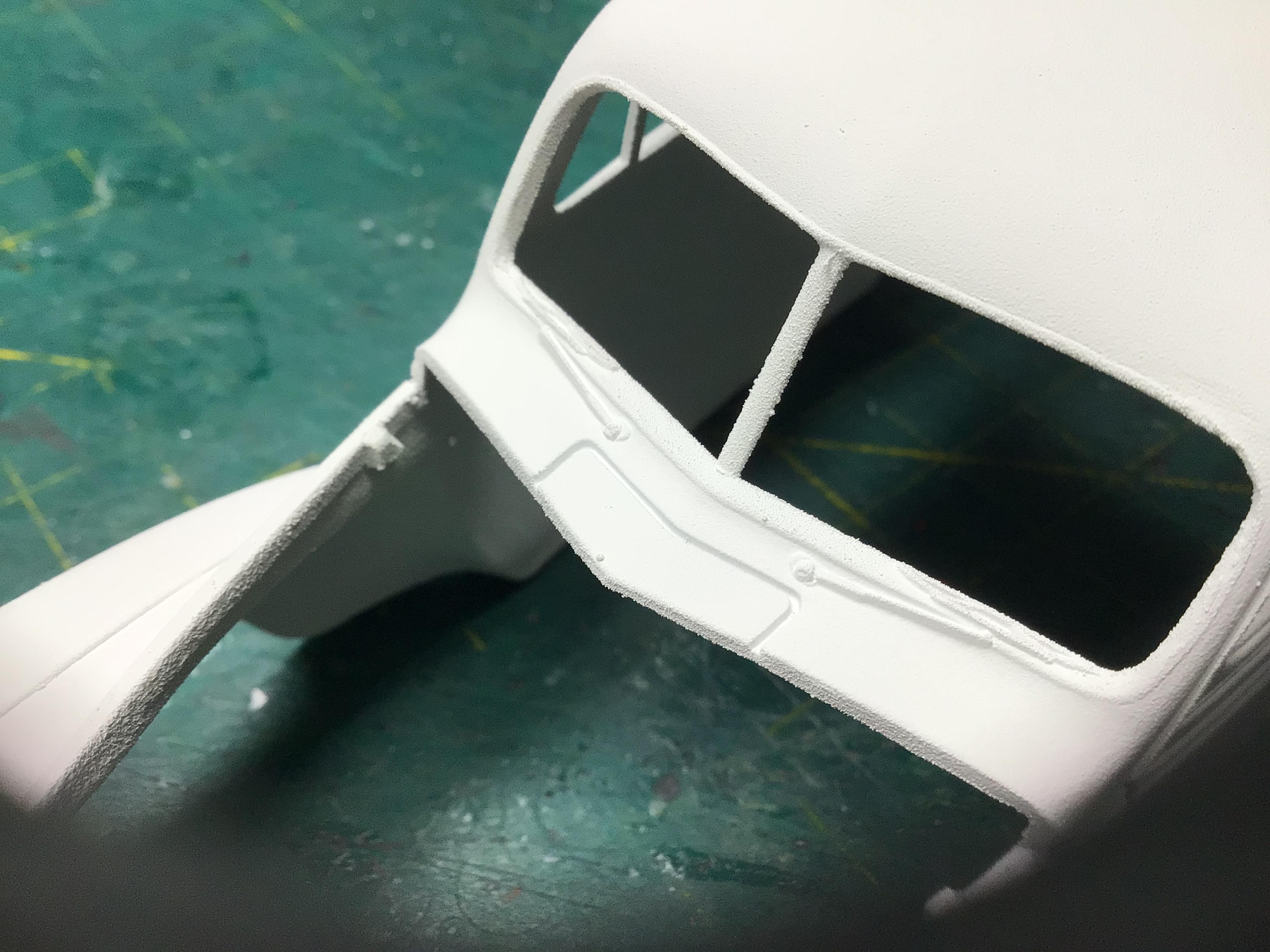

NOBLNG Posted April 2, 2024 Posted April 2, 2024 I just bought this can the other day. I shook it for over 2 minutes after the ball lossened. Temperature in my garage is about 60F and 34% humidity. I sprayed it from probably 8-10” away. It looks like it has dried before hitting the surface? It comes off like chalk on my fingers (not right down to bare plastic) after sitting in the dehydrator overnight. Any Ideas? I will definitely do some tests before trying it on a model again. Thankfully it washed off after a short soak in Super Clean.
Ace-Garageguy Posted April 2, 2024 Posted April 2, 2024 (edited) Boy, you guys have more problems with Duplicolor primers. That definitely looks like extreme dry-spray. But every time I've shot the stuff, it's slicked out just real nice. Either they've changed all the formulas, or...something else. Edited April 2, 2024 by Ace-Garageguy 2

stitchdup Posted April 2, 2024 Posted April 2, 2024 I've had 2 cans do that recently. i think it might be unmixed pigments in the straw as both cans cleared up after a little spraying. mine looked even more fibrous than that, almost like carpet, lol. both tins i had the problem with were filler primer and both were well shaken beforehand. I've got a jar next my booth now to do the first wee squirt into to be sure it safe

Pierre_tec Posted April 2, 2024 Posted April 2, 2024 My bet is paint distance, or maybe a dirty nozzle. I like to keep a rag with thinner, to clean the nozzle after every spray pass

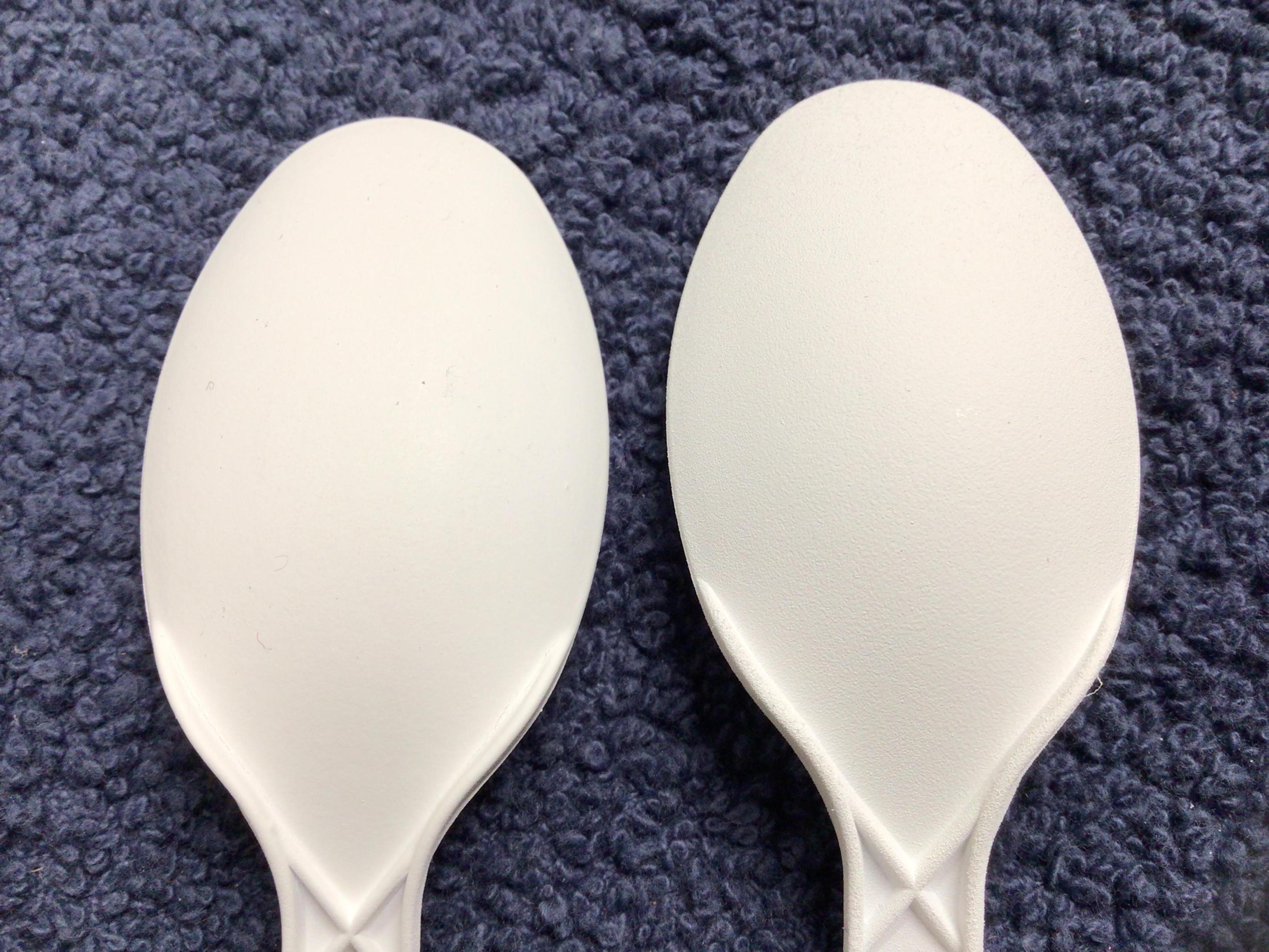

NOBLNG Posted April 2, 2024 Author Posted April 2, 2024 (edited) Thanks for the advice guys. I can get a bit of a smoother finish by spraying from 4-5” away (left spoon). The right spoon was sprayed from 8-10 “ away. At 4-5” away it is hard to get a light coat that won’t obliterate details.? The Dupli-Color sealer I bought sprayed beautifully, so maybe this is a bad can? I have a can of grey that I just bought also, so I will compare them later to see how bad the white is. I could always decant it and airbrush it, slightly thinned with LT maybe? Edited April 2, 2024 by NOBLNG

StevenGuthmiller Posted April 3, 2024 Posted April 3, 2024 (edited) On 4/2/2024 at 10:42 PM, NOBLNG said: Thanks for the advice guys. I can get a bit of a smoother finish by spraying from 4-5” away (left spoon). The right spoon was sprayed from 8-10 “ away. At 4-5” away it is hard to get a light coat that won’t obliterate details.? The Dupli-Color sealer I bought sprayed beautifully, so maybe this is a bad can? I have a can of grey that I just bought also, so I will compare them later to see how bad the white is. I could always decant it and airbrush it, slightly thinned with LT maybe? Expand Looking at the one on the left tells me that there's really nothing wrong with the primer. That's exactly how it should look. Duplicolor white is a bit on the transparent side, so it's good to use several light coats versus one heavy one, and doing so is advantageous for plastic protection anyway. It's actually difficult to obscure detail with all of the Duplicolor primers, regardless of how much you use. I routinely use as many as 5 coats, and I never have issues with detail hide, even after covering it with 4 or 5 coats of lacquer color, and another 5 coats of Duplicolor clear lacquer. I know that most people would consider as many as 15 coats of primer, color and clear overkill, and would conclude that that process would cover all of the fine detail, but with the right materials, it's absolutely not the case. There is a method to my madness, and to date it has served me extremely well. Multiple primer coats serves to ensure total protection against hot solvents in subsequent coats of paint, and while it's very possible that this many coats might not be required in every case, It's my view that it's better to be safe than sorry, and short of the extra time required to apply that many coats, I have never been able to find any down side, and using this procedure has assured me that I will never have any solvent issues down the line. Multiple color coats of course ensures uniformity and color depth, which is the reasoning for 4-5 coats of color. Multiple coats of clear adds depth to the clear, which ensures that there is sufficient material to prevent burn through during the polishing process, which is always a part of my paint process, regardless of how shiny the clear ends up straight out of the can or airbrush. I feel that polishing creates a more realistic finish than "spray and walk away". In any case, as an example, this '64 GP has the aforementioned 5 coats of primer, 4 to 5 coats of color, and 5 coats of clear, followed by polishing, and even with extremely fine scripts, such as the "GRAND PRIX" scripts and badges on the lower front quarter panel, there has been no discernible detail hide at all. Steve Edited April 3, 2024 by StevenGuthmiller 2

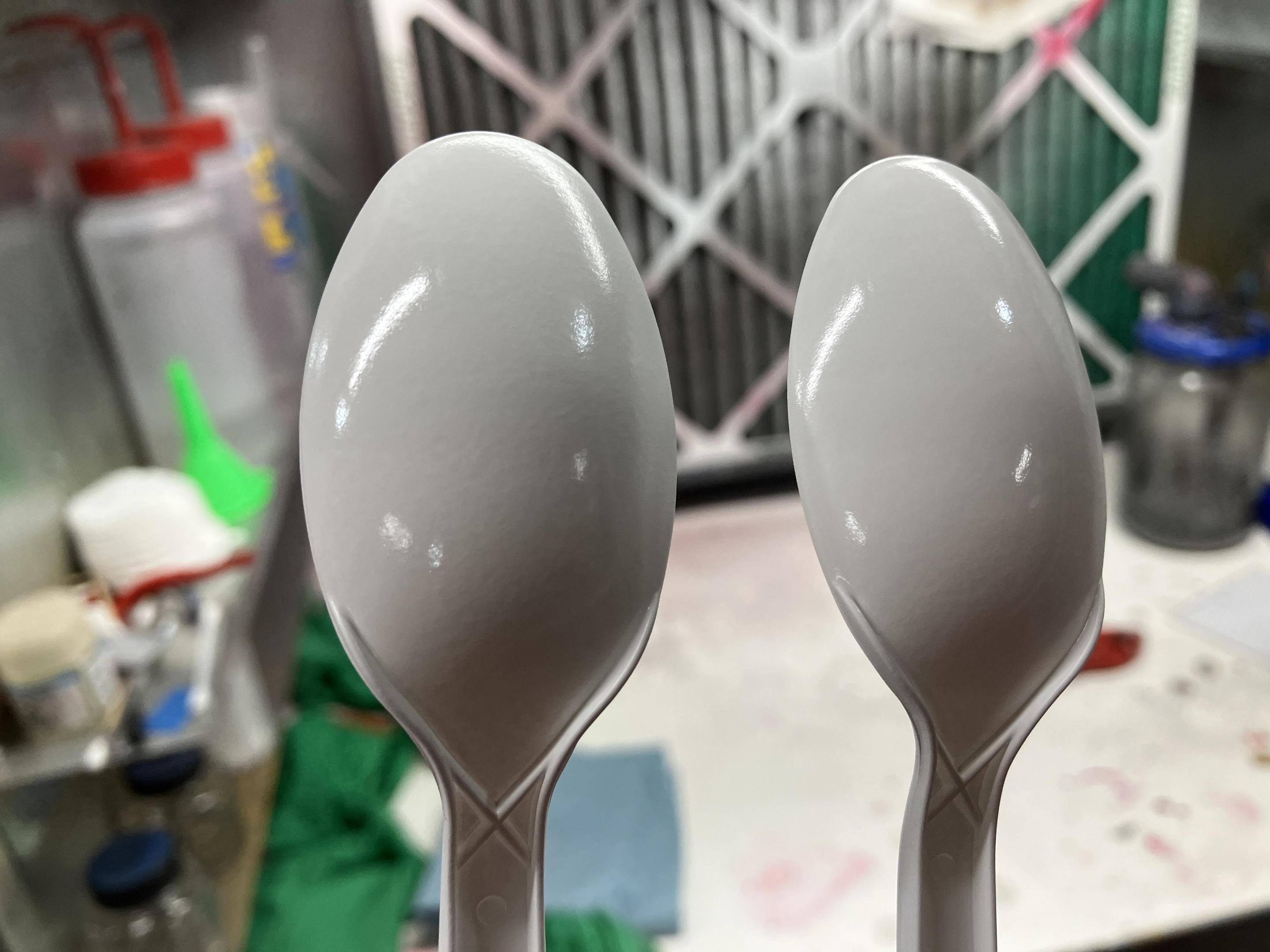

NOBLNG Posted May 14, 2024 Author Posted May 14, 2024 It was definitely a bad can. I had no receipt, but luckily I paid for it with a credit card and Canadian Tire exchanged it after checking my history. This one sprays nicely!?
