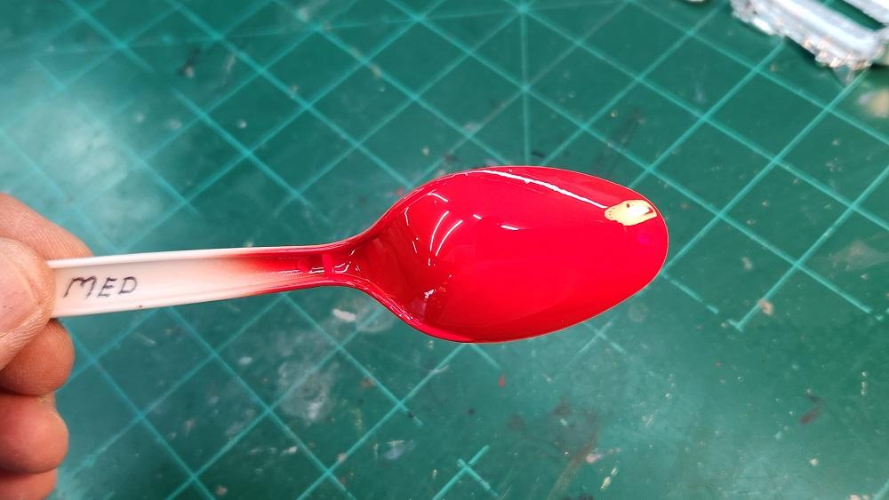

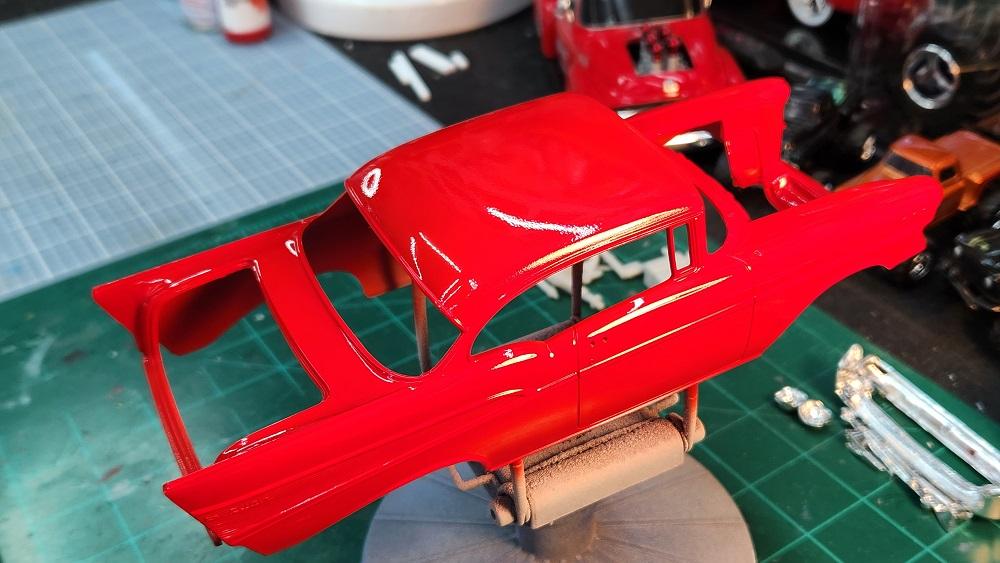

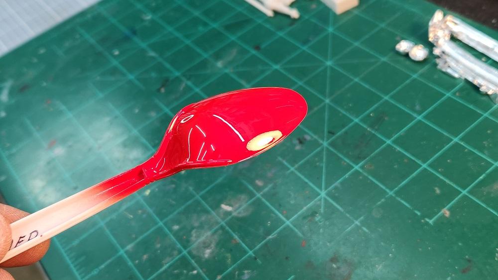

I sent Splash Paints a message about cure time on their paint and got a quick response.  I was told that 2 hrs cure time was more than sufficient.  I let it set for 24 hrs before I started.  I left my compressor set at 21 psi (about 17-18 working psi) and mixed the 2K Urethane and catalyst at 3:1.  I started out shooting my test spoon to see just how much clear was coming out.  I then started out with a tack coat and let it flash for 5 min.  I followed that with two wet coats letting it flash 5 min between coats.  The test spoon really helped because when Splash Paints says wet coats they mean WET coats.  I had to really lay it down heavy to get that wet look I was looking for like I do when I airbrush my Tamiya X-22 clear.  I got a little trash in the clear so I'll have to do some wet sanding after the clear has cured out for 72 hrs per Splash Paints recommendation.   Overall I'm satisfied with the Splash Paints products.  We'll see once it has cured out and I can wet sand and polish it out.
