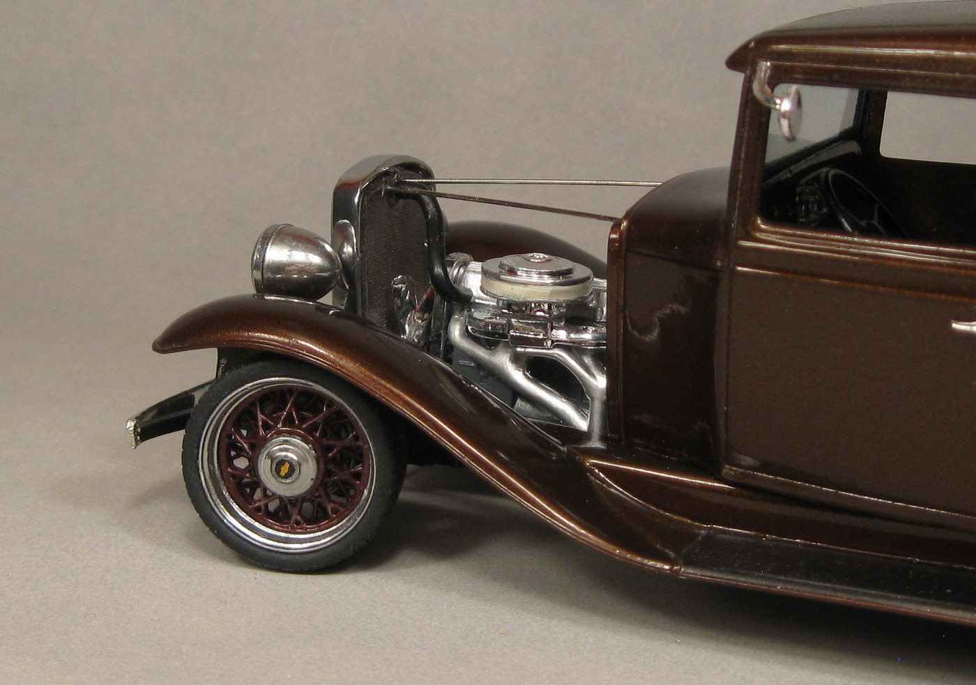

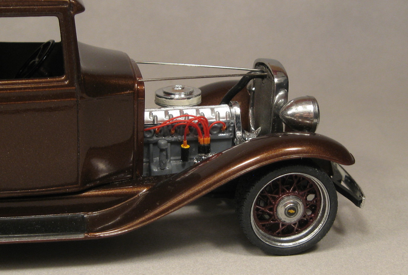

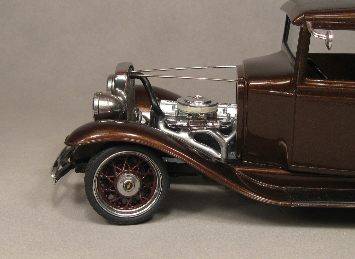

These headlights and grille shell got some pretty rough handling during the build. I did redo the shell before assembly as I but a pretty good scratch in it but only did the headlights once.
Both headlights were attached with CA , removed and re-attached a couple times as I hadn't noticed before but the previous owner apparently glued the headlight bar on crocked and I just drilled out the holes in the same places.  It wasn't attached when I got it and assumed it was glued into the proper holes. So I ended up re-positioning the headlights by trial and error.
ANYWAY, They were done with the Revell spray, let dry a week or so and given a single coat of Future. They still look pretty good even after all the rough handling they got. I wouldn't have had to redo the grille shell if I had been more careful. It looked fine until I did it in.
I understand the Spaz Stix clear spray made for their chrome spray will also work well.
IMG 4130IMG 4131IMG 4133
Expand
