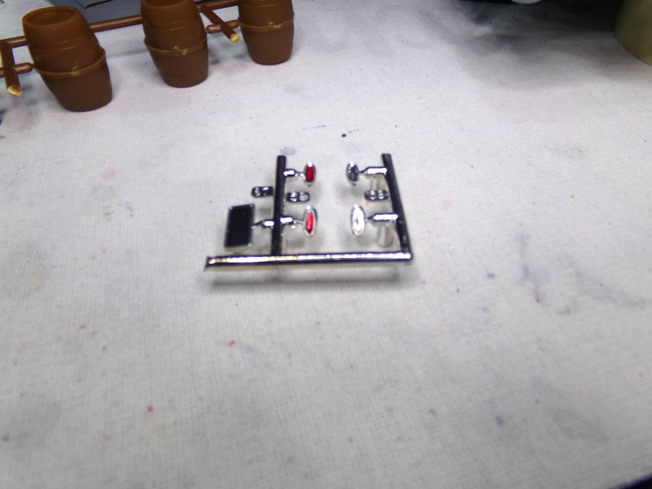

Anyway, my wife tells me I need to clean up my modeling mancave, so I agreed to work on it at least an hour each day. I started by trying to sort out some of my extra parts that I have stored in a four-drawer chest to make more room for stuff. As I am going through parts that I have bagged by model I have built so I can tell where the parts came from. I found what looks like tear-drop taillights, two sets, in bags for a 55 Chevy convertible with the continental kit (see second photo). I don't know if these were just on the parts tree and left there because I don't think they could be used for anything for a 55 Chevy and I couldn't find them in the instructions. They are marked as parts no. 68 on the tree.  But they will do fine for taillights for some street rod builds.

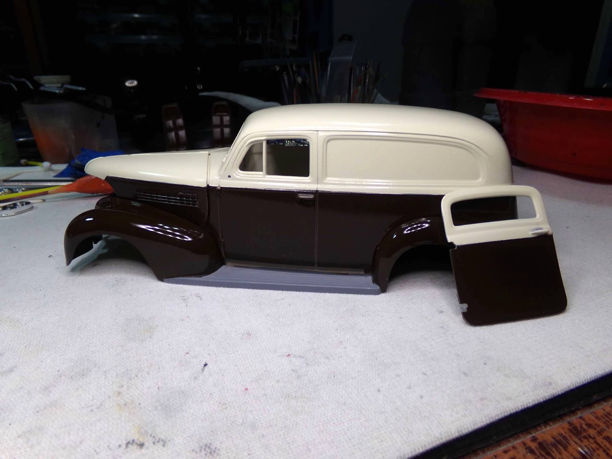

Well, with a hurricane developing in the Gulf, even though it is forecast to go into Louisiana, we are still going to get a lot of rain. So I couldn't wait for my paint to get here and went out and bought a can of Krylon Short Cuts Expresso (dark brown). Beautiful day for painting today with humidity about 40 percent so the paint came out pretty good! The last can of Short Cuts I got was horrible but this one is great! A Nice gloss brown finish. So once I rub this out it will be ready to build. Everything else is also painted. Should keep me busy in the rain! Thanks for looking! ?

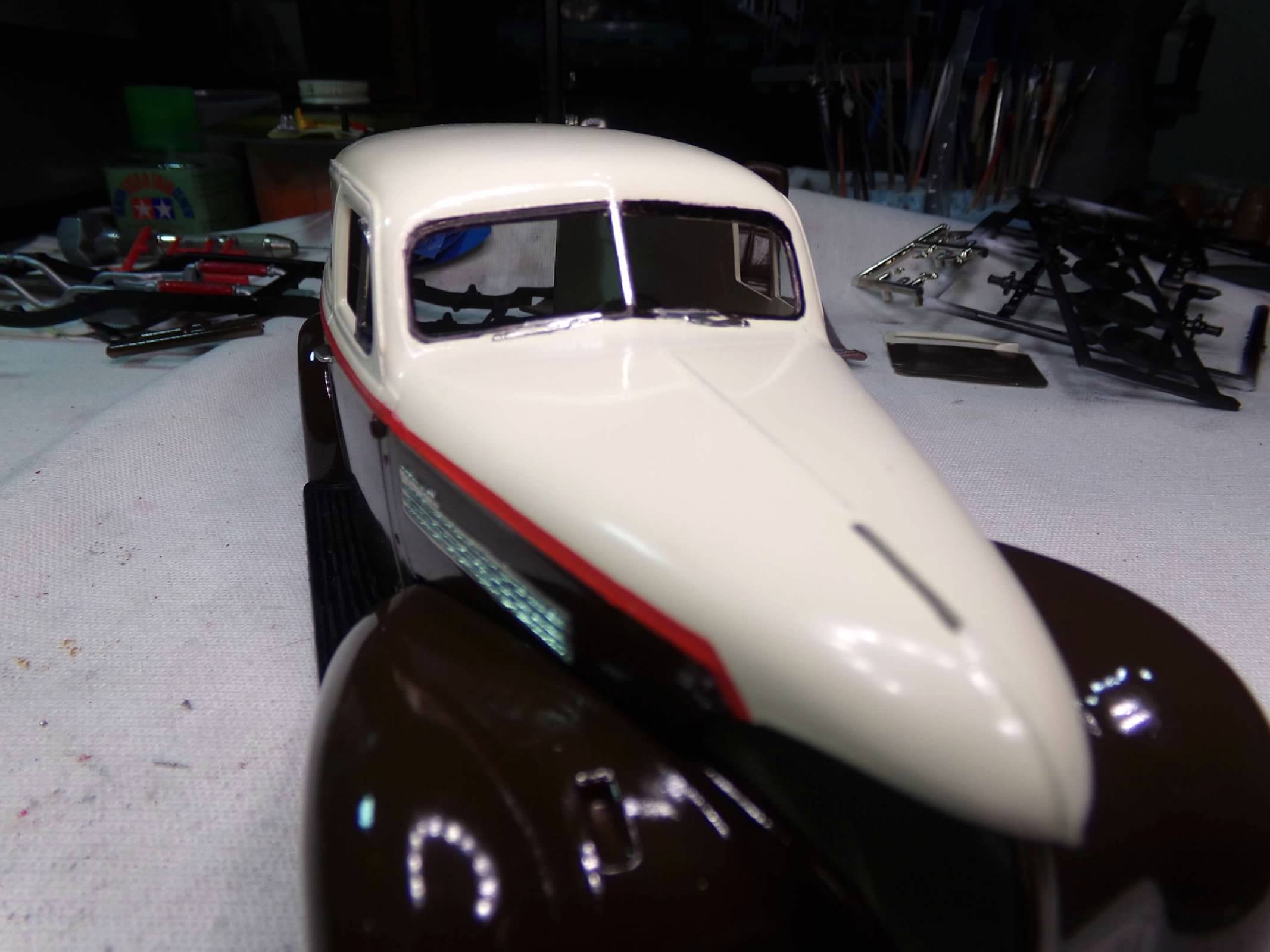

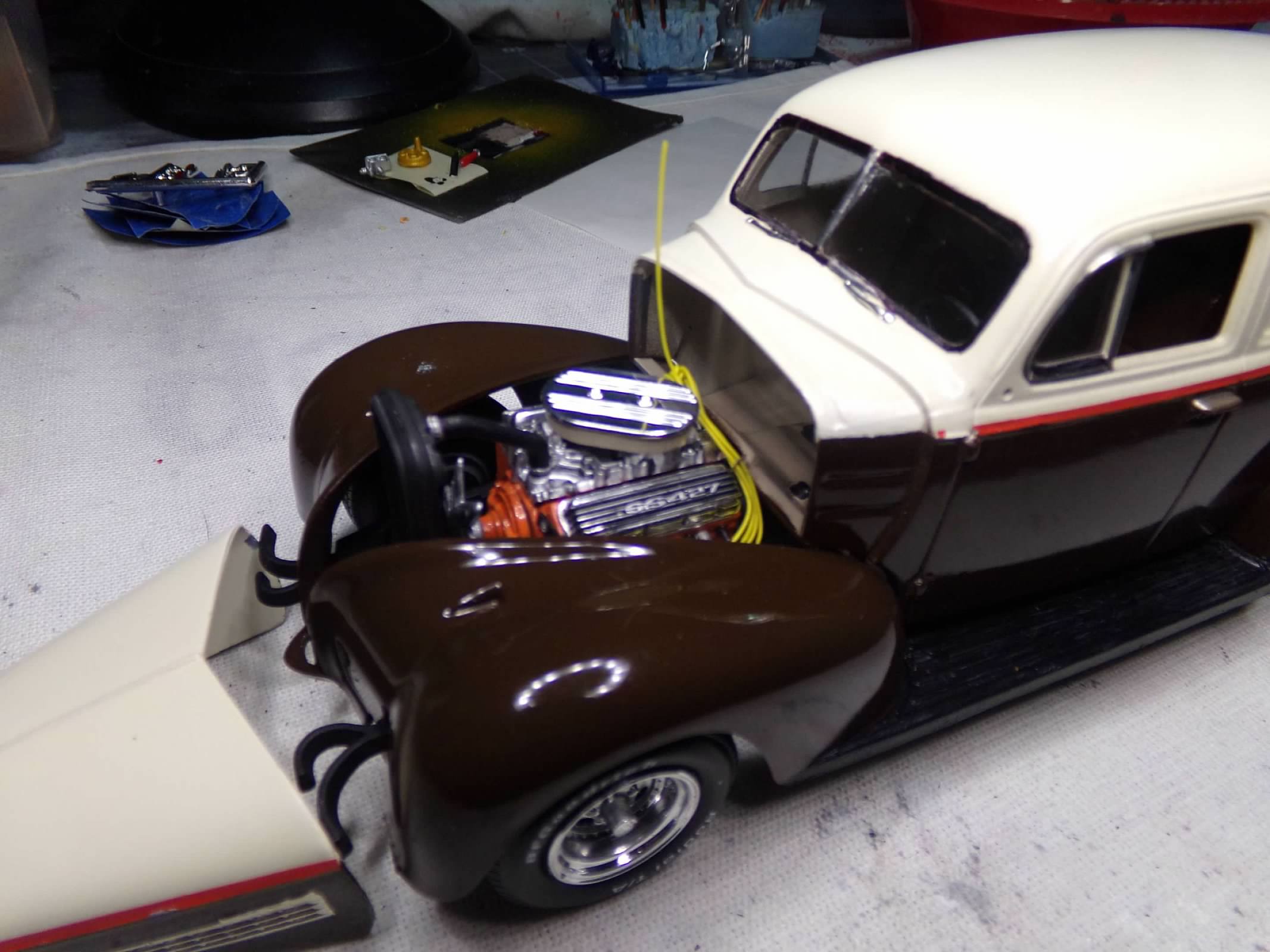

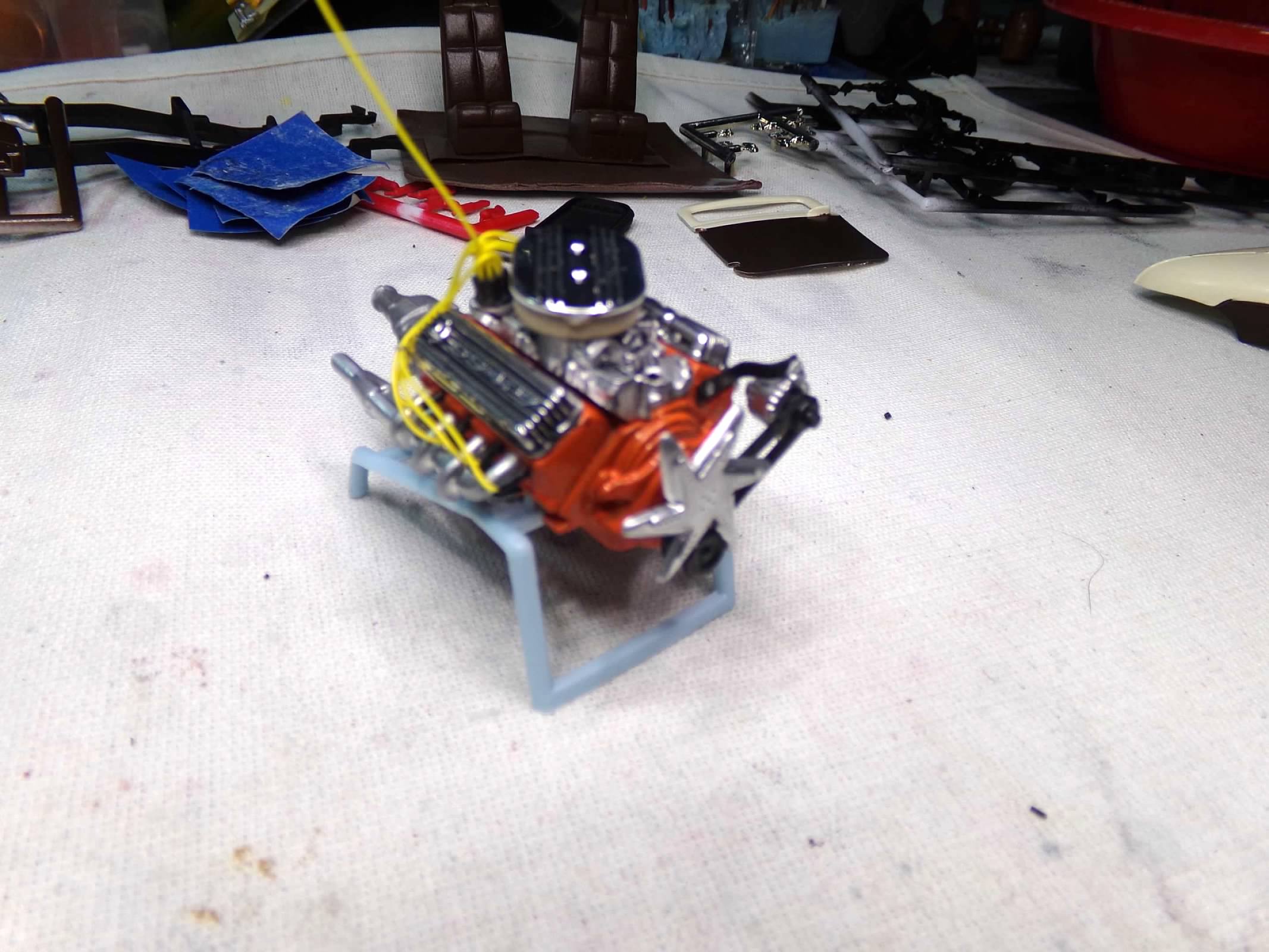

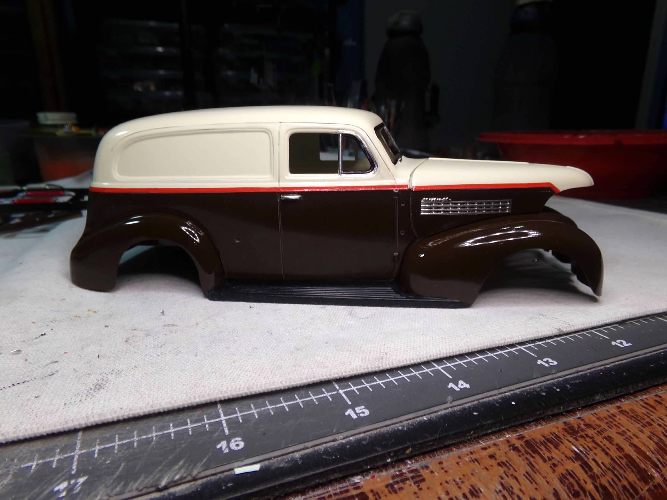

I haven't posted in a few days but have been busy with other things in addition to work on this project. I rubbed out the paint and had to re-paint one side of the brown but I didn't want to clear it because the humidity was too high and I didn't want the blush or fog on the clear. So I let it sit for a couple of days and then rubbed it out a bit with some polish and it looks fine. While waiting on the paint, I assembled the engine. I didn't want to use the high-rise manifold with carbs sitting on top. It also had a magneto. So I found a cross-ram intake with a couple of lumps for carbs in extra parts and an air cleaner to cover both. I then used a pre-wired distributor and will hang the coil on the firewall later. I also made a bracket from a piece of strip styrene for the alternator.
Once the paint was dry on the body, I finished rubbing it out. I didn't clear the fender unit either, as I thought it looked good enough without it and so I didn't touch it for a couple of days either. I then foiled and and used a king size sharpie around the windows to trim them. Also trimmed the sides of the hood with foil. Finally, I cut some red decals that I had in the decal stash in strips to serve as a paint divider between the two color. Although the tape line was ok, a red divider always works for me and makes it a little cleaner. That's it for now. Thanks for looking! ?

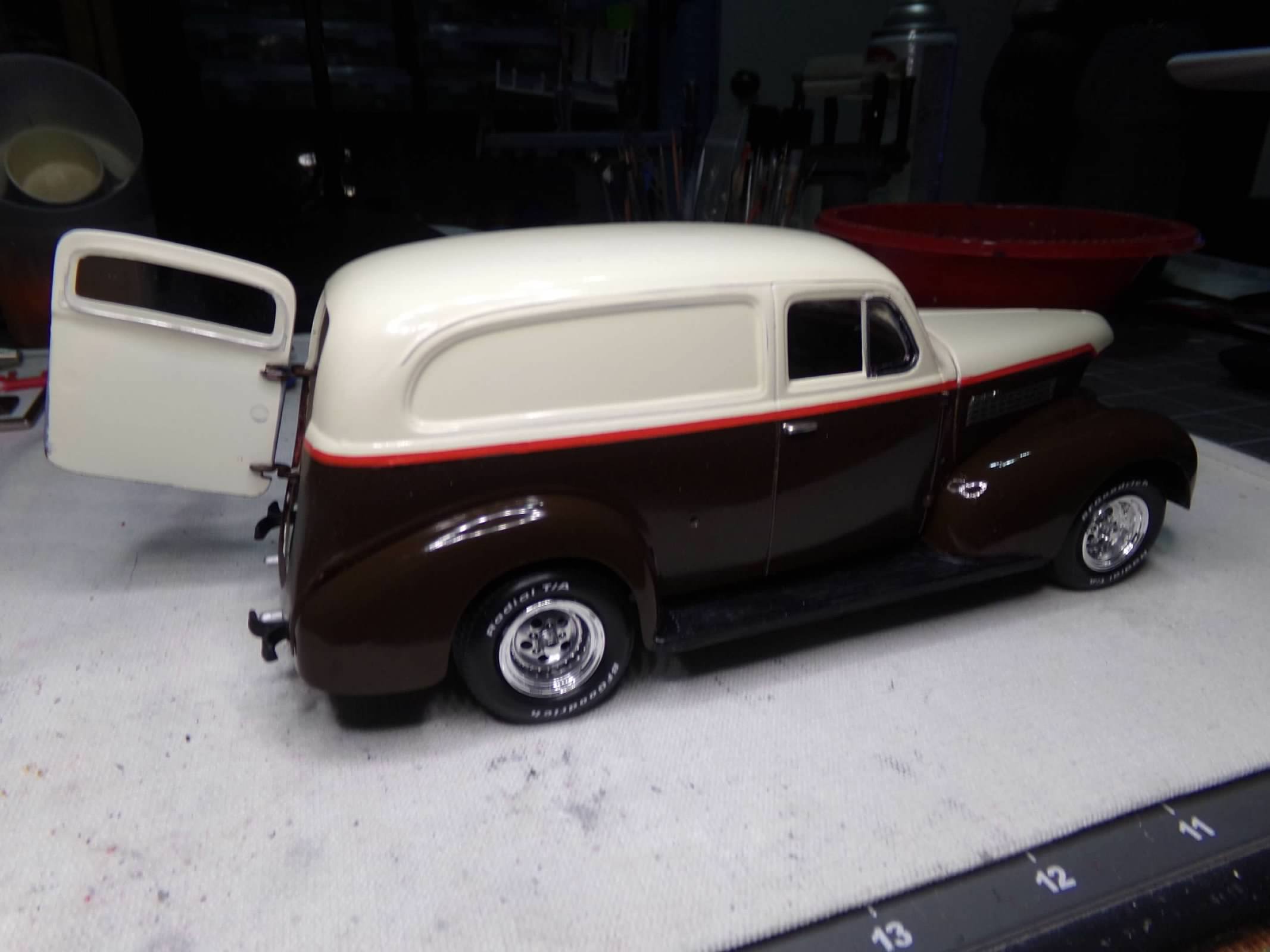

This is a mock-up on wheels. The rear door is hinged and working, Windows are and interior are in and now I just have to finish a couple of barrels, glue everything together and mount all the hardware and it will be done! Thanks for looking! ?
