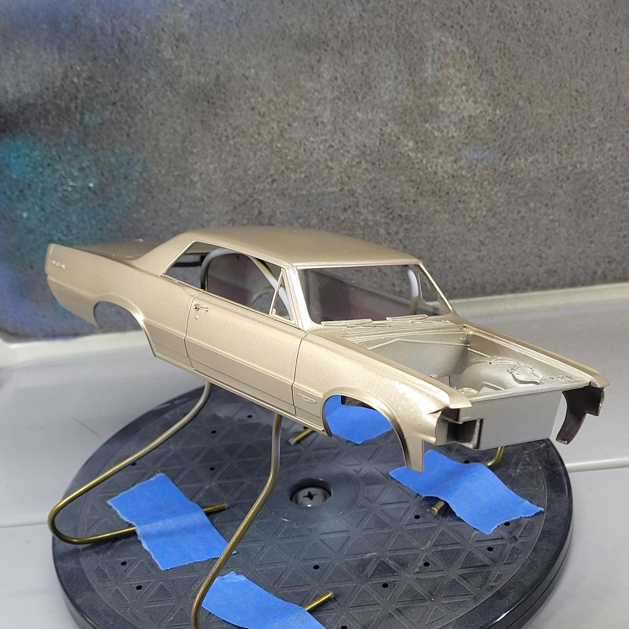

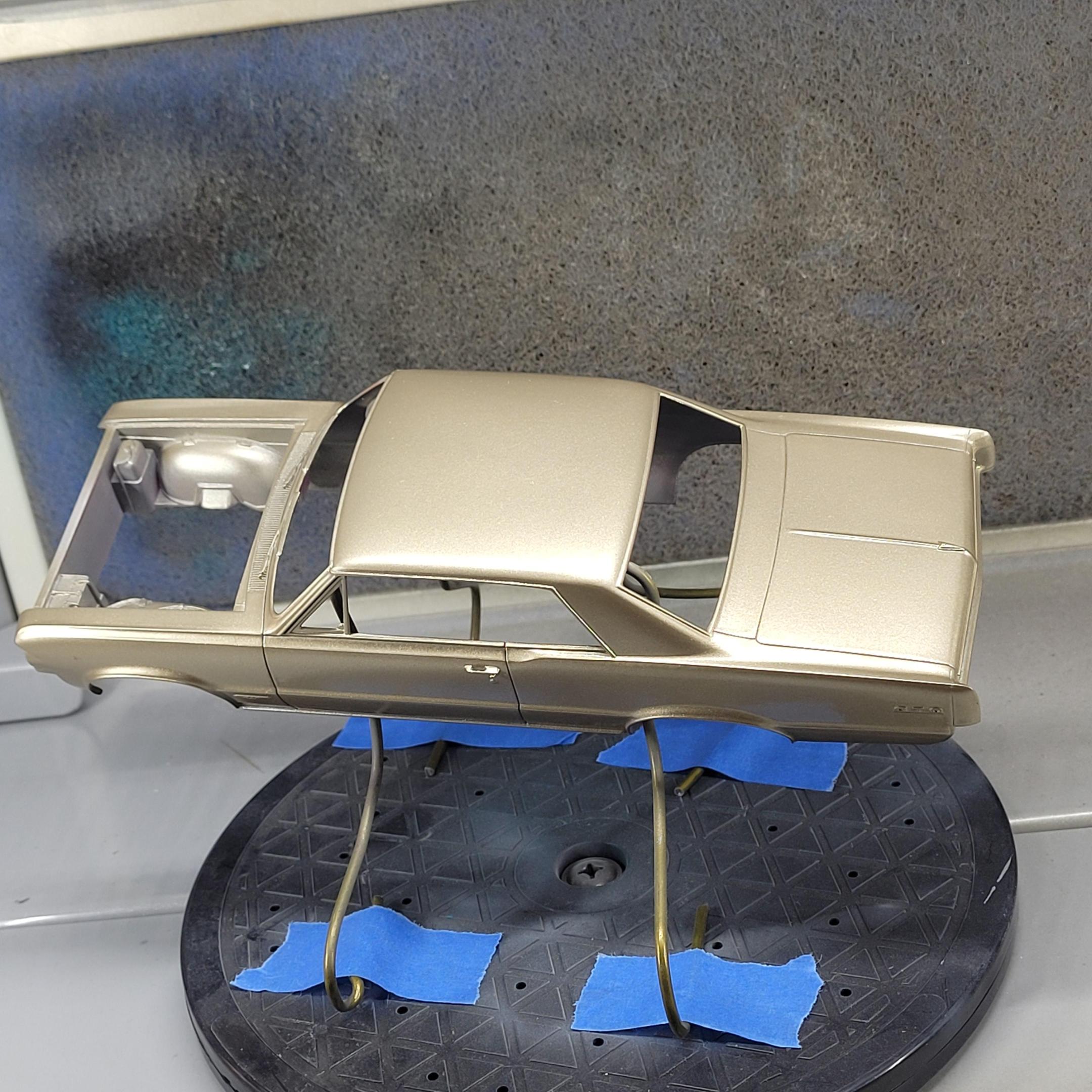

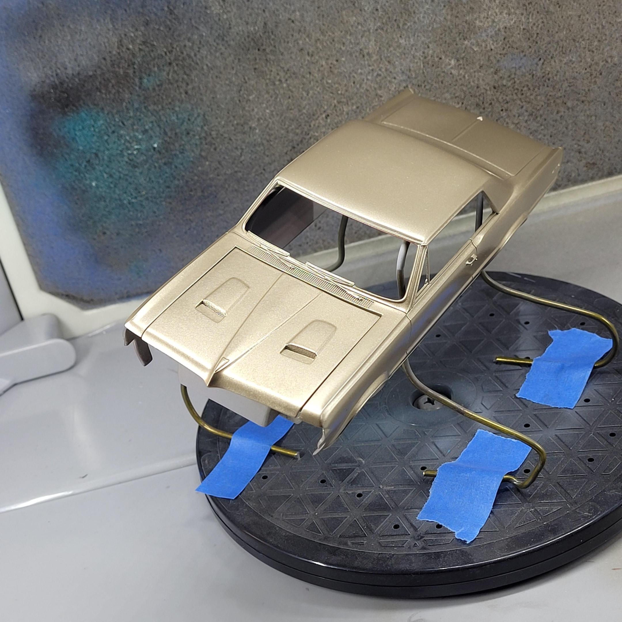

Finally got some color on the body, second attempt. First attempt had zero adhesion. None. Figured I might be the thinner, we'll see if this works. The whole craft paint thing has been learning experience,  I can see how it has its place, and where it may not. I'll chalk it up to inexperience.

Thank you. By the time it was thinned enough to spray I was basically spraying the metallic,the pigments seem to be very translucent.

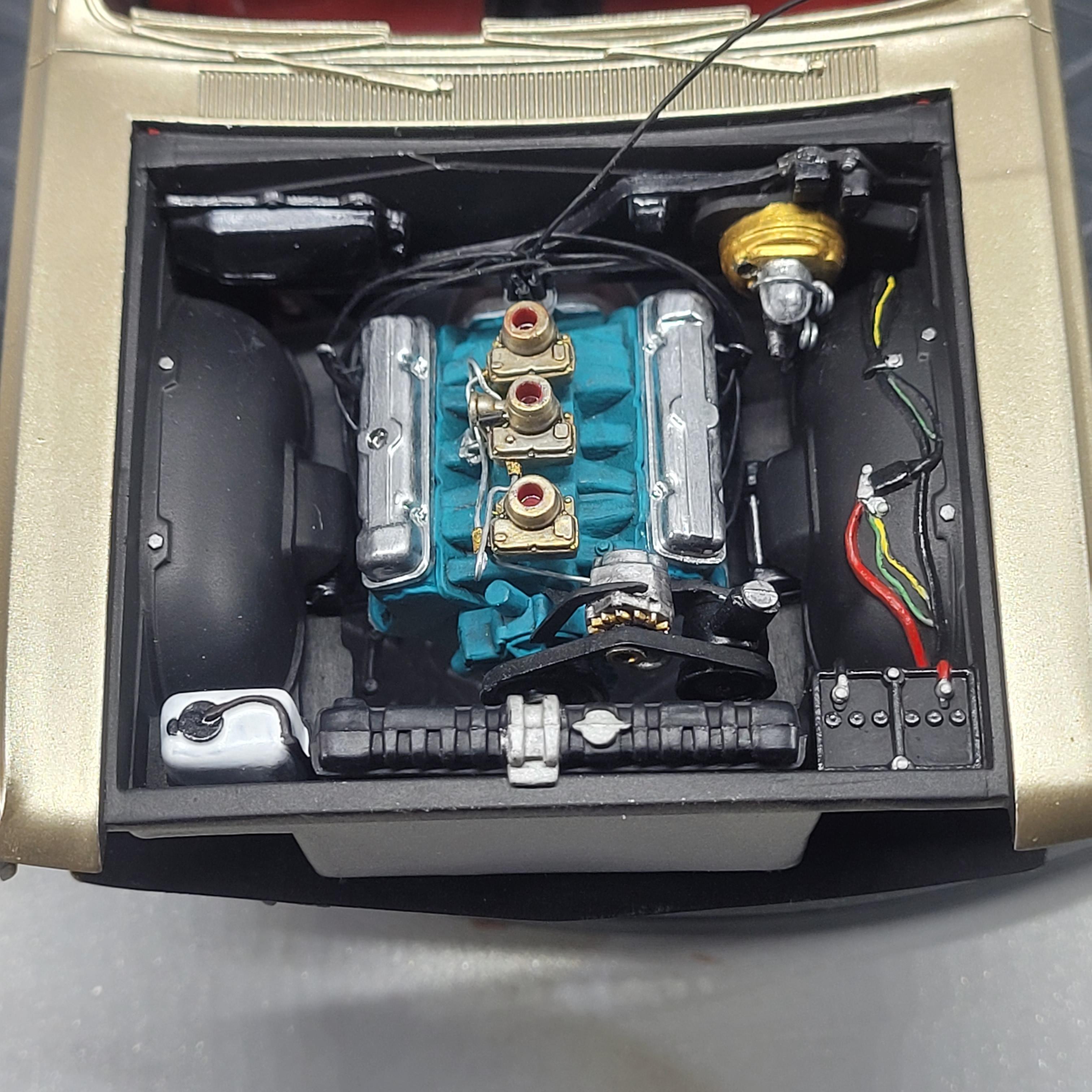

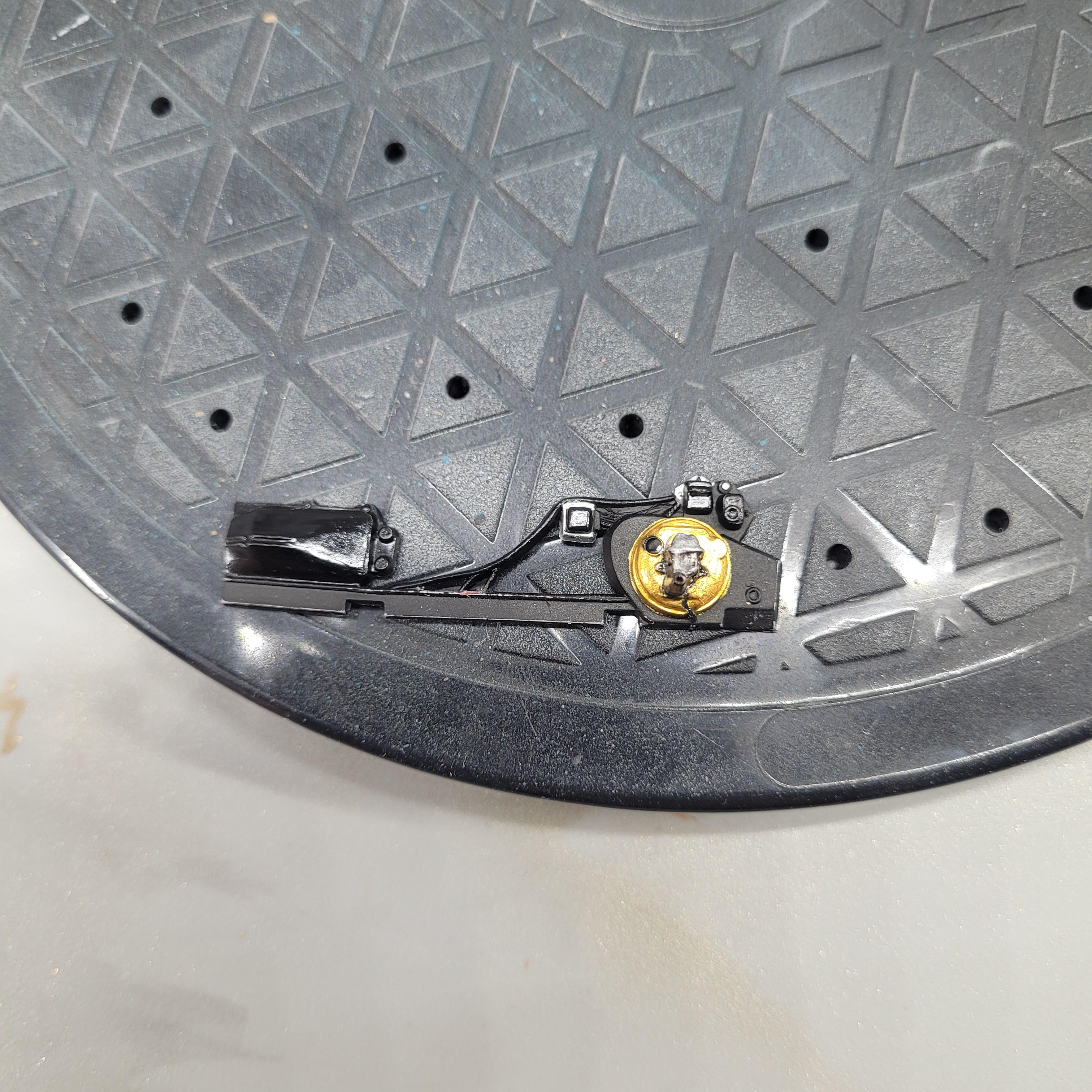

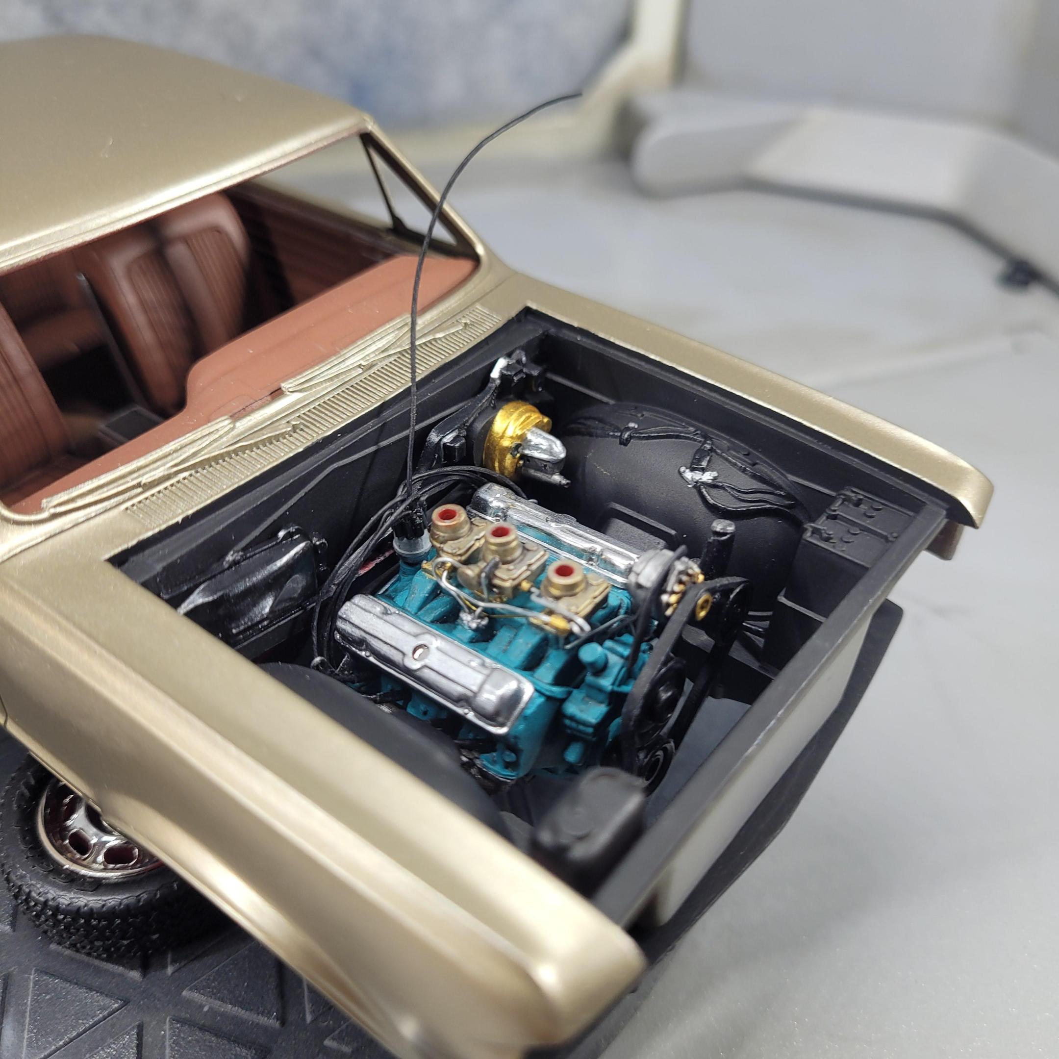

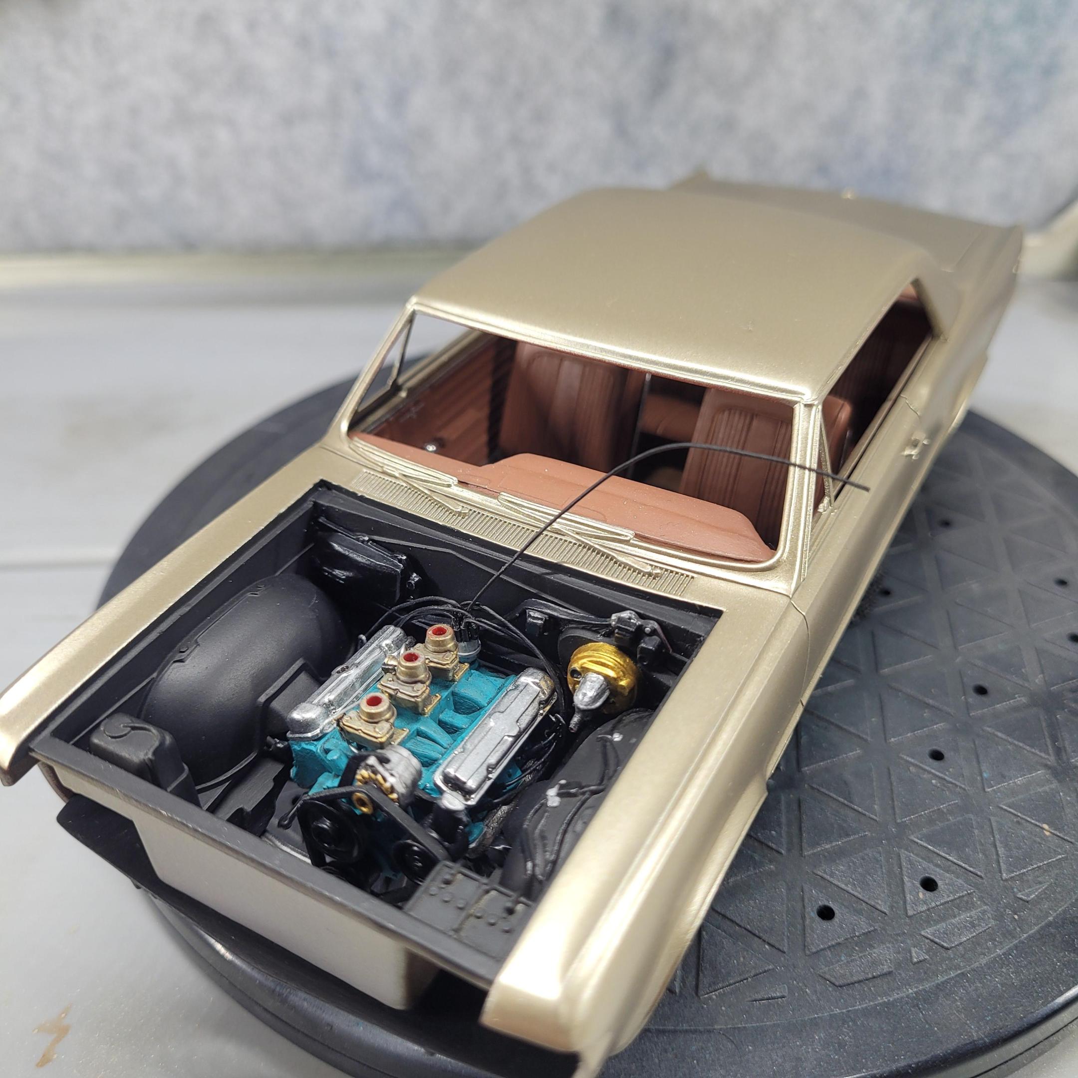

Started diving into some detail work and getting this finished up. Painted the engine compartment,  installed the engine on the chassis, some touch up work on the exhaust,  and molotow on the tips. Still have to black out the centers. Trying to not get too carried away detailing, it's difficult to know when to stop, or if it's feasible. And I really dislike the master cylinder on this kit. Look ls like a 5 o'clock on Friday attempt.
Monogram/Revell really should have made the power brake booster and the master cylinder as separate parts, like they did with later GM offerings.
I completely agree.

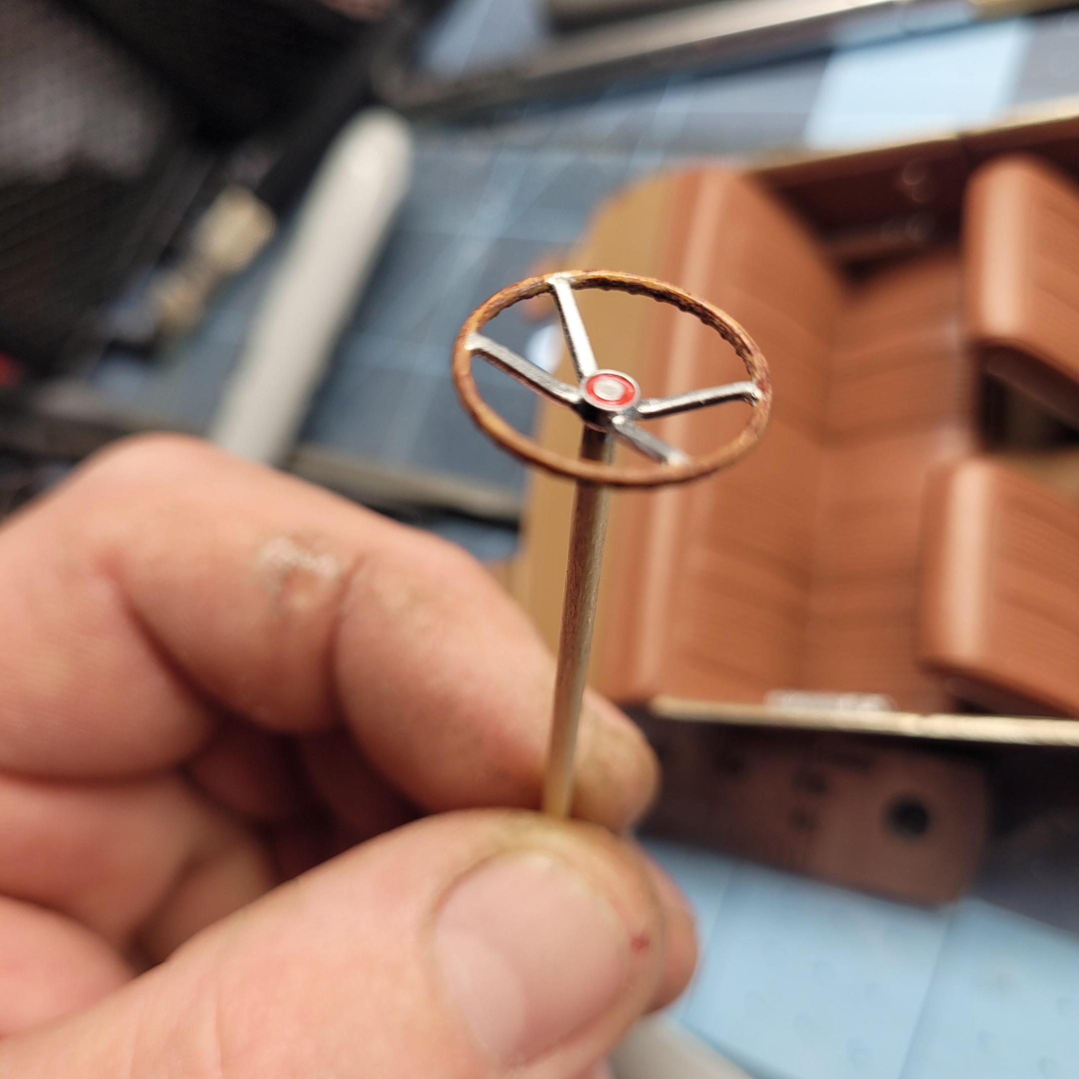

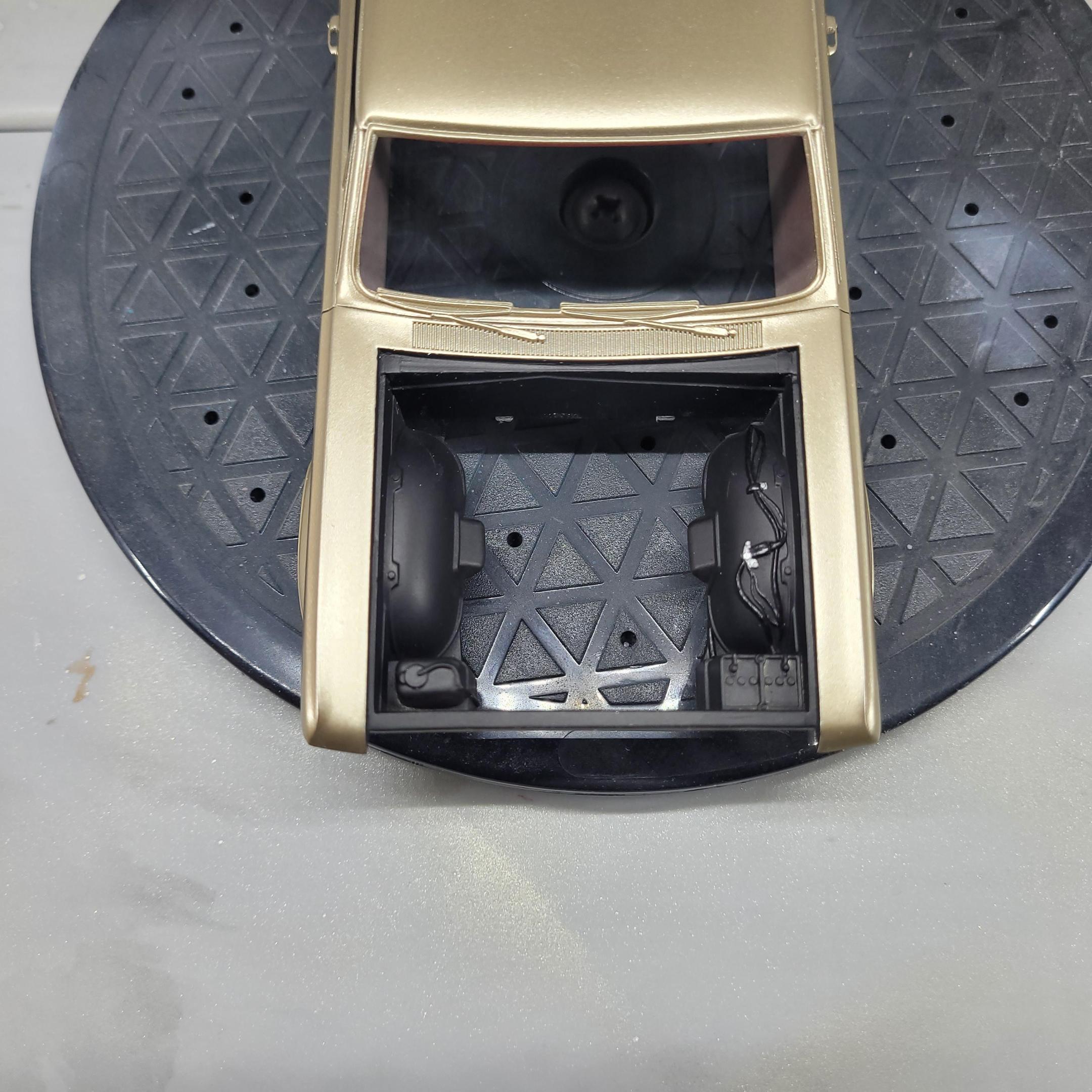

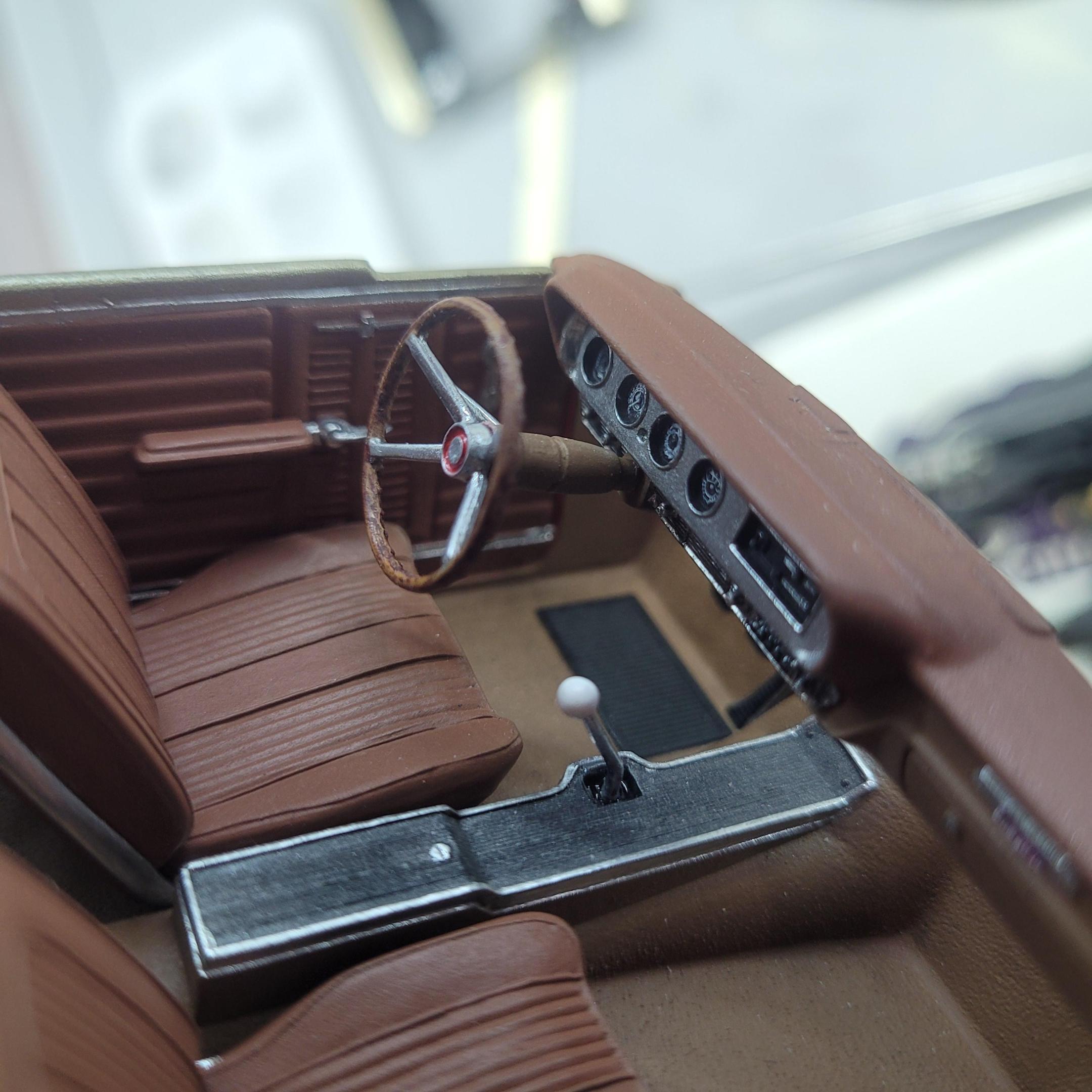

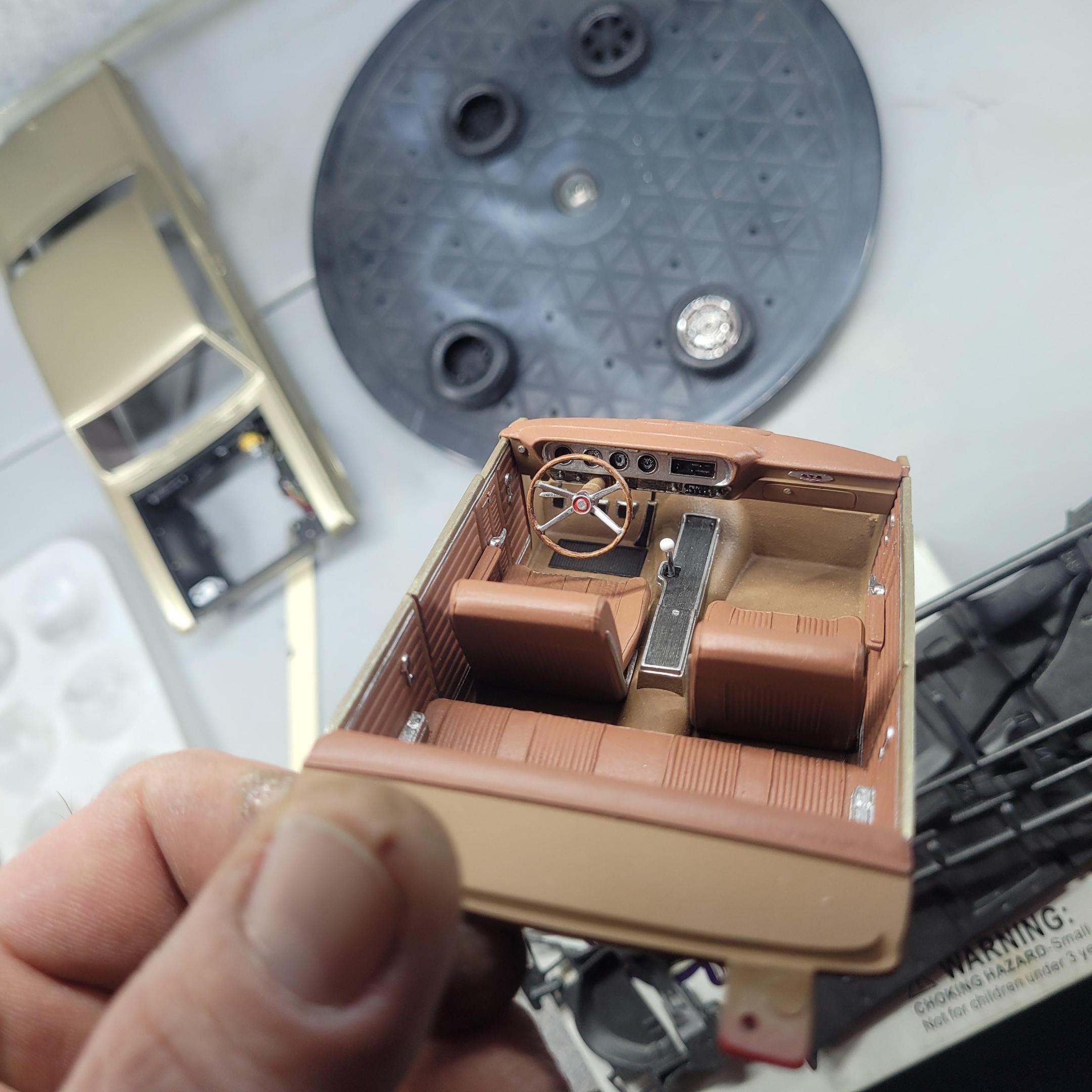

I think I have the engine compartment where I want it. More detail, added some brake lines and the bale(I believe that's what it's called) for the sorry excuse for a master cylinder. Doesn't look too bad now. Also finished the interior. That's my first attempt at woodgrain on the steering wheel.
  • Like 2
  • Thanks 1

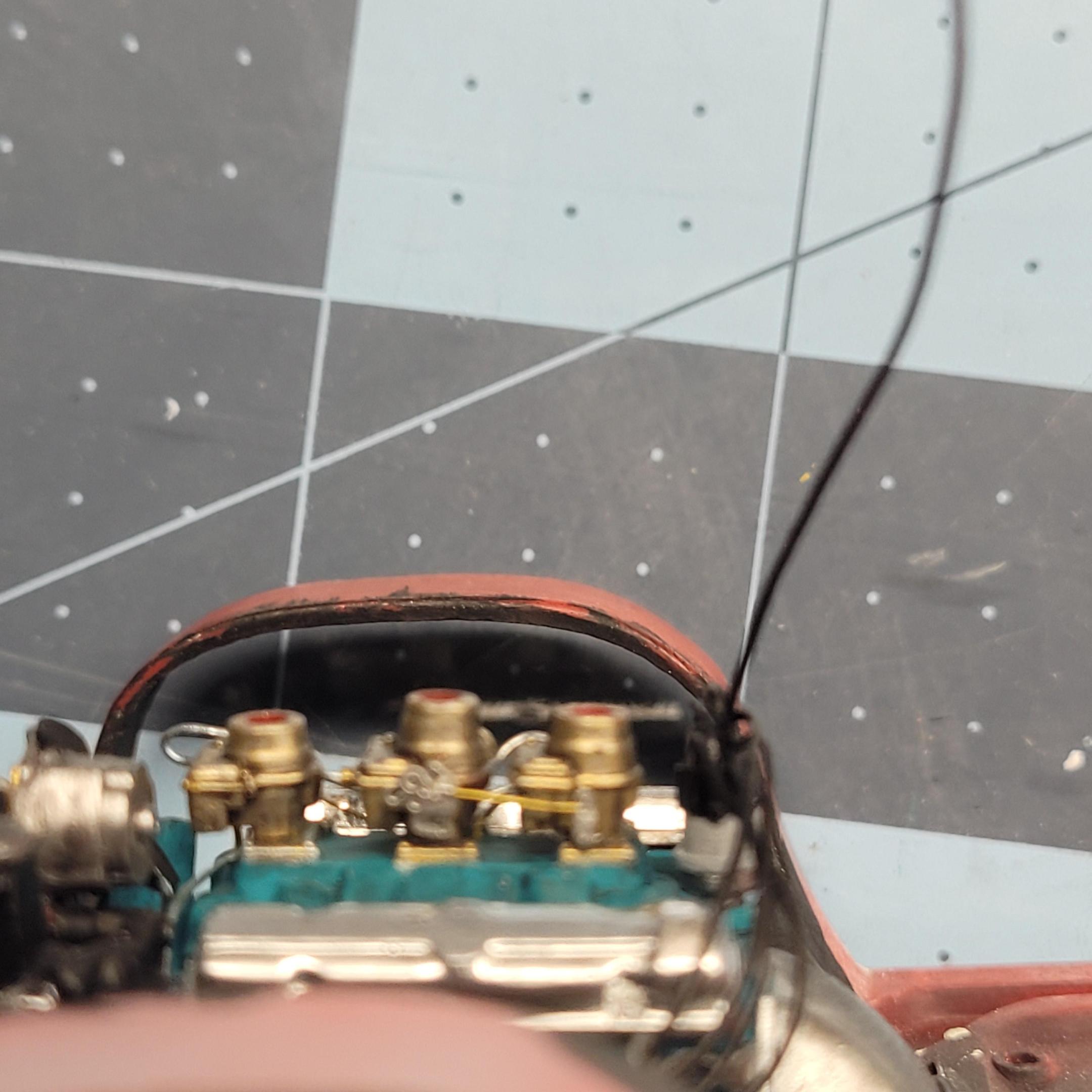

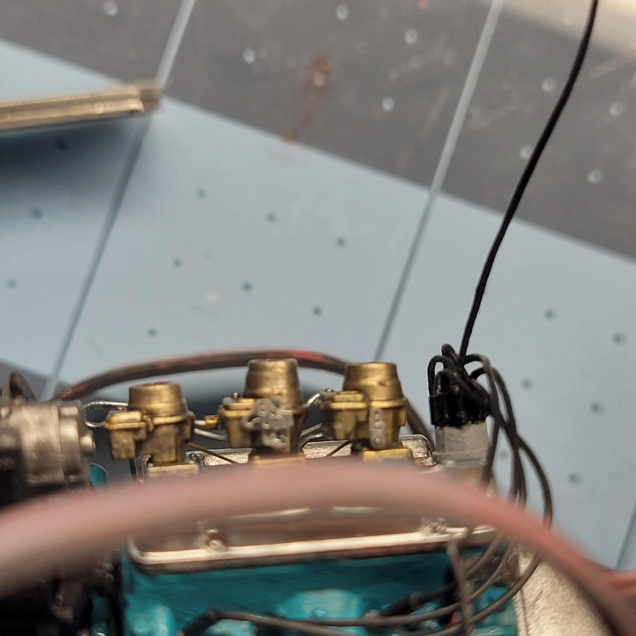

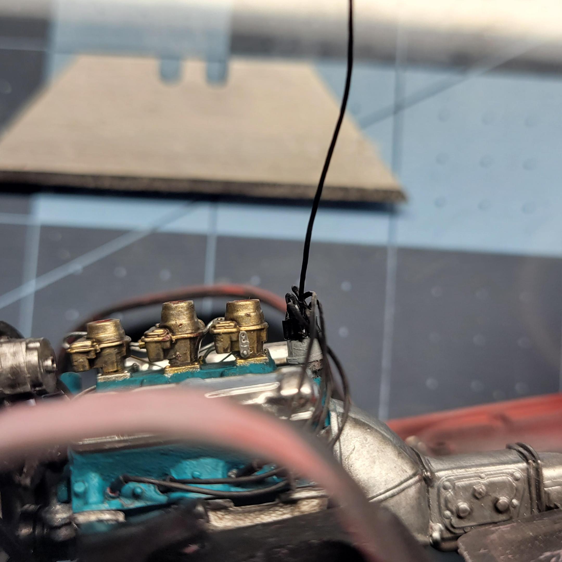

Photo etch is fun. I really need to get some magnifacation, welding doesn't lend well to vision long term I'm learning. Put some linkage on the other side of the carbs, kinda wish I had done this on the other side. There's one vacuum line for the brake booster and then I'm calling this part good. Thanks for looking

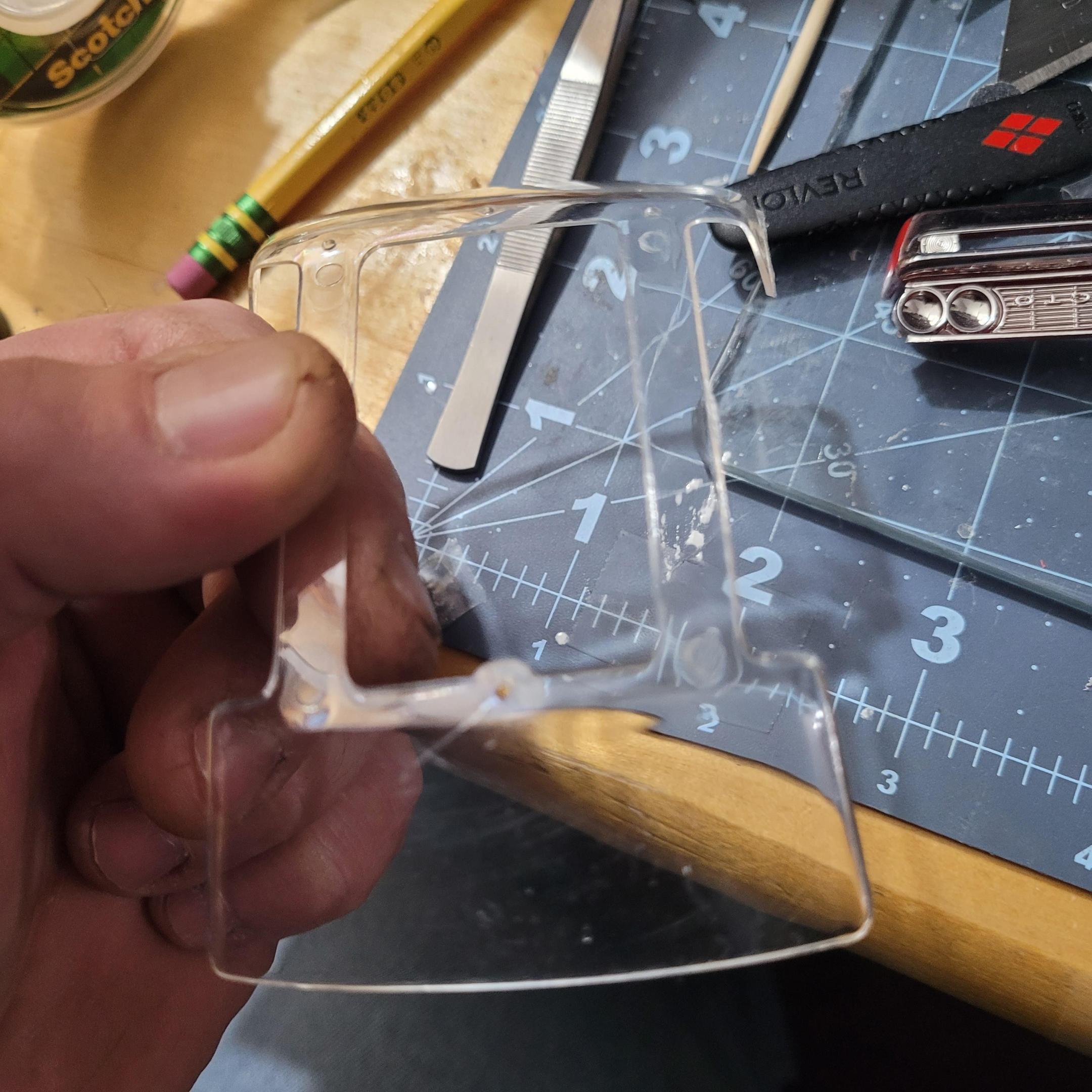

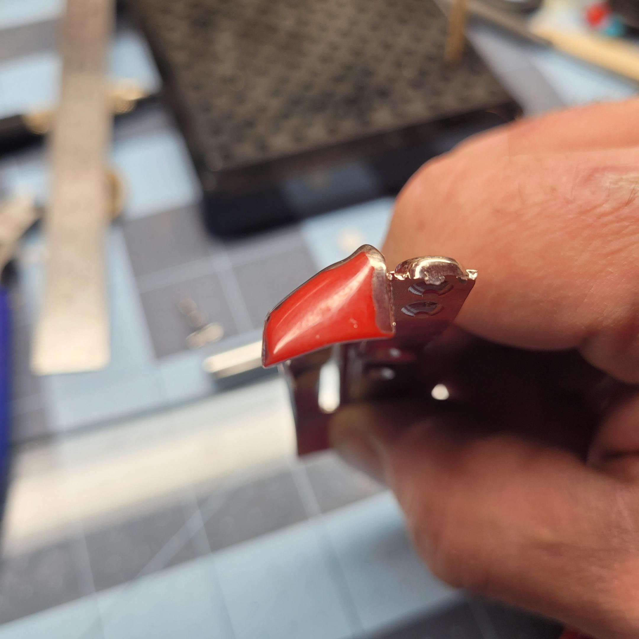

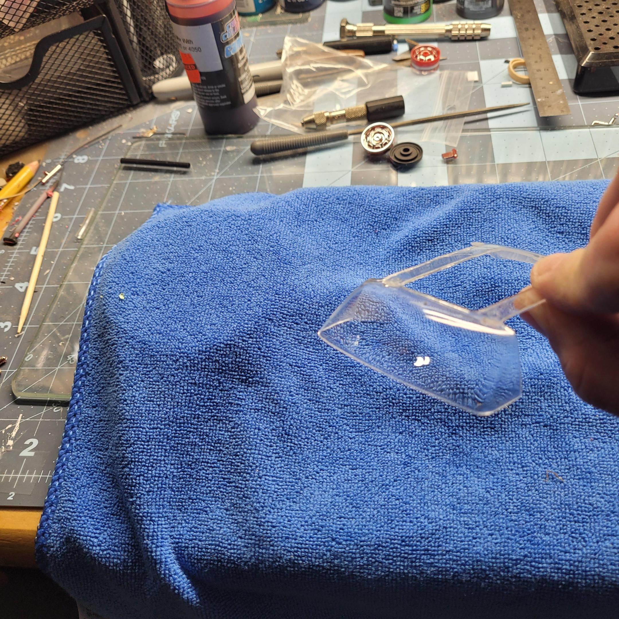

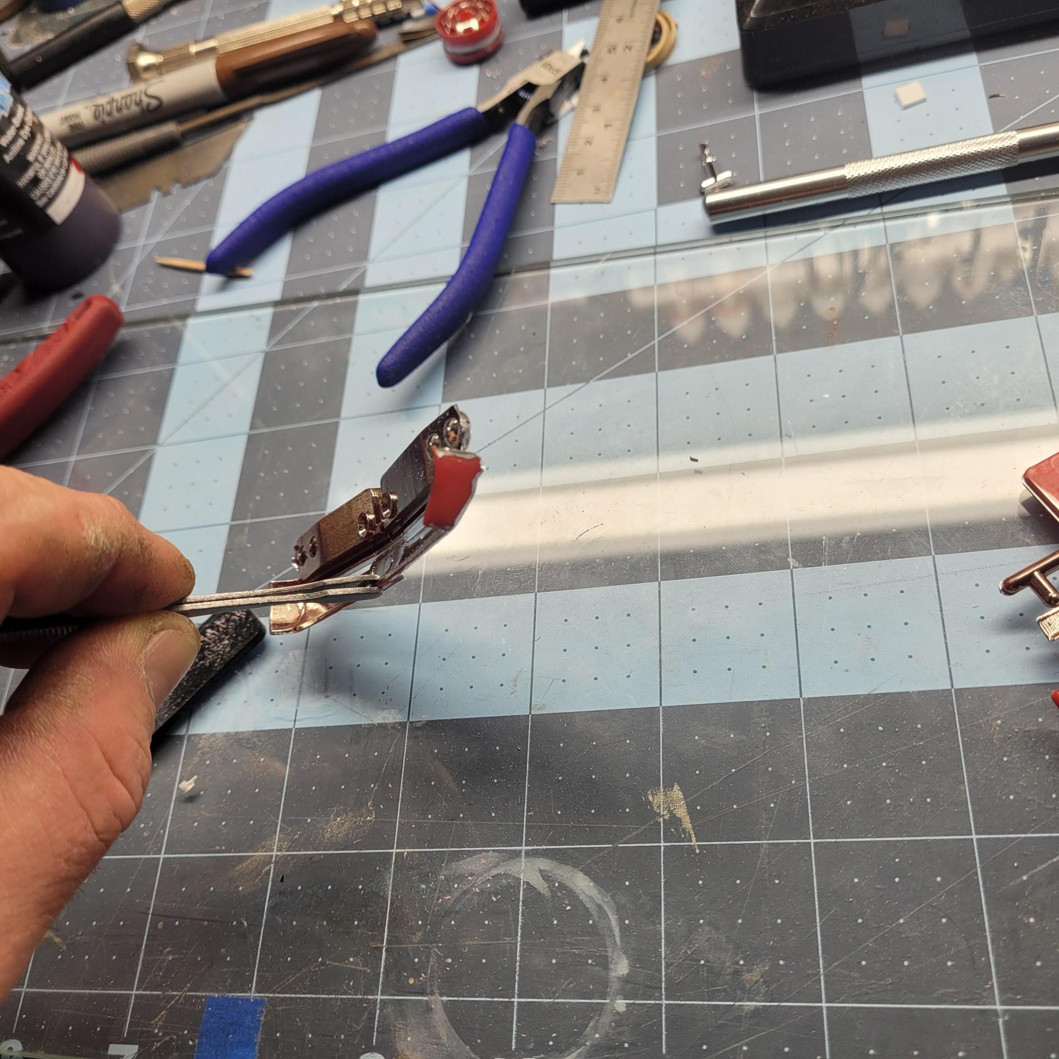

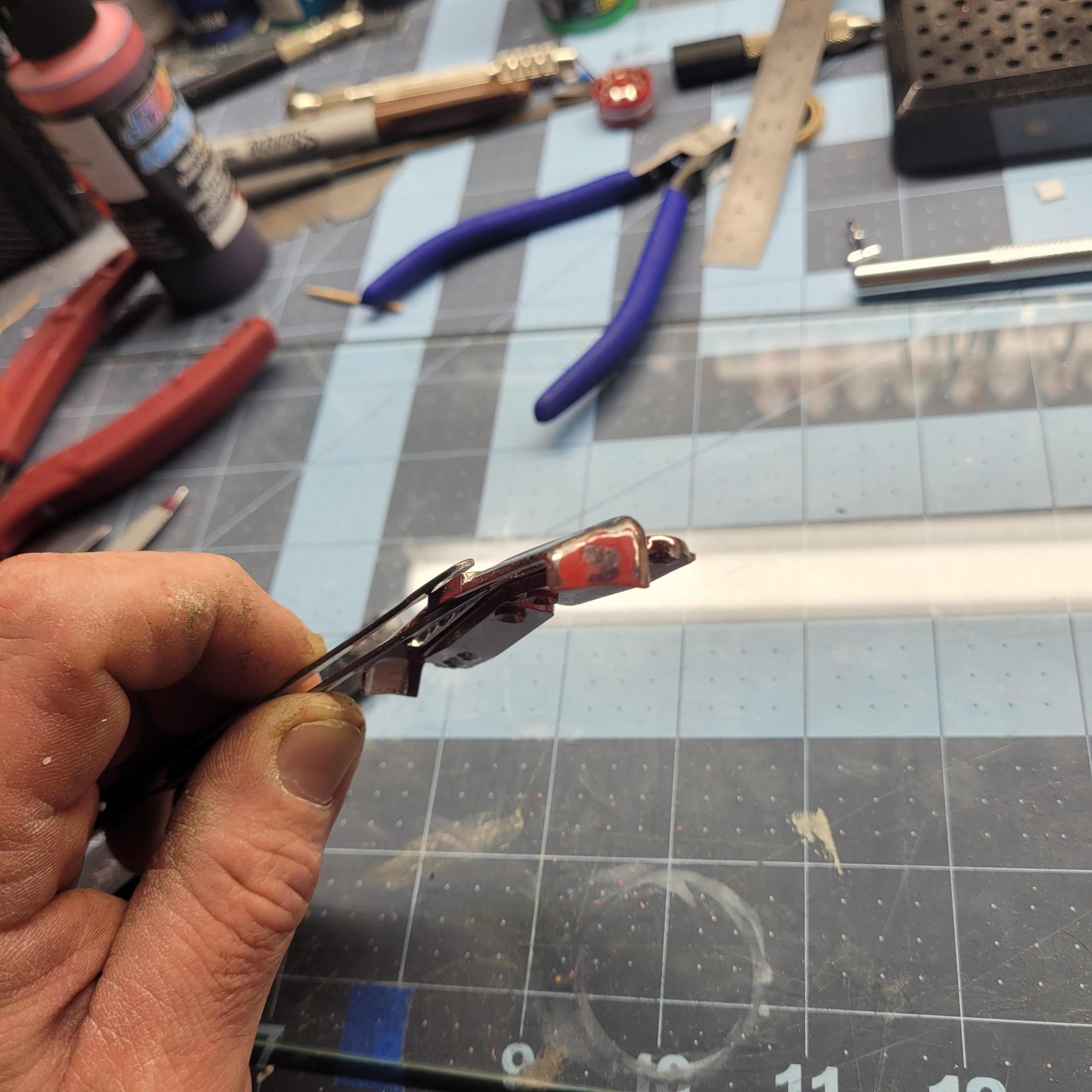

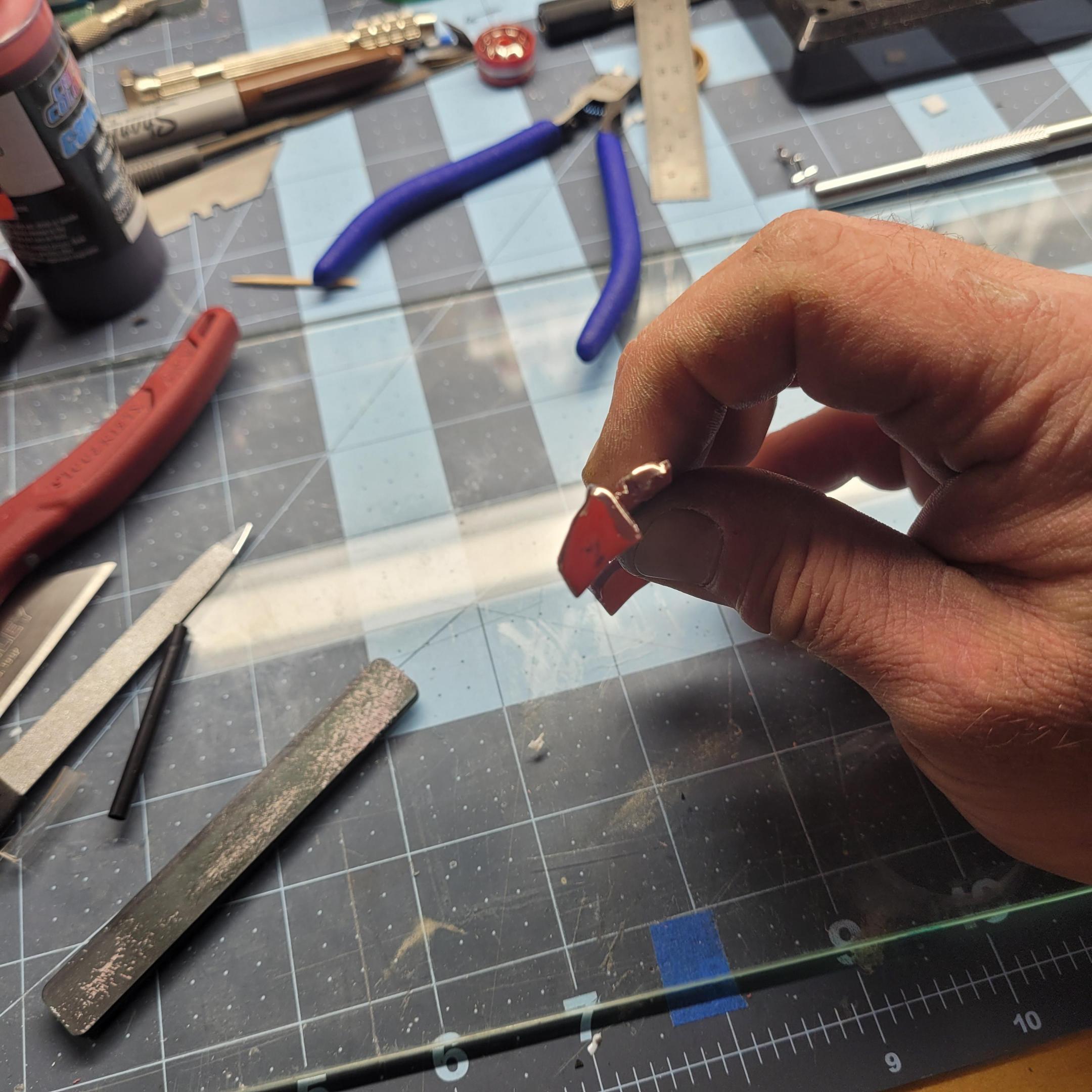

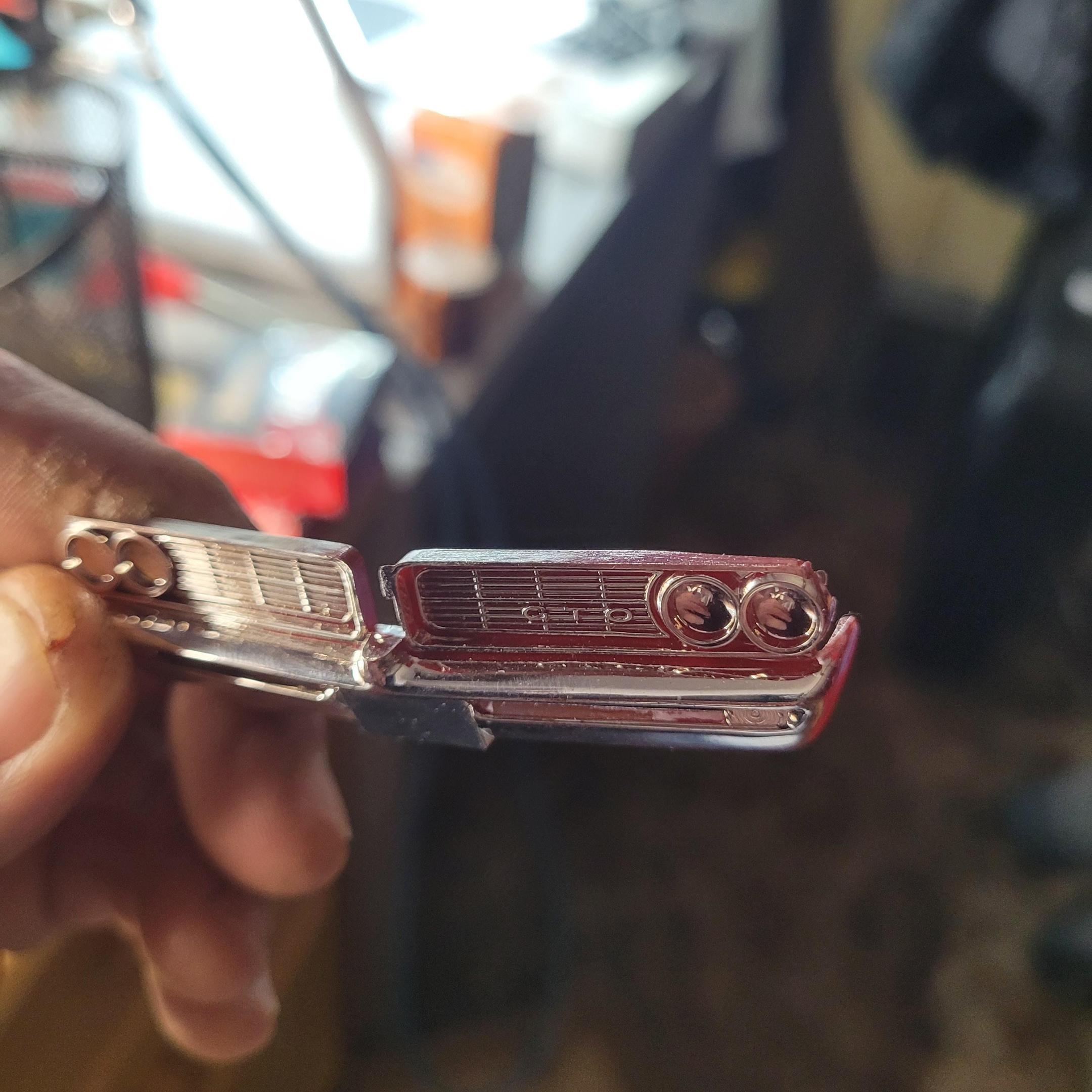

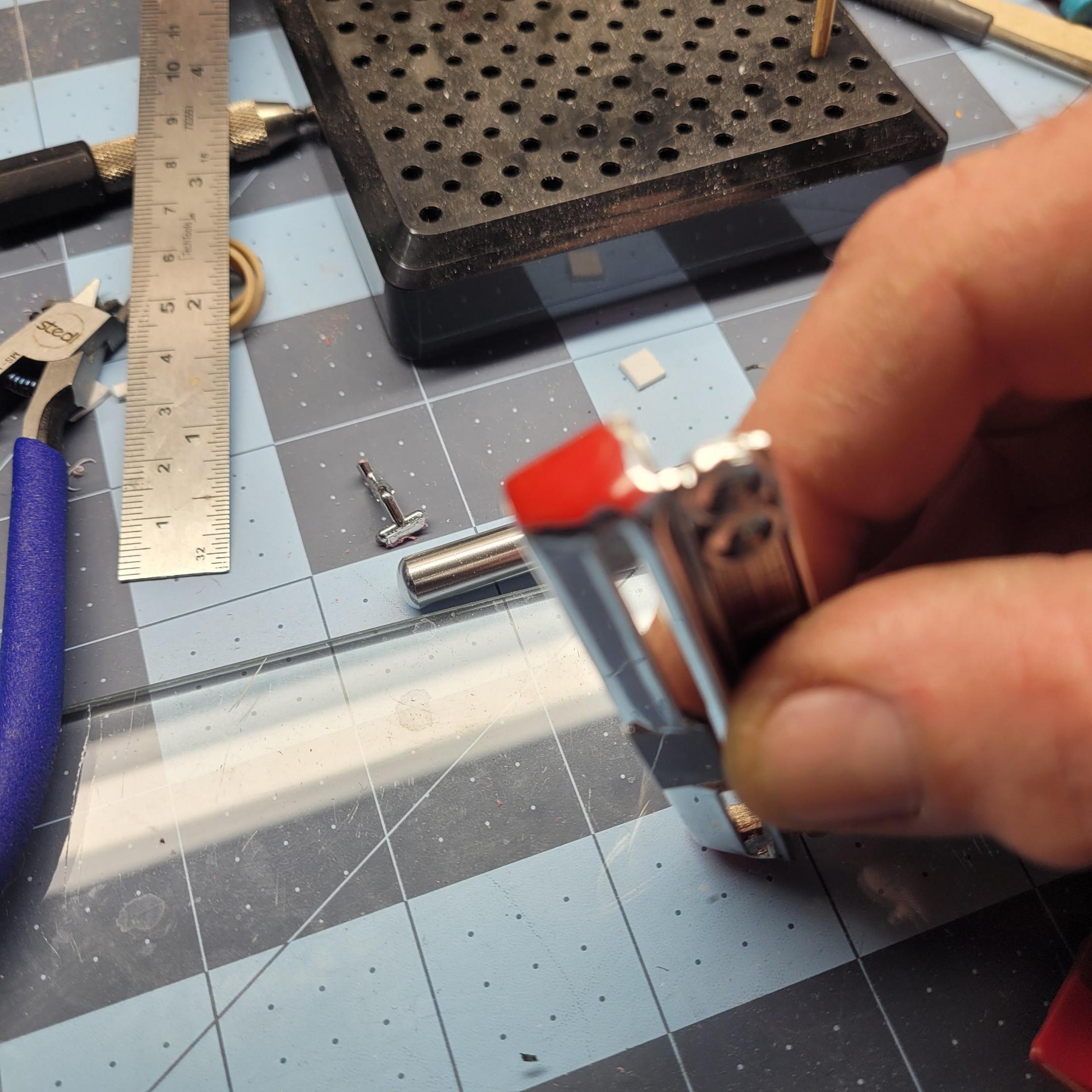

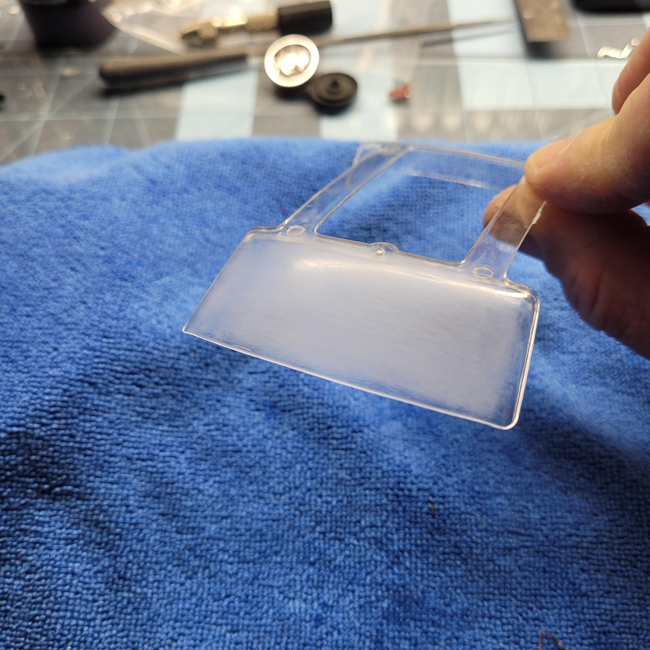

Started polishing the "glass", no pics of that,  one scratch is deep, I can catch a fingernail. That's bad enough to warrant repair/ replace on machined surfaces, not sure if it's worth the work on this. Also stripped the chrome, it's horrible. Half of it shows the red plastic, flash, ect. Smoothed out some low spots on the front bumper,  those files are awesome. Left it polished. I'm sold on them.

Best of luck with that glass John, that looks like a pretty challenging scratch. Have you considered a replacement?
That bumper is shaping up quite nicely though. How do you plan to replace or touch-up the chrome?
David G.
If I fail with the glass, I may try some clear acetate, yet another thing I haven't done before. I've polished headlight lenses on 1:1 vehicles,  so I have a clue how to go about it. For the chrome, I'm on the fence with molotow,  I would like to try bmf, but I've seen where people had problems with the amazon sourced. Something about its age, and coming folded. I've seen 2-3 other products people used, I really want something that will be reasonably tuff. Or something I can top coat with minimal issue.

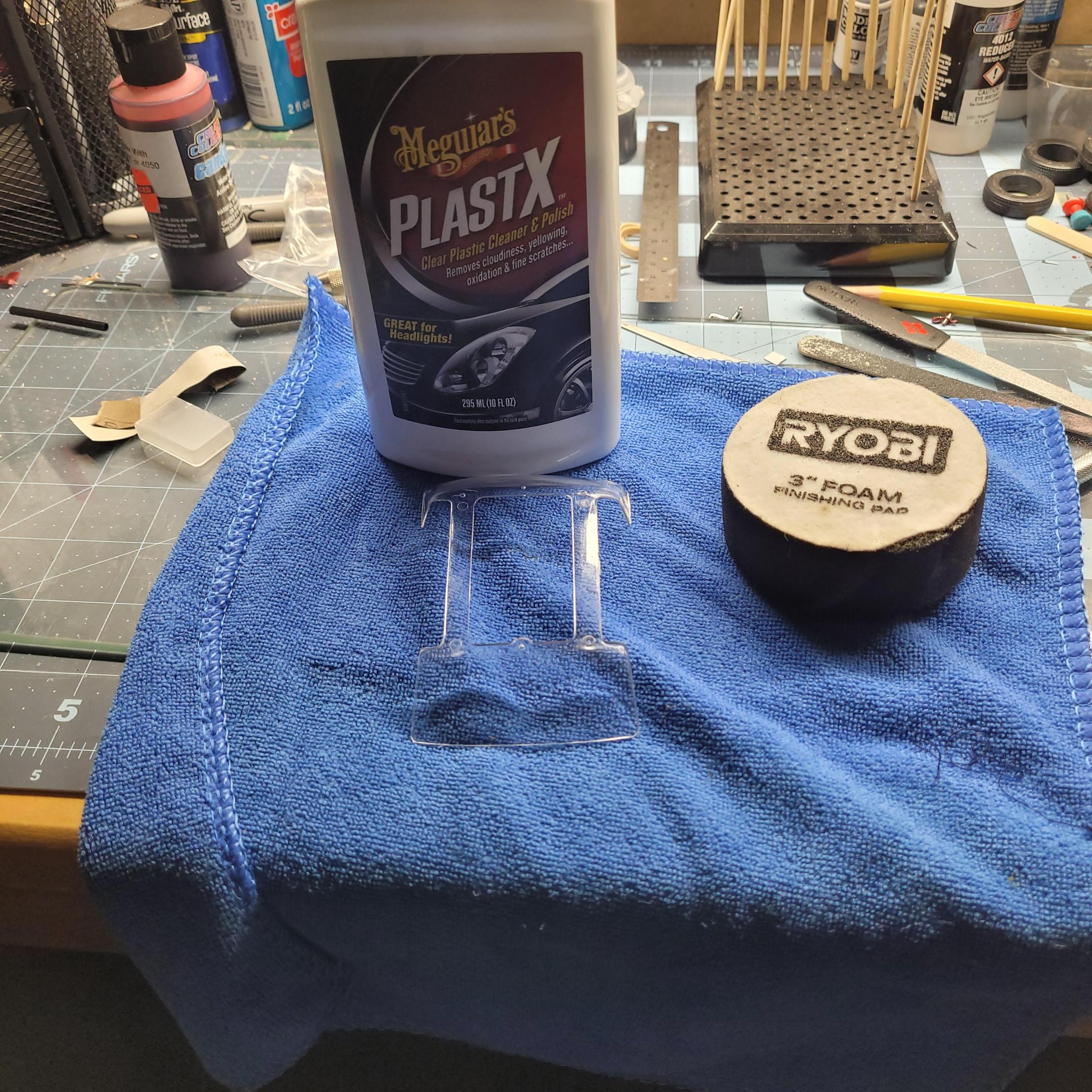

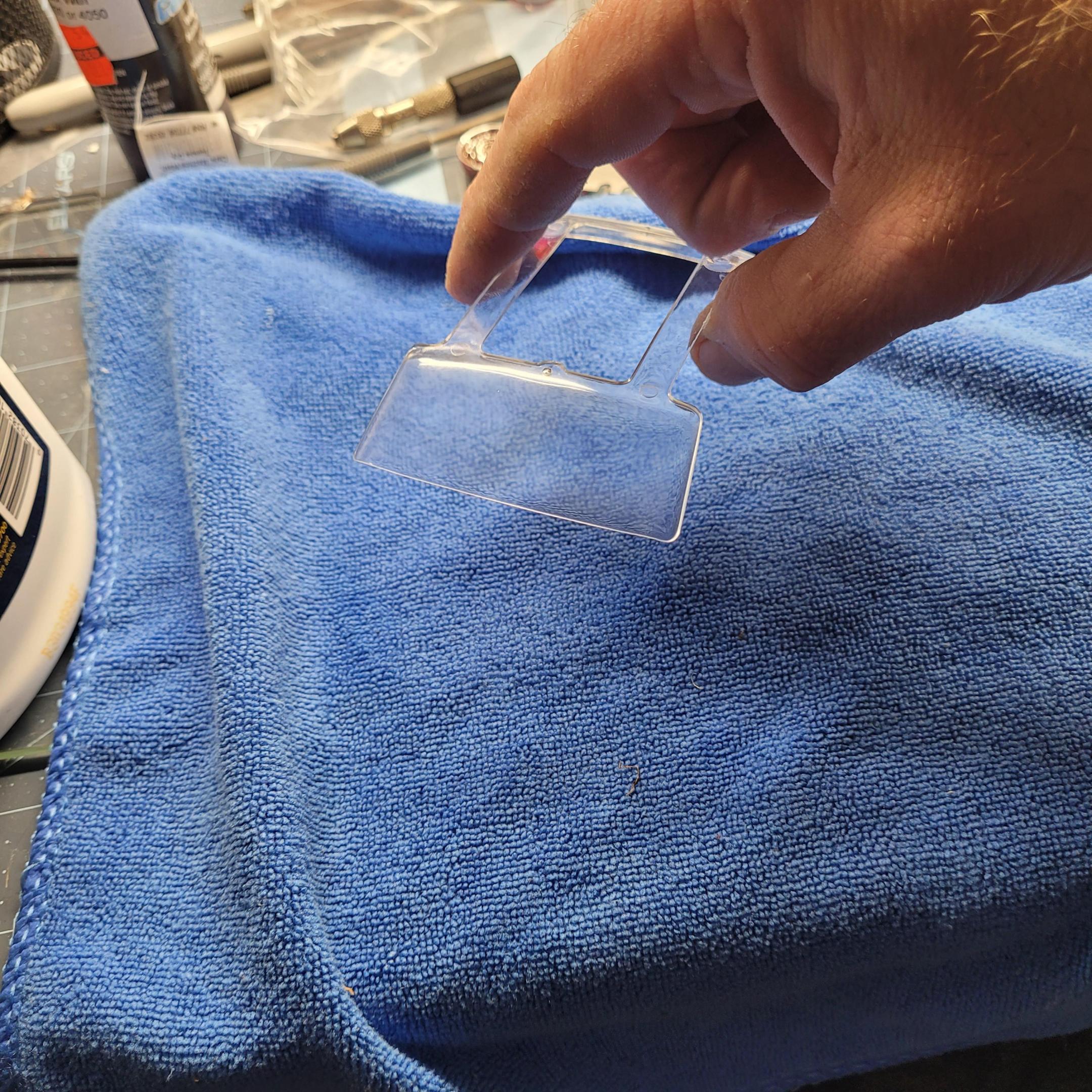

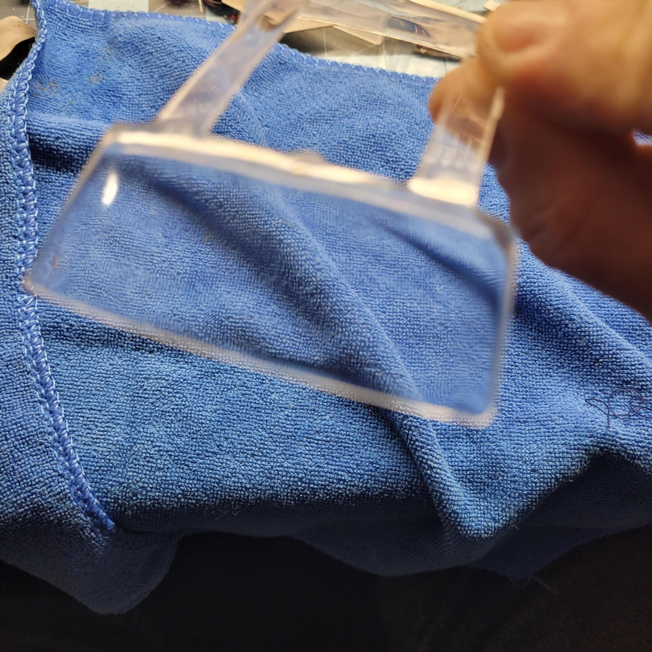

I've saved the glass. About a half hours worth of work. 12000 grit paper, wet and a drop of dawn dish soap for lubricant. Sanded both sides, as it had scratches on both outside and in, of course. Followed up with meguiars plastic x on a pad, and then on a micro fiber. The pads are mildly abrasive,  so it acts like an intermediate step. I think one more polishing and it will be back to original.
