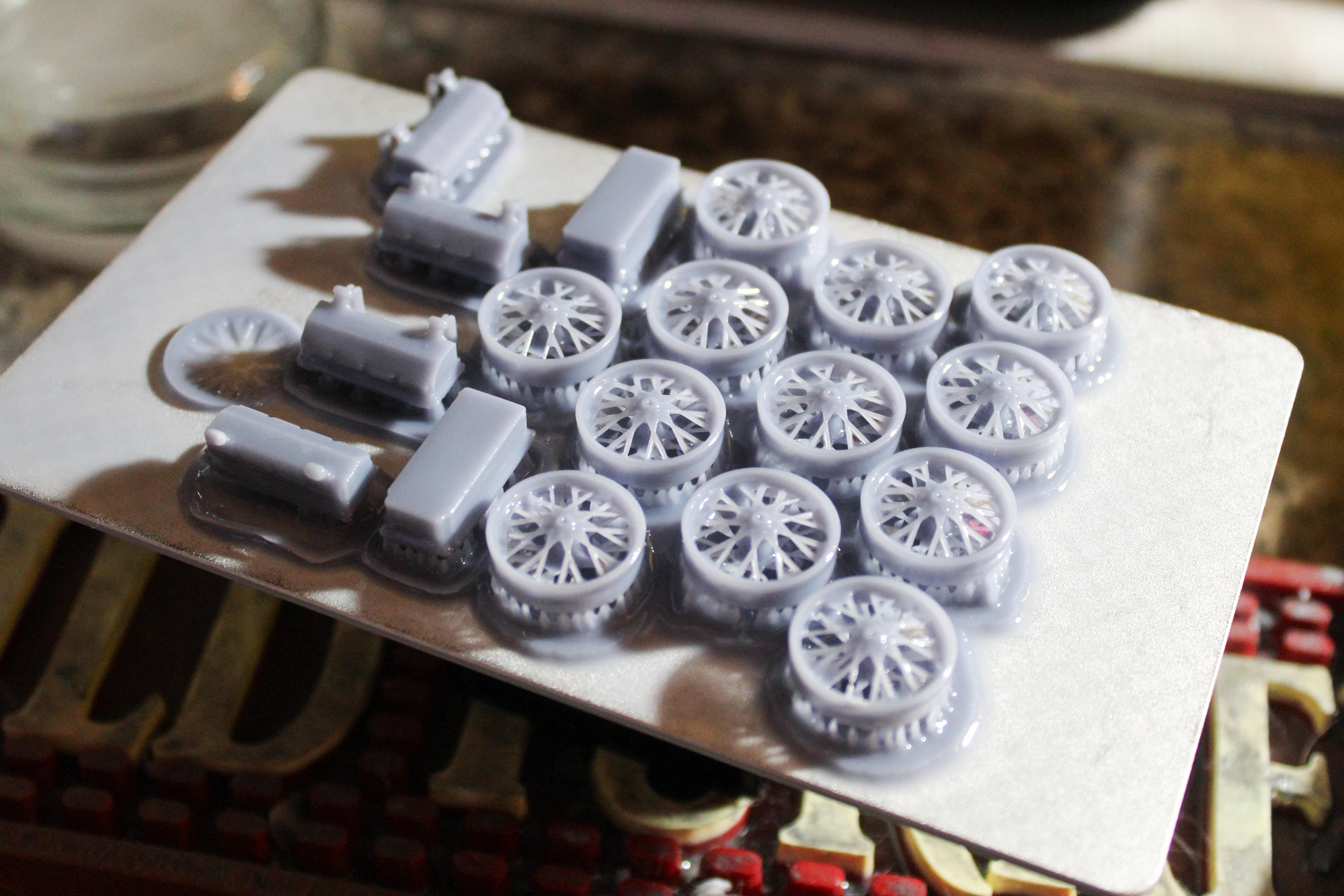

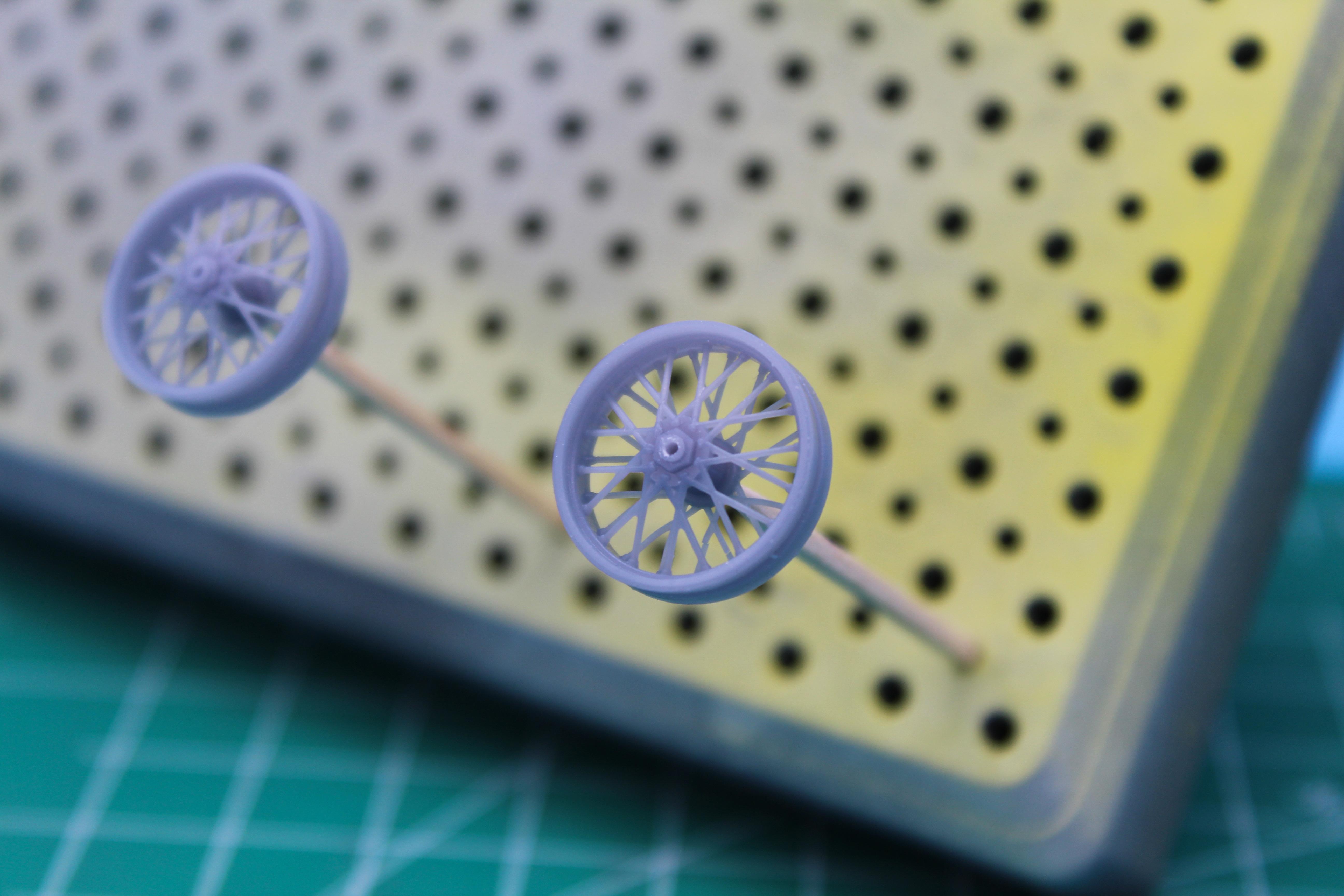

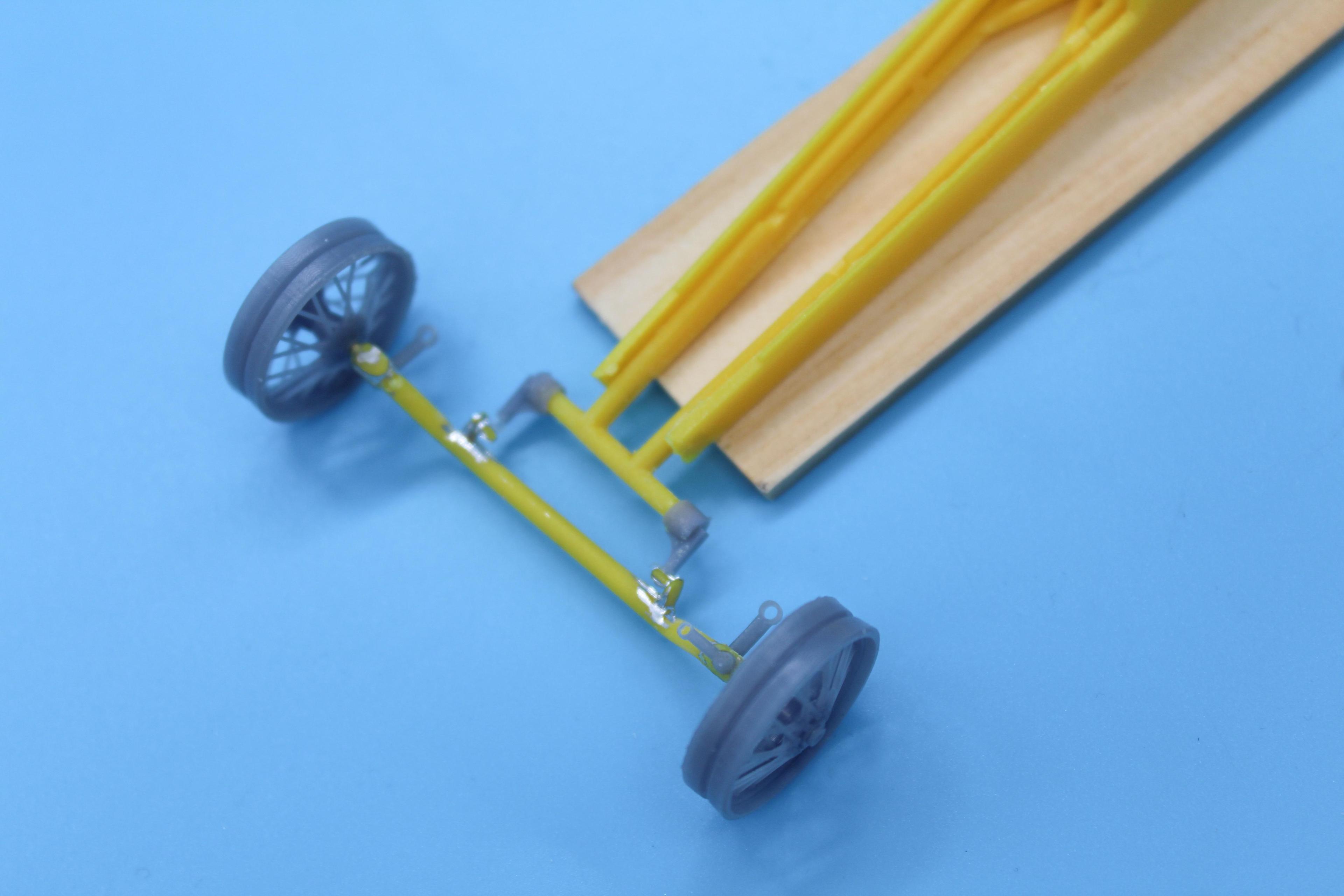

Took a week (the spokes are 0.4mm thick so they’re REALLY tricky to print) but I got an acceptable set eventually:
To put it into context - of this batch here, I only got a couple of good sets (and this was the SUCCESSFUL batch):
High rate of attrition…
Now that I’ve figured that out, and I wasn’t going to build one of these with those chunky styrene kit wire wheels, I can start at the front and work back.  The front axle will be the other challenge on this one - the axle isn’t too bad, but the front suspension is pretty blobular.

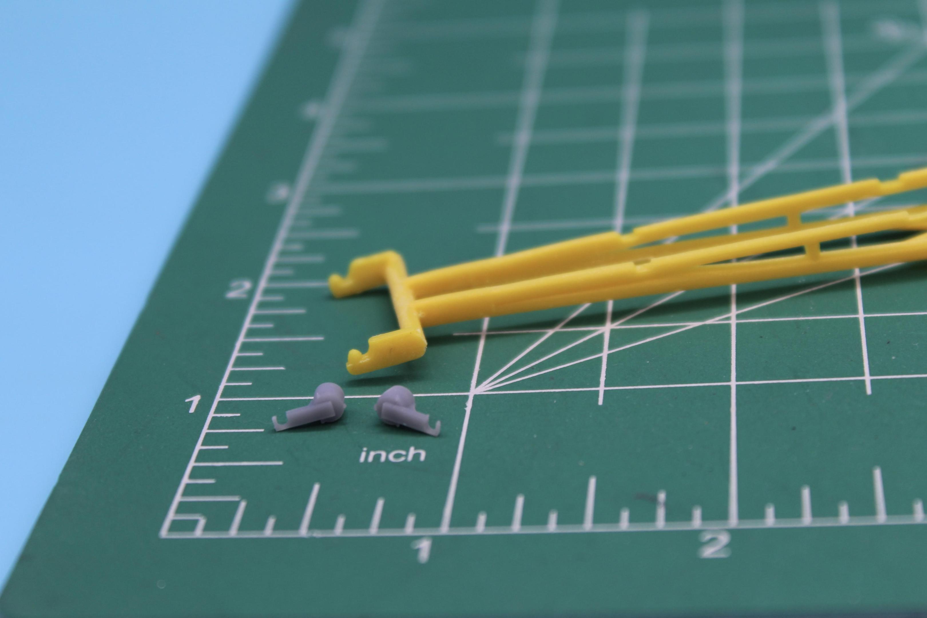

Designed and printed some replacement pieces that will sleeve onto the kit frame…
Chopped the existing horns off, cleaned it all up and they install like this:

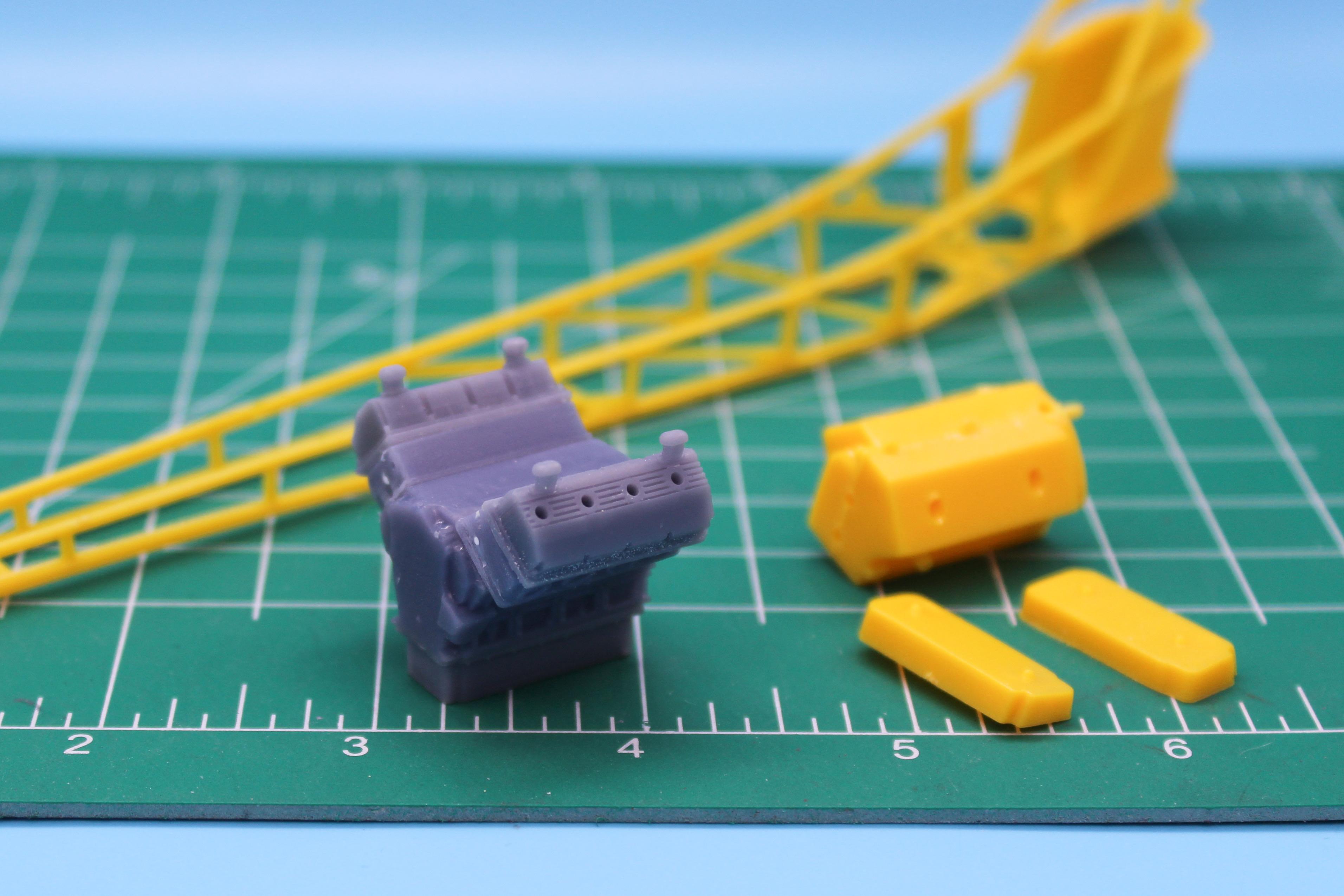

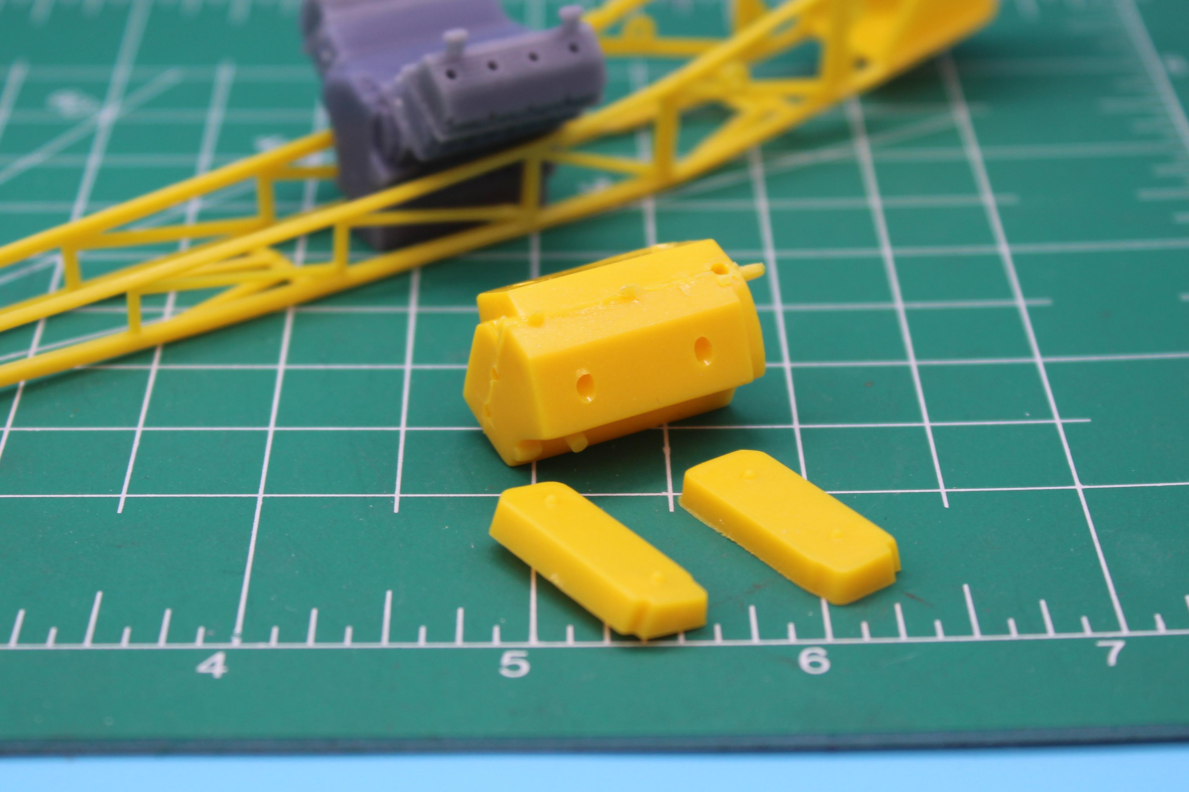

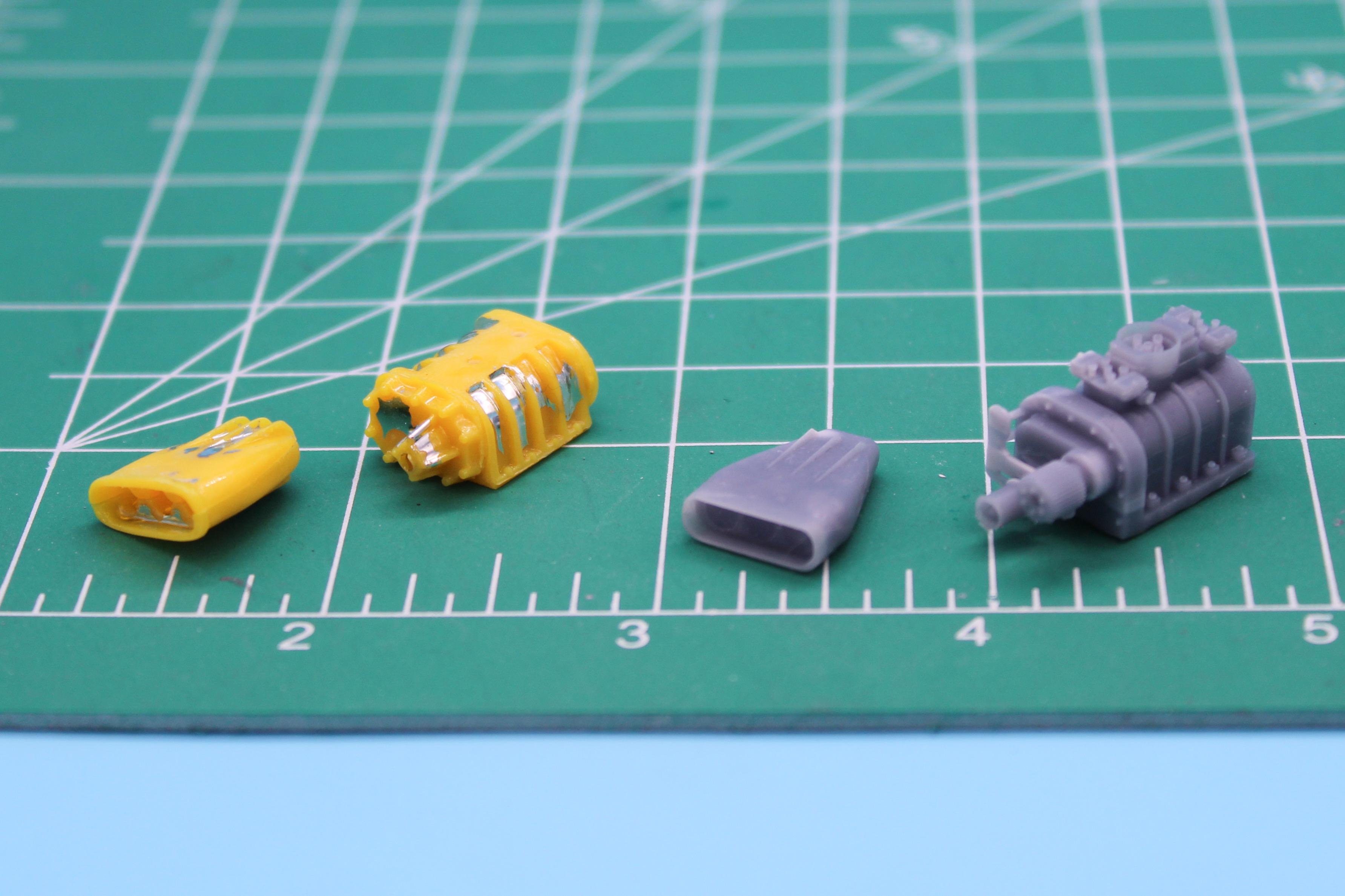

Whilst the printer was running, I also tackled the engine - I’m not ready for that yet, but this Matty’s 3D printed piece is WAY better than what the kit gives you:
I’m actually planning to use the kit induction setup if I can…a hybrid of the printed block and some of the kit parts, but we’ll see how that works out once I’ve got the stubborn-to-remove chrome off those bits so I can start playing with them…

This is a render of that block - I’m no Hemi expert and I THINK it maybe be a few years too modern for this era of build…but it’s better than what came in the box at least.  I’m sure it would be ok for a Cacklefest car at least:

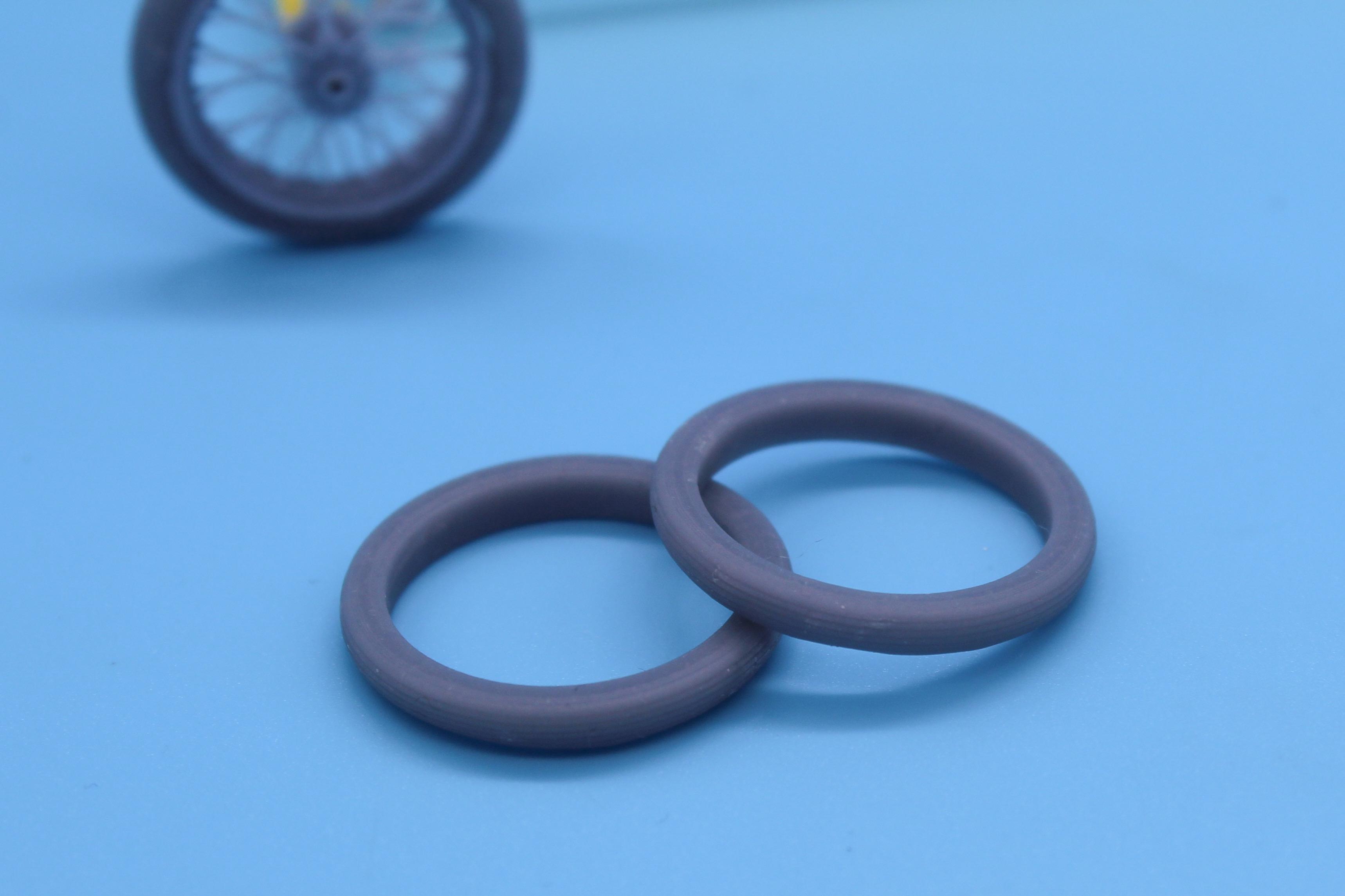

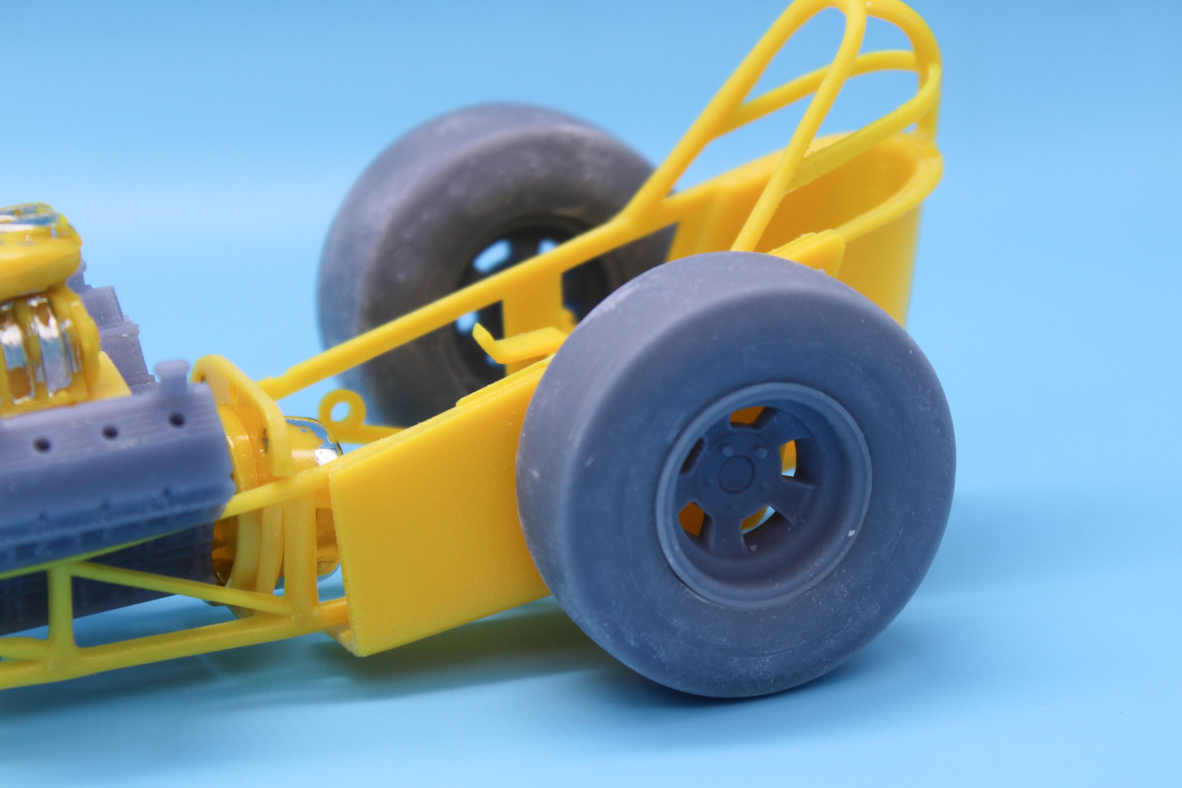

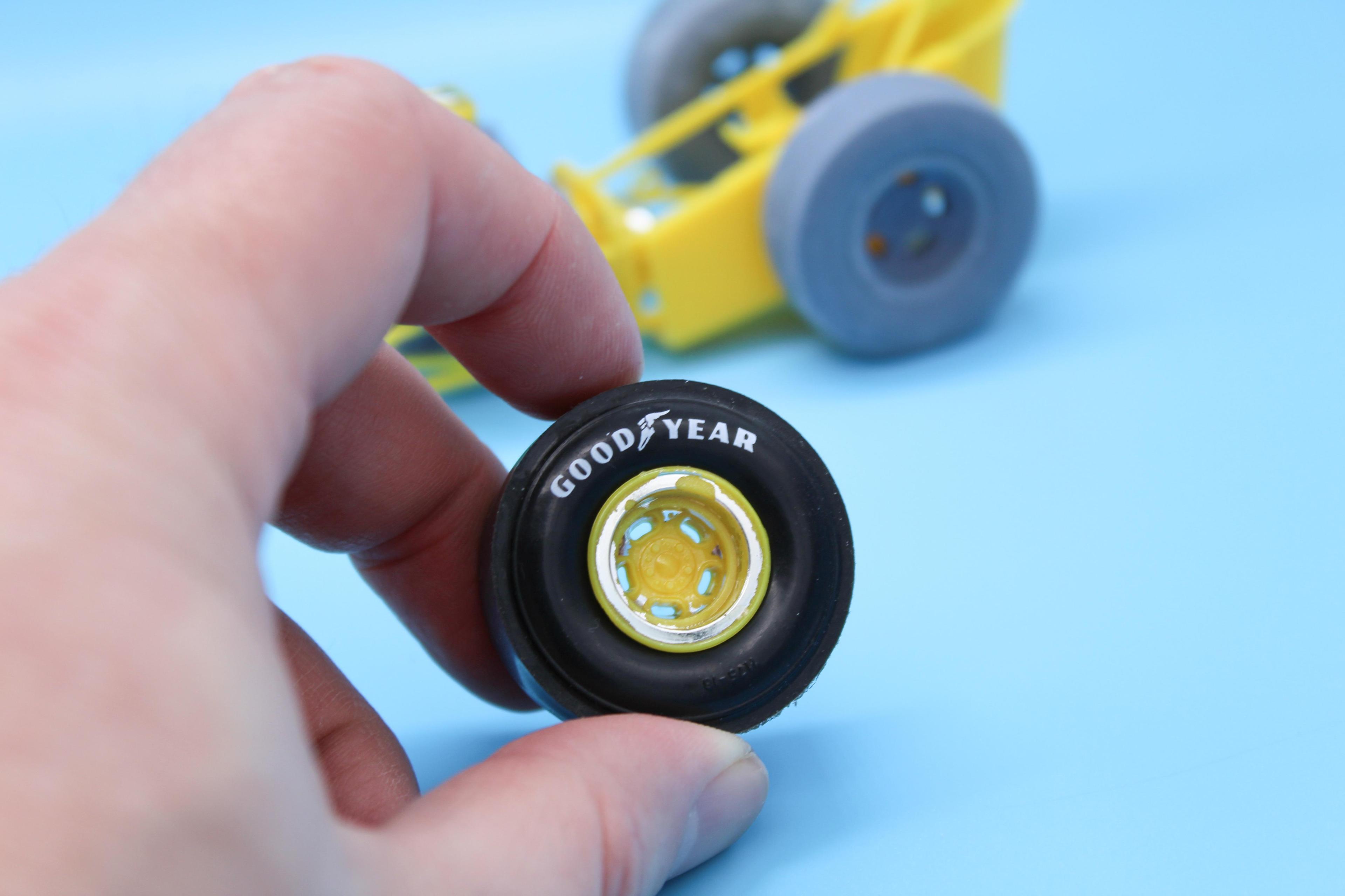

Fronts were easy…printed some cycle tires to fit my wire wheels:

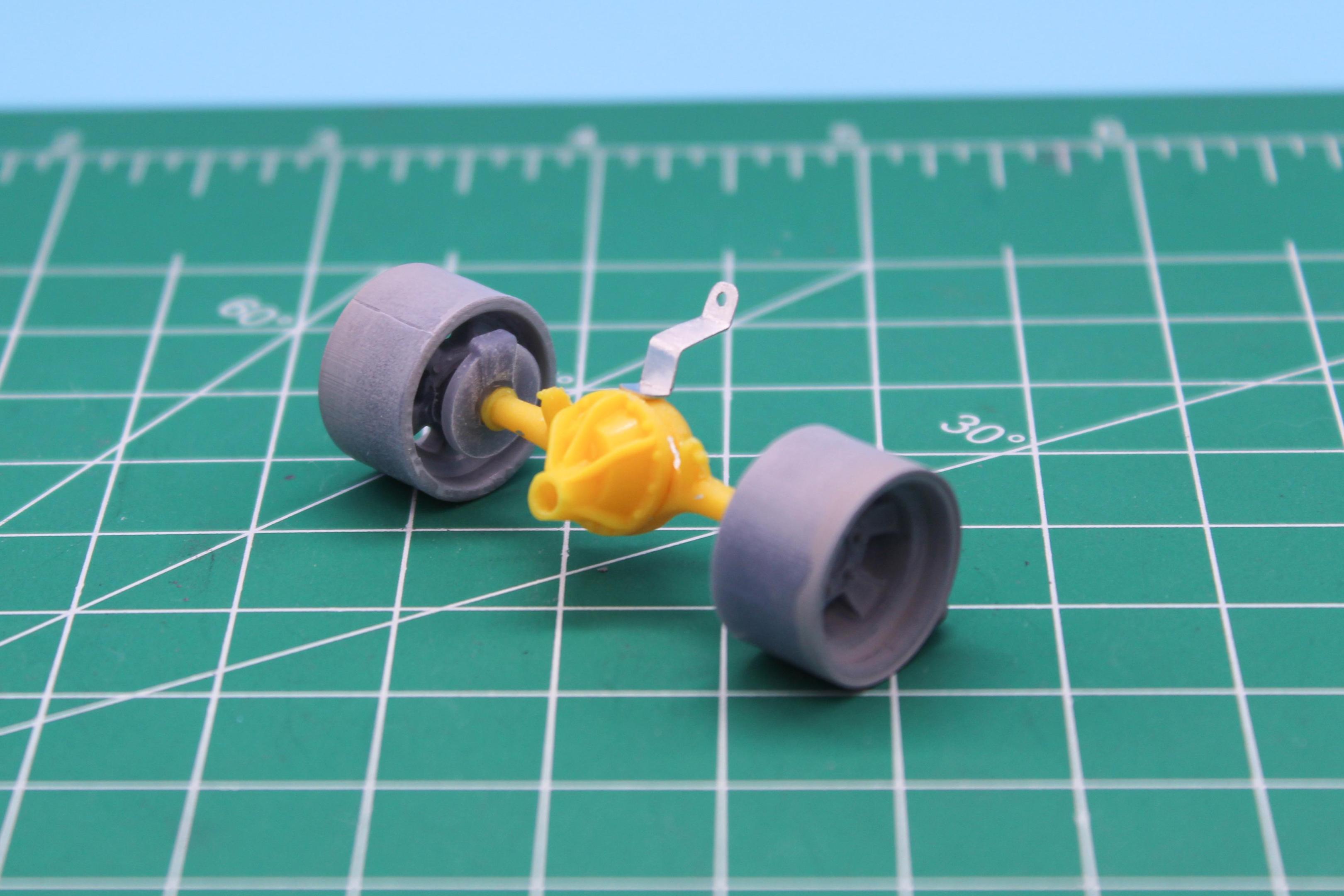

The kit rear tires are okkkkkk-ish, but the sidewall is way to square, and they have different manufacturer logos depending on which side you look at…
These still need some post-processing, but I think they’re a bunch better:

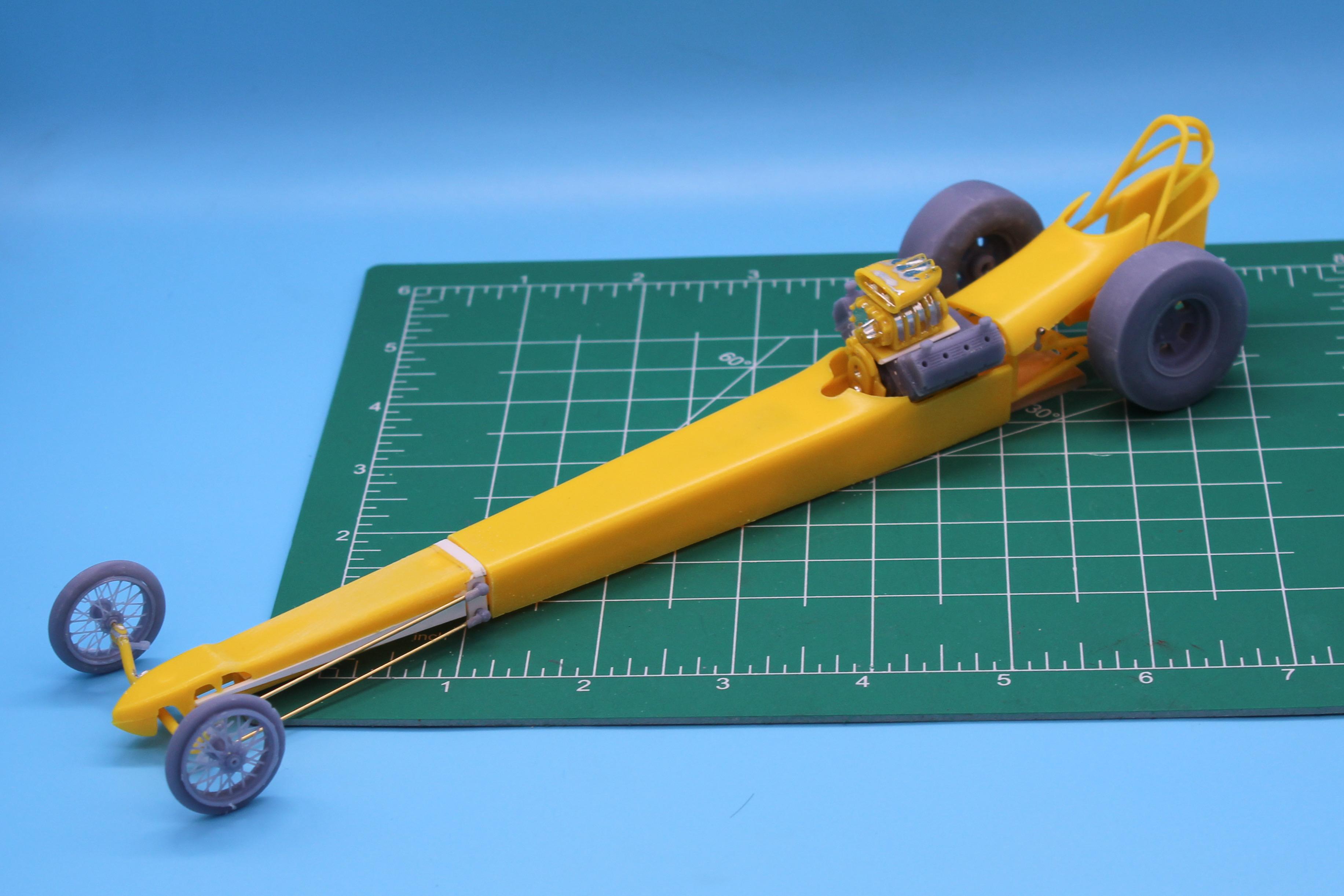

Quick mockup with my new tires…looks like a dragster to me!

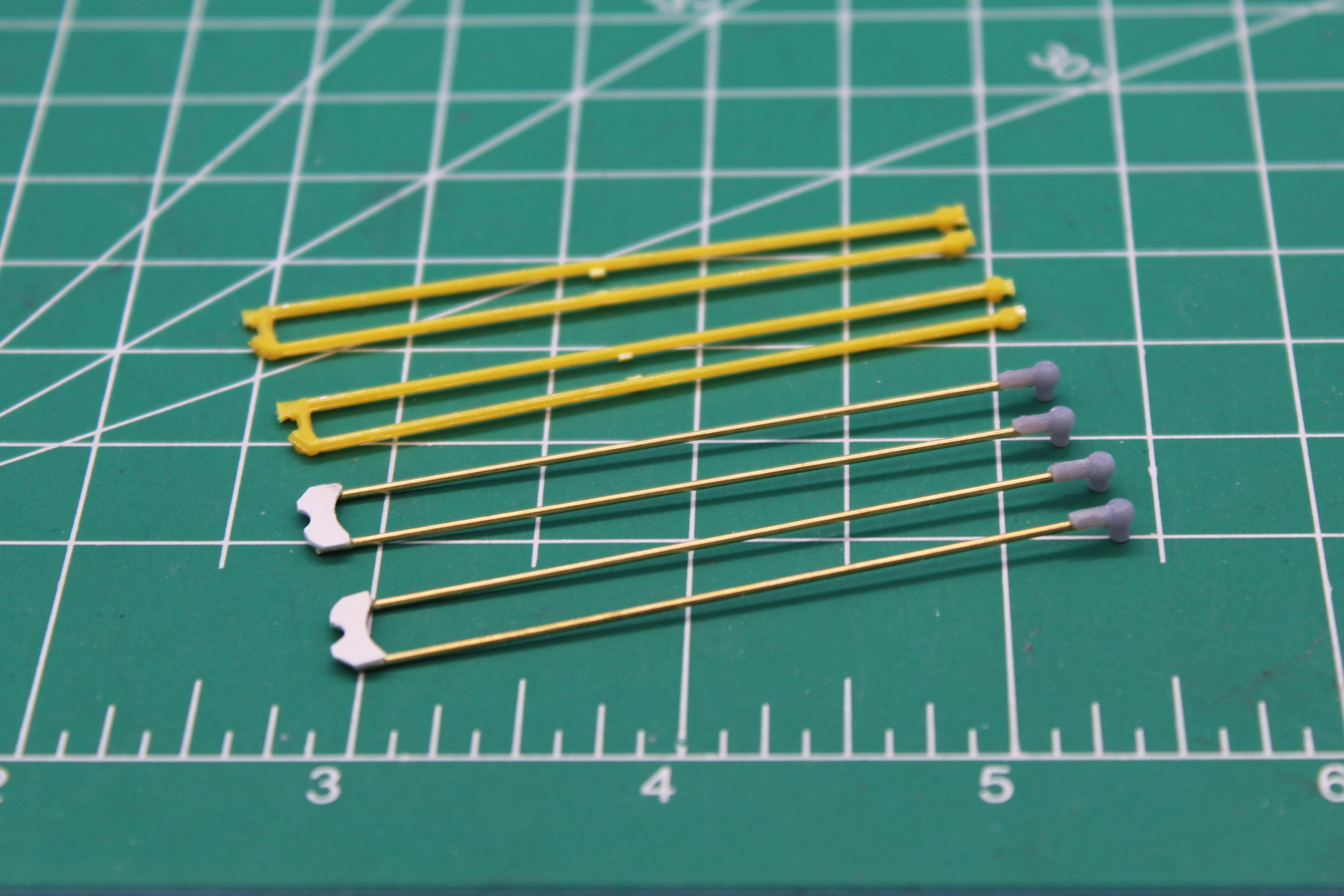

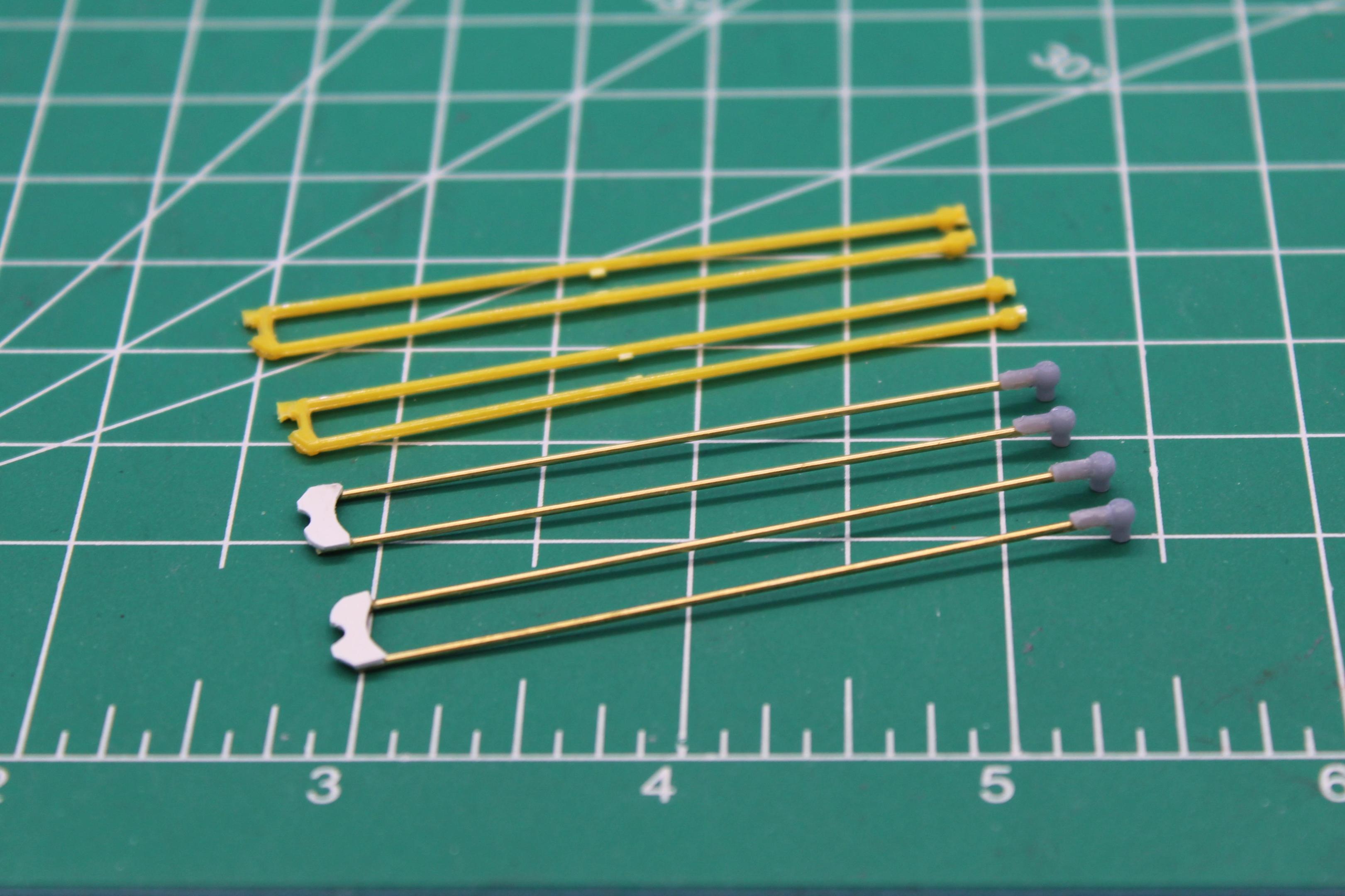

I needed to finish off the front suspension linkages - the kit ones are a little rough so I printed some rod ends and just made my own:
WAY crisper!

As you can see, I’ve started messing with the body a little also…this kit isn’t really designed with having the body panels be removable in mind - so I started the cutting and shutting today so that with the frame completely assembled I can (hopefully) add and remove the body panels as I see fit.  I did toy with running the bare minimum of a body - but I want some surface area for a nice paintjob too…
Still have to finish locking in the exact mounting position for the motor, figuring out the steering and a couple of little projects and then I can start really going back through this thing and doing some fun detailing…thanks for looking - more soon, soon as I’ve done more!

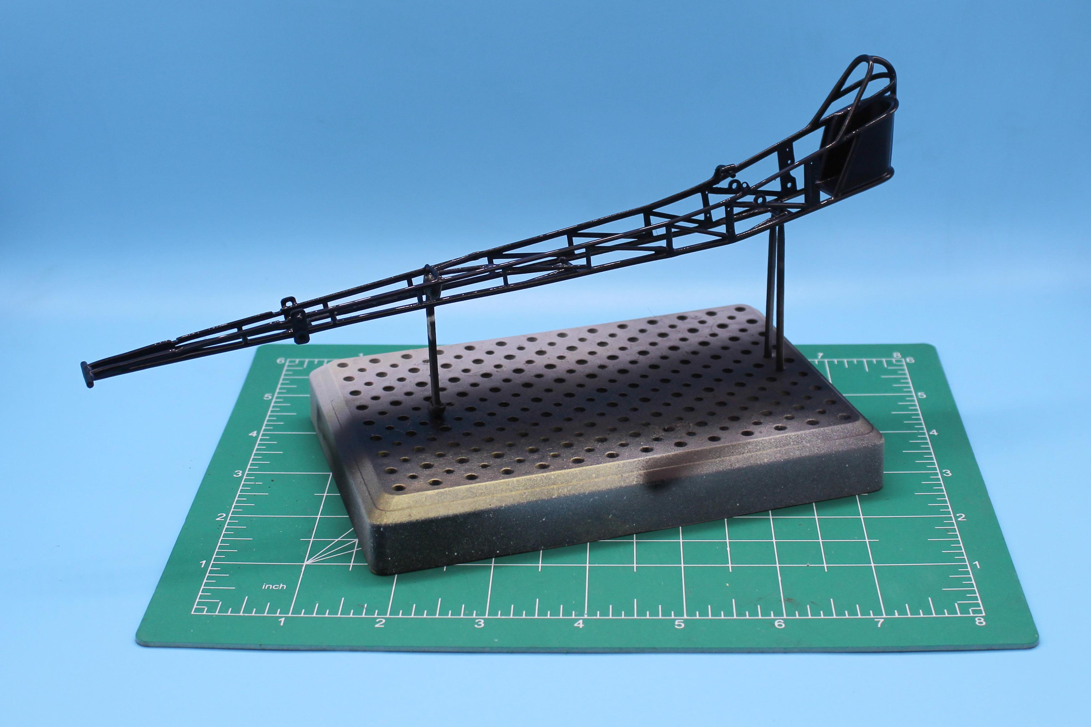

I DID get the frame shot in some Createx black, followed by their high-gloss clear…this frame has so many fiddly little bars and braces that I didn’t really want to have to try polishing it to make it look decent, and a few good wet coats seemed to work ok:

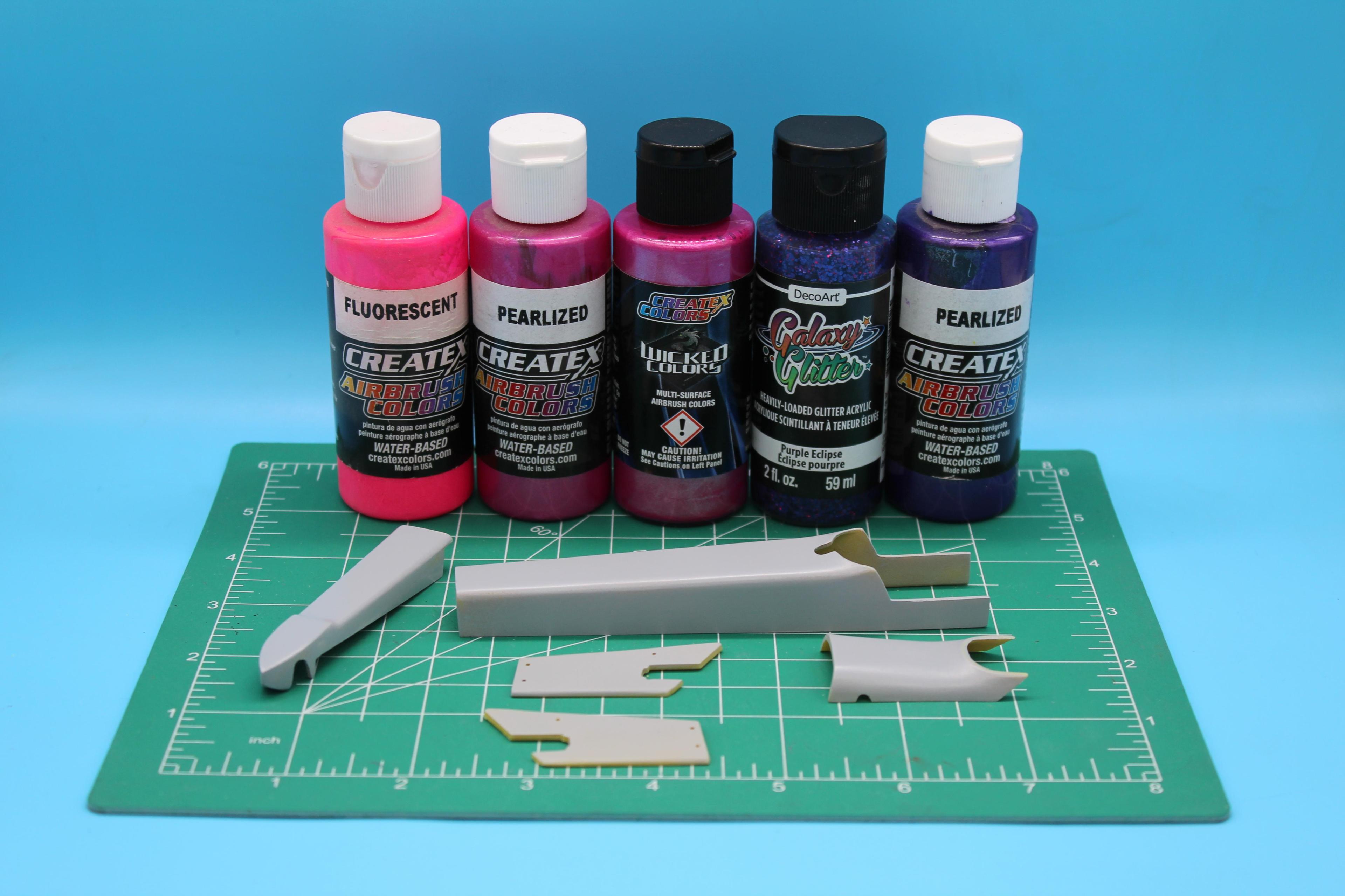

I’ve got a really colorful paint scheme in mind for this one, and I want there to be a bunch of chrome so I opted for a simple black frame and engine block to really help the more interesting stuff pop.
Speaking of color-scheme, here’s the palette I’ll be using on this one:
Definitely going for a traditional INSPIRED look, but as though it’s a modern paintjob - really excited to get to work on this.  It won’t be a perfect reproduction of a period correct car, but I’m hoping it WOULD be welcomed with open arms to any vintage drag or cacklefest type event…

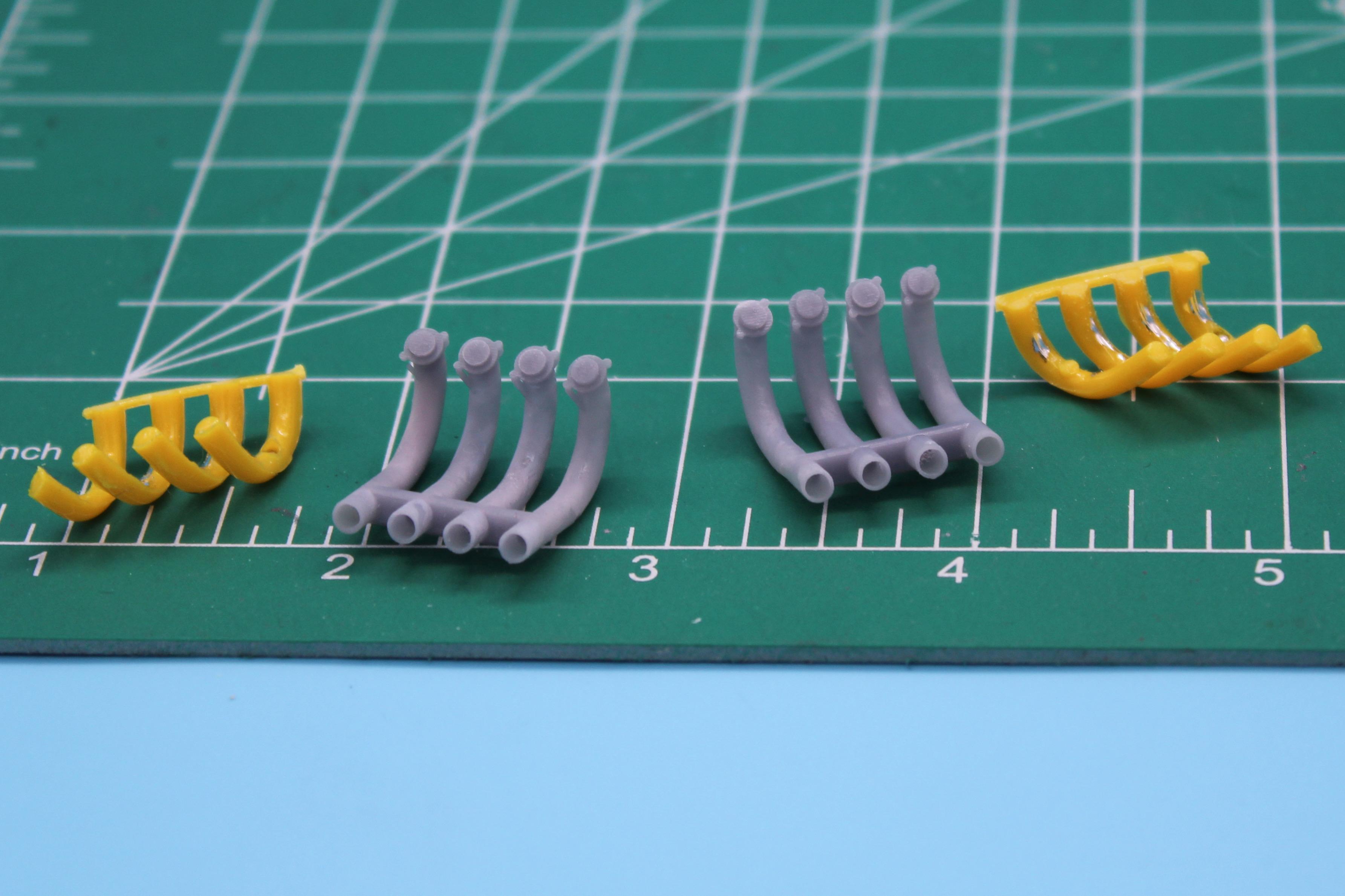

Oh, and the kit headers didn’t look like they’d be fun to try and open up OR clean-up, so I printed some better ones.
They’re actually hollow all the way down, which means they should look super realistic on the car…but they’re REALLY fragile.  We’ll see how many of these I ruin before we’re done ?

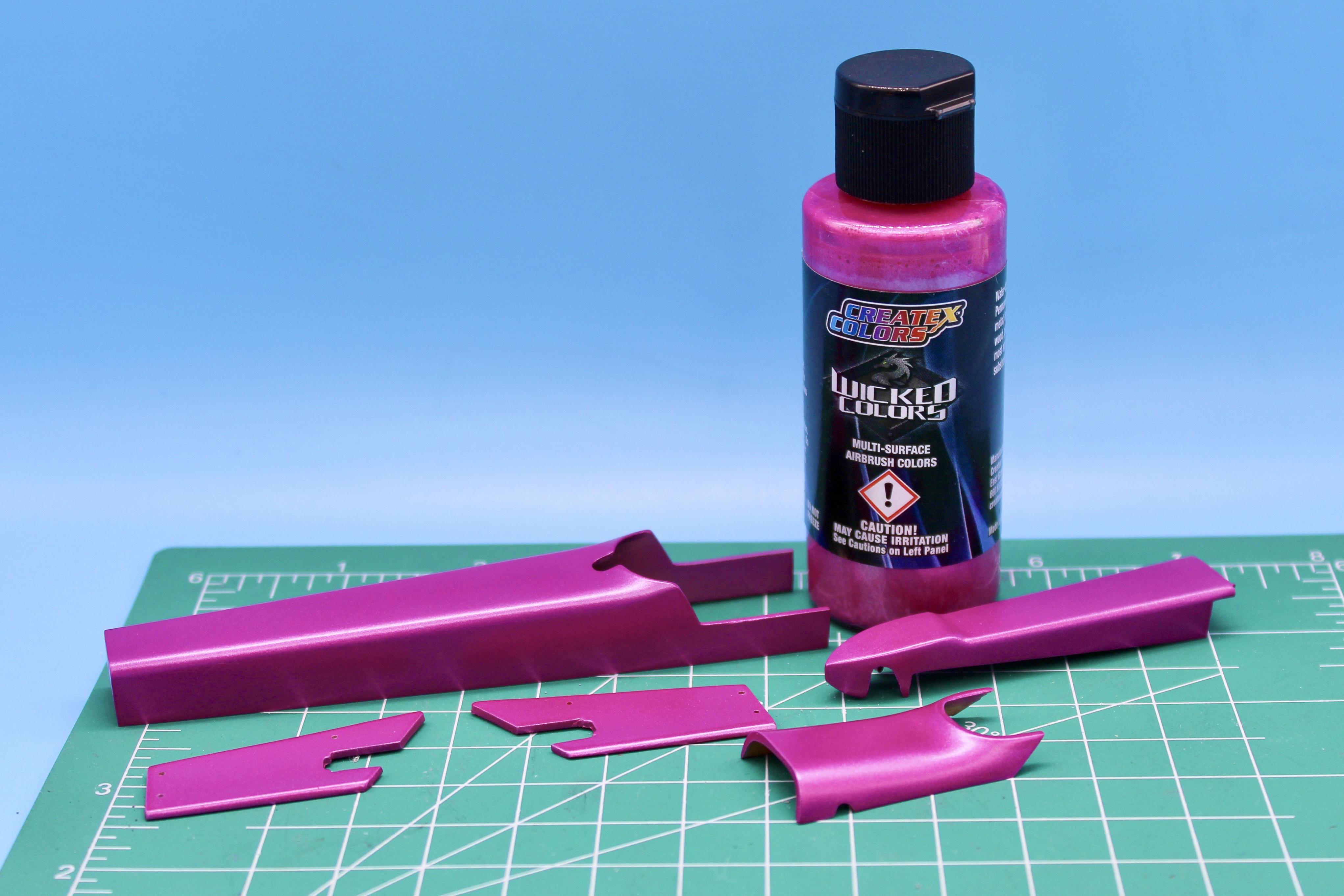

Thanks fellas!  A little more progress this week…most of it fairly disjointed and all over the place - but it makes sense to me…
Got the body in paint!  Spent forever trying to find the color I had in my head and then found it in Wicked Color’s paint line…I use their paint a lot so I should’ve looked there first, duh;

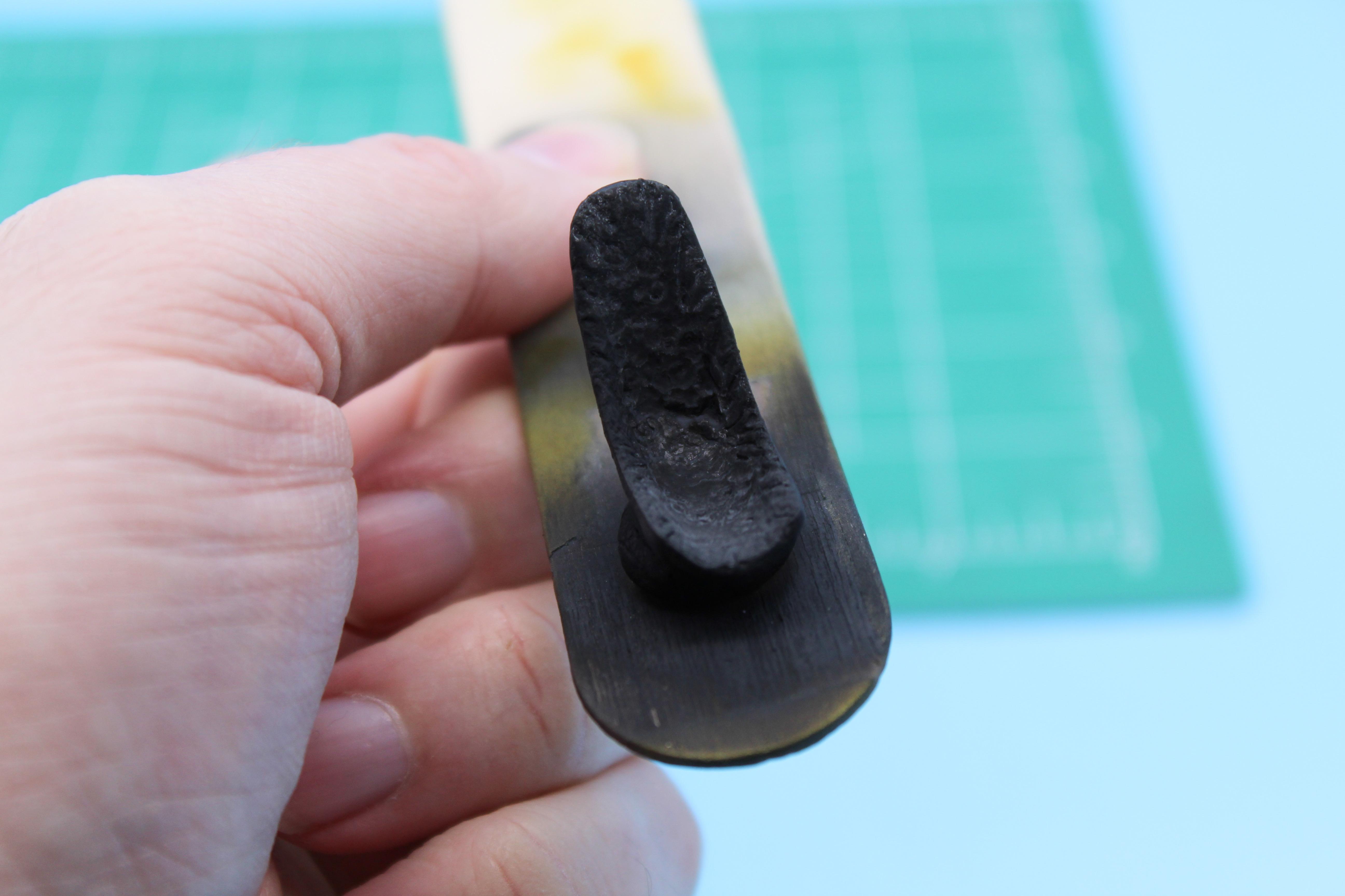

The kit seat is made of rubber (or vinyl, probably) same as the kit tires, and it’s not the best…sliced and diced a parts-box part to fit the frame and then played with that putty some more to add the same wrinkly kinda fabric texture as the parachute pack:
I went a bit overboard with the creases and wrinkles on this one - I figure the seatbelts will hide a LOT of this but I still want the interesting texture to show, so I just kept going…

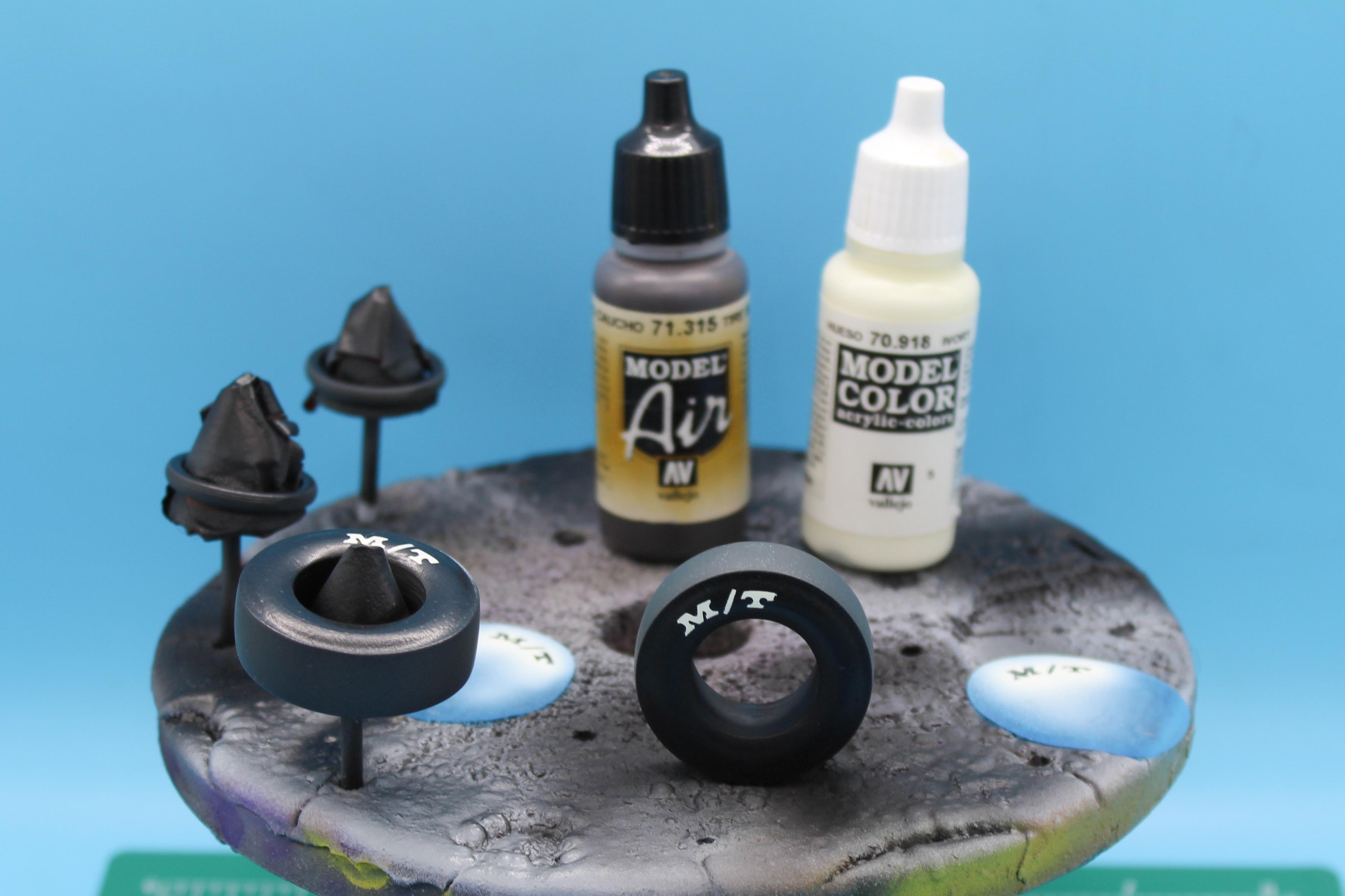

Painted the tires - Createx black to start, then Vallejo tire black and then cut some masks for some lettering…I need to seal these in some dullcoat and then do the next steps:

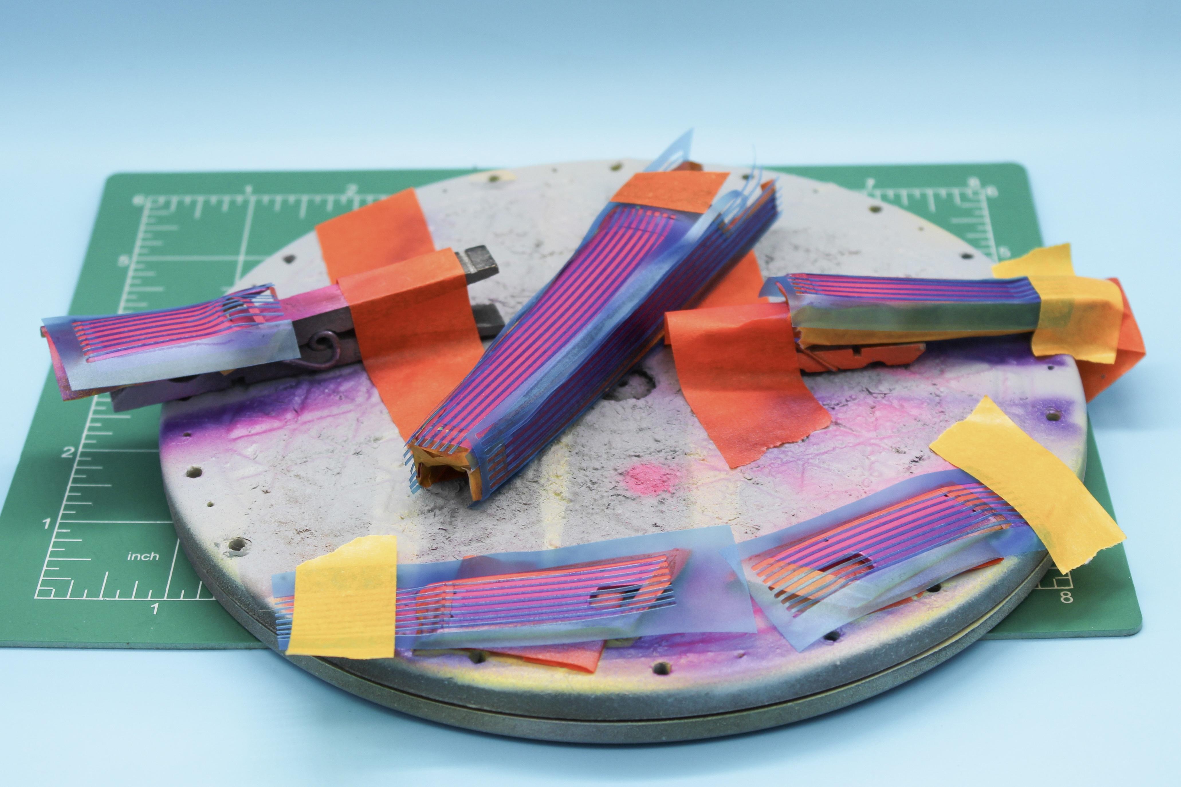

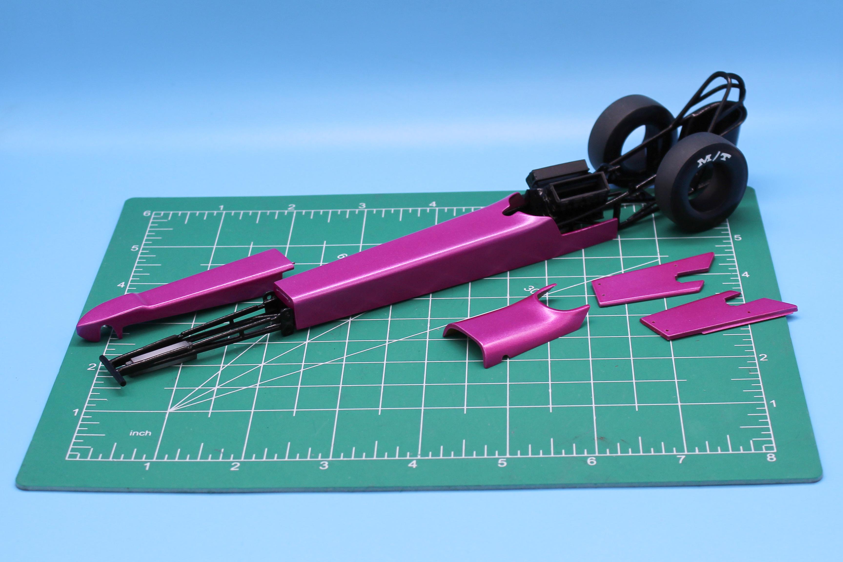

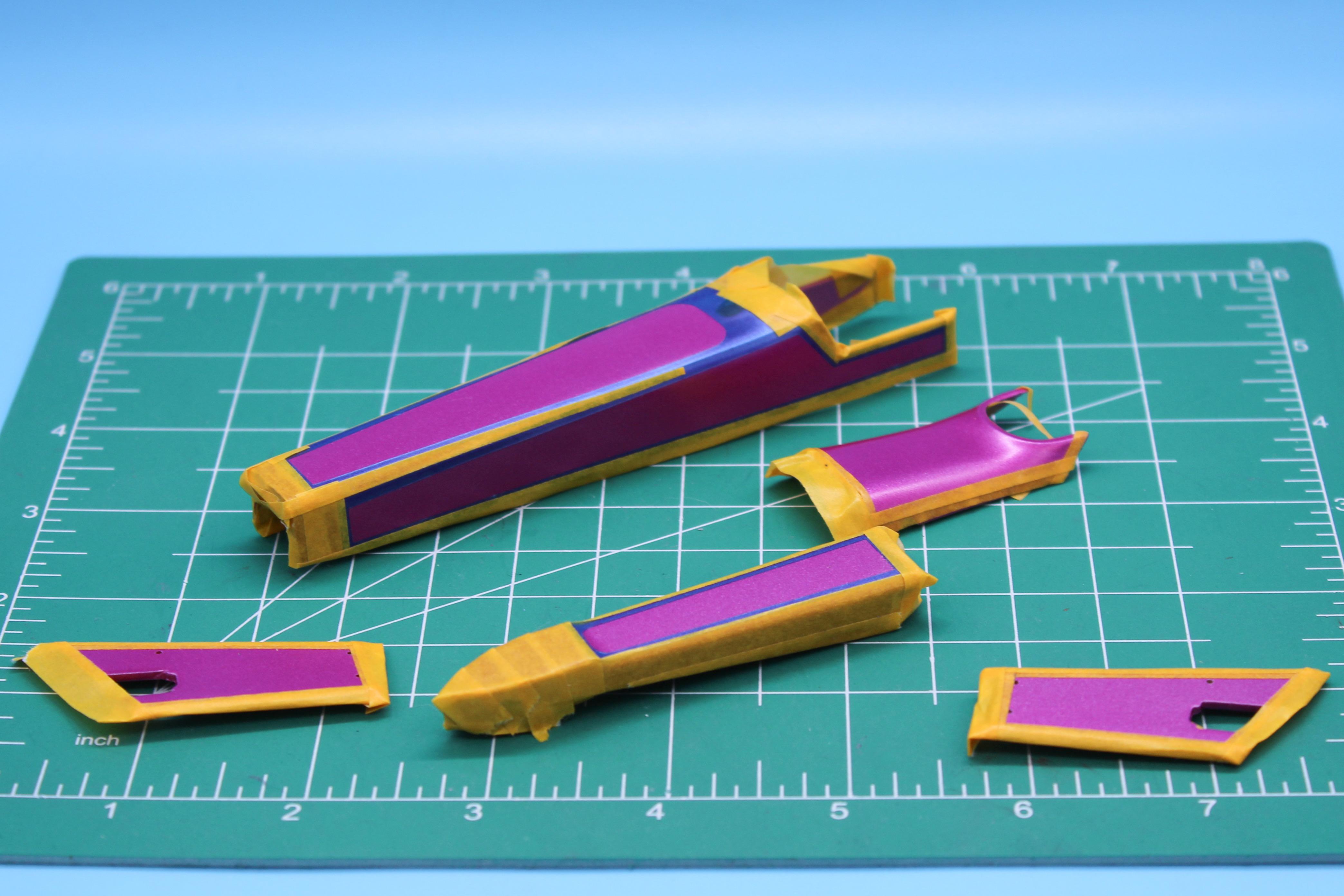

Working on the paintjob this week - not done yet, but about halfway thru anyway…

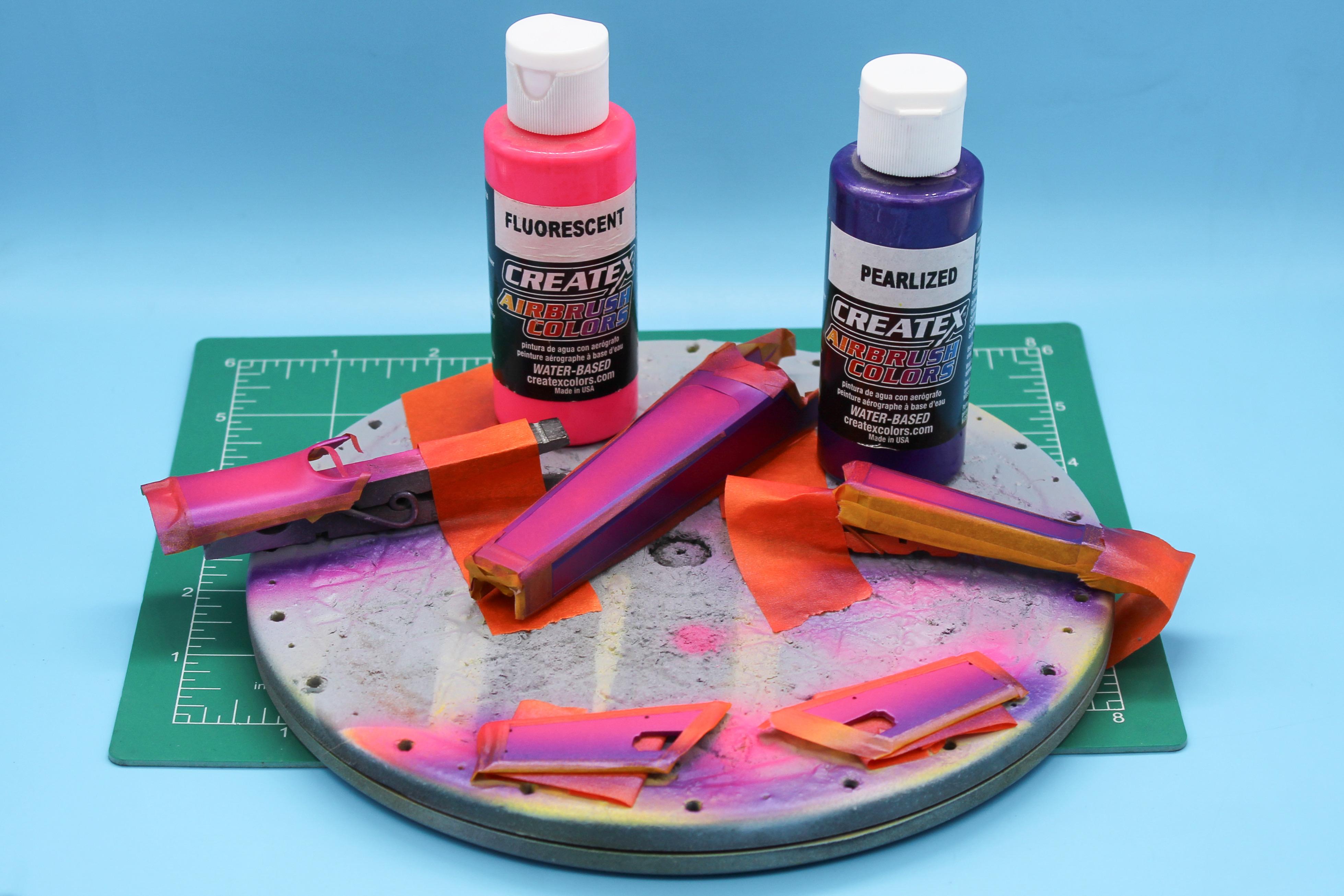

Designed and cut some masks so I can lay down some panels that compliment the shape of the body:
Shot those with some fades between a pearl purple, and fluorescent pink:

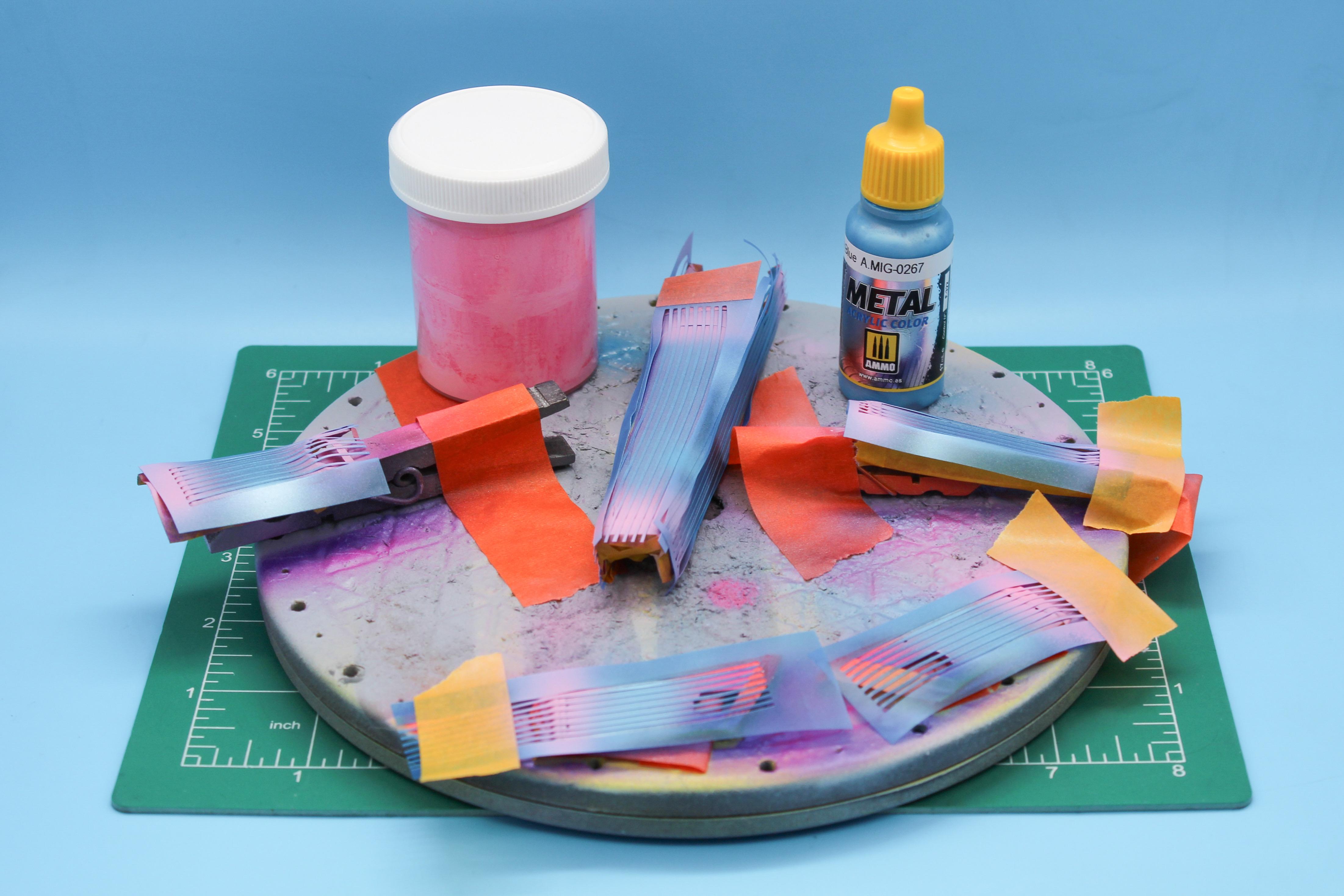

Next up, designed and cut some more masks:
And then shot some more pink (this time a strawberry-milkshake color that I mixed) and some Ammo chrome baby blue:
Remove those masks and we have this:

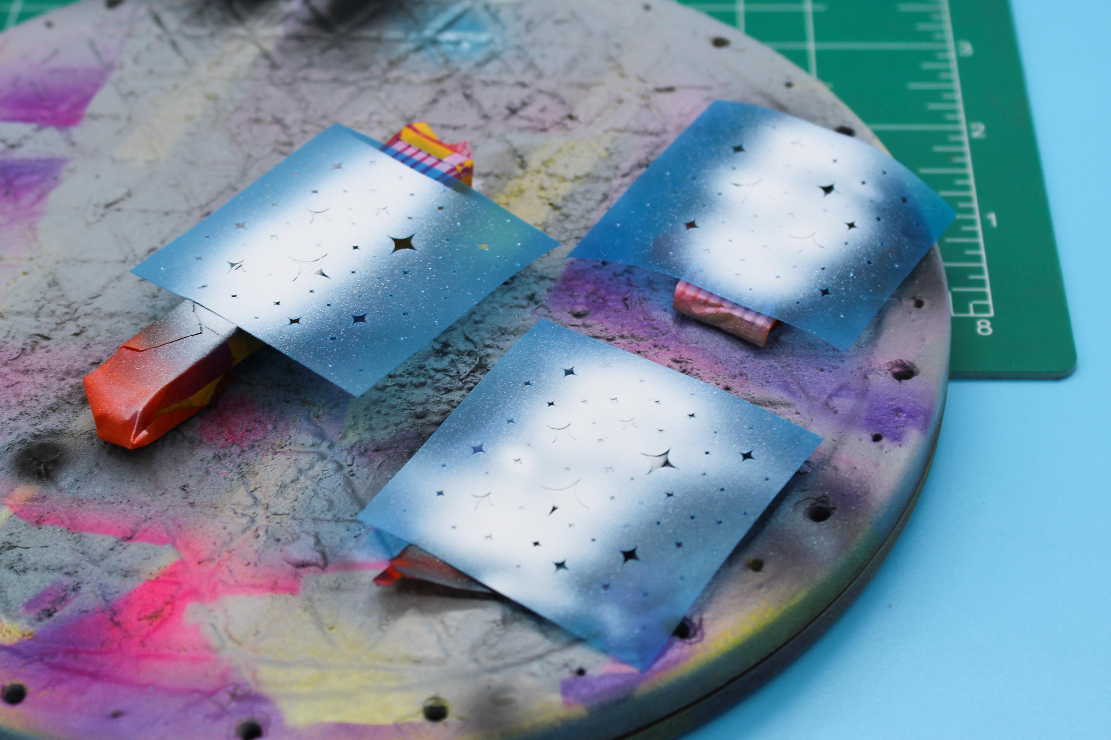

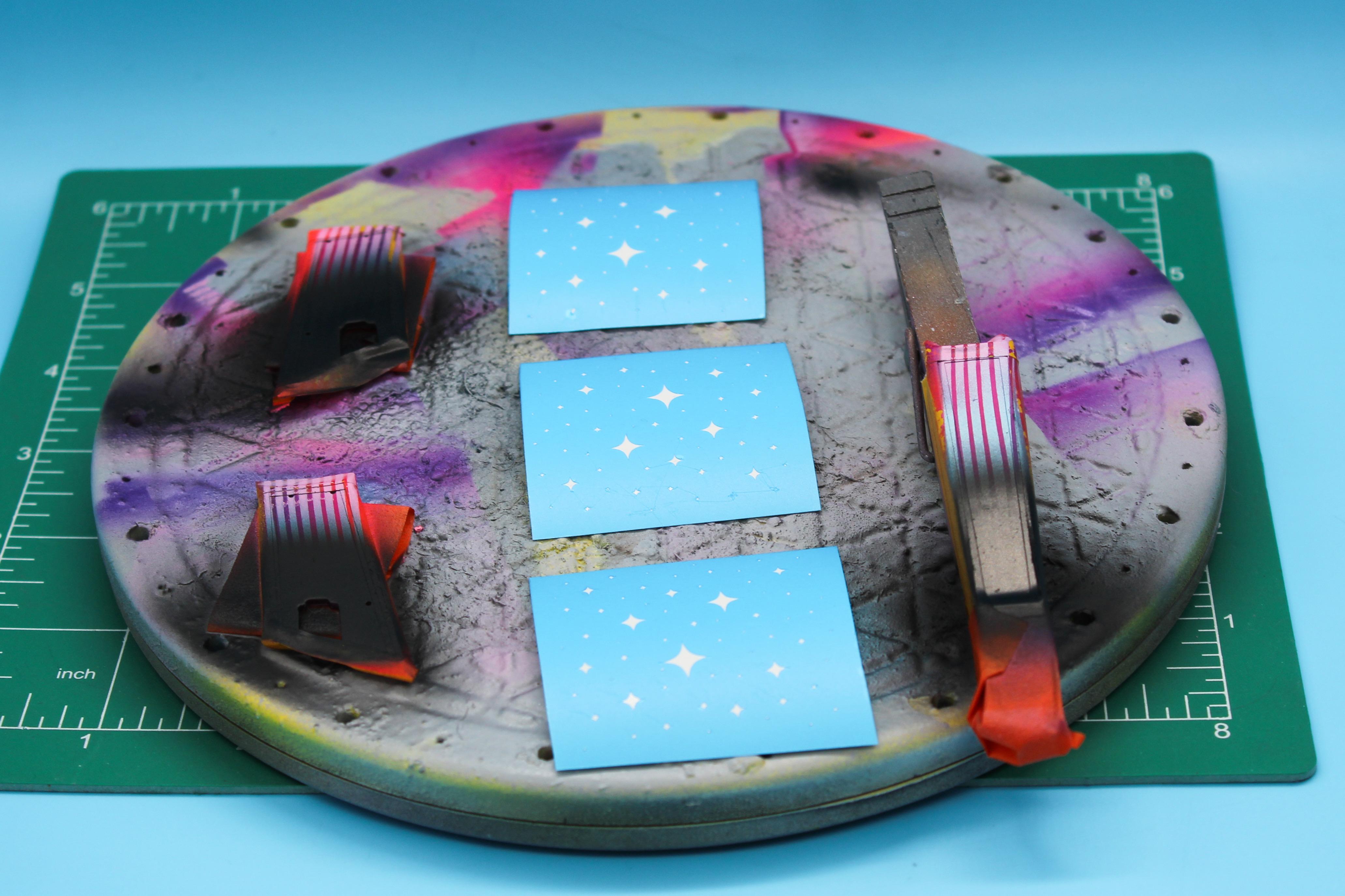

Next up, after letting this dry overnight I cut some more masks (stars and sparkles this time) and airbrushed a black fade on the very front of the nose, and the very back of the rear ‘tins’:
Then, laid down the masks and shot some Vallejo opaque white:

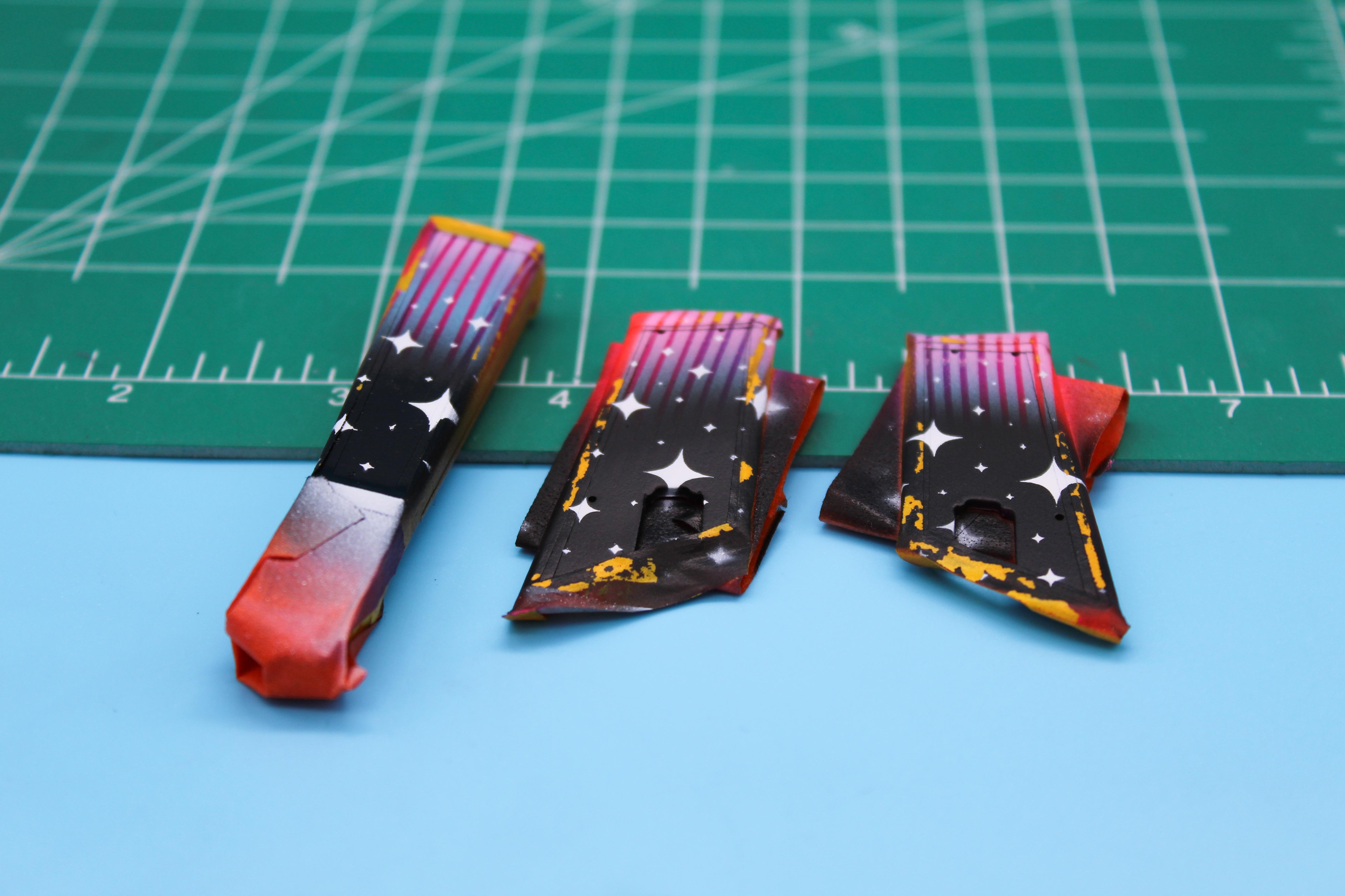

Let it tack up, removed the masks and had this:
That’s most of the graphic-y stuff done on the body before I start adding some signwriting, but before I pulled the masks I added some yellow striping to the edges to stop it looking unfinished, with some extra little dots to add to the kinda sparkly glittery theme I’m going with on this body…then pulled the masks and here’s where we’re at:
