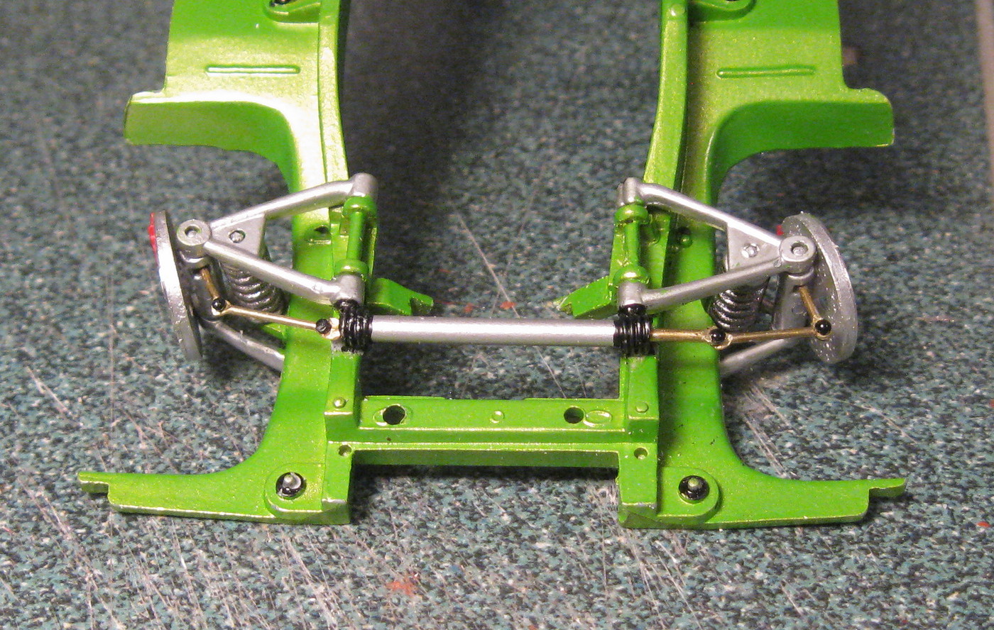

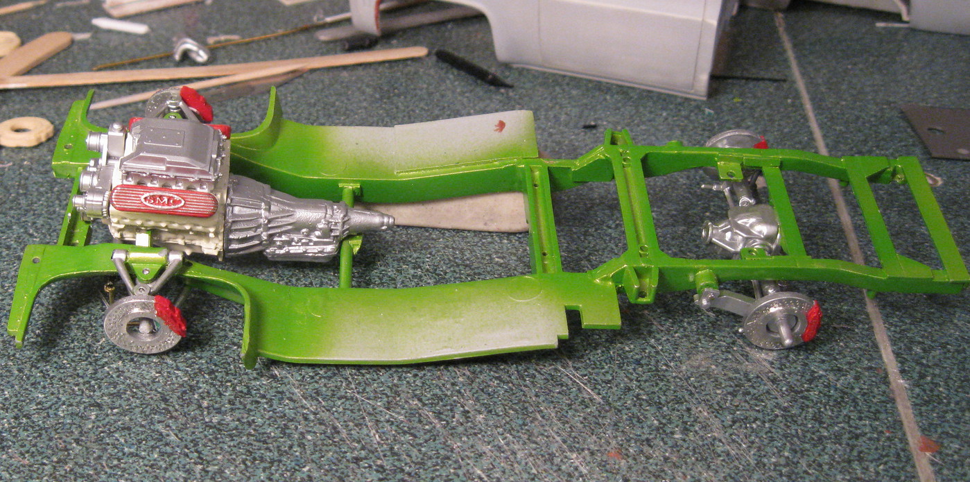

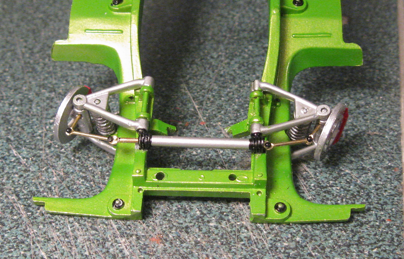

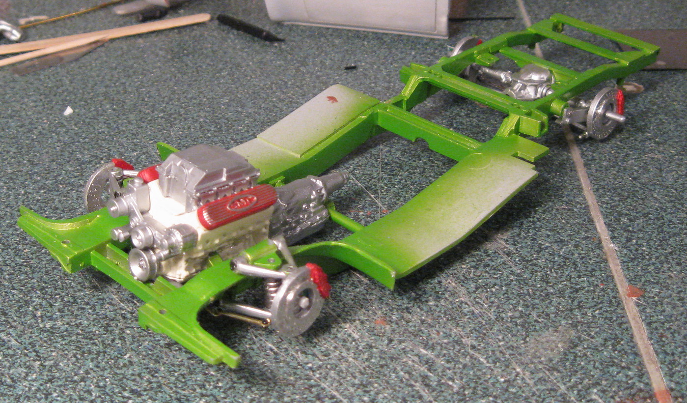

Steve H Posted March 5 Posted March 5 On 3/1/2025 at 5:18 PM, Can-Con said: Chassis is ready to go except for the shocks. I know it looks severely low with the bodywork on but rest assured the ride height and wheel travel would be more than adequate for a few quick laps around a track or a spirited drive on a winding road. Here's a look at my scratch made rack and steering linkage. I would say it looks perfectly low Steve! That is a perfect stance. Very nice work on the chassis. 3

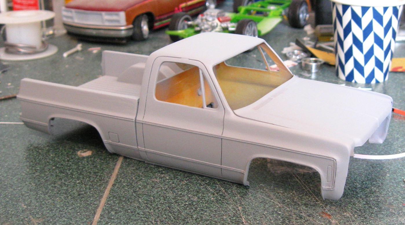

Can-Con Posted March 16 Author Posted March 16 Added the body side trim. Should look a lot better once cleaned up and some primer shot on it. Also did a bit of work modifying the old grille. 6

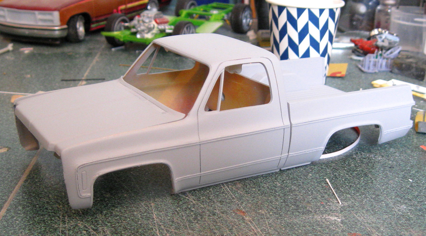

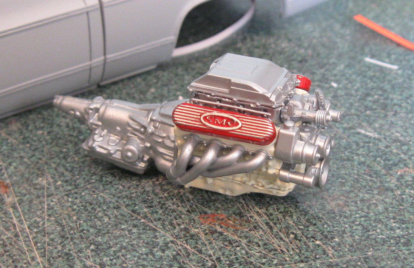

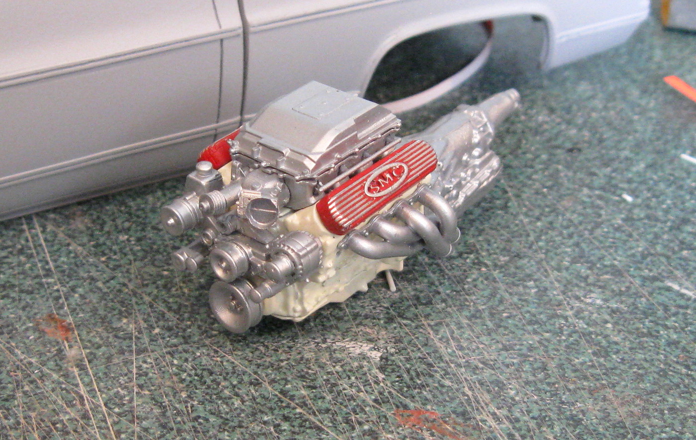

Can-Con Posted March 24 Author Posted March 24 Finished adding the side trim to the pickup and got it in primer. The wheel opening trim really should be doubled like the rest of the trim but I'm getting itchy to paint it. Still needs some more work before that happens though. Also finished the assembly of the engine. Hard to find pics but I did figure out it's a supercharged LSA as used in a 2012 Cadillac CTS-V or Camaro ZL-1 After I found some pics and figured out exactly what it is, I took the intake off and but it back on the right way around. LOL 4
catpack68 Posted March 24 Posted March 24 (edited) Looks great Steve! The engine looks really good.What size styrene strips do you use for the side trim? Looking forward to seeing more progress on it. Edited March 24 by catpack68 1
Can-Con Posted March 24 Author Posted March 24 7 hours ago, catpack68 said: Looks great Steve! The engine looks really good.What size styrene strips do you use for the side trim? Looking forward to seeing more progress on it. Thanks, It's .015X'020. It's the smallest I could get. 1

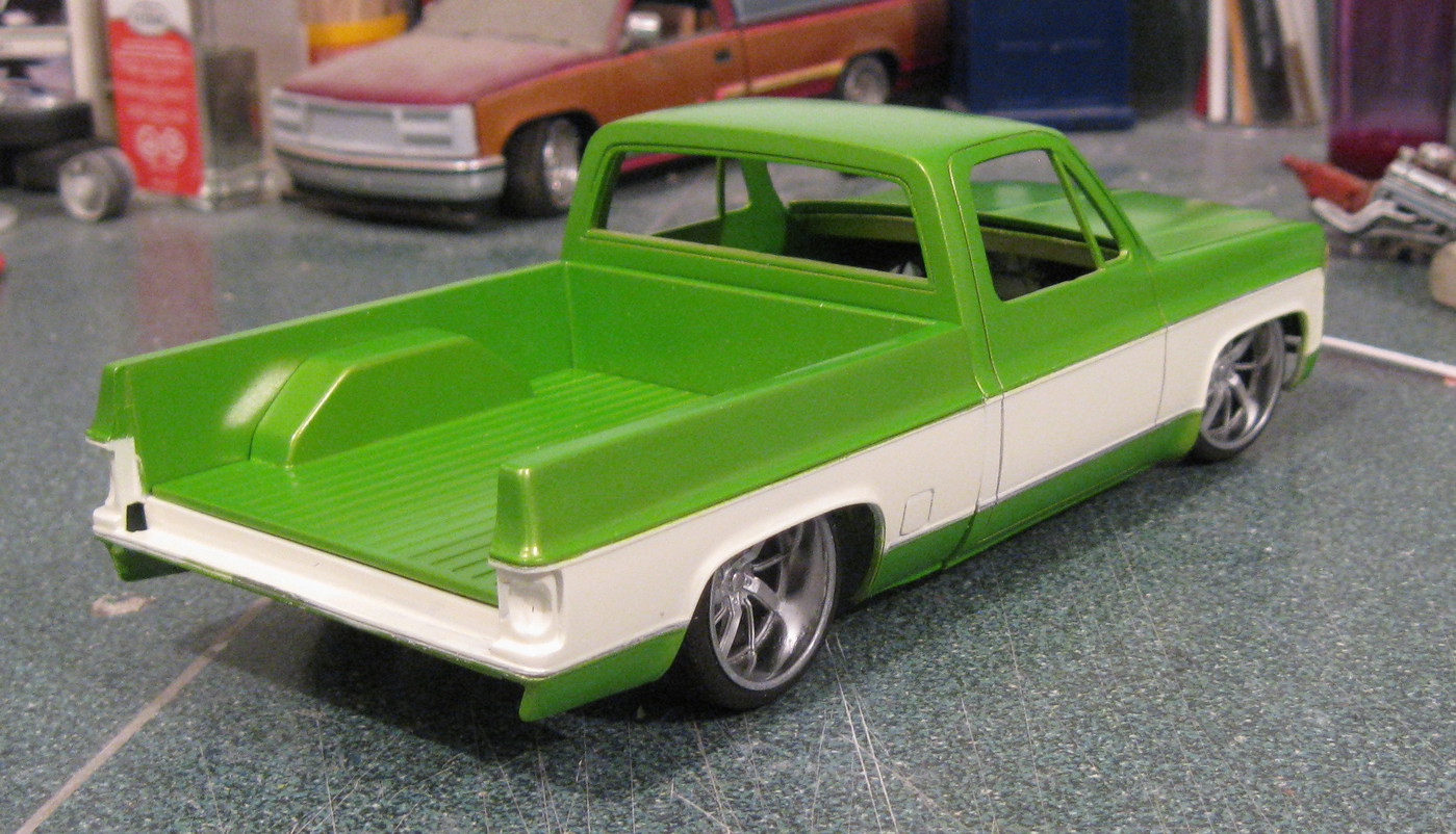

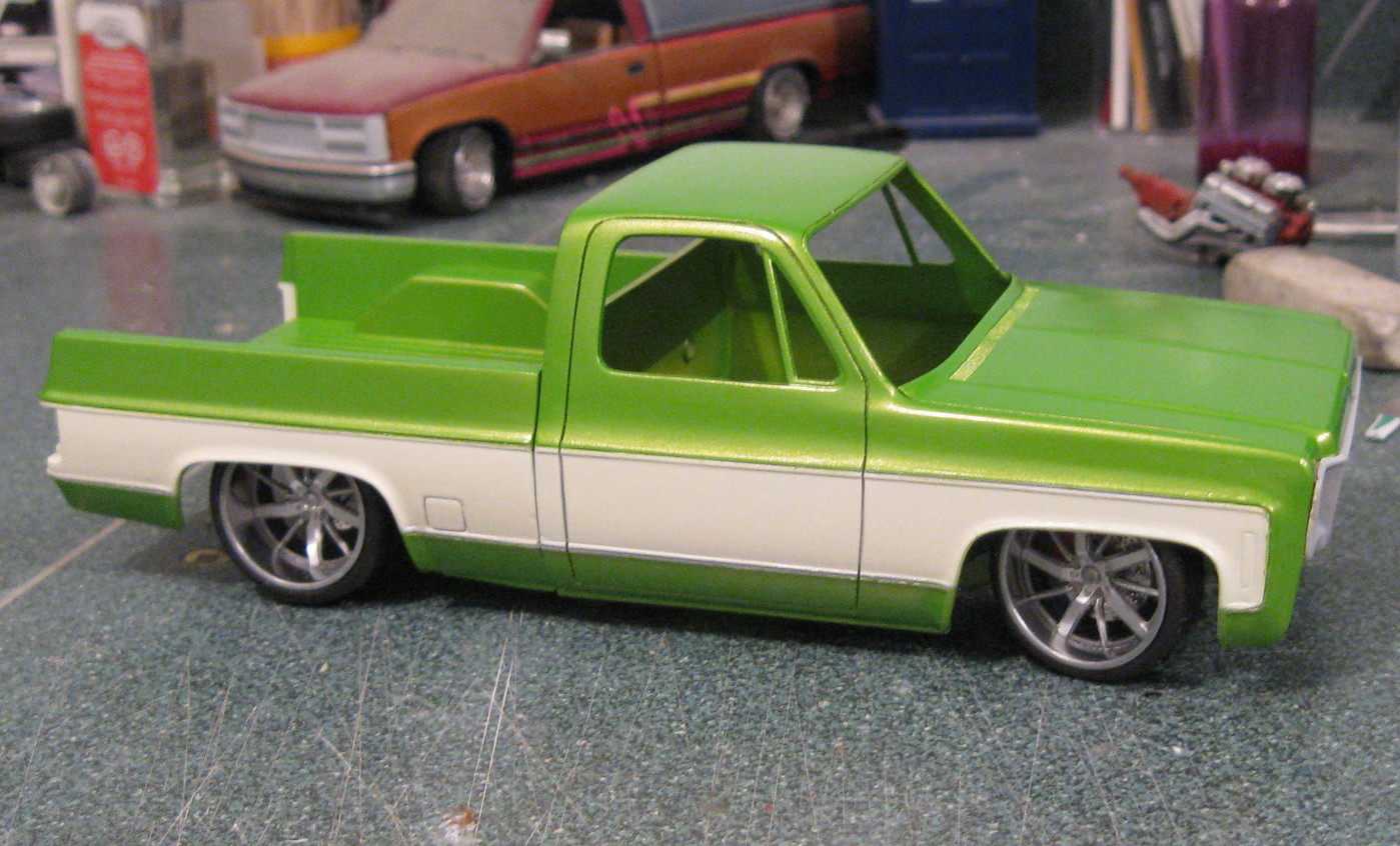

Can-Con Posted April 19 Author Posted April 19 Put some Tamiya "racing white" in the side coves and sprayed the underhood bits, inside of the fenders and bed floor on the custom mixed apple green pearl. I plan to wait a couple days and spray the green on the rest of the bodywork. 7

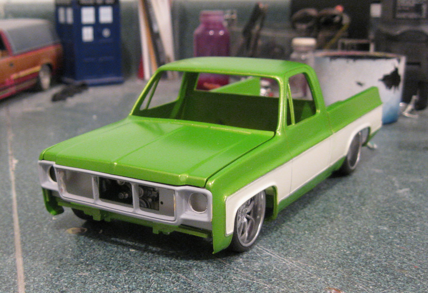

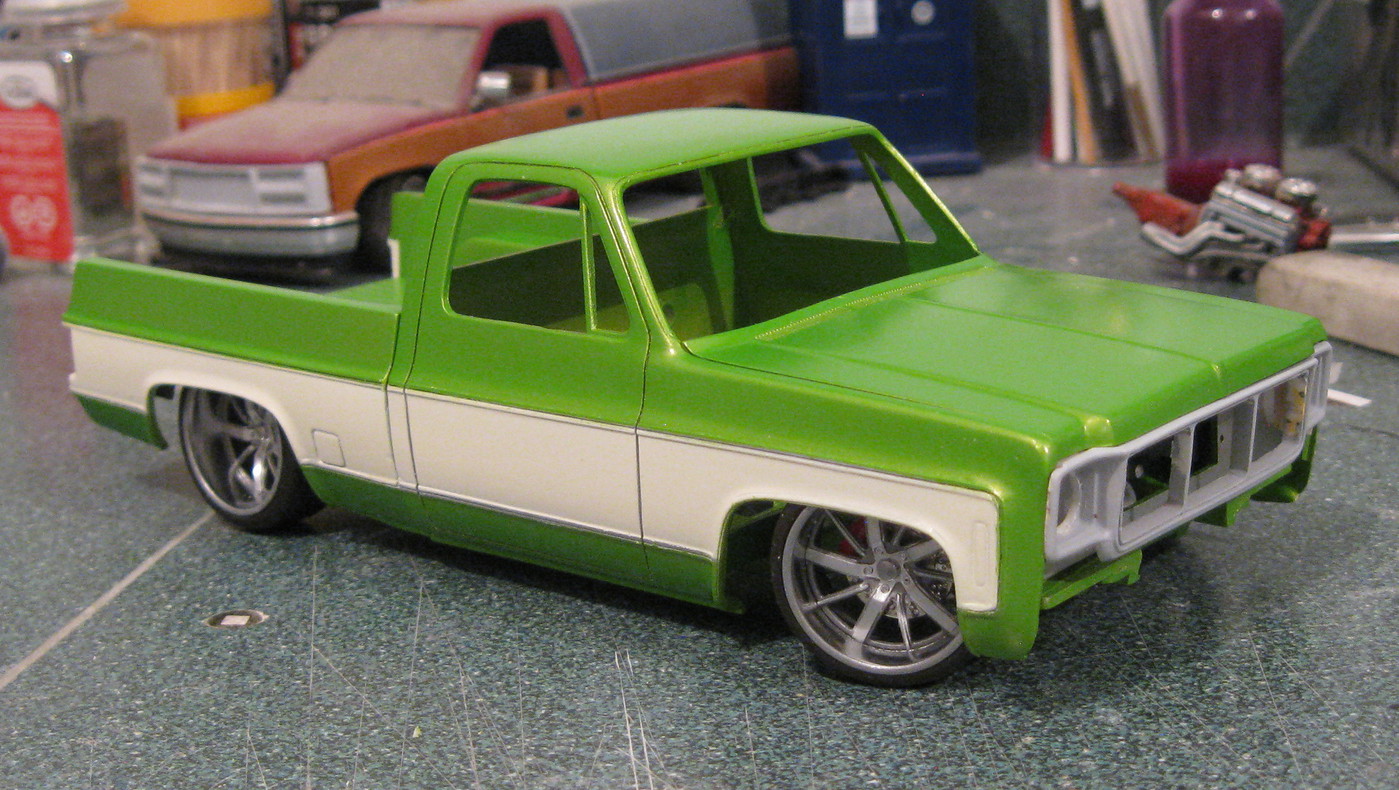

Can-Con Posted April 21 Author Posted April 21 OK, a few pics with the final color. I'll clear it tomorrow. , , and, as you can see, I'm going with a '73/'74 GMC grille. 10
catpack68 Posted April 21 Posted April 21 (edited) Looking good Steve! Love the colors and the GMC grille. Edited April 21 by catpack68 1
Steve H Posted April 22 Posted April 22 Looks fantastic Steve, beautiful paint. I can say with confidence that I would completely lose my mind trying to do that side trim. Very nicely done, I like everything about this build.
Can-Con Posted April 22 Author Posted April 22 15 hours ago, Steve H said: Looks fantastic Steve, beautiful paint. I can say with confidence that I would completely lose my mind trying to do that side trim. Very nicely done, I like everything about this build. Thanks Steve, I'm sure you wouldn't have any trouble doing that trim, I've seen your work.

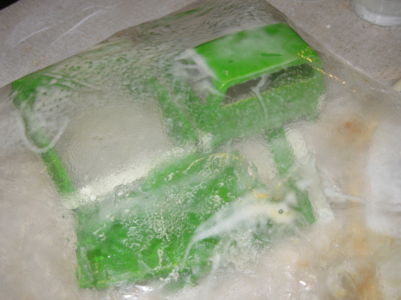

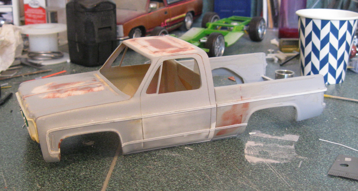

Can-Con Posted April 27 Author Posted April 27 Yes, this is a zip-loc bag with the truck covered in Easy-Off. 1 3

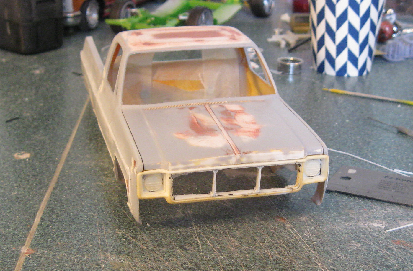

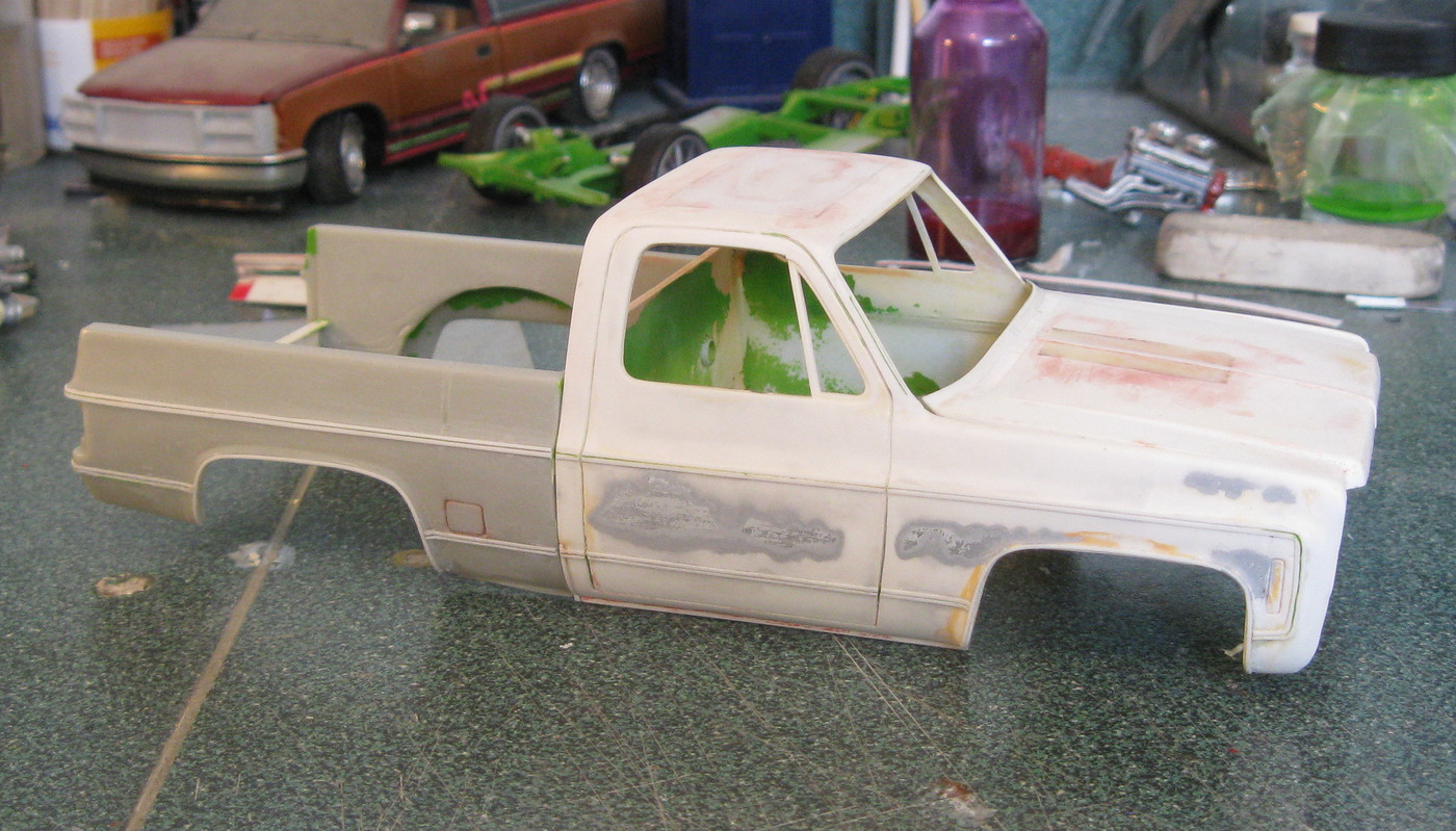

Can-Con Posted April 30 Author Posted April 30 On 4/29/2025 at 8:25 AM, TopherMcGinnis said: What happened? I wet sanded the clear getting ready for a second coat. Was making a mold of the bumpers earlier so I could cast a few sets for myself and I must have contaminated my hands with mold release and didn't get it all of and transferred it to the sand paper. That's my best guess anyway, that's what it looked like when I sprayed the second coat of clear. 1

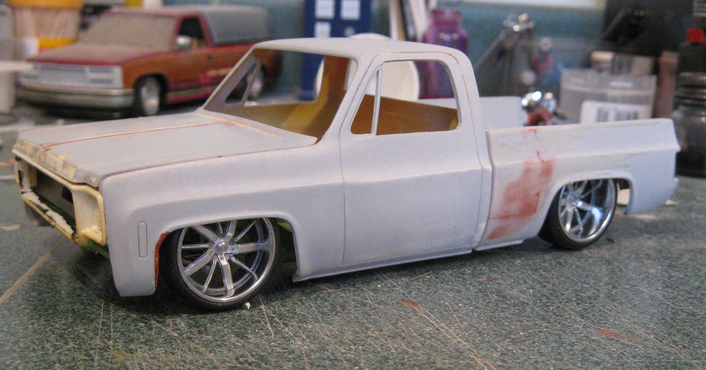

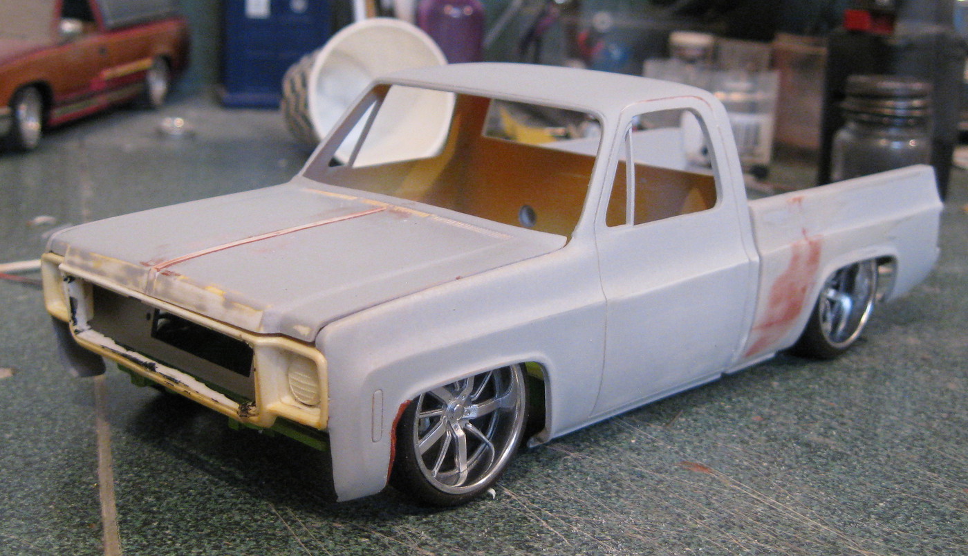

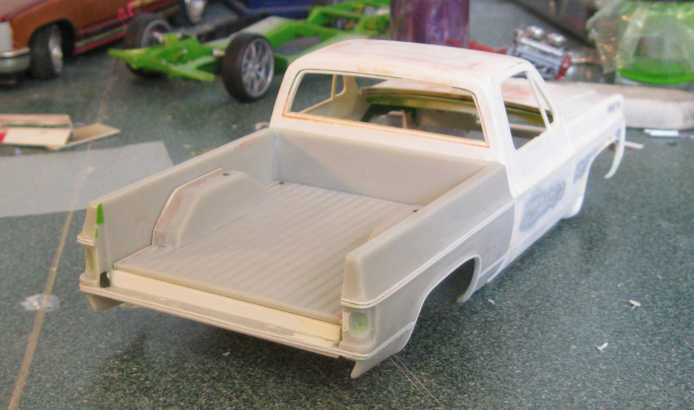

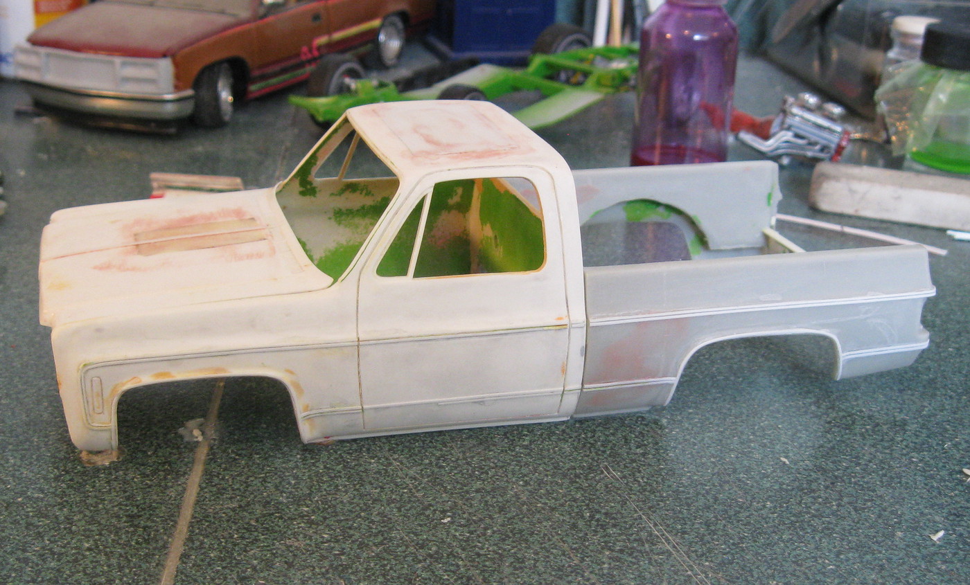

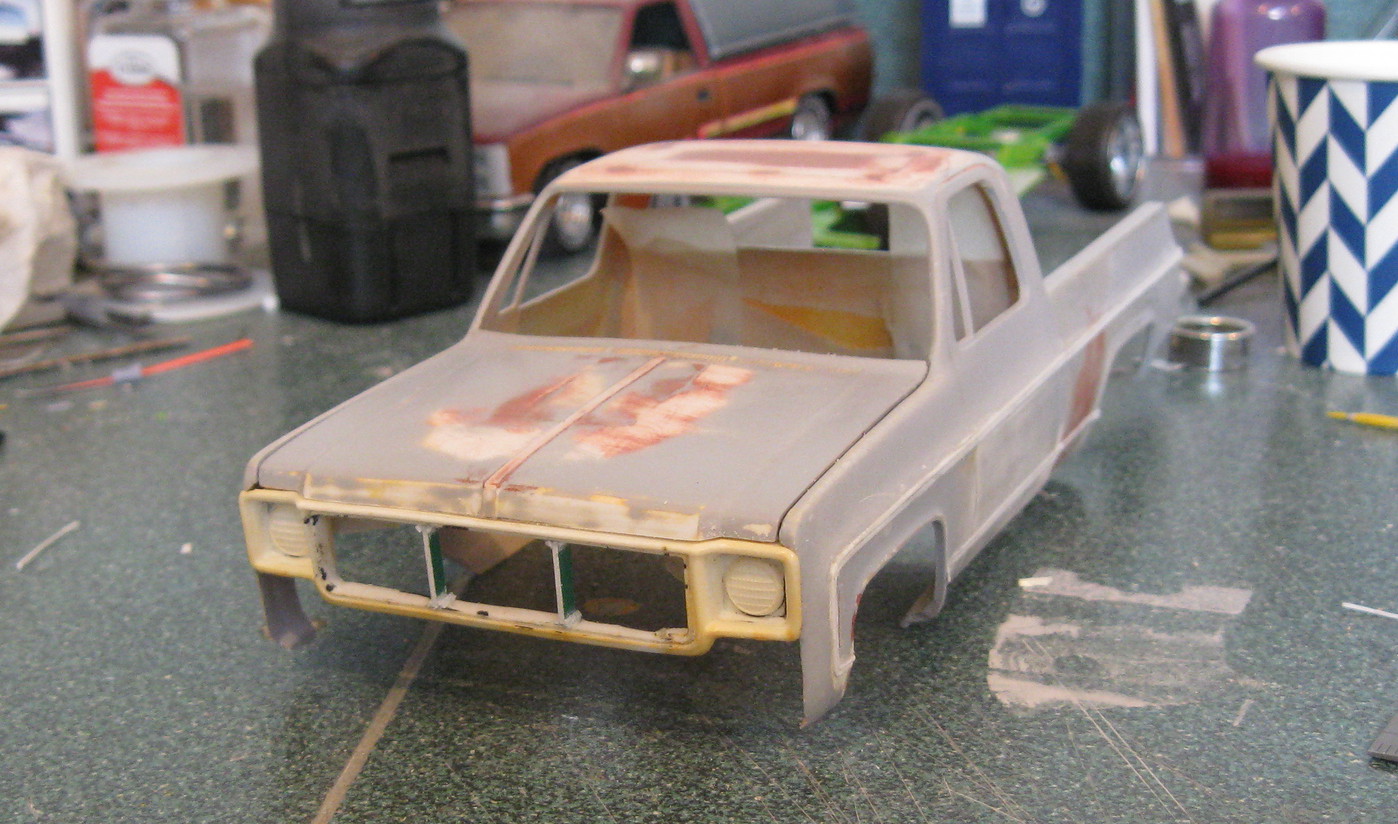

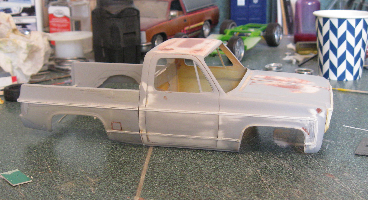

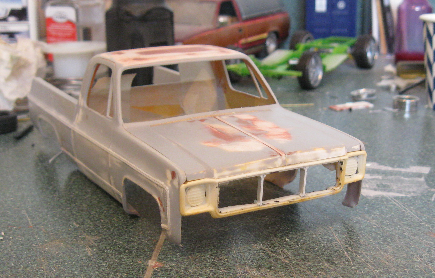

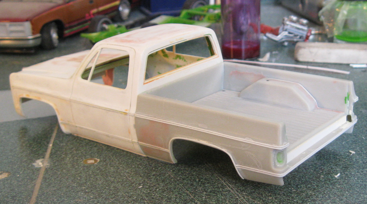

Can-Con Posted May 5 Author Posted May 5 There were a few "issues" I noticed after I started painting but just ignored as I was done the bodywork and really wanted to see it in paint. BUT, since I'm now repainting I'll be making some adjustments and additions before repainting. It will be better when I'm done then it was the first time around. I got pretty lucky as most of the trim I added stayed put. I'll easily fix that and replace a couple sections that didn't come off but didn't turn out as well as the rest. More on those later but for now here's a couple pics "in the nude", as it were. 😉 3

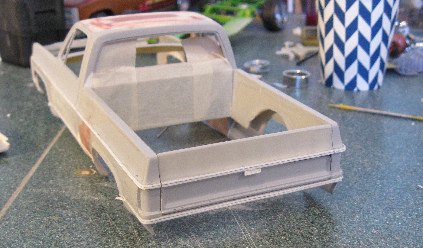

Can-Con Posted May 9 Author Posted May 9 There's a couple things I want to improve on before I repaint the truck. First is the box. The back wall wasn't exactly flat where it meets the bed. Note the "step" on the right and how it thickens out on the left. So I filed it flat. This box is from another kit but it's identical to the first one. The other issue is while this box, from one of the '84 GMCs mates up well to the newer cabs, it's a touch wide at the top and narrow at the bottom when up against the older '78 cab. While I did file it a bit at the top edges before I painted it the first time, it's still off a bit. So a quick cut down the inside corner on both sides will remedy that. I cut down about 1/2 way with a regular X-acto saw blade, pulled the top so the cuts closed and glued them with lacquer thinner. This way it not only brought the top of the box in flush with cab but also spread the bottom slightly so it now also matches. That was the first mod I wanted to make before the re-paint. There's another mod and a couple additions I want to do so me screwing up the first paintjob will have a silver lining. 3
