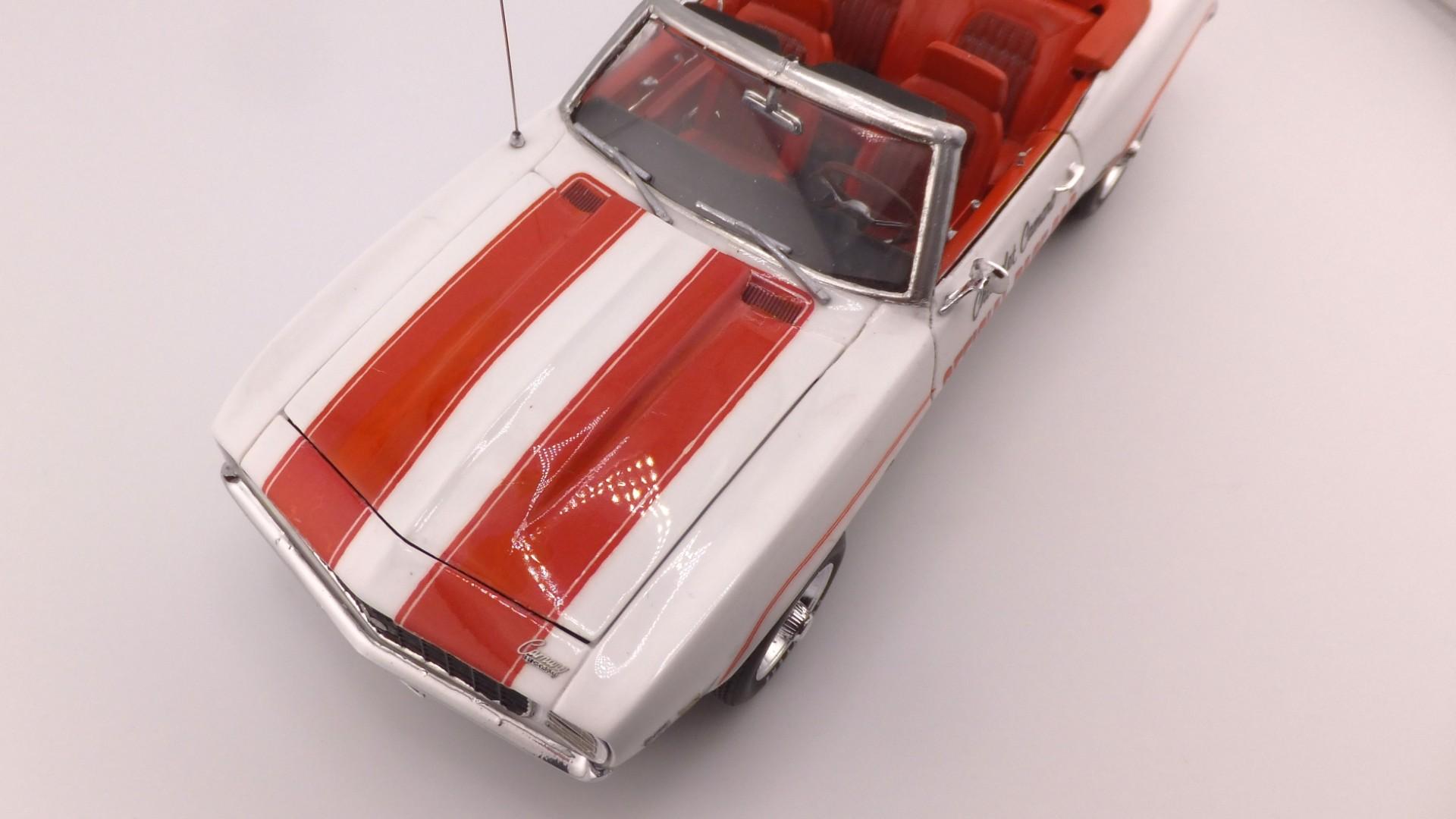

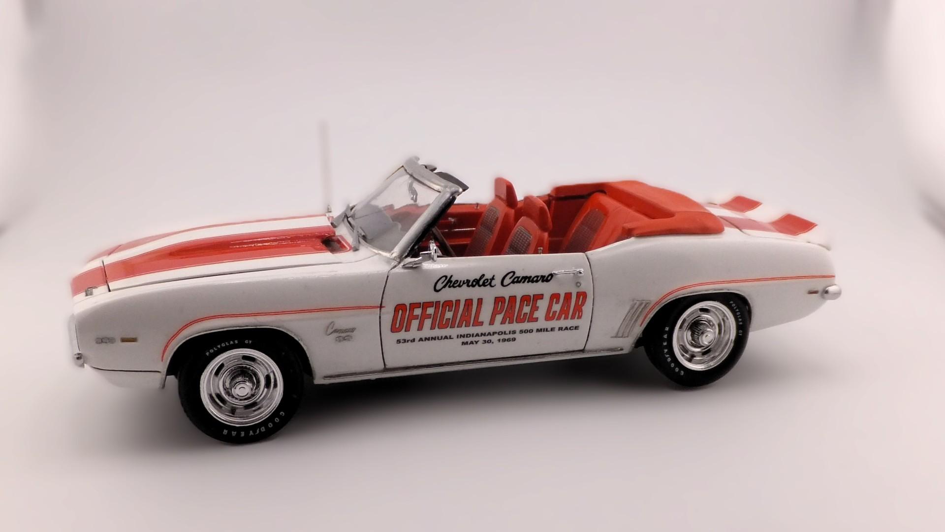

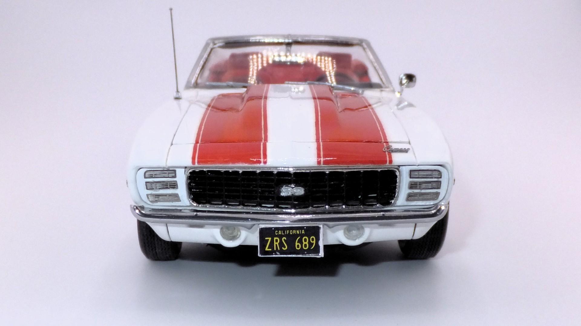

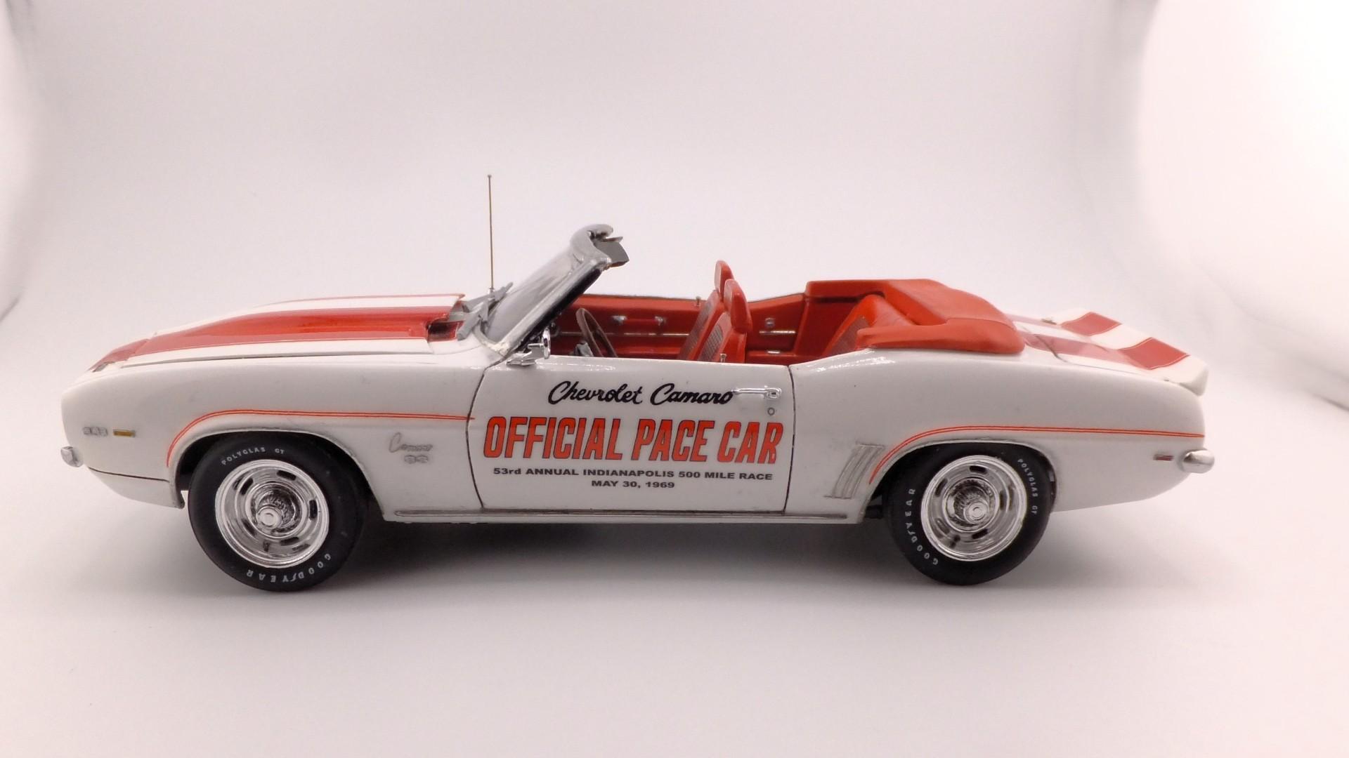

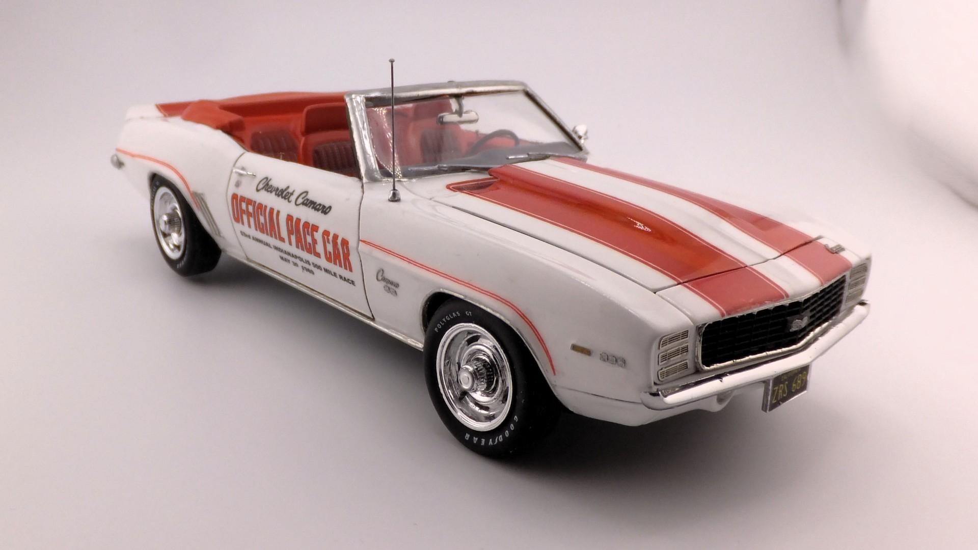

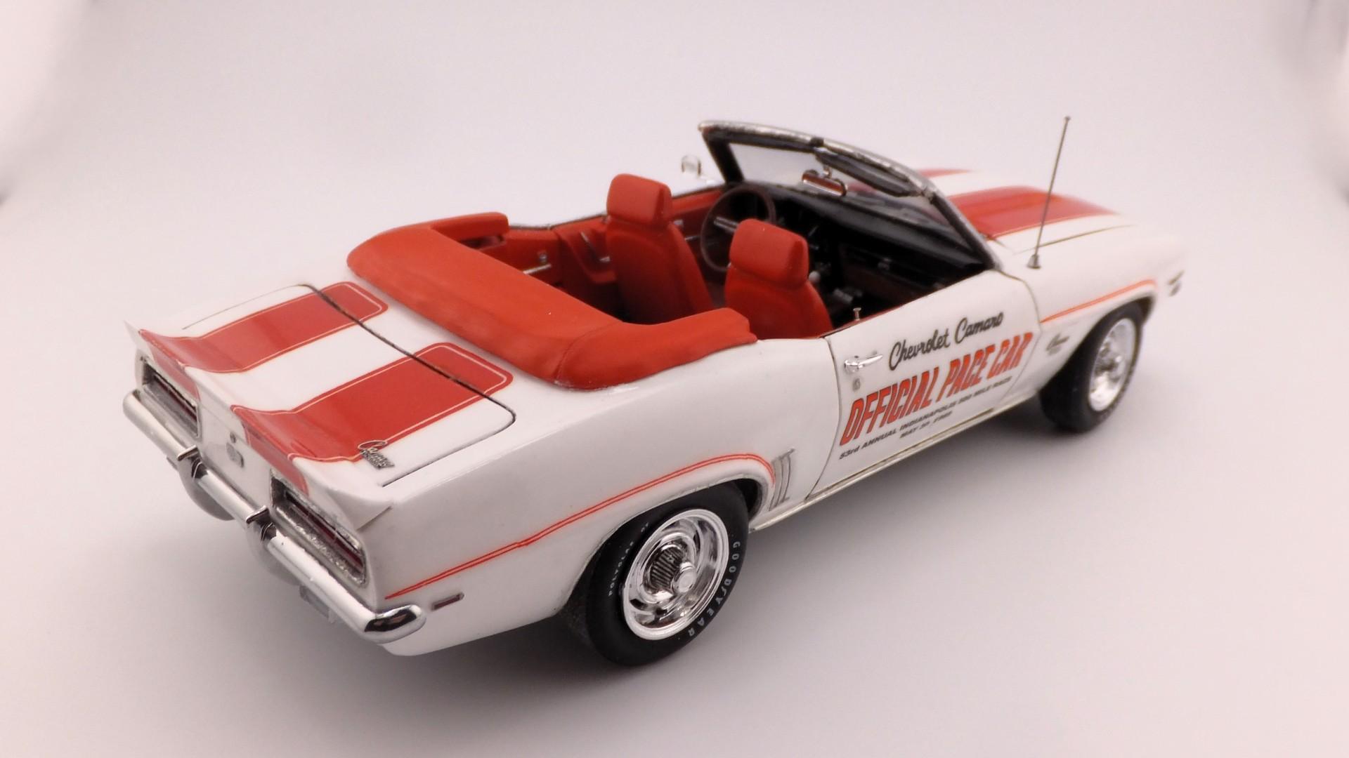

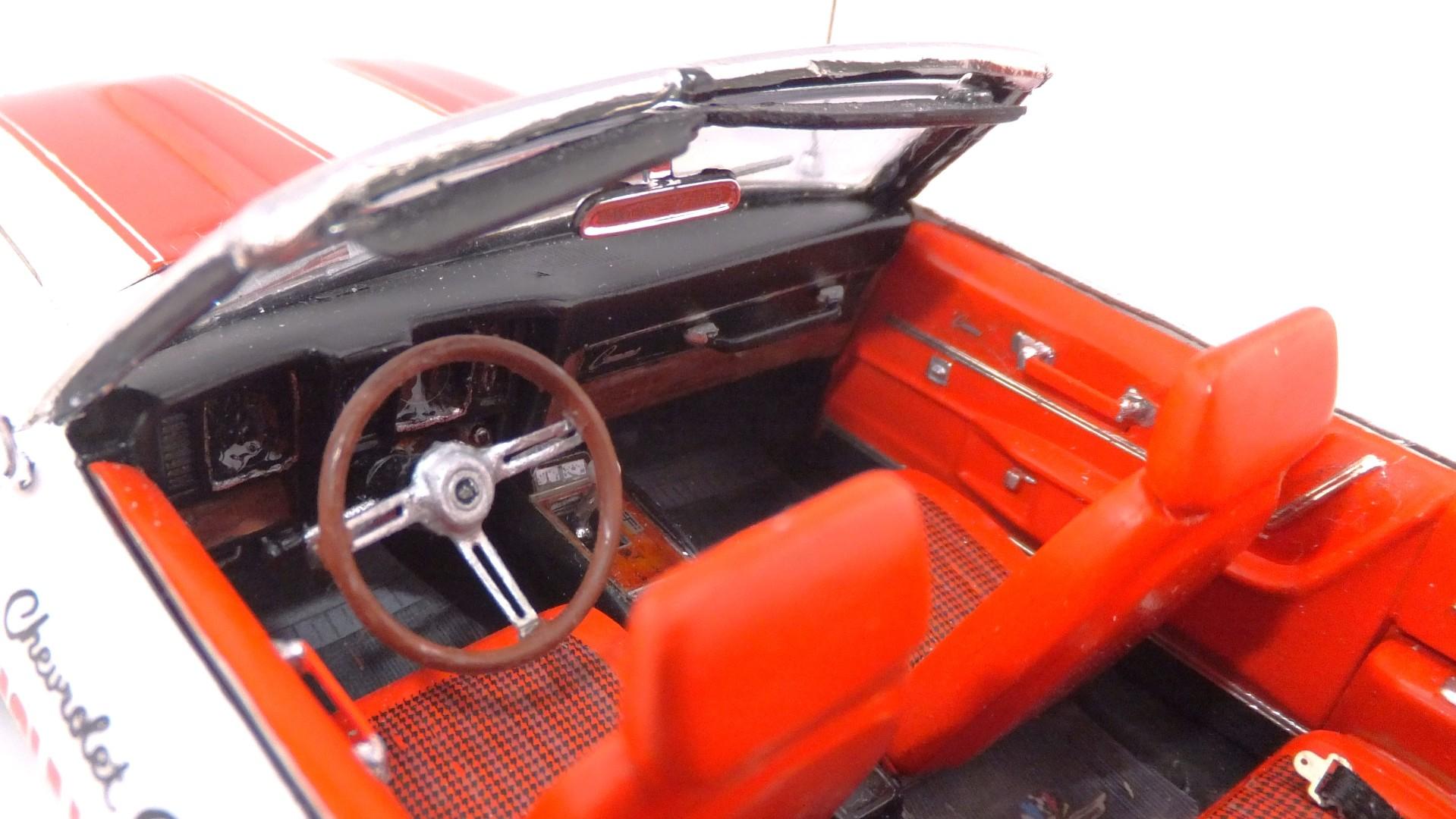

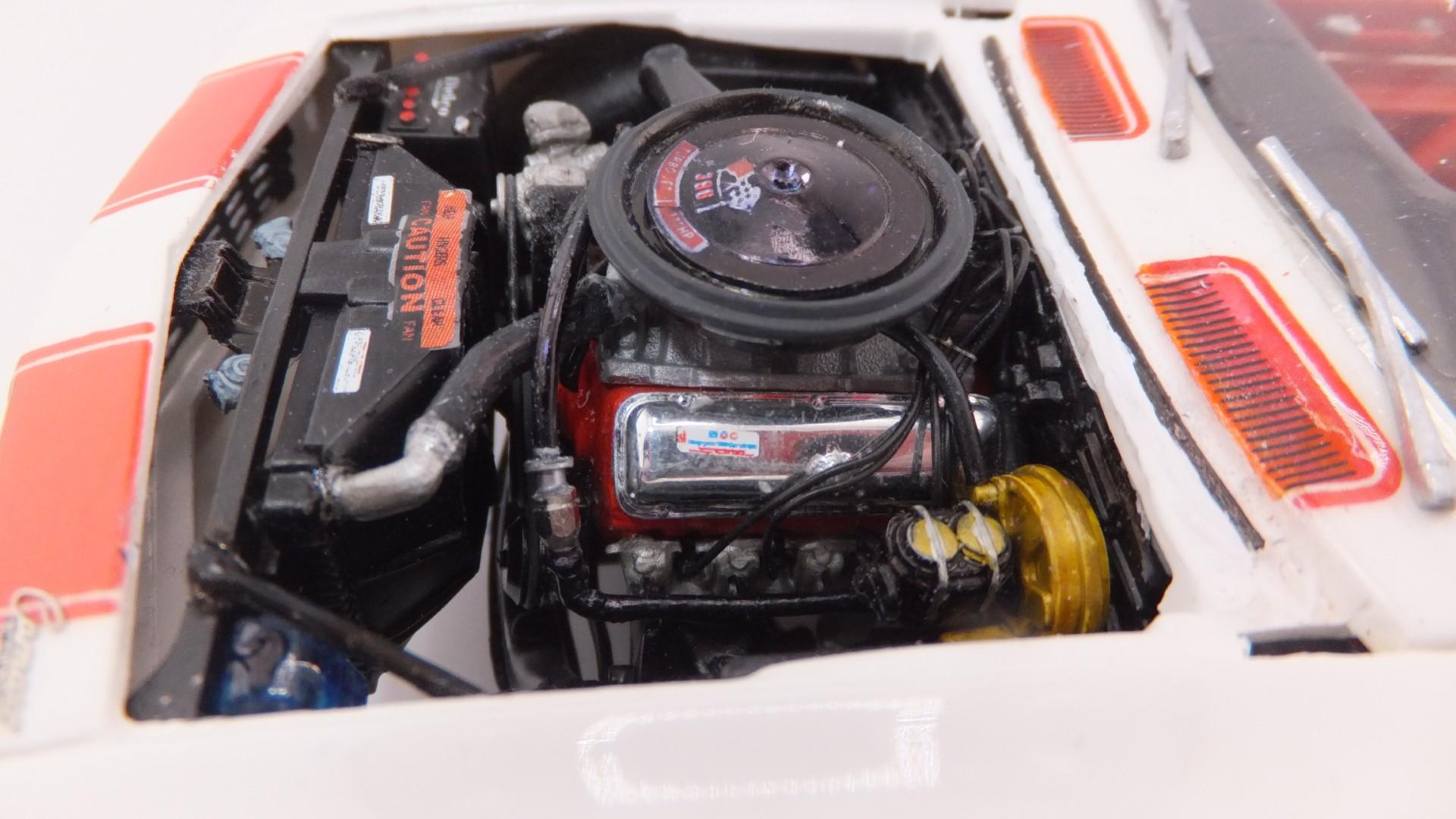

Well, I am calling it done.  But as I was posting this, I discovered I forget to add the front chin spoiler.  So, a little added step besides more dusting of the model.  Even though the humidity is fine in the house, and I run a HEPA filter in the hobby room, this model seems to attract dust like a magnet.  Anyway, a quick recap of work:
Chassis:
  • Corrected to convertible style with center ribbing and chassis plate.
  • Fit a Revell 68 Firebird exhaust to fit chassis changes.
  • Detailed it out.

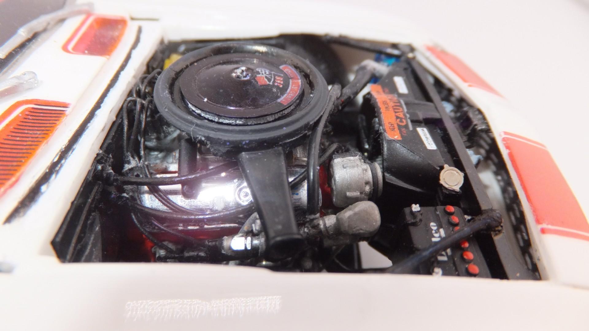

Engine:
  • Detailed out with wiring and plumbing.
  • Revised accessories to add smog and power steering pump in correct placement
  • Added smog pump lines to exhaust manifolds.
  • Added non-working dipstick in correct location.

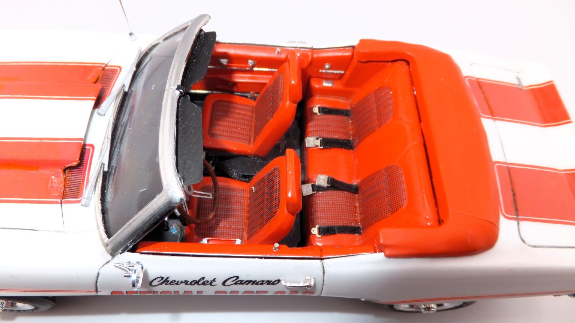

Interior:

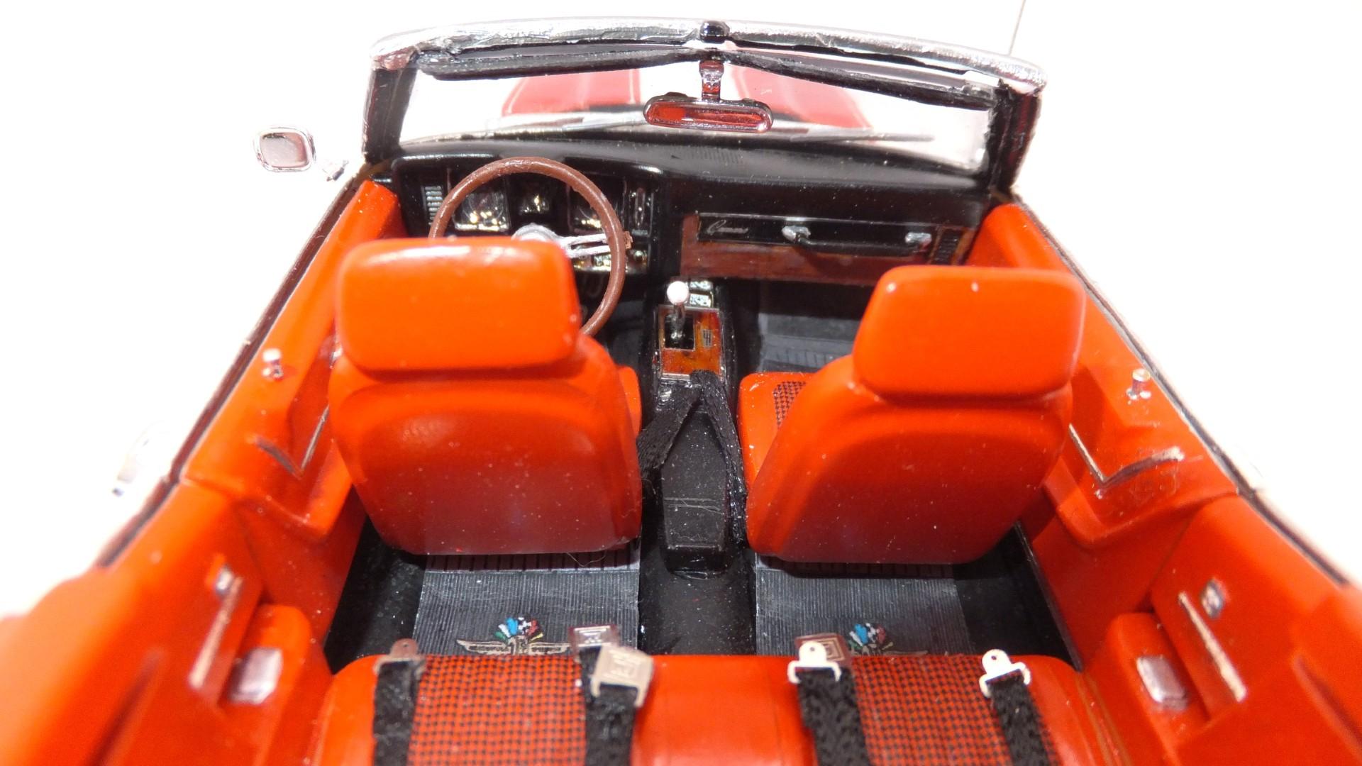

  • Detailed out the interior.
  • Added front vents and radio grill on dashboard top (used parts from MCG C1 Corvette PE set)
  • Painted Hugger Orange as real car.
  • Added seat belt hardware as in the real car.
  • Added "wood" trim decals to reflect real car.
  • Revised grab handles for realism.
  • Crafted front and rear floor mats.
Engine Bay:
  • Detailed out.
  • Added missing radiator cap (not in kit).
  • Added warning stickers on radiator shroud top.

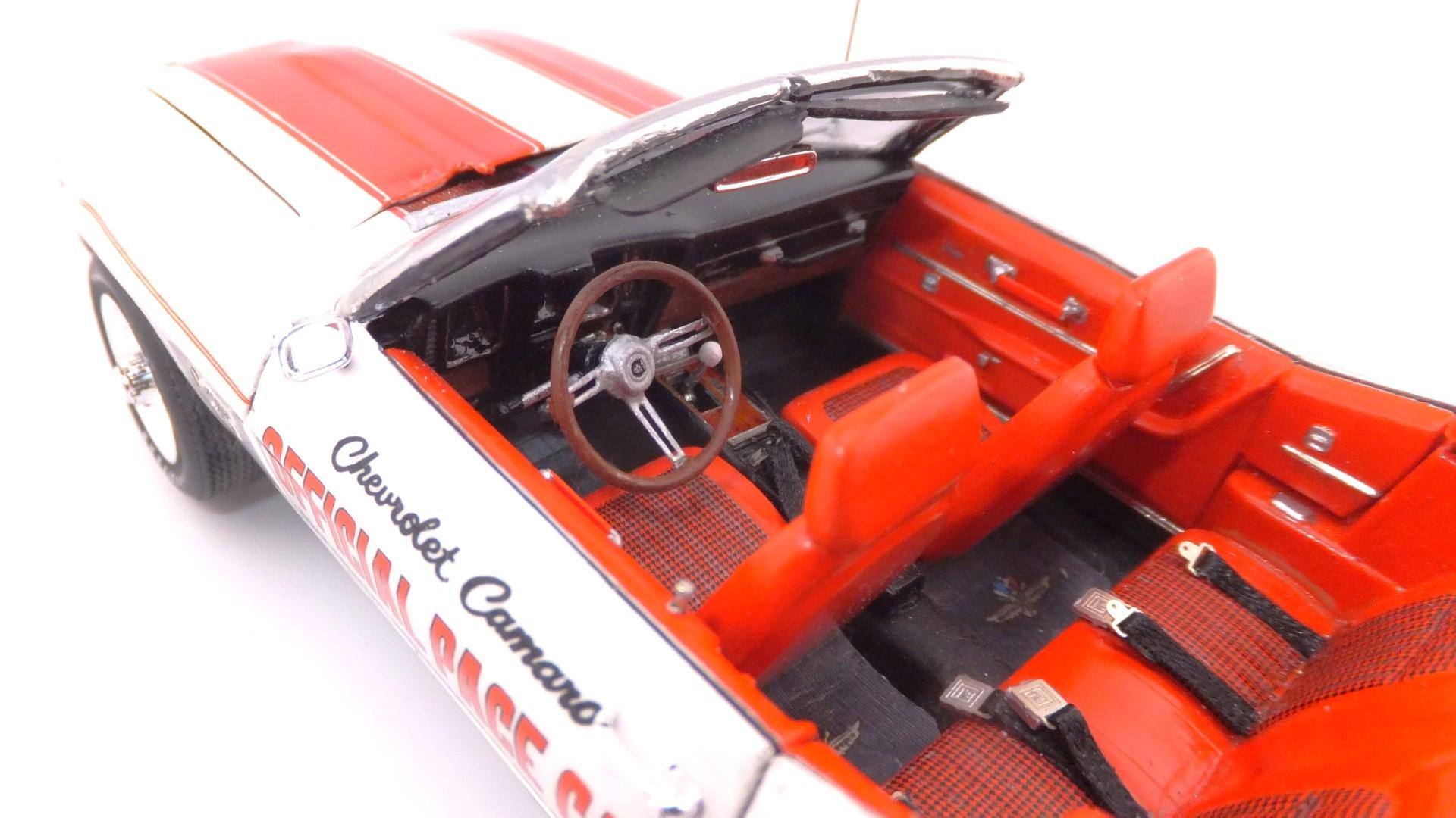

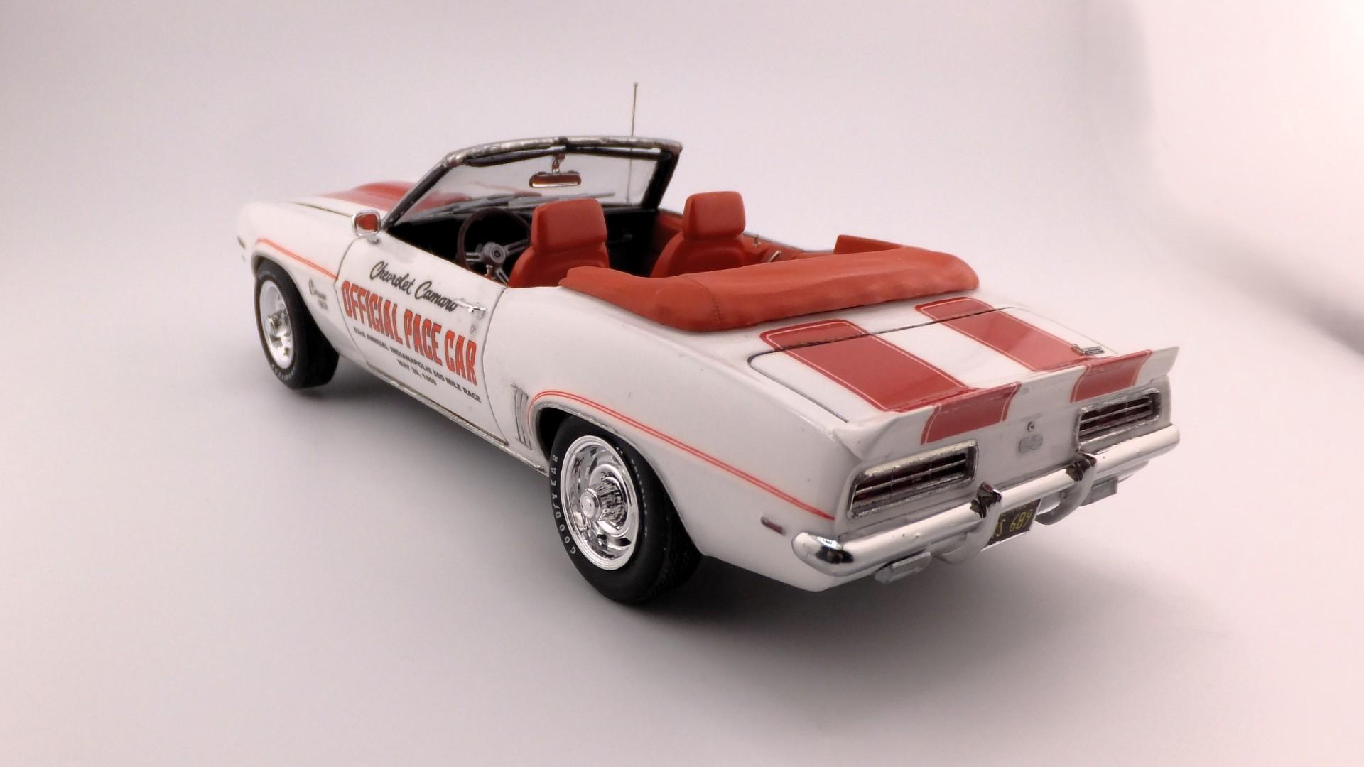

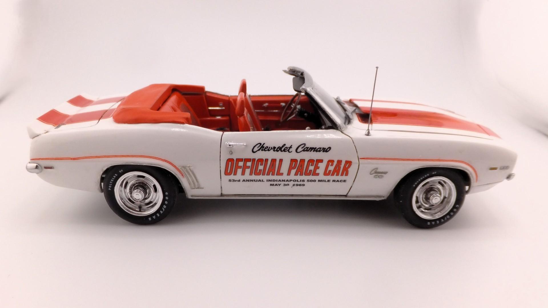

Body:
  • Cleaned up and detailed with Model Car Garage PE Set.
  • Added fixed radio antenna using carved base and insect mounting pin.
  • Adjusted setting of front RS grille to reflect real car.
  • Opened the grille.
  • Using kit decals as templates, created new decals in proper Hugger Orange color.
Wheels and Tires:
  • Used AMT Parts Pack Goodyear Polyglas GT White Lettered tires.
  • Opened the wheel slots.
  • Added valve stems.
  • detailed out the wheels.
Here are some photos of the (I thought) finished model (I'll add the spoiler this weekend).

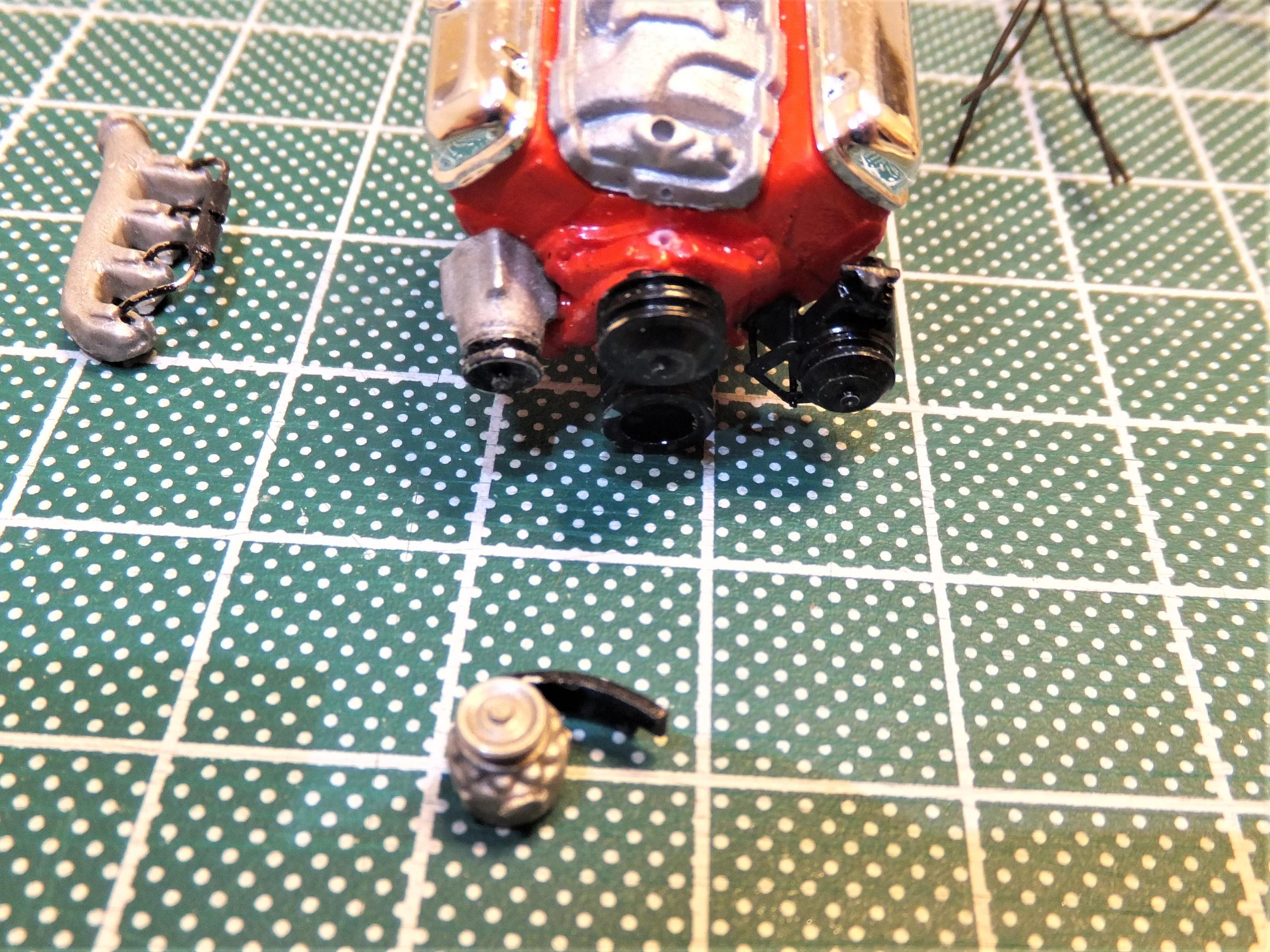

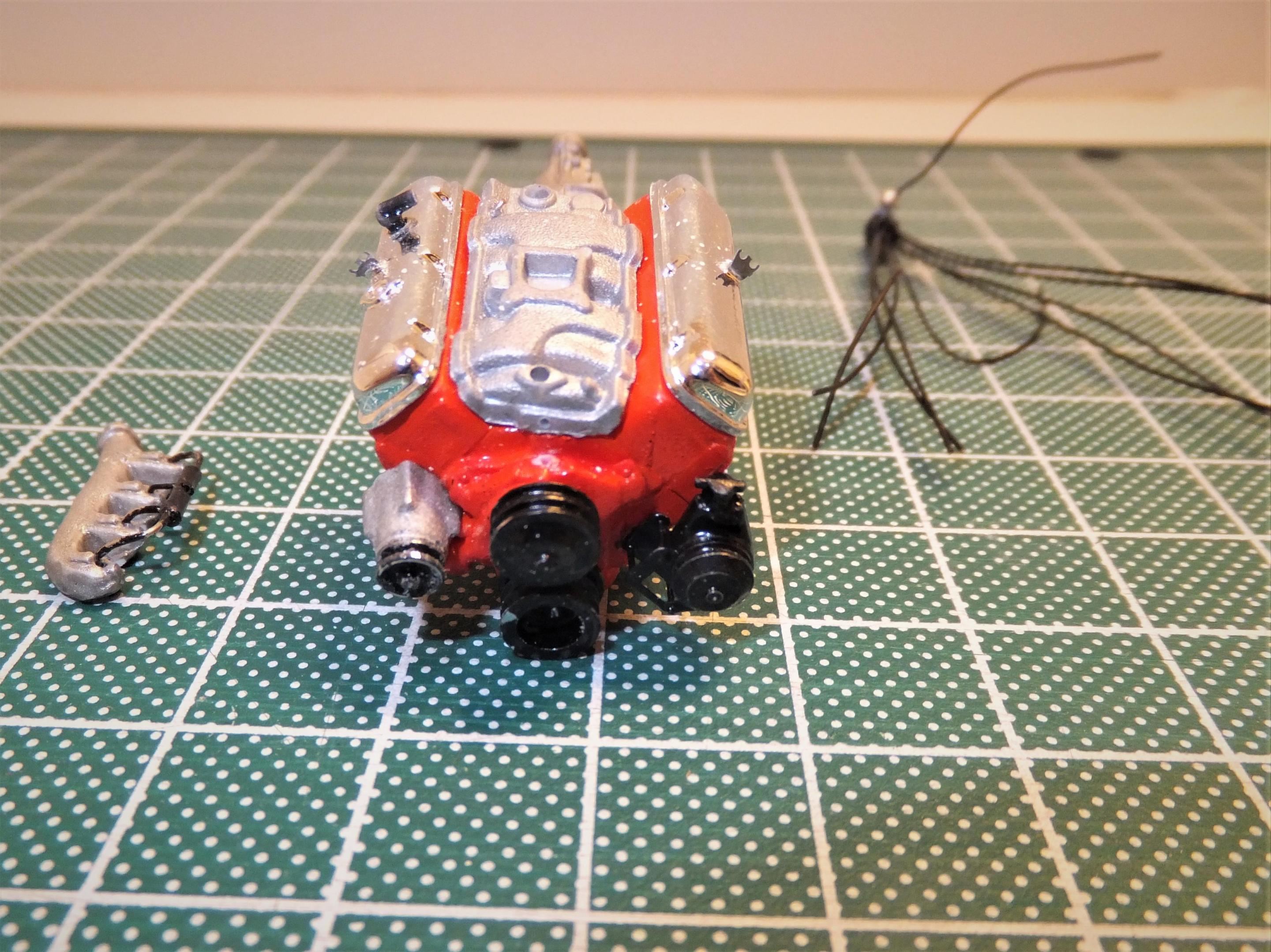

A most impressive build of a sharp looking version of the Camaro. Don't ever recall seeing any A.I.R. systems installed on a scale model accurate right down to the check valve like yours.
Edited by AMT68
  • Thanks 1
Took a little research to scratch build

looks great , how did you do the stripe decals
I scanned the kit decals at max res on my scanner.  I then used a CorelDraw trace function to convert to vector.  I found the RGB codes for Hugger Orange and applied to the orange color areas of the decal.  Finished it off with printing on my Laser printer with Clear decal paper (going over white so no issue).
