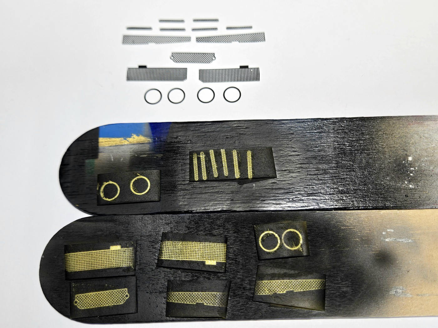

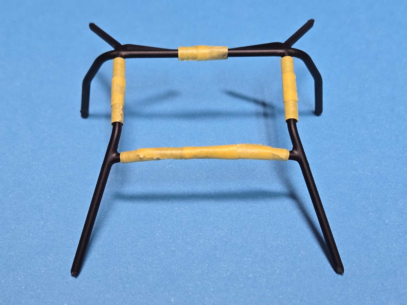

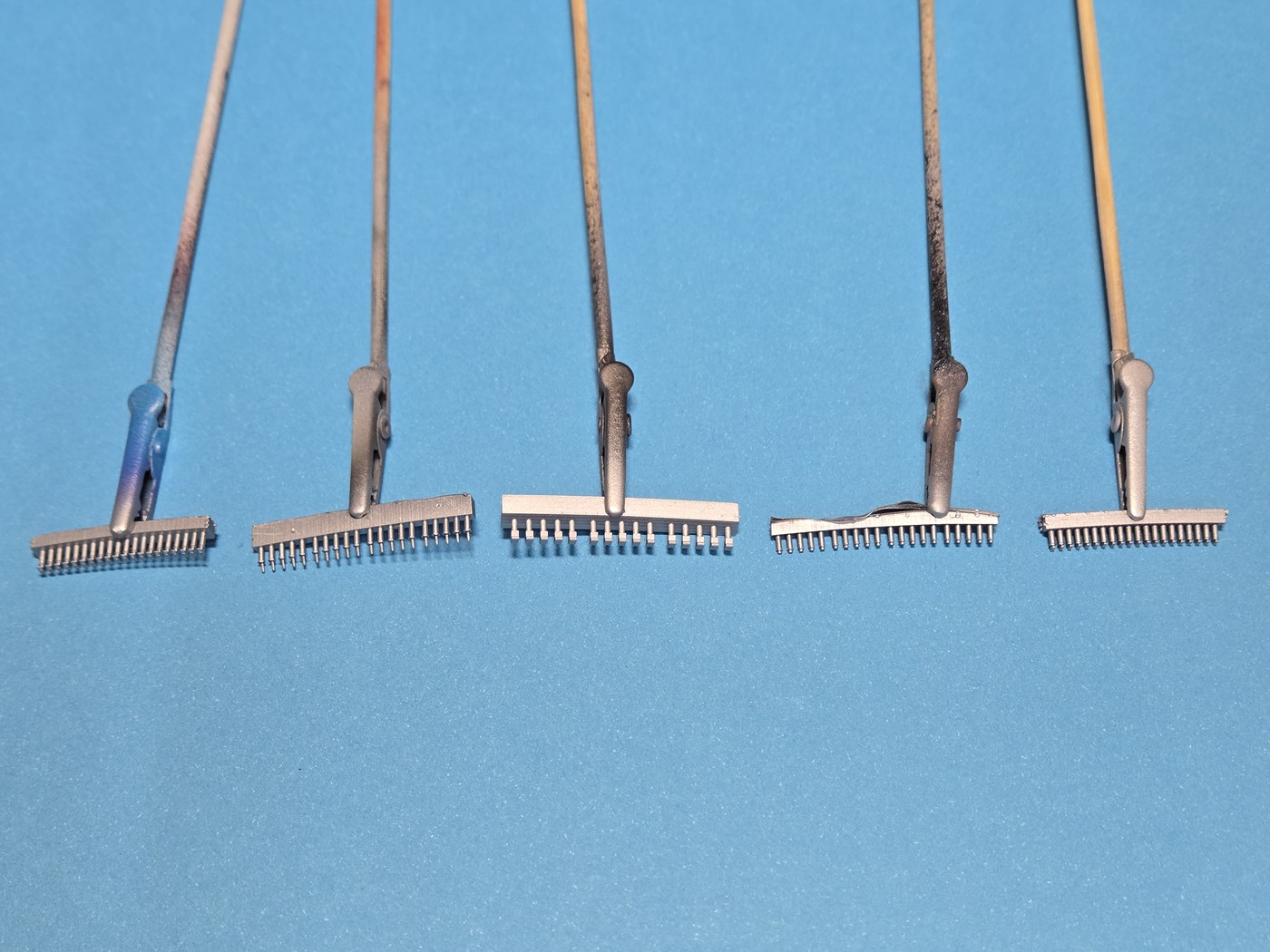

I have all of the external (body) PE grills, etc. prepped and painted.  There are 15 pieces with approximately 40  attachment points that needed to be filed down.
Something that I thought was kind of neat when I saw it.  This is a picture of the leftover Tamiya tape that I used to hold the PE pieces in place while I airbrushed them.

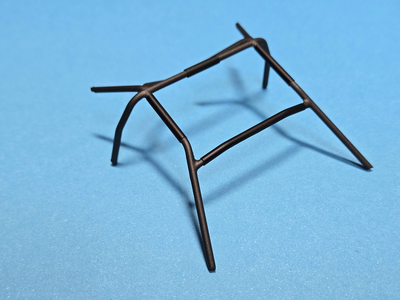

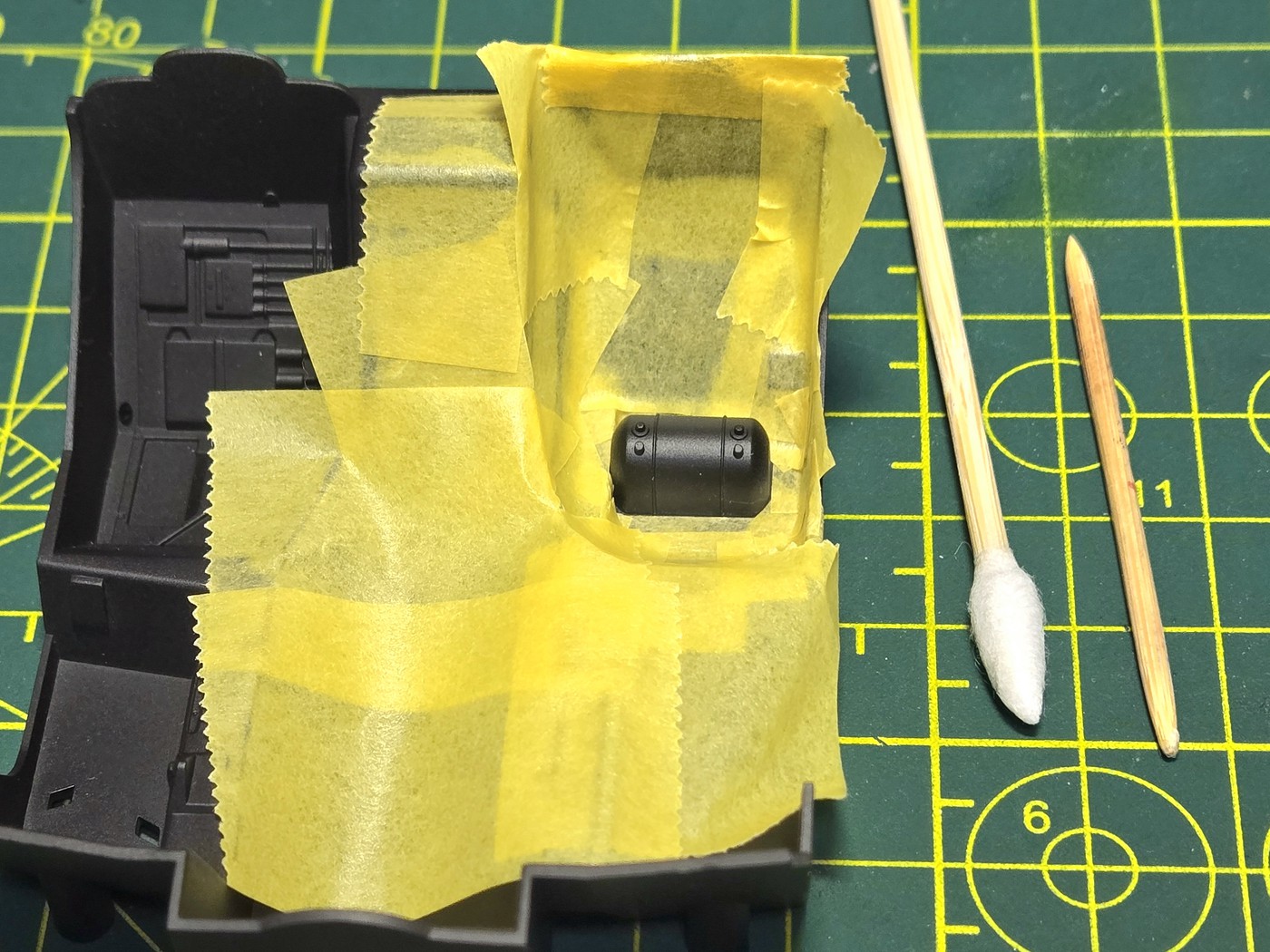

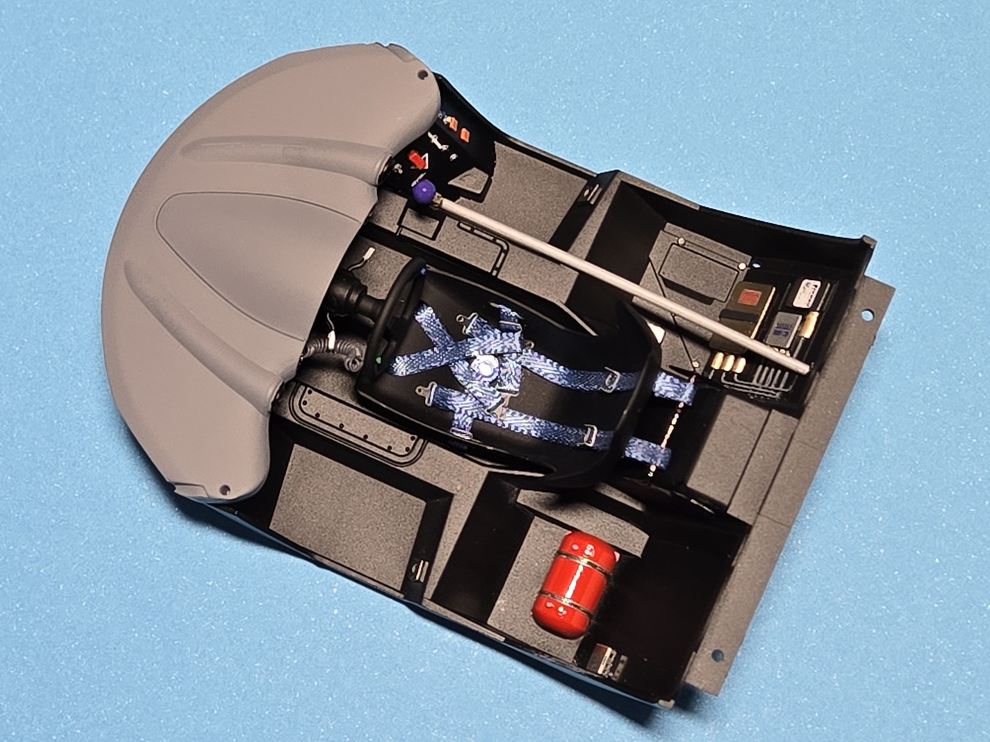

I have also started on some interior details.  I painted the roll cage semi-gloss black, masked off the padding and then shot a metal color.  The effect is subtle, but your eye will catch it.
I will work on the racing harness next.

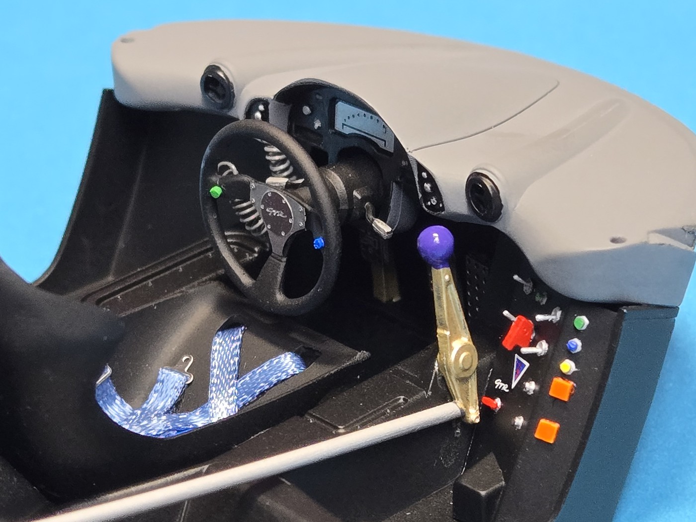

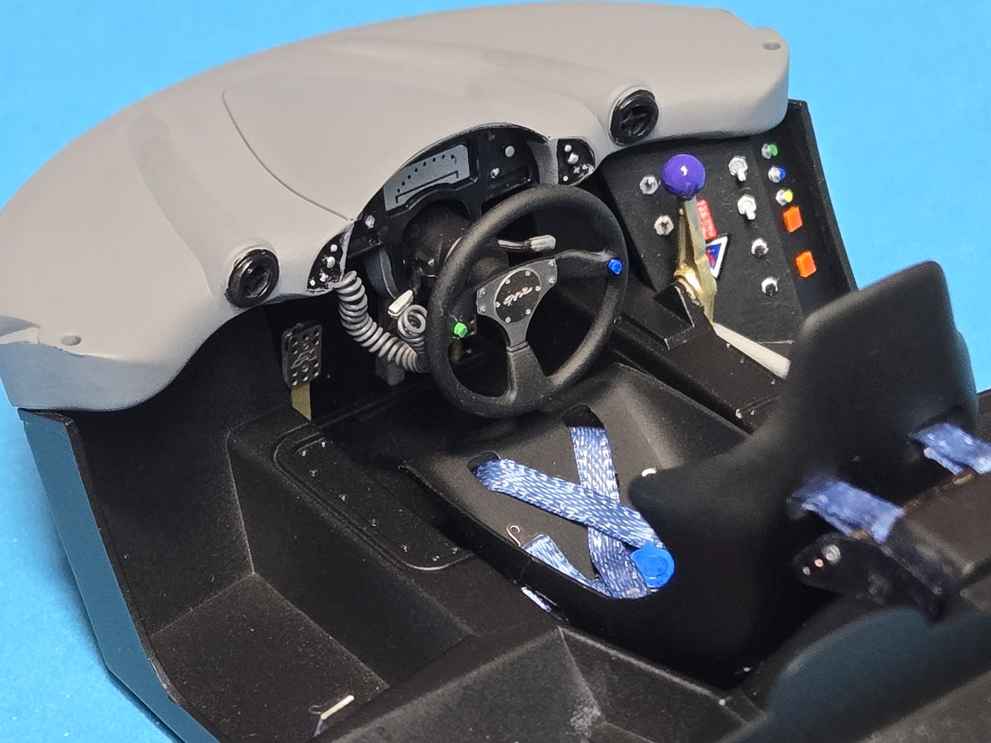

Work is complete on the interior.  I thought I would share some WIP pictures.

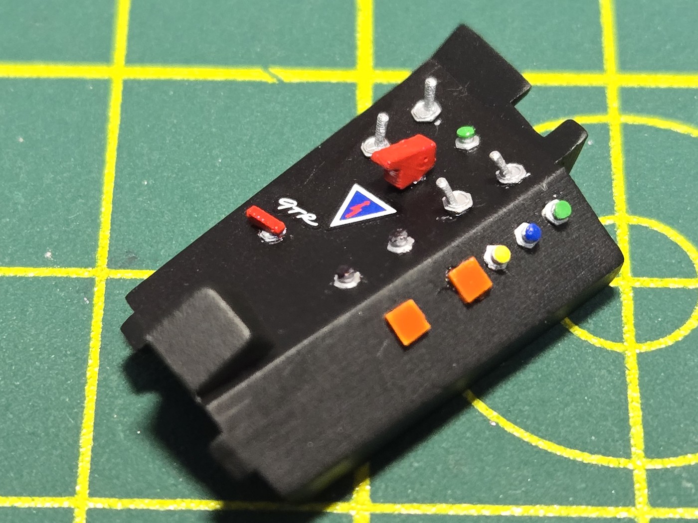

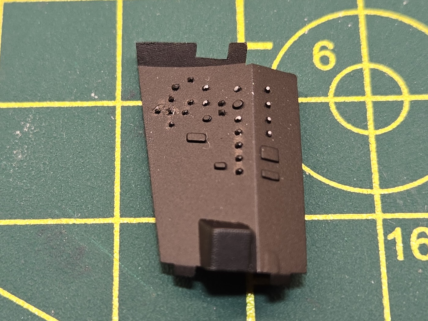

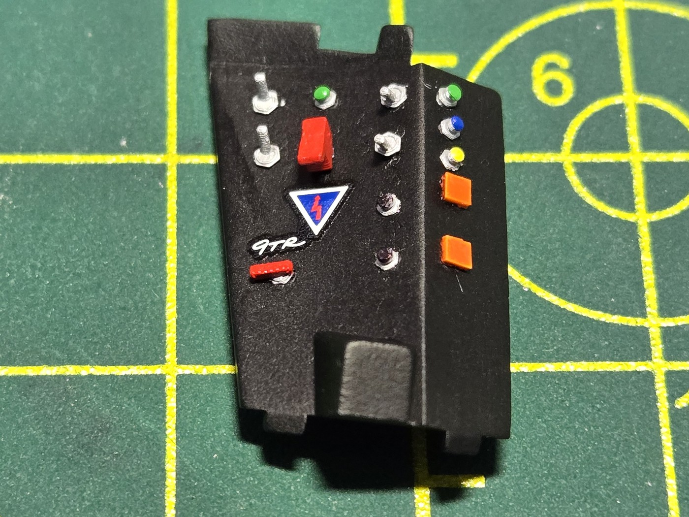

Here is the original kit part, it is a center console.  I tried to do some detail painting, but the results were unacceptable.
I bought a variety of switches from ESS Resinworks.  I primed and painted them.  I removed all of the molded on kit part details and installed the ESS Resinworks items.  I also cut small squares from sheet styrene and painted them clear orange to simulate warning lights.  It is not prototypically correct, but it looks so much better.
I am always disappointed to see molded in items that would be so much better as separate pieces.  I masked the fire extinguisher and shot it red..

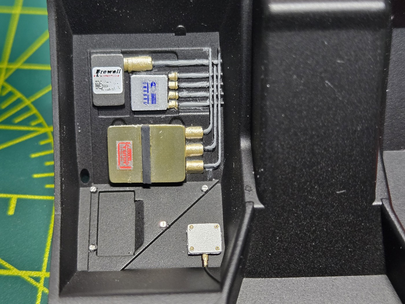

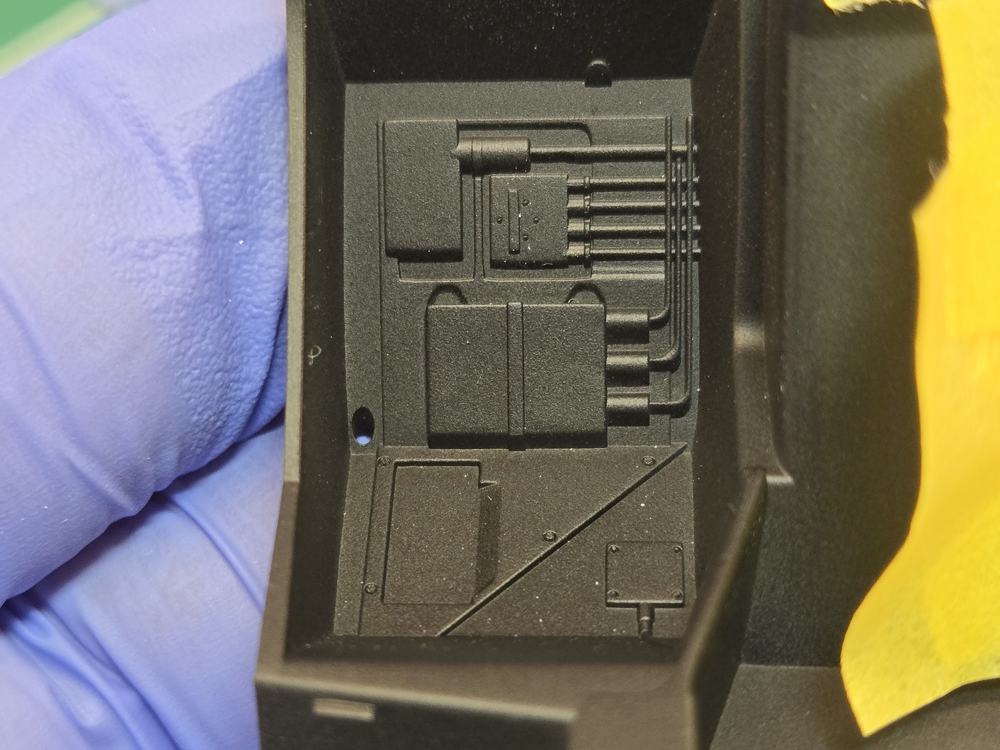

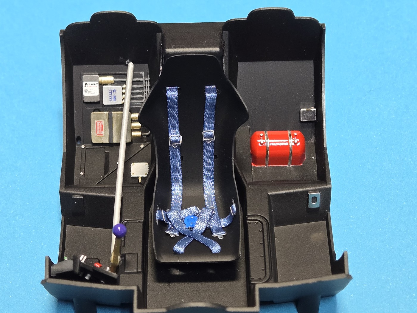

Next were the electronic boxes.  There was no way that I would be able to mask them.  I cut out pieces from .010” sheet styrene and sized them to each electronic box.  I then removed all molded on detail from the kit boxes.  I painted my sheet styrene “covers” in three different colors for visual interest.  I glued them on the appropriate electronic box and added details as needed.  The decals are just random spares that I had.
That is it for now.  I’ll post the 6 point race harness that I made and the completed interior next time.  Thanks for checking in.  Comments, suggestions, and critiques are welcome.

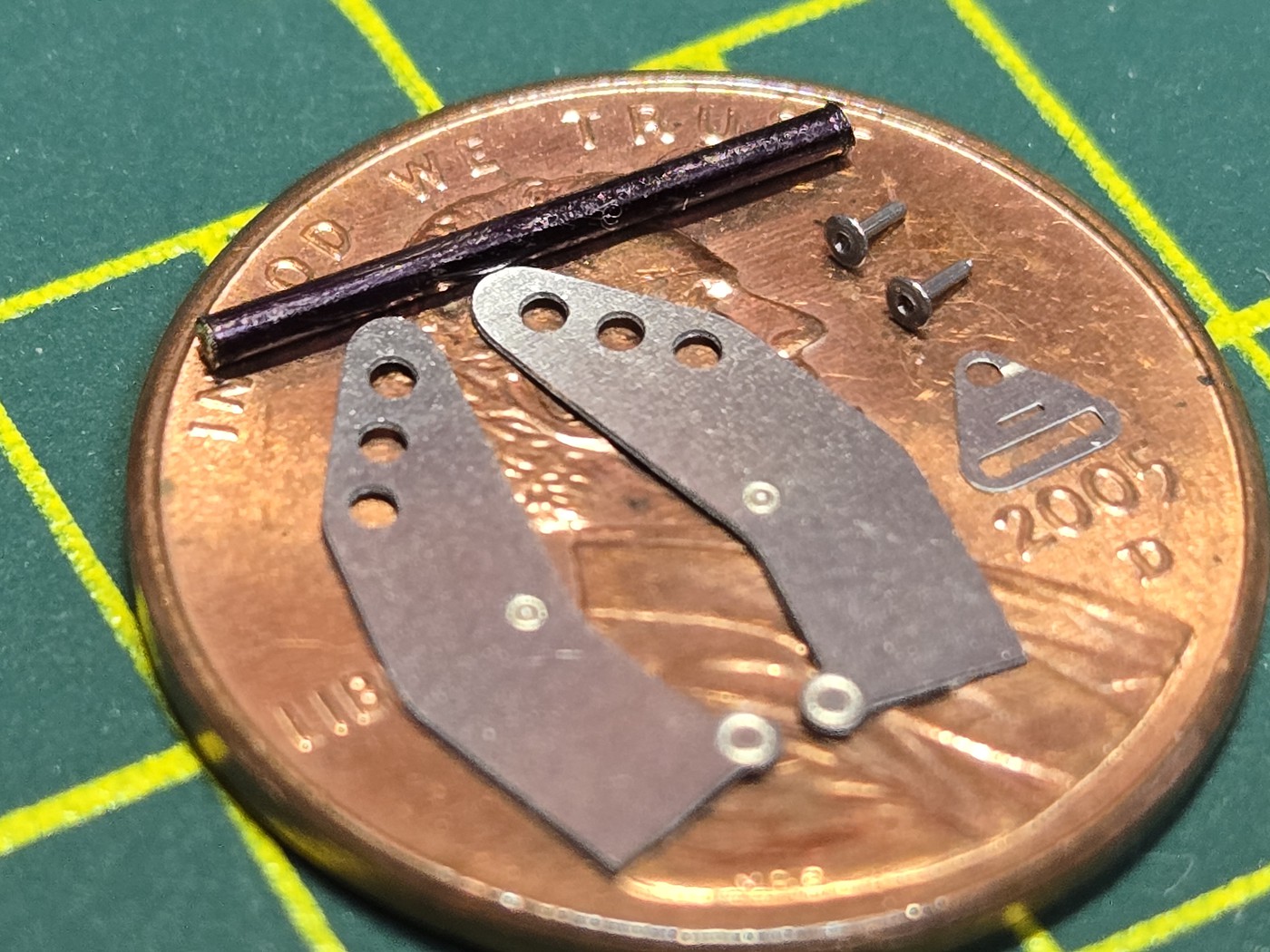

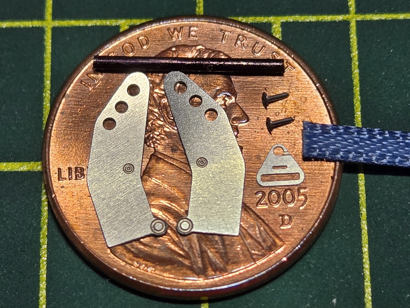

John...I can certainly identify with working with tiny pieces of photo etch having just completed a project with 100's of tiny pieces.  One tip I can give you if you aren't already doing it. To get those attachment points on PE I use the cut-off wheel to the moto-tool. Chuck the wheel into a battery operated unit  on at the lowest possible speed. Hold the piece tightly with a good pair of pliers and gently move the piece up against the spinning wheel. Hold the piece on its edge and make sure you use the side spinning away from you. That little attachment piece will disappear very quickly. I work on a full sheet of black construction paper and keep it completely clear of tools and parts. The parts will fly ( and some will fer sure)  but they show up on black easily. A magnet sometimes helps too.  You are doing a fabulous job on  this project. That dash is killer.

My goal for this model was not to build a super detailed model, but just to improve it beyond box stock.  I have never liked using decals for racing harnesses. The Hobby Design detail up set had a funky piece of material that you had to cut into strips for the seat belt material.  I made a couple of strips but I just didn’t like the looks of it.  I bought a variety of 2mm wide ribbon and used that as my seat belts.  I used a combination of kit PE and Hobby Design PE for the harness hardware.  I didn’t take any pictures while I was making them.

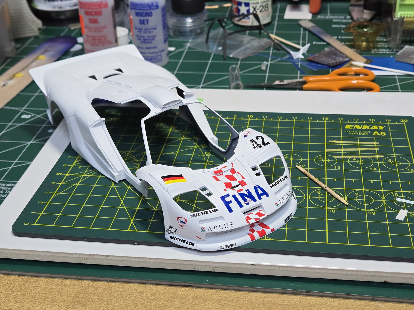

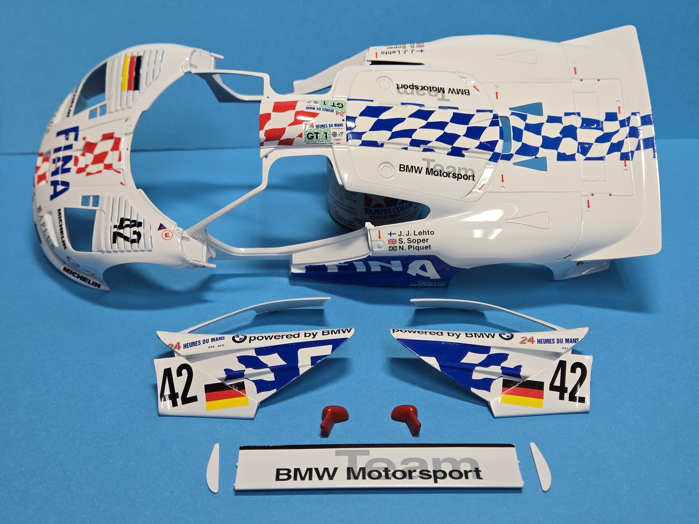

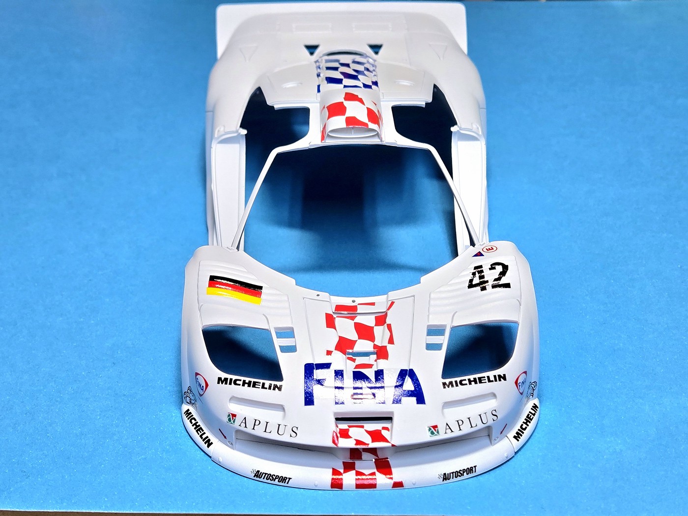

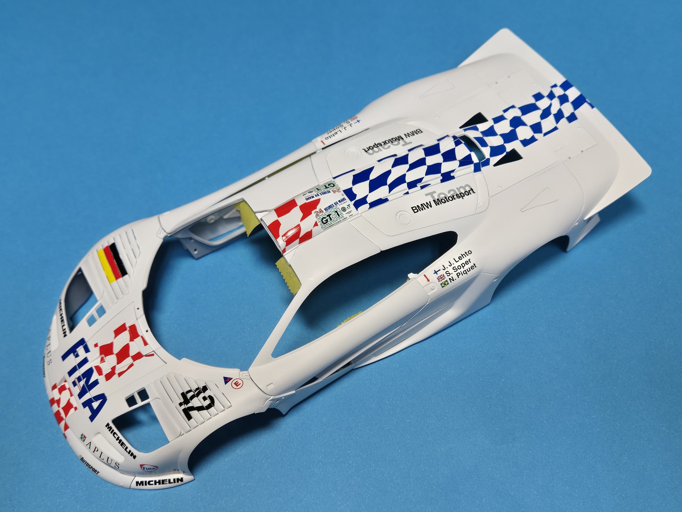

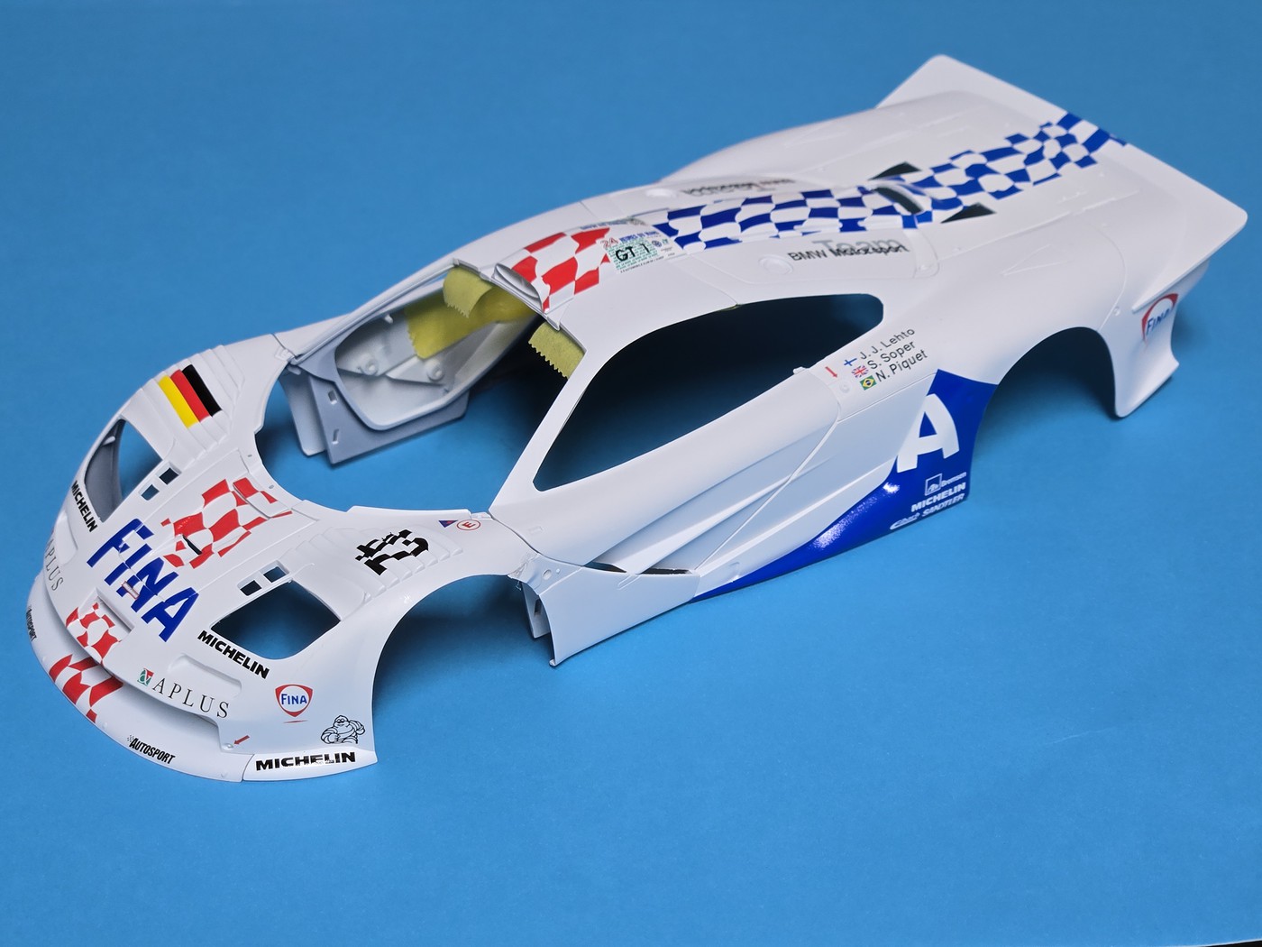

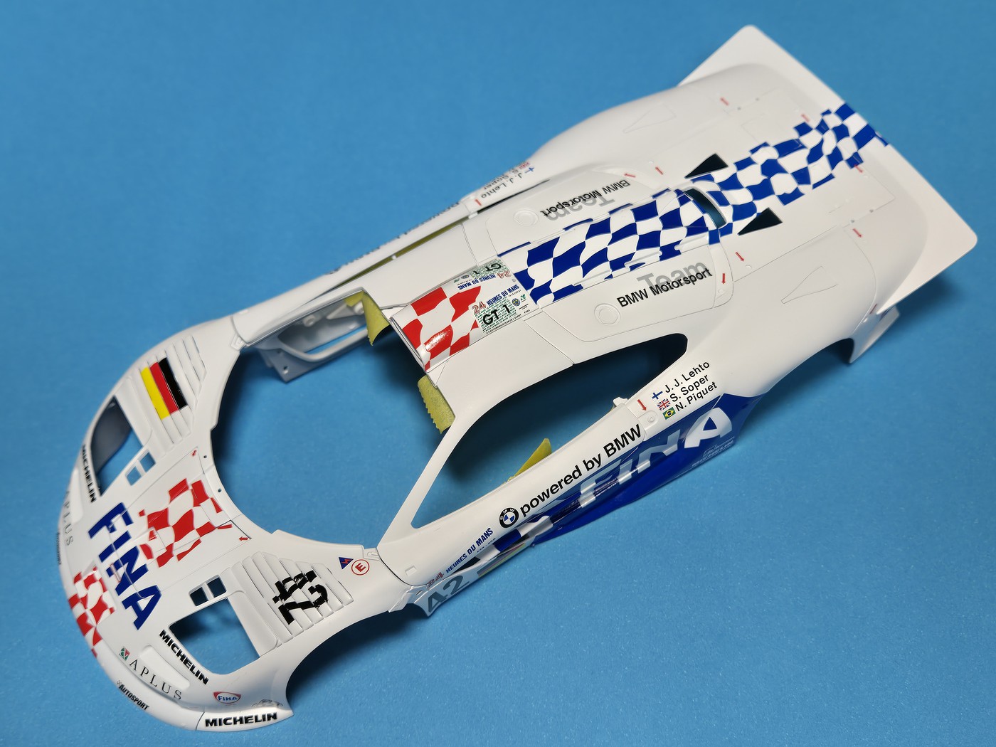

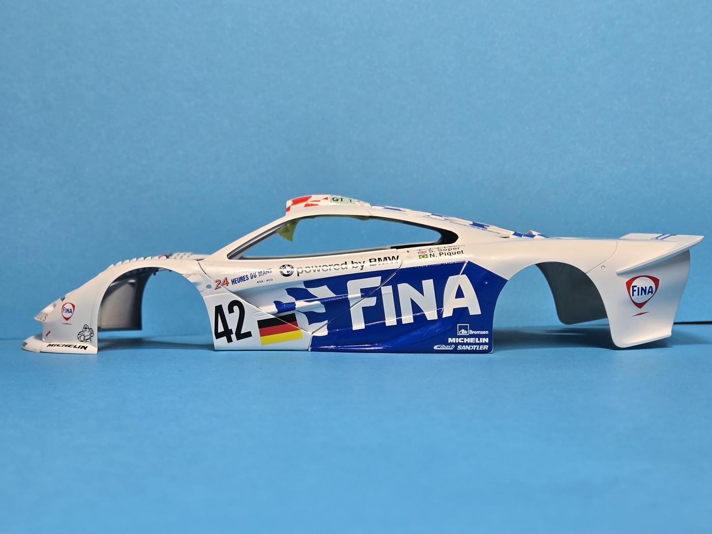

The McLaren is fully decaled.  It took me several nights to do them all.  I believe there were around 107 decals.  I’ll post a few in progress pictures so that you can see the sequence that I did them in.
A couple of notes.  I noticed when I taped the doors in place that they are just a shade of white different than the body.  I’m sure that I painted everything the same number of coats.  My guess is that I just shot it a little heavier on the body.  The good thing is that I plan to display it with the doors open.  You will not be able to notice the difference.  The next thing is that the decals, or the guy putting them on, are not perfect.  There were gaps in some areas.  Also, the decals did not completely cover the bottom of the car and the inner lips of the wheel wells.  I mixed some blues together until I got a match.  I am very happy with how it turned out!
As always, thanks for checking in on this one.  Comments, advice, and critiques are welcome.

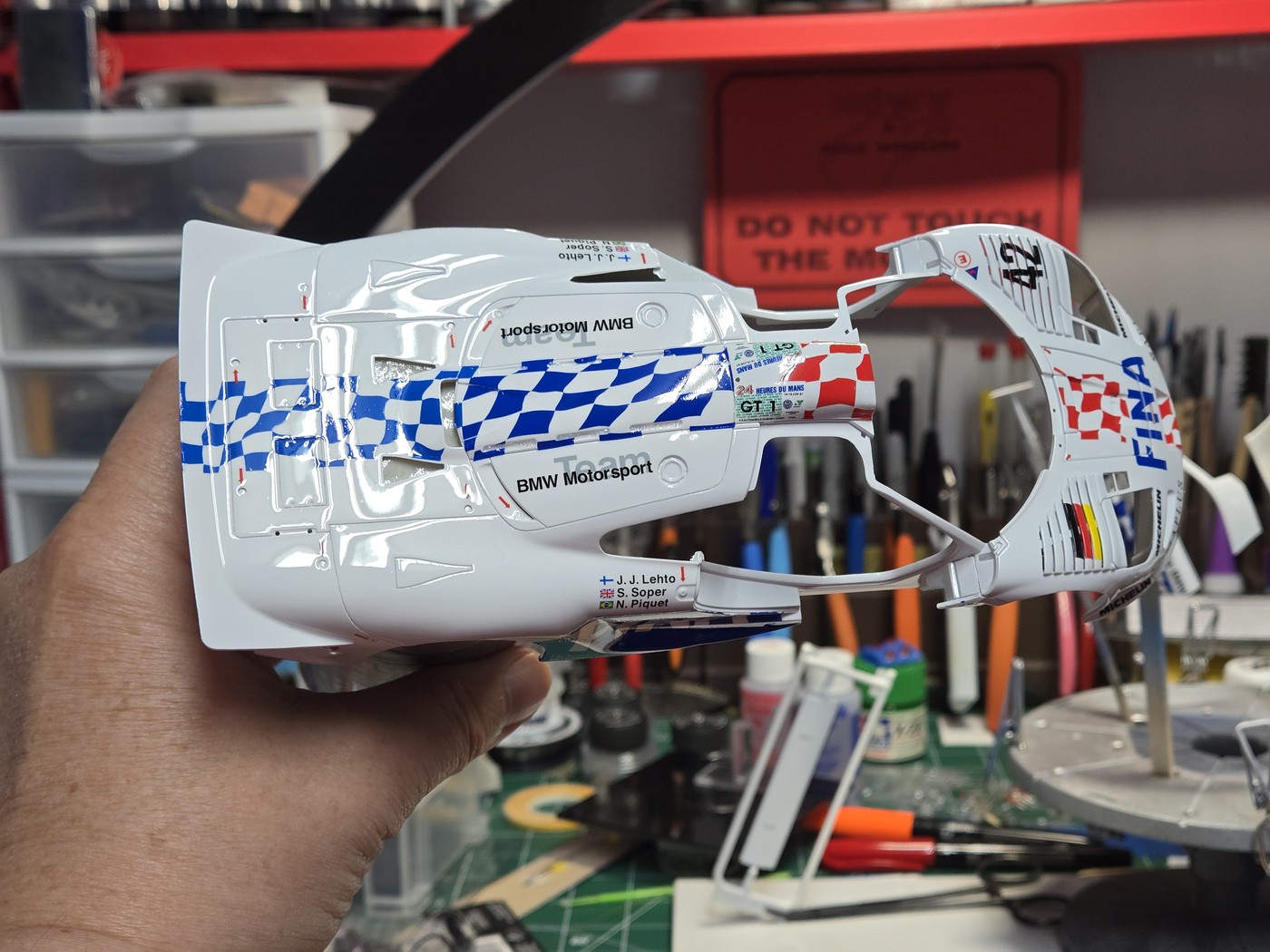

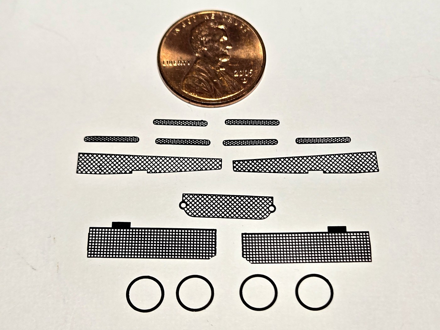

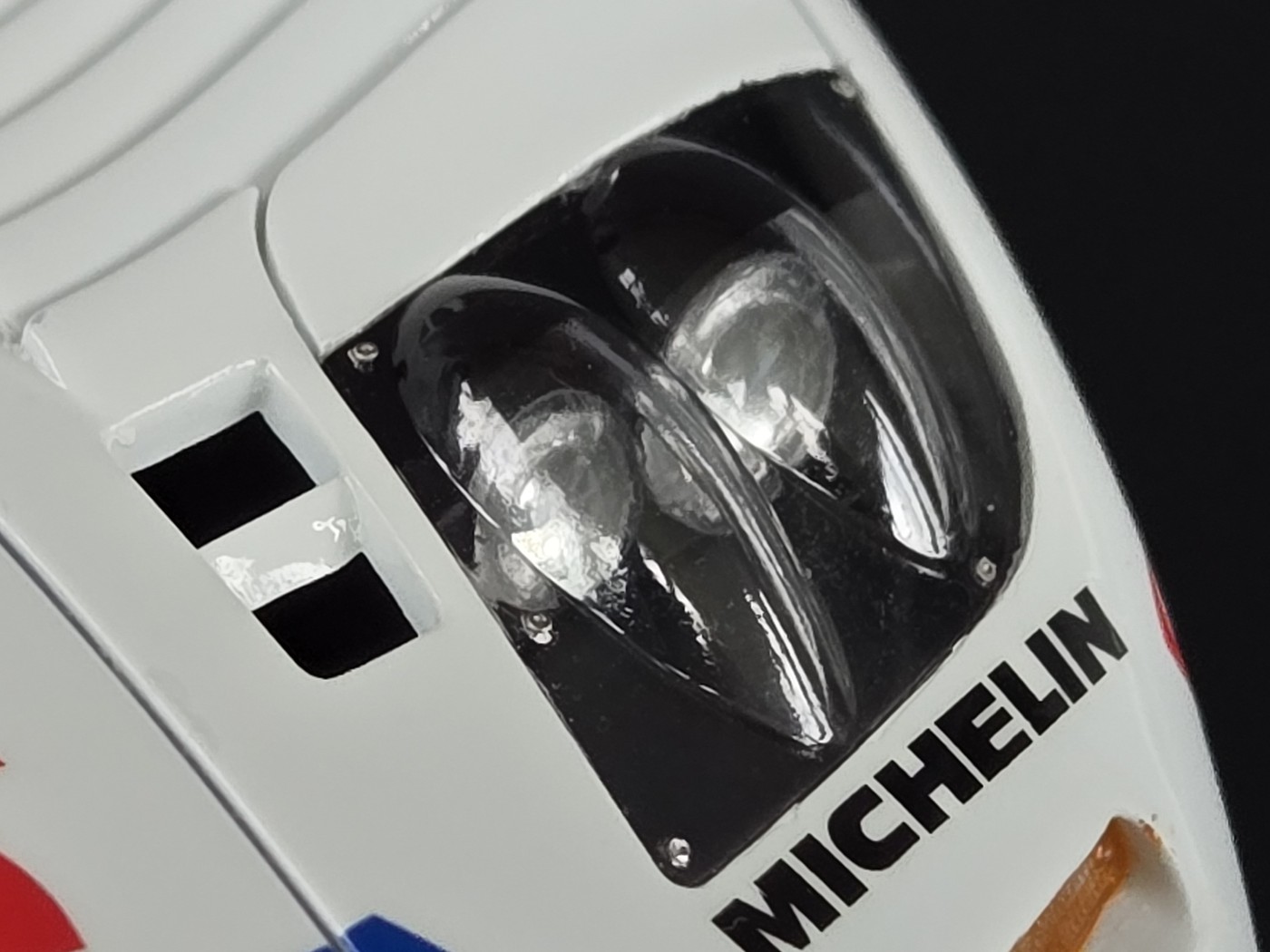

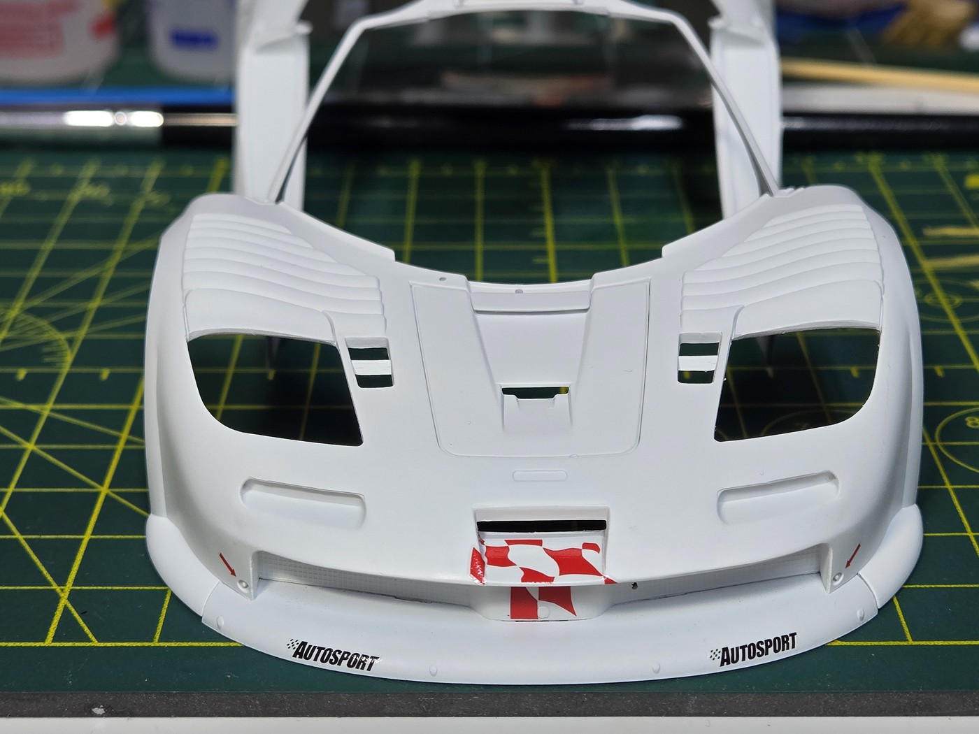

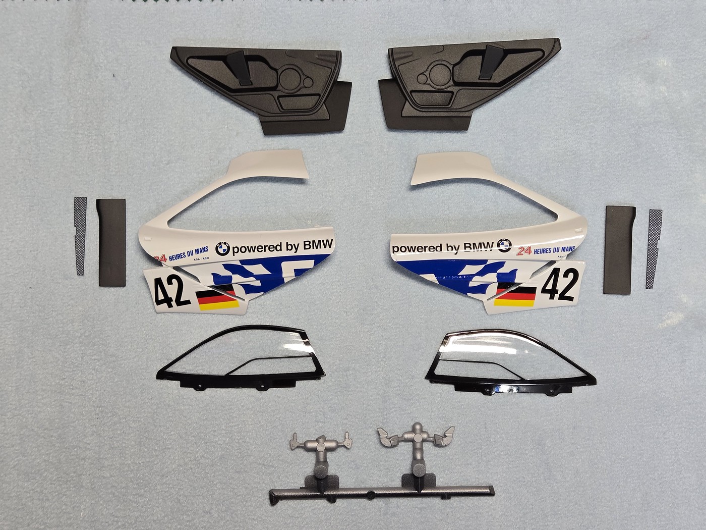

This will be the last update.  The model is finished, but I wanted to finish out this WIP thread.  I let the decals dry for a week and cleared the car with Mr. Top Coat Premium.  It was too thick and too glossy for my liking.  I rubbed it out with Micro Mesh cloths and then polished it with Tamiya compounds.  The finish is much more realistic, IMHO.  From there I used Tamiya Light Gray panel liner and detail painted some area.  Next I added all of the PE mesh and fasteners.  I built the doors and added the final items to the body.
An unnatural shine, IMO.
Here are the exterior components after rubbing out the paint and then polishing it out.  The finish is much more realistic.
The doors consisted of 9 pieces each. (Not pictured are the mirrors).
I added a good bit of PE items to the exterior of the body.  PE screw heads are a nice touch to the headlight covers.  There is one inside the right hand 0.
