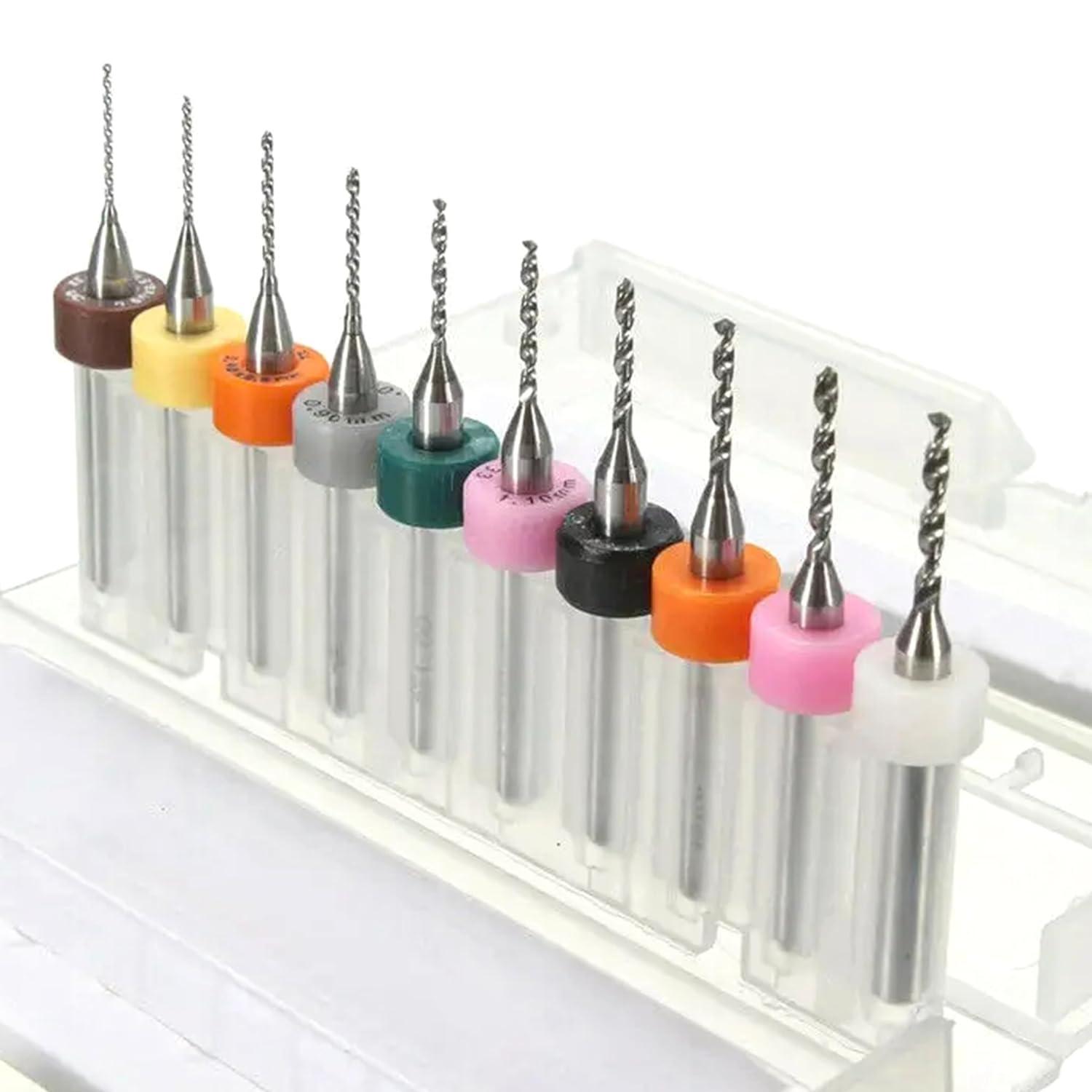

jdcar32 Posted June 13 Posted June 13 I use these Amazon purchased bits exclusively but I suggest care - they are carbide, sharp, do not tolerate side loading like conventional carbon steel ( like those in the little metal drill safe ). But they work very well and cut thin aluminum as well as plastic. I've bought several sets ( the smaller ones DO break ). These 'circuit board' type drills pretty cheap in bulk on Ebay to. They typically have a 1/8" ( .125" ) diameter shank so you need a pin vise to match. A good investment for modeling.

peteski Posted June 13 Posted June 13 On 6/13/2025 at 1:27 AM, jdcar32 said: I use these Amazon purchased bits exclusively but I suggest care - they are carbide, sharp, do not tolerate side loading like conventional carbon steel ( like those in the little metal drill safe ). But they work very well and cut thin aluminum as well as plastic. I've bought several sets ( the smaller ones DO break ). These 'circuit board' type drills pretty cheap in bulk on Ebay to. They typically have a 1/8" ( .125" ) diameter shank so you need a pin vise to match. A good investment for modeling. Expand What you have here are typical TC (Tungsten Carbide) PC-board drill bits with 1/8" shanks. These have also been mentioned in the other threads.
sidcharles Posted June 14 Posted June 14 (edited) not definitive, but some passing thoughts on my experiences after reading the replies: the sets shown above are a single twist and can feed themselves into the material being drilled too quickly to clear the swarth. good news is that their tapered body will generally clear the chip & deburr the hole if you get it that far. since they come in such small sizes, breakage is a constant threat & frequent occurrence. i use them, but also understand why they are moderately priced and usually sold in "3 sets for $10" quantities. the Xacto drills & index is an excellent choice. again, with the smaller sizes, breakage is always in the shadow, so choke up putting the drill into the collet and don't exert radial stress when drilling. remember: one of the tenets of scale modeling is patience. become One with the drill . . . [ X-acto Drill Bit Set w/Stand (Cd) ] i have found any tool made by Tamiya to be a marked improvement to whatever i had been using prior. for 40 years i have used a 6" hardware store mill file to straighten edges on styrene or fair an outside curve. recently i had amazon points so squandered them on a $30+ Tamiya flat plastics file #74058 [ Amazon.com: Tamiya 74058 Craft Tools - Plastic Modeling File (Flat 16mm Width) : Arts, Crafts & Sewing ] difference using & results is exponentially better than previous smoothing tools. also, an investment of tiny reamers years ago has proven a good decision. if you don't have the exact size drill bit for the job at hand, a reamer can save running to the LHS on a rainy afternoon. even if you do have the drill, go 1 or 2 sizes smaller, and ream the hole to a snug fit. i got mine from Micro-Mark. not a big user of their products [ i have issues how they "obtain" some of their branded tools' designs] but here's the link: Micro-Size Precision Reamers (Set of 6) – Micro-Mark i think i paid 50% of current price, but it was 20+ years ago, so i guess everything is relevant. they are only used for styrene and if they have dulled, it's not something of which i am cognizant. YMMV an index can also be a valuable addition to kit if you use a variety of wire sizes for detailing: [ Amazon.com: BIG HORN Horn 19878 61-80 Drill Gauge : Tools & Home Improvement ] sid Edited June 14 by sidcharles typo
bobss396 Posted June 14 Posted June 14 On 6/13/2025 at 1:39 PM, peteski said: What you have here are typical TC (Tungsten Carbide) PC-board drill bits with 1/8" shanks. These have also been mentioned in the other threads. Expand We made PC boards in-house at work until about 1989. I was in the right place when the drill collection was headed for the dumpster. I have more than a few 50 quantity boxes of them around.
