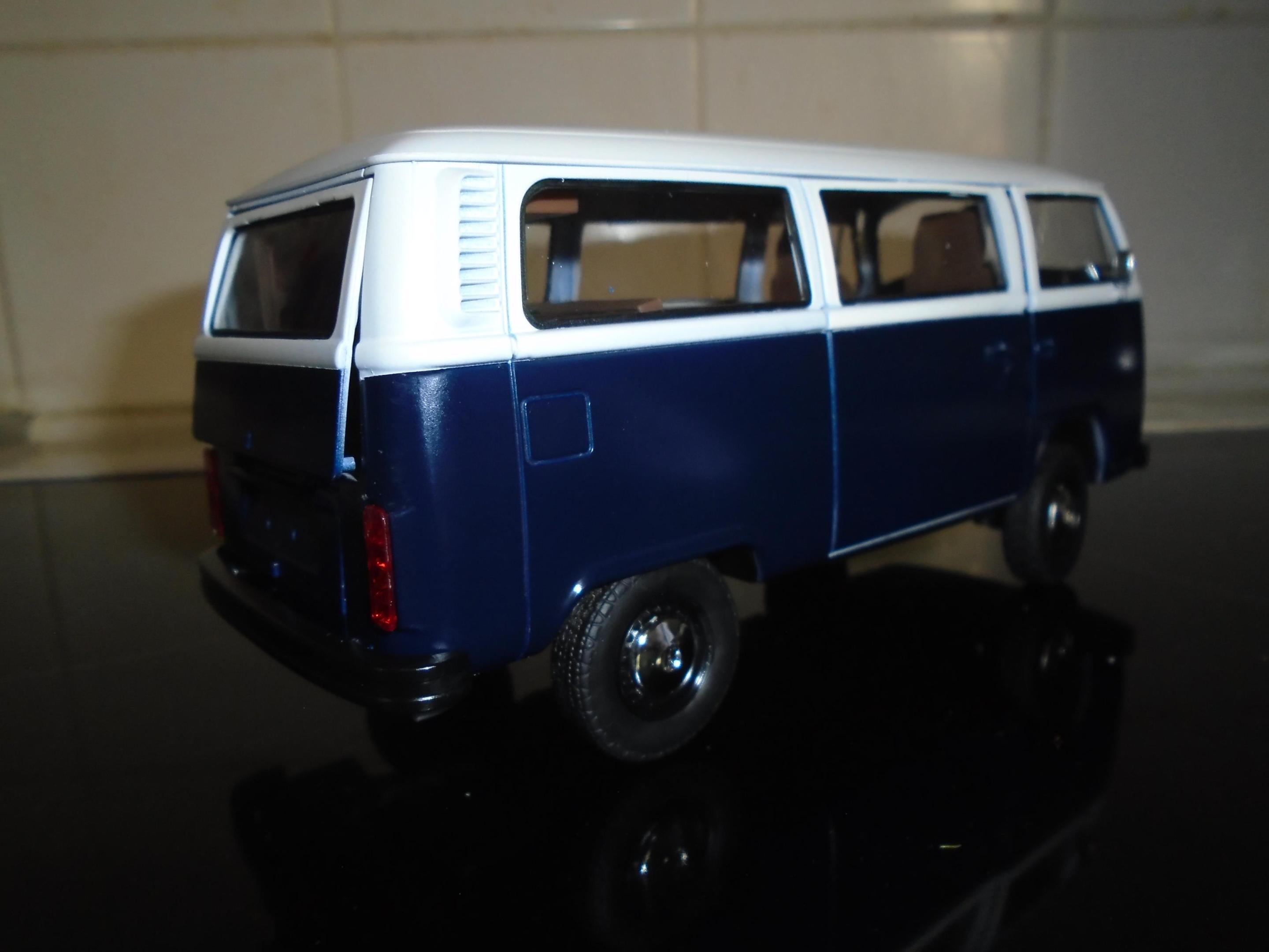

Can-Con Posted 1 hour ago Posted 1 hour ago 20 hours ago, stitchdup said: the worst bleed through i've had was the orange revell t2. with every coat of grey primer it got more and more peach and it took 2 coats of silver. usually just enough to cover does the job but it took a paintjob nearly. if i wasn't just using the tailgate it would have made a great early 90s cal looker colour I was kinda wondering if that kit would bleed, Les. We had a blue and white microbus of that generation when I was 13 or 14 so I'm definitely gonna get one eventually. 1
stitchdup Posted 48 minutes ago Posted 48 minutes ago 23 minutes ago, Can-Con said: I was kinda wondering if that kit would bleed, Les. We had a blue and white microbus of that generation when I was 13 or 14 so I'm definitely gonna get one eventually. the camper version is tan plastic and doesn't bleed
