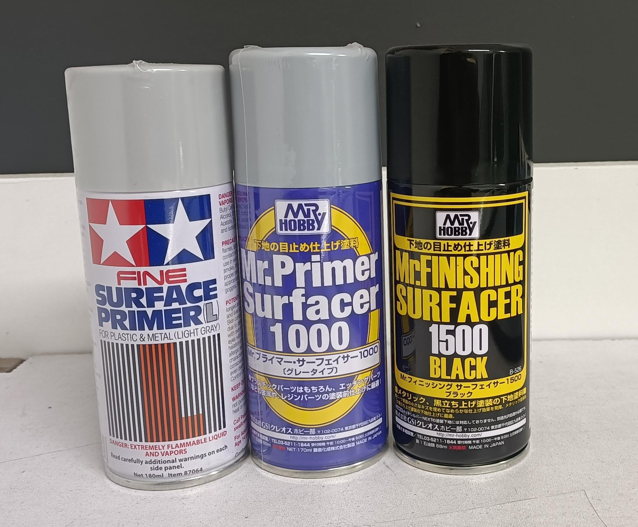

Bainford Posted 22 hours ago Posted 22 hours ago (edited) Yes, one can obtain great paint from a rattle can. Keep in mind though, that the path to achieving great paint is a journey. Even the best builders can be tested by a paint job. It is a career-long pursuit. To start, use quality products intended for model building, Tamiya and Mr Color paints are highly recommended, as are others. They are not the cheapest, by far, but they will be the most hassle-free, and will eliminate many of the variables that non-hobby paints will throw at you. Once some experience has been gained, you can experiment with other brands, such as Duplicolor, etc. Great paint jobs begin at the preparation stage; eliminating mold lines and block sanding across panel gaps, filling sink-marks, and other body corrections, but I wouldn't get too wrapped around the axel on this stuff if you are at beginner level. I would focus on getting rid of the mold lines, scuffing and washing the body, and using a compatible primer under your paint. And remember, if you screw it up, there are several effective methods of stripping paint from a car body. If you want to get deeper into prep, there is a lot of info on this forum, or just ask the group. Truley great paint will require advanced techniques such as cutting (colour sanding) & polishing, as well as years of trial & error. It all depends on how far you want to go with it, the level of greatness you strive for. Don't get discouraged, and ask questions if problems are incurred. If you are at all serious about the hobby, consider a good quality (not necessarily expensive) airbrush. Then, the trials & tribulations really start.😉 Edited 21 hours ago by Bainford typo 2

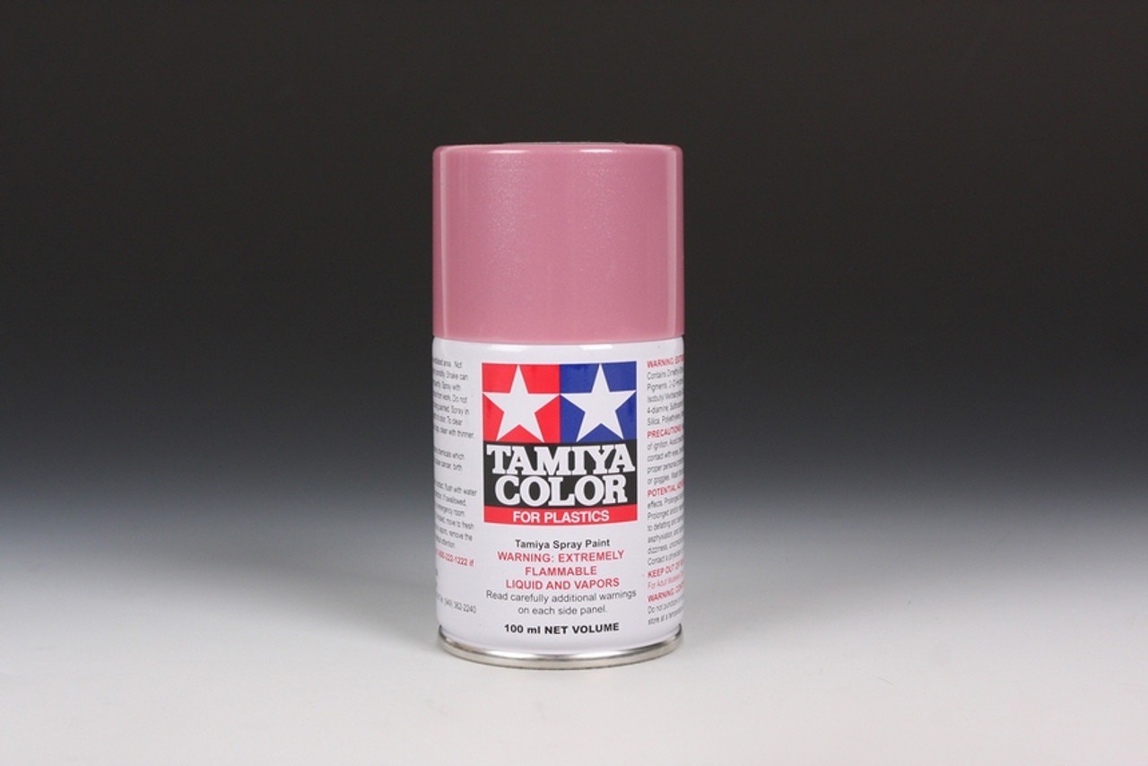

Zoom Zoom Posted 12 hours ago Posted 12 hours ago Tamiya TS spray lacquers are excellent. After you've watched some videos on paint prep, priming, painting consider getting a can of TS-59 Pearl Light Red, it's a mauve-like pink. These paints are designed for modelers for plastic models (not 1:1 cars) and apply very smooth as long as you've done a good job on body prep and use a good quality Tamiya or Mr. Hobby white primer. Their TS-13 gloss clear is also almost fool-proof. Grab some white plastic spoons to test out the various spray paints you want to use before committing to spraying the actual model body. 1
