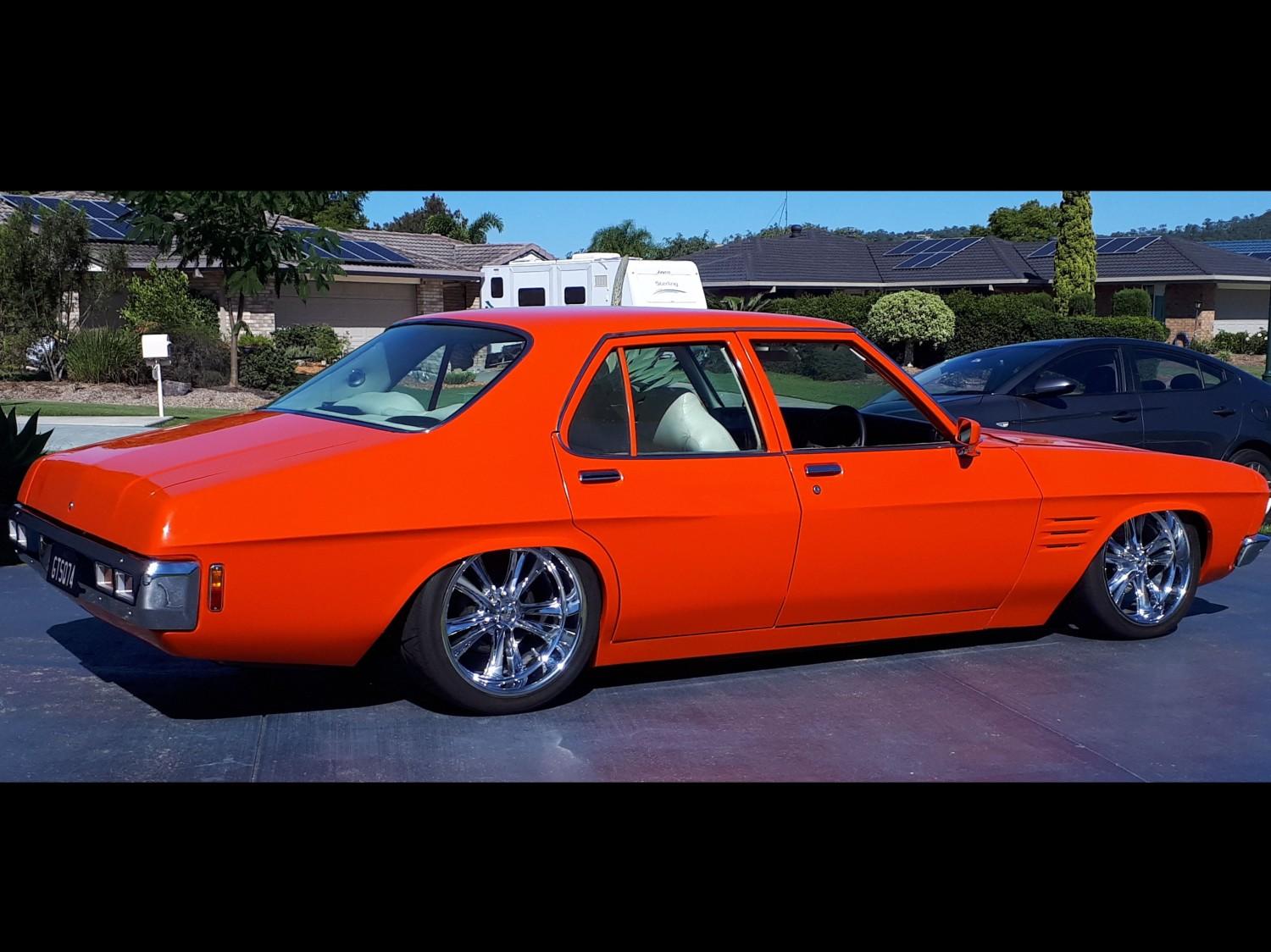

This build is a special one to me as its inspired and my interpretation of local car that was one of my favourites  back in day during the late 90's. And its the reason I like Holden HQ sedans. I only manage to get one picture of it from a local event.
My memory of it is pretty vague, but il never forget how it did sound and look. The engine was a fully worked 350 Chev with a Jackson Gear drive, big stall convertor and 4:11 gears. If you know you know.
