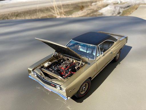

IMG_3756.jpeg.9f11c78a6eac2220c298e205cfeddab3.jpegIMG_3757.jpeg.c2b3d92046b8e0c2c4d69d42d3c7cf00.jpegD0760AD3-5365-4E09-81AF-106EC670114B.jpeg.0b5bb1977d9e5da62b0ef3e84603d99c.jpeg

a gateway procedure to the above final method would be to paint the firewall solid color, and the glue wire of whatever color you want using the molded wire as a path.
most of it would disappear into the shadow if your new wire was applied to the topside & viewing surface.
a betcha a cookie after 2 or 3 like that, you'll be ready to sand down to flat and run the wires to suit.
you can see the results are well worth the effort.

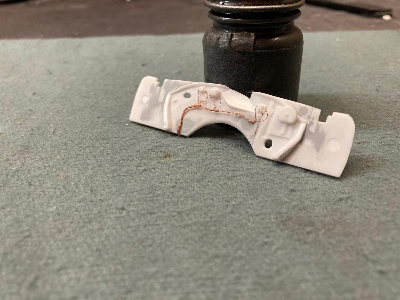

Another one that was done by replacing firewall details.
IMG_3758.jpeg.52f9688152bbb782d635e75ba934973d.jpegIMG_3759.jpeg.5a826befe4dc2ec2ca72985ae973e74f.jpegIMG_3760.jpeg.19a5f214f5dfd0d1a232114bb1295e90.jpegIMG_3761.jpeg.2d9936d4edcbefafc4ff2704389a0780.jpegIMG_3762.jpeg.920687420745f14f17d5fbc109b88d9f.jpegIMG_3763.jpeg.b2cd3e7057669209a6a626f9fd28724b.jpeg
Steve

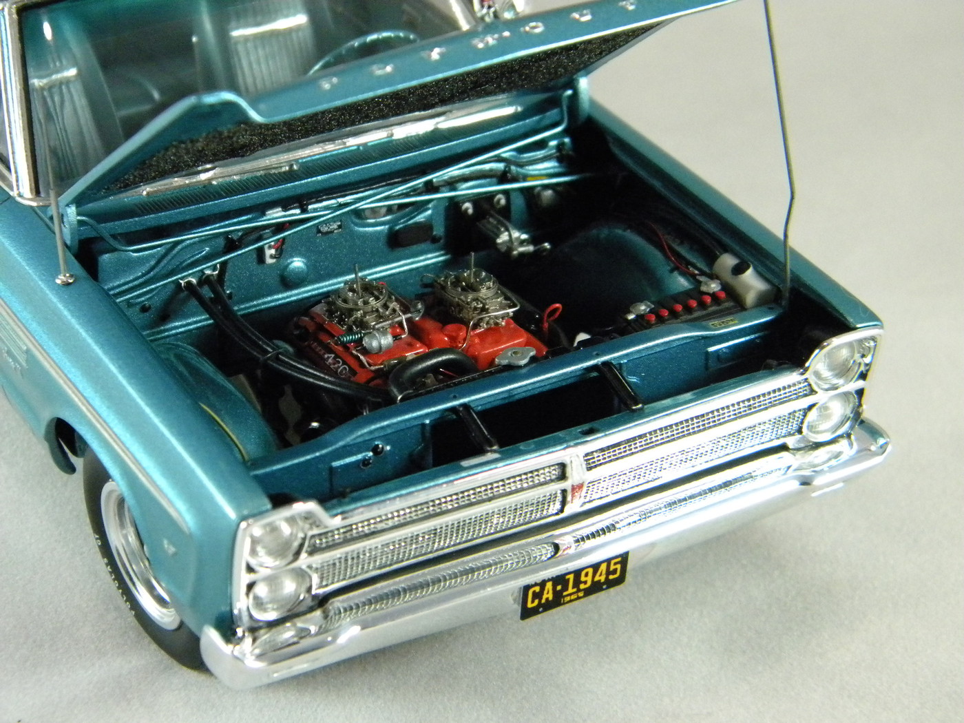

A few examples.
IMG_3766.jpeg.0d3f5e5694a9dee7d51efe04023c654e.jpegIMG_3553.jpeg.8e2f4e312073748658fcccde26c6008f.jpegIMG_3768.jpeg.0546dfb0dc8fb5cd69407ab9a2b0d0f0.jpegIMG_3769.jpeg.d8072653d0b6ed12b25574001f256b36.jpeg
Steve
