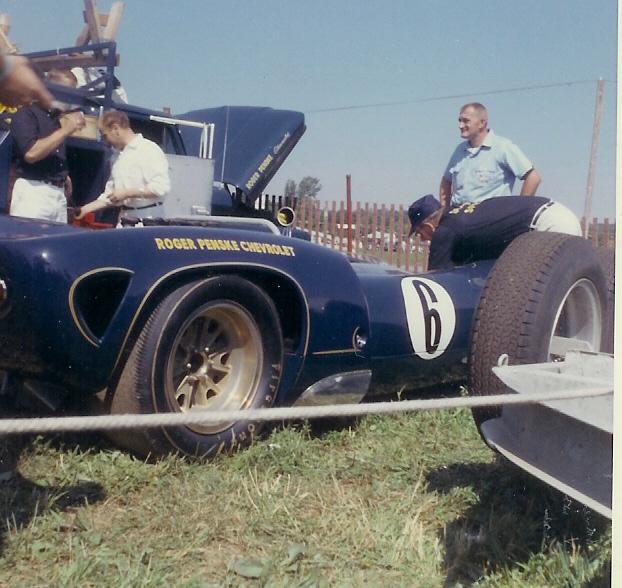

Gramps46 Posted August 13 Posted August 13 (edited) Great choice of a super Lola. Watched them race at Mid Ohio course with my Kodak Instamatic. . Will be watching closely. Edited August 13 by Gramps46 6

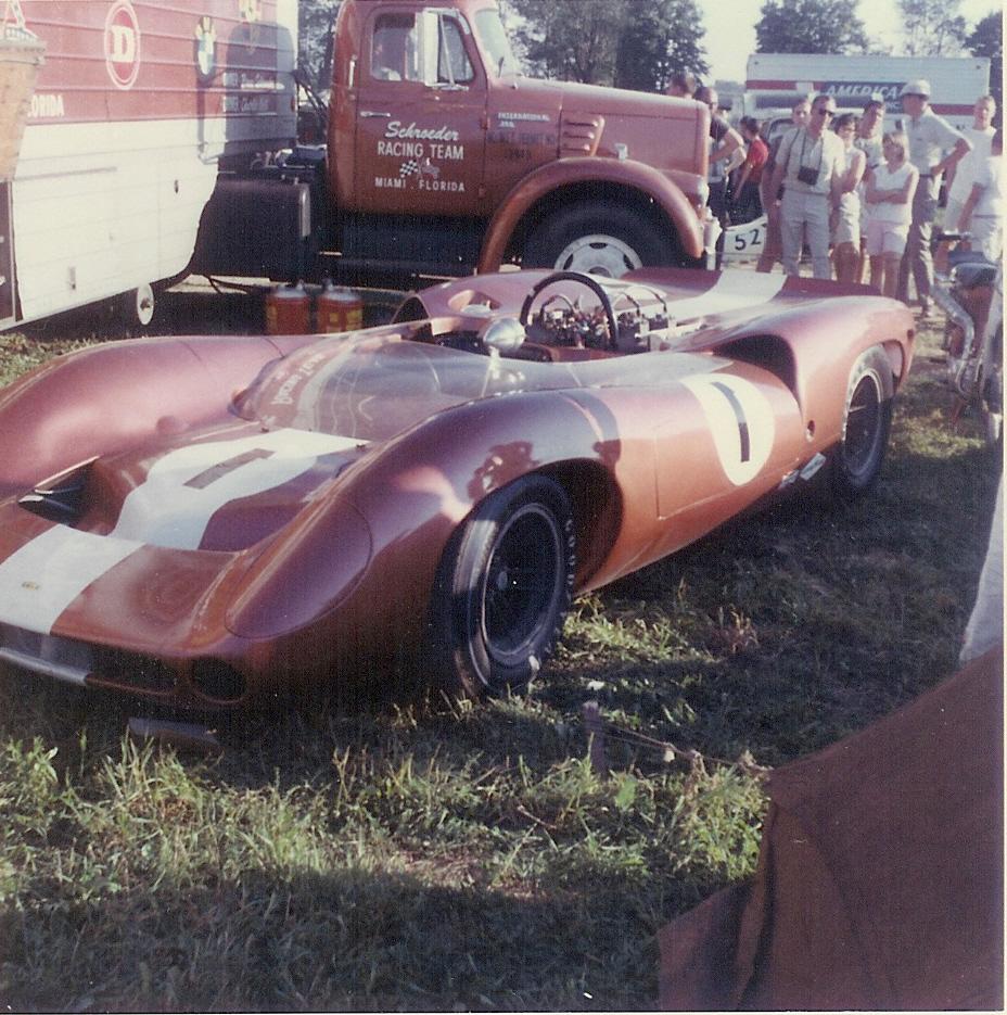

absmiami Posted August 13 Posted August 13 Kodak Pit pix from Mid-Ohio fr ??? 1968 ??? Gramps strikes again …
Gramps46 Posted August 13 Posted August 13 2 hours ago, absmiami said: Kodak Pit pix from Mid-Ohio fr ??? 1968 ??? Gramps strikes again … 1966

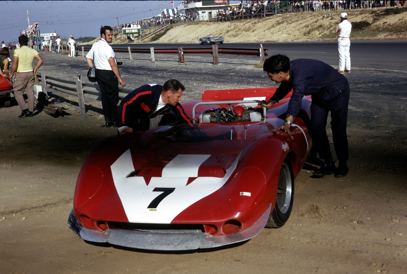

RancheroSteve Posted August 14 Posted August 14 I've got one: a photo of the Surtees Lola shortly after he parked it at the Bridgehampton Can-Am in 1966. Taken through a fence by my dad (I was standing right next to him). Looks like you're off to a good start - I'll be watching your build. 4
