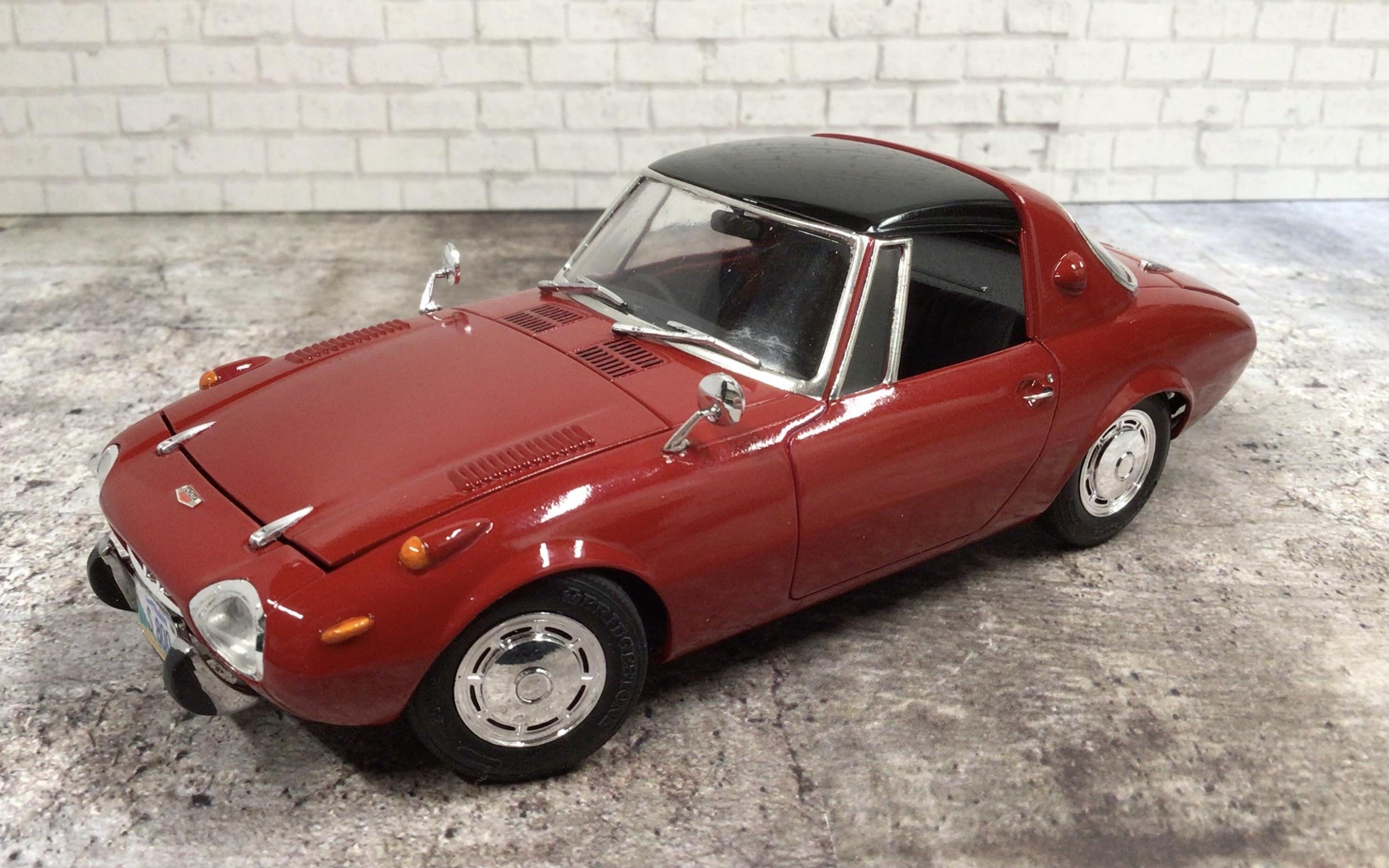

NOBLNG Posted 22 hours ago Posted 22 hours ago On 9/27/2025 at 3:57 PM, MackDrop said: Hi folks, is it possible to airbrush acrylic matte paints on a car body and then hit it with clear gloss? Due to health concerns, spraying enamels and lacquers is out of the question. Thank you! This is painted with Vallejo Model Air 71.102 Red. Then clear coated with Mr. Hobby Premium Topcoat. I use winter windshield washer fluid for cleanup of the Vallejo. It works as good or better than their proprietary stuff.
