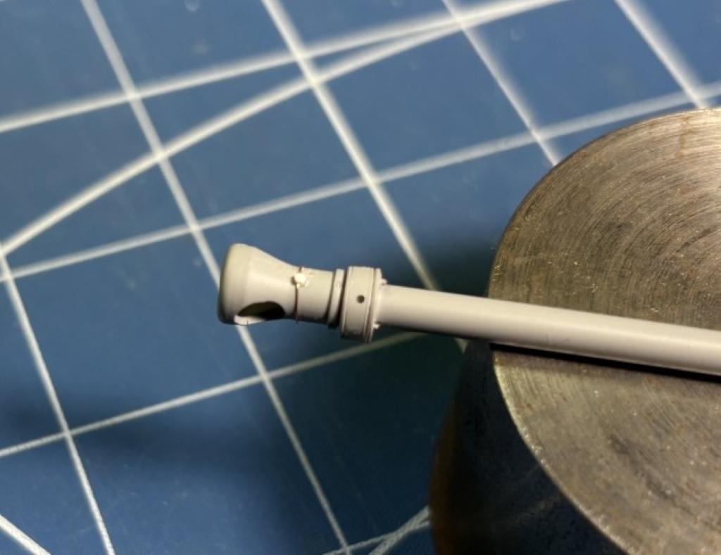

NOBLNG Posted November 22 Posted November 22 That certainly is tiny! You’re not likely to use that one by hand in a pin vise.😬 I managed to drill 0.4mm (0.0157”) holes in some aluminum hinges I made for a Toyota S-800. I mounted my rotary tool in a press stand to do it. 7

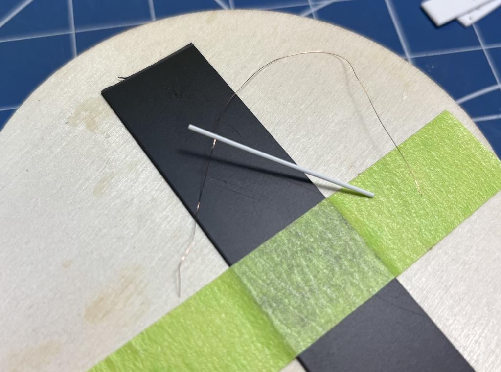

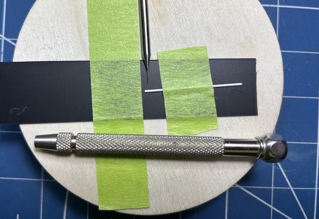

ColonelKrypton Posted November 22 Posted November 22 I was recently working on a project and wanted to drill some very small holes. A 0.15mm hole in a piece of 0.6mm hex shaped piece of plastic was the target. The 0.15mm hole was needed to feed a piece of 0.1mm brass wire through. I sourced some of the common Chinese carbide PCB drill from amazon and gave it a try just to see if I could indeed manage the task. After a bit of fussing and working my way down in size from 0.4mm, I did in fact manage to make my 0.15mm hole and just to prove to myself that it was no fluke I repeated the task several times. Admittedly, I did break three 0.15mm bits, one in use and the other two from just being careless. Best holder for these style of drill bits having a 1/8" shank is the holder of my Starrett 70A scriber. Used only the weight of holder and bit with the index finger of my left hand steadying it vertically and carefully turning with the fingers of my right hand. Holding the piece to be drilled is vitally important. You are doomed to failure if you try to hold it in your fingers or loose on the bench. Piece with hole and 0.1mm brass wire through that hole: Tamiya markets some 0.2mm high speed steel (HSS) bits that work very well and are not as easily broken as these carbide bits. I never broken one but I have lost one by being careless when putting it down on the workbench where it simply vanished into the clutter never to be seen again. cheers, Graham 5 2
johnyrotten Posted November 22 Posted November 22 43 minutes ago, ColonelKrypton said: Best holder for these style of drill bits having a 1/8" shank is the holder of my Starrett 70A scriber. I have the same scribe,though yours is in much better condition. Mine was a 1.00 dollar swap meet find. Fits carbide drills perfectly. 1

ColonelKrypton Posted November 22 Posted November 22 1 hour ago, johnyrotten said: Mine was a 1.00 dollar swap meet find. Fits carbide drills perfectly. I wasn't so lucky but bought mine on Amazon on sale. Fits any cutting tool having a 1/8" shaft. I also use it to hand hold small burrs for delicate work. cheers, Graham 1

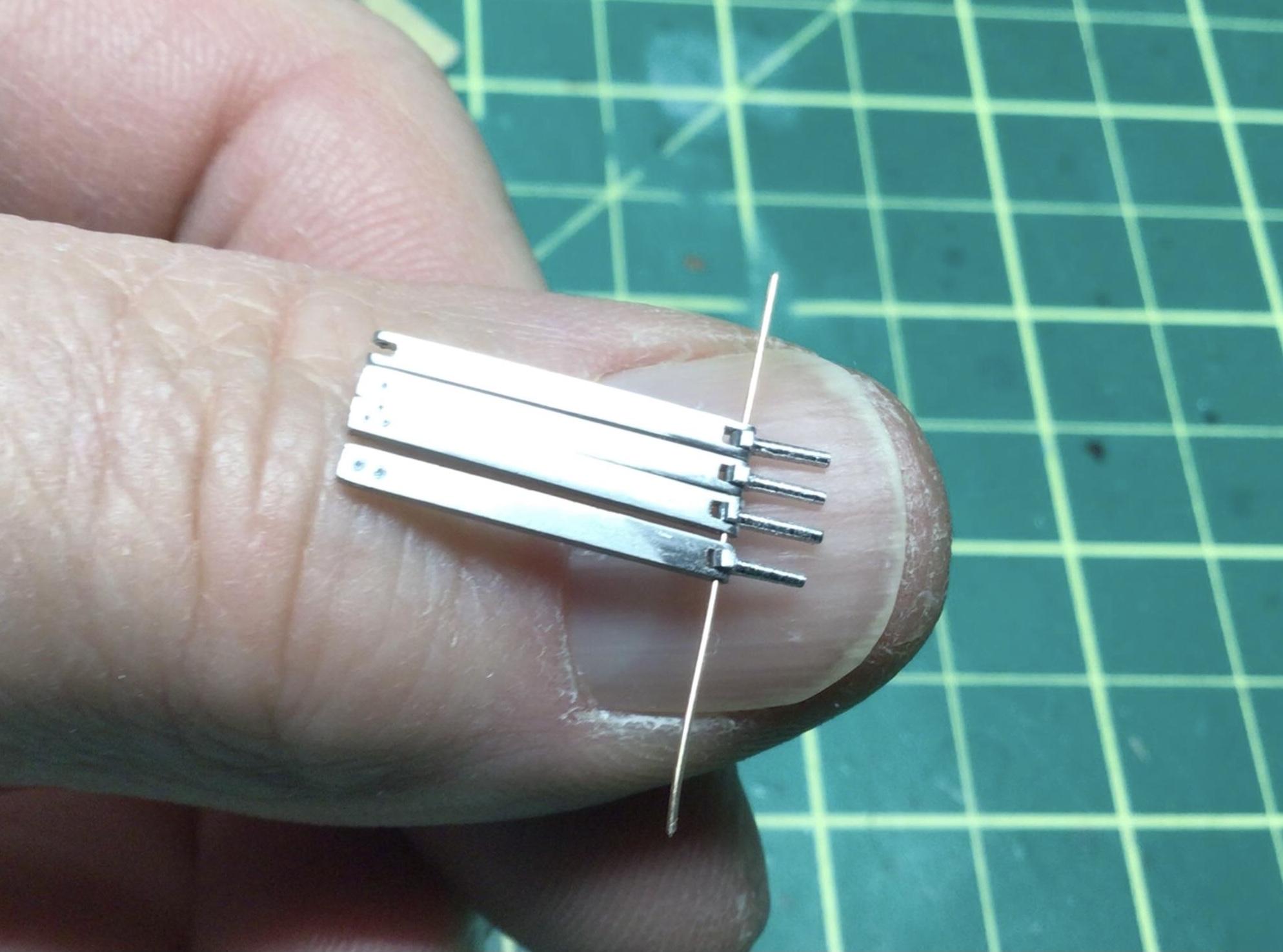

peteski Posted November 23 Posted November 23 Here are my smallest PC board drill bits. I have no problem hand-drilling using #80 and #85 bits in plastic (I do occasionally break a bit), but I only used the #96 bit in my miniature drill press (and broke few even then). When I use a drill press, I can drill #80 and #85 holes in metal. The dimensions in my drill index are in inches. The #96 bit is protected by plastic tube because it will break pretty much even if you gently brush against it. 5

peteski Posted November 24 Posted November 24 10 hours ago, ColonelKrypton said: Nor do I and even in brass and aluminum with the bit held in a quality pin vice and the work piece held steady and not in my BFF ( Big Fat Fingers ). Carbon steel or high speed steel ( HSS ) wire size number or metric drills are far less brittle than those carbide bits but I do break one from time to time. #80 is approximately 3.5mm diameter and #85 about 0.3mm. For plastics I actually hold the drill's 1/8" shank directly in my fingers, but I don't have BFFs. For soft metals yes, I do put them in a pin vise with the free spinning back that rests in the palm of my hand. As for #80 size I suspect you made a typo. It is 0.013" or 0.33mm. Just slightly larger than #85. 1
