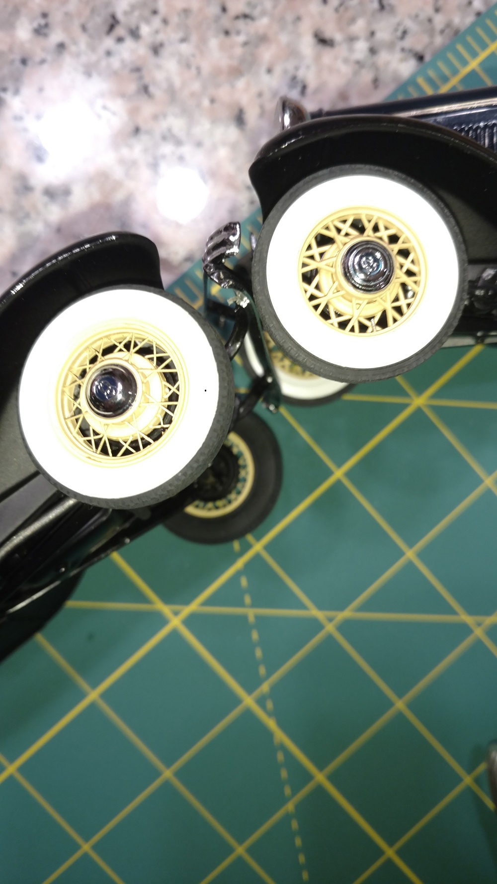

Flat32 Posted December 5, 2017 Posted December 5, 2017 2 hours ago, peteski said: Fireball Resin makes several types of tires cast in soft (urethane?) rubber material. I know they do. Just not what I need to fit my rims. I suppose you could say I want a real tire at 1:25. I see no reason why we can't have Danbury Mint quality level spoked wheels on the beautifully hand crafted models I see on the forums.
peteski Posted December 5, 2017 Posted December 5, 2017 18 minutes ago, Flat32 said: I know they do. Just not what I need to fit my rims. I suppose you could say I want a real tire at 1:25. I see no reason why we can't have Danbury Mint quality level spoked wheels on the beautifully hand crafted models I see on the forums. Fireball Resin tires are depict tires on modern vehicles. So you are planning on making tires for antique cars? As far as as the diecasts from Danbury or Franklin Mints go, I have couple Danbury Mint '30s cars and I don't consider their spoke wheels to be particularly well made. The spokes are fairly out-of-scale molded plastic. Maybe you've seen some that have photoetched spokes? Those look much better, but the best ones are hand-laced using wire.
Flat32 Posted December 5, 2017 Posted December 5, 2017 Danbury '32 roadster on right, molded plastic. Danbury '32 3 window coupe on left, real wire spokes.
peteski Posted December 6, 2017 Posted December 6, 2017 18 hours ago, Flat32 said: Danbury '32 roadster on right, molded plastic. Danbury '32 3 window coupe on left, real wire spokes. Fair enough. I'm not a die-cast model collector and I have never seen any of the "Mint" models with nice real wire spokes like that.

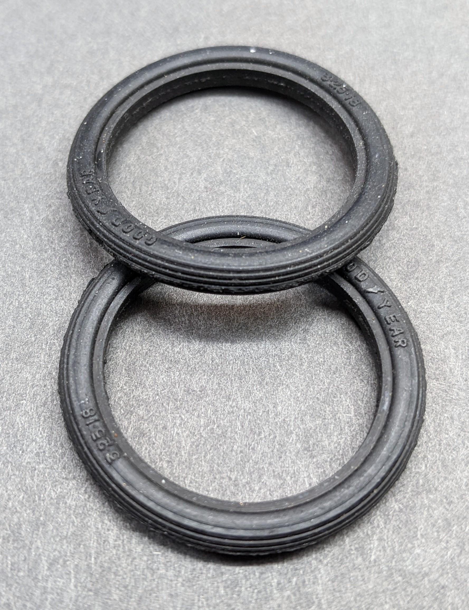

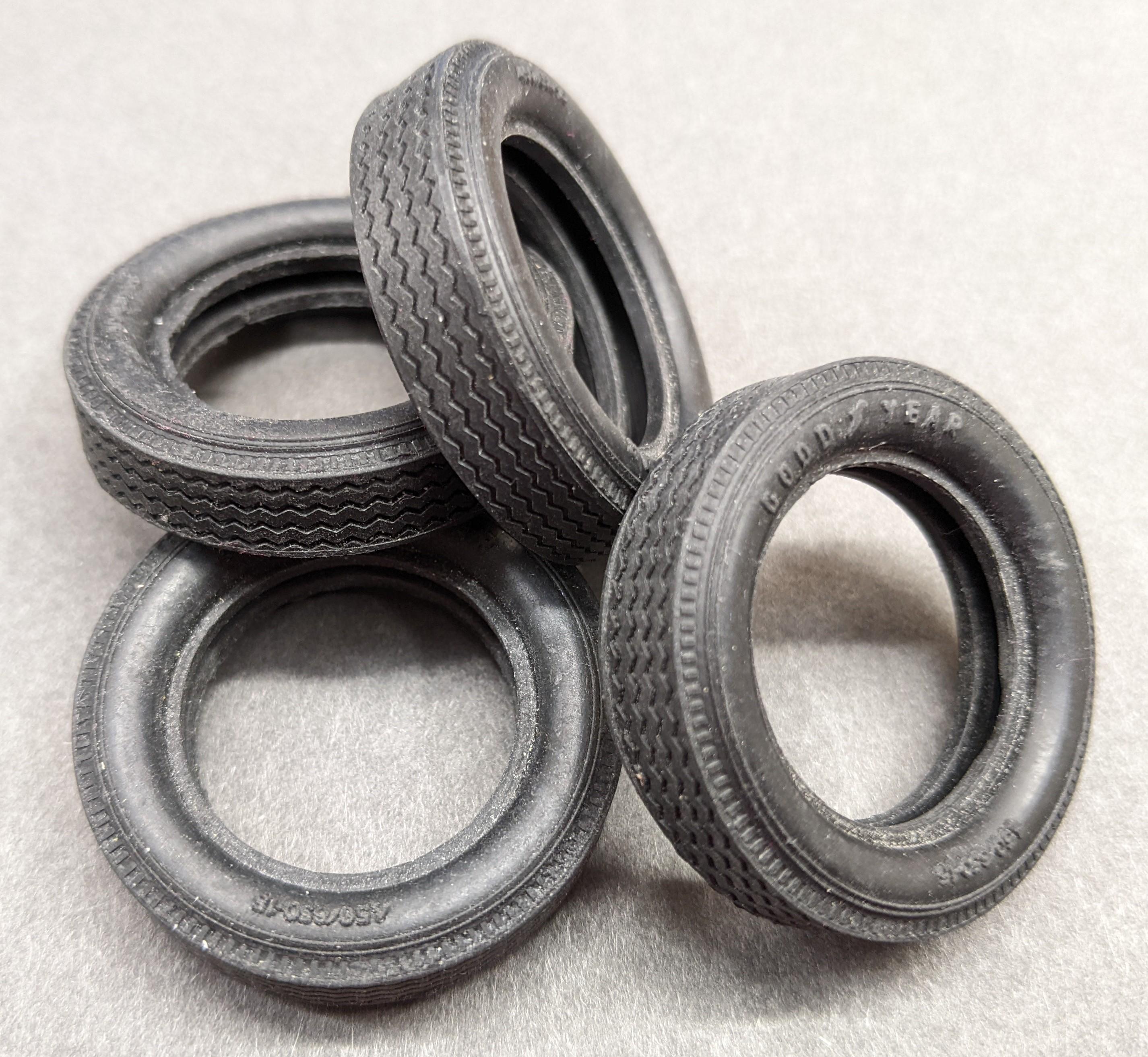

Casey Posted January 18, 2022 Posted January 18, 2022 On 11/2/2010 at 12:08 PM, Jon Cole said: What tire melt? http://images116.fotki.com/v700/photos/5/54765/228091/3Timehastakenitstollonthetires-vi.jpg http://images22.fotki.com/v820/photos/5/54765/228091/QQThisslickhasREALLYdecomposed-vi.jpg While I have seen a handful of 1/16 Revell F/C tires deformed, I have yet to find one which has melted. The rear slicks were molded with relatively thin (much thinner than other scale slicks) sidewalls, so that may have been a major factor in their eventual collapse, too. I think it was Ed Sexton who told me the place in Japan where Revell had these tires molded (presumably the same place since the early '70s when the 1/16 scale F/Cs debuted) was destroyed by the Great Tohoku Earthquake in 2011, so the 2014 Hawaiian Charger F/C reissue had all-new tires which were molded in China. As for Revell semi-soft tires holding up over time, I doubt it can be explained by one issue or phenomenon, so what may have caused the total failure of one set may have left another set unscathed. Maybe it's just luck, too, but don't assume the tires in your kit are now useless-- check them to be sure. Here are pics I took today of the Mikey Thompson Baja King tires included in the 1/16 Revell Chevy Off-Road Pickup kit (and it's later modified reissues), which was released in 1979. The first image is of the four tires still "sealed" (with two small staples) in the original bag: They are still in good nick, fortunately. I have another set from a built model I bought a decade ago, not nearly in the same condition, unfortunately. I'll take and add some images tomorrow.

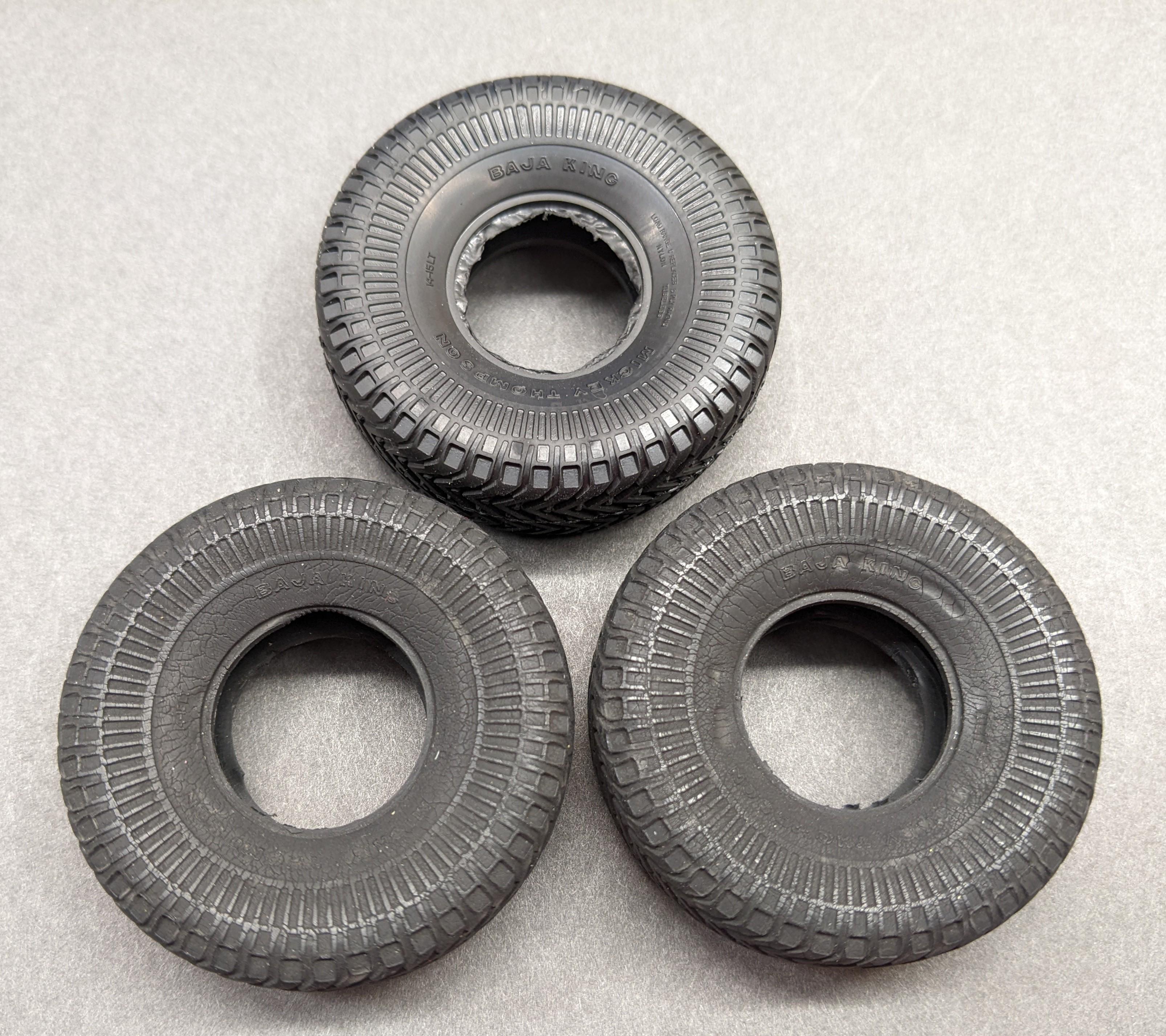

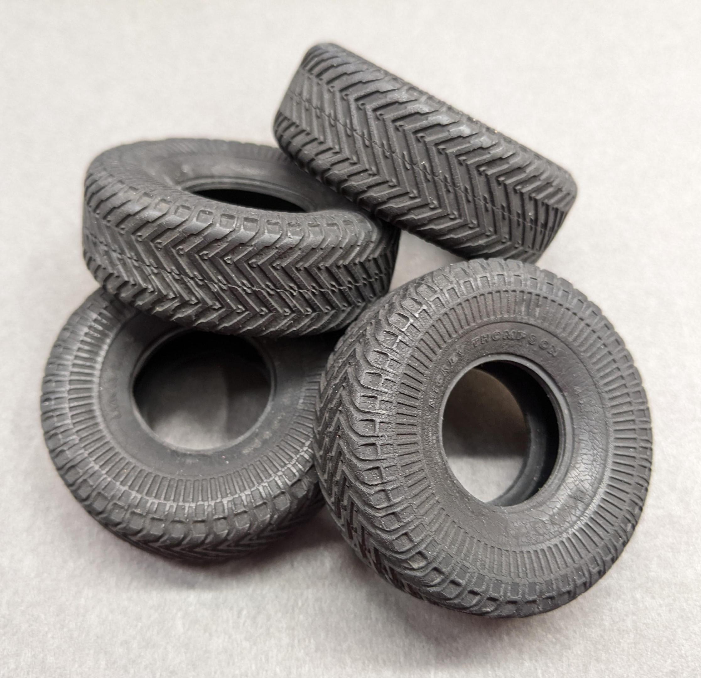

Casey Posted January 20, 2022 Posted January 20, 2022 Here is another vintage set of the Mickey Thompson Baja King tires, this set is poorer condition. Multiple factors at play I think, but as shown further below, other 1/16 Revell rubber-like tires have fared just fine. ?? Same tires, vastly different condition: 1/16 Revell Funny Car Goodyear front tires, still in good nick: Same for these 1/16 Revell T/F dragster skinnies:
Casey Posted January 20, 2022 Posted January 20, 2022 As mentioned earlier in this topic, a few companies have tried experimenting(?) with different methods and material to mold tires, but something's got to give-- literally. Either the mold itself (say, when using a silicone rubber mold) or the tire itself (see, Revell and others' "rubber-like" tires) needs to be able to flex and allow the tire to exit the mold without damaging the intricately shaped tread blocks, something which need to be done thousands of times in a production cycle. MPC tried something with it's Swamp Buggy Jeep kit, using styrene slick halves (outer and inner), then requiring the builder to glue the ends of a "Thermo rubber" tread strip together, allowing it to dry/cure (did model kit glue really work for this?), then slipping the tread piece over the circumference of the slick to create an off-road style tire...I'll let you decide if that was realistic, effective, accurate, etc. This appears to be one of the earlier attempts by MPC to mate PVC and styrene, and while they molded other parts (seating surfaces, floor mats, snowmobile seats and treads come to mind) in the same flexible vinyl material, the idea never stuck, was abandoned, and doesn't appear to have ever been attempted since. For the record I don't think this was a terrible idea, as it allowed for excellent tread block/lug detail, but the mating and blending of two very dissimilar materials seems to be the stumbling block. Maybe the more recent proliferation of water-based acrylic paints make this lees of an issue in 2022 than it was in 1970?
