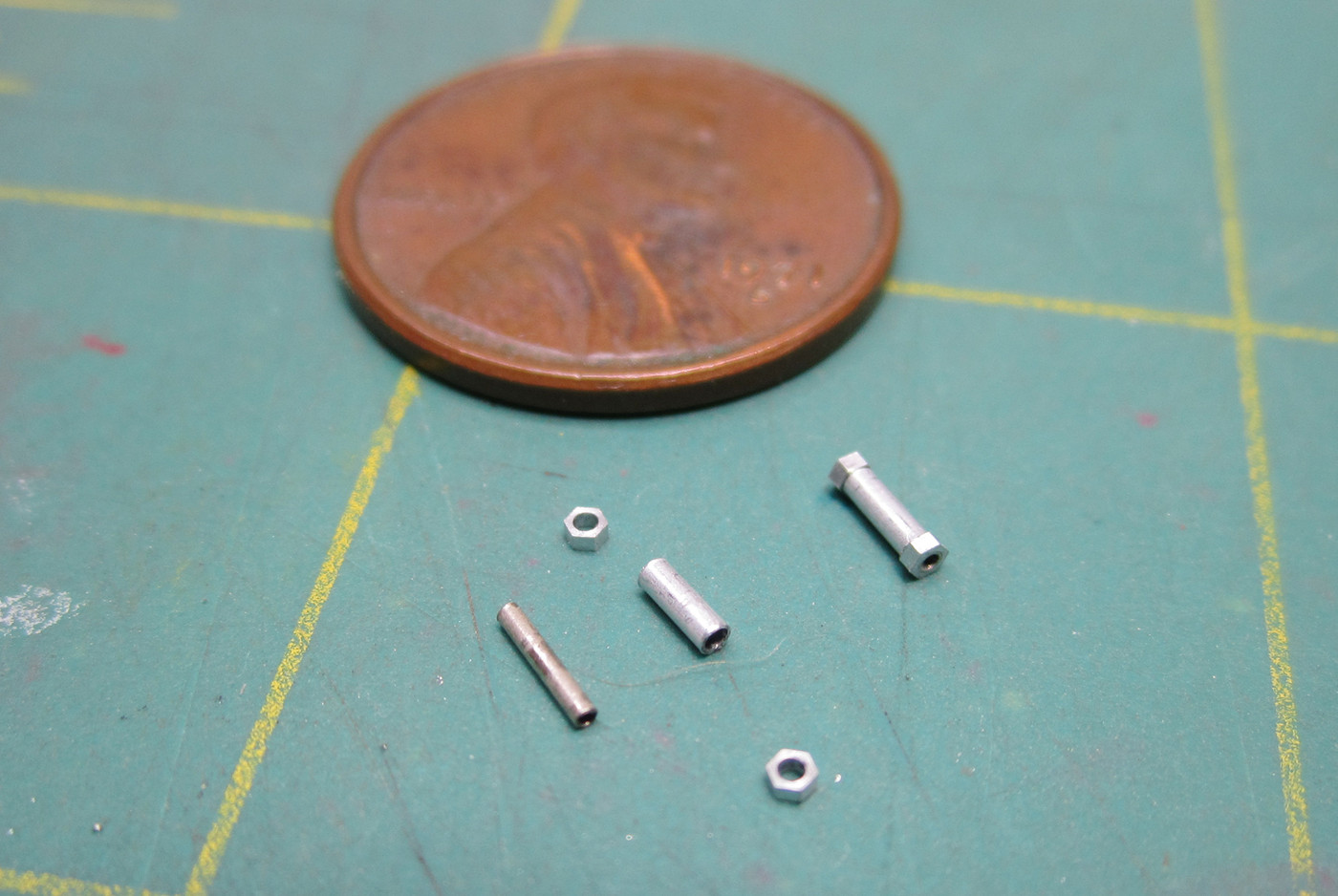

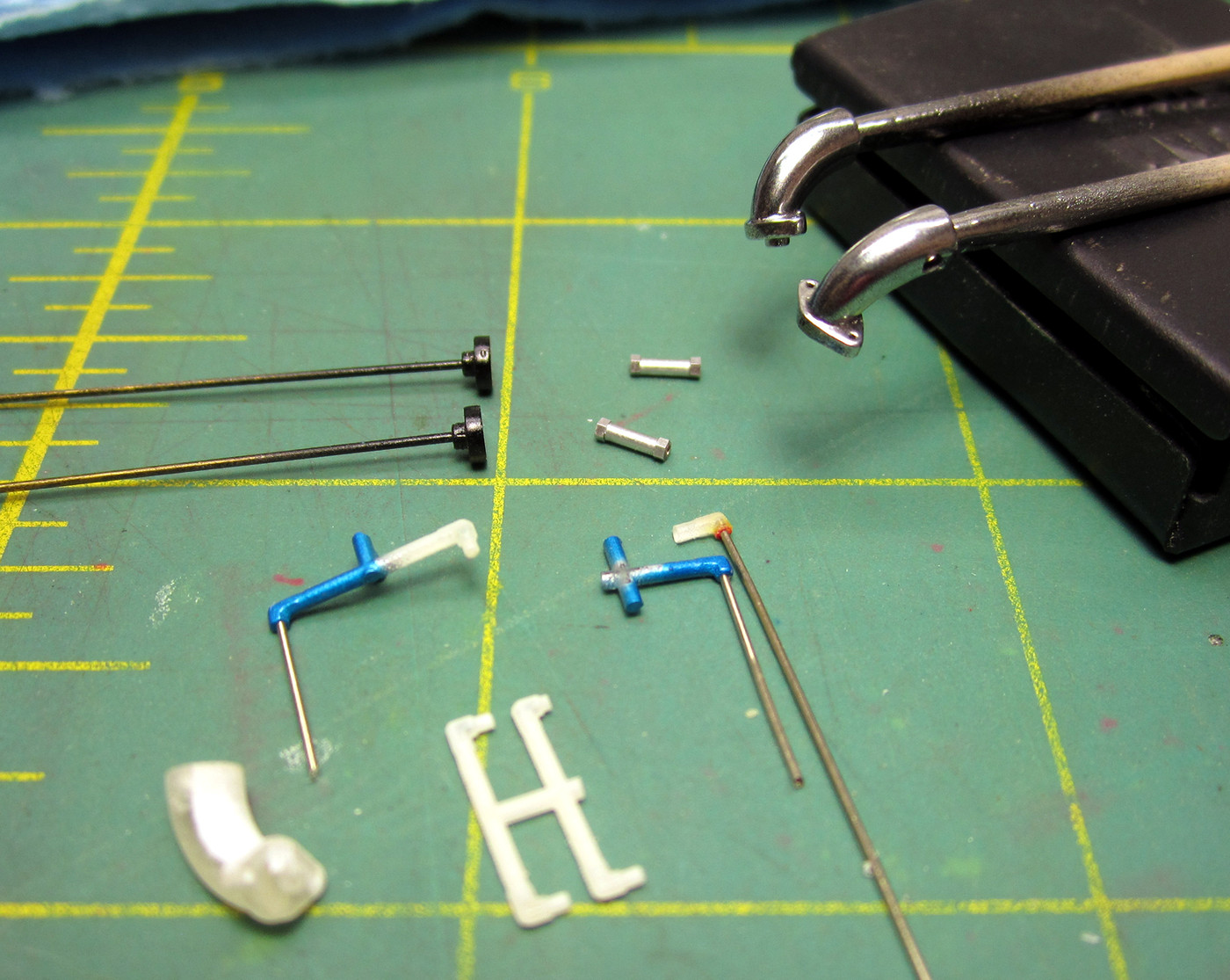

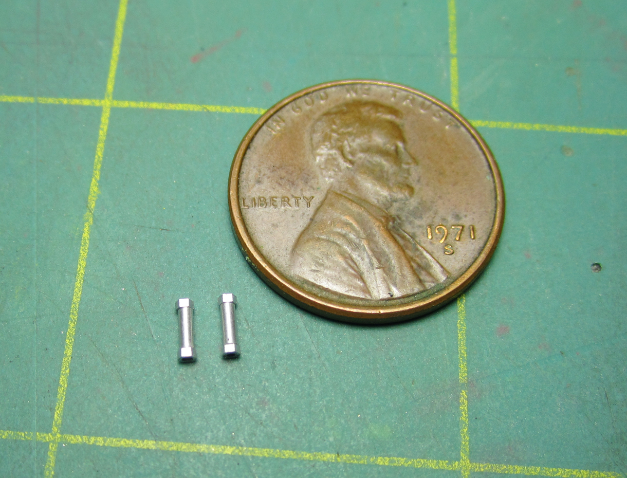

Mooneyzs Posted September 16, 2017 Author Posted September 16, 2017 Hello Fellas... Well I got a little bit of bench time in today. Was happy that I was able to check off another item from my to do list. Wish I could continue working on this but I have to get ready to go over to a friends for a BBQ to watch the Canelo vs GGG fight tonight. I was able to work on the Water Jacks and get them pretty much completed other than one item left for them. I just need to fabricate the line that goes from the Water Jacks down to the header. Anyway I have a few pics I took with my cell phone so they aren't the greatest but wanted to show some progress and that I have been at the bench. I had started by making the check valves that go on the exist side of the water jacks. I used some RB motion nuts and some Abilon Alloys tubing. These pieces were made from 4 pieces as shown and since I was having trouble gluing them together I actually staked the inside tubing basically by flaring the tubing to lock it in place: Here both check valves are completed: I had modeled the Water jacks and Cap a while back and had them 3D printed from Shapeways. Then recently when I had drawn up the Hampton Blower for another project I decided to draw up some fittings that attach to the water jack just to see if they would print because they are so small (.035" thick x .055" wide x .065" long) and to my amazement they actually printed, i think I pushed the envelope on these. I had gotten the water jacks painted with Alclad a while back and the Cap to the Water Jack painted a black:

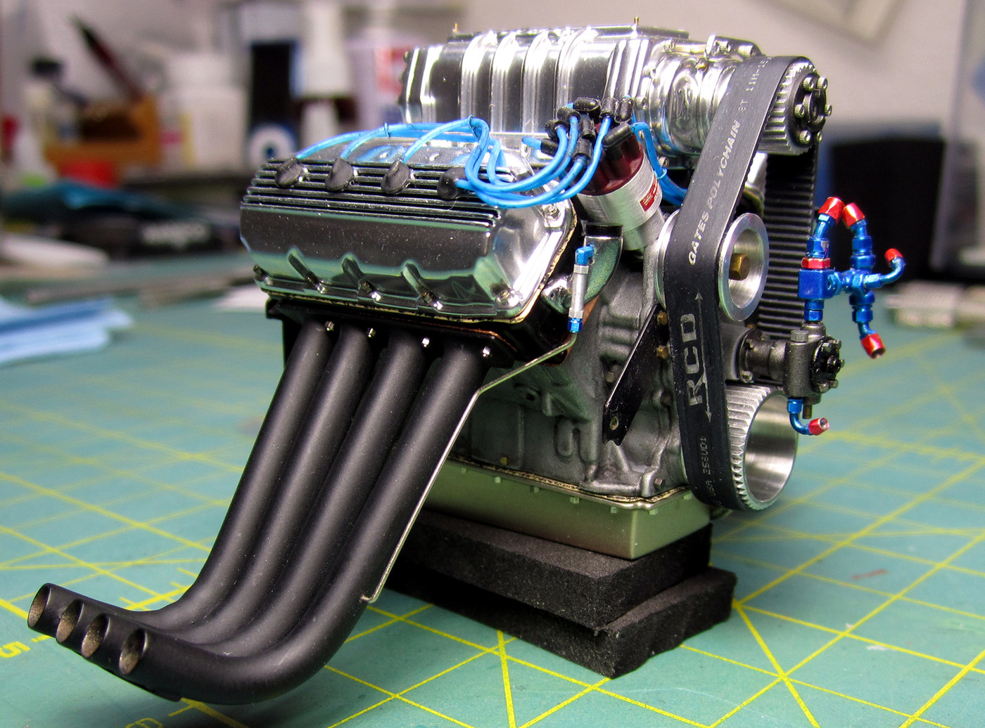

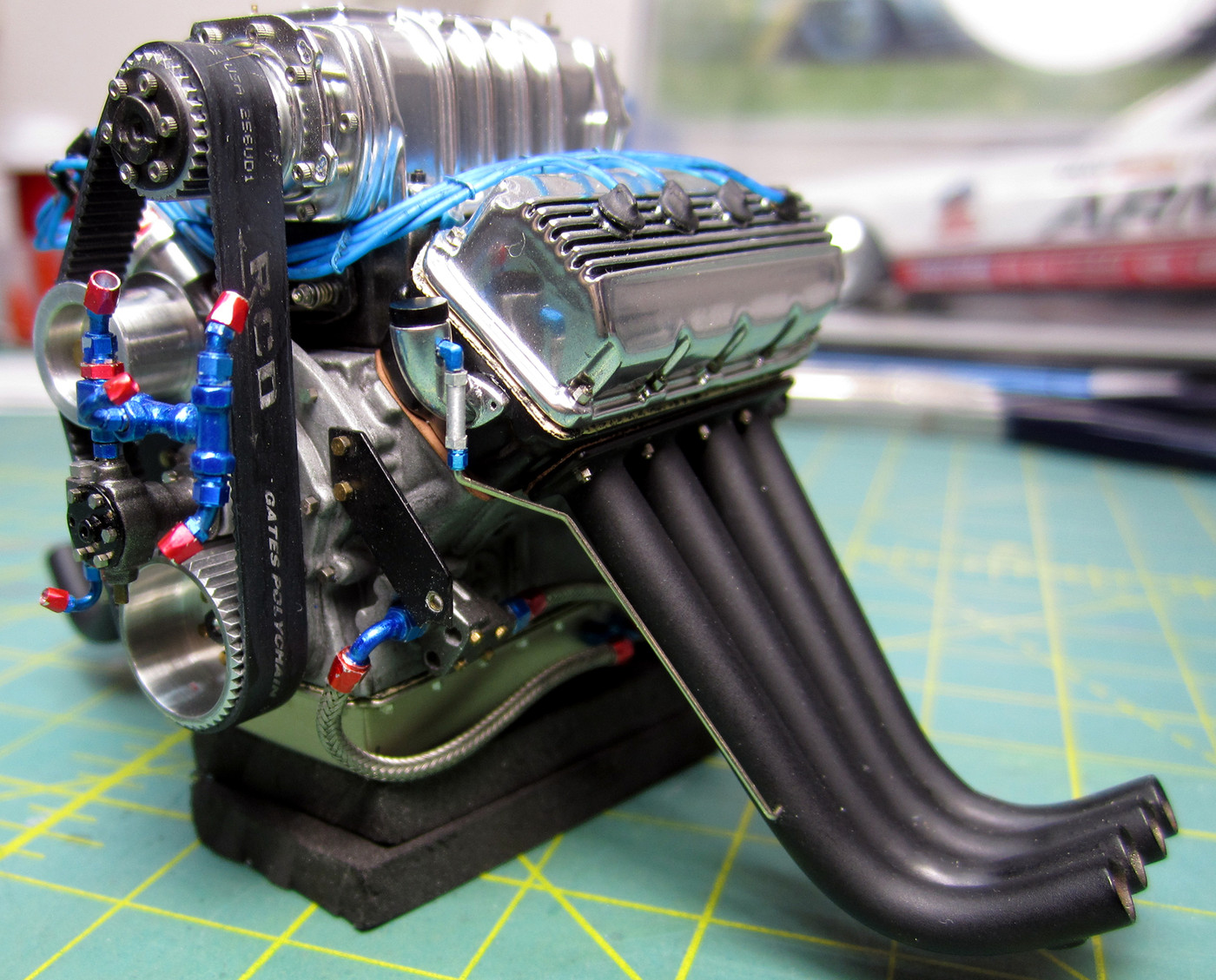

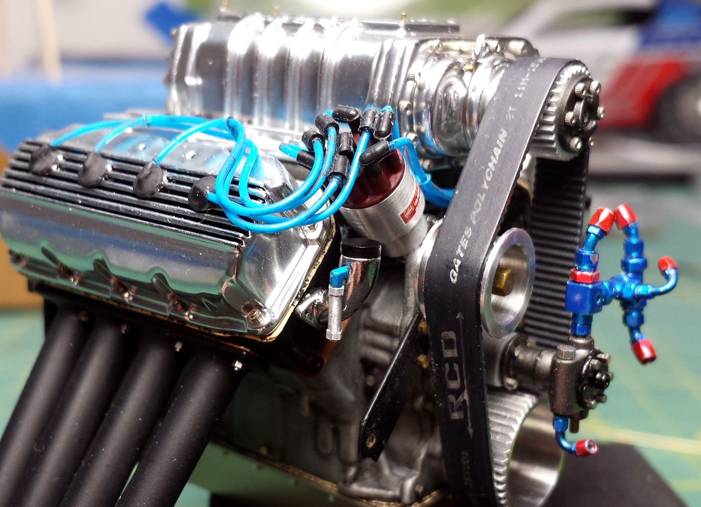

Mooneyzs Posted September 16, 2017 Author Posted September 16, 2017 I got them assembled and glued onto the engine: Front View: Right Side:
gascansam Posted September 17, 2017 Posted September 17, 2017 ...holy smokes, that's a beautiful engine!.......
Daddyfink Posted September 17, 2017 Posted September 17, 2017 Wow, that is some insane detail! And as an aside, this is a perfect case study on how to wire up and engine, nice and clean and proper. No more angry spider plug wires!!
Mooneyzs Posted September 18, 2017 Author Posted September 18, 2017 Christopher... Thank you very much. Jesse.... Thanks man I really appreciate the kind words, I have been trying my best on this one but I can tell you this much it sure has tested me and my patience at times

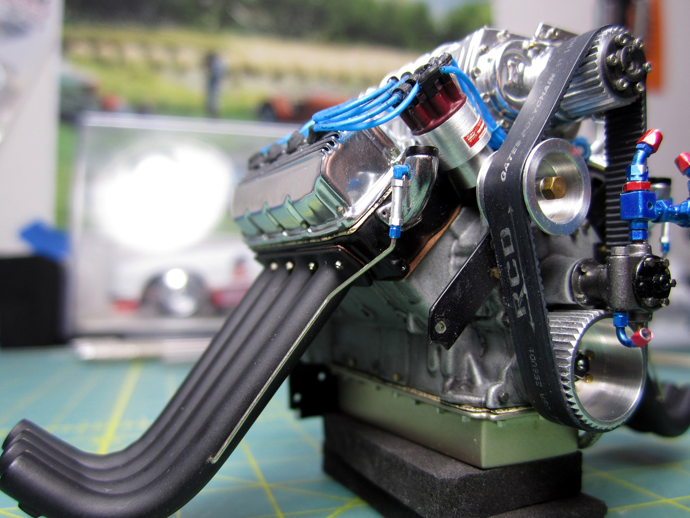

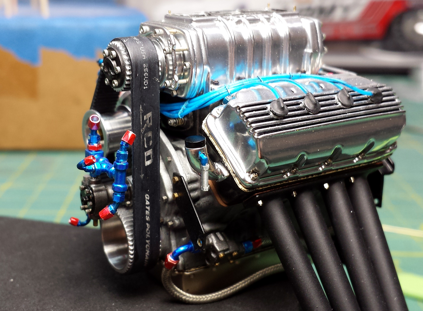

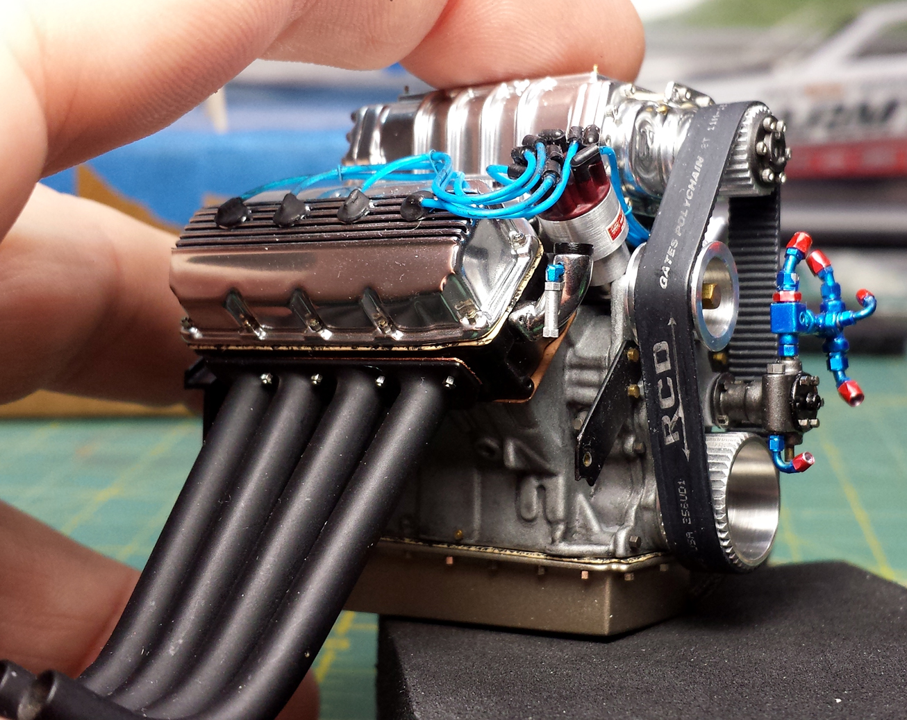

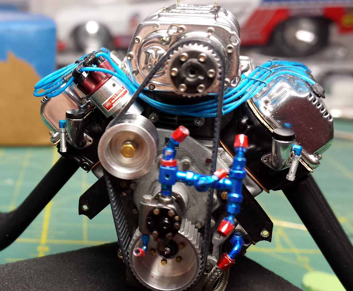

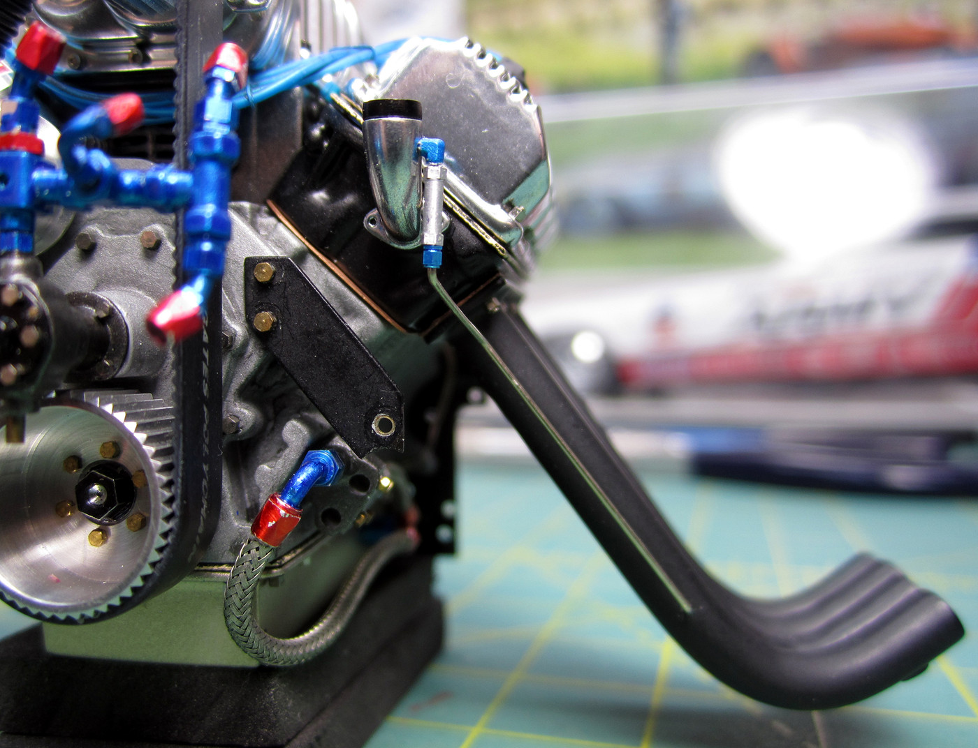

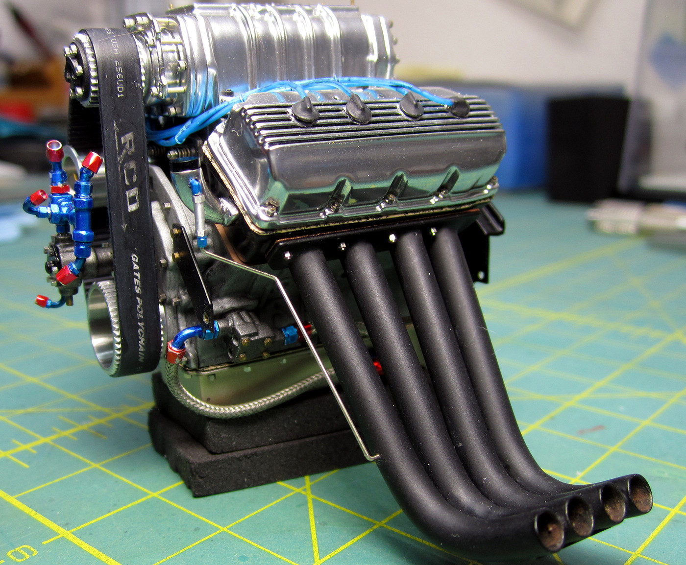

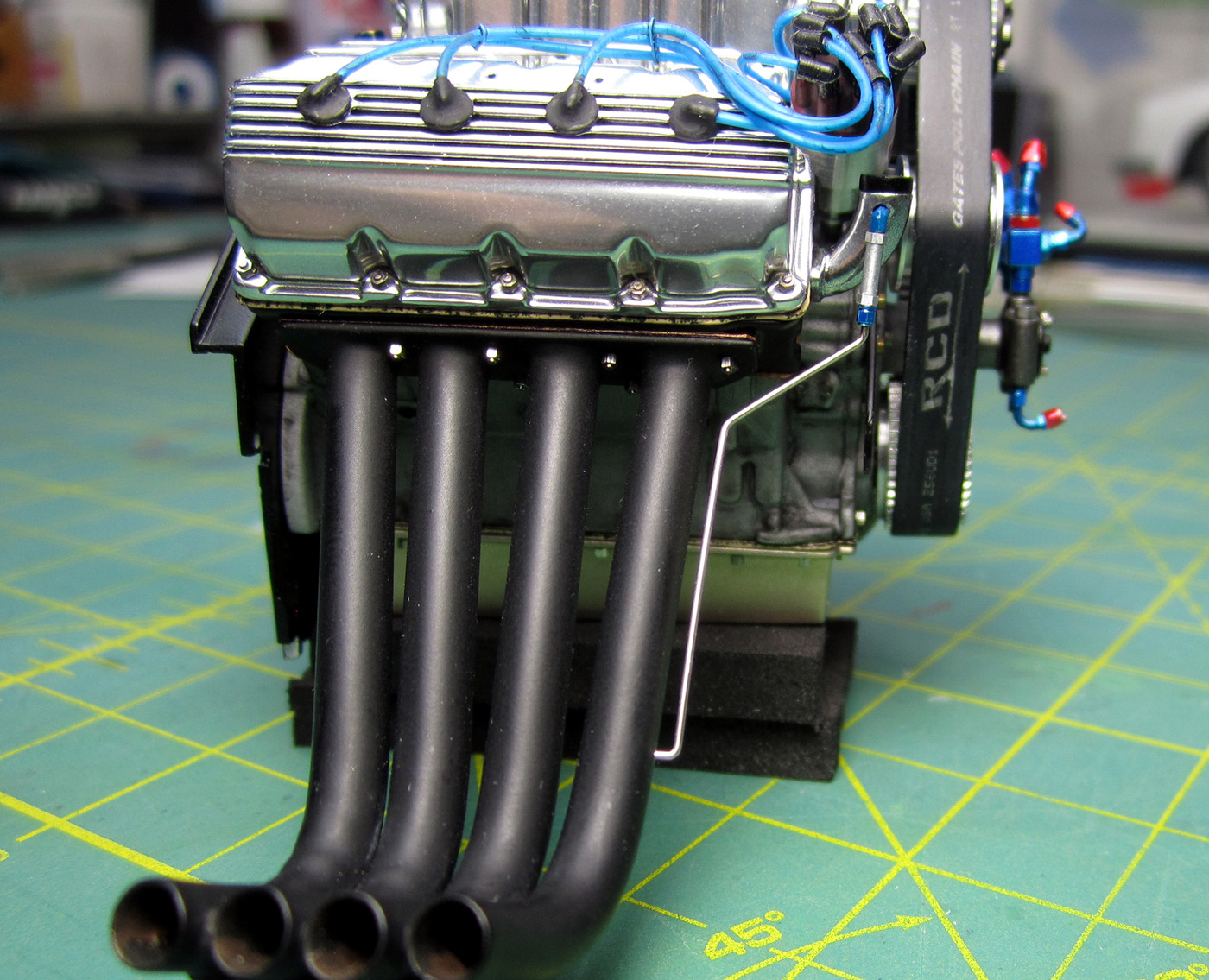

Mooneyzs Posted September 18, 2017 Author Posted September 18, 2017 Alright Fellas.... I was able to squeeze in a little more bench time this afternoon. What I thought wasn't going to take me very long ended up taking me a little longer than I thought. I know it always happens like that but then again I am at a point in this build where I am trying my best not to screw anything up as I go. So I was able to get the Water Jack lines fabricated and installed onto the engine. One more thing to Check off the ole to do list. I was pretty happy with myself I think I only had to redo the lines a total of 3 times, a much better success rate than I thought I was going to have.. . I figured I was going to end up with a pile of bent wire. HEre are a few pics of the competed pieces: Here is the Water Jack lines along with the fitting installed onto the left side of the engine, I still need to add the bold to the water jack itself: Here is a side view of the Left side: Here is the line fabricated for the Right Side: Here is a side view of the right hand side: Here is a some what of an up-close straight on shots of the Water Jacks, Check Valve, Fittings and hard line:

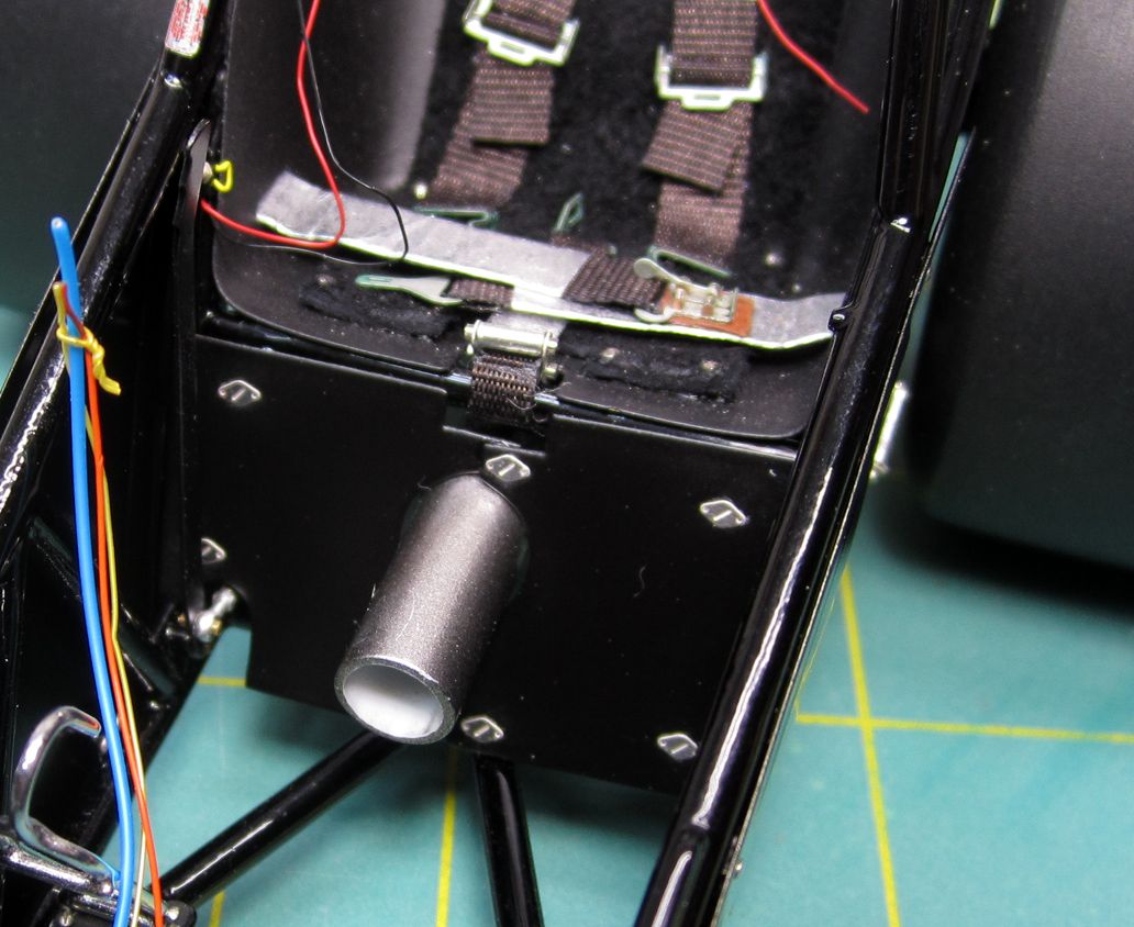

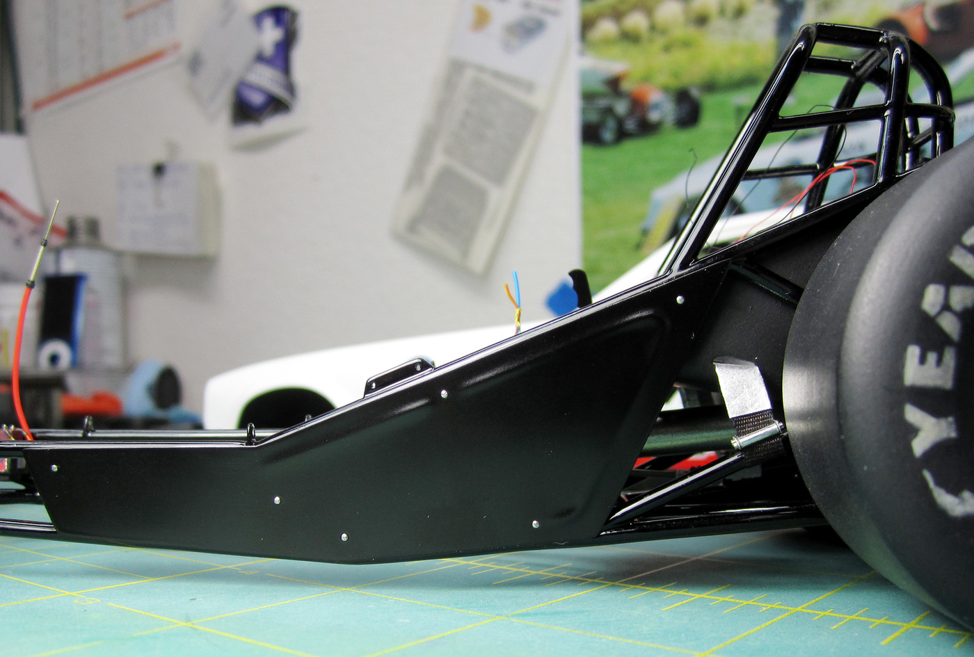

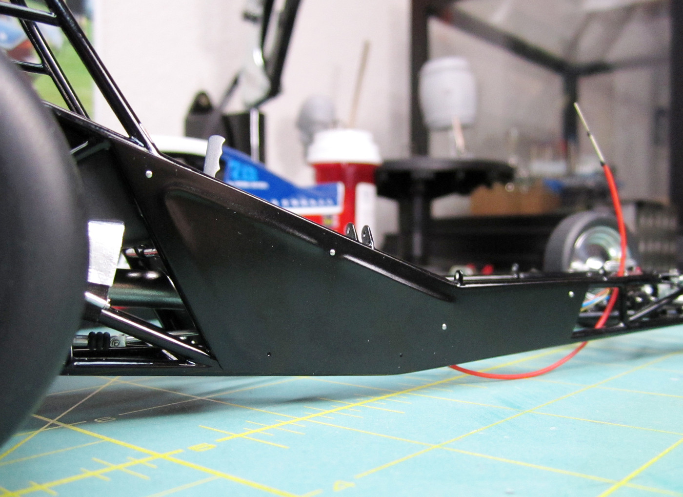

Mooneyzs Posted September 23, 2017 Author Posted September 23, 2017 Well Fellas... I was hoping to have this update posted a little sooner but I had to finish up stuff for work this morning and it took much longer than expected. So needless to say I rushed on these pics since my camera battery was dying and they didn't turn out great. I will have to retake these but I wanted to show a little bit of the progress I have made this past week. I was able to install my under seat panels as well as the chassis side tins to the chassis. Here are a few bad pics..... Left side Chassis Tin: Right Side Chassis Tin: Under seat panels:
