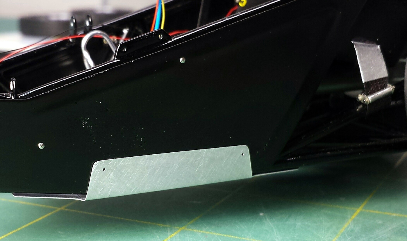

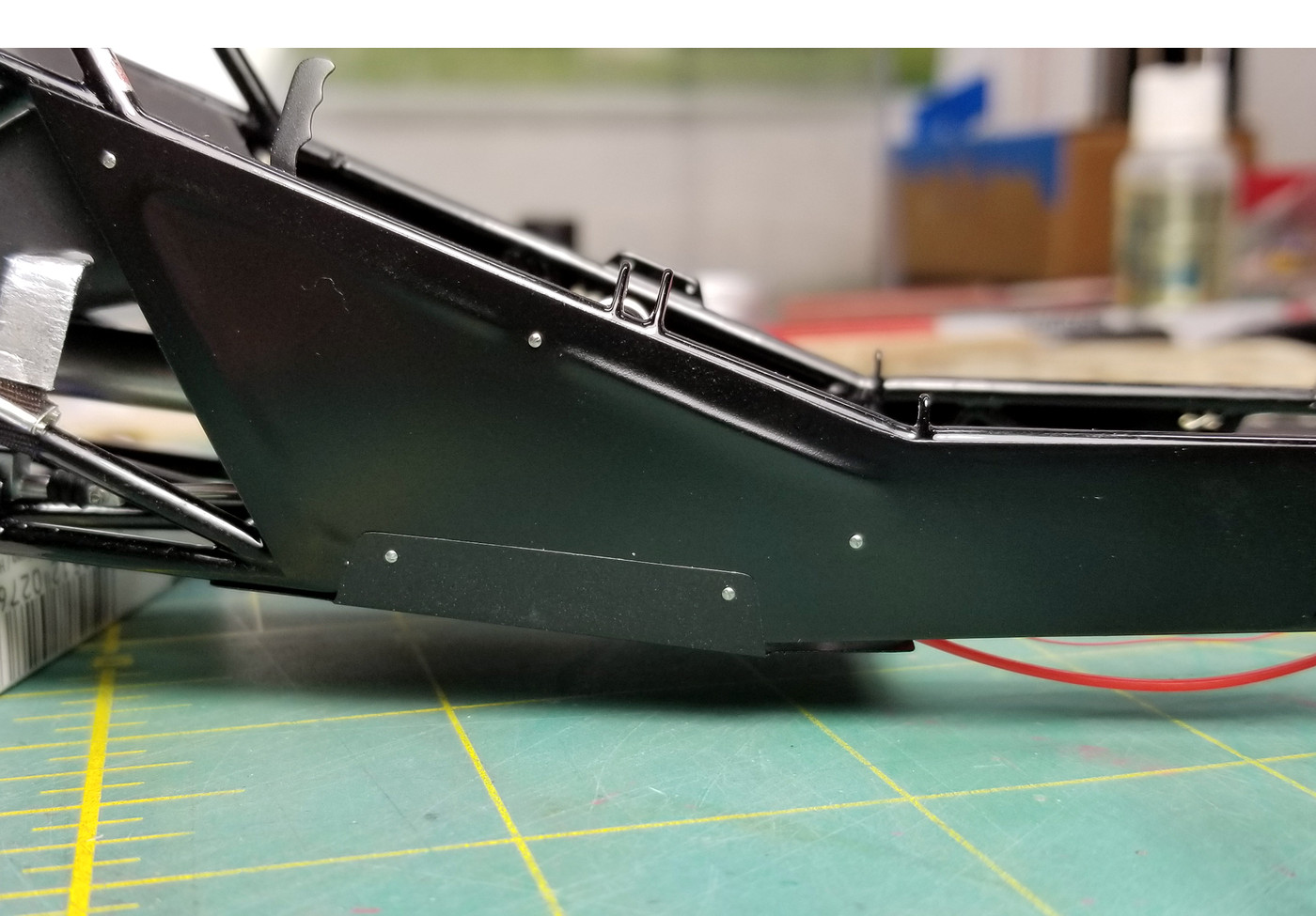

Brad... Thanks Brother!! Felt good to check those off the list. But it seems every time that I start to make some good steps forward there is always something that ends up pushing me back. I started to install the chassis floor tin yesterday and well it didn't go very well and did not fit like it did before, actually wasn't going to work at all. So needless to say I had to re-fabricate a new one. Guess this is the story of my life on this build. I am so ready to be done with it. I will try to get some pics up in a bit.

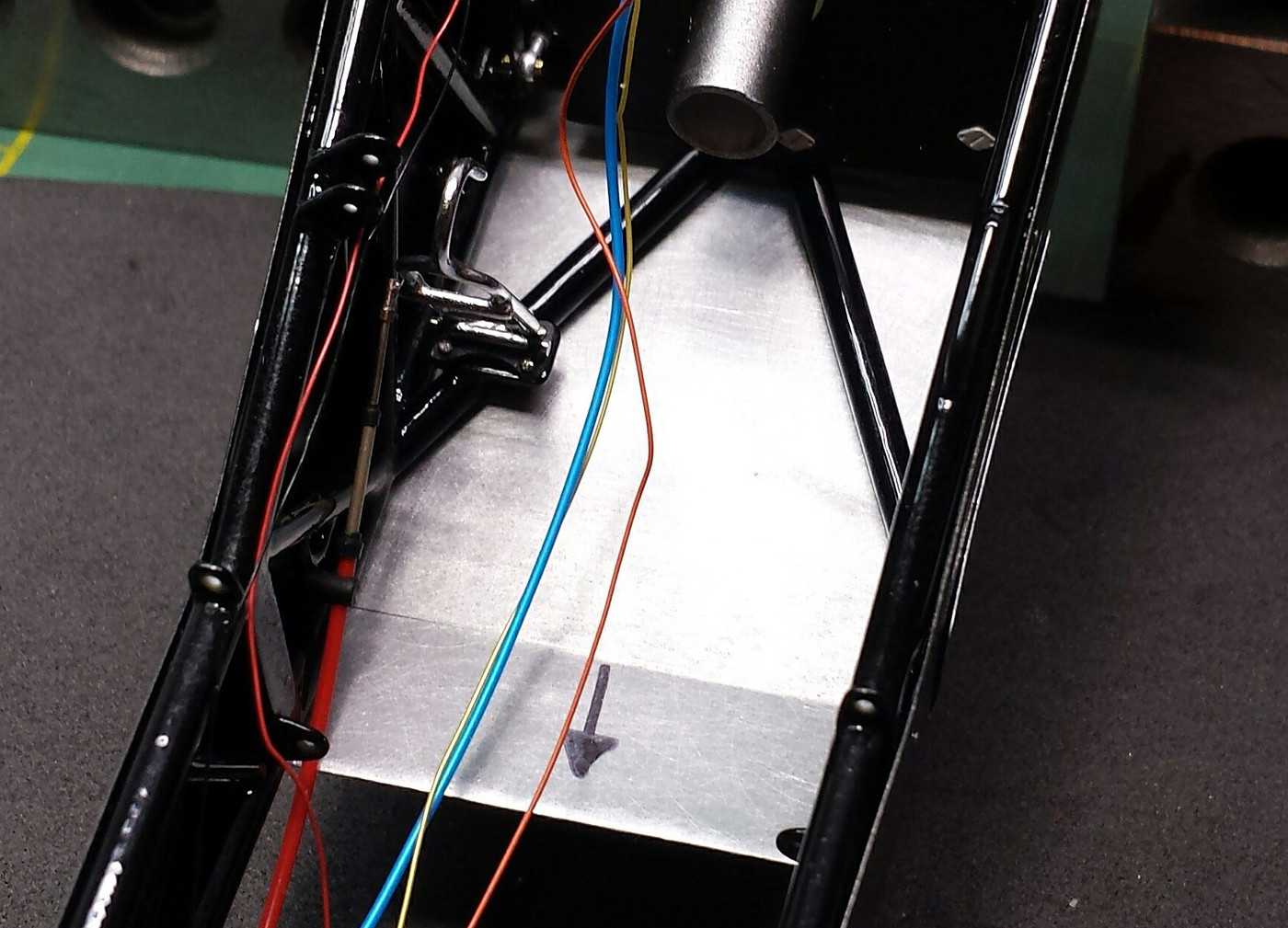

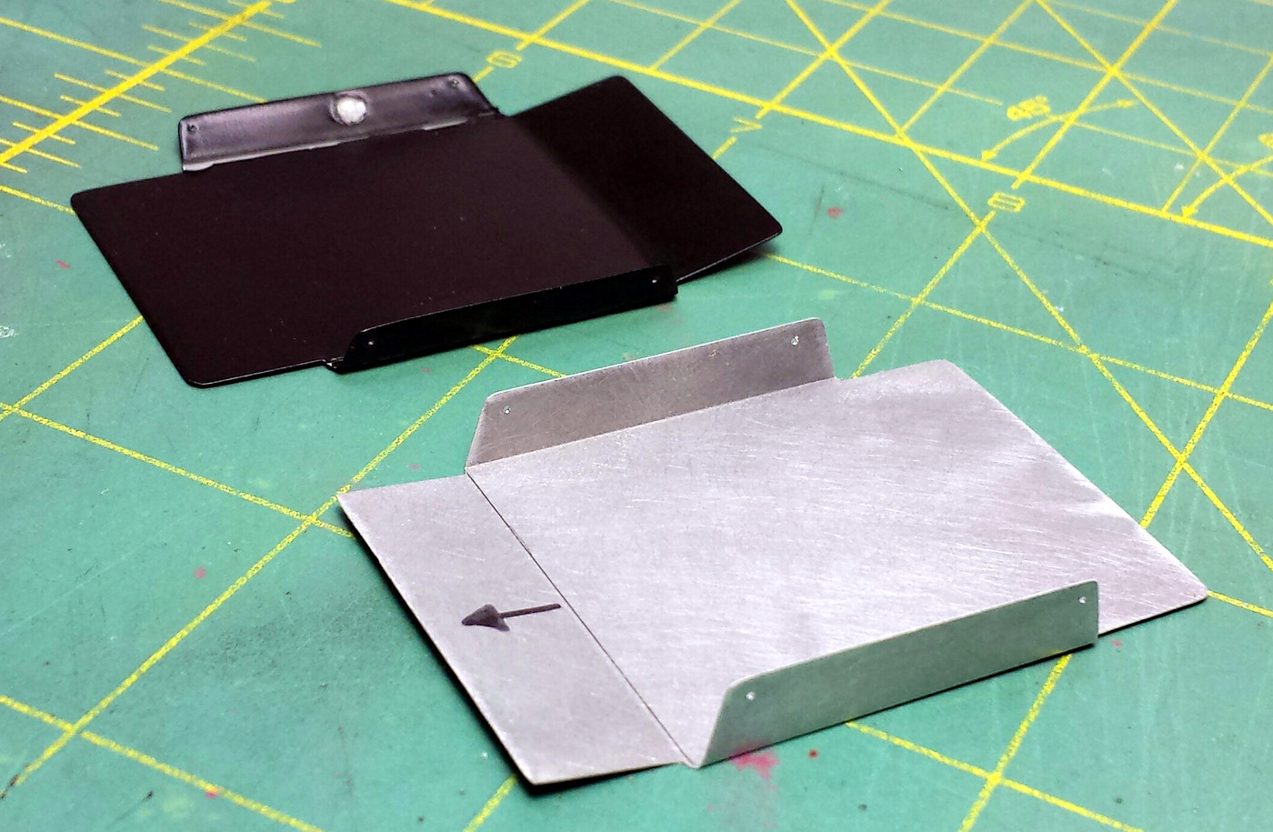

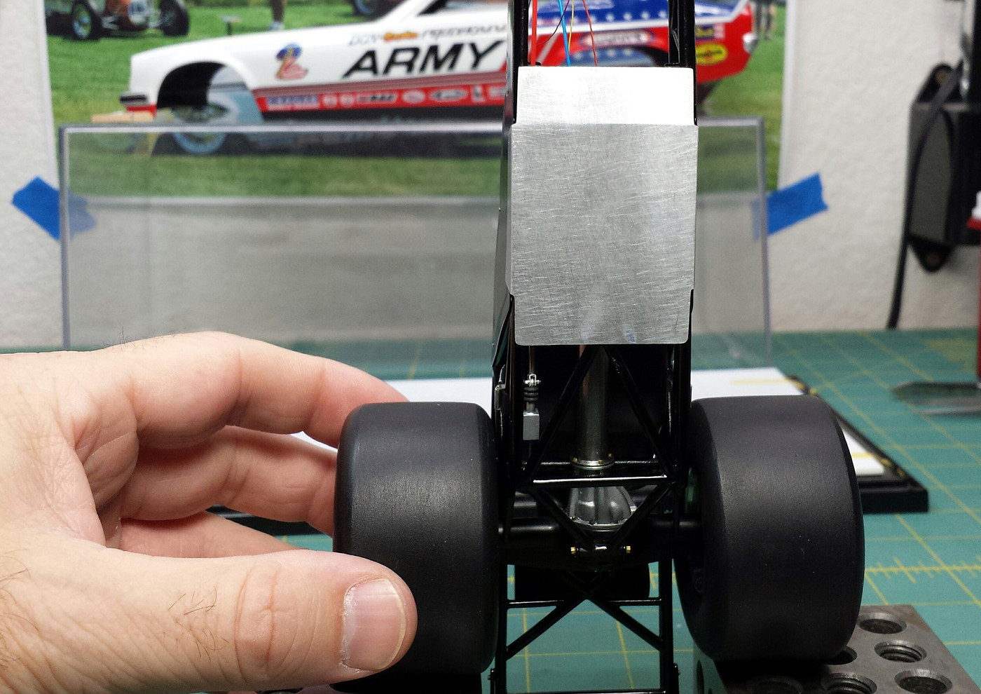

Brad.... As promised here are a few pics of the new Chassis Floor Tin....
Here is the remade floor tin, It still needs to be painted but the painful task of remaking it is done. But the good news is that It fits much better than the original one did and am much happier about that. Also Thanks goes out to Brad because he was the one that gave me a sheet of this printing plate which I still have plenty of stock to make more parts from and its really easy to work with. Here is the old piece next to the new one:
placed on the chassis for a fit check:
Bottom View:
Right Side:
Left Side:
Link to comment
Brad... Thanks brother. This one fits much better and will fit just fine once painted.
Bob....Thank you. It's getting much closer. I have a final list of things to do that I am trying to check things off and well this small hiccup has pushed me back a little. This floor pan needs to be painted and glued in place before I can proceed.
Dave... Thank you!!
Paul... Thanks brother! The printing plate is about .006" to .007" thick.

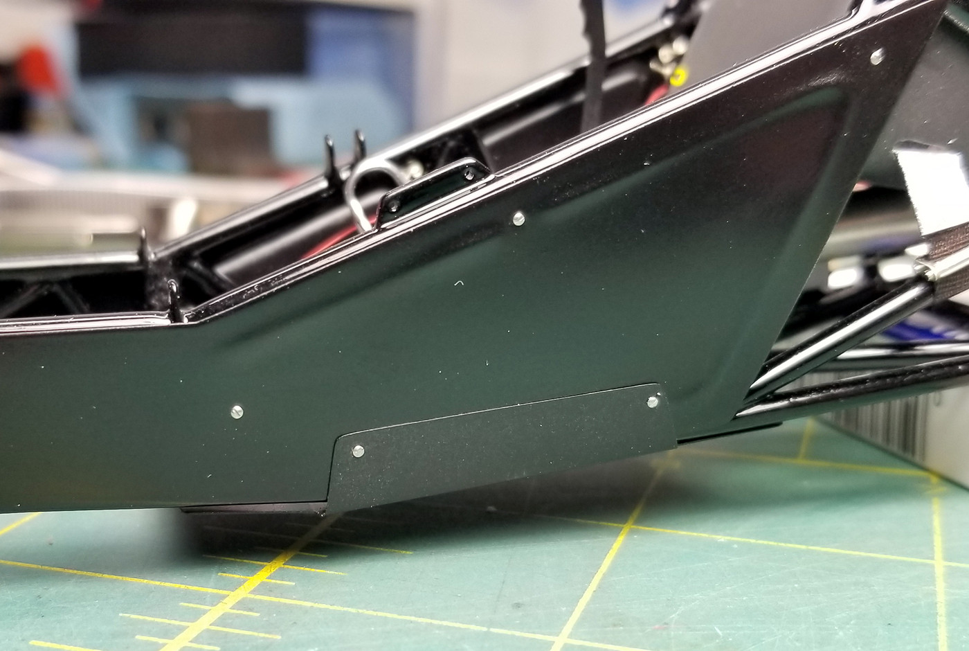

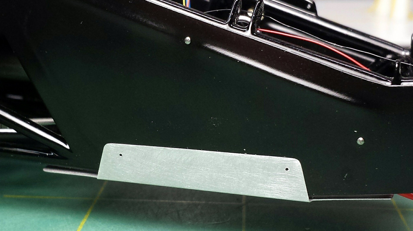

Tim.... Thanks Brother. Glad to her the side tins have put a smile on your face. I need to get some better pics so you can see the details and the dzus fasteners. I will get some better pics up soon.

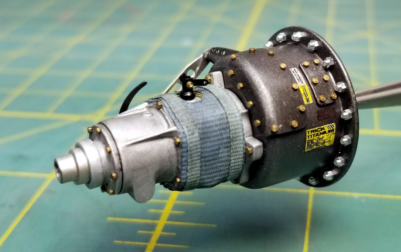

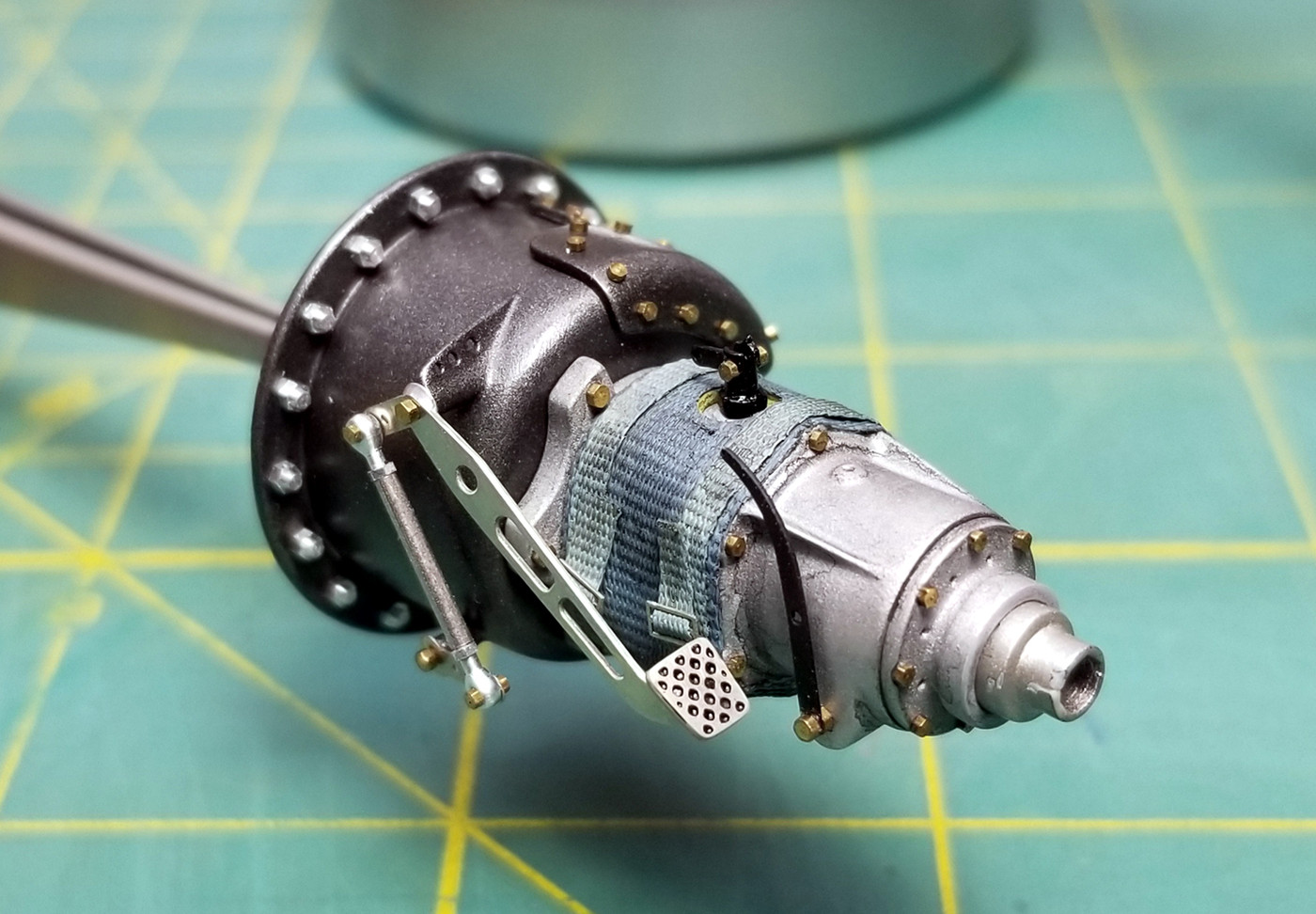

Then I did a little more work to the transmission, adding all of the bolts to the bell housing flange. I used RB motion hardware for these:

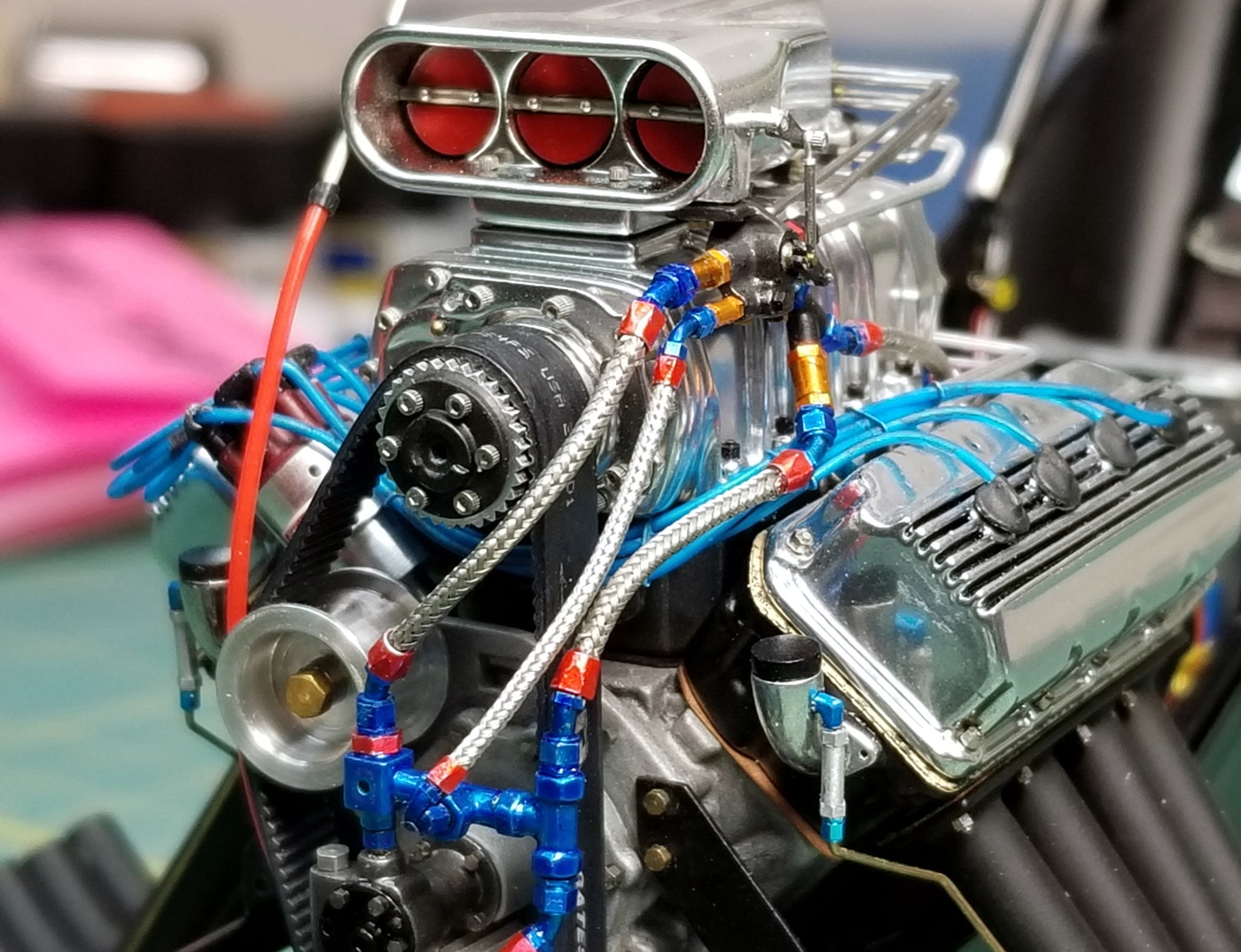

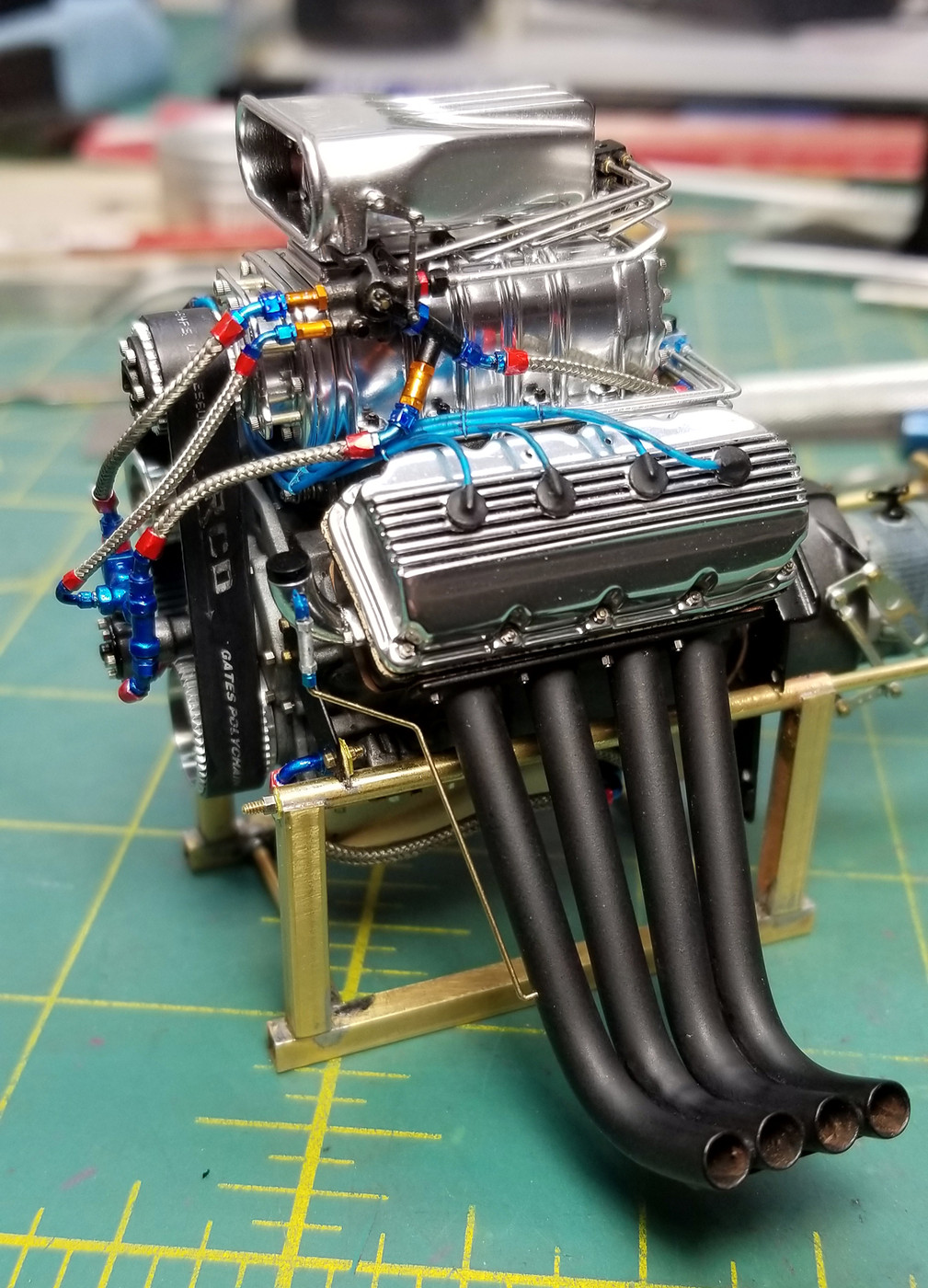

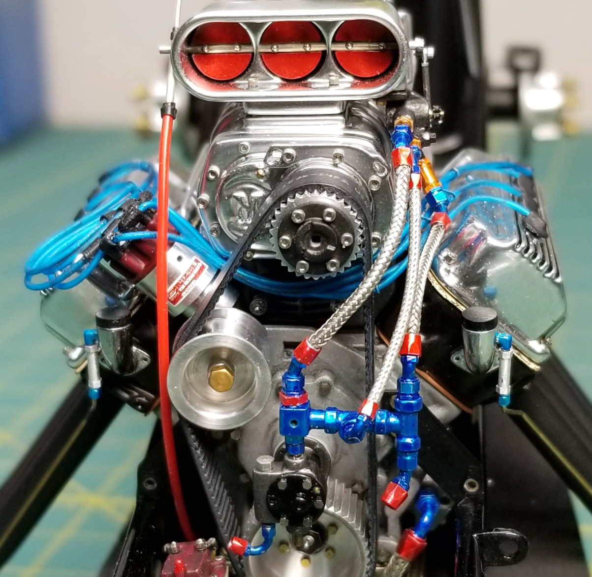

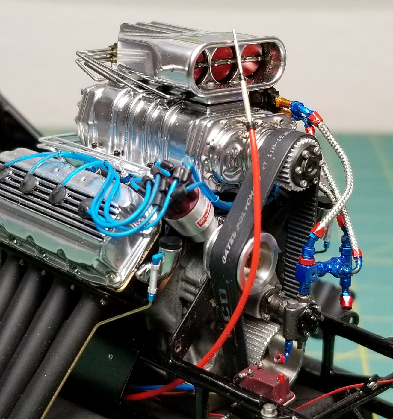

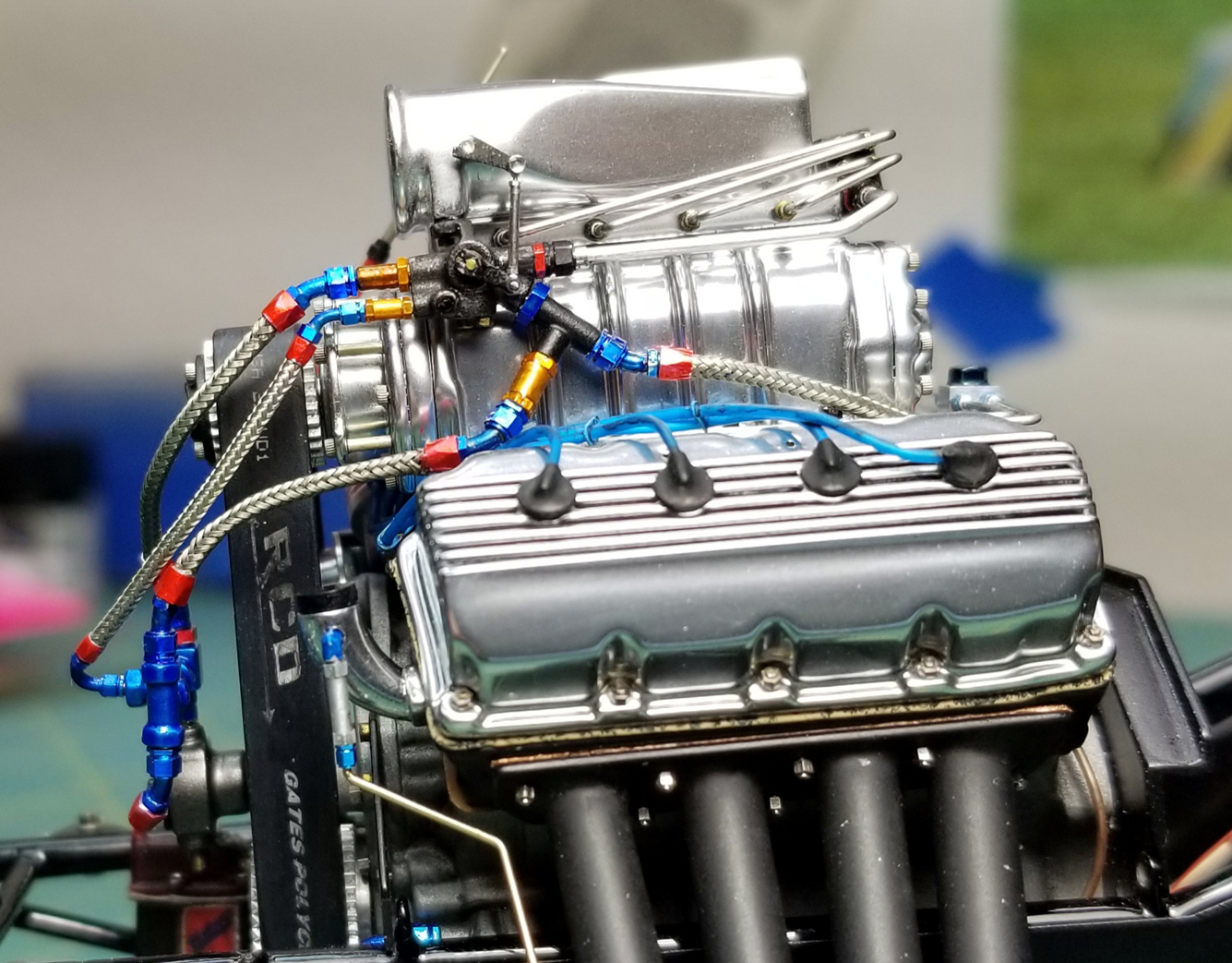

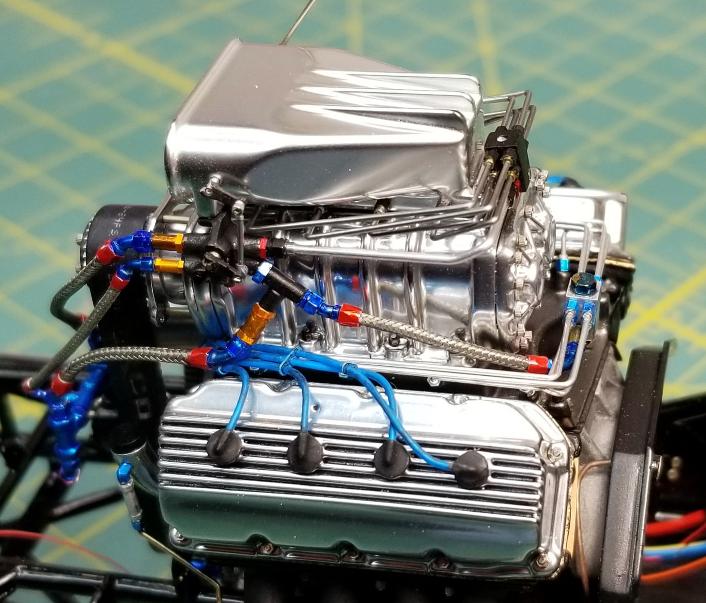

Up next was installing some of the braided lines and gluing in the fittings and let me tell you these suckers tested my patience for sure. All A/N Fittings are RB Motion Fittings and the Braided line is Pro-Tech which is the best in the business in my opinion:

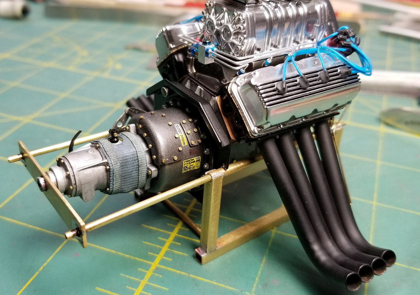

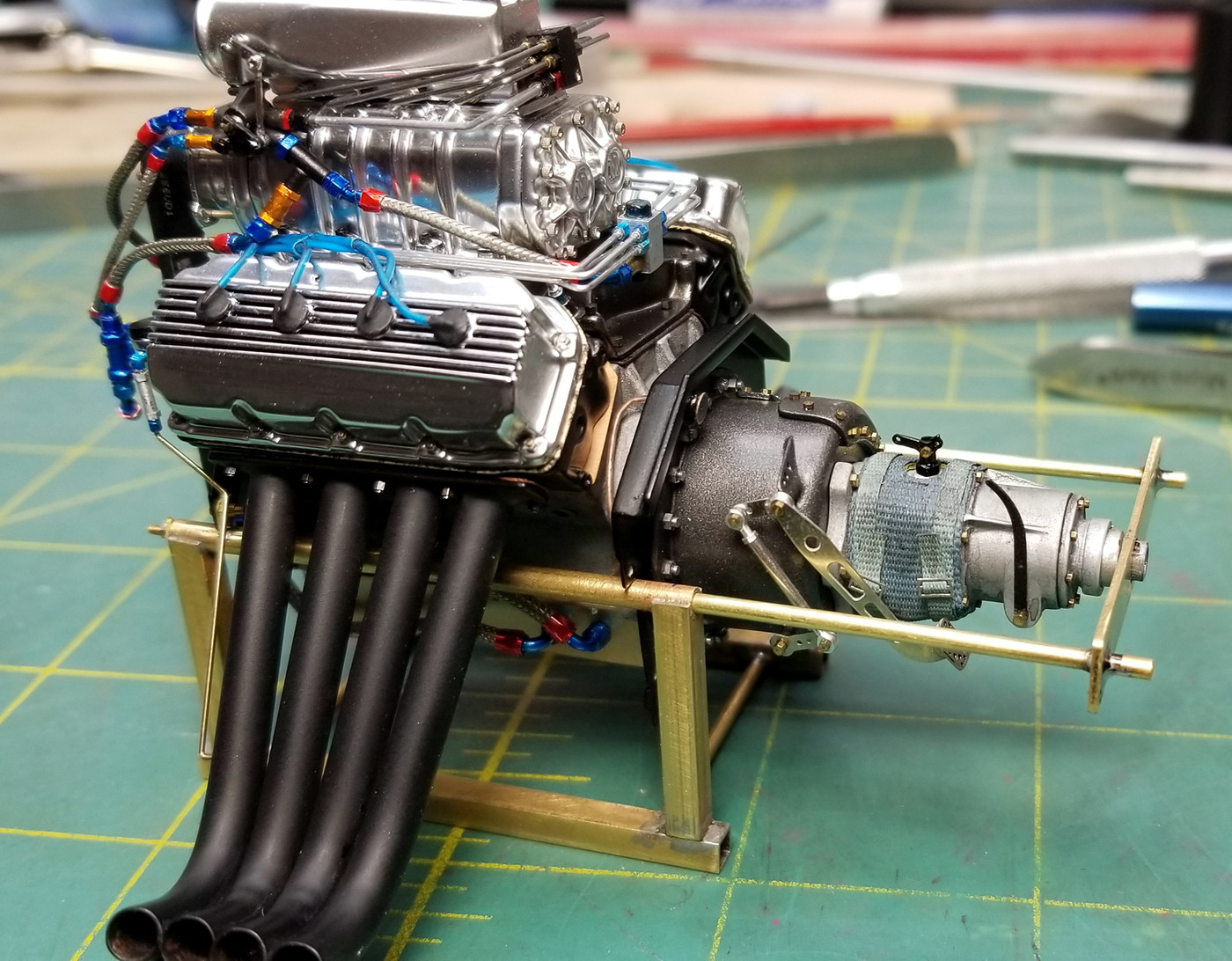

The next thing I decided to tackle was getting the transmission glued to the engine mid-Plate. But I decided to design a jig up first which would hold the engine and transmission together while the Epoxy was drying. I wanted to be sure that it wouldn't move and fully cure overnight. I decided to make the jig out of brass and soldered it all up. Then my choice of epoxy was 30 min epoxy which would allow me more working time to get things into place the way I needed to before it started to set up:
2v2udiaRGxAhe9C.jpg\
So as I mentioned It felt good to get all of these things accomplished and check off the list. Some of these were little milestones for me. But with the Good comes the Bad. After I had got the epoxy applied to the transmission and got it mated up to the block. I tightened the bolts on the jig which would pull the transmission towards the engine block to keep constant pressure applied while the glue dried. I was checking on the epoxy on my mixing sheet to see if it was setting up and well I decided to pick up the jig to make sure that there was no epoxy that was pushing out and noticed a few spots where I had to wipe some off and well just my luck I drop the engine from a good 6" to 8" on to my workbench. Not sure how it slipped out of my hands but it did and needless to say there are some things that I need to be fixed. I am starting to feel like I can't win with the build. The only thing I can do is go back and fix these things one by one...... Not sure when I will have another update now....
