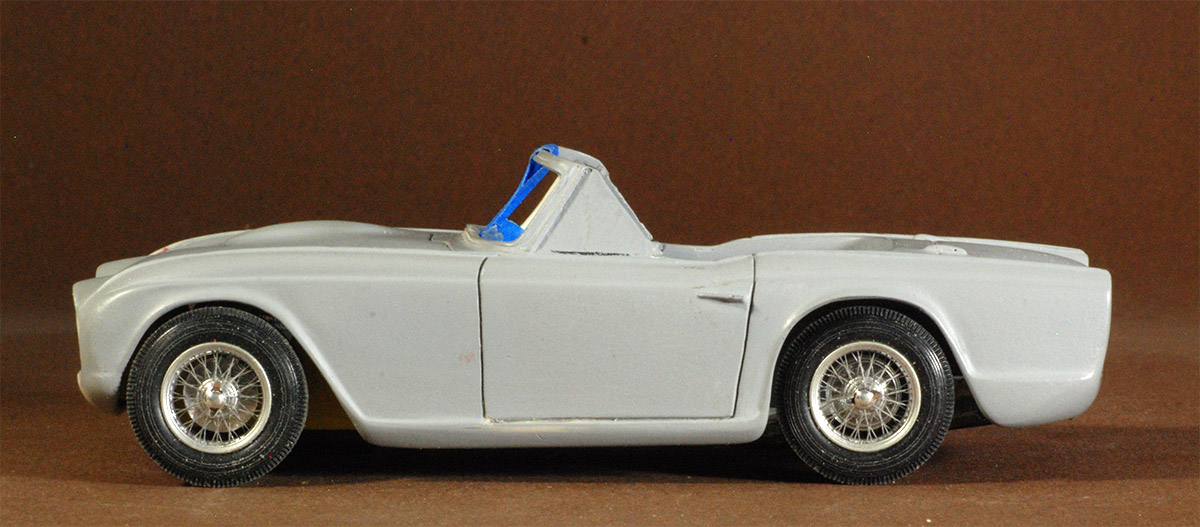

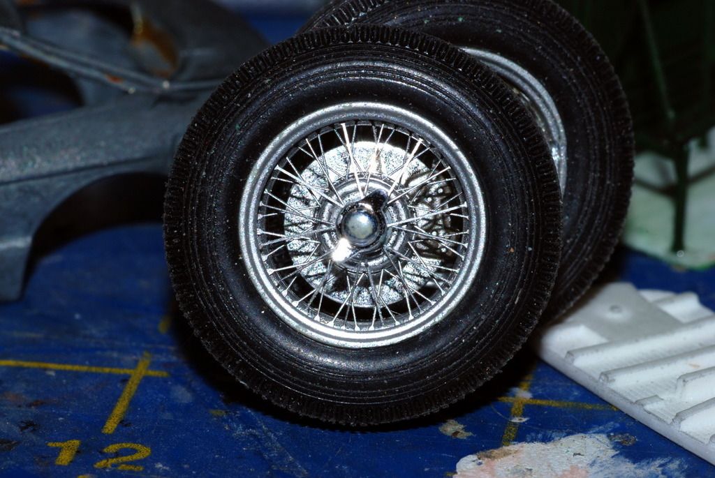

Belugawrx Posted March 18, 2016 Share Posted March 18, 2016 Huge difference in wheels ! Love the P/E wires Quote Link to comment Share on other sites More sharing options...

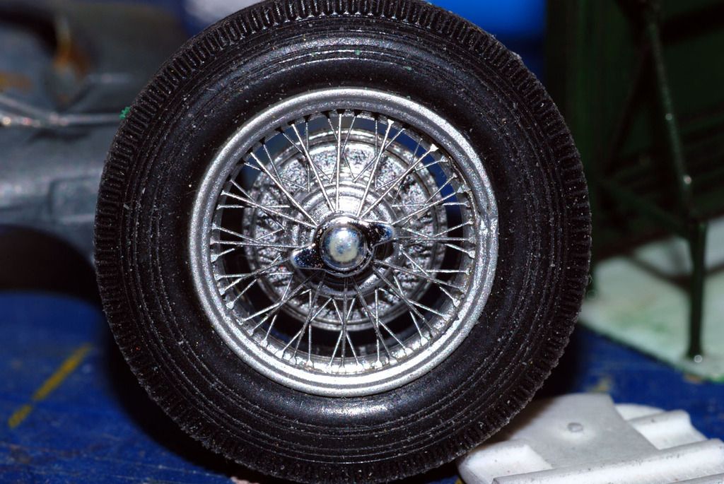

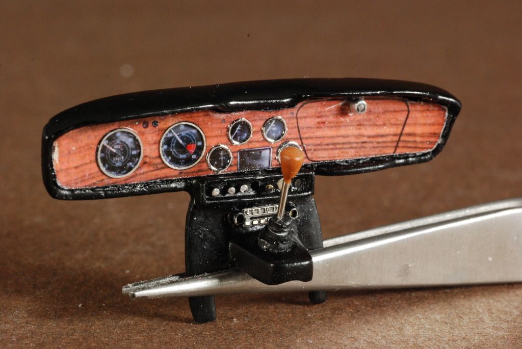

Foxer Posted June 10, 2016 Author Share Posted June 10, 2016 (edited) I've been working on mounting the PE wire wheels and had to make a metal axle for them as the Air-Trax kit came with resin axle shafts. Glue is drying on that fitment but in the meantime I finished the dash with some pe rings for the dash and speedo and some stick-on metal rings on the small ones. I wish I could get larger rings as these went on easy and look great! Edited July 5, 2017 by Foxer Quote Link to comment Share on other sites More sharing options...
Randy D Posted June 10, 2016 Share Posted June 10, 2016 Always good to see your progress on this one Mike. Brings back memories of 40 years ago and a red GT 6 plus. Randy Quote Link to comment Share on other sites More sharing options...
Brizio Posted June 11, 2016 Share Posted June 11, 2016 Dashboard looks great! Quote Link to comment Share on other sites More sharing options...
Dann Tier Posted June 12, 2016 Share Posted June 12, 2016 I've been working on mounting the PE wire wheels and had to make a metal axle for them as the Air-Trax kit came with resin axle shafts. Glue is drying on that fitment but in the meantime I finished the dash with some pe rings for the dash and speedo and some stick-on metal rings on the small ones. I wish I could get larger rings as these went on easy and look great! WoW! -you made that dash look 100% better!! Quote Link to comment Share on other sites More sharing options...
Foxer Posted June 12, 2016 Author Share Posted June 12, 2016 (edited) Tidying up this point as things start crying out for paint and assembly! This is everything laid out ... not that many parts, though I think I made (or borrowed) more than came in the kit. The underside of the chassis is being ready to accept the wheels and copper axles in a fixed position. The plastic TR3 chassis fits into the resin body with no movement .. almost a snap-tight fit! )) The resin axle shafts were replaced with 12 and 14 gage copper house wires that fit perfectly into the PE wire wheels. The exhaust pipe will be replaced with an aluminum one that will show the open pipe sticking out the back. Edited April 4, 2018 by Foxer Quote Link to comment Share on other sites More sharing options...

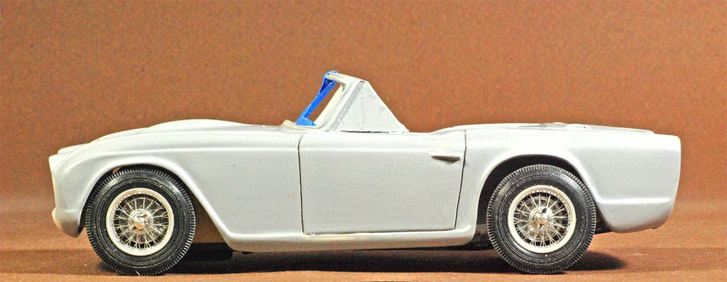

Foxer Posted June 23, 2016 Author Share Posted June 23, 2016 (edited) I've been spending my time getting the axles fixed in place so the wheels are centered and will just slop through a hole in final assembly. You can see a bove photos that axles are just metal rods through the chassis but they are near the top edge at the rear and I'll run out of adjustment getting the wheels up tight to the top of the wheel wells. The fronts are done. Here's some lightened pics from the side. You can see how I have to move the rear wheels and get the rear body down. Those PE wire wheels sure look good though! Edited April 4, 2018 by Foxer Quote Link to comment Share on other sites More sharing options...

Twokidsnosleep Posted June 25, 2016 Share Posted June 25, 2016 Love it, great progress The wire wheels take away the 'toy' appearance and your dash is over the top gorgeous Great stuff Quote Link to comment Share on other sites More sharing options...
Foxer Posted July 8, 2016 Author Share Posted July 8, 2016 (edited) Just a quick, but not so timely, update getting the wheel mounts fixed so the wheels are centered. There was much watching glue dry, styrene and epoxy and it looks done to me. As can be seen in the last photo, I just used some pieces of styrene drilled for the brass rod axles. No suspension or engine in this curbside. I did start fiddling with the front turn signals but the first attempt failed. It did give me a direction to head toward for 2nd attempt. Edited April 4, 2018 by Foxer Quote Link to comment Share on other sites More sharing options...

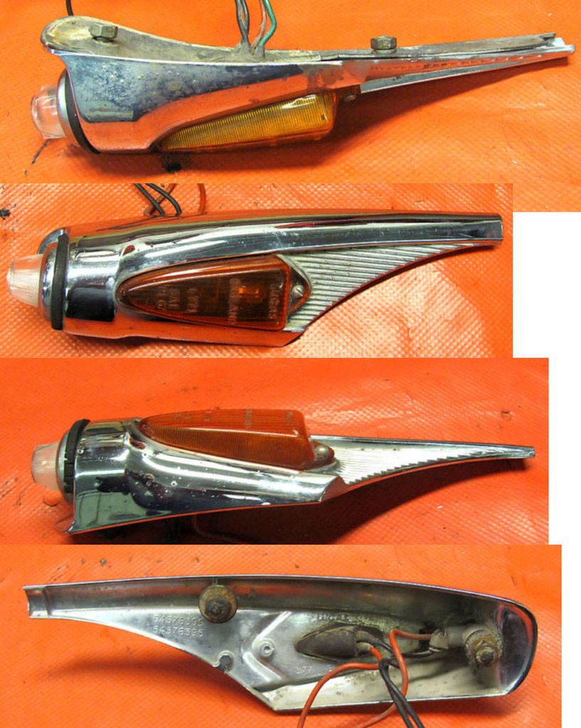

Foxer Posted August 13, 2016 Author Share Posted August 13, 2016 I've been debating with myself for two years about how I was going to make the front turn signal fixtures and I finally have a solution! I had a question up here all that time looking for suggestions and this led me to have some made with a 3D printer. I have a TR5 3D file that I took the signals from and fixed them up in 3D Max. They went to the printer yesterday. Here's the model I took them from ... the signal pod with light lenses .. and this is what went to get printed .. A couple shots of the wire wheels close up. The fronts have disk brakes while the rears are drums. Quote Link to comment Share on other sites More sharing options...

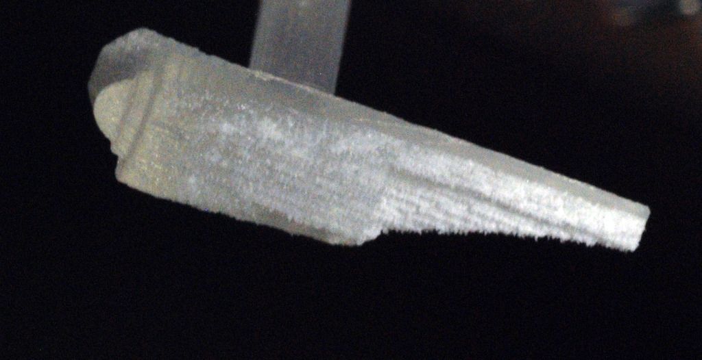

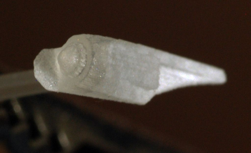

Foxer Posted August 20, 2016 Author Share Posted August 20, 2016 (edited) I got the turn signals back from Shapeways and they look good. Remember, these are 3/8" (.375" or 9.525mm) long! In these closeup photos the striations from the 3D printing can be seen, but not with the naked eye. I have to experiment with these to figure what I have to do to get smooth enough for Alclad. I'm going to put some thin primer on one and maybe some silver paint on the other. They are tough to see in the plain clear material, so hopefully some paint will bring to life. The material is Frosted Extreme Detail. Painter silver .. Edited August 20, 2016 by Foxer Quote Link to comment Share on other sites More sharing options...

Foxer Posted August 21, 2016 Author Share Posted August 21, 2016 Very interesting build. Your research and ambition to do this car right will reward you with a 1 of 1 model to be proud of. Thanks, James. As I read your post I looked at that last photo I posted and I sure looks a mess. But they are all sanded and look smooth. Only used 600 and 1000 grits and very easy. Quote Link to comment Share on other sites More sharing options...

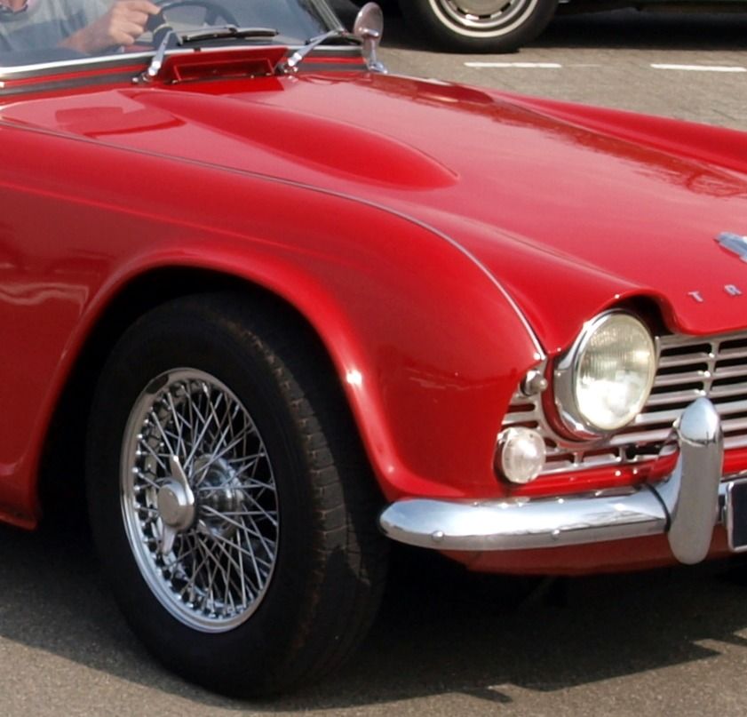

Foxer Posted August 22, 2016 Author Share Posted August 22, 2016 (edited) Here's a test mount of the turn signal pieces. The body crease on the resin body turns down and prevents the signal from sitting flush. The third photo shows how the crease on the model turns down and the fourth shows a TR4 that plainly shows the crease ending before where the turn signal would be. Just some body sanding to remove the high spots and the signal should fit well. These are also good shots of the 3D printed parts sanded and ready to chrome! I really am impressed with how these came out .. 3D printing IS in our hands! Edited August 22, 2016 by Foxer Quote Link to comment Share on other sites More sharing options...

GerN Posted September 4, 2016 Share Posted September 4, 2016 (edited) This one has been a lot of work! The headlight lamps in the Revell Ferrari California kit look a lot like your Triumph front turn signals, just a little larger. These kits can be found for not many $, and styrene might be easier to work. The 3d pieces might look better with a small coating of something like MicroMark CR300 resin or DecoArt triple thick glaze to give a smooth finish. Edited September 4, 2016 by GerN Quote Link to comment Share on other sites More sharing options...
